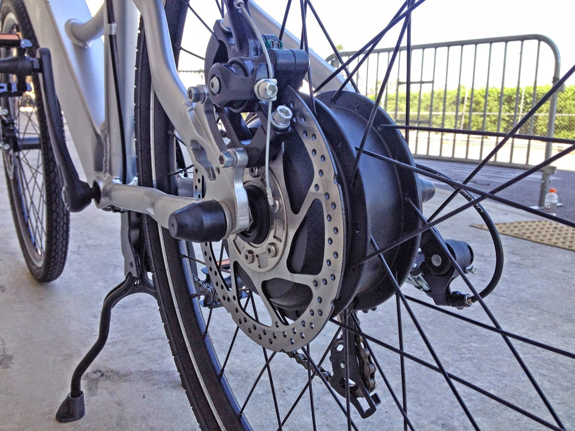

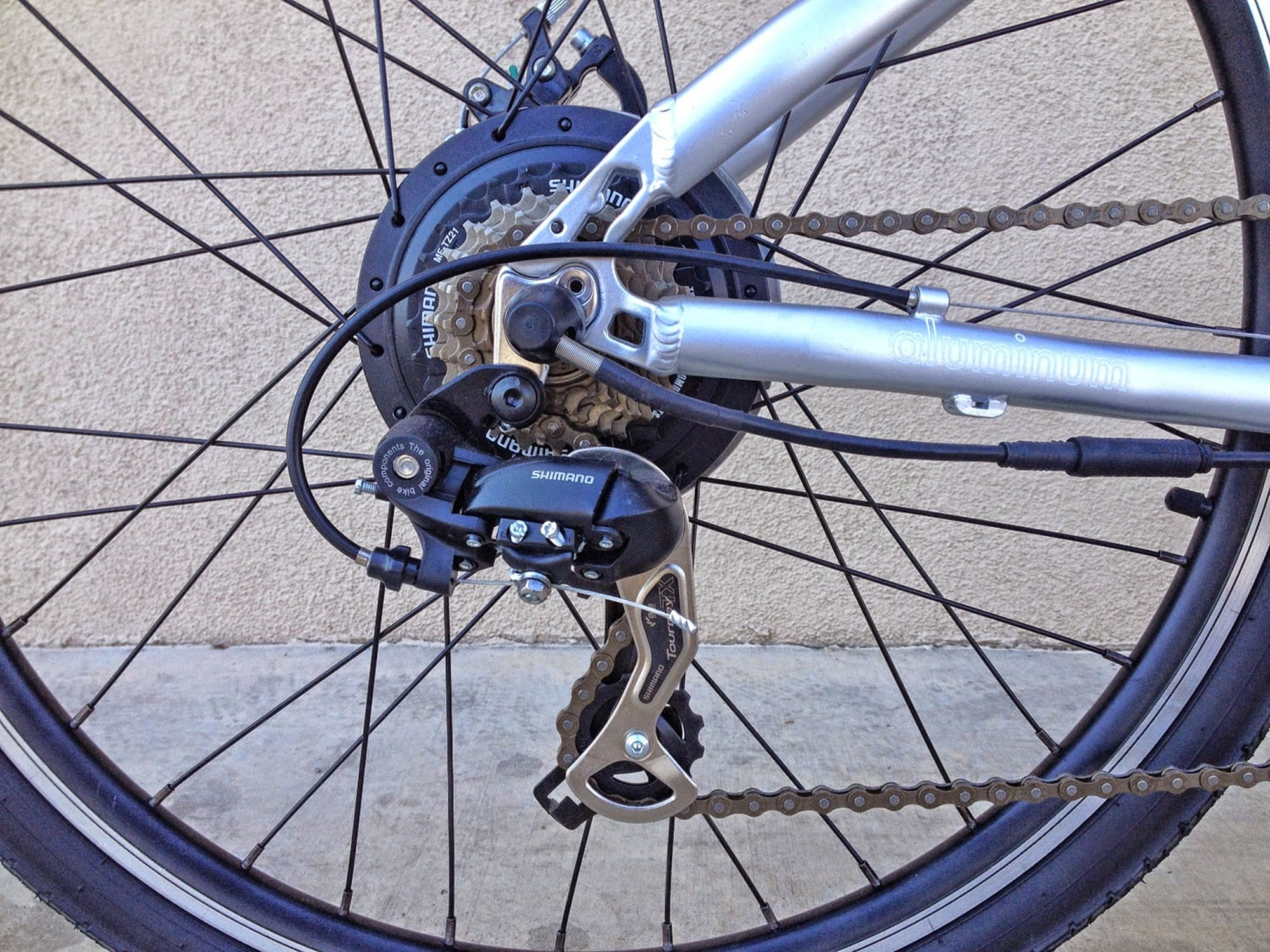

The motor on the GenZe e102 is a 250 watt geared hub that’s mounted in the rear. Being geared, it offers a bit more torque for starting and climbing and is also small and light weight but it’s not as durable as a gearless option or as efficient as a mid-drive. This is your generic, “get the job done” kind of motor and it shines in this capacity. It’s relatively quiet as shown in the video review above and it practically disappears behind the 160 mm mechanical disc brake rotor on the left and seven speed Shimano Tourney cassette on the right. Overall, this is a fairly stealth ebike meaning that it blends in with normal bikes. I also like the torque sensing pedal assist setup here, some other bikes feel too responsive and the power feels uneven as you push forward with each foot. The e102 feels smooth ovarall and climbs quiete well in pedal assist mode.

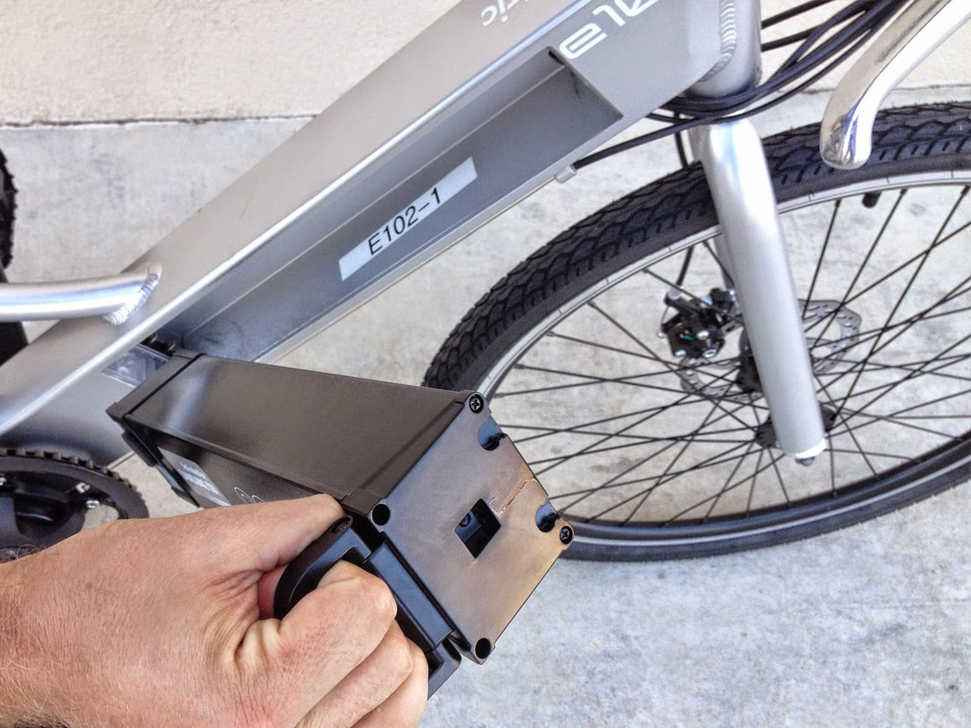

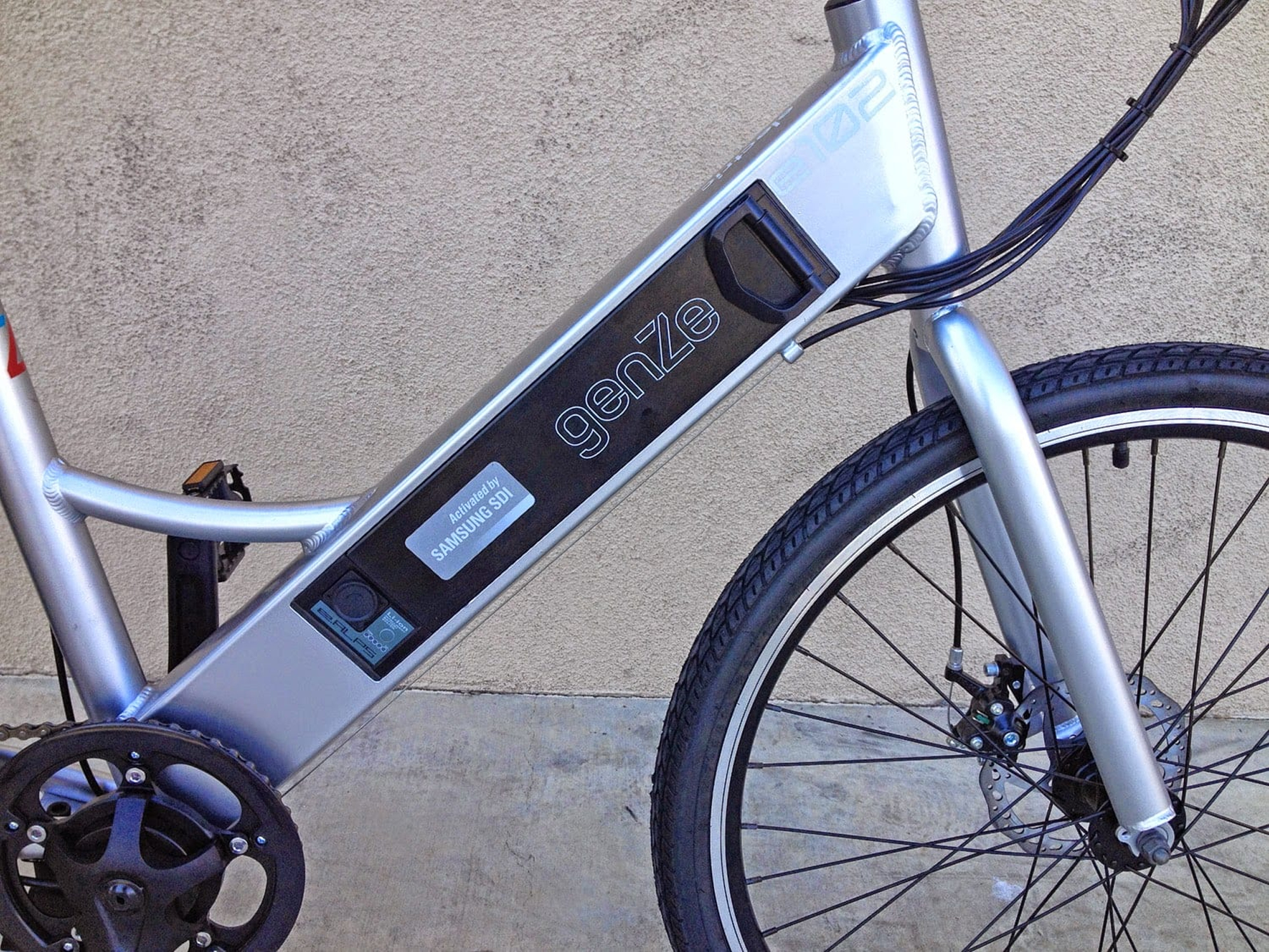

Powering the Recreational e102 is quality Lithium-ion battery pack with Samsung cells. It offers 36 volts of power and 8.7 amp hours of capacity which is slightly below average but more than sufficient for an efficient 250 watt motor. It’s a solid setup and my favorite part is the ability to remove the pack easily. This makes transporting the frame (perhaps on a car or bus rack where you might have to lift the bike) much easier. It also makes charging more convenient because you can park the bike outside and just bring the pack upstairs or whatnot. The only downside here is that the display is not removable so you’re more prone to vandalism and degradation through sun exposure over time.

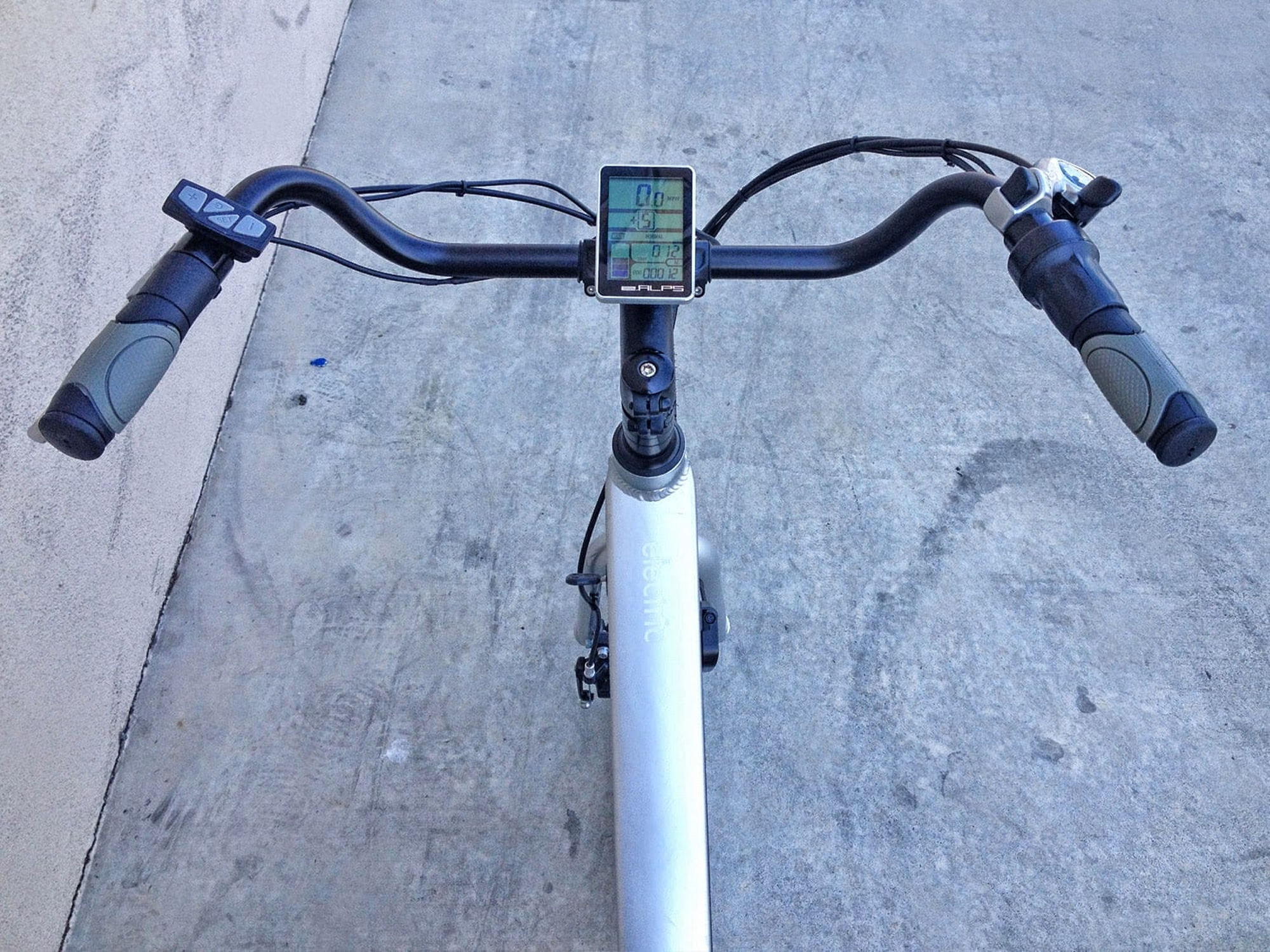

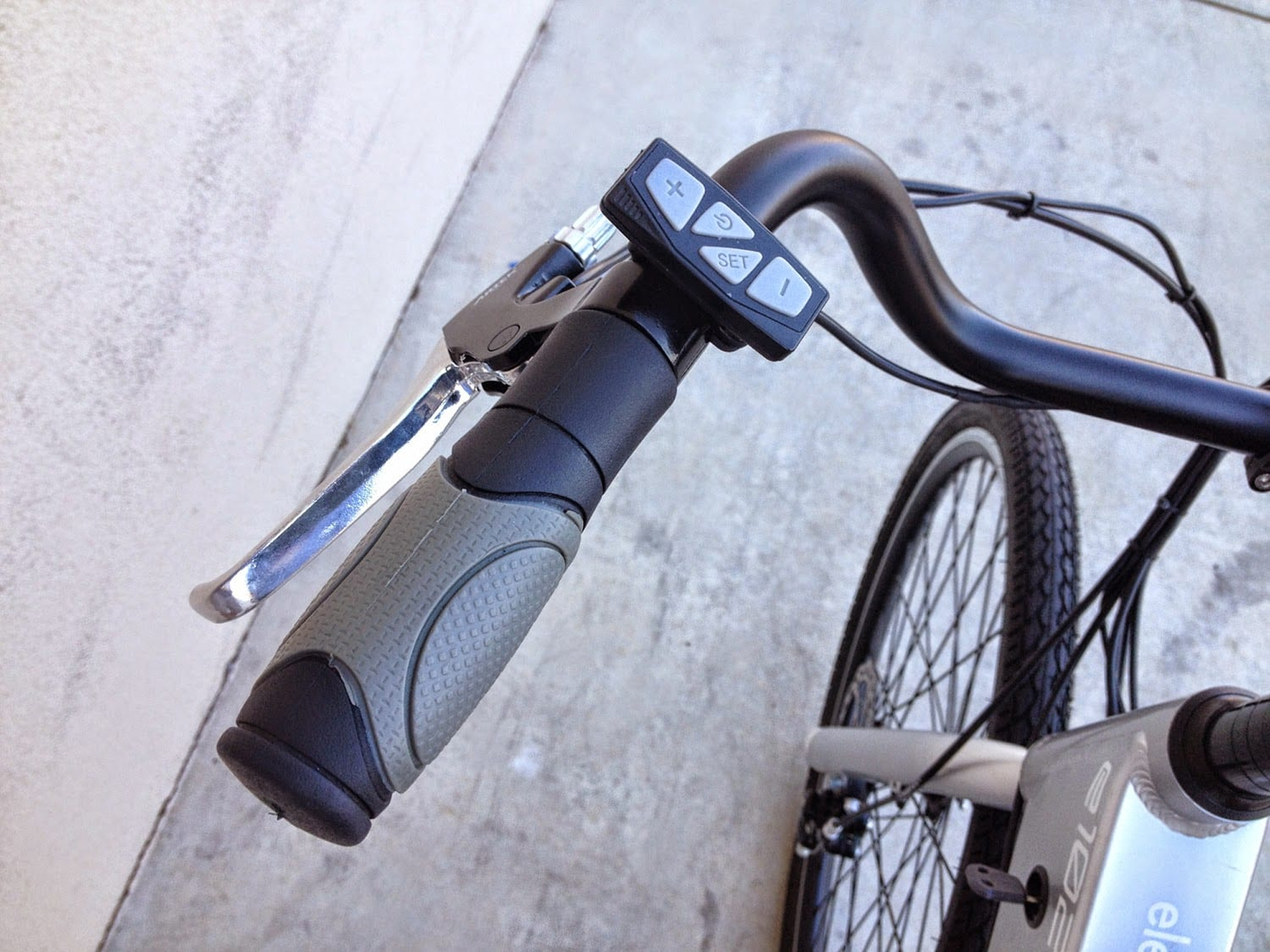

Operating this electric bike is pretty straight forward but you still get a wide range of settings to mess with. Once the battery is attached you press the remote button pad near the left grip to activate the bike. From here you can navigate up through five levels of pedal assist with each offering more power (and using the battery more quickly). Alternatively, you can arrow down to zero and just use the twist throttle for instant power. This is fun and can be very useful if you’re trying to balance a load of supplies or keep your feet up when crossing a puddle. The LCD display is backlit, large and full of standard readouts such as speed, distance traveled and battery level. I love that it swivels forward and back so you can adjust the view angle and reduce glare when riding.
