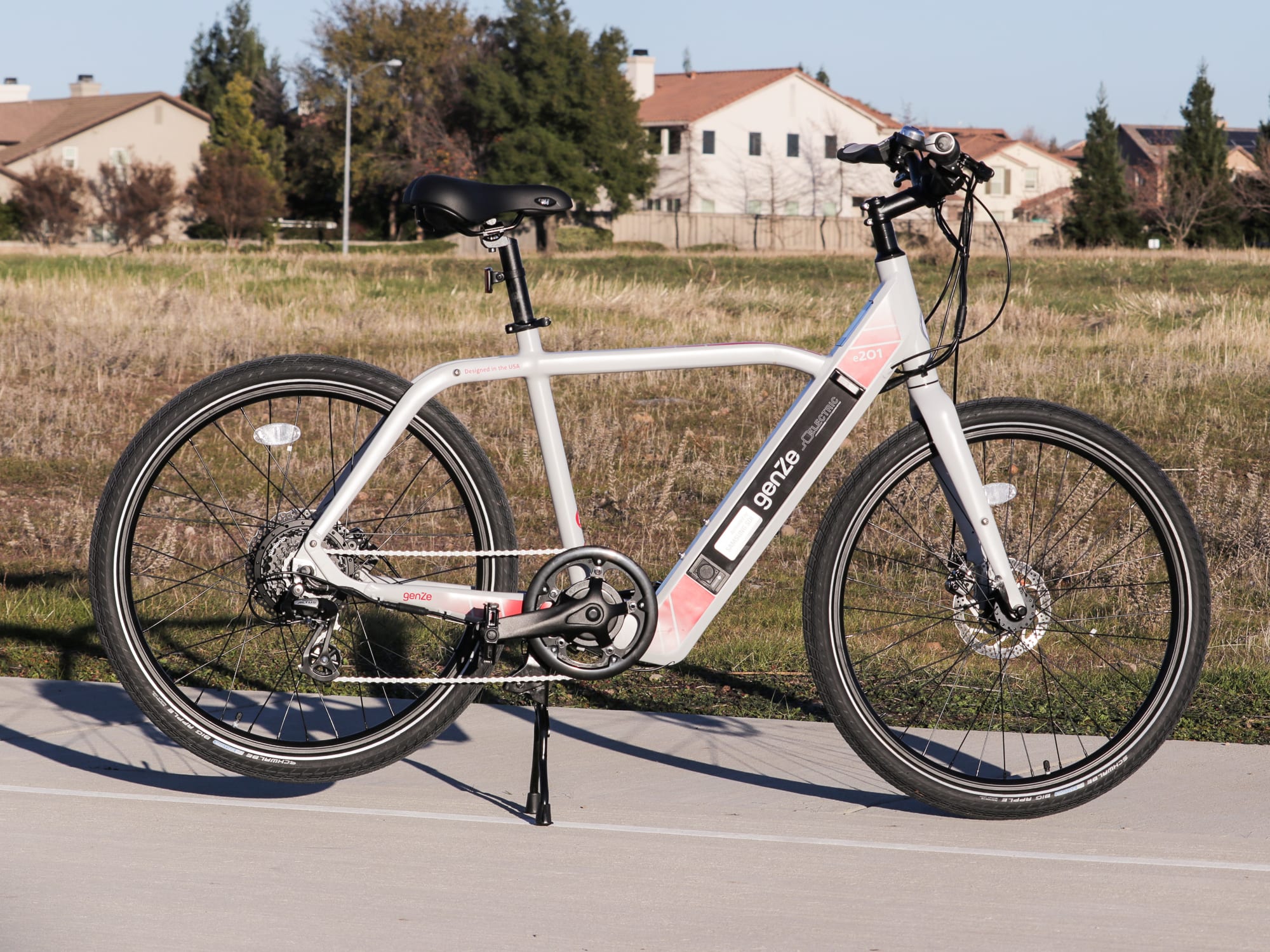

GenZe has been making electric bikes for a while, having established themselves with their 100 series several years ago – in fact, Court actually covered both the e101 and e102 all the way back in 2014. Now, GenZe has a new lineup – the 200 series – with some improvements over their earlier iterations. The e201 and e202 have more powerful motors, larger capacity batteries, a sleeker design and improved warranties. The e201 and e202 come in either 16-inch or 18-inch frame sizes with two color schemes: white with red accents or black with blue accents. The e201, which is the model I tested, is a high-step frame, while the e202 is a step-thru. I like that GenZe has a variety of frame sizes and types as opposed to a standard “one-size-fits-all” frame. I believe this allows for a wider variety of riders to find the perfect setup for them. In my opinion, the GenZe e201 is a striking bike with a unique frame design and the Ergon ergonomic grips coupled with the Selle Royale Free Way saddle and overall geometry make for a comfortable ride that feels something like a hybrid of a cruiser and a road bike. Priced at $1,899, the e201 and e202 aren’t exactly entry-level price point electric bikes, and while it seems like there are some compromises when it comes to the components, overall there are still a lot of positive aspects to these models and the smartphone app really sets it apart. I particularly like the fully integrated and removable battery that all but disappears into the frame, making these electric bikes pretty stealthy – you really have to pay attention to notice it’s electric because the motor is compact as well. The battery is surprisingly light at just 2.1 pounds, which means lugging it around the city while the e201 is parked at a bike rack wouldn’t be nearly as much of a chore as some of the heavier batteries that way upwards of six pounds. A quick turn of a key unlocks the battery and with a slight tug on the built in handle it slides out of the frame, ready to be charged on the go. I love that the battery has a handle built in too, so you won’t drop it as easily. GenZe estimates the max range of the 200 series is about 40 miles, but given the battery has 345.6 watt hours, I’d venture a guess and say the range will probably be a bit less than that, especially if you’re a larger rider like me (200 lbs) and are using the throttle and power mode a lot.

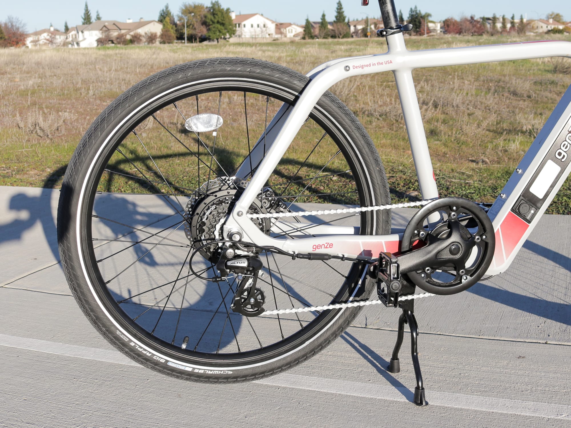

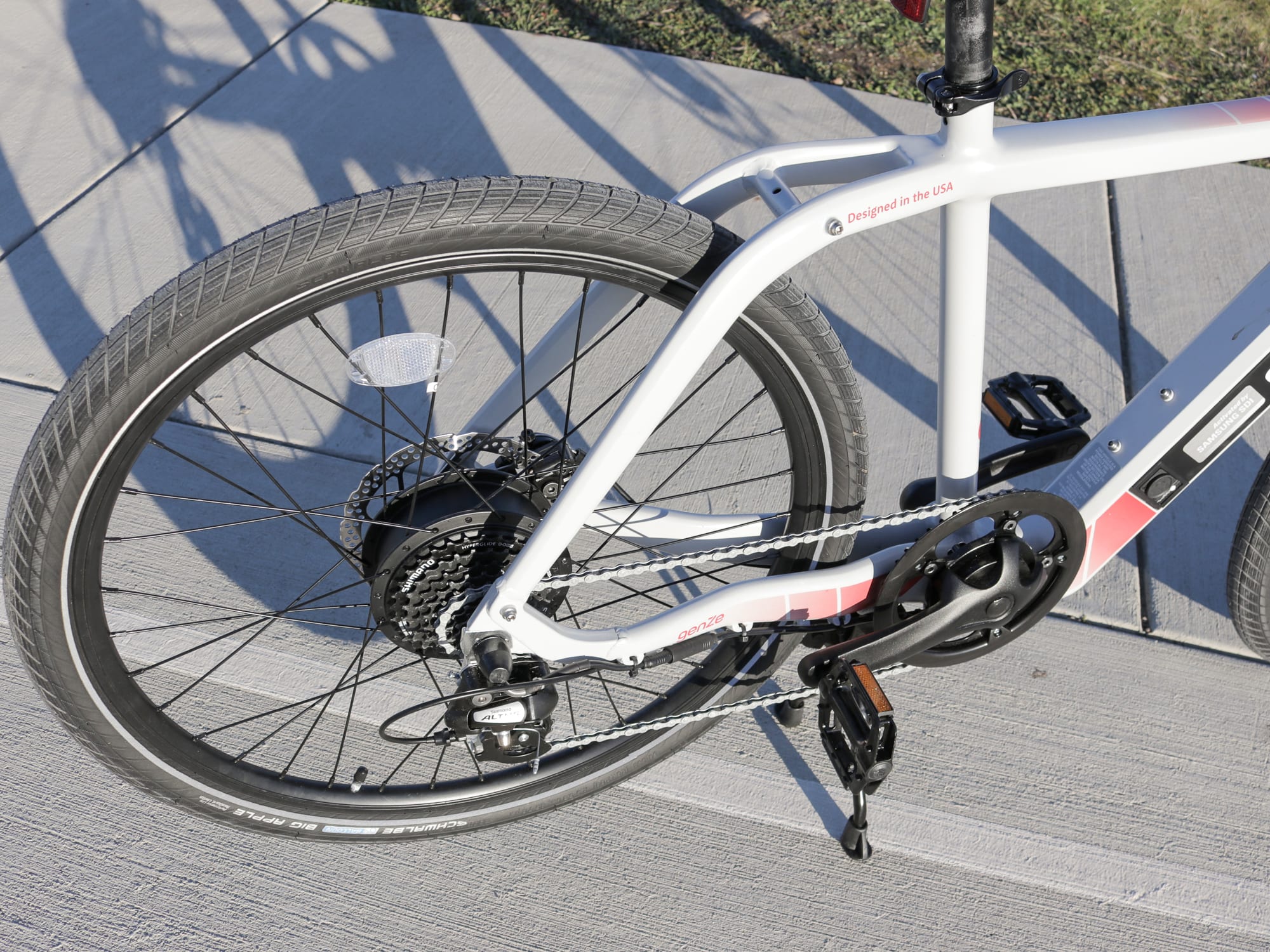

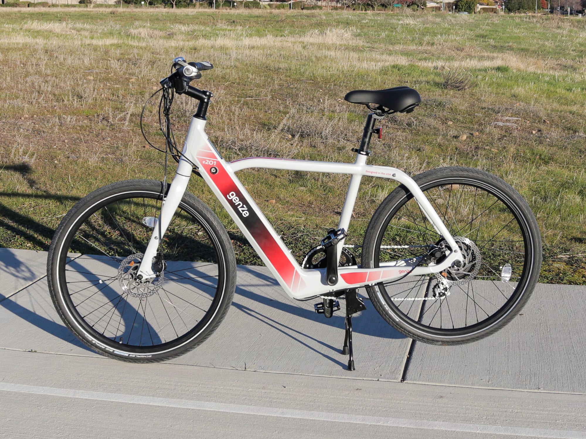

Weighing in at 49 pounds, the GenZe e201 isn’t the lightest electric bike in the world but the 350-watt geared hub motor in the rear and the integrated battery in the middle of the frame, it felt like it was well balanced. There are two different operating modes for the e201 – “Normal” and “Power” – and the power mode provides a decent amount of, well, power. Even at 350 watts the e201 felt pretty zippy, even when only using the throttle. The motor can bring this bike up to 20 mph with the throttle or with pedal assist, and even though I weigh 200 pounds I found I was able to easily reach top speed. The e201 also has a torque sensor as opposed to a cadence sensor – one of the areas where I feel GenZe opted for an upgraded component. The torque sensor felt relatively responsive and the power came on quite quickly once I applied pressure to the pedals, and perhaps more importantly power cut off just as fast when I let off the gas. I always appreciate electric bikes with quick power cut offs as having the motor continue to provide power once pedaling has stopped can make traveling at low speeds a bit tricky, and sometimes even dangerous. Imagine trying to weave in-between cars or pedestrians on a busy street at slow speeds and having the motor cranking out full power when you don’t want it to… not that I’d advise anyone do that of course. :) Thankfully, that’s not an issue with the GenZe bikes. Additionally, the 200 series have motor inhibitors, so anytime the brakes are depressed the motor instantly shuts off, even if the rider is still pedaling or twisting the throttle. The Shimano Tourney derailleur offers 8 gears to cycle through, another slightly upgraded feature.

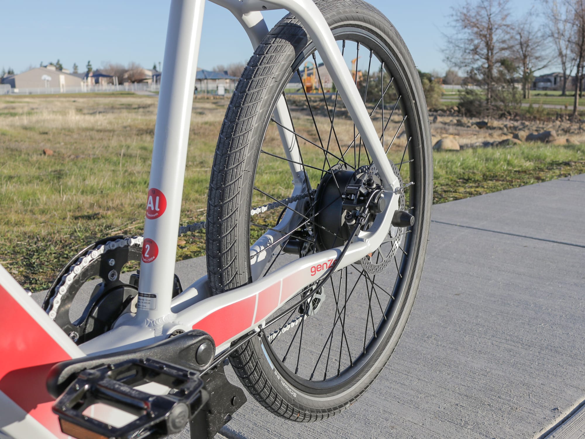

Braking power for the e201 was ample, though the mechanical disc brakes did require some extra pressure compared to hydraulic disc brakes. I think one of the upsides of having mechanical disc brakes is the ease of maintenance and adjustment. Generally speaking, they’re easier to fine tune than hydraulic disc brakes for the end user. Interestingly, the e201 has two different sized rotors for the front and rear disc brakes. The front has a 160 mm rotor while the rear has a 180 mm disc rotor. Given that the majority of stopping power comes from the front wheel (as your body weight shifts forward), I feel like it would make more sense for this to be reversed, with the larger rotor in the front and the smaller one in the rear. Still, I was able to bring the bike to a full stop pretty easily. During my brake testing I also put the motor inhibitors to work by trying to pedal while braking and also using the throttle while braking. In both instances the motor inhibitors worked as intended and power to the motor shut off as soon as I put pressure on the brake levers. I should probably note the brake levers aren’t adjustable in terms of reach, which could make grasping them difficult for those with extra large or small hands, or those wearing gloves. Maybe not, but just something to keep in mind.

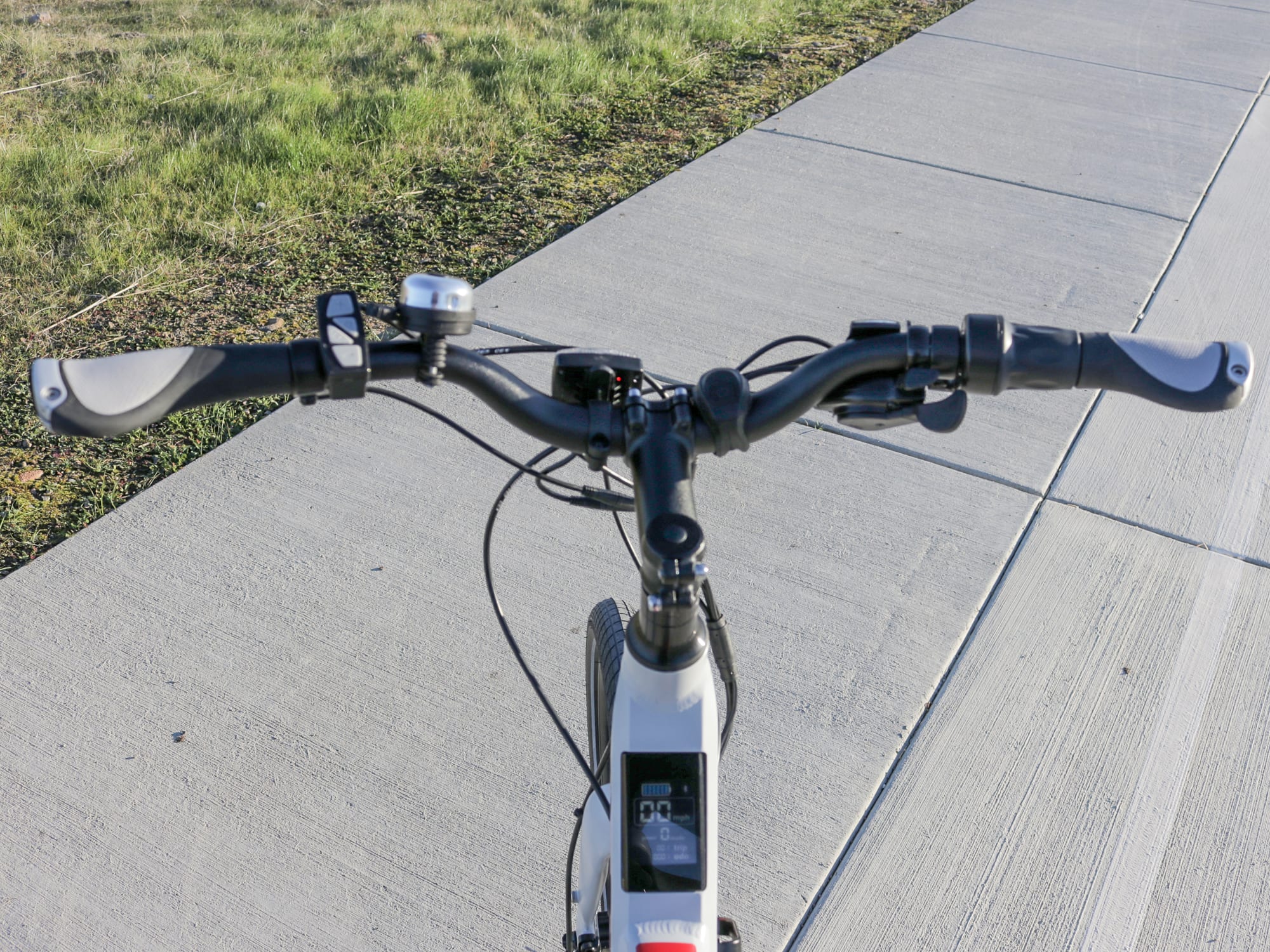

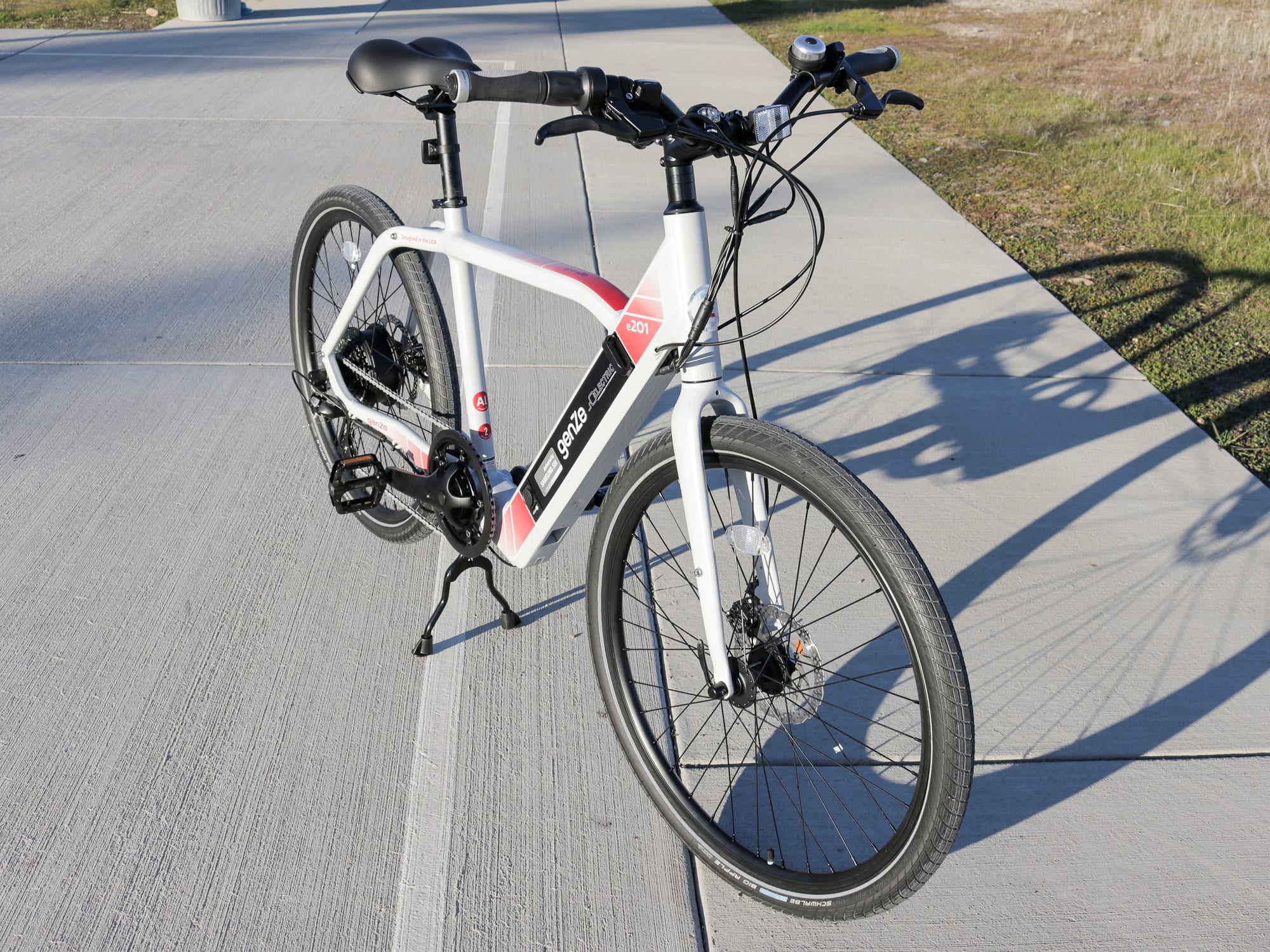

One of the areas the e201 really shines is the integrated LCD control center and its corresponding app. The control center on the bike itself probably has enough information to satisfy most riders – a 6-bar battery level indicator, current speed, tripometer, odometer and pedal assist level – but the app has an incredible amount of additional information. And because the main display is integrated into the top-tube, you have plenty of room on the handlebar to mount your phone! On the smartphone app homescreen, you can see battery level in precise percentages, as well as a range estimation based on the current pedal assist setting and the ambient temperature. On the “Trips” tab there’s a built-in navigational tool where riders can input a destination and then get turn-by-turn directions. Very sweet. The app can diagnose the bike if there’s a problem, tracks all activity and displays it in graph form and also provides an overall synopsis of the bike. I really dig the app if you can’t tell. That being said, the display’s location on the top of the downtube makes viewing stats while riding somewhat difficult. I had to tilt my head down quite a bit in order to read it, obscuring obscuring my view ahead, and while I was in a safe area this could be dangerous in busier locations. The display is also non-removable, which means it’s going to be constantly exposed to the elements and possibly scratched at racks.
The GenZe e201 feels like it would be a great electric bike for shorter trips around the city. There’s rear rack bosses so riders can throw on a rack and stow their gear, and also fender bosses to attach fenders to help keep riders dry and clean. The Selle Royalle Free Way saddle, Ergon ergonomic grips, wide pressurized 2-inch wide tires and overall frame geometry make for a relatively comfortable ride. But since there’s no suspension, longer treks could prove to somewhat uncomfortable (I definitely felt this when riding through some grass off-road). The e201 feels like a responsive electric bike that’s enjoyable to ride and I want to thank GenZe for partnering with me on this review.

- The front disc brake rotor is smaller than the rear, and since most stopping power comes the front wheel it seems like that should be the other way around

- The tube-integrated display looks neat and keeps the handlebars clutter-free but it requires you to look further down to get to the readouts vs. something up higher and more forward where you’re already looking as you ride, the good news is, you now have plenty of room on the bars to mount your phone with something like this
