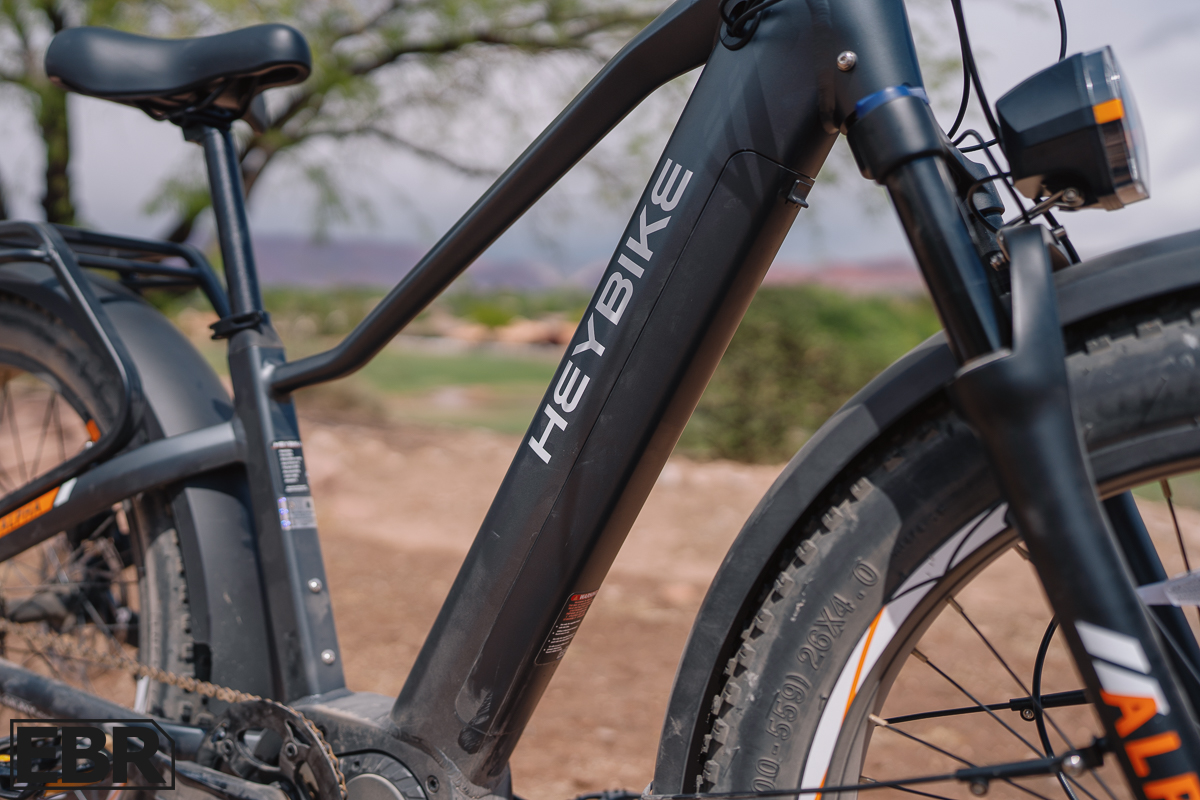

The Galaxy Black Heybike Alpha arrived for testing, and unboxing it was a pleasant surprise. The new alloy frame sports a sleek, modern design, moving away from the bulky fat-tire frames that dominated e-bikes in recent years. It’s a refreshing look that feels both stylish and functional.
Fit-wise, the high-step Alpha is advertised for riders from 5’3” to 6’3”, while the step-through version accommodates 5’1” to 6’1”. At 5’11”, I found the high-step version spot-on, with no fit issues. The frame’s geometry strikes a great balance, offering an upright position that works equally well for leisurely cruises or more aggressive weekend trail rides. The design avoids unnecessary bulk while maintaining the rigidity and responsiveness you’d expect from a capable e-bike. It’s a modern frame that doesn’t compromise on performance.

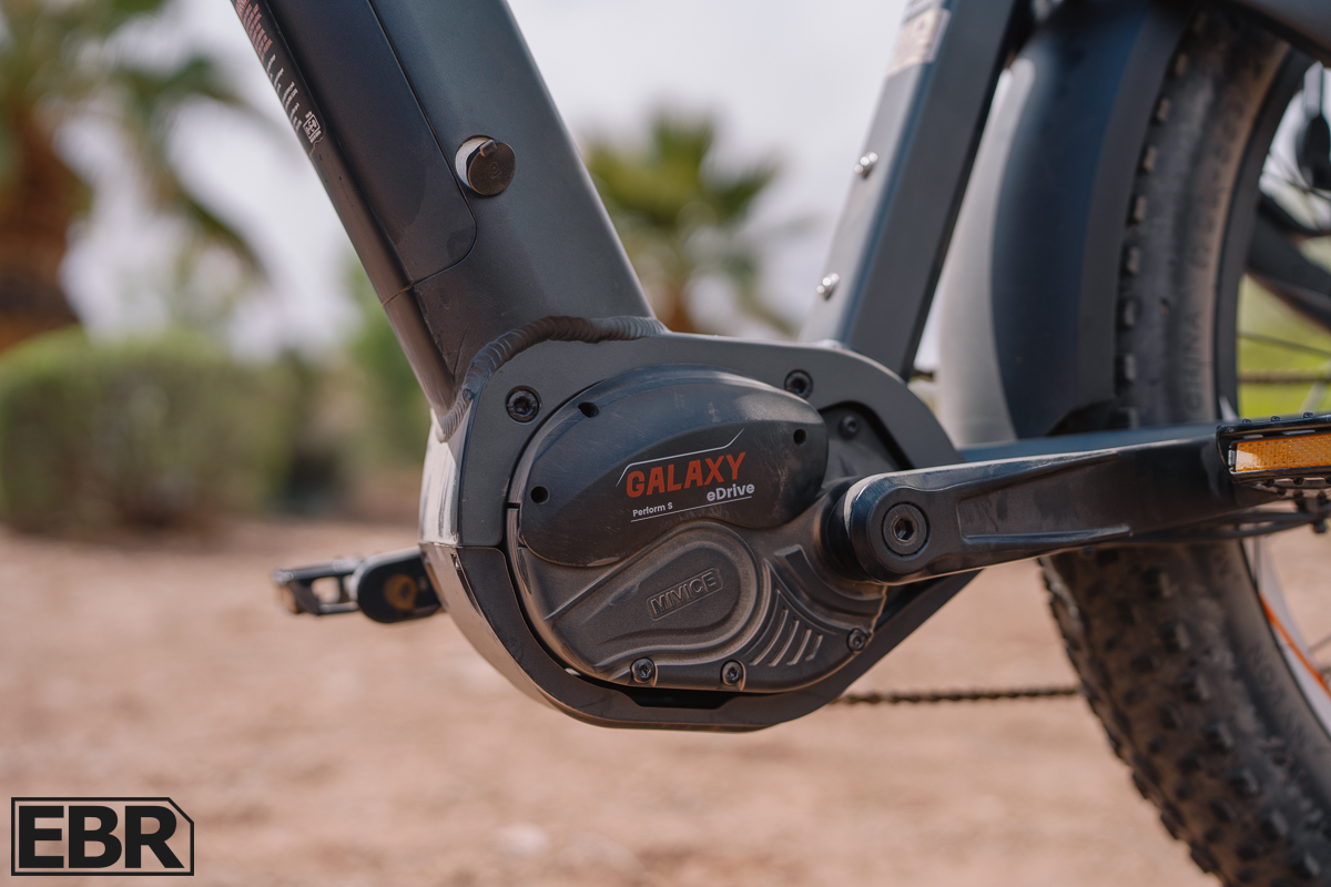

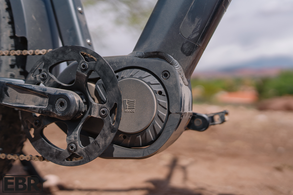

The standout feature is the MIVICE mid-drive motor, boasting a 500W nominal rating and an impressive 105 Nm of torque. Its pedal assist rivals pricier mid-drive systems I’ve tested—smooth, quiet with no annoying e-bike whine, and powerful enough to handle flats or steep hills with ease. Honestly, it feels like it belongs on a more expensive bike.

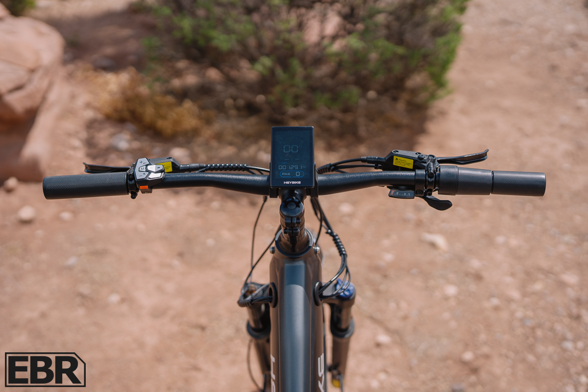

One quirk to note, the throttle isn’t your typical setup. Instead of a full-power option, it’s designed more like a cruise control, capping speeds at 14–18 mph for relaxed town rides. It won’t hit the expected 20 mph, and you can’t use it from a standstill—you need to pedal to get moving before engaging it. This is intentional, protecting the drivetrain from the immense torque of the mid-drive motor. Full-throttling from a stop could shred the chain, cassette, and chainring in days, so Heybike cleverly programmed the throttle to prioritize longevity while still offering a cruising option.

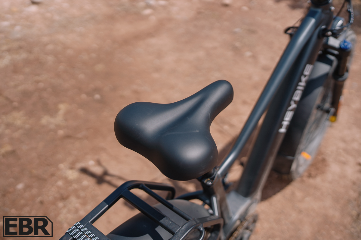

The ride itself is smooth and comfortable, thanks to the plush saddle, 4-inch-wide tires, and front suspension fork. Together, they make for a ride that’s as enjoyable as it is practical, soaking up bumps without sacrificing fun.

I’ve spun my share of e-bikes with MIVICE rear hub motors, and their quiet, buttery delivery always impressed me, so I was stoked to test the Heybike Alpha’s MIVICE X700 mid-drive—a first for me with this brand.
This 500W unit, pumping out a hefty 105 Nm of torque, powers a $1,499 fat-tire rig that’s left me rethinking what a budget mid-drive can do. Paired with a 680Wh battery, it’s a combo that’s kept me rolling far and feeling refined, and after putting it through its paces, here’s what stands out.
The X700 mid-drive is a beast—105 Nm is eMTB-level grunt, enough to muscle up steep grades or haul gear without flinching. It’s IP66-rated, UL 2849-certified, and looks sharp with a BOSCH-esque aesthetic, but what got me was the ride.
The torque sensor delivers pedal assist so smooth it feels like a high-end unit, syncing with my cadence for a natural, almost acoustic-bike vibe—none of that jerky surge you get with cheaper systems. It’s near-silent, too, letting me hear the crunch of gravel or city hum instead of motor whine. I pushed it on climbs and loaded trails, and it responded with poise, though Heybike doesn’t specify the peak wattage (likely north of 1000W based on feel and torque).
The 48V, 14.1Ah battery (680Wh, UL 2271-certified) slots neatly into the alloy downtube, weighing a svelte 7.4 lbs. It’s removable with included keys, so I could charge it indoors or lock it tight for commuter parking—handy for urban life. The standard 2A charger takes 6-8 hours to top it off, which is par for the course.

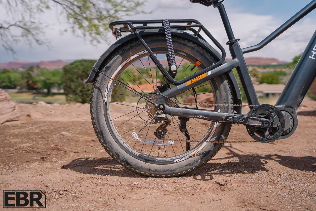

The Heybike Alpha’s component spec is all about getting the job done without flash, and after testing my preproduction step-through model, I’m impressed by how it balances utility and longevity for $1,499. With a focus on keeping the drivetrain alive under the MIVICE mid-drive’s torque, plus solid brakes and fat tires, it’s a setup that’s ready for the Alpha’s all-terrain mission. Here’s how it shakes out from the saddle.
The drivetrain leans on a Shimano Altus 8-speed rear derailleur, paired with an 11-32T cassette and a 42T chainring. It’s not the lightest or sexiest—Acera’s the workhorse cousin to high-end groupsets—but it shifts clean and reliable, handling my city loops and trail jaunts without a hiccup.
Braking comes from unbranded 2-piston hydraulic disc brakes with 180mm rotors (1.8mm thick). They’re not overbuilt for downhill bombs, but they don’t need to be—this is a consumer e-bike for mixed riding, and the brakes stop my 180 lbs plus the 71 lb bike with confidence on pavement or light trails.
They’re effective, low-maintenance, and keep the build cost down, which I respect for a rig in this price bracket. No, they’re not Shimano XT-level snappy, but they’re right for the Alpha’s everyday vibe.

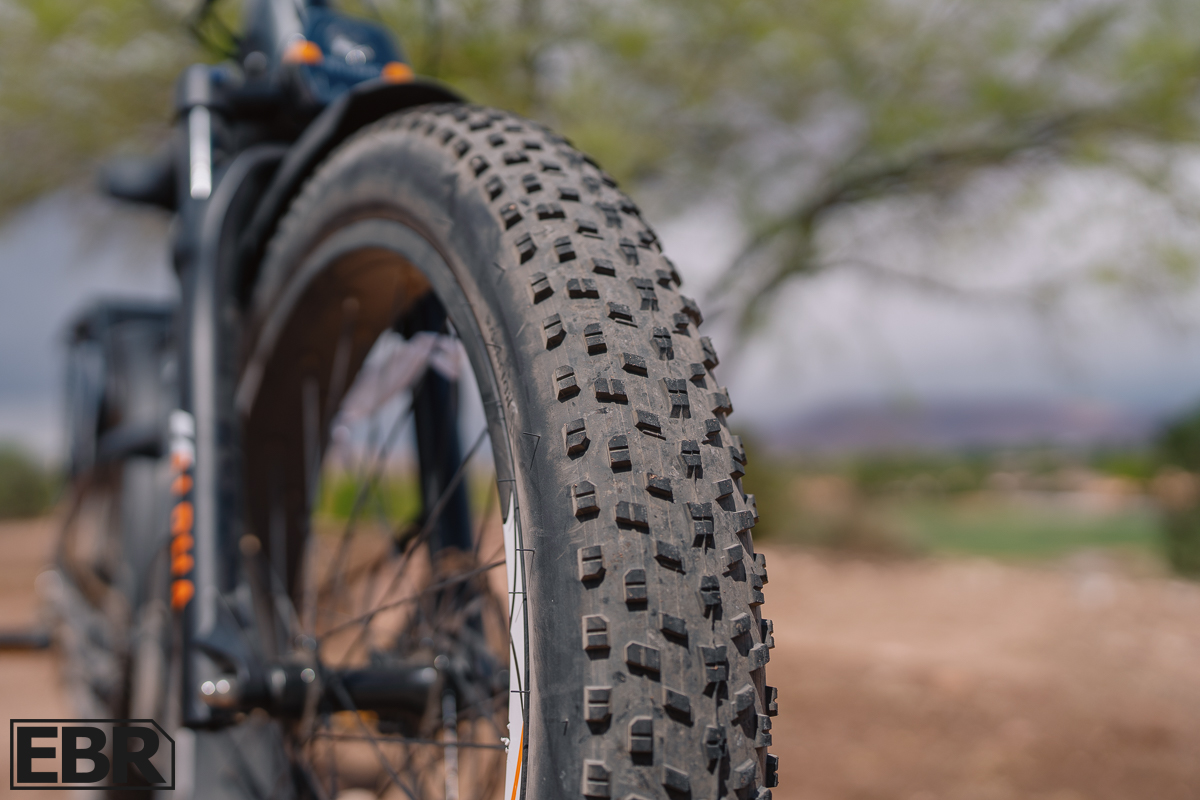

The wheels and tires are where the Alpha’s fat-tire soul shines. The 26-inch rims, with an offset spoke pattern for extra resilience, are wrapped in 4.0” wide tires sporting a mild knobby tread. They’re a sweet spot for casual cruises or light off-road—grippy enough for gravel or dirt, yet quiet on asphalt, giving me versatility without the drag of hardcore MTB rubber. I’ve rolled them through city paths and trail detours, and they’ve held steady, though the extra width adds some heft to the ride.
The cockpit keeps it clean and functional. An alloy flat bar anchors a tidy setup, with cables internally routed to the frame for a sleek look. Shimano trigger shifters and brake levers flank the bar, with a PAS/display control pad on the left—intuitive and uncluttered. The full-color LCD display (more on that later) sits center stage. One oddity: the stippled rubber/plastic grips feel tacky at first, but as my hands got sweaty on longer rides, they turned slippery—not ideal if you’re prone to palm sweat. It’s a small gripe, but swapping them out might be on my list.
For a bike pitched as an all-purpose explorer, this kit delivers. The drivetrain’s longevity focus, wallet-friendly brakes, and versatile tires align with the Alpha’s do-it-all ethos, while the cockpit’s simplicity keeps the ride fuss-free. It’s not a spec sheet to drool over, but it’s a cohesive package that’s held up to my mixed riding demands—proof you don’t need bling to build a solid e-bike.

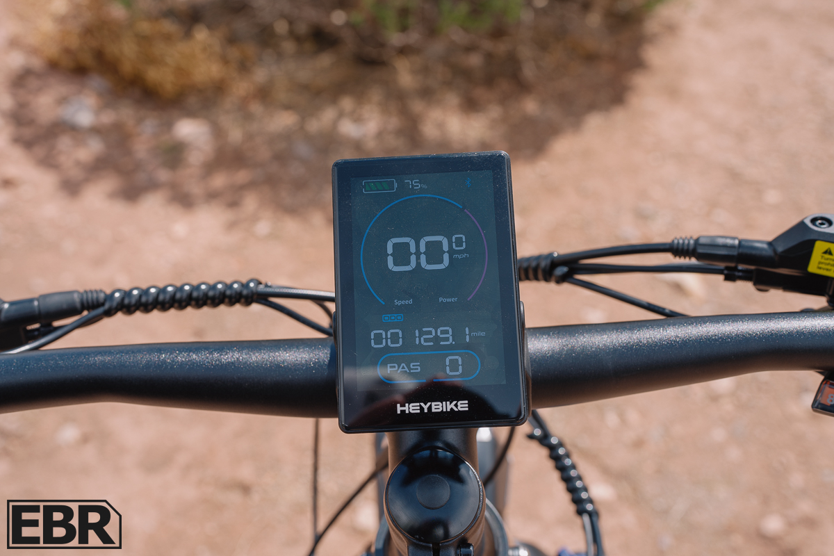

Screen / User Interface / App
The Heybike Alpha’s full-color display and app are its nerve center, and after logging miles on my preproduction step-through, I’ve got a solid read on how they steer this $1,499 fat-tire rig. Designed to keep things simple yet customizable for all-terrain riders, the setup delivers the essentials with a few quirks. Here’s what I found as I poked through the screen and app, tweaking settings and tracking rides.
The display’s a bright, full-color LCD that pops even in sunlight, laying out the vitals clearly. At top left, a five-bar battery meter sits next to a percentage readout—handy for precise planning. Top right, a Bluetooth icon lights up when paired with the Heybike app. Speed takes center stage, with ODO and trip meters below and the PAS level (0-5) at the bottom.
A weatherproof flap guards a USB-C port, a nice touch for juicing a dying phone mid-ride—I’ve used it to keep my GPS alive on longer loops. The interface is intuitive, but the real depth’s in the advanced settings. Hold the plus and minus buttons to dive into a menu where you can reset the system, swap MPH for KPH, adjust sleep timers, set wheel diameter, tweak PAS levels (0-3, 1-3, 0-5, or 1-5), cap speed, or add a startup password for security. It’s powerful but not user-friendly—you’ll need the manual to decode the symbols, which feels like a step back for a bike this modern.
The Heybike app mirrors most of those tweaks and adds some flair. It’s effective for adjusting PAS, speed limits, or wheel settings, plus it tracks rides for sharing and handles OTA firmware updates wirelessly—a big win for keeping the Alpha current. I’ve synced it via Bluetooth to name my bike and log trips, and it’s stable enough. But here’s the rub: in April 2025, the app’s still decked out in a Christmas 2024 theme, complete with holiday icons and festive vibes. It’s quirky, not a dealbreaker, but it screams “we’re not updating this regularly.” Don’t expect frequent polish or new features.
For the Alpha’s all-purpose pitch—commutes, trails, or loaded hauls—this display and app get the job done. The screen’s clarity and USB-C port are practical for daily riding, and the advanced settings let me tailor the bike to my style, even if it’s a clunky process. The app’s ride tracking and updates are a bonus, but the stale holiday flair hints at a hands-off approach. It’s a solid control hub for a sub-$1,500 e-bike, just don’t expect the slickness of pricier brands. I’ve tweaked it to fit my rides, and it’s kept me in command—Christmas jingles and all.

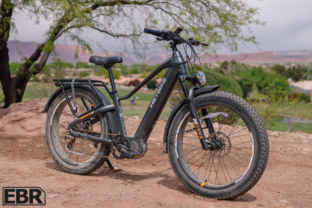

Heybike Alpha Model Options
The Heybike Alpha comes ready to roll for a range of riders, and after testing my preproduction high-step model, I’ve got a clear view of how its options stack up. At $1,499, it offers two frame styles, distinct colors, and a practical accessory package, all tuned for the Alpha’s all-terrain versatility. Here’s what you’re working with—and how it fits the bike’s do-everything ethos.
The Alpha comes in high-step (HS) and step-through (ST) configurations.
The HS, with a 29-inch stand-over height, suits confident riders and feels stable at speed, fitting folks from 5’3” to 6’3”. I’ve been riding this one, and it’s solid for longer hauls or trail detours. The ST, with a 16.5-inch step-over, is a better pick for those new to e-bikes or easing back into riding, offering easier mounts and dismounts for 5’1” to 6’1” riders. Both frames handle the 400 lb max payload, though the ST’s lower entry gives it an edge for balance-conscious commuters or casual cruisers.
Colors are tied to the frame choice. The HS comes in Galaxy Black, which my test bike sports—more of a deep charcoal grey than the “blacked-out” look I expected, so keep that in mind if you’re chasing a stealth vibe. The ST gets Pearl White, which tracks true to its bright, clean name. They’re not bold, but they’re functional, fitting the Alpha’s practical appeal.
Included accessories lean toward utility.
The rear rack is standard, great for panniers or light cargo, but Heybike doesn’t specify a payload limit, only citing the bike’s 400 lb total capacity. When I reached out, they advised sticking to the bike’s max, so I’d cap the rack at 55-60 lbs—standard for most e-bike racks—to play it safe. I wouldn’t push it further without a rated spec.
Commuters will dig the front and rear LED lights with turn signals, plus fenders to fend off splashes. The 100mm hydraulic fork adds cush for rough roads, though it’s more commuter-friendly than trail-tough. Optional accessories from Heybike include front racks, bags, and other staples, sold separately to customize your setup.
Mounts give you room to grow. The frame’s got bosses for a front rack and bottle cage, plus the existing rear rack, fender, and light mounts in use. It’s a solid starting point for tweaking the Alpha into a commuter, tourer, or trail buddy—versatility that matches its fat-tire, go-anywhere pitch. My test rides leaned on the stock setup, and it handled city runs and light dirt fine, but adding a front rack could open up longer adventures.
The Alpha’s options cover the bases for its all-purpose goal. The HS and ST frames fit a wide range (5’1” to 6’3”), and the accessories—while not heavy-duty—support commuting or casual exploration. The lack of a clear rack payload’s a bummer, and color choices are limited, but the package feels cohesive for a sub-$1,500 e-bike. It’s got enough flexibility to grow with your rides, whether you’re hauling gear or just cruising.
