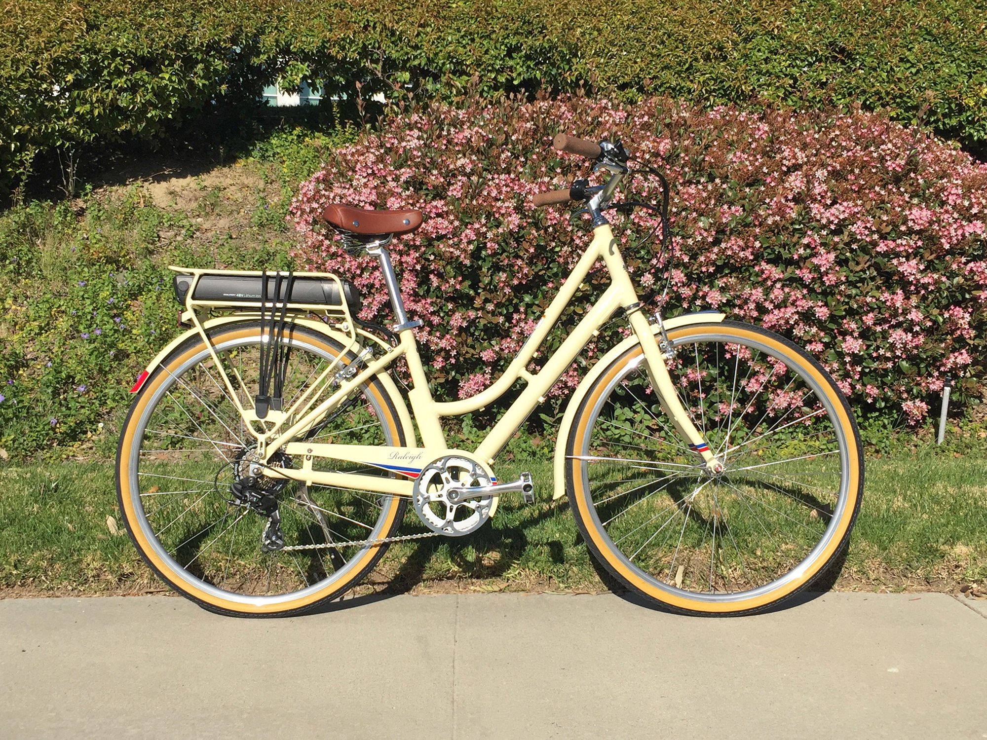

The Raleigh Superbe iE is a bicycle first, with just a dash of electric. And that’s not to say it isn’t powerful or effective… just that the drive system doesn’t get in your way or change the appearance much. This is a beautiful, vintage-styled electric bicycle harkening back to Raleigh’s long, rich history of bicycle making in England. I love how approachable this bike is, especially the step-thru version. It’s available in two frame styles including a diamond high-step that rides a bit stiffer but isn’t as easy to mount. Both frames only come in one color but they are different (a cream for the step-thru and brown for the high-step). You get three frame sizes spread out across four style/size combinations. For this review, I was riding the small step-thru but was able to raise the saddle enough pedal comfortably. The geometry is relaxed and upright with swept-back handlebars, comfortable rubberized cork grips and a cushiony sprung saddle. Even though you won’t find a suspension fork or larger balloon tires here and the frame is all Aluminum (not exactly known for comfort) it actually felt pretty good to me. This is a Class 1 e-bike that can reach 20 mph in the US or 15.5 mph in parts of Europe with pedal assist only operation. You get seven gears to pedal with and a large easy to understand shifter. And while the Tourney drivetrain is at the bottom of the Shimano line in terms of performance and quality, the cassette offers good range with a Mega gear for climbing. This is, after all, a ~51 pound bicycle. The only missing feature was lights and the frame actually comes pre-wired for them so ask the dealer if you plan to ride in nighttime conditions.

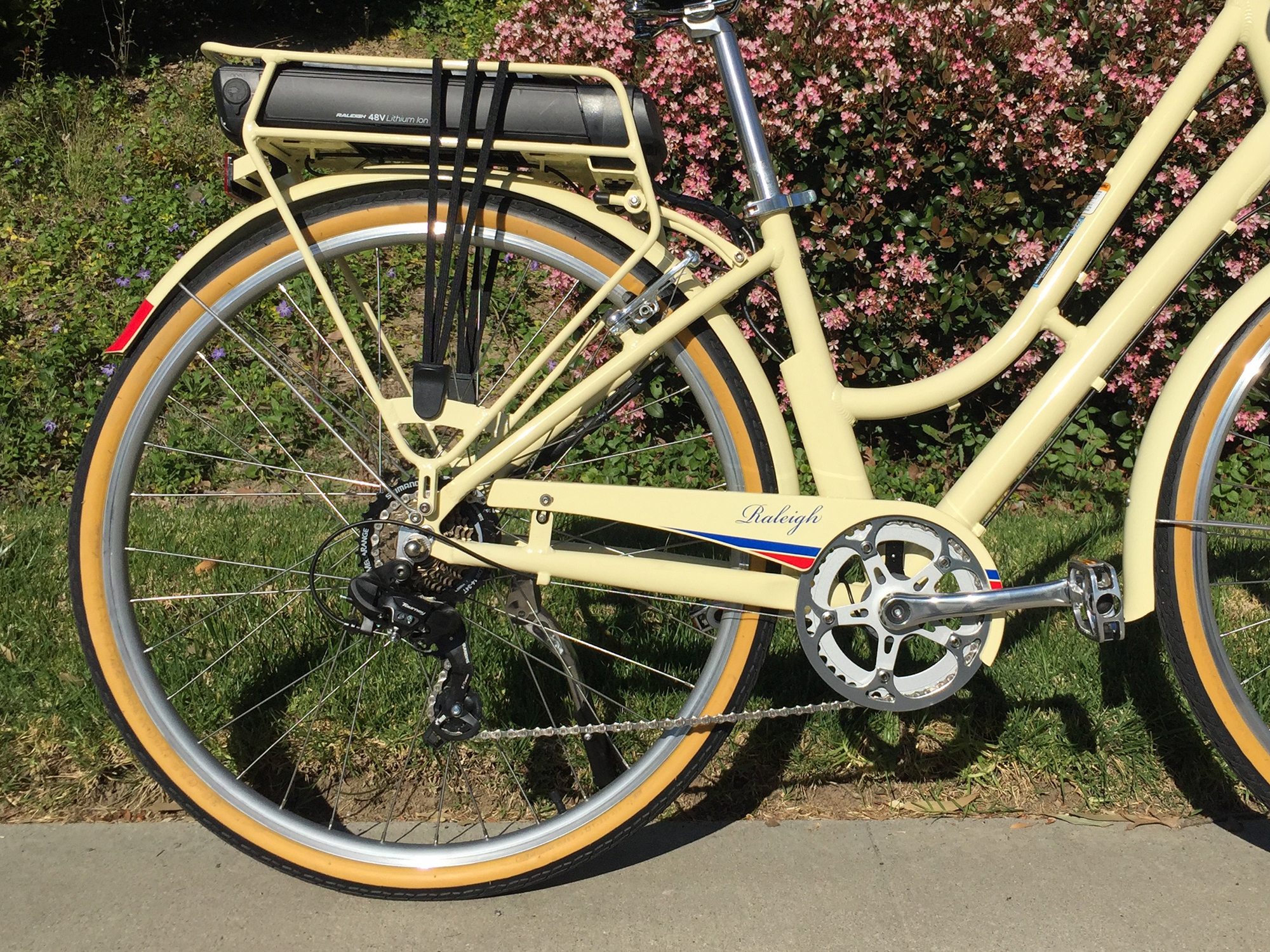

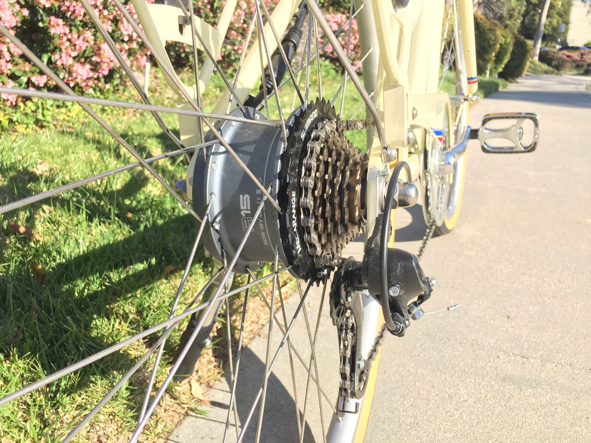

Driving the bike is an average power 250/350 watt internally geared hub motor. It’s mounted in the rear wheel and almost disappears behind the cluster of sprockets. While the rating on this thing is average, it performed very well and was exceedingly quiet during my test rides. I had no problem climbing small hills and found that the 12-magnet cadence sensor was very responsive without making the bike feel jerky. As a person with sensitive knees, I appreciate how cadence sensors can take the work out of e-biking by listening only for crank arm movement and not force like torque sensors. They are bit simpler and cheaper but when the motor controller is programmed well, as it is here, they can be delightful. The only drawback is that they don’t offer power instantly when starting from a complete stop. If you haven’t planned ahead and shifted down, this could result in a very difficult first pedal stroke before the bike realizes you need assist and jumps in. Another highlight with the electronic drive system is how well the motor is wired with the power cable coming into the side of the axle vs. the end (which exposes it to bends and snags). Note that both wheels are fastened to the bike with nuts vs. quick release and the tires are more basic so you might want to bring a tool and a patch kit or cell phone in case you wind up with a leak.

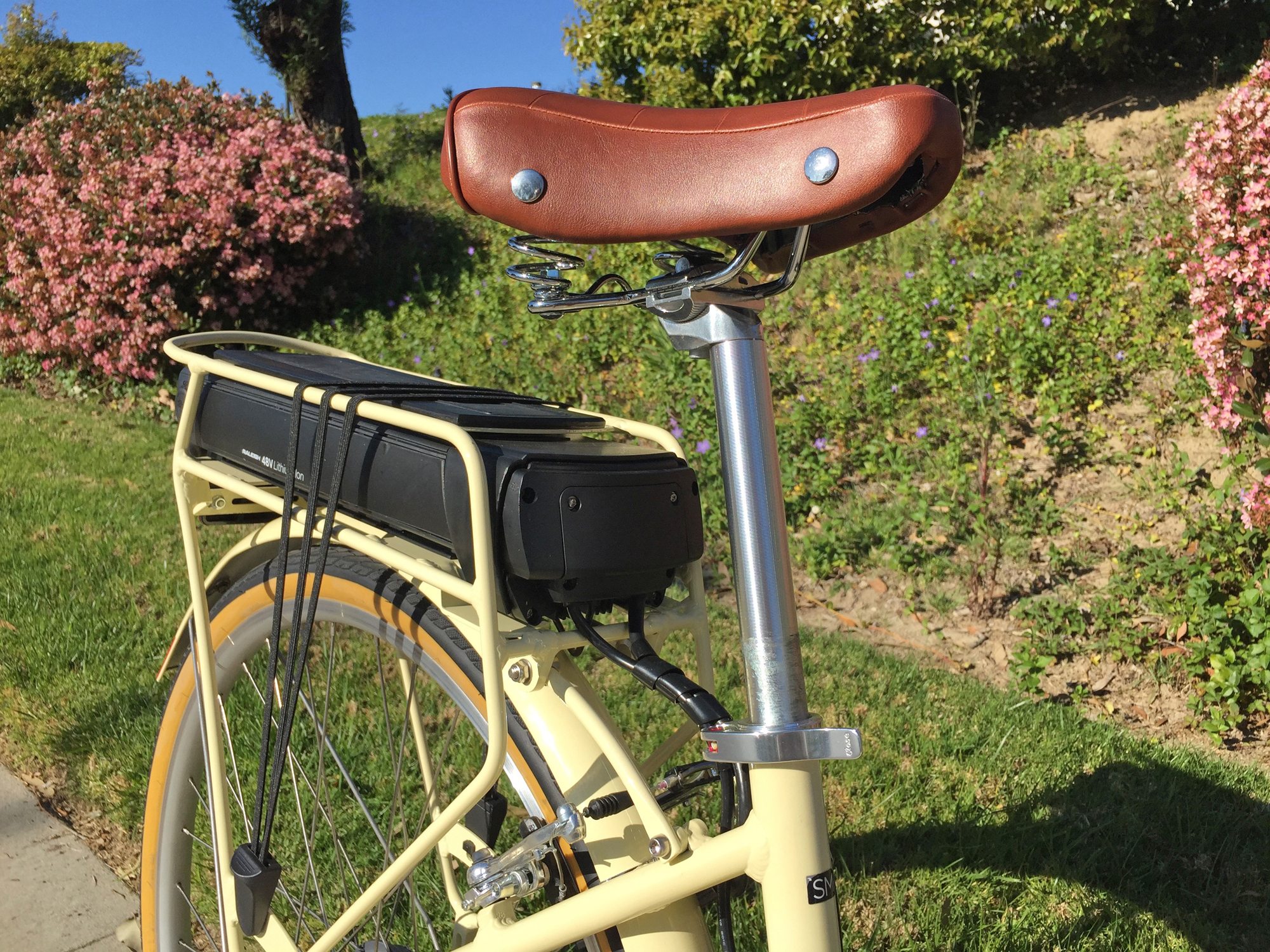

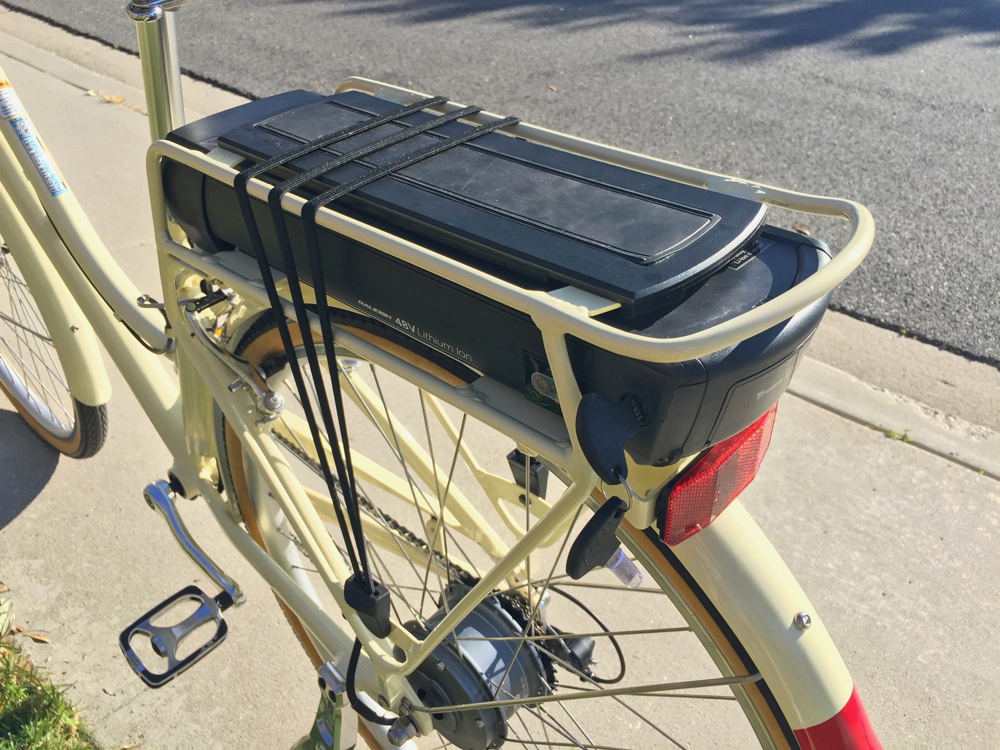

Powering the motor and display panel as well as lights (if you choose to wire them in) is a rear-mounted removable battery pack. It offers efficient 48 volt power with 8.8 amp hours for an average capacity. Some older Raleigh electric bikes ran on 36 volts which didn’t seem as peppy. I don’t know what the Amperage is here on the Superb iE but as I mentioned before, it felt surprisingly capable given the size and low noise being produced under full power. The battery pack is well done with a magnetic handle at the back (great for pulling it off the bike and carrying it around safely), an integrated fuse for safety and an LED charge level indicator on the left side towards the back. You can see how full the battery is whether it’s on the bike or not and you can charge it on or off the bike which is super handy. I tend to park my bike in the garage and store my battery inside for charging and it’s the same setup at the office. Being able to remove the ~7.4 lb battery also makes the bike itself lighter and easier to work on or transport. Inside are premium Lithium-ion cells produced by Panasonic and they are covered by a leading two-year warranty. My only complaints with the battery are how it can be difficult to slide on and pull off because the track is tight… though perhaps it will loosen up over time? And also, how you have to press the LED power button before you can press the power button on the control pad near the left grip in order to actually operate the electric systems of the bike. It can be easy to get excited and hop right on the bike only to have to get off again to press the battery power button (unless you’re more flexible than me and can reach!).

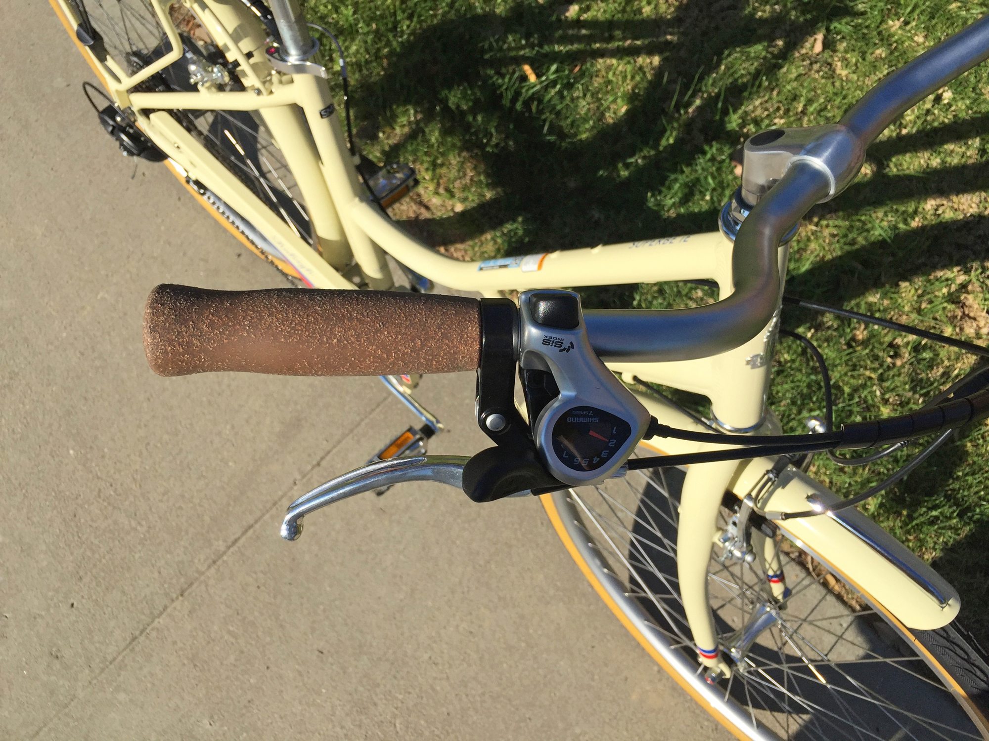

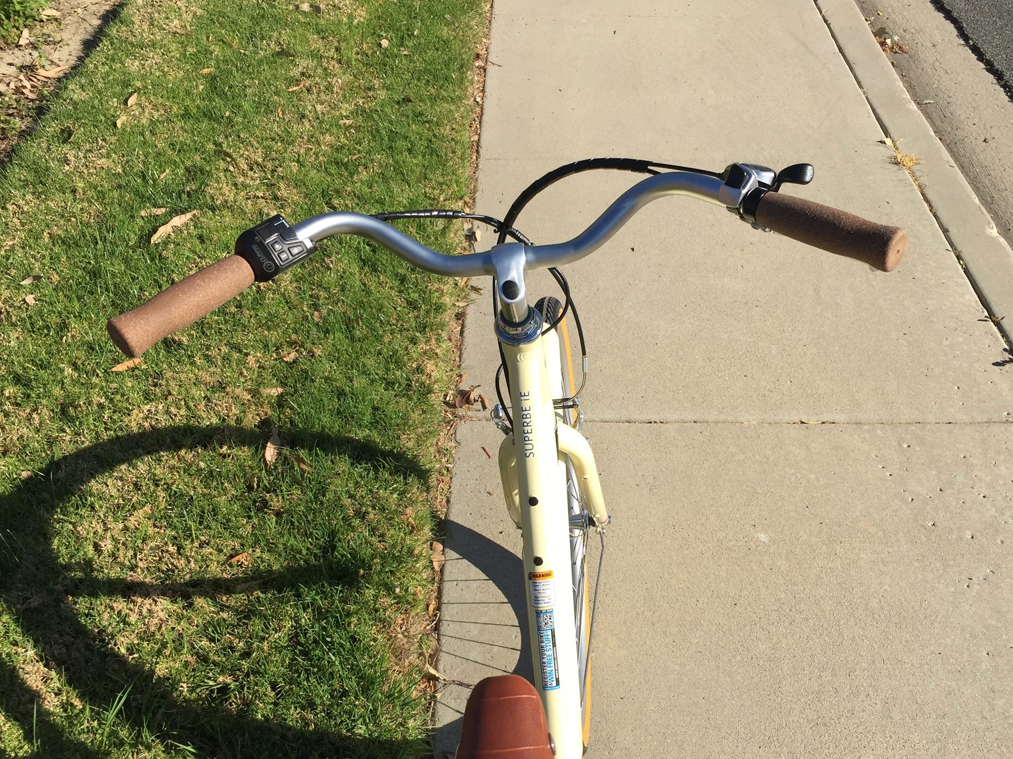

Once the battery is charged and both power buttons have been pressed, the control pad will come to life with four red LED lights showing what assist level has been chosen, a red, yellow or green LED at the top right indicating battery charge level and a number at the top left indicating your current ride speed or range. I love how Raleigh was able to cram so many useful readouts into such a small, neat space. And even though it’s not as easy to see from afar or removable, I feel like it fits well on a relaxed neighborhood styled electric bike like this. The handlebar looks clean and open compared to many other electric bikes… but I do wish you got more than just green, yellow and red for charge level. It’s no fun to be outside on a nice day riding your bike, wondering how far you can go now that the battery light says yellow or red. Does that mean 60% and 30% respectively? I have no idea. And that’s where the range menu really shines, but it’s a little buried. This is the secret! In order to have the bike show how far it thinks you can go based on the level of charge remaining and your chosen level of pedal assist, you have to press the power button while in one of the four assist levels. For a brief moment, the speed readout changes to a different number and this is your estimated range… I believe in miles, at least for the US version of the bike. I welcome owners or test riders from abroad to chime in on how theirs works and whether it’s in kilometers :)

- Great electric bike for a his-and-hers setup, the step-thru will be easier to mount but the high-step is stiffer (less frame flex), there are three frame sizes to choose from in total

- The motor is compact and nearly hidden behind the 7-speed cassette… with some panniers over the battery rack it would blend in even more look just like a regular unpowered bicycle

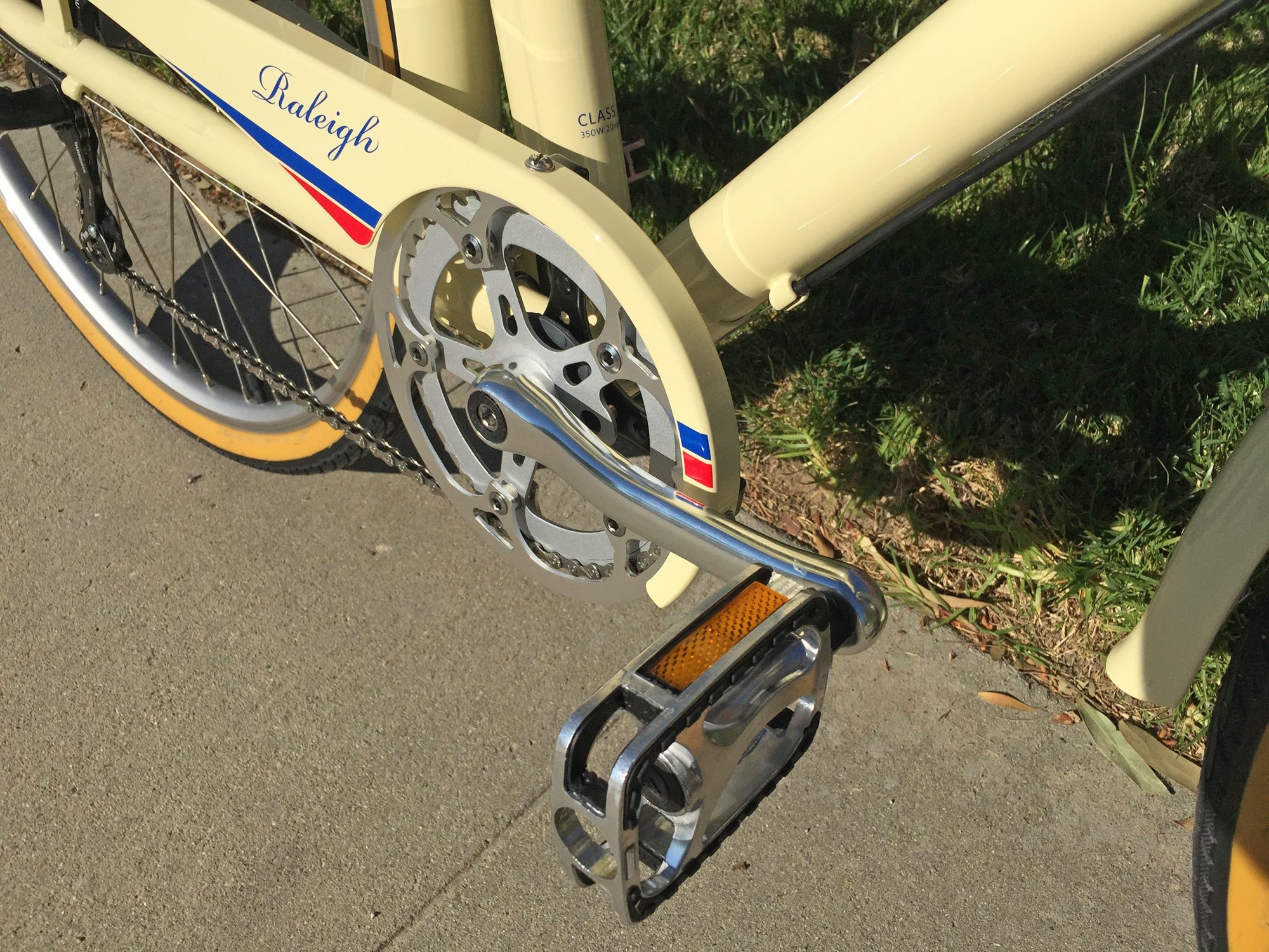

- I love how the chainring has two Aluminum alloy plates sandwiching the chain so it won’t bounce off as easily when riding, this can be a big problem with some electric bicycles

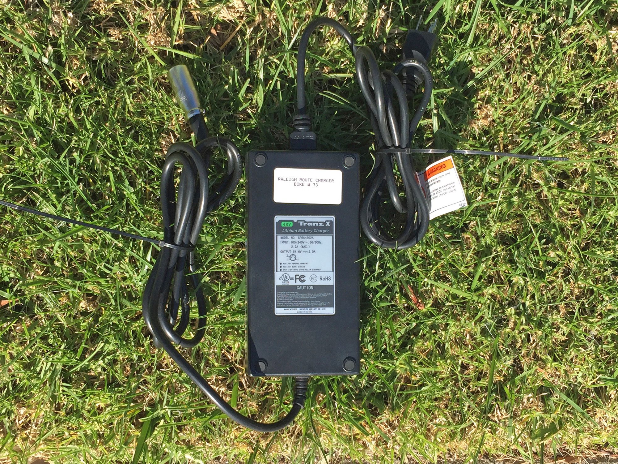

- The battery has a magnetic handle at the back that won’t rattle (and makes it easy and safe to carry around), it has a fuse built in for safety and the battery charger has a tough metal cap… the one thing I struggled with was how tight the battery slides onto the rack

- One of the really neat things about hub motors, compared to mid-drive systems, is that they operate independently from pedaling and don’t put as much stress on the chain, sprockets or derailleur

- The display doesn’t show as many readouts as a full LCD panel might (time, average speed, max speed, precise battery level) but you do get speed, 3-color battery capacity, assist level and range estimate which is pretty solid

- This shouldn’t be a big concern for relaxed neighborhood riding or basic commutes but the Shimano Tourney drivetrain (rear derailleur) is at the lowest end of the performance/quality line, they work alright but might need more tuneups over time
- There’s an on-switch at the battery as well as the control pad near the left grip…
this two-step process is easy to forget and many newer bikes only have one power button that can be reached while seated, which I appreciate - The fenders do clink around a bit while riding over bumps and the bolt-on rear rack might require tightening over time
