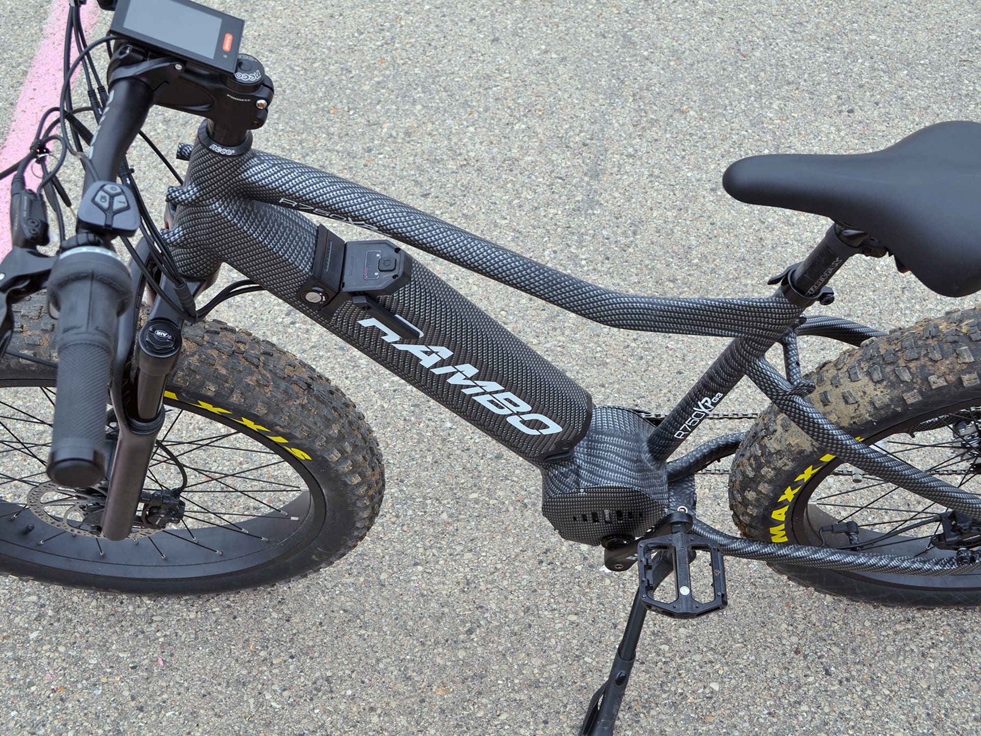

Powering the bike is a 48v 11.6ah lithium ion battery pack. I would consider this a high capacity battery pack and really necessary for that super powerful motor. The battery has an easy to use handle and I love that it is even color matched to get the same carbon fiber we have on the frame! Anyway, the battery is mounted via lock and key, however, you don’t need the key to start the bike, it is just for battery security. The battery has a power button and I love the LED display read out on it so you can check to see round about how much juice is left. To really care for this and other lithium-ion packs, I have heard that storing in a cool dry location vs. extreme heat or cold will extend the life and try to keep it about 50% full when not using for long periods so you won’t stress the cells. Try not to let it run down to zero, because that’s really hard on the cell chemistry.

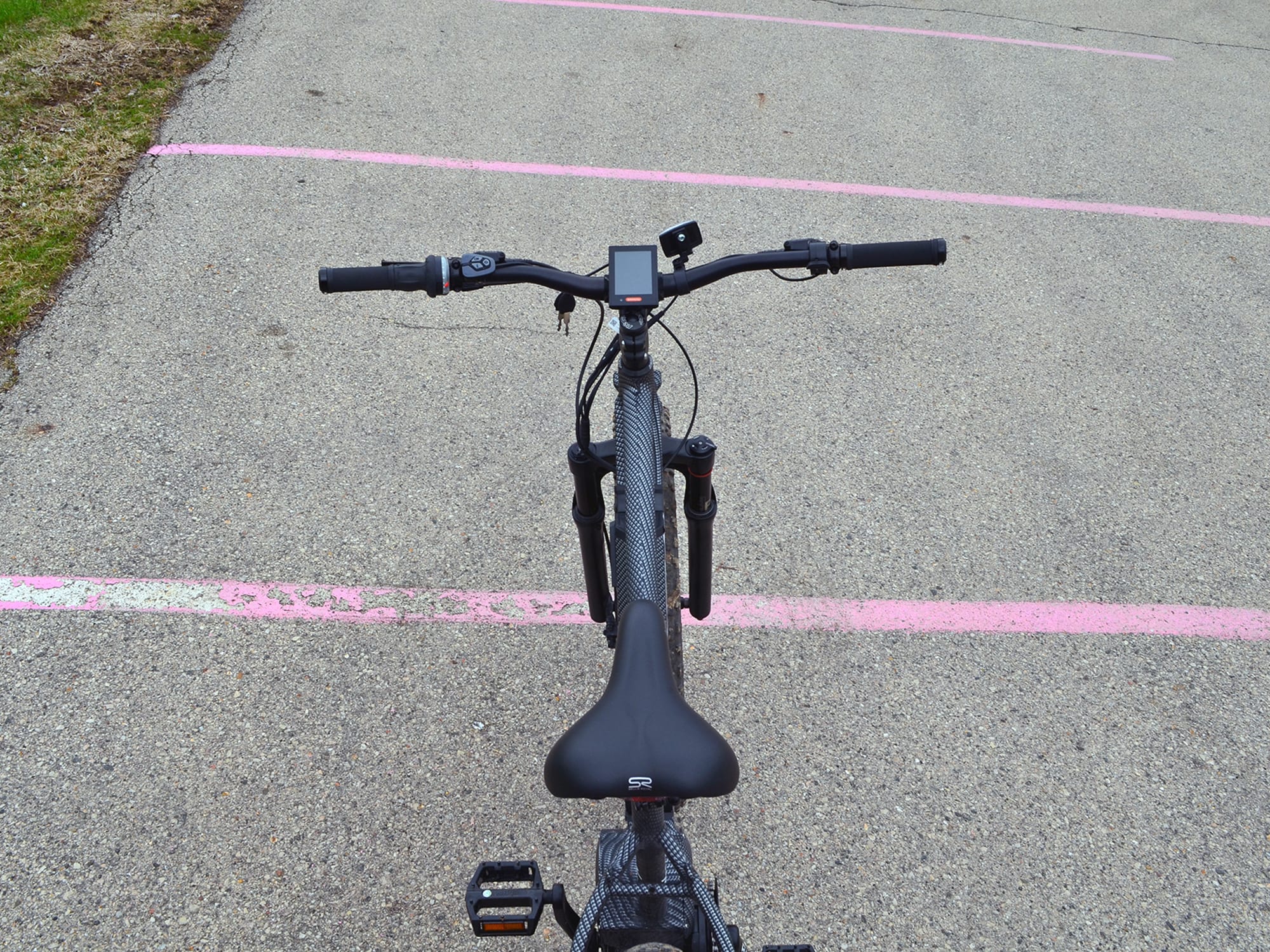

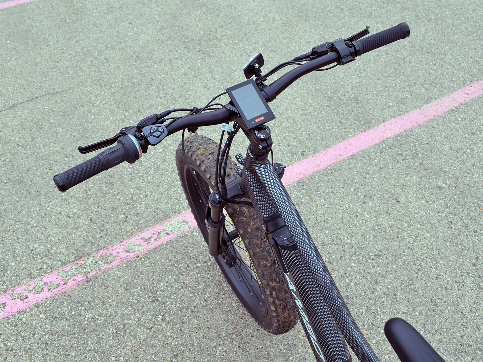

Another area worth mentioning here is the control center. I’m kind of a control center geek and I always love to see comprehensive stats while riding. The Bafang control center on the 750 XP does just that. It displays pretty much everything, including current speed, top speed, average speed, range, battery level, pedal assist mode, wattage output and more. More importantly, I could read it in direct sunlight! I love that it is color and uses an automotive motif. The only downside to this display was that it’s not removable, so I might worry about it getting dinged up when the bike is being parked or transported and just taking more sun and rain damage over time. On the plus side though, it does have the ability to enable a passcode, adding another layer of security to the bike which is a bigger deal if you have kids around or are just concerned about safety. It does however angle, and I love that the controls can be pressed easily by your left hand since they are positioned well as to keep your eyes on the road.

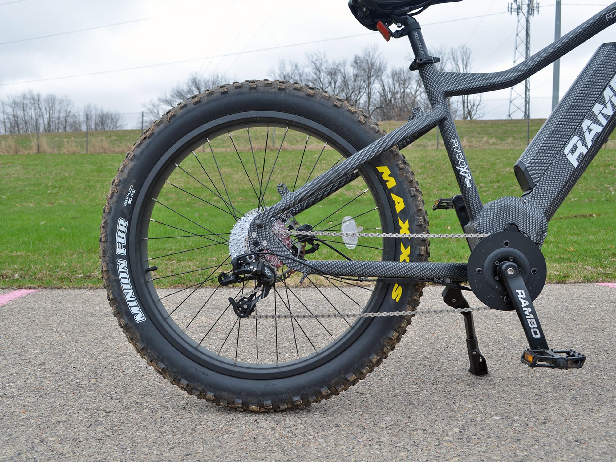

  • Maxxis Minion 26” x 4” fat tires, these have some great knobby tread, this allows for tons of grip, and matches the high-power motor capabilities as well

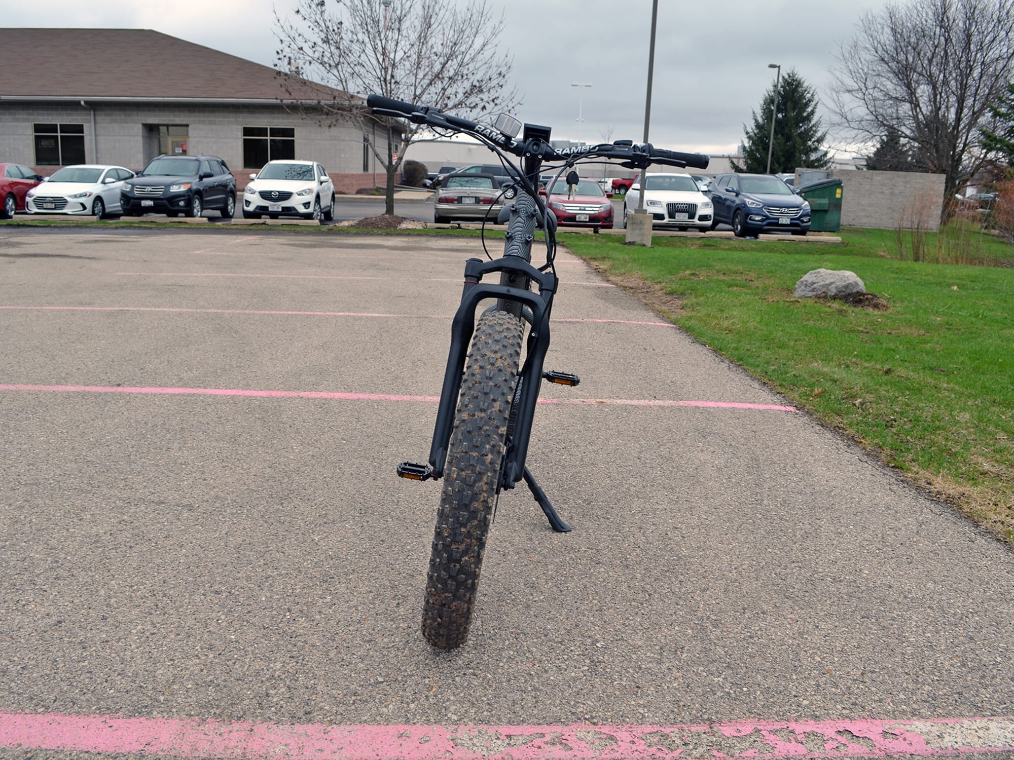

  • GT MRK 355 front suspension does a great job of soaking up hard hits and making for an overall pretty smooth ride, features preload adjust and lockout

  • Gearing is good for high speed thanks to the 11-32 teeth cassette in the rear and 36 teeth chainring up front, I love the metal chain ring guard

  • Despite the Carbon name, this is not a real carbon fiber bike, it is an aluminum alloy frame which is still great, so it gets its carbon name from the carbon fiber wrap motif throughout the bike

  • The grip twist shifting was not my favorite, trigger shifters would offer a more tactile and accurate feel, also, it was mounted upside down which made understanding what gear you are in take some time
  • Control center can’t be removed, leaving it vulnerable to theft and scratching when the bike is left at a public bike rack

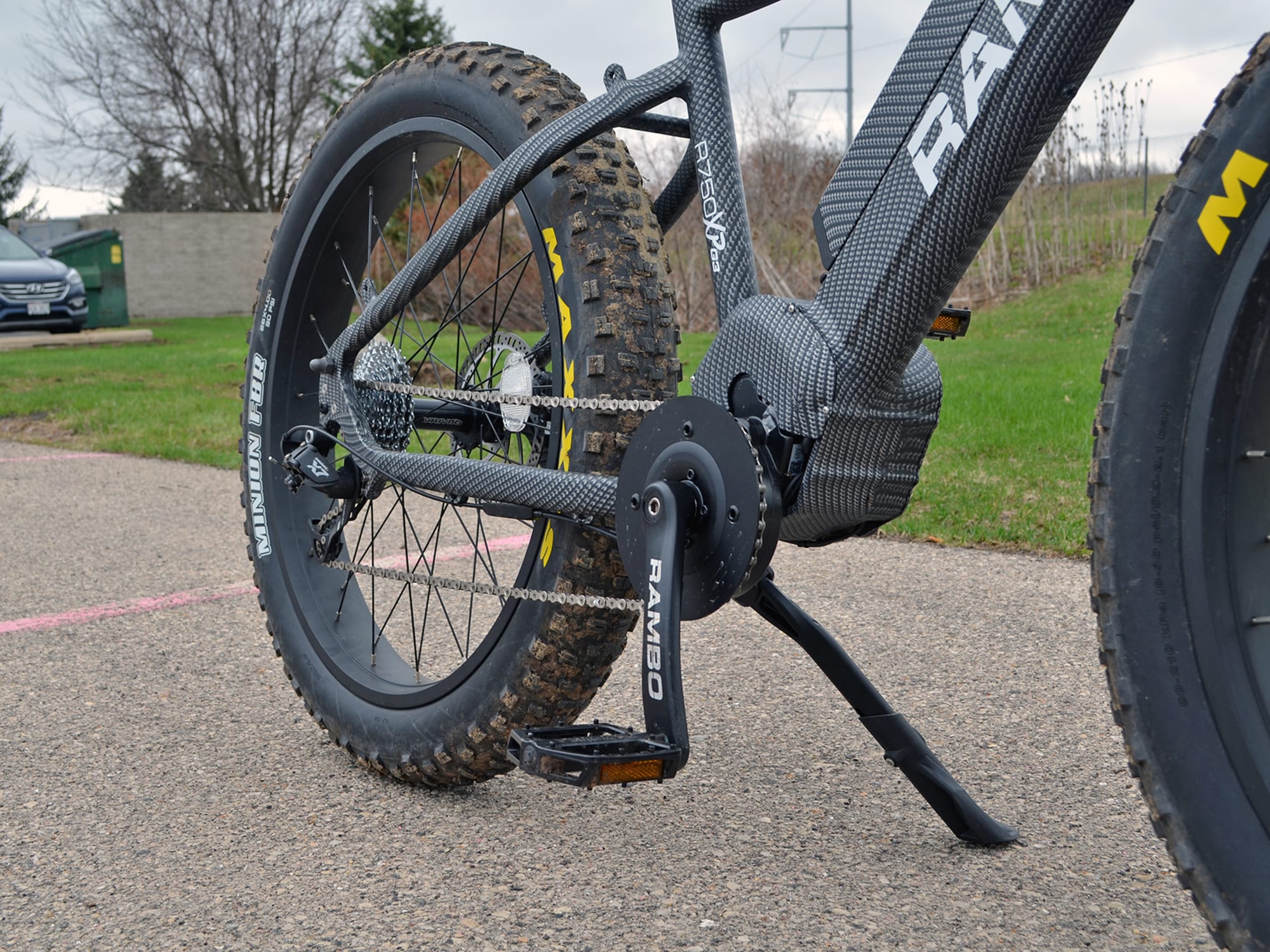

  • I love that it includes a kickstand, but it is mounted near the crank arm, so it can produce pedal lock when reversing in a garage for example
