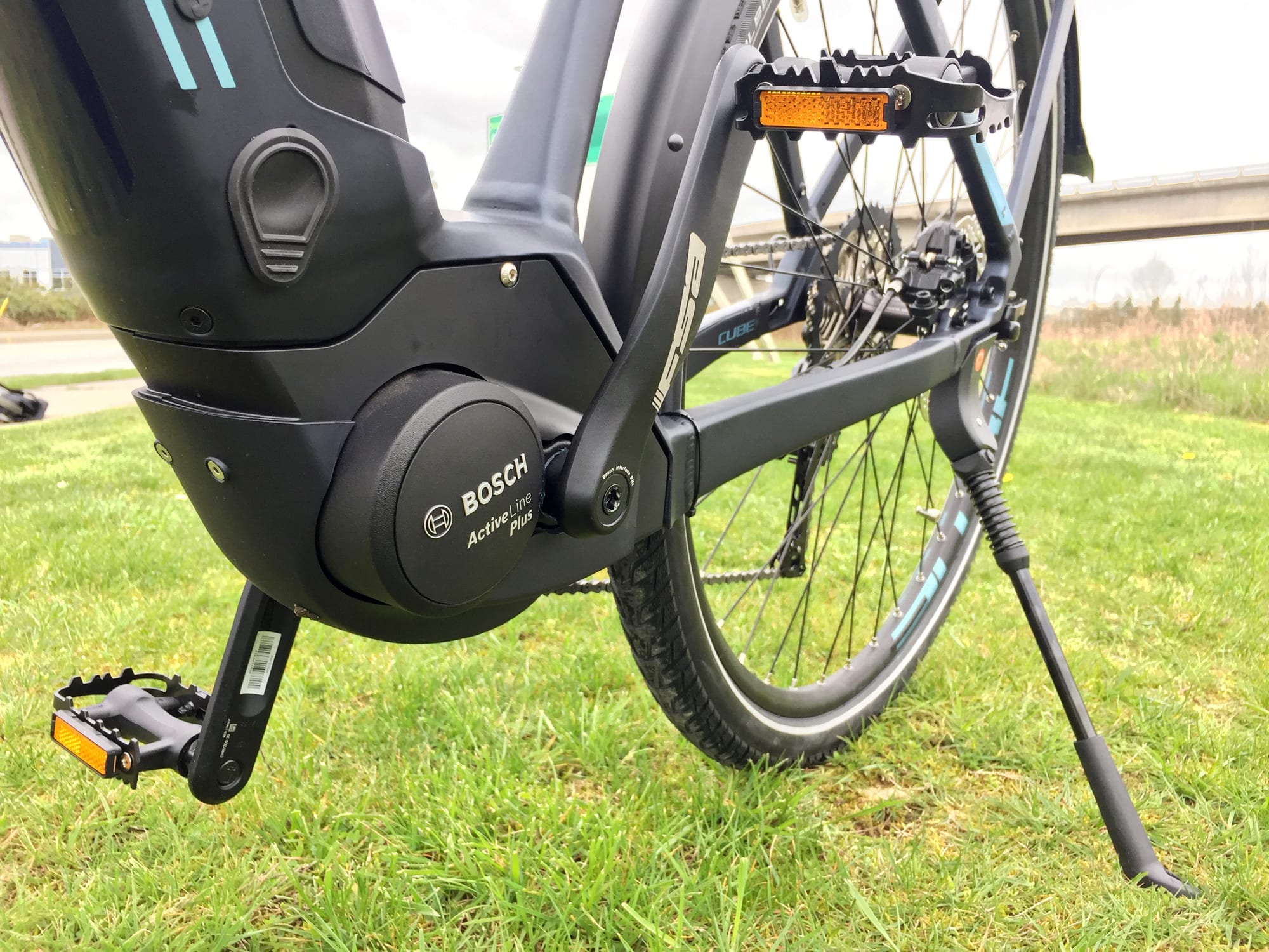

Driving the CUBE Touring Hybrid Pro 400 is the new Active Line Plus motor from Bosch. It weighs nearly one pound less than the Performance Line motors, is more compact in size (hiding behind the chainring beautifully), and operates without producing as much noise. It’s a good fit for a bicycle like this, offering higher 105 rotations per minute vs. just 100 from the entry Active Line motor. You get slightly lesst torque, about 50 Newton meters peak, compared to the Performance drive units but it still climbs well if you shift gears thoughtfully… and with 10 gears to choose from, the bike is very capable. It really compliments the lightweight efficient design of the bike itself. All Bosch mid-drive units offer shift detection, to reduce mashing and drivetrain wear. The motor controller measures rear wheel speed, pedal cadence, and pedal torque, over 1,000 times per second. I’m told that it listens for actual pedal pressure and is able to separate out shifting pressure to then cut power and ultimately reduce mashing, where the chain and sprockets can grind or slip. This motor also uses a traditionally sized 38-tooth chainring vs. the smaller proprietary sprocket on the Performance Line motors, which uses a reduction gear and introduces some friction when pedaling unpowered or above the 20 mph top assisted speed. In short, even though this is the less expensive, less powerful motor, it actually performs quite well and delivers a few unique advantages. I noticed that it started and stopped very quickly during the ride tests and was able to pedal backwards, actually feeding the chain in reverse, which can be useful for drivetrain adjustment and servicing.

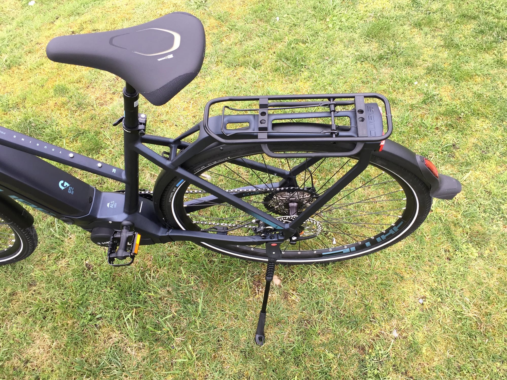

- So much utility on offer, the sturdy integrated rack with spring latch and pannier hangers allow you to haul cargo, the full length fenders keep you dry and clean, integrated lights and reflective tires keep you seen

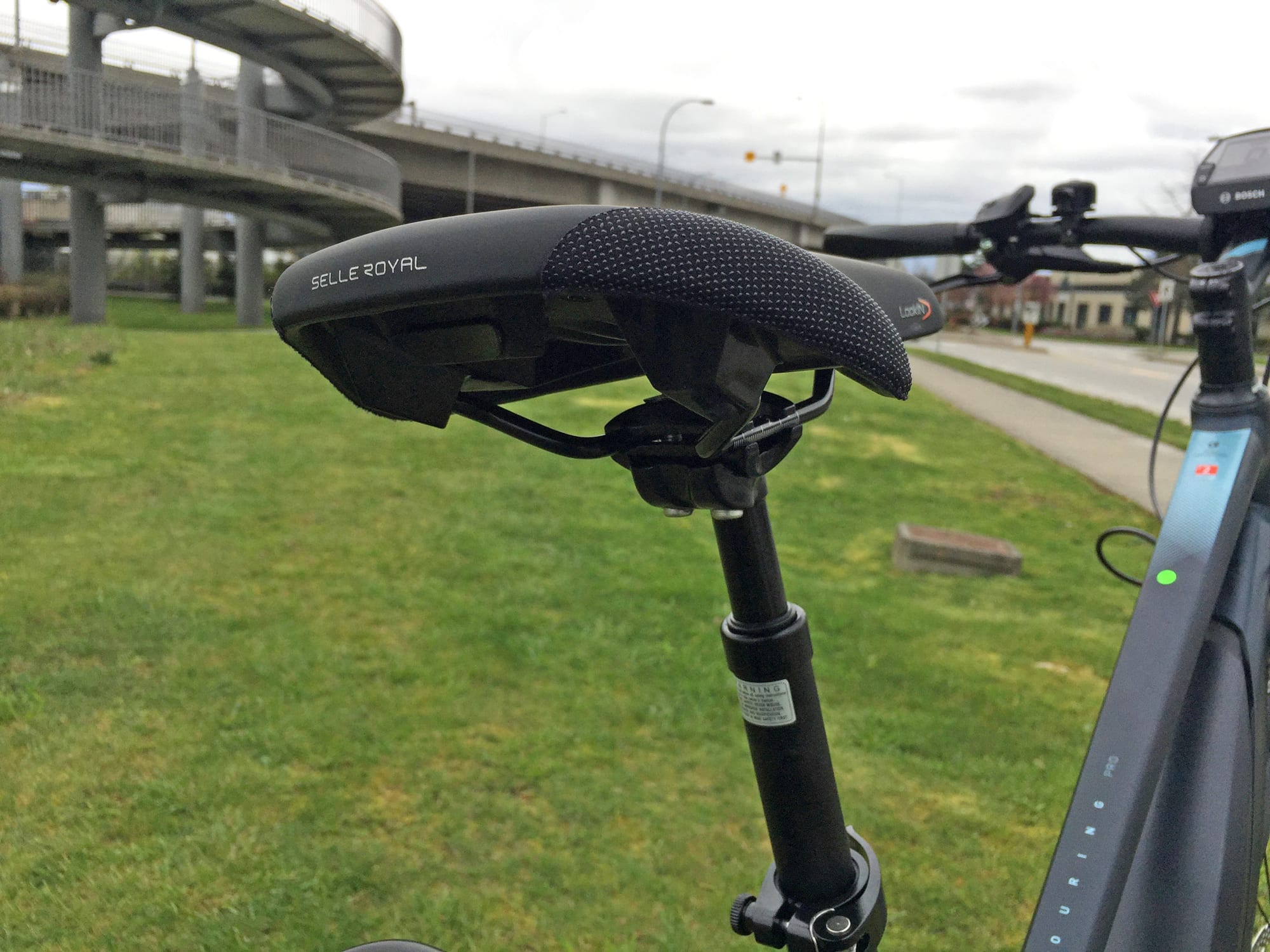

- Comfort is addressed very well by the gel saddle and locking ergonomic grips, suspension seat post, and adjustable air suspension fork

- The Bosch Active Line Plus motor is fairly quiet, uses a standard sized chainring that does not produce drag when pedaling unassisted, but still offers shift detection to reduce wear on the drivetrain

- The alloy chainring protector helps to reduce chain drops, will keep your pant legs from getting as greasy or snagged, and protects the chainring teeth if you hit a curb or log… a full chain cover would keep you even cleaner but add weight and possibly rattle

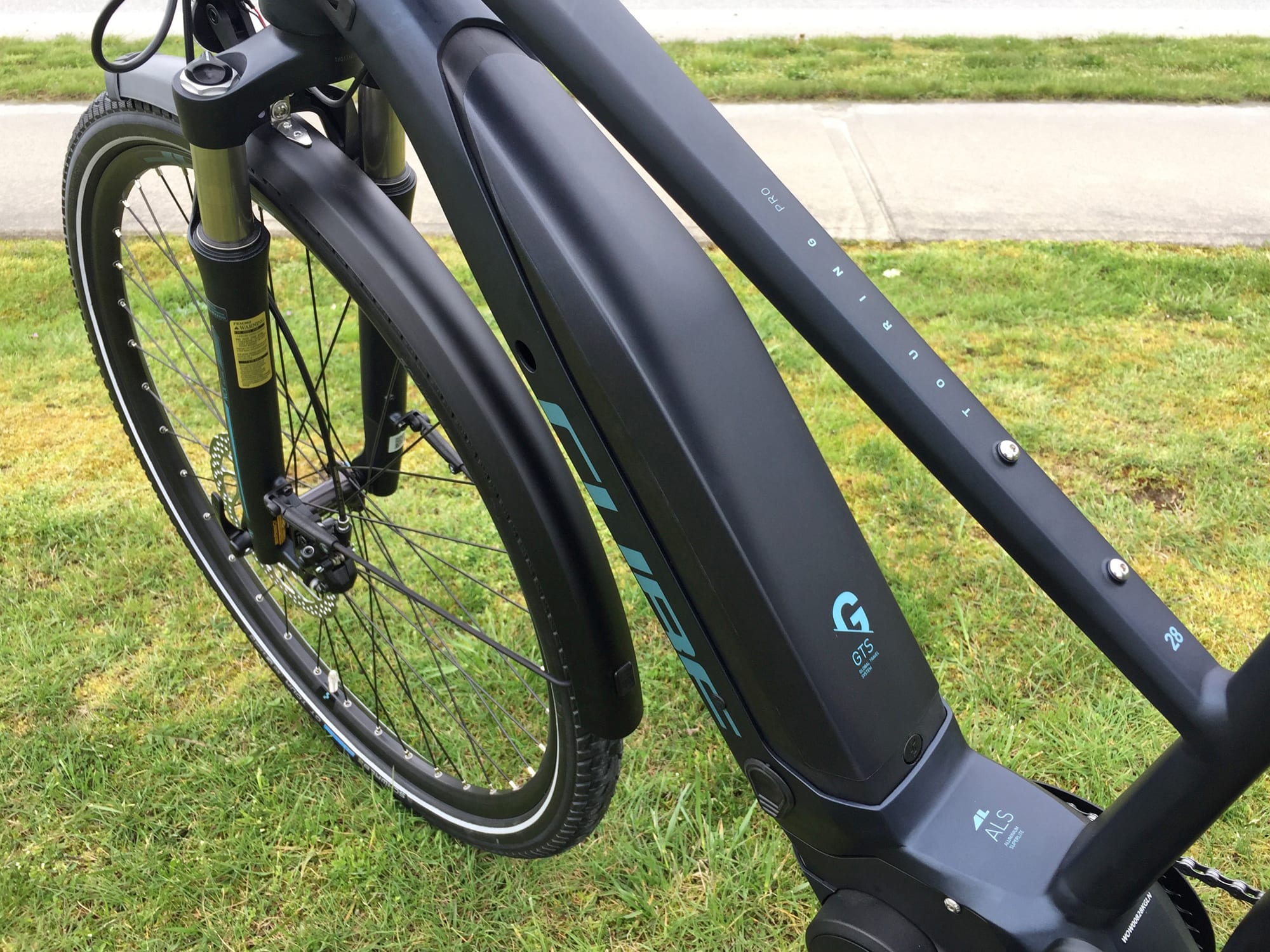

- I love how the battery is sunk into the downtube to keep weight lower and make the bike look great, the plastic cover keeps dust and water out of this compartment, but unlike the battery inside, this cover doesn’t securely lock to the frame and could get taken

- The rack should be compatible with a wide range of trunk bags and panniers but might require an adapter like this if you want to mount a child seat, because of the custom frame-welded supports that take up space below the rack itself

I am thinking of buying the trapeze version having seen this review. I like the ability to step on to the bike but not sure whether the 54cm frame would be big enough for my 6 foot height and 33/34 inside leg.
I would love to know what the number 28 stands for which is painted onto the trapeze down bar? Any idea? It clearly is not size.
