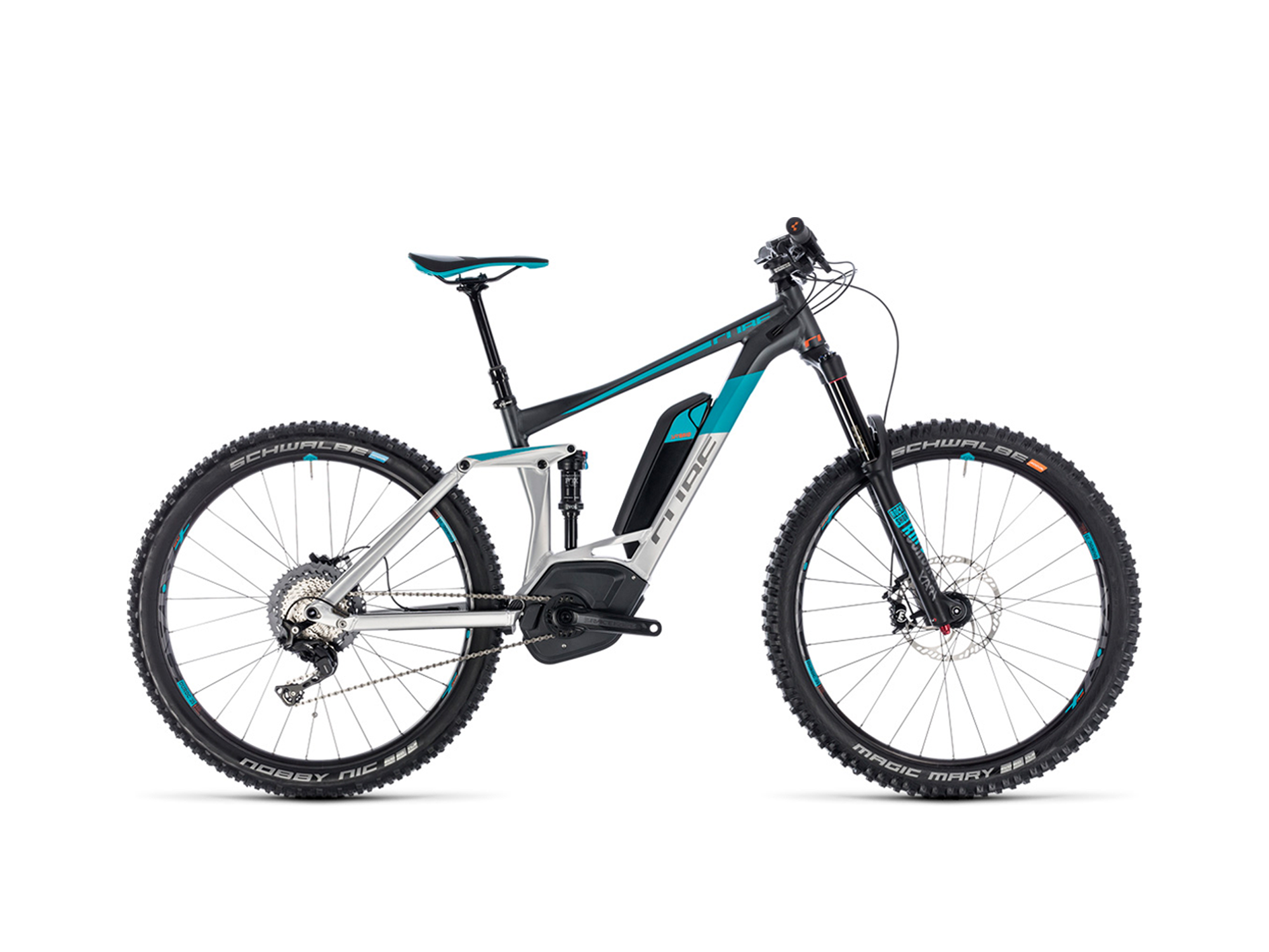

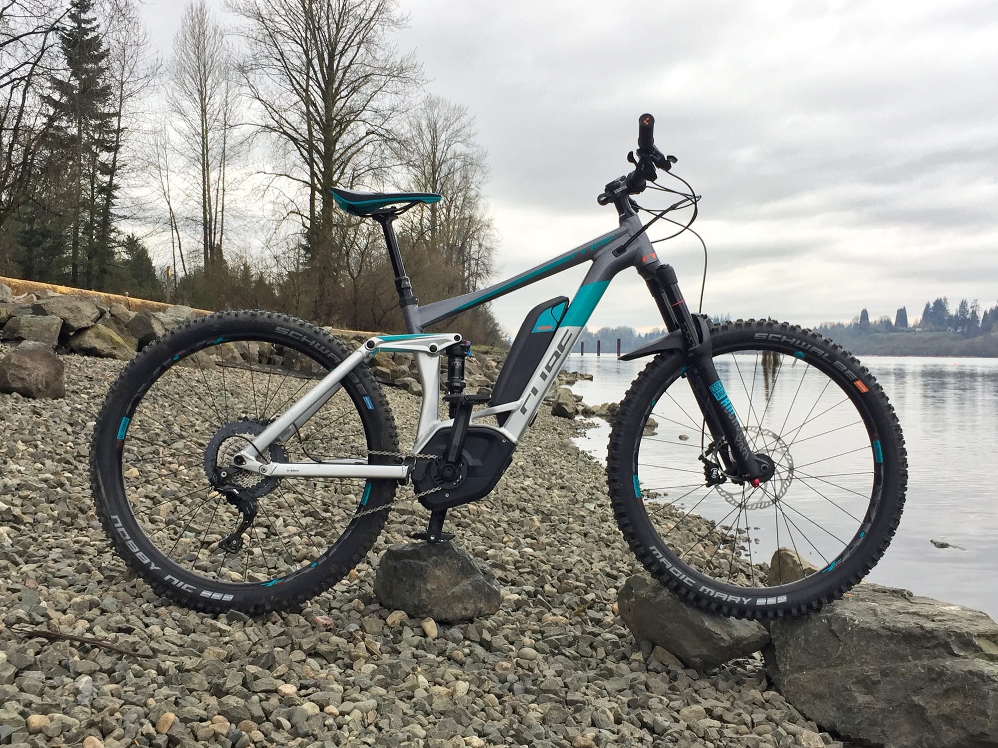

CUBE is a large European bicycle manufacturer, based in Germany. The Stereo Race 160 Pro 500 is one of their full suspension models with longer 160 mm travel for all-mountain and enduro riding. It’s a 1x which means there’s a single chainring up front, but the 11 to 46 tooth cassette range is very good and managing steep climbs. Considering the suspension, longer boost hub spacing, 2.6″ plus sized tires, heavier Bosch Performance Line CX motor and high capacity PowerPack 500 battery… I think it’s impressively lightweight. Built around an aluminum alloy frame, the Stereo Race 160 Pro feels stiff and responsive. It utilizes high quality Race Face cranks, short 35 mm 0° stem, and a fatter 35 mm handlebar that minimizes flex. For this review, I metup with Jason from Cit-E-Cycles in Langley Canada. This guy is a friendly expert, he considers himself an advanced novice in terms of riding but has years of bike shop management experience and has attended a full time year-long mechanic school in New Westminster BC, Canada. I learned a lot of little from him during this review and would strongly encourage you to watch the video above :)

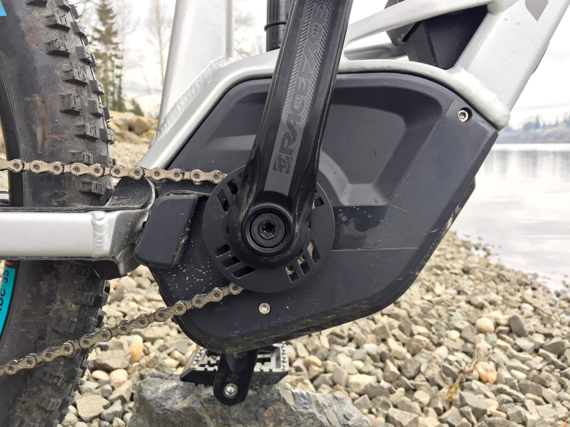

Powering the CUBE Stereo Race 160 Pro 500 is planetary geared mid-motor that’s rated 250 watts nominal and 600 watts peak. Depending on the market you’re in, the top speed may be 32 km/h (20 mph) or 25 km/h (15.5 mph) to comply with local regulations. It’s a Class 1 product, meaning that it utilizes pedal assist only. With a peak torque rating of 75 Newton meters, it’s one of the most powerful centerdrive electric bike systems on the market, but it’s also one of the loudest. If you’re riding on gravel trails or through the woods, the motor whirring is mostly masked by tire contact. What’s so impressive about this system is that it responds to rear wheel speed, pedal cadence, and pedal torque over 1,000 times per second. Bosch is well known for their motor controller system, which also listens for shifting and backs off to protect the derailleur, chain, and sprockets. With a slightly wider Q-Factor of 180 mm and slightly higher weight of 8.8 lbs, there’s definitely room for improvements, but Bosch has been in this market longer than Brose, Shimano, and many others. What you trade in millimeters and grams is made back through reliability and leading performance. Perhaps my favorite part about this motor, and a feature that is especially relevant to electric mountain biking applications, is the higher pedal RPM support. Basically, you can pedal fast in a high gear and the motor will continue supporting you at up to 120 pedal strokes per minute. Some other motor systems cut out at 100, 110, or begin to fade near 120. The Stereo Race is a “go anywhere” EMBT and it’s nice to know that you can climb without limit if you shift gears appropriately (aside from your own balance) and utilize features such as walk mode when the technical challenge becomes too much or you get a flat or damage. I do feel that the large black plastic casing around the motor is effective, but it’s one of the less beautiful aspects of a bike with semi-integrated battery, internally routed cabling, and matching colored accents on the frame, fork, grips, saddle, and rims. What I discovered about the casing however, is that it serves as a bash guard and eliminates chain suck (which has been a documented limitation of the smaller Bosch chainrings (which spin 2x per crank revolution). Cube has engineered a plastic bulge directly behind the chainring to clear mud and keep things on track, and it’s something that appears to be unique to them right now. On the front of the chainring, an alloy guard will prevent drops and reduce pant leg snags.

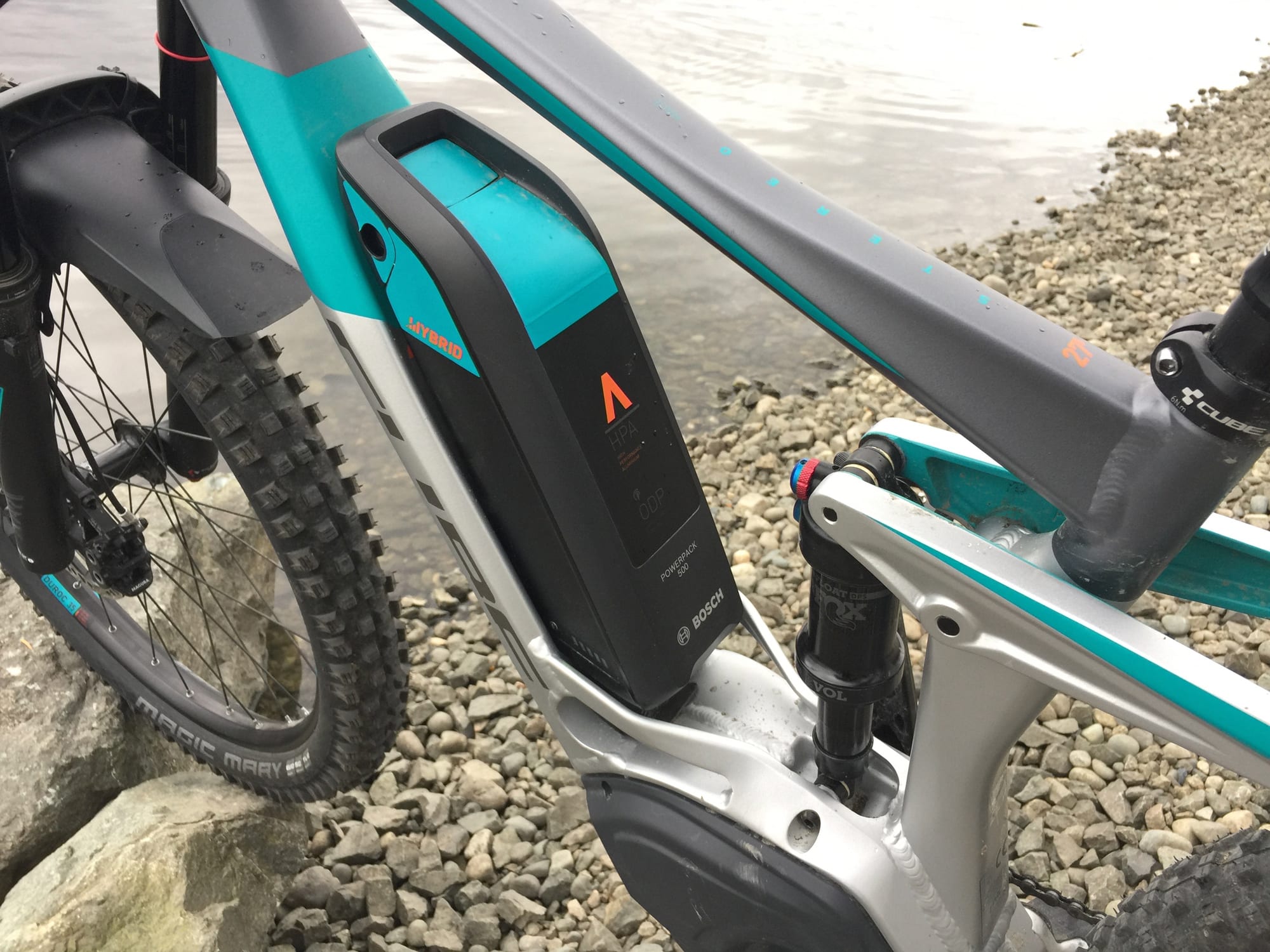

Powering the bike is a 482.4 watt hour Lithium-ion battery pack, also from Bosch, called the PowerPack 500. At the time of this review, it is their highest capacity battery pack, yet it fits into the same casing as the older PowerPack 400. Yes, the interface is backward compatible, so you could take a longer overnight trip and extend the range by carrying a spare. While it isn’t quite as aesthetically pleasing as the new fully-integrated PowerTube 500, it does weigh less at just ~5.7 lbs, tends to be easier to get off the bike for charging and storage, and is much easier to rent or borrow on location… Since most airlines do not allow high-capacity Lithium-ion batteries to be taken aboard, it’s nice to know that wherever you end up in the world, the likelihood of finding another PowerPack (400 or 500) is higher than any other ebike battery. I love how Bosch has designed a loop handle into the top of the pack, for easier lifting and safer transport. They utilize a proprietary plug design that won’t get flipped or confused with other power tools and electronics, and the charger itself is very compact and lightweight considering the relatively high 4 amp output. The battery charges quickly, includes a five-LED readout for quick charge level checks, and is one of the longer lasting more reliable systems around. You pay more for Bosch, but they are definitely one of the top leaders in the space, and this is why CUBE has partnered exclusively with them for all of their electric bicycles.

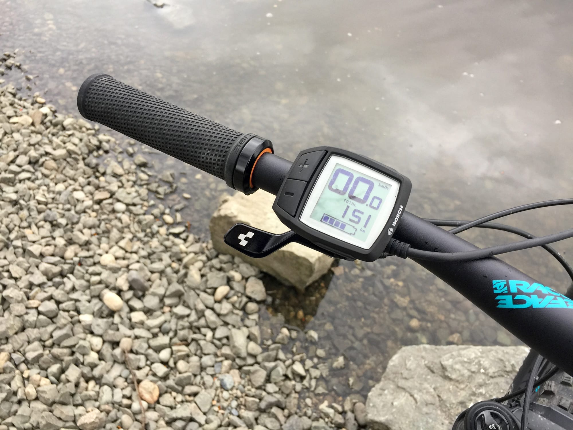

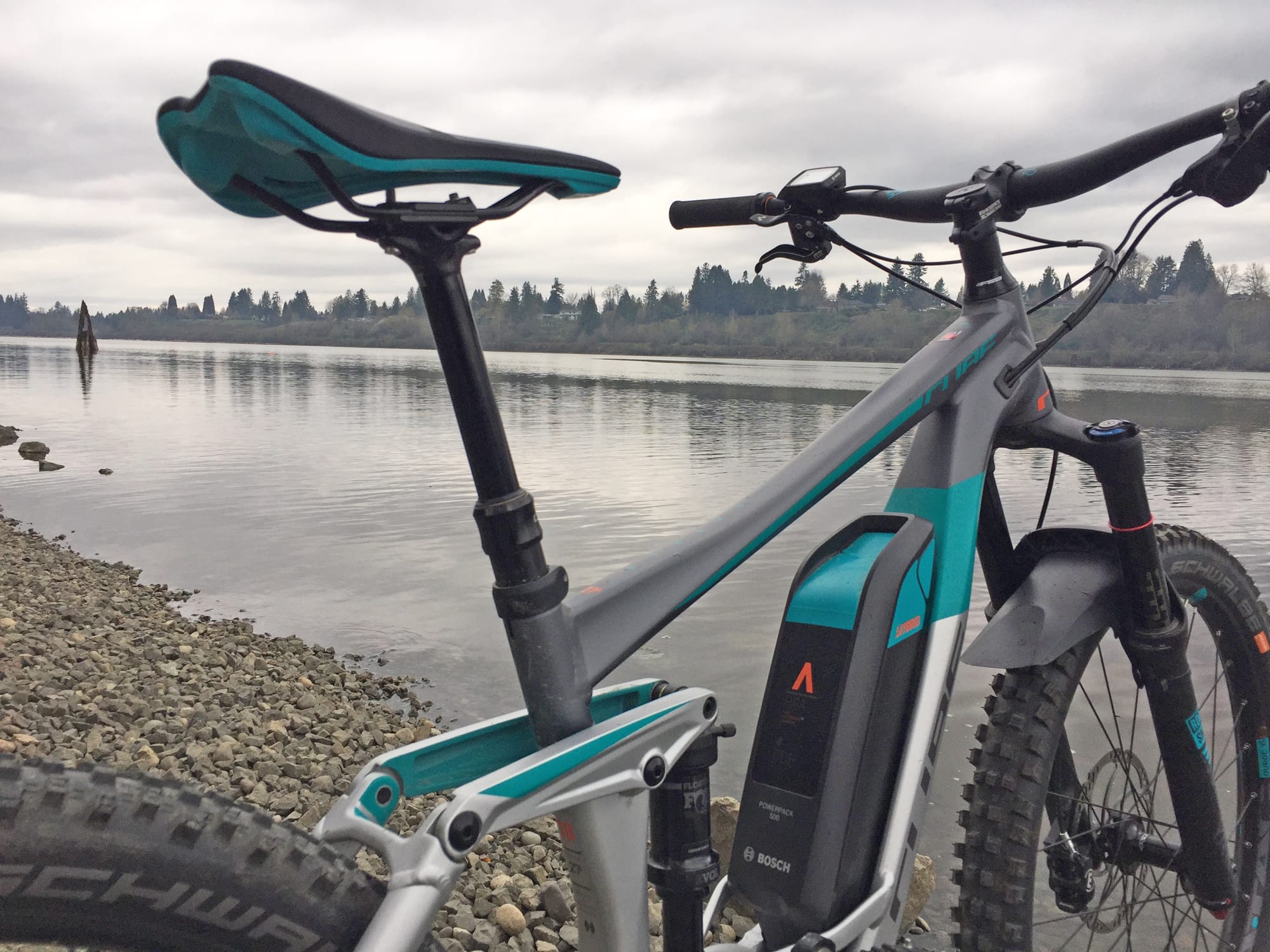

Operating this bike is simple because the display panel has been stripped down a bit, and is positioned within reach of the left grip. Once the battery pack has been charged and mounted, just press the power button along the top edge of the Bosch Purion display panel. The LCD screen blinks to life quickly and shows your current speed, level of assist, and a basic 5-bar battery infographic near the bottom. It’s the same five bars as the LED lights on the side of the battery, and each bar represents a 20% step. You can change units from miles to kilometers by holding the minus button and tapping power once. You can adjust assist levels by clicking the + and – keys individually to raise and lower assist power and speed. It’s really that simple, pressing plus lets you navigate from Off, to Eco, Tour, eMTB, and Turbo. The higher you go, the more energy the motor will expend and the faster you can go. I usually ride in Eco and Tour for Cross Country and on-road sections, but eMTB has quickly become a favorite for trail and all-mountain riding. This mode provides 120% to 300% power based primarily on pedal torque. It was designed by Bosch with the help of professional mountain bikers and feels incredibly natural. This is one of the few electric bike systems that can be easily wheelied (if you’ve got the balance). Compared to many other “all in one” electric bike modes I have tried, this one feels the most predictable and responsive. Sometimes, I feel that torque sensors make you work too hard, and conversely, I don’t always want to be getting Turbo level performance. As someone with sensitive knees, I want to avoid straining myself when going from flats or descents to climbs, especially with a bike that weighs 50+ lbs. the eMTB setting offers a smooth ramp of power, and allows you to focus more on shifting gears, pedaling, maneuvering the frame, and steering through technical quickly-approaching terrain. And, with a wide range of 11 gears offering 11 to 46 tooth sprockets, there is plenty of shifting to be done here. The drivetrain uses a Shimano Deore XT derailleur with the one way clutch for increased tightness. Clicking this lever into the up position will reduce chain slap but requires a bit more energy when shifting. It may not ghost shift when the rear section of the bike is traveling up and down, introducing some chain growth. I usually put the clutch into the down/forward position when performing rear wheel maintenance. Coming back to the display, you can get feedback about trip distance and odometer by holding the minus button, and then eventually you’ll get to a dynamic range menu. To me, this menu is much more useful than the battery infographic because it factors in your last mile of riding and the assist level currently in use to give you a realtime estimate. Another useful feature on this display is the walk mode button positioned along the lower edge, it’s great that CUBE has left this enabled as some other companies (including Trek) have not. If you decide to introduce lights on this ebike, and have them wired in by a professional shop, you can hold the plus button to engage and disengage them. The backlighting of the LCD unit itself is always active and shows with a faint white glow. In my experience, the Purion has harder buttons that pivot in towards the screen (which can feel inconsistent or require more focus to press perfectly), it is not removable, and does not swivel to reduce glare, but it is compact and tough… which is nice for mountain biking. Some shops will help you upgrade to the larger Bosch Intuvia, which is removable and has an active Micro-USB port on the right side.

- The Bosch PowerPack battery has been inset into the downtube just a bit and blended with the paint job (using stickers) to be more visually appealing, they tend to be lighter and easier to replace or rent than the newer Bosch PowerTube fully enclosed battery packs

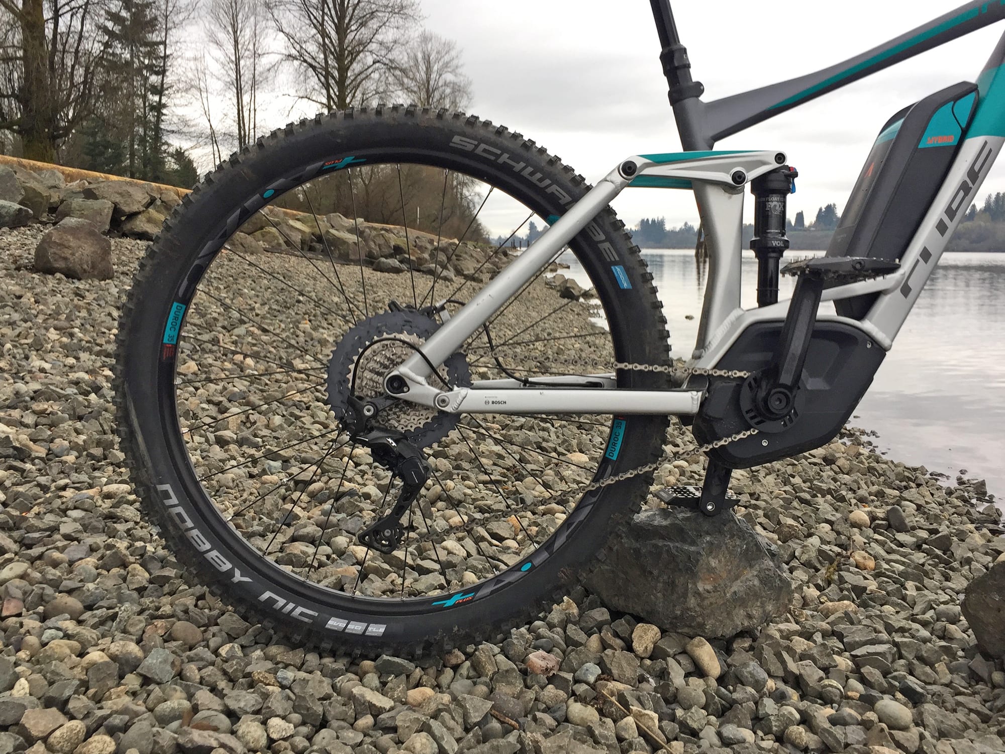

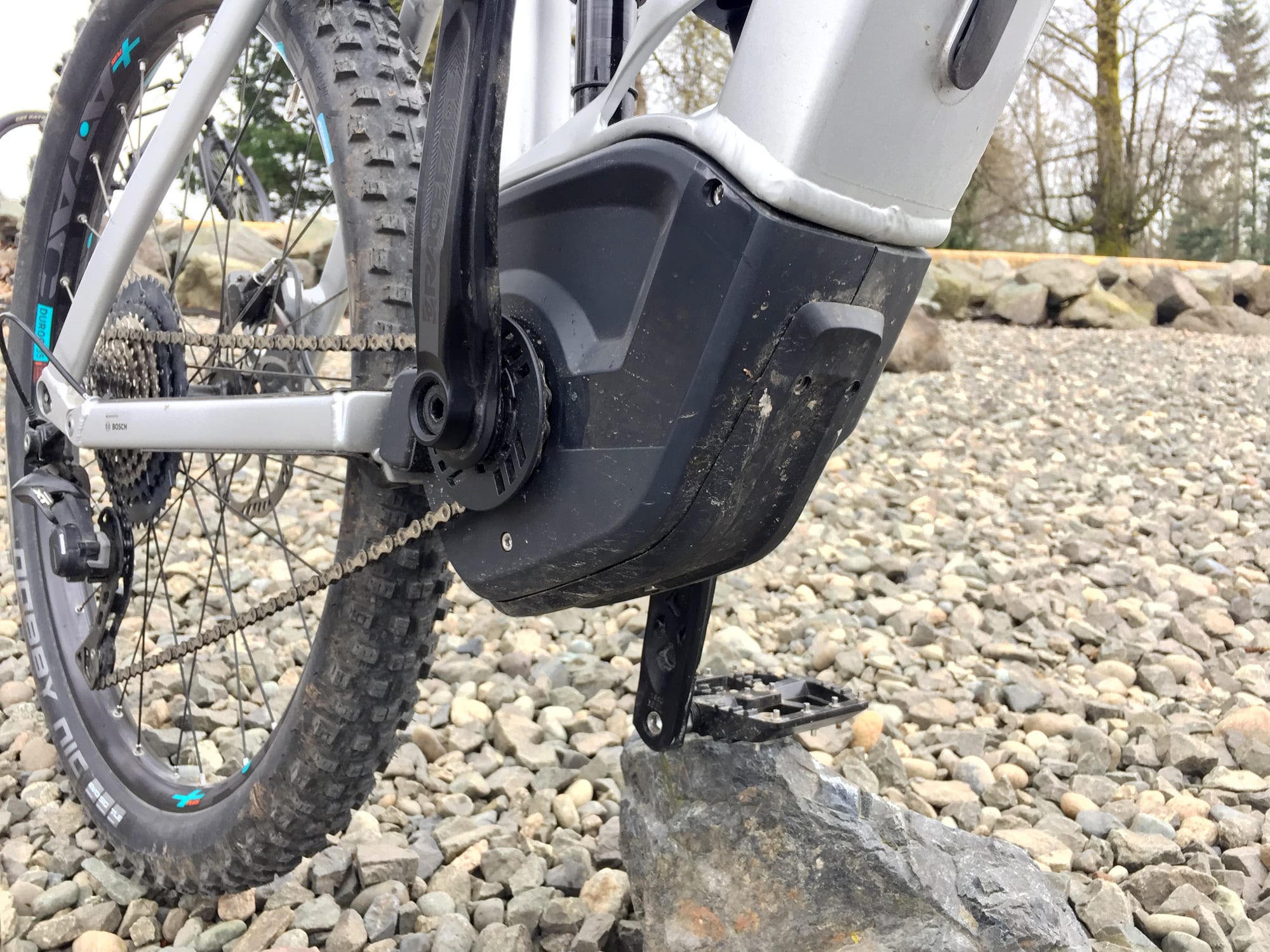

- In addition to the plastic skid plate below (protecting from rock and log strikes), there’s an alloy chainring guard (reducing drops and clothing contact with the chain), and a plastic spacer (to prevent chain suck), great slap guards implementation along the right chain stay (top and bottom)

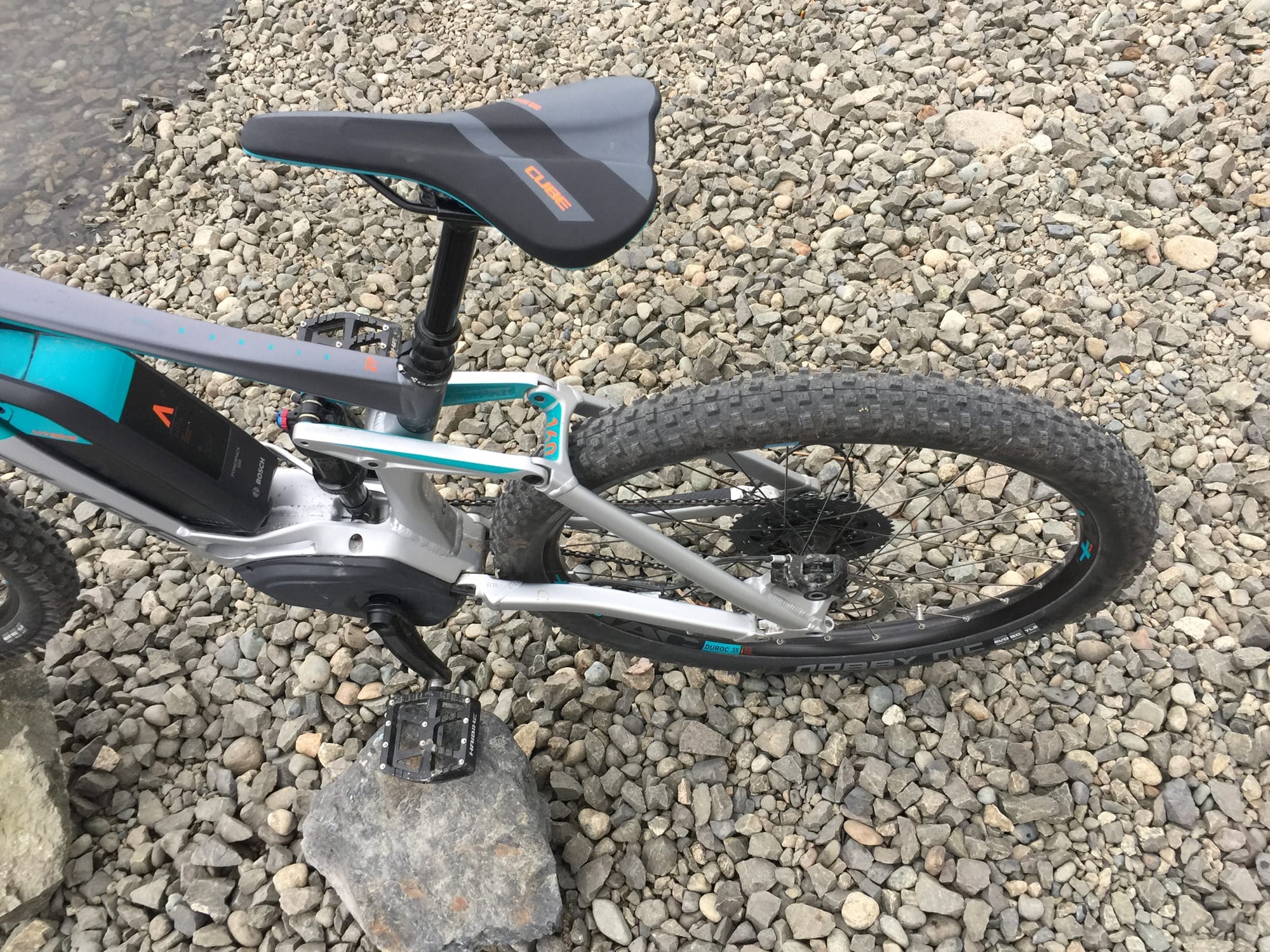

- Great rear suspension design, looks like a modified four-bar setup that reduces chain slackening, the Fox DPS shock offers three compression settings and rebound along with dual piston and higher volume for the long 160 mm travel

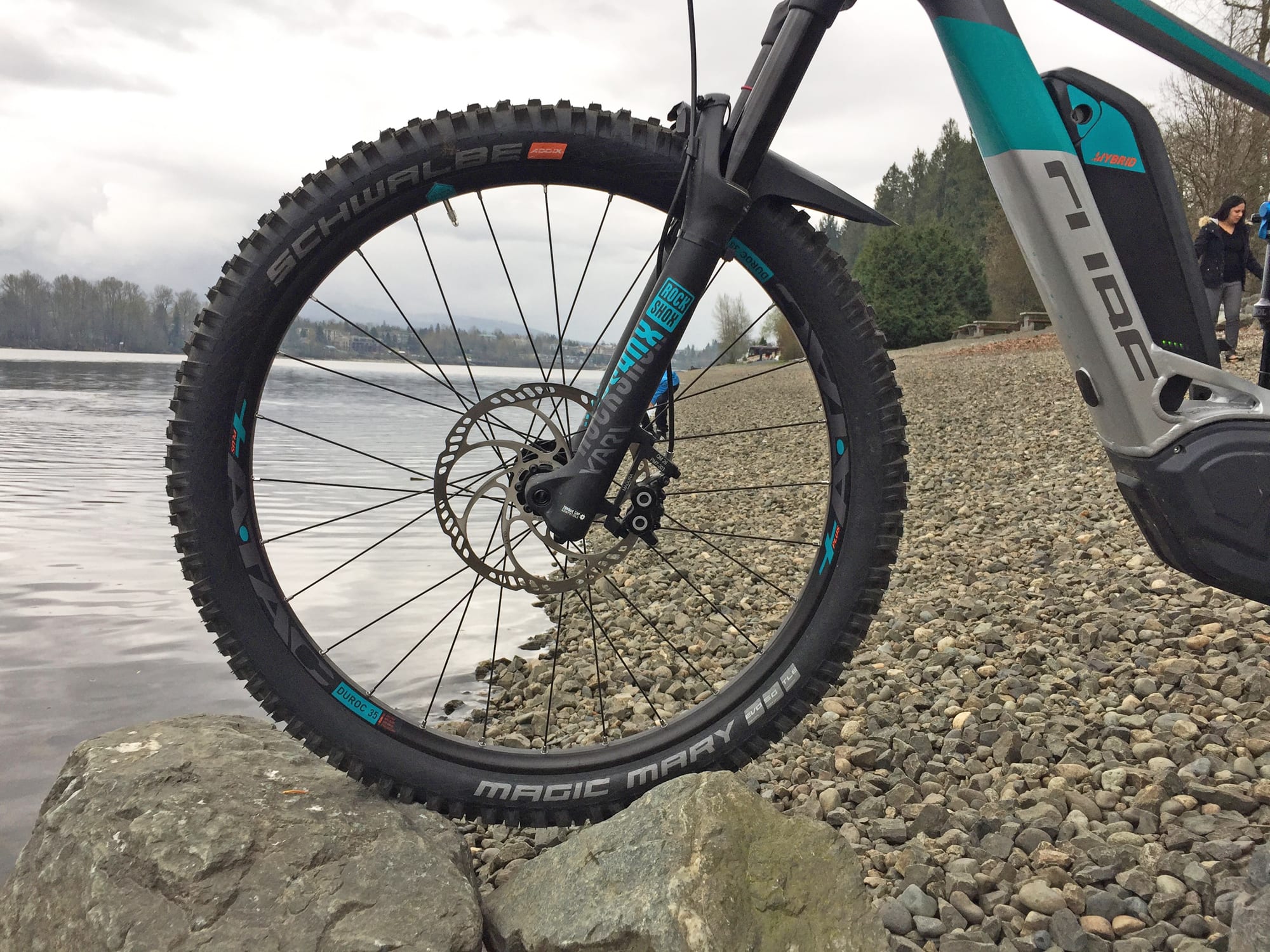

- Sturdy lightweight rims with reinforcement eyelets, lightweight plus sized tires with 27.5″ x 2.6″ which is the narrower of the three plus sizes (the other two being 2.8″ and 3.0″) should be nimble and fast
- Relatively lightweight at just ~52.5 lbs, that’s with the larger Bosch Powerpack 500 battery, longer travel full suspension, and the heavier Bosch CX motor (which weighs ~8.8 lbs all on its own)
- The seat post dropper is not stepped, you can set the height at a wide range of positions vs. just 10 steps or something and it offers 150 mm of height adjustment

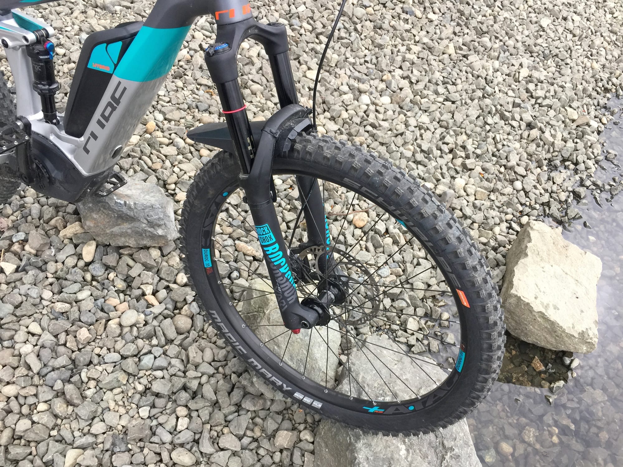

- Thicker 34 mm stanchions on the suspension fork provide stiffness for taking on larger hits and supporting the longer travel, most forks use 30 mm stanchions
- Extra large 203 mm front rotor with quad piston calipers to provide massive stopping power and just a greater mechanical advantage while cooling more efficiently, Magura brake levers offer very consistent braking application because their piston is perpendicular to the grip vs. parallel

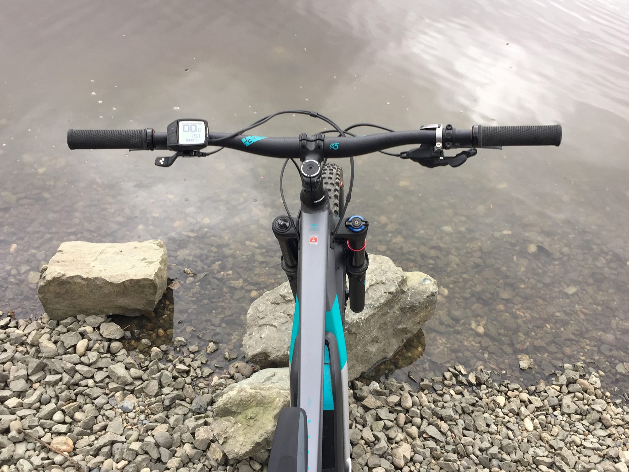

- Thicker 35 mm Race Face handlebar (vs. traditional 31.8 mm) offers more strength, stiffness, reduced handlebar flex and overall precision… I like the lightweight Race Face stem and crank arms as well
- The tires are using the new Schwalbe ADDIX rubber compound with increased grip, the Magic Mary tires are tubeless ready if you want to further reduce weight and lower tire pressure for soft terrain

- The motor is fully enclosed in a plastic casing with a skid plate along the bottom, it stands out more than some competing designs from Bulls and Haibike which blend into the alloy frame and top upwards
- Current generation Bosch Performance Line motors use a reduction gearing system that spins the smaller proprietary chainring 2.5 times per single crank arm revolution (that’s why it is only 15 tooth)

- Compared to the Bosch Intuvia display panel, the Purion cannot be angled to reduce glare without a tool, is not removable, and the buttons don’t click as consistently, they pivot in towards the LCD screen so press higher up for best results

- Sometimes it seems like the buttons on the Purion control pad don’t click in as evenly or consistently, they are on a pivot which clicks towards the LCD screen so if you press towards the right it will be more consistent vs. the lower left edge or center
