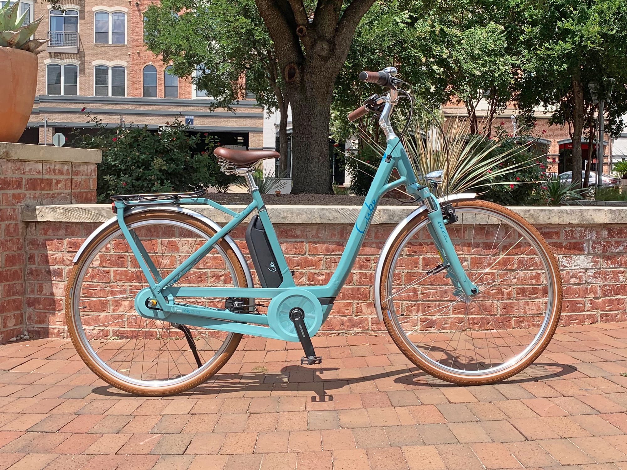

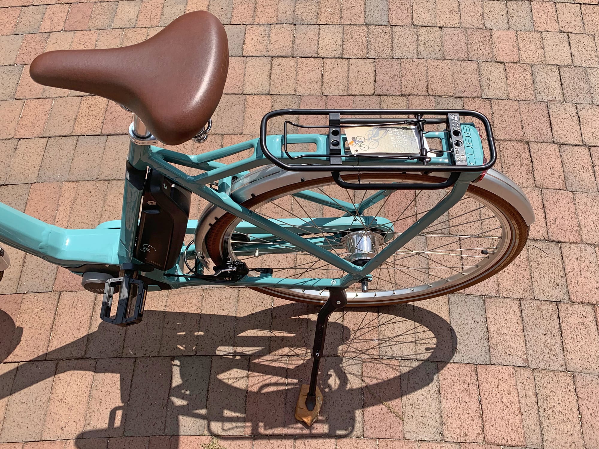

- Compared to the 2017 version of this bike called the Elly Ride, CUBE has moved the battery from a rear rack design to mid-frame, positioning it behind the seat tube. This provides better frame stability and offers more space for cargo bags and panniers on the rack

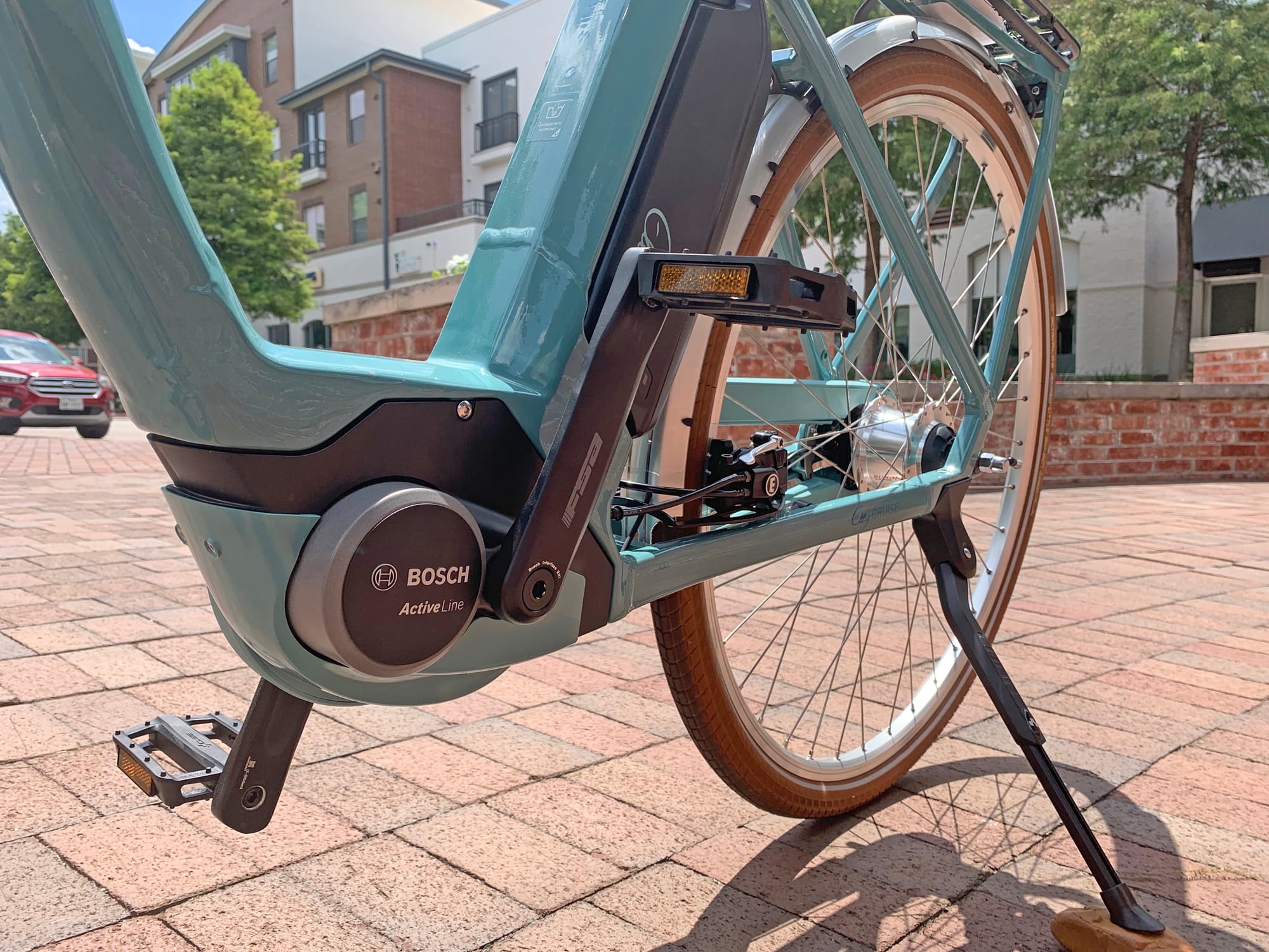

- While the Bosch Active Line Cruise motor is the weakest in the line, it’s also the quietest and most energy efficient… which is why CUBE was able to use a less expensive lower-capacity 400 watt hour battery pack

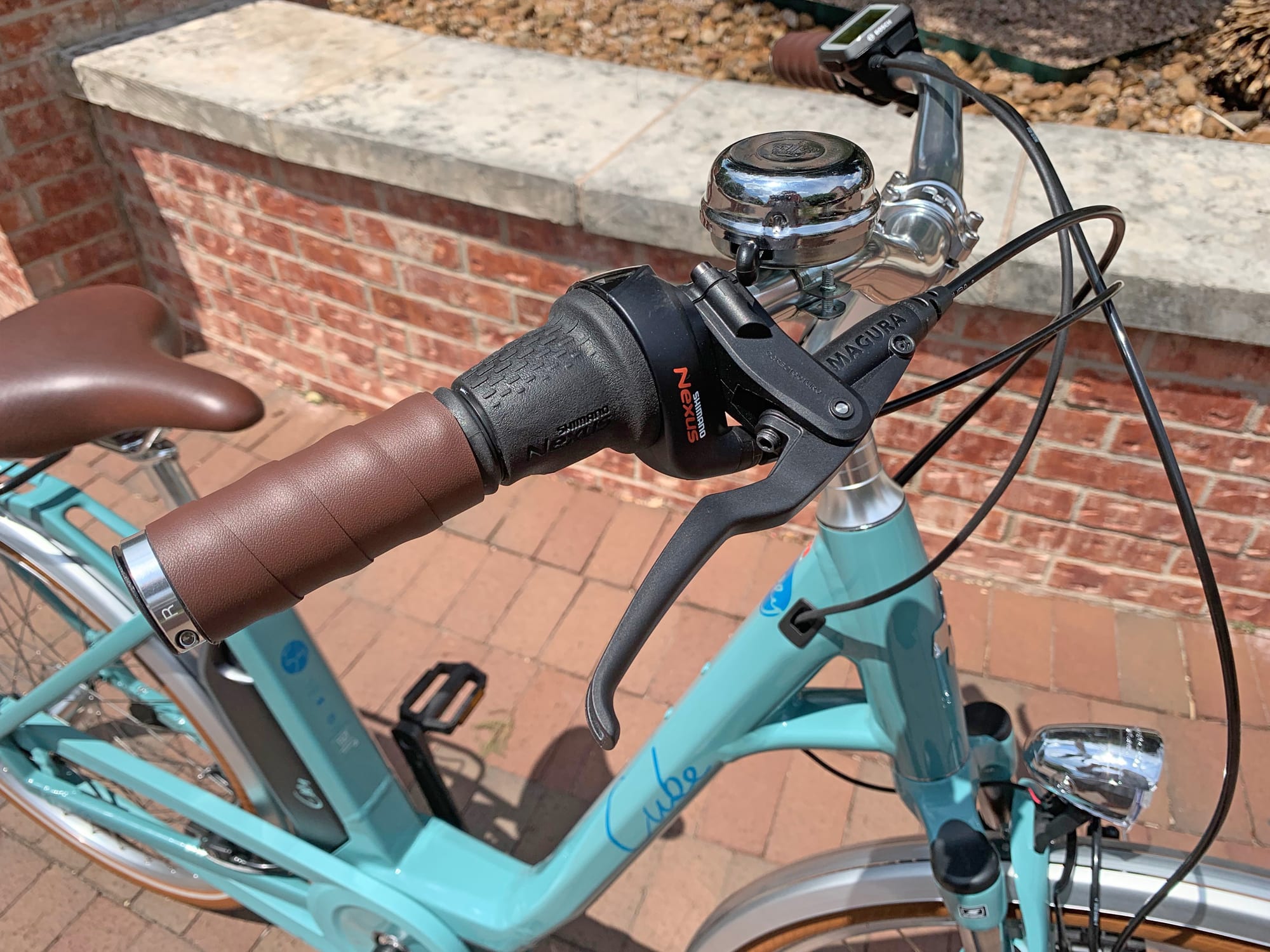

- Because the bike is using a Shimano Nexus internally geared hub, you can shift gears while standing still (great for moments where you have to stop unexpectedly and then get started again on a hill or with lots of cargo weight), internally geared hubs tend to be clean and they don’t drop the chain easily
- The half-grip twist shifter mechanism is very intuitive for most riders, easier to use than trigger shifters, and it has a nice little window so you know which gear you’re in! I also like the big classic bell for friendly signaling

- I really appreciate that the suspension fork, rear rack supports, chain guard, and even the motor skid plate are paint-matched to the frame! The bike looks beautiful and comes in two different colorways, including the aqua that I filmed and photographed and a berry red

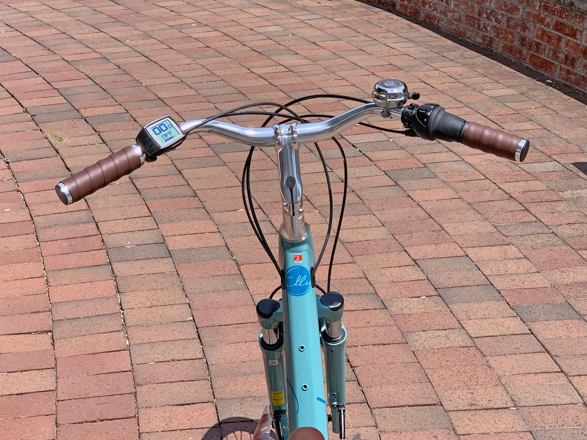

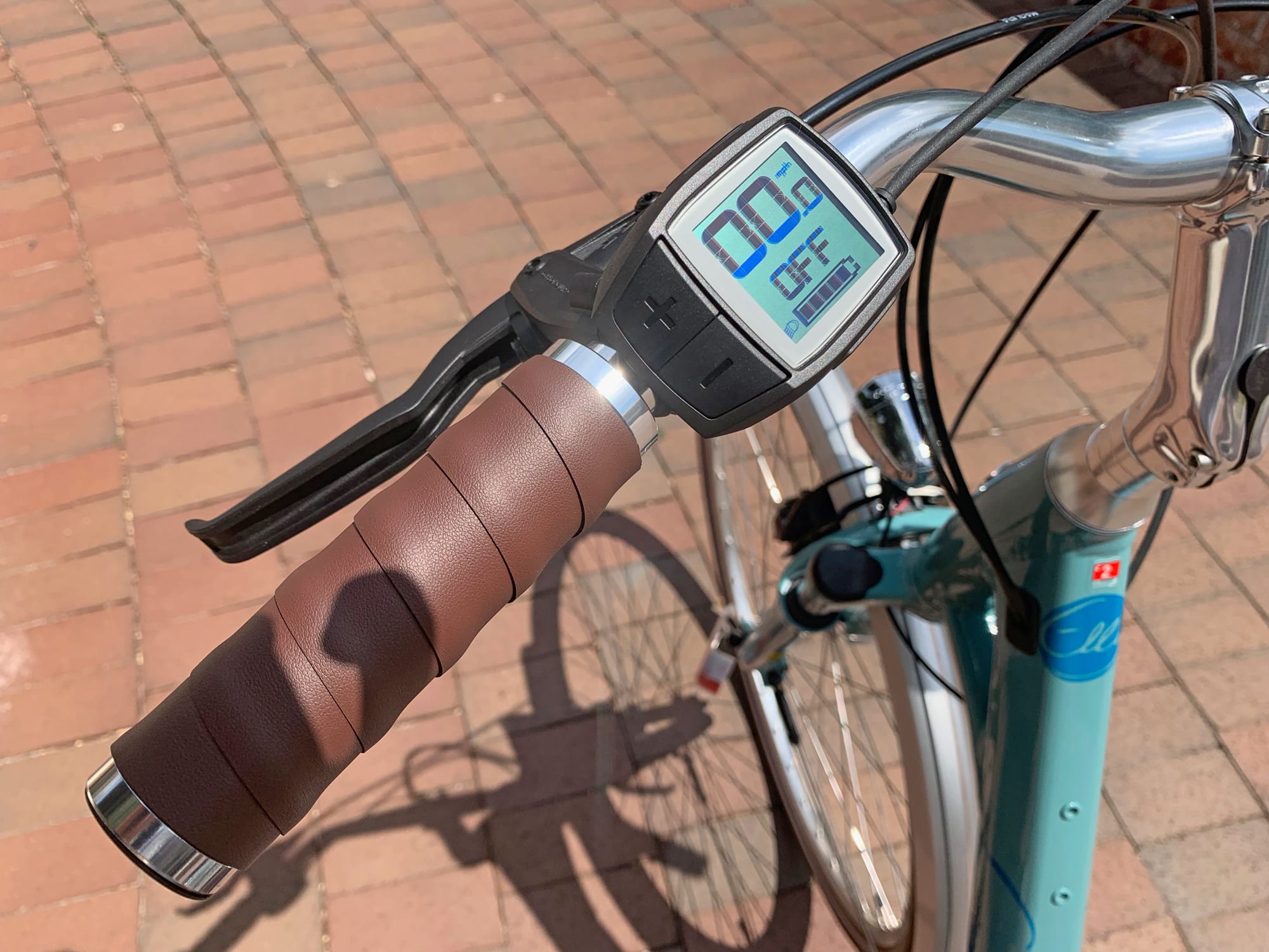

- Normally I complain a bit about the Bosch Purion display panel (because it’s smaller, lacks some of the advanced readouts, and doesn’t have an active Micro-USB charging port built-in) but in this case, the simplicity works well for casual riding

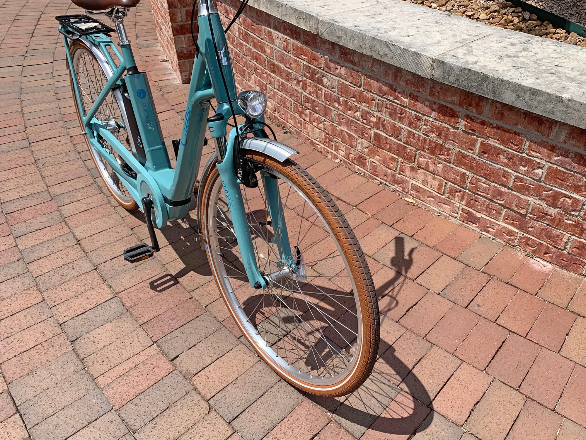

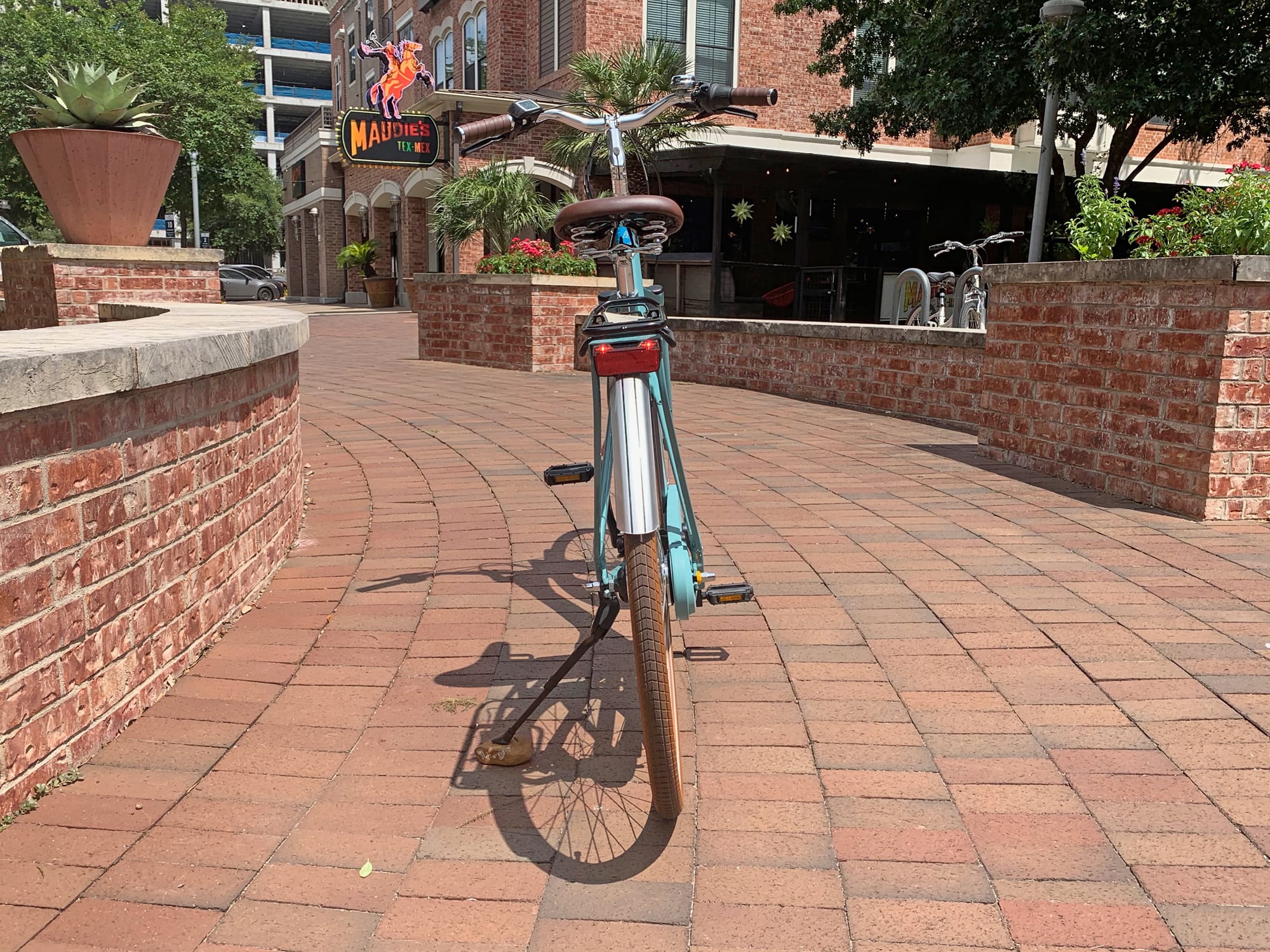

- This ebike comes completely setup for rain or shine, day or night, because it has fenders, integrated lights (with 2 LEDs in the rear light and a very nice headlight), and even a bottle cage mounting point on the downtube! Great attention to detail
- Notice how CUBE mounted a platform on top of the rear rack support? This thing is much easier to strap trunk bags to, clasp small objects with the spring latch, and even has side hangers for clip-on panniers, it’s ideal and shows more attention to detail
- Did you notice that even the tires have reflective stripes painted on them? This is a great safety upgrade that compliments the bright colors and integrated lights to keep you safe at dawn and dusk

- Even though the suspension fork is kind of basic, compared to mountain bikes, you still get preload adjust to “pre-load” the spring inside, which is great if you’re a heavier rider or plan on carrying lots of gear, carefully remove the black caps on both sides of the crown of the suspension fork and then twist the dials the same amount so the springs are even
- I love that this electric bicycle uses hydraulic brakes because they are more consistent and easier to actuate than mechanical (which get gunked up and can stretch), I also like that they chose rim brakes vs. disc because they are more durable when parking at crowded bike racks

- Sometimes, wave style step-thru frames can feel flexy… but CUBE added an extra tube for stiffness and strength near the steering tube, their main tube is angular and extra wide vs. a basic circle tube, I also noticed that they positioned the bottle cage bosses up high on the downtube so it wouldn’t compromise the tube strength further down or get kicked as easily when mounting/dismounting the bike
- The Bosch Active Line motor seen here, uses a standard sized chainring! There’s no reduction gearing like some of the older Bosch Performance Line motors, which increased noise and pedal drag
- Great kickstand position, it’s mounted near the back of the bike so you won’t get pedal lock, and the stand itself offers adjustable length
- CUBE is using an ABUS locking core to secure the rack battery and it comes with a little card that has a “Plus Code Card” code for ordering matching ABUS locks to secure your bike! This is handy because they you don’t need two separate keys for the bike battery and your folding lock or whatnot

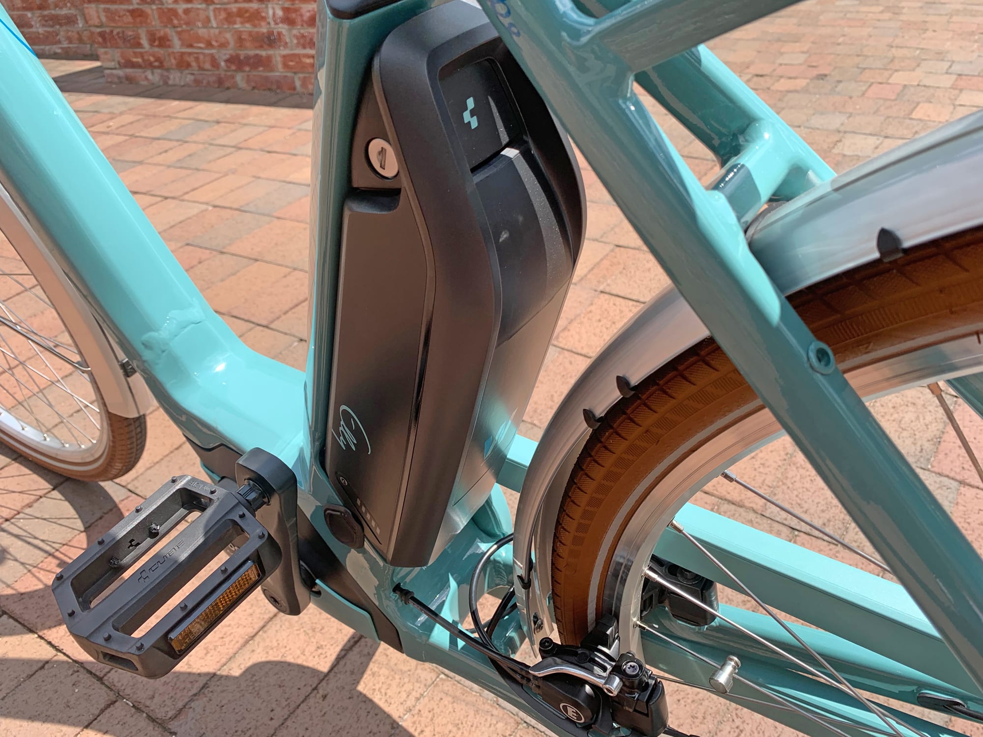

- The battery mounting position is a bit more cramped than the older rear rack design, you might need additional time and effort to unlock and remove it, and you might bump into the rear fender a bit while doing so, but it’s not a huge deal
- The charging port on the frame is positioned on the left side, very close to the left crank arm. This can create snags and is just trickier to reach than the port was up high and not near the crank arm

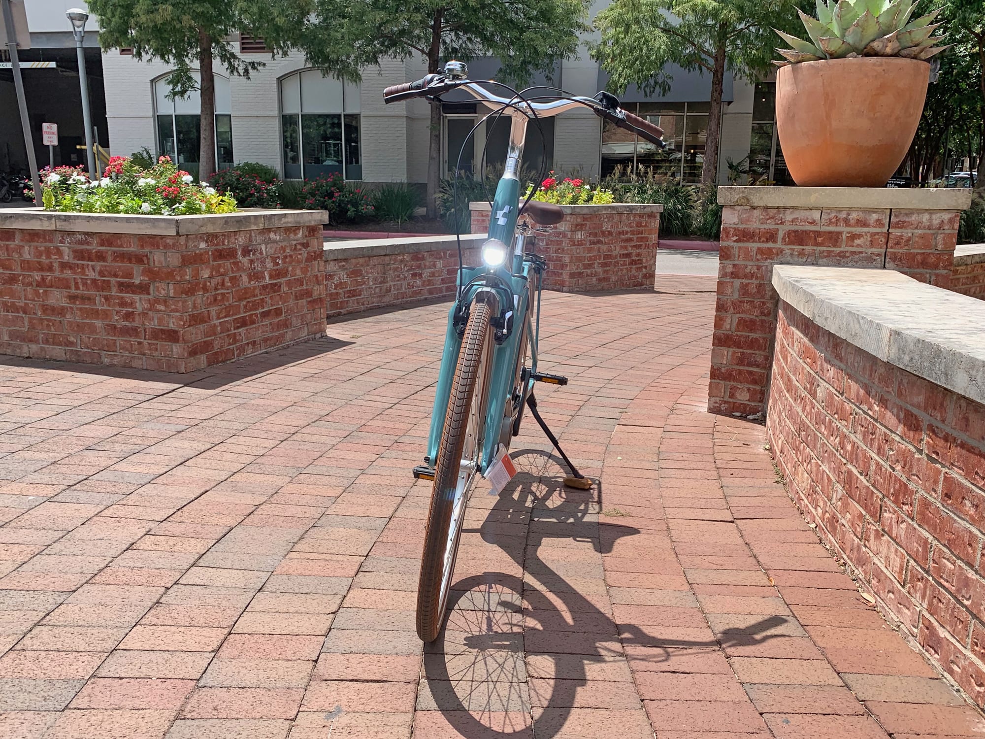

- Minor consideration about the headlight, they have new products now with side windows that further increase visibility, it would be nice to see CUBE adopting that style of light for their more premium city ebikes like the Elly Ride
- Minor consideration about the suspension fork and headlight, there’s no lockout and the fork is heavier and just not as fluid as an air fork would be, the headlight is mounted to the fork arch which travels up and down so the light could bounce a bit, it would be cool if they put the headlight up at the handlebar
- The Bosch Purion display is great in terms of small size and it has many functions that are useful but it is not removable which could lead to damage at bike racks and just more exposure to weather, and sometimes the buttons can be difficult to click (I usually push near the display face vs. the lower left edge because they angle towards the display), it also does not have a working Micro-USB charging port the way that the larger Bosch Intuvia display does… but it’s not a huge deal considering the smaller 400 watt hour battery on this bike
