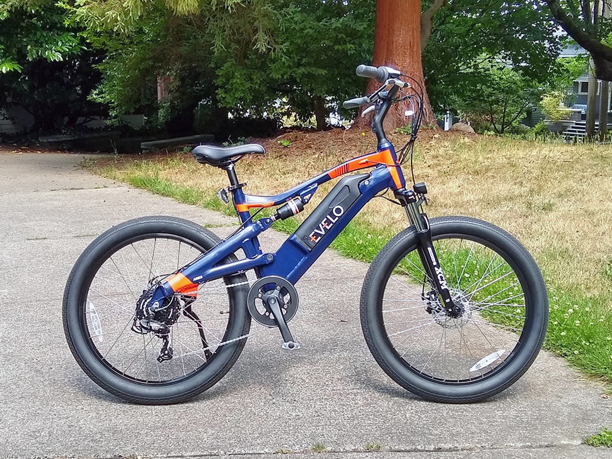

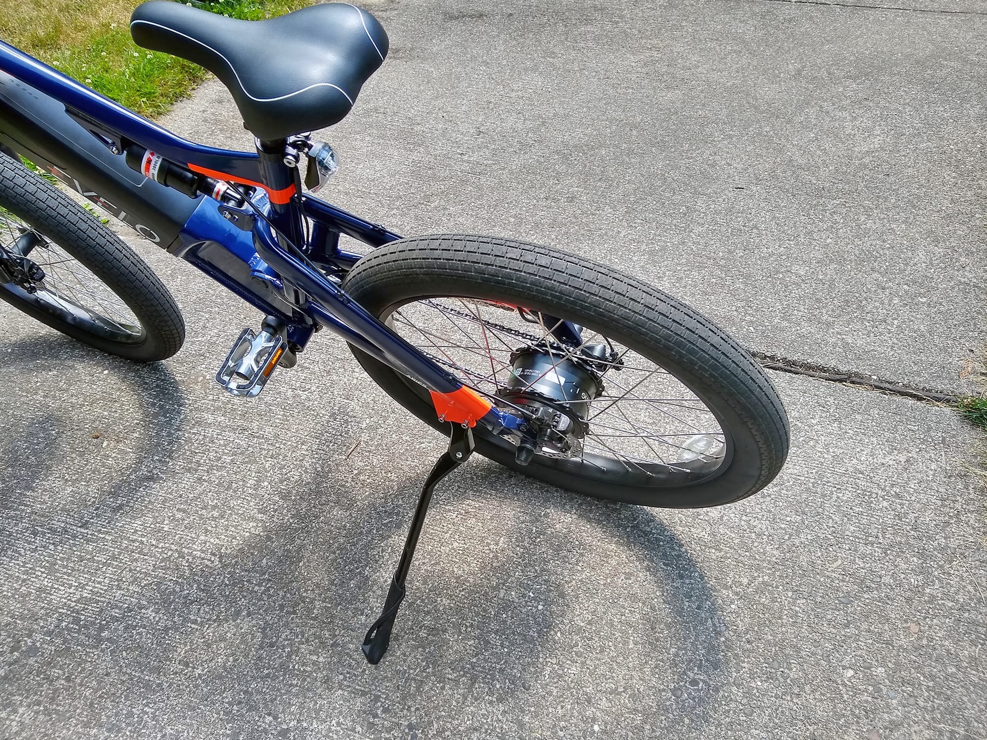

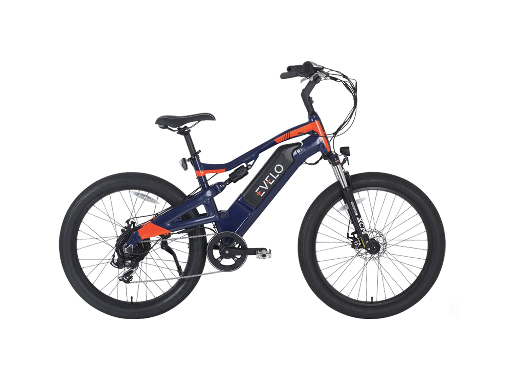

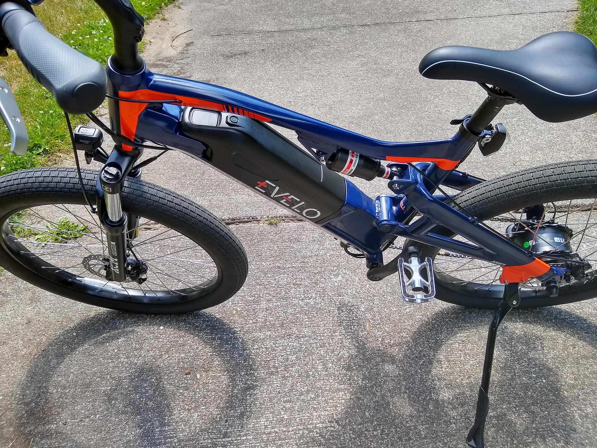

EVELO makes a number of bikes and has been around for a while. I would have to say one of the coolest rides they have is this full suspension all purpose bike, the Aries. Now the Aries we are looking at today is the Aries Hub Drive. It also comes in a mid-drive, and that is a separate bike we will review as well. But the hub-drive version is really cool because it takes what makes the Aries Mid Drive so special, and puts it in a more affordable package. Being a more entry level bike in their lineup at $2,599, means it may have some scaled down parts, but you would be surprised what they put in. First off, let’s talk about this frame a little bit… It almost looks a bit like a mountain bike without much of a chain-stay. The choice of frame design here keeps it more stable, lightweight, and makes it easy to get that back wheel on and off as well as service the hub-drive motor. Adding to that all purpose feel are these high-volume tires. These are 26” x 3”, so with that greater width, you get more stability and comfort. There is not knobby tread, instead, they went with a more efficient and comfortable tread you might see on a cruiser. The tires have puncture protection, and they do a great job getting the bike up to speed. Speaking of comfort, the bike has a lot to go around, like the ergonomic grips, swept back handlebars, and special stem design that has a lighter, more robust, and comfortable rise to it compared to most. This bike seems to float on air thanks to the suspension.. the front is an SR SunTour XCM fork with 100mm of travel, lockout, and preload adjust. The rear is also a more basic spring suspension, but you can tighten or loosen the spring by twisting the canister, so there is some adjustability here. I love the battery integrated lights here, they have them both in the front and the rear. Safety has always been a priority for myself and other cyclists, so it’s nice to see that more and more companies are including these on ebikes. I should also mention that the back light is an active brake light when you press the brake levers…very cool! The bike also includes a kickstand in the rear. It is nice to have it back there since having it near the crank arm can produce ‘pedal lock’; an annoying occurrence that locks the pedals when you reverse a bike with the kickstand down. Luckily, this bike eliminates that by having it positioned further back.

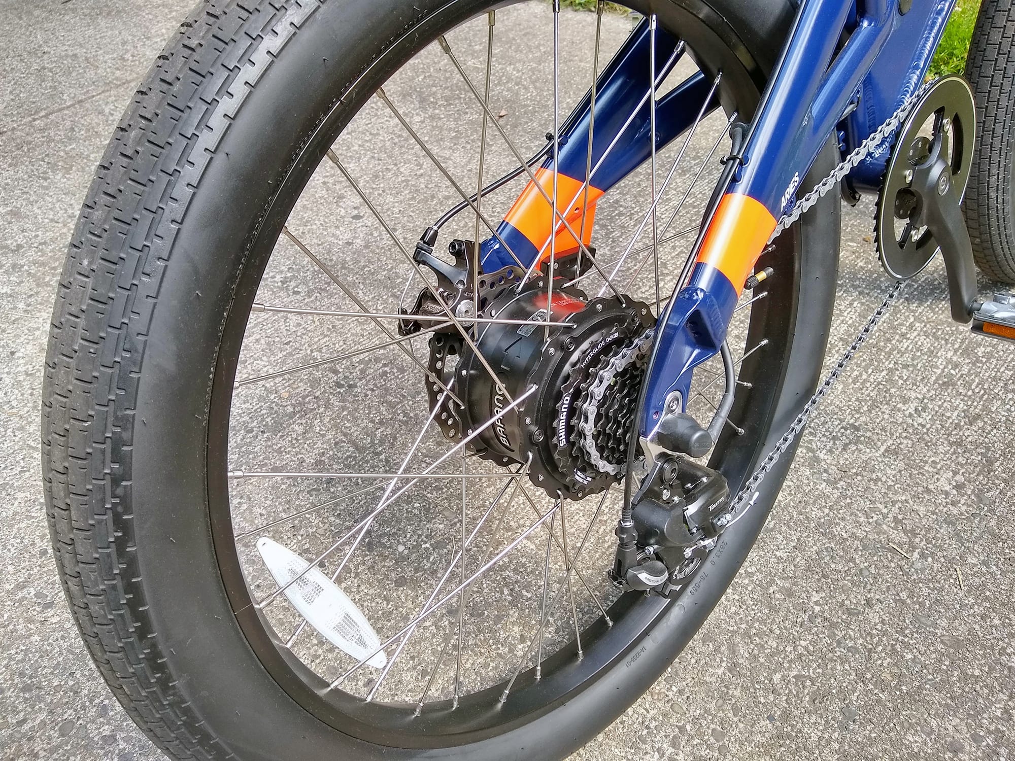

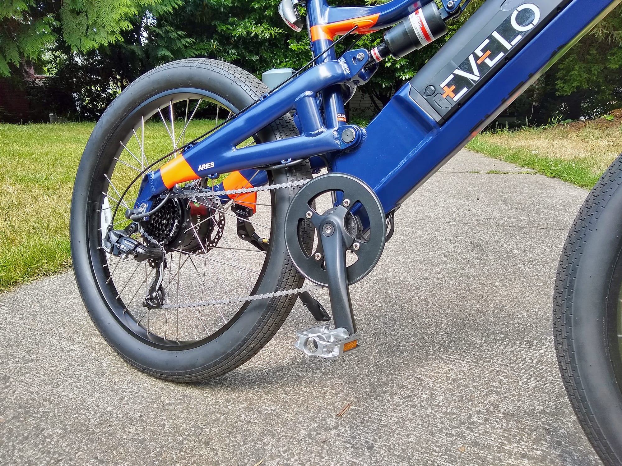

Driving the bike is a Bafang 750 watt – 1000 watt peak hub motor, just as the name implies. This has about 80nm of torque and is a pretty strong and reliable setup. The bike has both cadence based pedal assist as well as a thumb throttle mounted on the left side of the handlebar. Mechanically, the bike is operated by a Shimano Tourney 7 speed system. It has 11-28 tooth cassette in the rear and a 48 tooth chain ring in the front. Shifting is done with this twist style grip shifter on the right. I will say that grip shifts are not my favorite, but it feels solid on this setup, so I can’t complain. Stopping the EVELO Aries Hub Drive is a set of Tektro Aries mechanical disc brake rotors. The rotors are 160mm and I love that both of them have motor inhibitors built in to cut power to the motor when braking. Mechanical disc brakes are easy to maintain as well as adjust, however, they lack the immediate stopping power that hydraulic brakes offer. Mechanical brakes are still quite capable, but they take a little bit more hand actuation compared to hydraulic brakes.

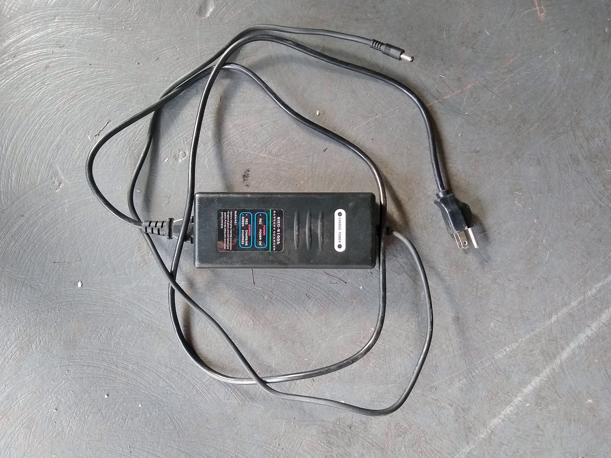

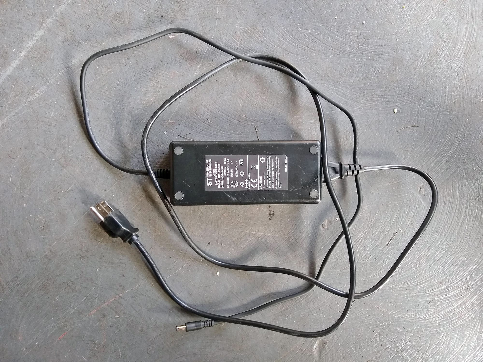

Powering this bike is a large 48v 11.6ah lithium ion battery. This makes for a total of about 500 watt hours, so the bike is both powerful and able to hit decent ranges. It is located on the downtube and can be charged both on and off the bike. Removal is done via lock and key, and overall is pretty easy as you take it out from the side. Charging the battery is done via the included 2amp charger. Not the fastest, but I am told charging it at lower amps can reduce wear on the charging cycles over time. To really care for this and other lithium-ion packs, I have heard that storing in a cool dry location vs. extreme heat or cold will extend the life and try to keep it about 50% full when not using for long periods so you won’t stress the cells. Try not to let it run down to zero, because that’s really hard on the cell chemistry.

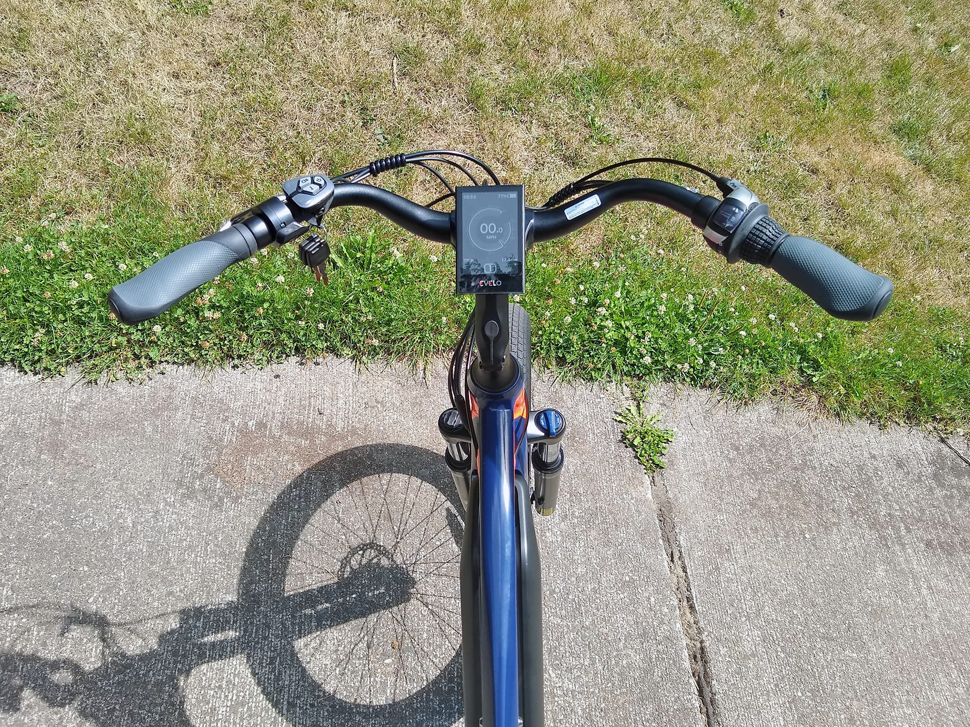

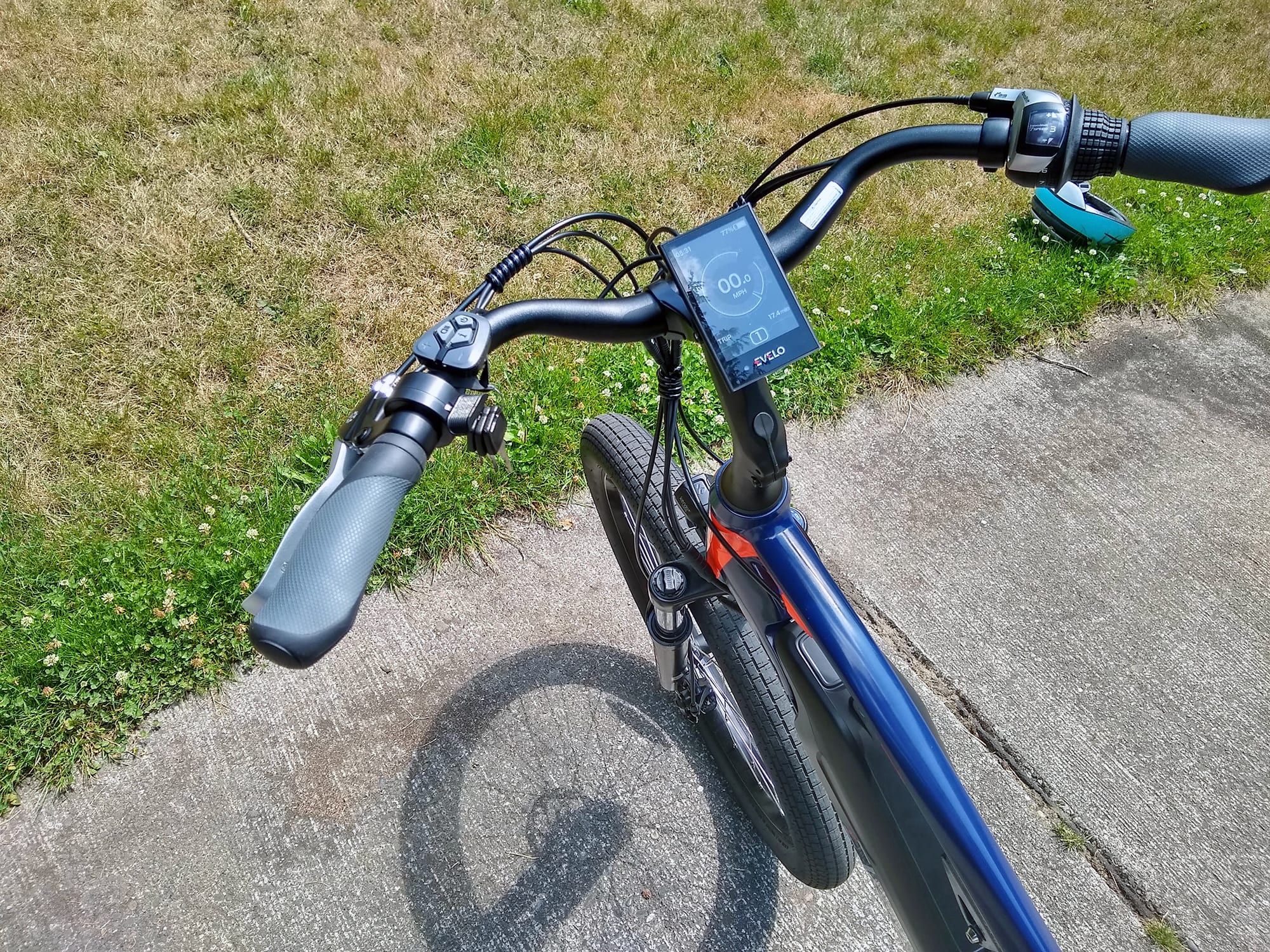

Operating the bike is simple enough. I’m kind of a control center geek and I always love to see comprehensive stats while riding. The control center on the Aries does just that. It displays pretty much everything, including current speed, top speed, average speed, range, battery level, pedal assist mode, wattage output and more. More importantly, I could read it in direct sunlight! I love that it is color and uses an automotive motif. A big win here is that the battery power is listed in percentages. Some ebikes use just 4 or 5 ticks on the display to portray battery life. This can leave you guessing at the last tick. Do you have 25% battery life left? Do you have 2% left? You simply will have to guess. Not with this display… since it is written in percentages, you know exactly how much battery you have at all times. The only downside to this display was that it’s not removable, so I might worry about it getting dinged up when the bike is being parked or transported and just taking more sun and rain damage over time. It does however angle, and I love that the controls can be pressed easily by your left hand since they are positioned well as to keep your eyes on the road. Some versions of this setup allow you to enter a deep menu mode, but I am not sure if EVELO included this. By holding the UP and DOWN button, it will allow you to get in there and change things like the top speed or motor output.
