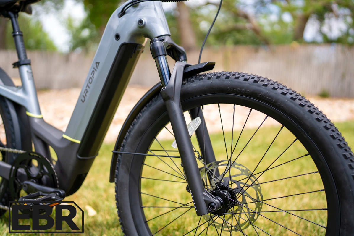

I know I’ve talked about the carbon frame a lot already, but the Toray carbon fiber also improves how the bike feels on the trail. Carbon fiber is both stiffer than aluminum, and it absorbs bumps better as well. Urtopia also added an extra support bar towards the bottom of the step-through design, making it feel sturdier than most step-through frames I’ve ridden. A lot of riders shy away from step-throughs because they expect flex or worry the bike doesn’t look bold enough.

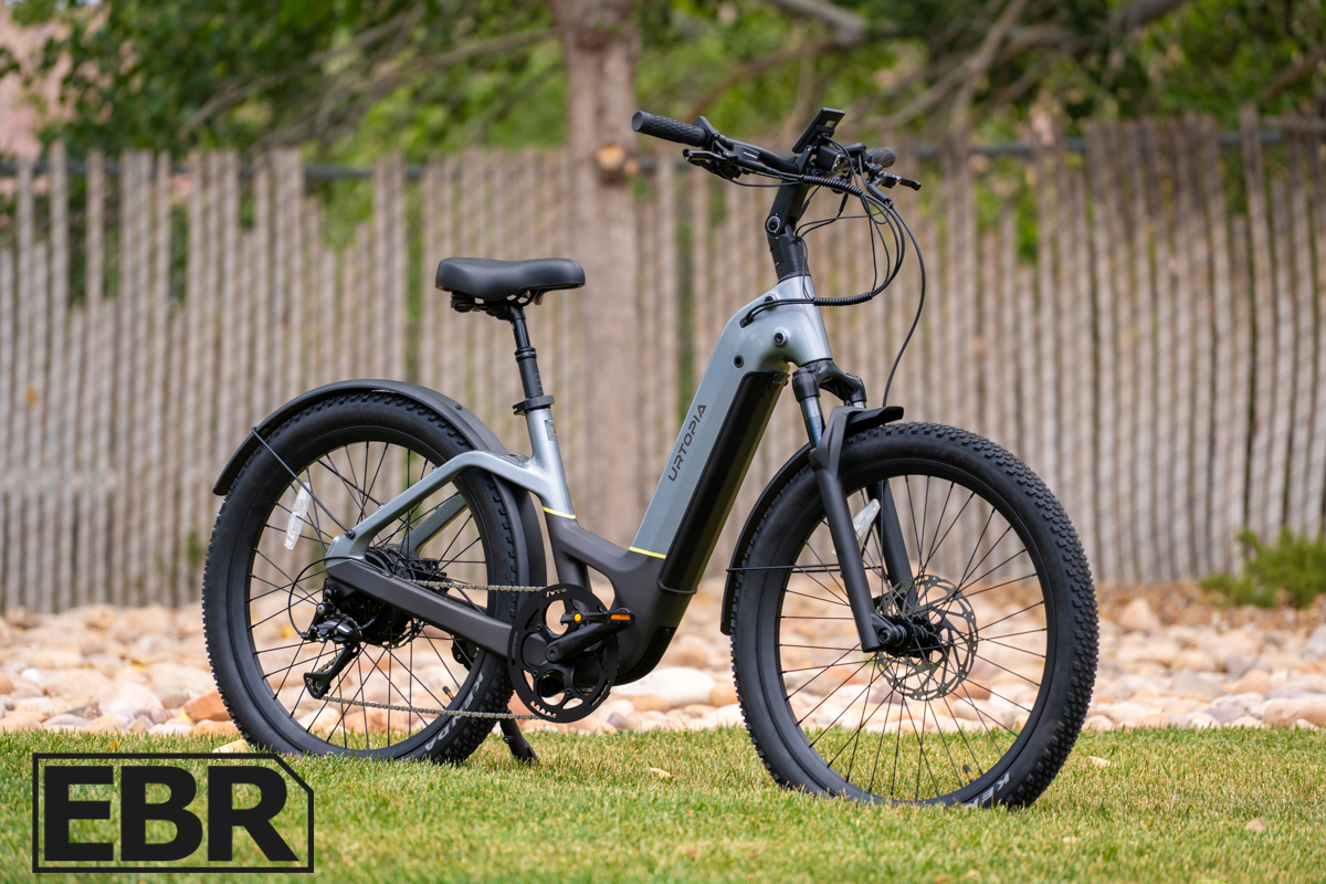

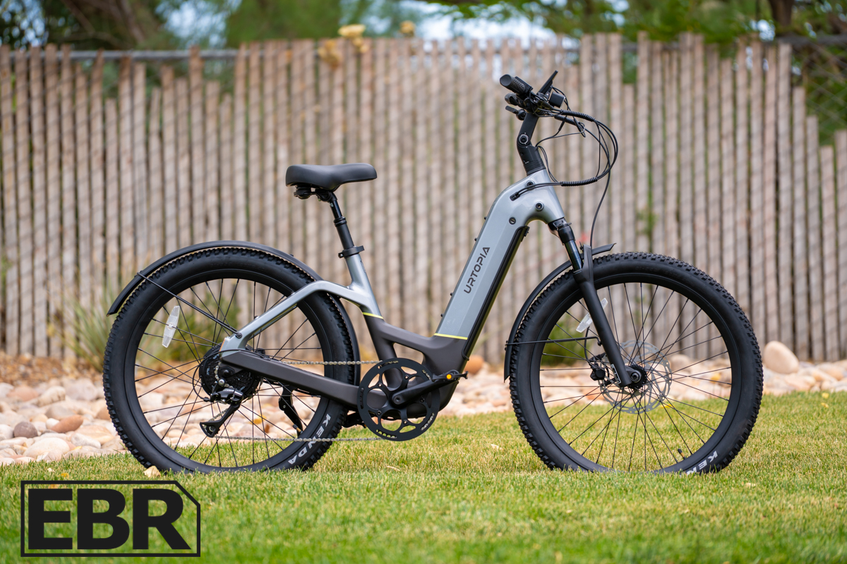

This one looks bold and feels strong while still being approachable with a low step-thru height.
Geometry-wise, the reach measures 355mm and the position is more upright than a mountain bike but not as laid-back as a beach cruiser. For my height it felt comfortable for longer rides without being either stretched out or cramped.
The bike is a one-size-fits-most frame rated for 5’3″ to 6’3″. Being honest about the edges of that range, riders near 5’3″ will likely run the seatpost close to the minimum insertion mark, and riders near 6’3″ may not get full leg extension.
However, the 90-degree adjustable stem helps here, letting shorter riders drop the bars and taller riders raise them, so the effective fit range is better than a single frame size might suggest.

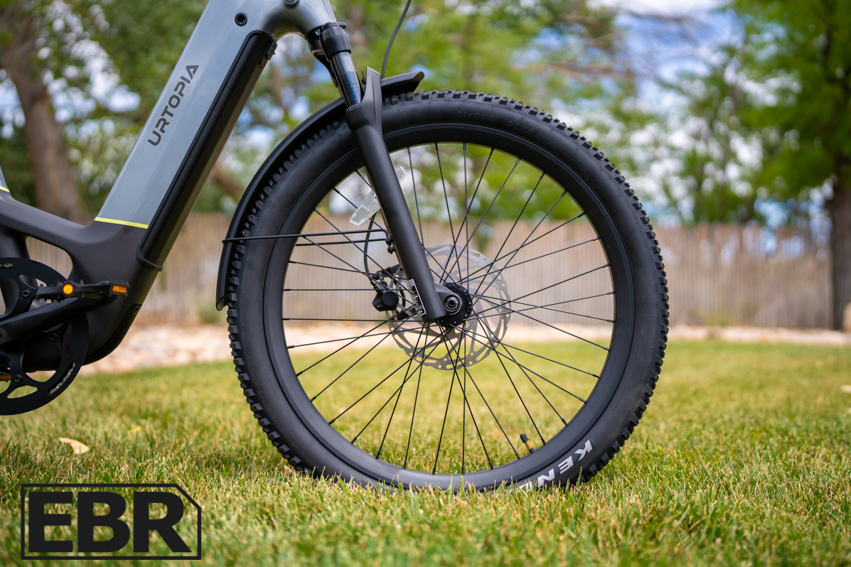

Handling is one of the bike’s strengths. At around 64 pounds it’s lighter and more nimble than most SUV bikes, easy to lean into turns and confident on the 26 x 2.4 all-terrain tires.

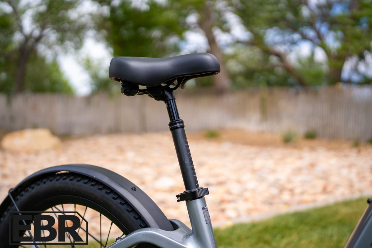

The 80mm fork with 32mm stanchions does a good job over bumps, and paired with the 30mm suspension seatpost, the bike stays comfortable over rough pavement and light trails.
One note on Urtopia’s marketing: they call this a full suspension bike. It isn’t.
There’s no rear shock. The suspension seatpost adds comfort for your backside but won’t keep the rear wheel planted on the ground the way a rear shock would. It takes the edge off, and I’m glad it’s there, just don’t expect mountain bike suspension when you hear the words ‘full suspension’.
That being said, I took the Carbon Atom off-road on some loose dirt double-track to see how the SUV bike handles that kind of terrain, and it did better than I expected. The knobby tires gripped well even on loose sections, and the front fork felt more plush than I anticipated.
This isn’t a mountain bike and I wasn’t hitting single track or jumps. But for camping trips and dirt roads around town, the Carbon Atom is a comfortable, capable ride.

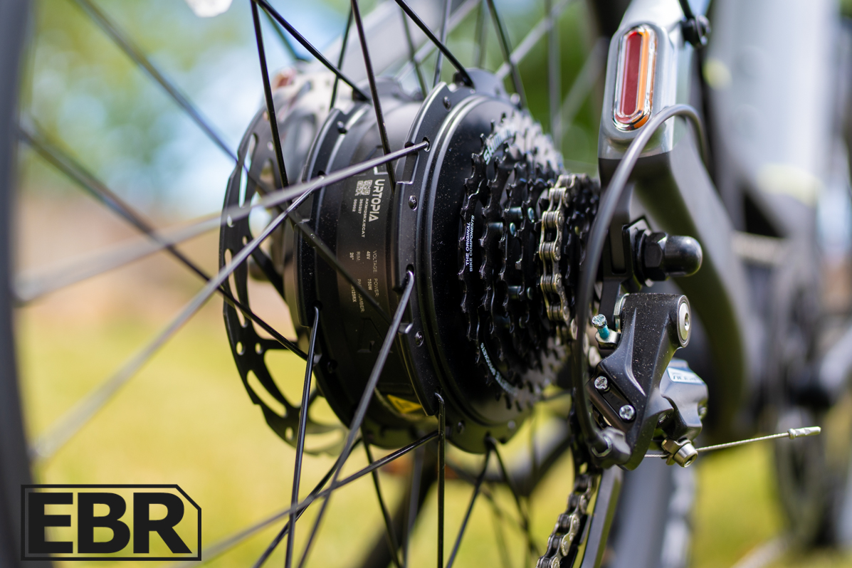

Urtopia spec’d the Carbon Atom with a 750W nominal rear hub motor (1250W max) rated at 90Nm of torque. For an SUV-style hub-drive bike, that’s the kind of power output we’d expect to see.
Where this motor stands out is the sensor.
Urtopia calls it a zero-latency torque sensor, and it lives up to the name. Power engages within a quarter turn of the pedals, scales naturally with how hard you push, and cuts off cleanly the moment you stop pedaling with no extended surge to throw you off. It’s smooth and incredibly quiet across every assist level. I love how much hub motors have improved these last two years, and Urtopia’s motors are no exception – they are very impressive.
On the hill test, I climbed our very steep and long “black hill” in 1:23 in turbo mode at a 15.1 mph average, and 1:24 in boost mode at 14.9 mph, so the two top modes perform almost identically. On throttle alone it took 1:36 at a 13 mph average.
Those are solid results, but it’s not just the time that stood out to me, but how naturally the power was delivered. No, I didn’t have to put many of my own watts into the pedals to get up the hill. A lot of bikes are programmed that way. However, the Carbon Atom climbed in such a natural manner that I could have almost forgotten I was on an e-bike and believed it was me who had He-Man leg strength.

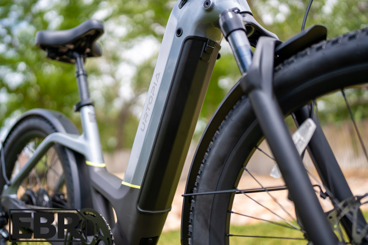

On the battery side, Urtopia went with an 802Wh, 48V pack, which is about 10% larger than the 720-730Wh batteries common on competing SUV bikes. The battery weighs about 8.6 pounds and carries UL 2271 certification.
Urtopia could have made the bike even lighter by about 1 lb, but they chose to give you more range instead, and I like that call since the bike weight is still very manageable.

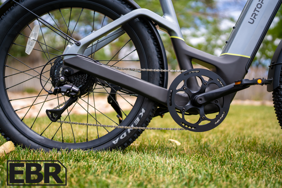

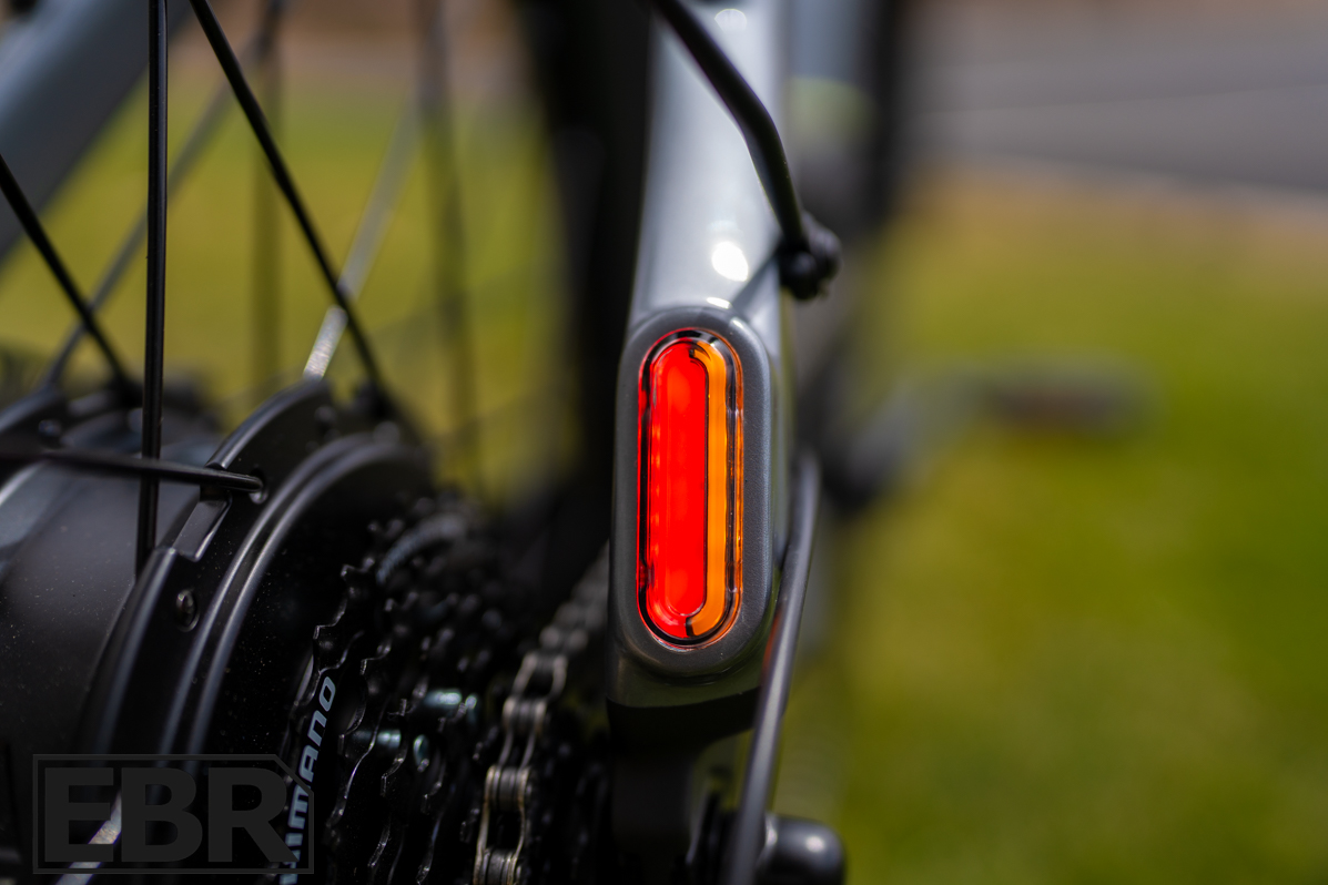

The drivetrain is a Shimano Acera 8-speed with a 12-32T cassette and a 52T chainring. Acera sits a step above Altus, which sits above Tourney, so you get crisp shifting that’s easy to set up and adjust. It’s still somewhat entry-level, and on most carbon fiber bikes you’d expect to see Deore or higher, but those bikes also carry $4,000-plus price tags. At $2,499 with a carbon frame, Acera is better than expected.

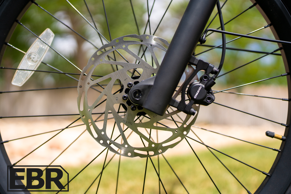

Braking comes from Tektro HD-E3520 hydraulic disc brakes with a large 203mm rotor up front and a 180mm rotor in the rear, both 1.8mm thick. We did our brake test down the Black Hill, hitting speeds of 25 to 28 mph and braking repeatedly seven times, and felt no fade at all. Strong, confident stopping power, and the levers are easy to reach and pull with two fingers.
Up front is an 80mm suspension fork with 32mm stanchions, with preload adjustment and a full lockout. The preload doesn’t do a lot, but the lockout works well, and heavier riders can firm things up if the fork feels soft. The fork is paired with a 30mm suspension seatpost for added comfort. Again, this is a comfort feature, not a full rear suspension shock.

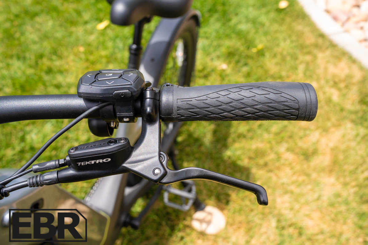

The cockpit has ergonomic lockable rubber grips that are comfortable, Tektro brake levers with good feel, and a 90-degree adjustable stem that extends the fit range nicely. The stem uses a custom headset assembly that’s a little harder to work with, and you can swap the handlebars if you want.
The right-side throttle requires a double-tap to engage from a standstill, a smart safety feature that prevents accidental “whiskey throttle” takeoffs. There’s also a loud, crisp bell mounted on the left, which is useful for alerting people on shared paths. I know it’s a small thing, but I really appreciate how loud the bell is without being annoying. Runners with airpods in still heard me – which doesn’t usually happen.

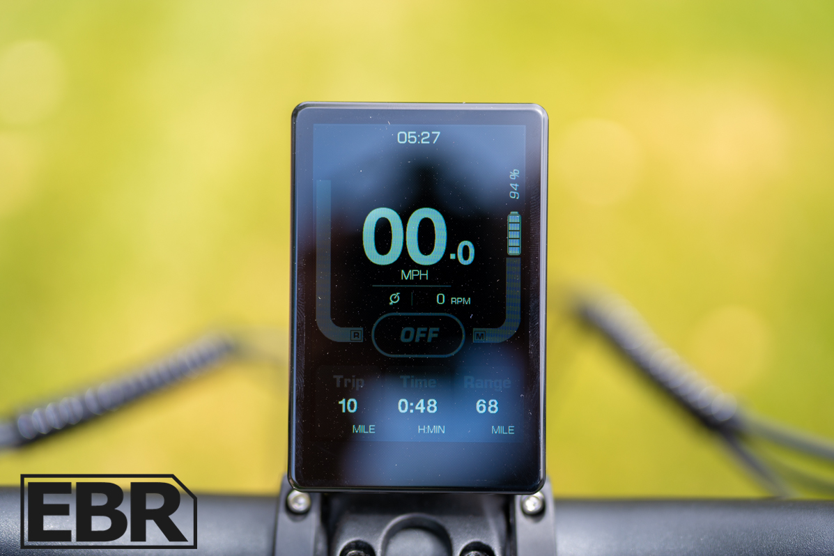

Urtopia gave the Carbon Atom a 3.5″ color display, and the location is one of my favorite things about it.
It’s raised up above the handlebars so you don’t have to look far down to read it, and it’s large enough to take in everything at a glance. The main screen shows the time, battery readout in both percentage and bar form, speed, RPM, and your current assist level.
The battery readout is a true percentage rather than 10% increments, so it’s more accurate than a standard bar display, which I appreciate.
Press the select button and you get into trip data, odometer, average and max speed, and a power analysis showing average and max wattage plus the split between rider and motor effort.
The one thing I’d add is a real-time wattage readout. Right now you only get average and max, not live output while riding, and that would be a useful addition.
What stands out most is that you can do all your tuning right from the display without an app.
Hold the select button and you’re into advanced settings, where you can adjust the speed limit anywhere up to 28 mph (it won’t let you exceed that, which keeps it legal, and you can password-protect the limit), set walk-assist speed, configure auto-sleep, enable OTA updates, and tune the output of each assist level (Eco, Tour, Boost) to your liking.
Being able to tune assist levels directly from the screen, without needing a phone, is something I’d like to see on every bike.

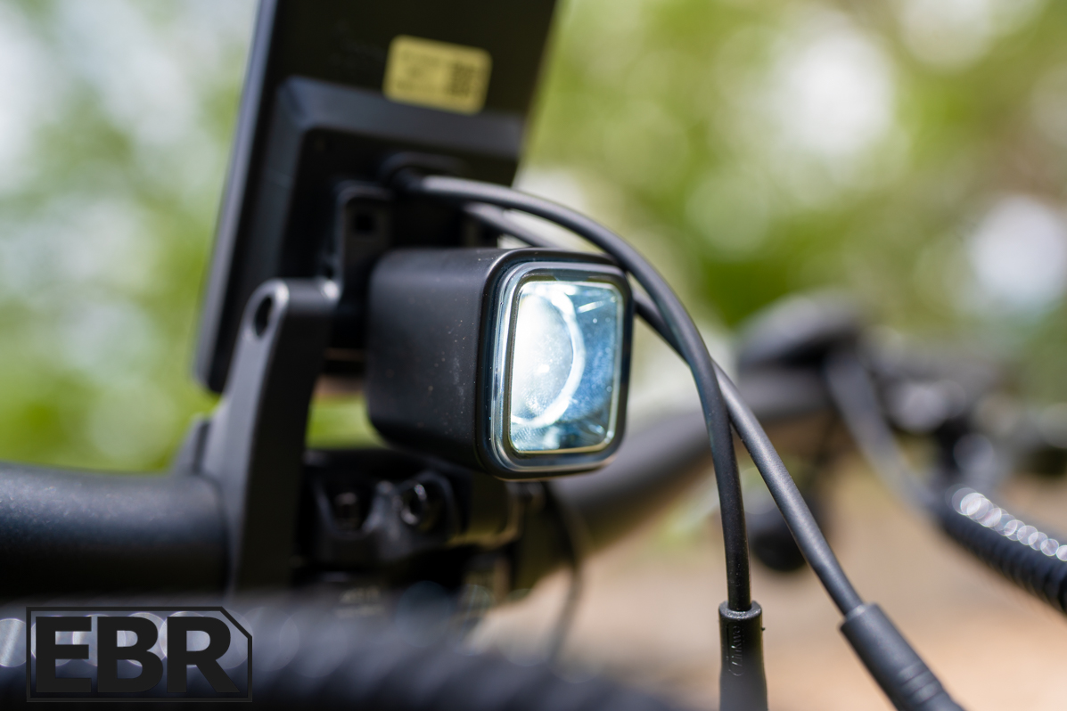

A bike with this spec: carbon frame, 802Wh battery, large-rotor hydraulic brakes, a smooth torque sensor, full lighting with turn signals, and UL 2849 and UL 2271 certification, would typically cost $1,000 to $1,500 more.
