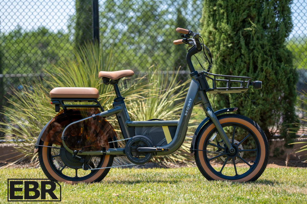

Segway calls the Muxi a beach cruiser with the stability of a Dutch cargo bike, which is an interesting combination – but one that I absolutely love!
Technically, the Muxi is a short-tail utility bike priced at $1,699.99 and has a ton of tech built into it – which is what I was expecting going into this review given that Segway wasn’t a bike company first. Segway has always been a tech mobility device company, and it shows in the Muxi.
What did surprise me is how tech-savvy Segway was able to nail the geometry and create a very fun cargo bike. With a few small tweaks, the Muxi could be a contender as one of the best cargo bikes available.

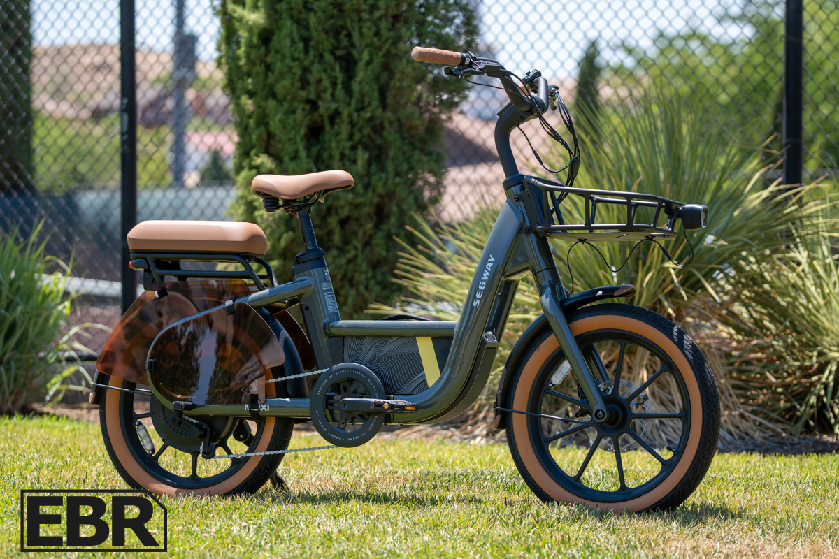

The first thing that stood out to me, before I ever turned the motor on, was how sturdy this bike feels. It has a 418 lb payload capacity (including 120lb capacity on the rear rack), which is a lot – and is a weight that requires a solid frame, low center of gravity, and precise engineering.

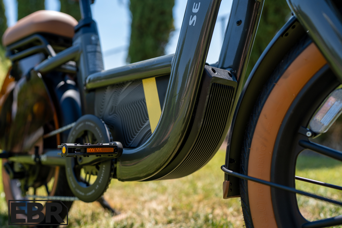

Segway did great with all three. Its incredibly stiff frame is well-built, with a 44.75″ wheelbase and 11″ bottom bracket height the bike’s center of gravity is nice and low to the ground – making me feel very comfortable riding loaded up with cargo.
Segway then “went Dutch” with the cockpit, making the bike very comfortable from a geo perspective. The handlebar is swept back far enough that I sit upright with my shoulders relaxed, and at 28.75 inches wide it gives good leverage without feeling too wide.
The quill stem has 3 inches of height adjustment. It is not a quick-adjust stem, but you can dial it in once and forget about it. Standover is 20 inches, so getting on and off is easy. Segway lists a fit range of 4’8″ to 6’0″, and I think they are being conservative on the top end. The seat post gives 6 inches of adjustment and I ride about an inch below the max insertion line, so riders around 6’1″ should be fine. Taller than that and you will be short on leg extension, though the cadence sensor takes some of the sting out of that. On the low end, note that Segway publishes a 28 inch minimum inseam, so shorter riders should measure before ordering.

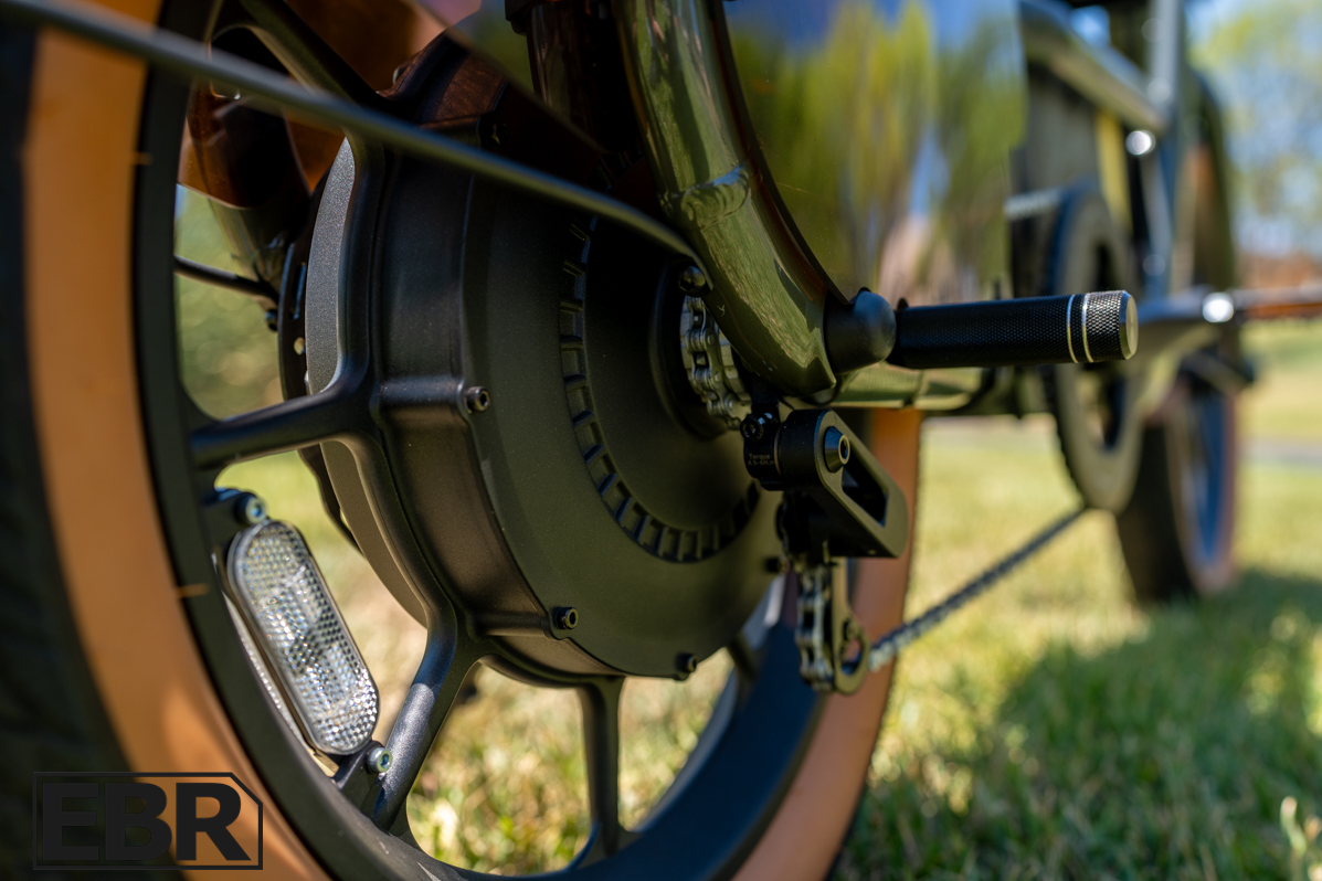

The Muxi has a 750W nominal, 1,500W peak direct drive rear hub motor with 80Nm of max torque. Direct drive is the choice that makes the rest of this bike possible, because it is what allows kinetic energy recovery, which is Segway’s name for regenerative braking.

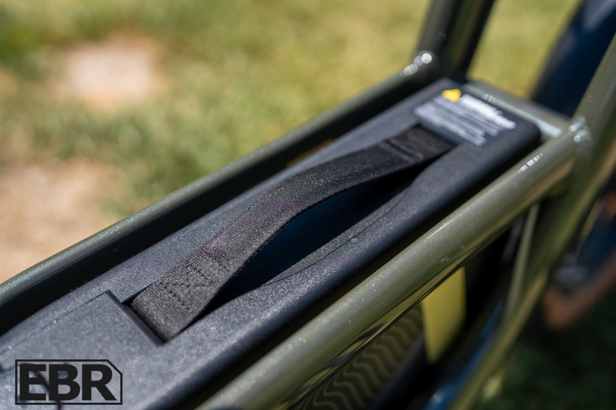

The battery is a 48V, 15Ah pack rated at 720Wh. It is UL 2271 certified, it is removable, and it lifts out of the frame without any wrestling. It charges at 3.9A for a full charge in about 5.5 hours.

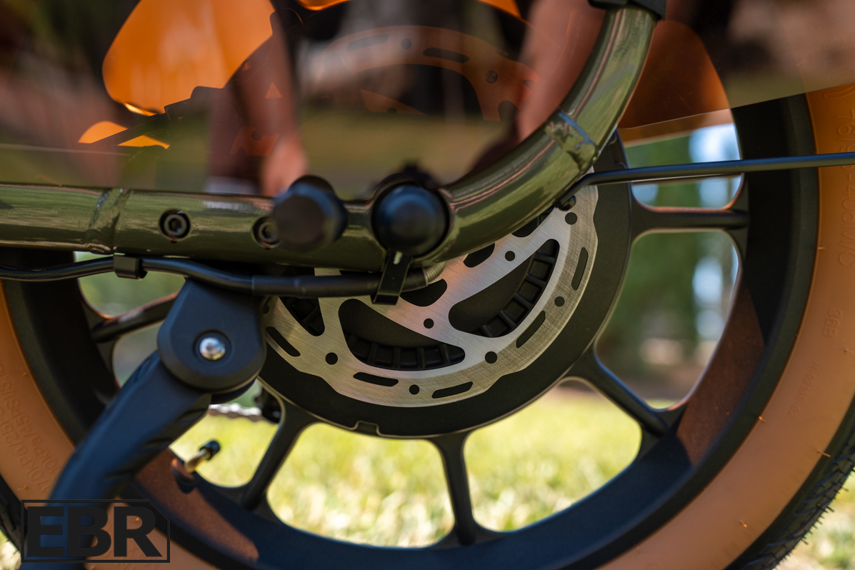

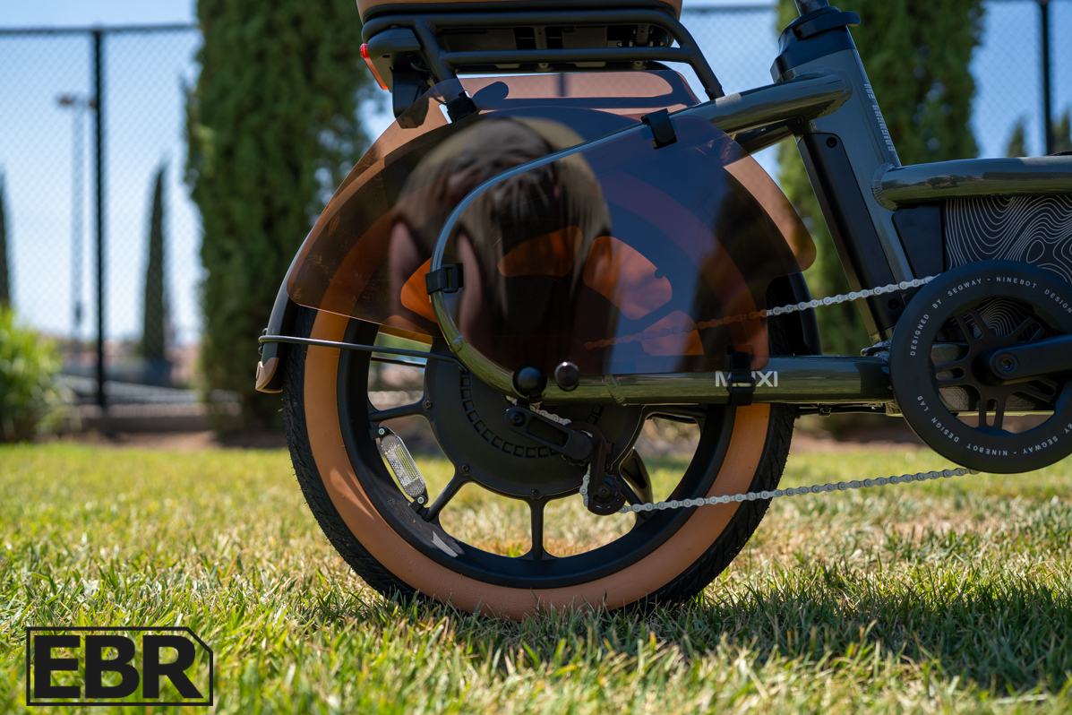

Drivetrain: there is no derailleur here. The Muxi is a single-speed with a 48T front chainring and a 13T rear freewheel cog.
Single-speed drivetrains are hard to get right because brands have to balance a gear low enough to climb against a gear tall enough to not ghost pedal above 20 mph. With the Muxi, Segway leaned more towards the climbing side of things, which makes sense on a cargo bike IF you have to choose between the two. The downside is that the bike starts to ghost pedal around 20 mph. It’s not overly bad, but it is my one complaint about the bike. I love having a single gear drivetrain, but Segway either needs to:
- Increase the power output of the motor so they can increase the gearing (i.e. make it harder to pedal so you don’t ghost pedal after 20 mph) and not hurt the hill climbing capabilities, or
- Put either an internal gear hub or rear cassette to increase the gear range.
I actually think that the single gearing is one of the reasons the Muxi is rated at Class 3 but only 23 mph max instead of Class 3 and 28 mph max.
Brakes:
- 2-piston hydraulic disc brakes
- 180mm rotors
- 1.8mm thick

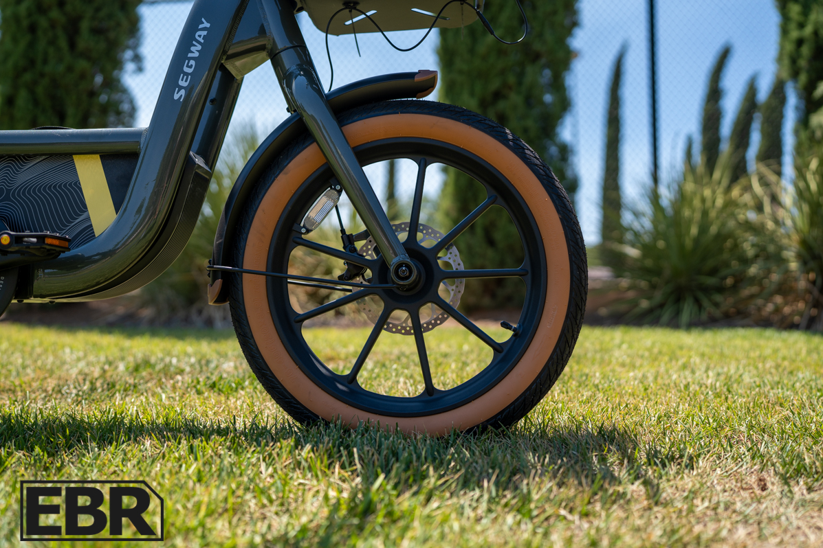

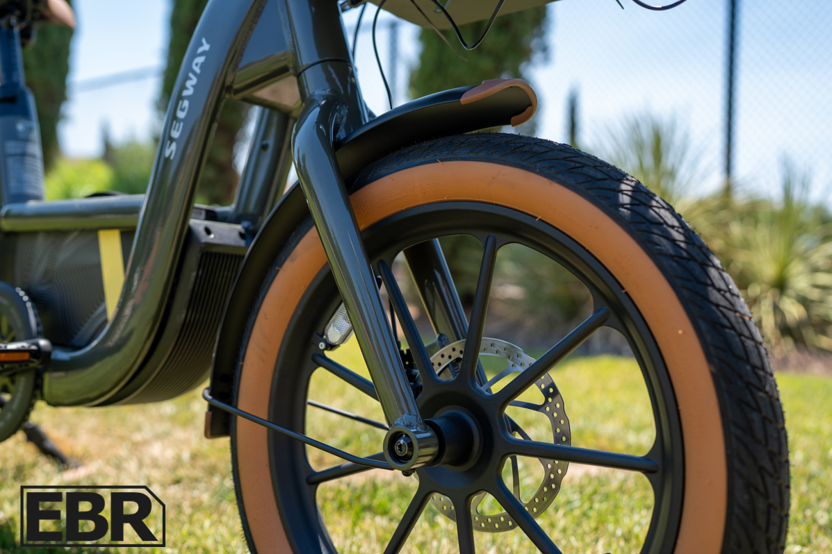

I was a little worried going in, because 2-piston calipers and 1.8mm rotors on an 84 lb bike that can carry another 330 lbs is asking a lot. However, the Muxi did great in our hill testing – the regenerative braking increased the braking capabilities of the bike.
Suspension: there isn’t any, and I am putting that in the plus column. Getting suspension right on a cargo bike is hard, because the load on the bike is constantly changing. Cheap suspension forks on cargo bikes tend to be divey and unstable once there is weight over the front wheel. A quality air fork solves the diving, but then the rider has to change the air pressure every time the cargo changes, and nobody is going to do that on the way to the grocery store. A rigid front end sidesteps the whole problem. You give up some comfort, and you can add a suspension seat post if you want some of it back, but for what this bike is built to do, rigid is the more capable setup.

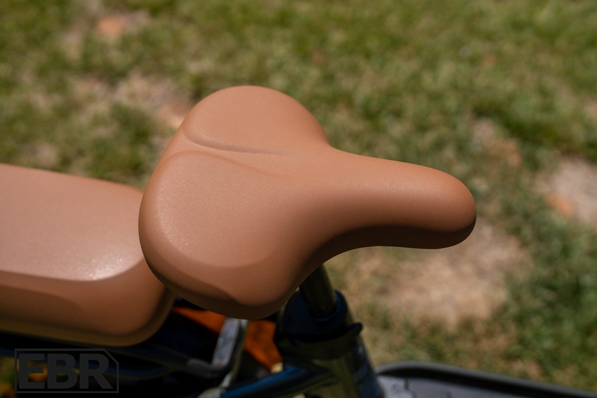

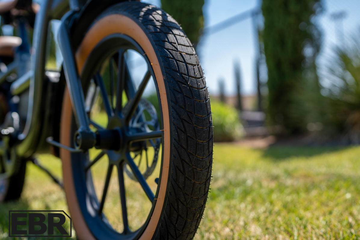

Tires, saddle, and cockpit: the 20 x 3.0 multi-surface tires do most of the comfort work, and they roll well on pavement. The saddle is more padded than what I usually find at this price and has springs at the rear for a bit more give. The locking ergonomic grips have a slight butterfly shape and my hands did not slip on them even when it was hot and sweaty out. The swept-back Dutch handlebar measures 28.75 inches wide and pairs with a quill stem that has 3 inches of adjustment. The left control pod handles power, horn, a five-way navigation button, and assist levels; the right side has a mechanical bell and the thumb throttle. Cable routing is tidy and runs into the top tube rather than through the headset, which I prefer.

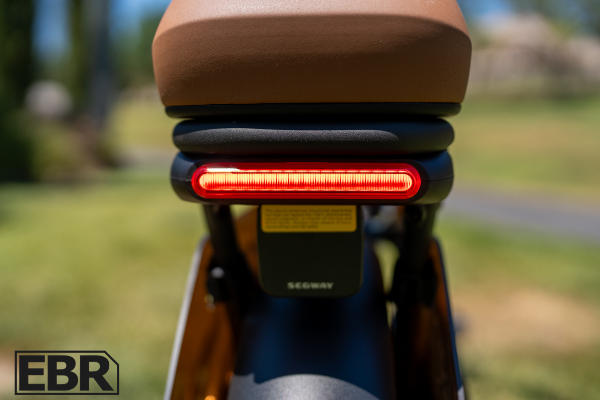

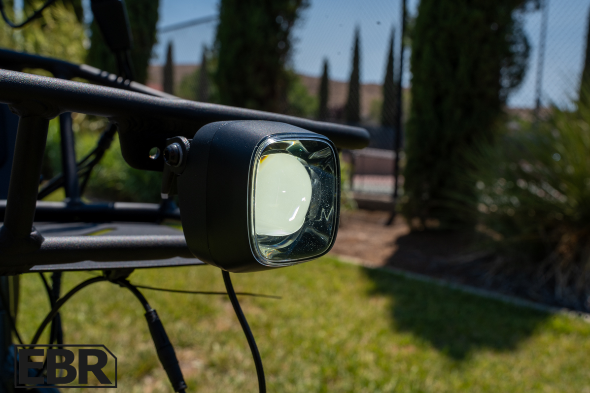

Lighting: a 600-lumen automatic headlight up front with high and low beams, which mounts to the front basket when you have one fitted, plus a taillight that activates under braking and flashes if the Rearview Radar detects a car closing in. There are no turn signals on this bike.

- Fender set ($79.99)

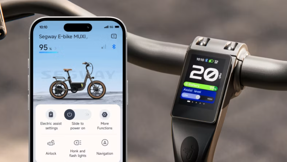

Screen / User Interface / App
Screen / App Score: 8.5 / 10
There is a lot going on with the display and app, and is another place where Segway shows that it’s a micromobility company who is now making an e-bike.
The display is a 2.4 inch color TFT that adjusts brightness on its own. I had it at 60 percent and pushed it to 100, and it gets very bright. The home screen shows the clock, Bluetooth status, light status, traction control status, and the battery in a true percentage alongside a bar. I like that Segway went with a percentage readout and that it tracked accurately through our testing. Assist levels are named rather than numbered, running from low through mild low, mid, and high, with six steps total. Arrow to the right and you get trip distance, remaining battery mileage, calorie count, and cadence. Keep going and you reach turn-by-turn navigation, which you set in the app and then follow on the screen, plus music controls for whatever is playing on your phone.
The settings menu is where you enable walk mode, switch between Class 1, 2, 3, and the hybrid setting, adjust screen brightness, pick a horn sound, set the alarm volume, and turn on quiet mode so the bike does not yell at a mechanic who moves it. On the horn sounds: there are three, and I would skip the train. It startles people on a shared path. The bell is the most natural of the three.
The Segway Mobility app goes deeper.
You can set pedal assist sensitivity to high or standard, toggle adaptive power, adjust how close you need to be for AirLock to unlock the bike, turn kinetic energy recovery on and off, and toggle traction control and hill descent control. The security section covers motion alert volume, motor lock, timeout shutdown, and lost mode, and the alarm is loud.
Battery settings show voltage, temperature, cycle count, and the charge level of that backup battery, and there is a low battery smart alert that pings your phone if a stored bike drops below 10 percent. There is also a maintenance guide in there that I would tell every owner to read. The Segway Mobility Lab holds beta features, currently vehicle location, pedal assist calibration, class switching, and hill start assist, and because the bike supports over-the-air updates, Segway can keep adding to it.
Two things to flag. GPS tracking and the network-dependent features like navigation are free for the first year and then cost $19.99 per year. I would rather they were free, but Segway is paying carriers for that data connection, so I understand it.
Riders should also know that AirLock, Apple Find My, adaptive power, music control, and quiet mode stay free with no subscription, so the bike does not lose its core functions when the year is up. And six assist levels is more than this bike needs. Four or five would cover the same ground with less clicking. I am looking forward to seeing where Segway takes this system over the next couple of years.
