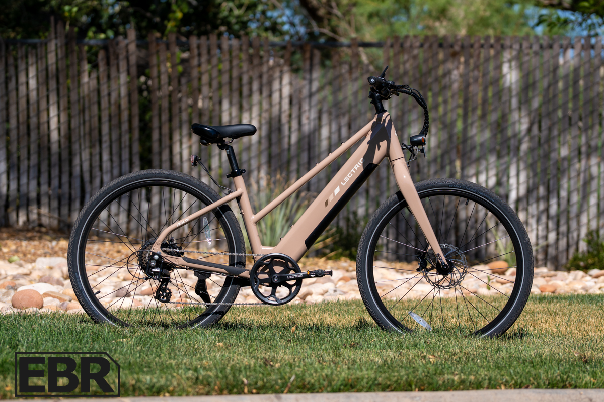

Lectric built the XPress Lite for people who want a city bike they can easily maneuver and pick up. At just over 53 lbs, it sits firmly as a light-to-mid weight e-bike and is a nice addition to the current Lectric lineup.
The bike isn’t flashy out of the box. Components are fairly straight forward and nothing on the spec sheet stands out as crazy (examples of ‘crazy’ would be Monarc offering 2 batteries for the price of one with their Tracer and Marker).
What did stand out was how well Lectric did with the motor and overall feel of this bike. The quality is not what I was expecting given the bikes $1,099 price tag.

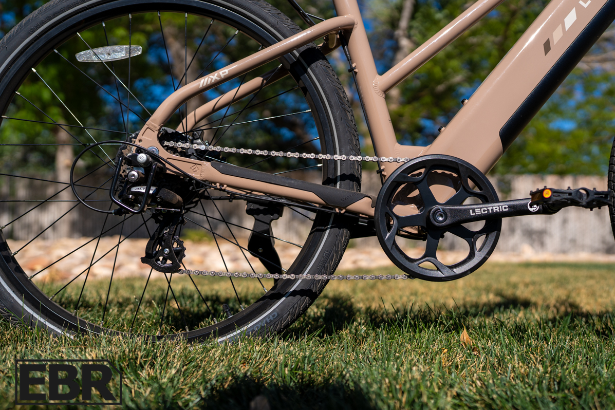

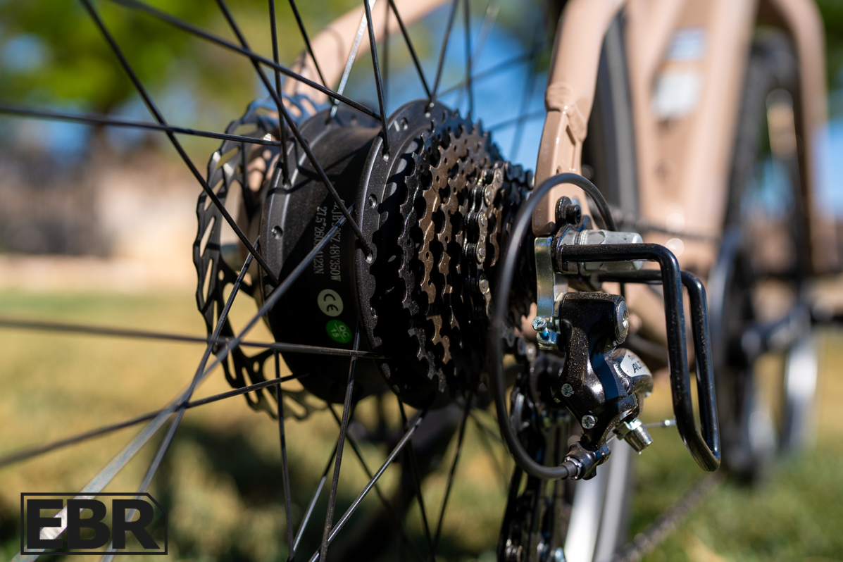

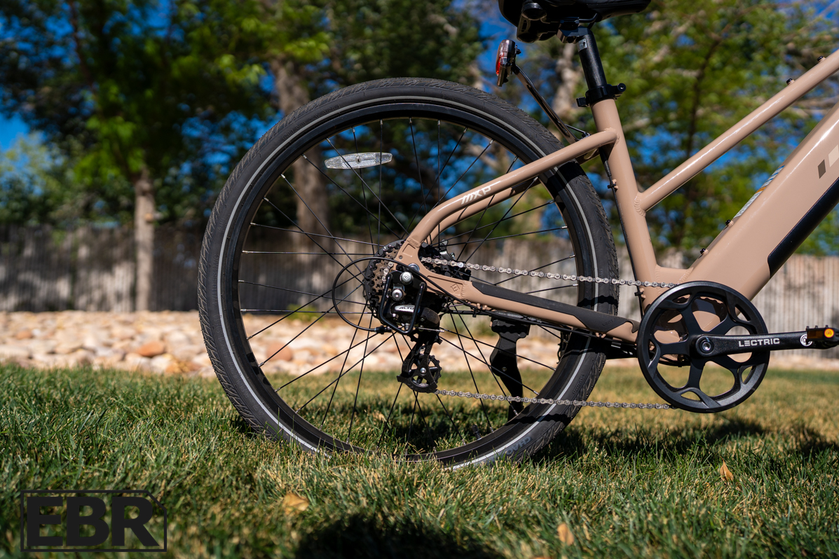

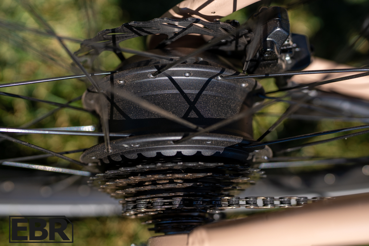

- Drivetrain. Shimano Altus 8-speed with a trigger shifter mounted under the bar, paired to a 46-tooth chainring and an 11-32T freewheel. Most bikes in this range use a 12 or 13 tooth for the smallest cog in the rear, which can lead to ghost pedaling. Thanks to the large front chainring and that 11T in the rear, there is no ghost pedaling in Class 3 speeds.

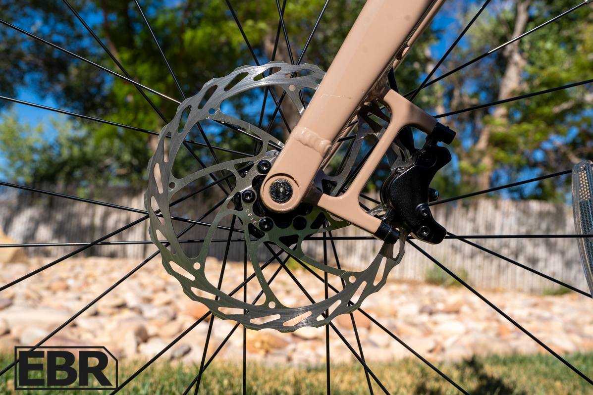

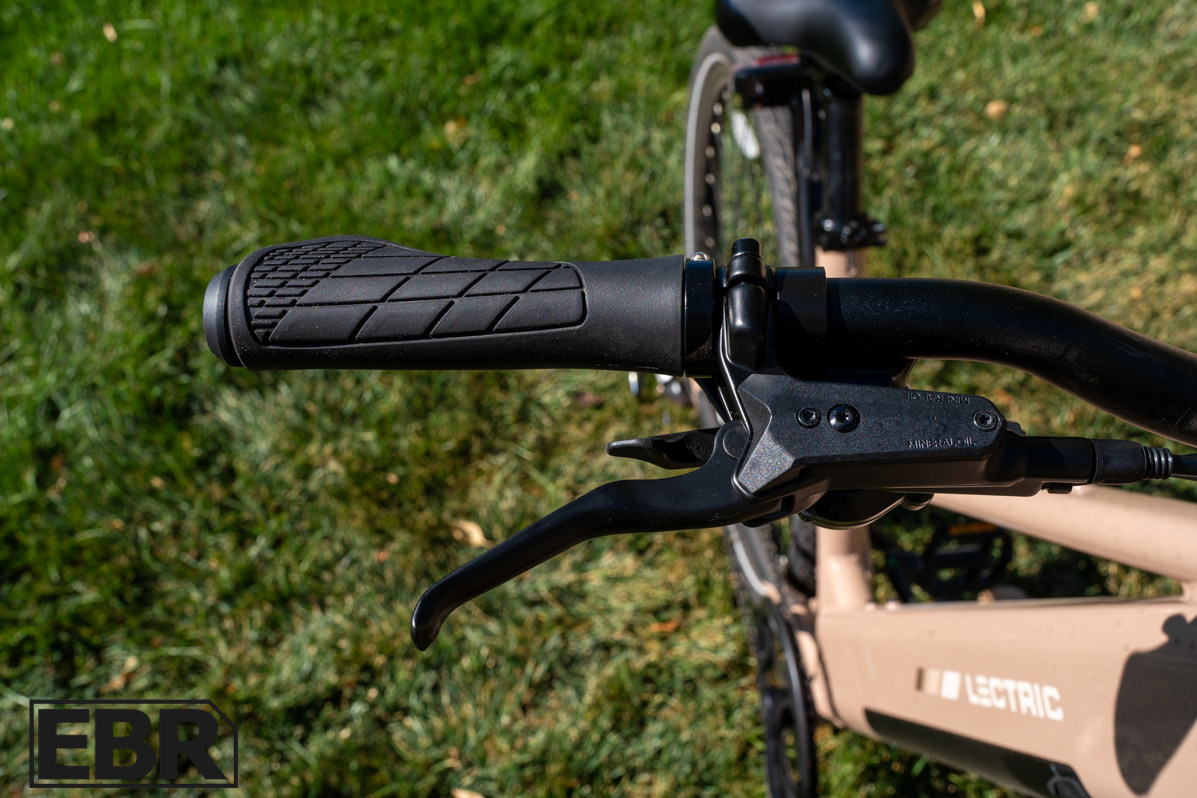

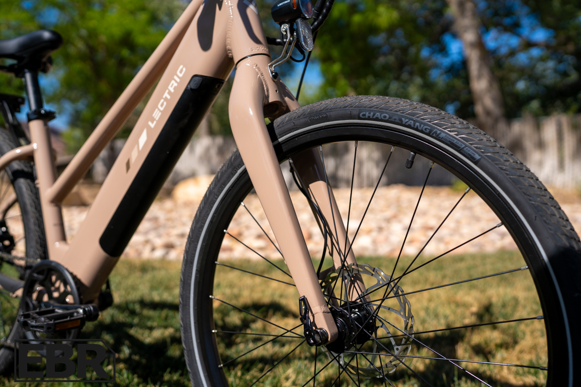

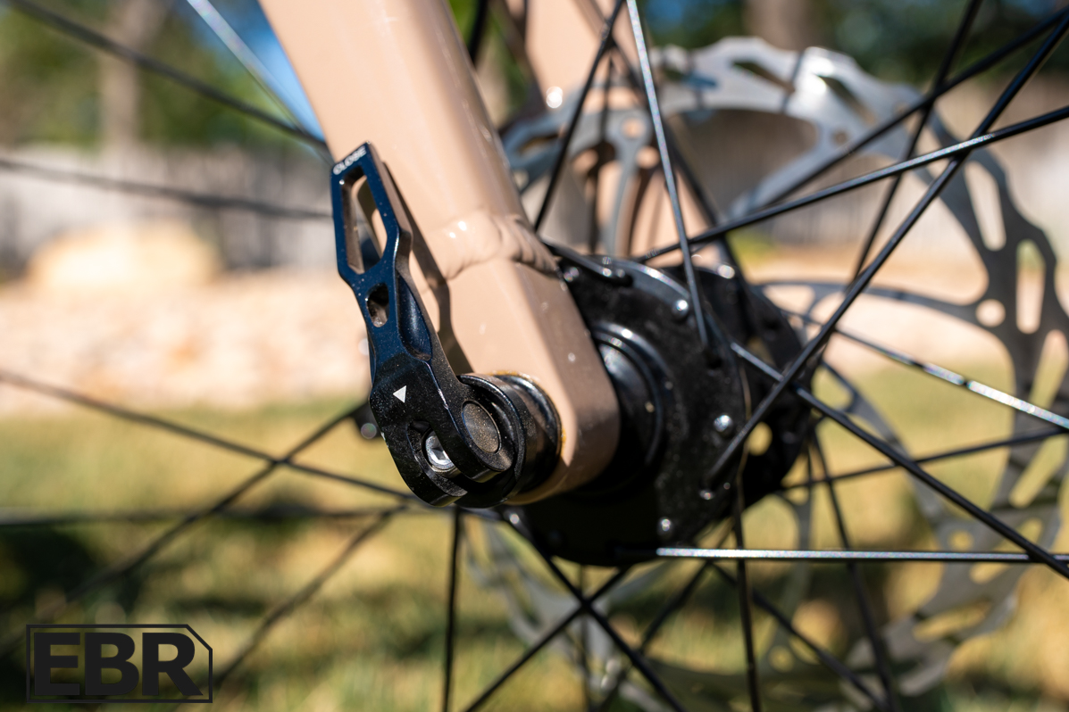

- Brakes. Hydraulic discs running mineral oil, with 180mm rotors front and rear at 1.8mm thick. This is the first Lectric in a while that does not have Star Union brakes, and I was a little surprised by that. I’m going to guess that it was a cost decision, as their 602 Star Unions have performed better than these. But, for this price, they are average to a little better than average and I have no complaints.

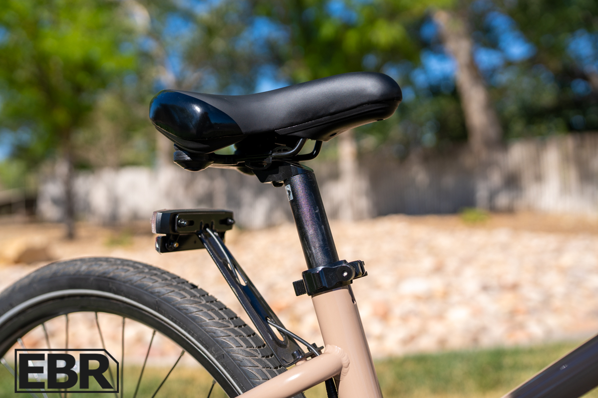

- Suspension. There is none. Rigid aluminum fork, no suspension seat post. Lectric sells a suspension seat post as an add-on if you want to take the edge off.

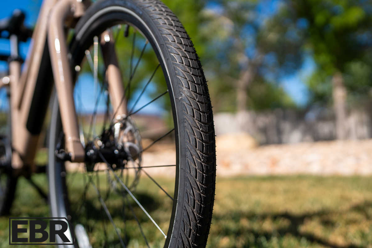

- Tires. Chaoyang 27.5 x 1.95 inch slicks with light grooving for wet and sandy traction. They roll well and they are not meant to go off road. And I LOVE how Lectric adds slime to the tires at the factory so you don’t have to worry nearly as much about flats.

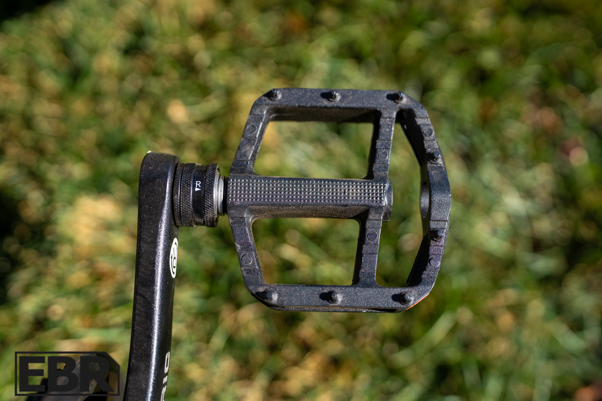

- Cockpit. Lock-on ergonomic butterfly grips, which give your palm something to rest on, 27 inch bars, and a fixed 40mm stem. The quick release pedals are the same ones Lectric uses across the lineup.

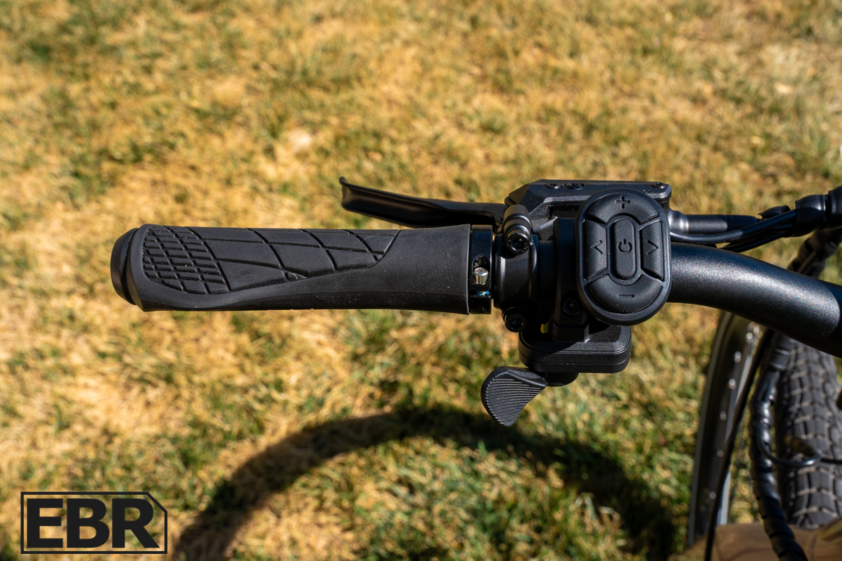

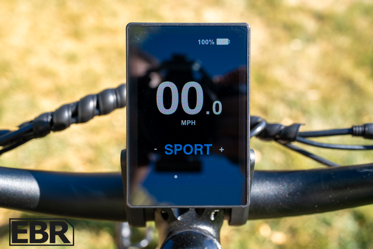

The XPress Lite has a 3.5 inch color display with a separate control pod on the left grip. The first screen gives you speed, assist level, and a battery readout in true percentages instead of bars or 10% steps.
Press the power button and you move to a second screen with cadence, trip time, distance, and odometer. The third screen is the one I ride on. It shows my input power next to the motor’s output power, along with amps and volts, which I always love to see.
Hold plus and minus together and you are into the settings menu. Brightness, sleep timer, units, tire size, odometer reset, and walk mode are all in there. The ones that matter more: you can set the bike as Class 1, Class 2, or Class 3, and there is a California Class 3 option that accounts for California’s rules.
You can switch the pedal sensor between torque and cadence, which is what Lectric calls the “XPerience Switch” – but even in torque mode you are getting plenty of power so I don’t see much need for swapping to cadence.
You can also pick a standard or increased torque multiplier, and also limit throttle output by assist level so you can better control your speeds while throttling, or you can run full throttle at every level.
There is no app. No phone customization, no GPS tracking, no over-the-air updates.

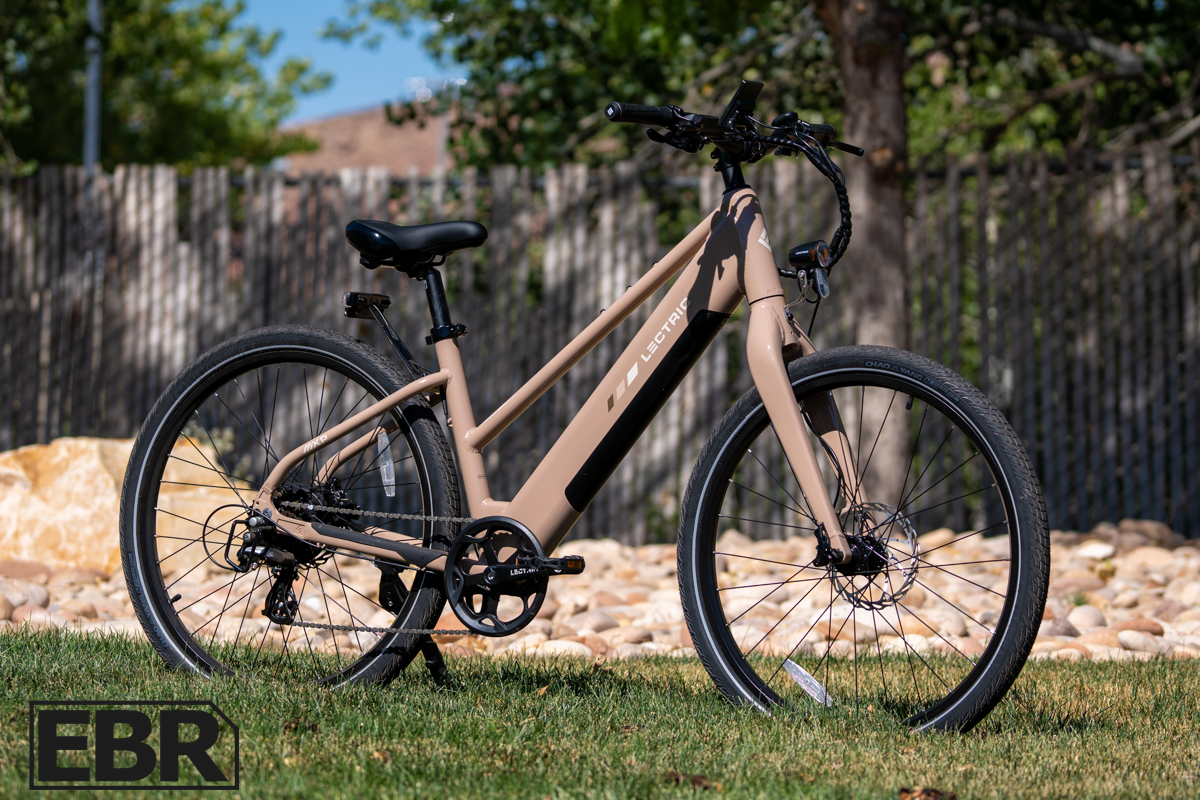

The XPress Lite comes in only one frame size, one frame style, one motor, and one battery option. The frame is a mid-step, which sits between a high-step and a step-through, and Lectric picked it so a single frame covers the widest range of riders.
Lectric lists a fit range of 5’4″ to 6’4″. Based on how far that seat post drops, I think a rider at 5’1″ could make it work, though their hands will sit high because the stem does not adjust. And once a rider starts to get taller than 6’1″ they will lose leg extension and the cockpit will start to fill a little small.
