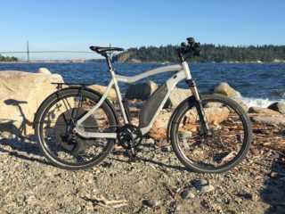

OHM is a Premiere BionX partner from Vancouver Canada that has been in the ebike business since 2005, using BionX electric drive systems exclusively during that time. I have reviewed eight of their prior year models here on EBR and always come away feeling impressed. In a world where fancy mid-drive systems are generating attention for mountain biking and turning heads with high-torque power output, the BionX system remains unique because it has a throttle, offers regenerative braking, does not interfere with shifting, and operates almost silently. Yes, it’s less efficient overall and weaker in terms of peak torque output because you cannot leverage a drivetrain… but it’s simpler to use and more enjoyable to ride for many people. The Urban electric bike model from OHM, featured here, was the first bike I had tested that utilizes the new semi-integrated downtube battery and transflective color display from BionX. The motor, battery, and display are excellent on their own but what really set the end product apart for me was how OHM overbuilt the frame, including top-end parts and accessories, but still managed to keep weight down. Despite having an 8.8 lb hub motor spoked into the rear wheel, this bike is well balanced from front to rear. It’s quiet, despite having large alloy fenders and a rear rack, powerful but efficient with smooth torque sensing operation, and thoughtfully laid out with lower top tube and side mounting battery design. And, because it’s available in four frame sizes, the lower top tube and smallest size is more approachable to petite riders and those with shorter inseams or injured hips. It’s also safe, thanks to premium Supernova integrated ebike lights and reflective tires. The two other 2017 OHM e-bike models I saw during this visit emphasize light trail and mountain riding and it seems like OHM just kept things simple by recycling frames, forks, sealed bottom brackets, custom crank arms, and drivetrains etc. vs. speccing them down for the city model. What that means is, the company saves money on volume orders, can have an easier time servicing any of the bikes in the lineup because they have so much in common, and you get a city ebike here that’s much more capable than a lot of competitors. I also noticed that the different sized bikes have different length stems, handlebars, crank arms, and grips! They get longer for the larger models to dial in comfort and control. The product does cost more, but not as much as I expected initially… At $3,599 USD, it’s only $1k more than the BionX D-Series stand-alone kit but looks a whole lot nicer. Cables are internally routed, the right brake lever has an integrated motor inhibitor vs. aftermarket glue-on solution, and you can add a USB charging port to maintain or fill your portable electronics on the go. There’s always a lot to talk about with the high-end electric bikes and I especially enjoy highlighting the comfort aspects such as Ergon grips and gel saddle here, the 100 mm air suspension fork which includes a compression clicker with lockout and rebound adjust, and slightly wider 2″ tires that provide stability and vibration dampening. OHM goes through several production prototypes each year before settling on a final version and it’s clear when you take a ride and actually spend some time up close that this is the real deal. The addition of bottle cage bosses, custom rear rack support bosses, iconic overbuilt head tube, and Magnesium pedals are not common.

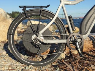

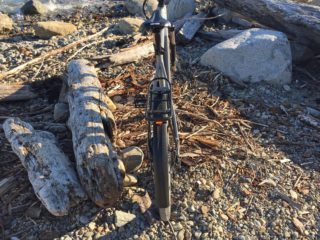

Driving the bike is a 500 watt nominally rated, gearless direct-drive hub motor. With peak torque output at 50 Newton meters and peak wattage around 750, it’s one of the strongest legal hub motors to be found. And it certainly looks unique… the design has grown on me over the past year but it’s hard to deny that it does stand out. The large diameter provides a mechanical advantage for the magnets and electromagnetic staters inside which increases torque while simultaneously improving cooling due to increased air volume. The casing itself is a sort of composite plastic that is lightweight, durable, and unobtrusive in black. It shouldn’t get scratched or nicked up and show damage as much as a painted alloy hub. Yes, it could catch some wind from the side, but that shouldn’t impact steering because it’s the rear wheel and there is still a lot of space between open spokes above and below. The spokes actually connect from rim to hub vs. rim to hub motor… meaning that they are normal full-length sized. This increased spoke length provides some comfort in the form of flex while riding. And while shorter spokes can be stronger, they translate energy into the frame and rims which can cause bending and cracking on rims. That’s not such an issue here but even so, OHM opted for double wall alloy rims with reinforcement eyelets just to be safe… and possibly because this is what their mountain models use. They painted the spokes black to match the hub motor casing, and they chose a capable drivetrain from Shimano to reduce maintenance intervals, speed up shifting, and improve chain tension. You get a 10-speed 11 to 36 tooth cassette here with Shimano Deore XT derailleur that has Shadow Plus (a one way clutch to tighten the chain). I found shifting to be easy, fast, and quiet. I was pedaling naturally, feeling empowered vs. carried or pushed like some cadence sensing e-bikes, and never surprised or annoyed by delays from sensor to motor output. It felt very smooth but definitely more powerful than average. Another minor note here is that the trigger shifters for changing gears and arrow buttons for raising and lowering assist were easy to reach and not too crowded near the right grip. I think this has a lot to do with the small form factor of the BionX button pad. It doesn’t take up much space so your brake lever and shifter mounts can all be close together, right where you need them.
Powering the bike, backlit display, two lights, and optional USB power port, is a high capacity Lithium-ion battery. It offers efficient 48 volt energy transfer with 11.6 amp hours for a total of 556.8 watt hours. That’s over half a kilowatt hour, definitely above average, but it spends quickly if you opt for the Class 3 speed pedelec setup or use the throttle constantly. I estimated range between 25 and 70 miles but that greatly depends on how you ride. Higher speed riding takes a big toll on efficiency because of air resistance and throttle mode, while fun, is a battery hog because the D-Series motor accelerates so quickly. The trigger throttle is ramped so you can press gently for less power, but the movement is relatively small (to keep it compact) so precise throttling takes some practice. Unlike many competing throttles, this one is easy to reach and not so fatiguing to use constantly. It is perhaps one of my favorite throttle designs because it’s a trigger vs. twist and that means you can really grip and handle the bike well. And you can use the throttle at full power to override assist! No need for clicking up and down through different menus to get the throttle going the way you do on some bikes like Easy Motion’s Evo line. The throttle is always active as long as the bike is moving ~1.5 mph. Yes, throttle from standstill would be nice, but this one activates super fast… again, I was bummed out by the 6 mph cutoff on one of Evelo’s 2017 models using the Bafang Max drive. Sometimes ebike manufactures are limited by what their motor supplier offers but kudos to BionX for their good work here. It’s part of why they were invited to be an advertiser here. They offer something unique, put a lot of thought into the design, and support it well. Anyway, the battery can be charged on or off the bike frame and uses a quick 3.45 Amp charger vs. the standard 2 Amp so you can fill the battery quickly and get back out onto the road! The removability of the display, battery, quick release front wheel, and seat post, make the bike easy to transport, protect, and store. I usually bring my battery into the office to fill up during the day before my ride home. Note that the battery does not have an obvious handle and would definitely get scratched and even damaged if dropped… at 7.4 lbs, it’s not the lightest thing… so be careful or use a bag to carry it.

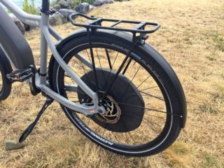

- Premium rack and 60 mm Aluminum alloy fenders offer a ton of utility, the stock photo shows plastic fenders with mud flaps but the production bike is upgraded and the metal fenders are solid and very quiet

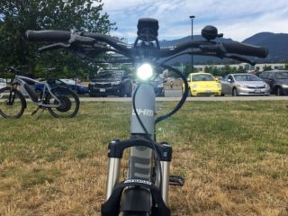

- Only the highest-end electric bikes seem to offer integrated lights from Supernova and they tend to last longer because of metal housings and sturdy mounts, I love how the headlight is positioned below the handlebar to make room for the LCD display

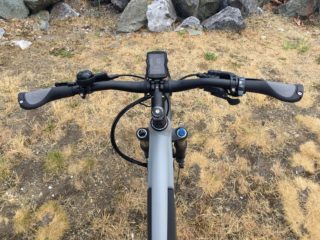

- There are so many ways to control this e-bike including the mini control ring near the right grip, the compact color LCD panel, or the smart phone app, being able to remove the display for parking (to reduce wear and tampering) is fantastic

- Comfortable touch points including locking ergonomic grips, finger-adjustable brake levers, a sporty Ergon gel saddle, and wider Schwalbe tires with a medium-range pressure recommendation

- The unique design of the hub motor casing, being relatively slim but tall, allows for the spokes to connect at the hub vs. the outside of the hub motor and this allows them to flex naturally providing a level of comfort and performance that most other hub motor ebikes lack

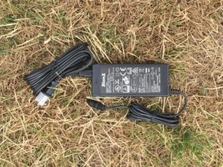

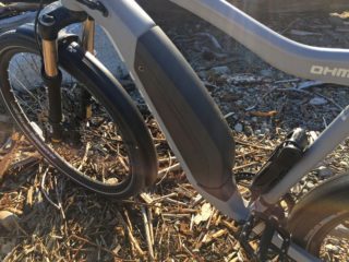

- The battery pack clicks in from the left side vs. down from the top which means it won’t bump into the frame as easily and the top tube can be lower, I like that the battery is rated against dust and water, uses a fast charger, can be filled on or off the bike, and even has a touch-activated capacity indicator (where the charger plugs in) it lights up green at 70%+, orange between 20% and 70%, and red when below 20%
- After a few minutes of inactivity, the display panel automatically powers off… it has lots of settings where you can change brightness, units, etc. to make it fit your preferences and style

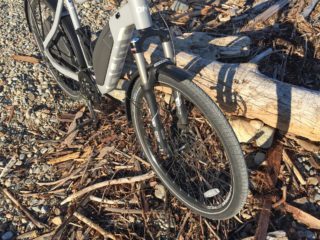

- Larger 180 mm hydraulic brakes provide the kind of stopping power that mountain bikers need, so it’s cool to have them on more of an urban bike, specifically because it weighs more and can be switched to 28 mph Class 3 if you want (I think you need OHM to do this and change the Class sticker before it’s shipped to you)

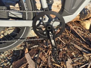

- Shimano Deore XT is a mid to high-level drivetrain and ten speeds is enough to let you climb and reach higher speeds comfortably… though the larger 48 tooth chainring is setup more for speed, there were more times where I was riding in the absolute lowest gear because of the hilly terrain in Vancouver, I like that the derailleur has a one way clutch to reduce chain bounce (the little grey lever, point it up to tighten the chain)
- The chainring has an alloy guard to keep your pants or skirt clear along with a plastic inner guide to reduce drops, basically they combine to create reliability when on bumpy terrain

- The large black hub motor casing definitely stands out visually, the design provides great torque for acceleration and climbing but may also catch a bit of side wind and attract attention compared to smaller gearless hubs

- The display panel takes longer to boot up than Bosch and some of the other high-end products, not much longer, but enough to be a little annoying every time you turn the bike on and are eager to go right away!

- It’s no fun to change inner tubes if you get a flat so the upgraded Performance Line GreenGuard Plus tires are a welcome part, I love that the front axle uses quick release to make it easier to service, but have to acknowledge that most hub motor setups can be a pain to work with on the rear wheel because of the additional motor wire and bolts or nuts, the BionX motor has a quick disconnect point and mounts fairly easily with the correct 6M hex wrench, but it still takes more time and tools than a mid-drive
- Some of the other high-end ebike displays offer a range estimation stat which can help you plan trips, that isn’t available with the BionX setup used here but at least it does show a high precision 10-bar battery infographic and battery percentage! Their battery packs are also smart and go into a deep-sleep mode when not used for long periods
