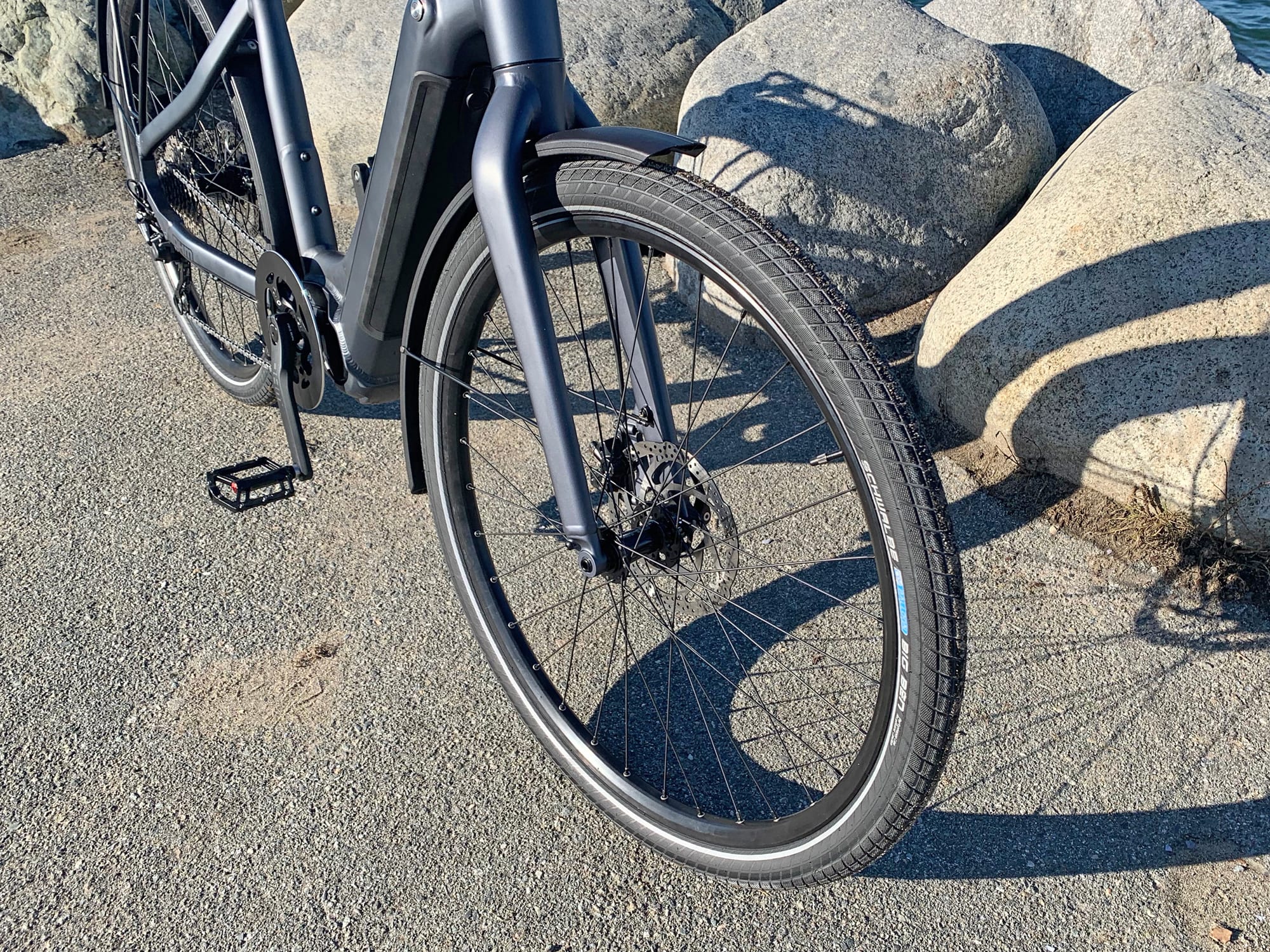

Rigid Bladed Hydroformed Aluminum Alloy, 100 mm Hub Spacing, 15 mm Thru-Axle with Quick Release
Alexrims FR30, Aluminum Alloy, Double Wall, 32 Hole, 25 mm Width, Aluminum Eyelets | Spokes: Sha-Dar, Stainless Steel, 14 Gauge, Black with Brass Nipples
Schwalbe Big Ben, 27.5" x 2.0" (50-584), 35 to 70 PSI, 2.5 to 5.0 BAR, K-Guard 3, Reflective Sidewall Stripe

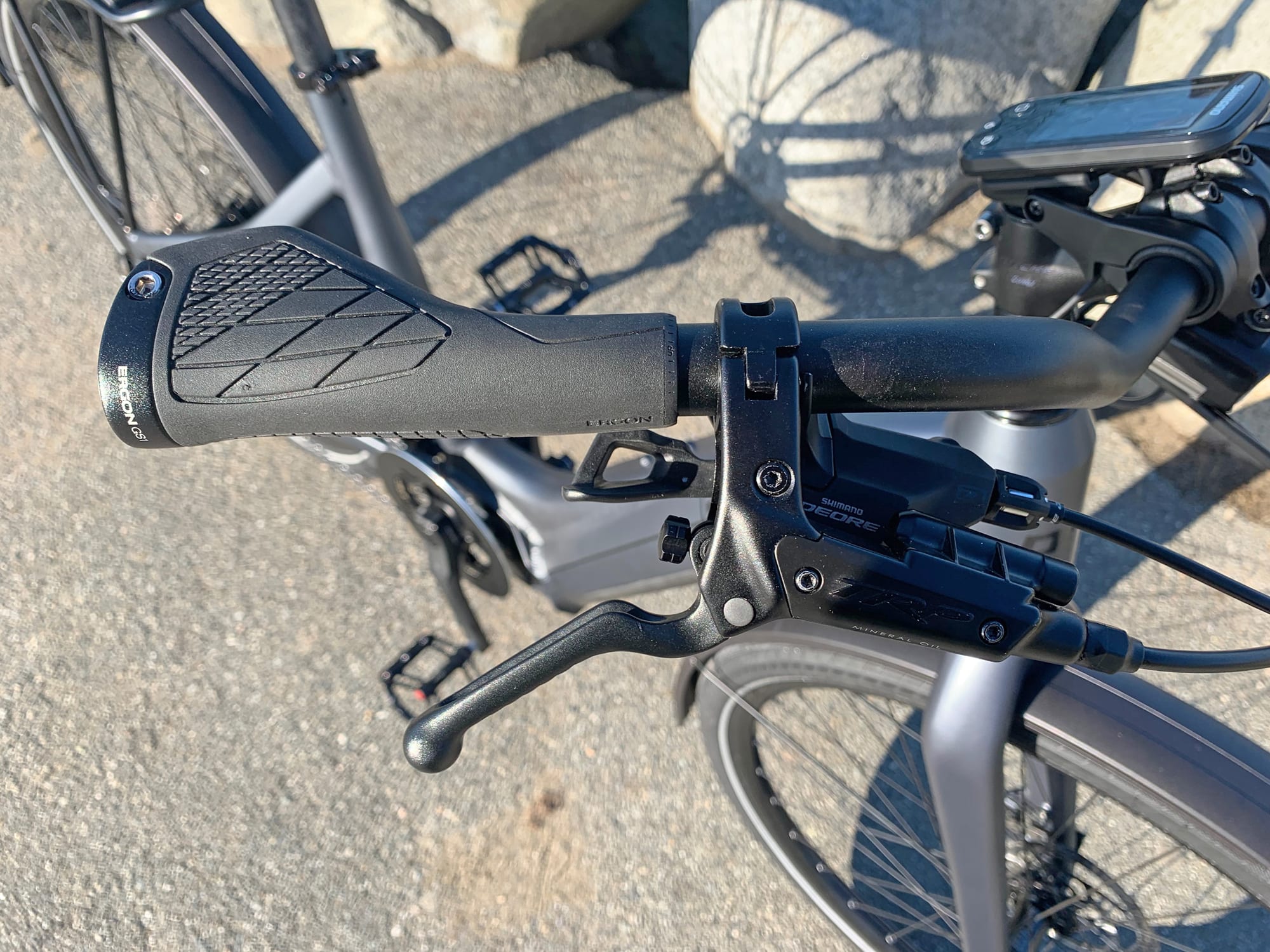

MJ, Aluminum Alloy, Mid-Rise, 660 mm Length, 40 mm Rise, 35° Backsweep
Ergon GC10, Ergonomic Rubber, Single-Density, Locking

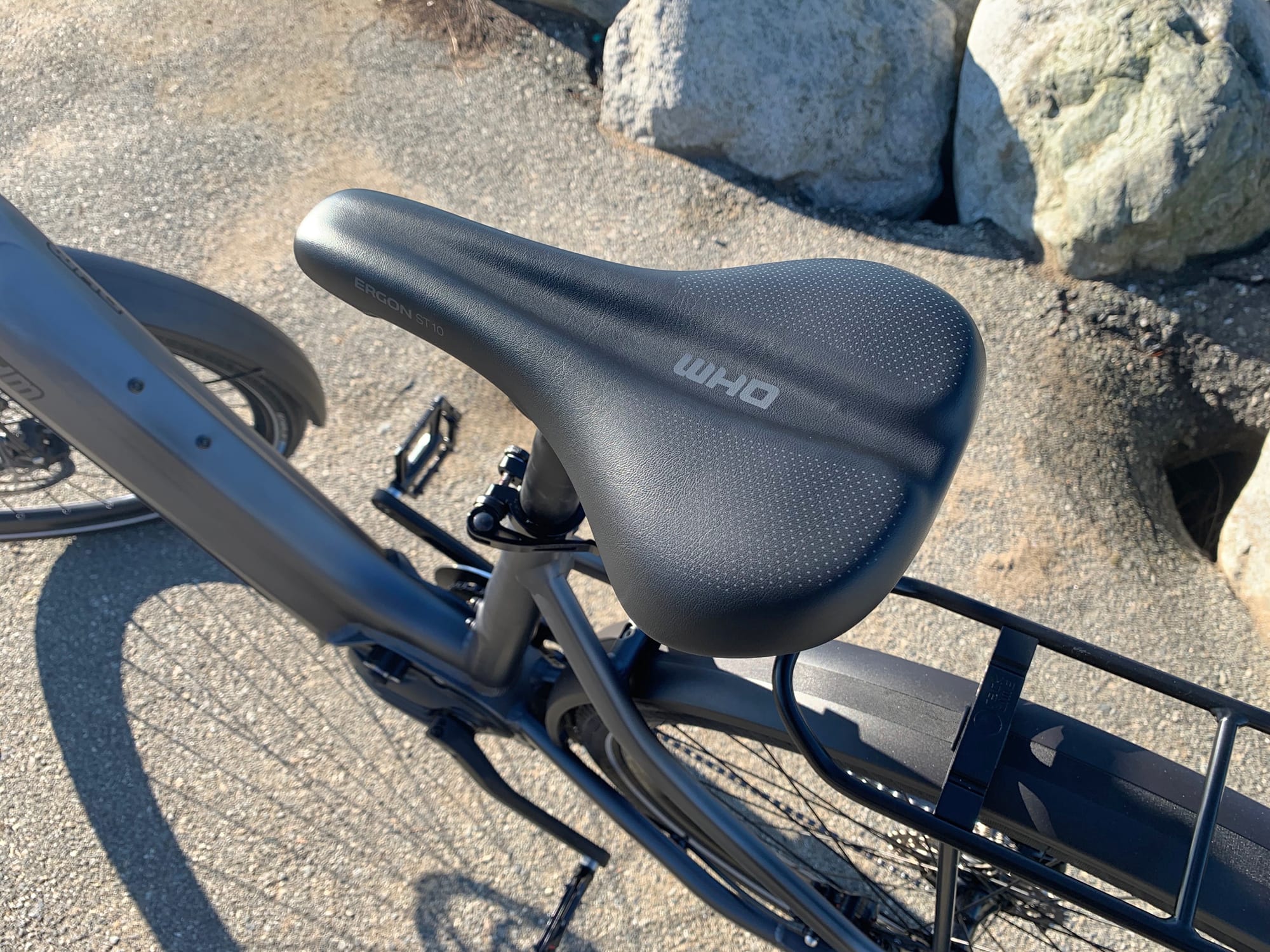

30.9
OHM Branded Ergon ST10 Gel, Chromoly Rails

TRP Zurich Hydraulic Disc with 180 mm Rotors, Quad Piston Calipers, TRP Three-Finger Levers with Tool-Free Adjust Reach

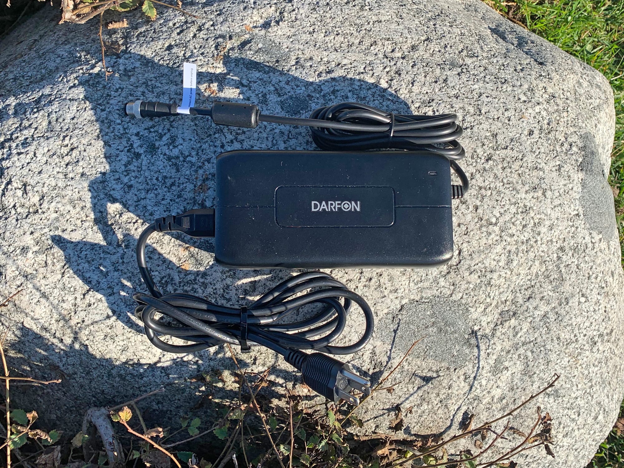

Locking Removable Downtube-Integrated Battery Pack, 2.1lb 4 Amp DARFON Charger, KMC X10 EPT MTB Chain, ABUS Locking Core and Key, 168mm Q-Factor

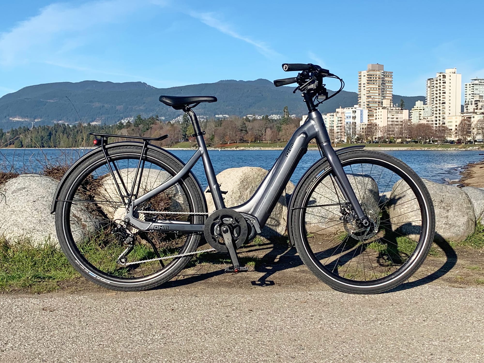

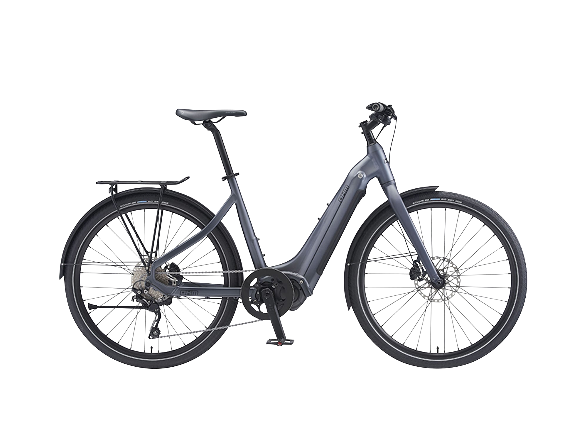

  • The OHM Cruise takes the same drive system, battery, fenders, rack, as the Quest and Urban, but gives you an approachable step-thru frame, I was impressed by the strength of the frame, that it didn’t suffer from frame flex while standing up and pedaling hard, and just how well the rack was position in relation to the saddle. OHM has been making ebikes since 2005 and this is their fourth generation frame build, they really pay attention to quality

  • Beautiful approachable step-thru frame, but it’s also sturdy and rigid thanks to the larger downtube sizing and extended gusset that connects to the seat tube, this is a purpose built electric bike that is well balanced and solid… notice the smooth welds and internally routed cables, even the grommets they use to cover the cable entry points are aluminum alloy vs. plastic!
  • OHM now includes the faster four-amp charger with all of their 2019/2020 models, which means you can spend more time riding! They used to charge additional money for this charger, so it’s a great value to see it included

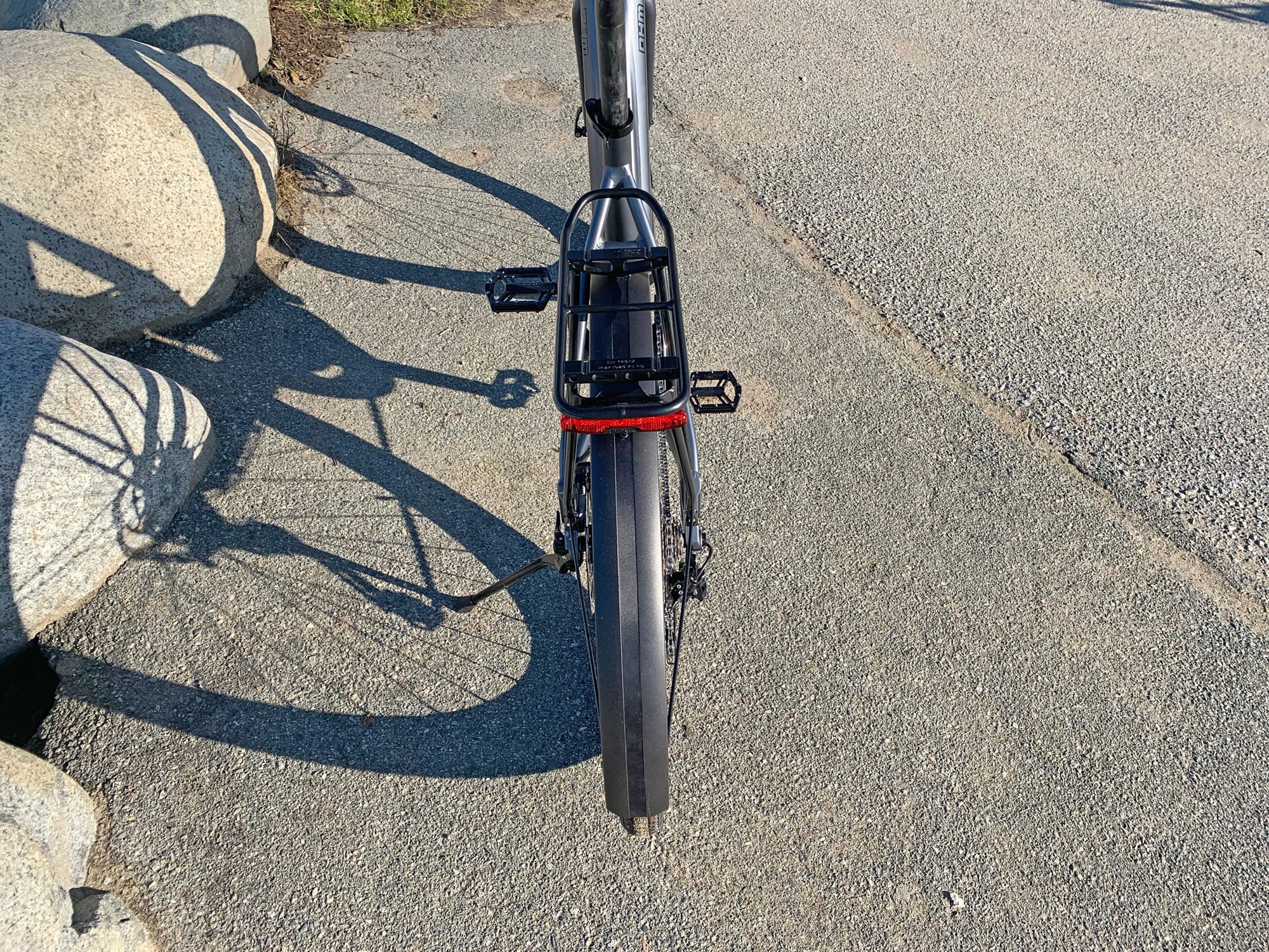

  • I really appreciate how OHM designed the rear light to be protected by the rack tubing… and that they chose a light with two LEDs to keep you extra visible from the back and sides

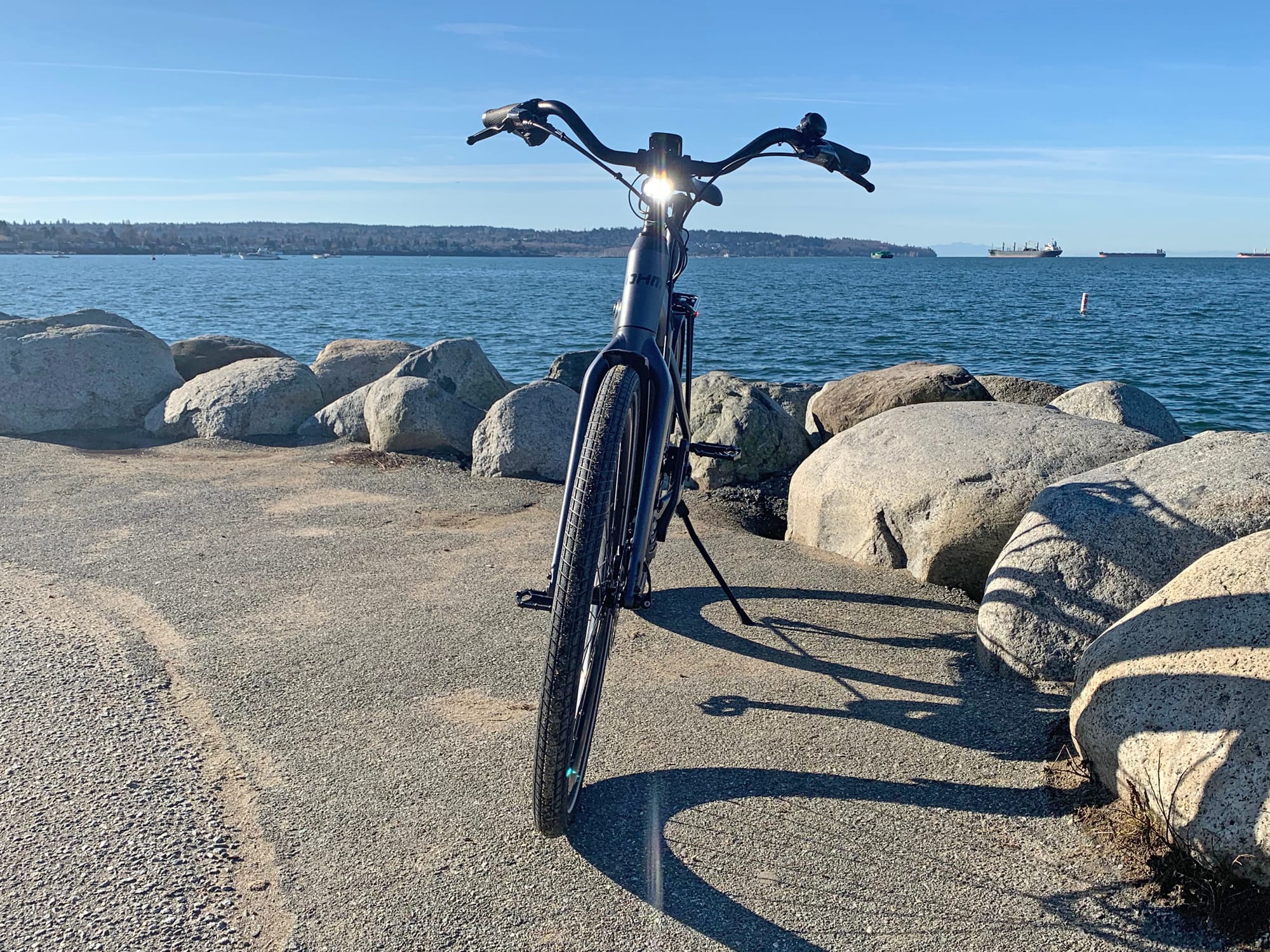

  • So many times, companies will mount headlights on the fork, but OHM stuck it up high on the handlebar/stem so you’re more visible, it still points where you steer and the casing just felt solid and high quality

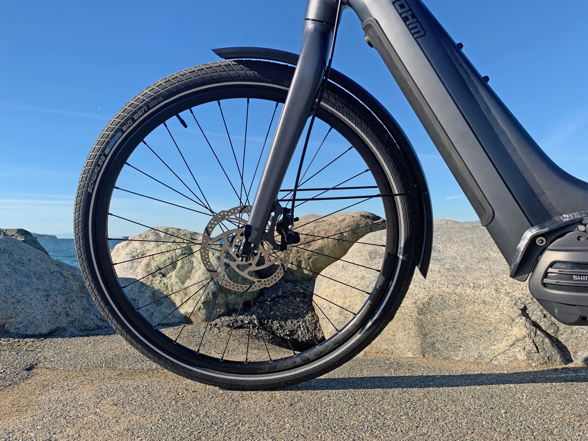

  • For tires, you get a set of Schwalbe Big Ben high volume comfort tires, these are 27.5” tall by 2” wide which adds stability and makes up for the rigid fork a bit, wider tires perform well on gravel and offer improved stability overall. The PSI range is 35 to 70 so you can dial them in for your body weight and intended use… higher PSI is more efficient for good range but less comfortable
  • The tires are great, but so are the rims. OHM went with ALEXRIMS that have reinforcement eyelets designed to add strength and durability, it’s one of many small upgrades that set the Cruise apart from other similar city/commuter electric bicycles… and notice how the rims, spokes, and hubs are all matching in black
  • Another great bonus to the tires here is that they have both puncture protection and reflective sidewalls, as a big fan of safety and convince, having both means visibility for riding at dusk or dawn as well as peace of mind against potential threats to your tires
  • This bike has a 30.9mm seat post, so if you were looking to add more comfort to the ride setup, you could get an aftermarket suspension seat post like a Kinekt or SR SunTour NCX seat post to give the ride more cushion for longer more sustained rides, I am told that this is one of the most popular upgrades that OHM sells on their site

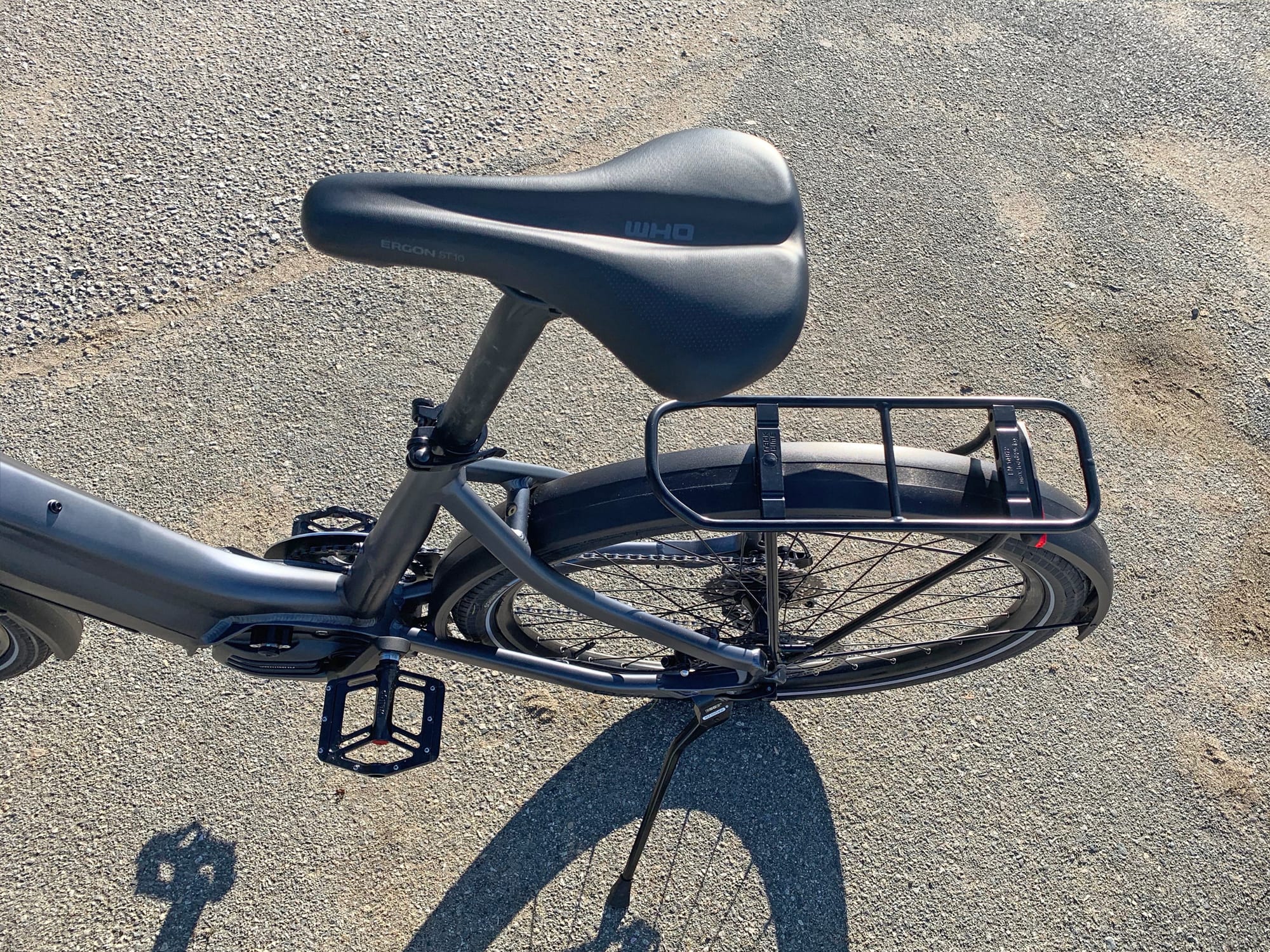

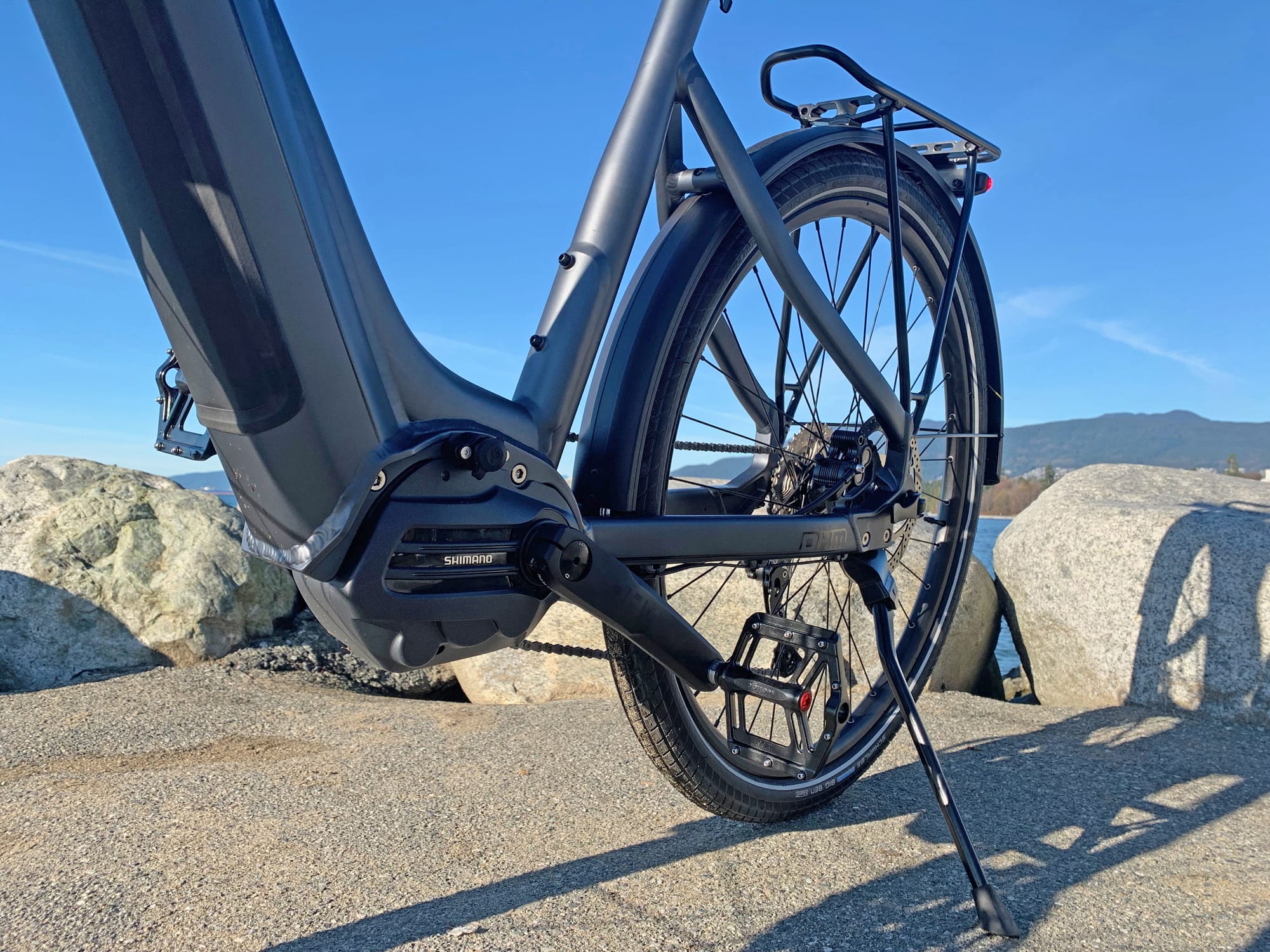

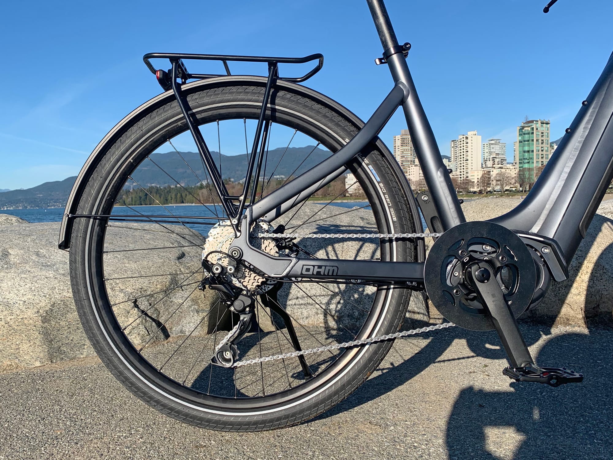

  • Great mounting choice for the kickstand, it’s out of the way at the rear of the bike but provides plenty of stability for a loaded rack, if you add a trunk bag or panniers
  • I love the included rear rack, this is rated for 25kg (which equates roughly to 55lbs) as a max weight limit and has great standard gage tubing to fit all sorts of styles of panniers, really one of the must-haves for a feature complete commuter bike… and Michael mentioned that the base interface increases the lateral stability of the rack by 20% compared with standard rear racks! Color me impressed :)

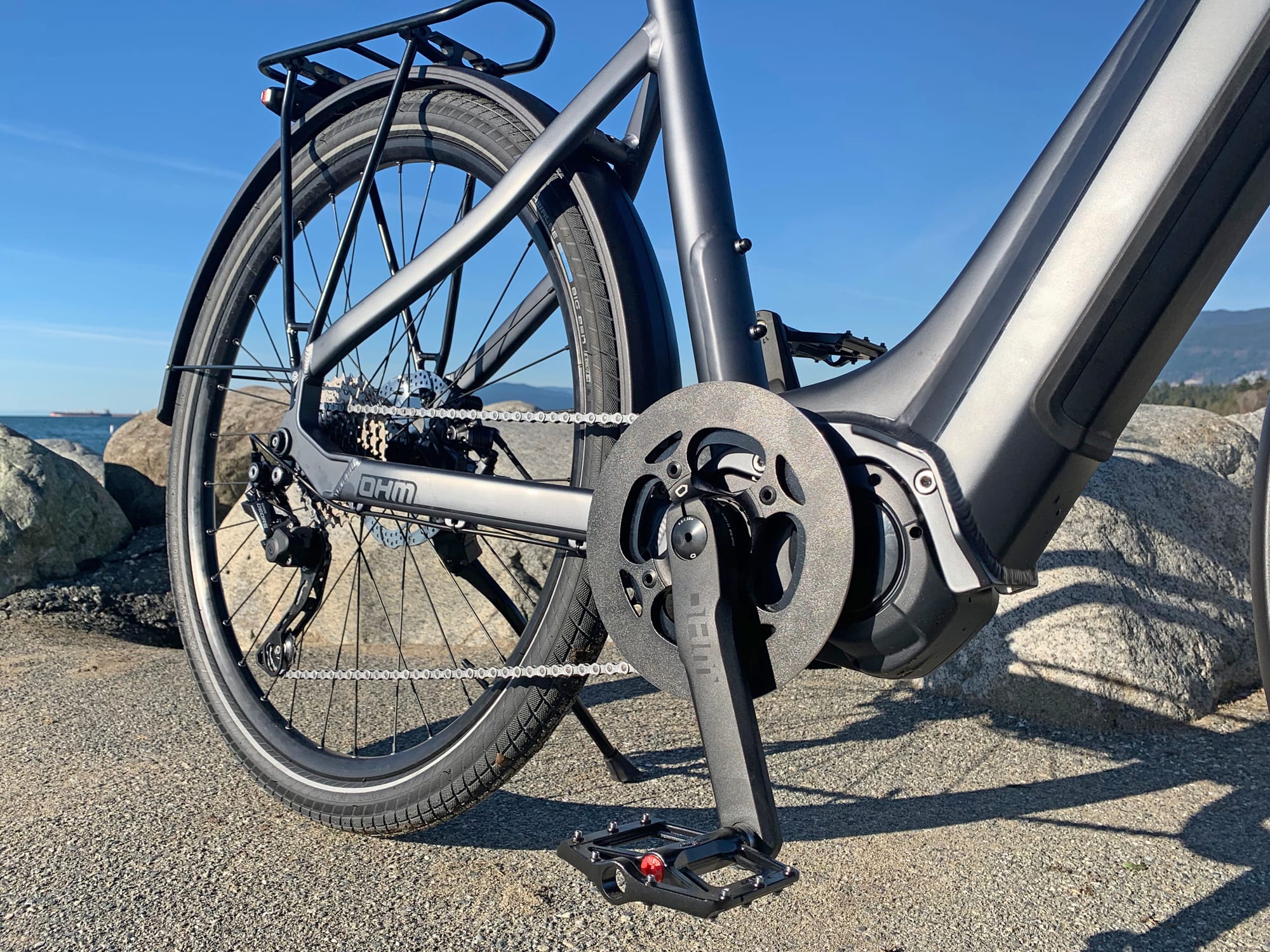

  • Powered by the Shimano E6100 mid drive motor, this is 20% more efficient than the older E6000 and has 130rpm pedal support (so you can downshift and “spin” in lower gears to climb steep hills), the motor uses a standard Q factor, offers 250-400 watts of power, and a varying rate of 50nm-60nm of torque. In my opinion, this is a neat motor that is pretty quiet and very stable

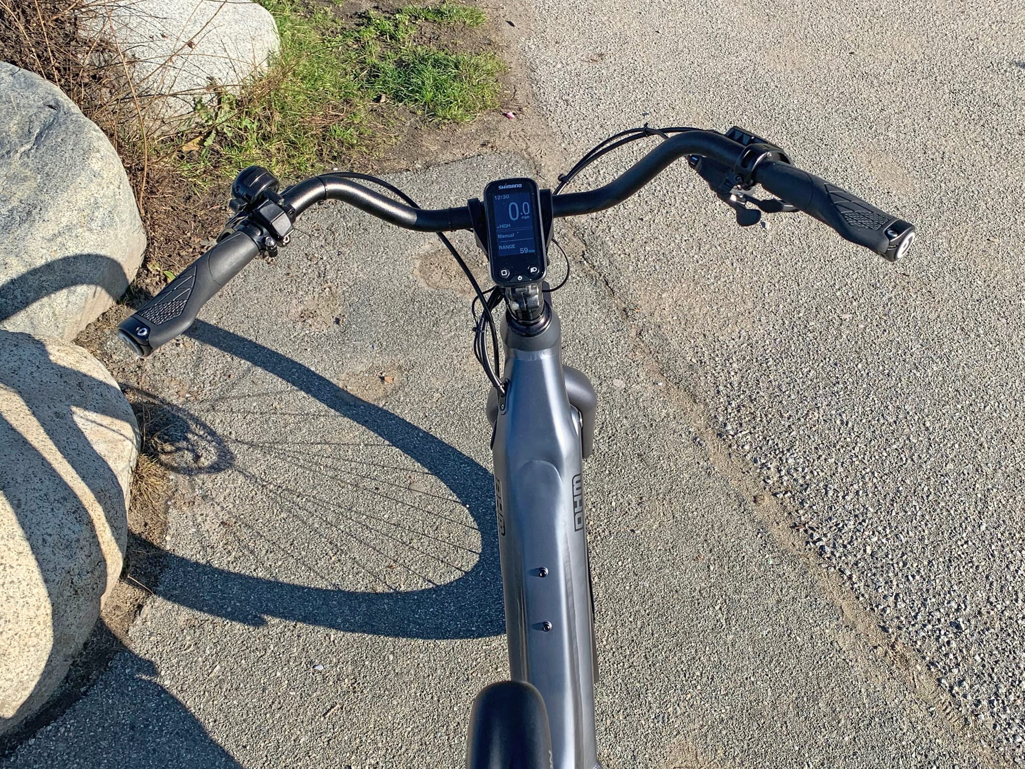

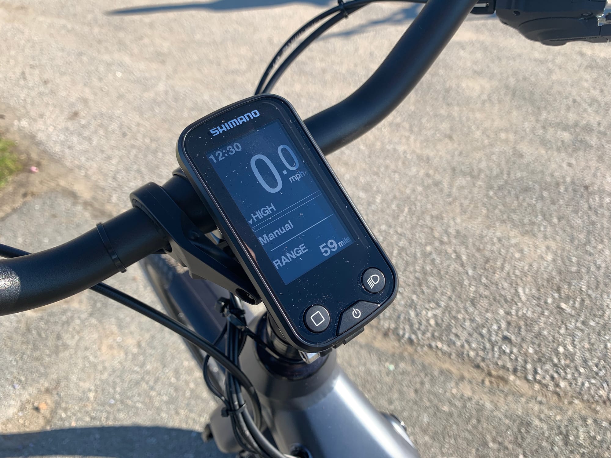

  • The new display that OHM has chosen for the Cruise is removable, fairly large and easy to read, uses transflective LCD technology that looks good in the sun or overcast/dark conditions because it’s backlit… you get a dynamic range estimate too. It has all of the important menus and a dedicated light button, which is perfect for this ebike since it has a headlight and rear light

  • A big win here are the 180mm rotor hydraulic disc brakes! The larger rotor cools faster and provides a great mechanical advantage for heavier loads or larger riders (especially relevant given the four frame sizes) and the brake levers are much easier to actuate and more consistent than mechanical brakes, the brake levers are even adjustable for different hand sizes (and can be adjusted tool free), and the quad piston calipers provide more stopping surface for the brake pad and better cooling, this is mountain bike level componentry
  • Very impressive 16″ stand over height! This is one of the most approachable ebike frames on the market right now, and that’s great for people with hip and knee issues, or if you’re wearing a dress or skirt

  • Narrow-wide tooth pattern on the chainring reduces the potential for drops, if you’re riding over bumpy terrain, and I like the aluminum alloy chainring guard that will help protect pants and dress ends from touching the dirty chain
  • Even the crank arms and pedals are upgraded here! The bottom bracket uses a stiff hollow spindle design from Shimano and the lightweight magnesium Wellgo pedals have independent metal pins stuck in, more like you’d find on a nice trail bike… they’re great for wet weather so you don’t slip off as easily
  • So many times, city bikes will only come with 11-32 or 34 tooth cassette, but OHM offers an even wider range with 11-36, which makes starting and climbing easier. The Shimano Deore derailleur is reliable and includes a clutch system for tighter shifting vs. easier rear wheel maintenance depending on whether you click the little grey lever into the up or down position respectively
  • Great choice on the Shimano Deore trigger shifters, the high lever offers two-way interaction and the low lever offers multiple steps, this is performance hardware that makes the bike snappier and fun to ride

  • I like that the display has a menu system with lots of options (just hold the square button to get into settings) and that one of those options is to turn off the electronic beeping noise! Also, the bike comes with a fairly nice bell for signaling other riders on the path
  • Great lightweight kickstand PERFECTLY positioned to be out of the way when you pedal, move the bike, and when you stow it so there won’t be any contact with the larger 180mm disc brake rotor, OHM nailed it beyond what I see with many other rear mount kickstands

  • I wish the display had a USB charging port built in, so you could maintain a smartphone or additional lights / accessories while riding, the battery capacity of the bike is pretty great, so why not take advantage of that?
  • The bike lacks a front suspension fork by default, this is part of what keeps the weight down and price reasonable, but you can add an aftermarket fork (though it might not match) and OHM does sell suspension seat posts

  • I was told that the rear rack is setup to be sleek and sturdy, in the sense that it can handle 25kg (55lbs) of weight, but that it isn’t ideal for children’s seats, because of how it connects to the frame. This was a bummer to learn because I could see the bike being great for parents and kids, still, Michael told me that there are aftermarket racks and seats that will work, and he uses one for his own child
  • Minor consideration here, the battery pack is a little tight to get on and off the bike because the front wheel and fender get pretty close to the downtube, you can turn the front wheel to the left or right to create space and make it easier
