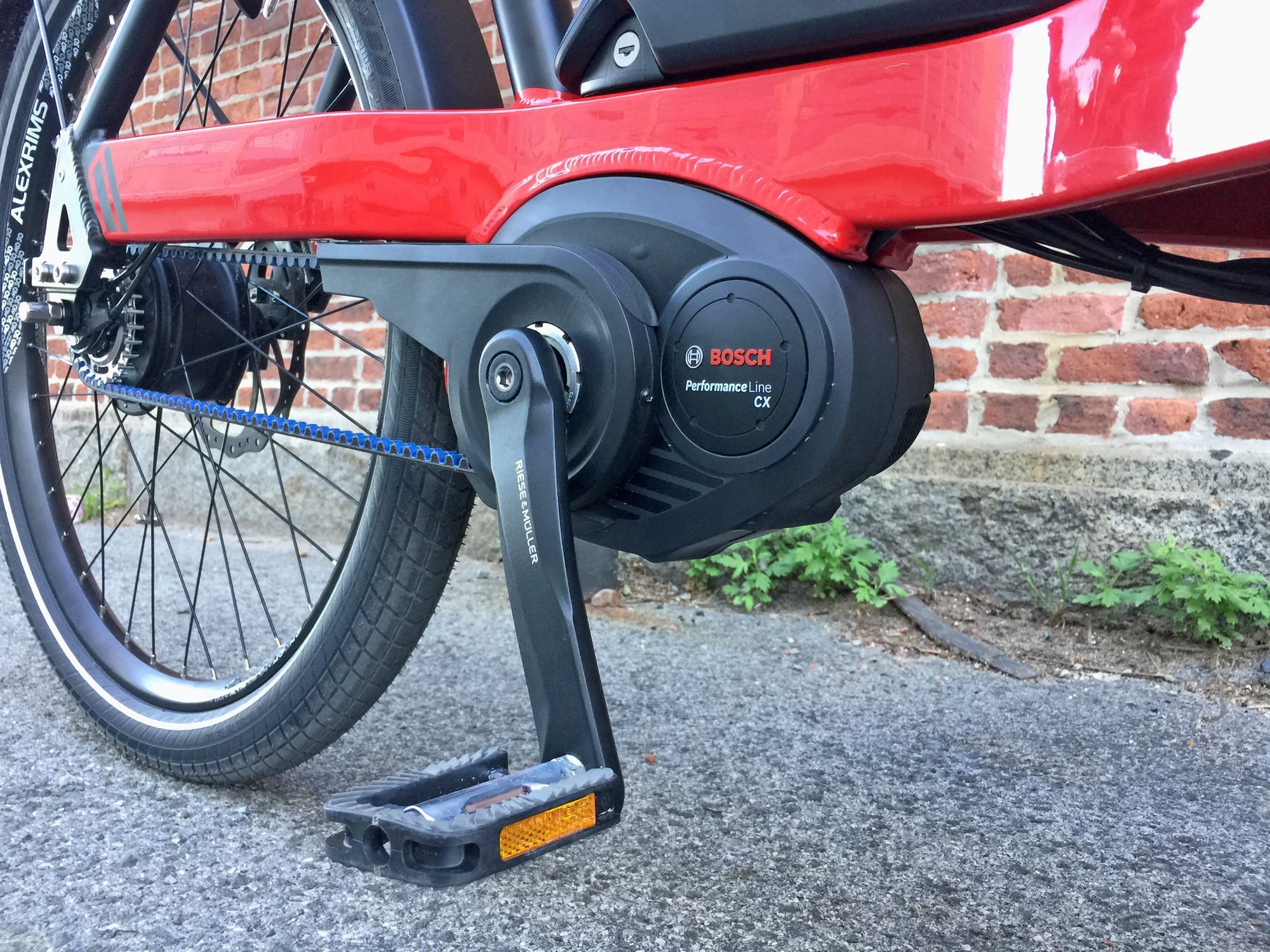

Driving this bike is one of two Bosch mid-drive motors. Both are designed to measure your rear wheel speed, pedal cadence, and pedal torque, 1,000+ times per second. Both offer shift detection, and both use a smaller proprietary chainring that spins 2.5x for each crank arm revolution. This is one of the most celebrated motors in the ebike space globally, it’s known for being reliable, and can support up to 120 RPM pedal rotations. This means that you can simply pedal faster to make the bike go faster without having to shift gears as frequently. Some of the downsides I have noticed are that the motor weighs a bit more at ~8.8 lbs, can produce more noise at high power (kind of an electronic whining that you can hear in the video review above), and causes a bit of pedal friction when the motor is off and when you try to exceed the maximum assisted speed. That 2.5 reduction gearing setup translates your pedal strokes into more motion, which empowers the motor but creates a bit of drag for you. It’s a minor gripe, and some of the other benefits are improved responsiveness and chain retention. It’s a trade-off that Bosch has moved away from with their new Active Line motors, but those don’t offer the same power and torque as the CX and Speed motor options on offer here. The demo model I tested for this specific review used the high-torque Bosch Performance Line CX motor, which offers 350 to 570 watts of power and up to 75 Newton meters of torque. It’s extremely capable if you shift gears thoughtfully, and the demo bike I tested had a “shift anytime” NuVinci CVT drivetrain. Instead of using steps to change pedal cadence, it uses an “infinitely variable” ramp. Contained inside the rear hub are eight orbs that pivot and change input rotation to output speed as you twist the right half-grip shifter. It’s extremely smooth and can be done at standstill (which is handy for such a heavy bike, in case you forget to shift down as you come to a stop), but this fancy system does add to the price and weight of the bike. If you opt for the less-expensive Shimano Deore 10-speed drievetrain, you’ll get faster shifts but more banging as the chain jumps from one sprocket to the next, as well as more grease and noise. The NuVinci system comes with a belt drive setup that is clean, quiet, and set at a fixed length. In some ways, this makes the motor sound louder, but my experience (and feedback from shops) is that the belts require less maintenance over time and rarely fall off because of a center-tracking design that Gates has patented.

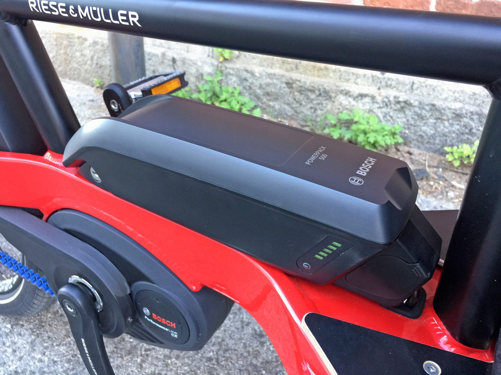

Powering this bike is one or two Bosch Powerpack 500 batteries. I love this product because it’s compact, relatively lightweight, has an integrated 5-LED charge readout on the left, and a big loop handle at the top. These Lithium-ion batteries are not cheap, and if you drop it (or decide to get a second battery to extend range on the Packster 40) it will cost you upwards of $900! And, I believe you have to decide on a second pack at the time of purchase in order to get the second docking point (which mounts to the back left side of the box). Oh yeah, and you’ll need to order the box or carry system for $164 or $218 respectively. Design wise, there’s not a lot to complain about with any of the Riese & Müller products, so I’m going to take this opportunity to say that it would be nice if they just included one of the box/carry options by default. Maybe that would increase the MSRP and be wasteful for some riders? I guess I enjoy choice… and that is a big part of the R&M philosophy. All of their products are built to order, it’s how they are able to offer so many accessory and build options, but it can take over a month to fulfill once an order has been placed (especially in the United States). The good news however, is that you know that you’re getting the latest and greatest hardware (as they make iterative improvements throughout the year) and your battery pack won’t have been sitting in a warehouse for an extended period of time. These packs should last well over 1,000 full charge cycles and can be cared for by storing in a cool, dry location. If you opt for the second battery option, for a 1 kilowatt hour capacity, you can fill both packs at once by plugging the fast 4 Amp charger into the bike. If you take the batteries off however, they will need to be plugged in independently. If you opt for the box or carry system, there’s a spot for mounting a bottle cage and folding lock on the right side that sort of balances out the second battery, which would be mounted to the left. The first default battery is mounted low and center on the frame, below the short top tube for protection. I love that the pack has been pointed backwards, in order to position the charging port clear of the right crank arm. There are so many little design considerations that have been maximized here, such as the included ABUS frame lock that immobilizes the back wheel. It uses the same key as the battery locking core so you don’t have to deal with clutter and lost or confused keys.

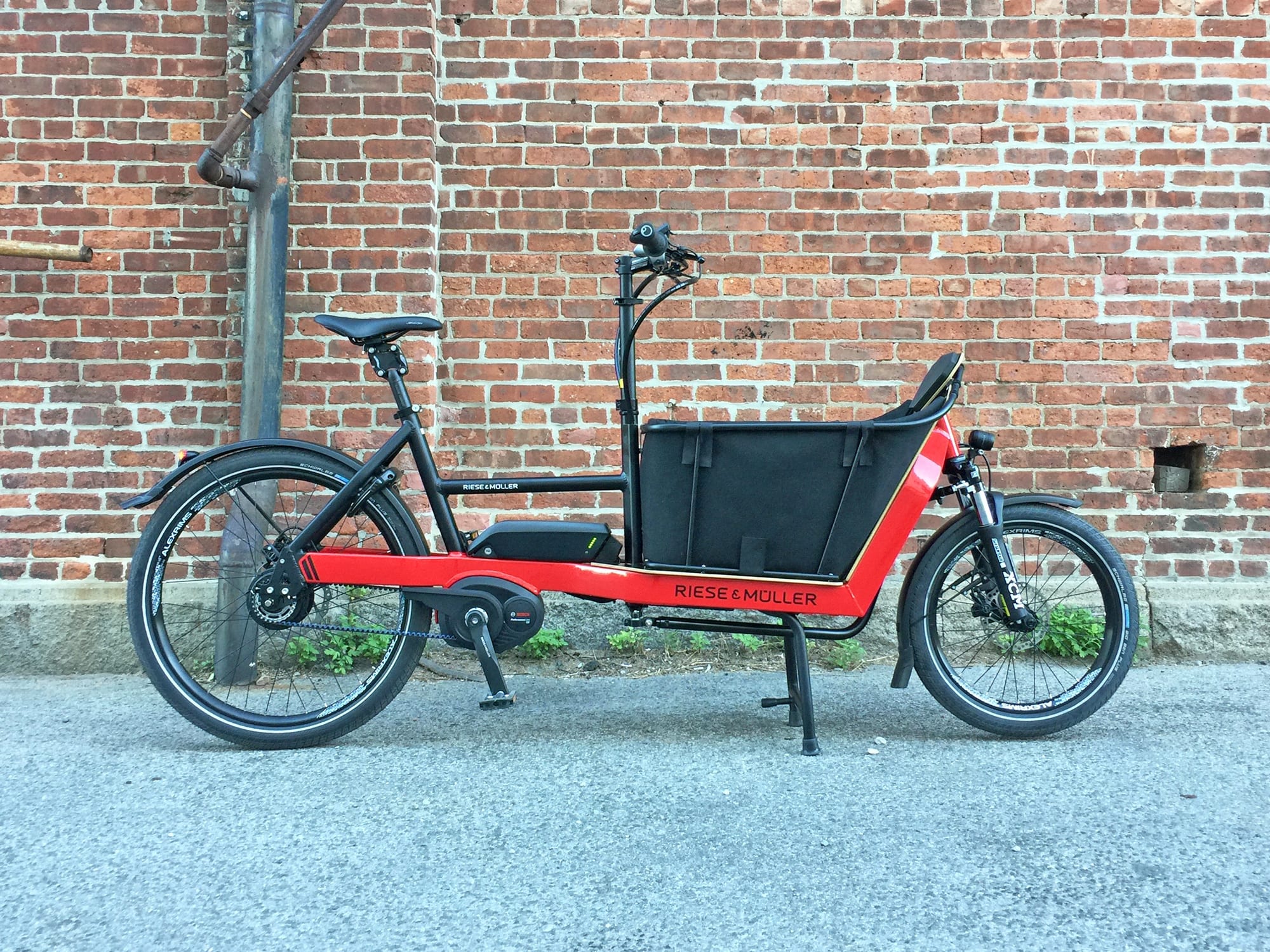

- The Packster comes in three length sizes now: 40, 60, and 80, and the 40 is their newest… it’s lighter, more nimble to steer, and won’t take up as much space to store (it’s their shortest cargo bike at 88″ vs. 97″ on the Load), yet it doesn’t sacrifice on comfort or safety

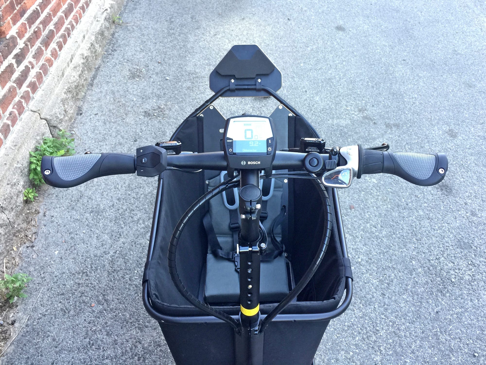

- One of the coolest features of this new shorter model is that you can flip up the head rest in the front bucket to see the front wheel while you ride, I found that this makes steering easier and more natural

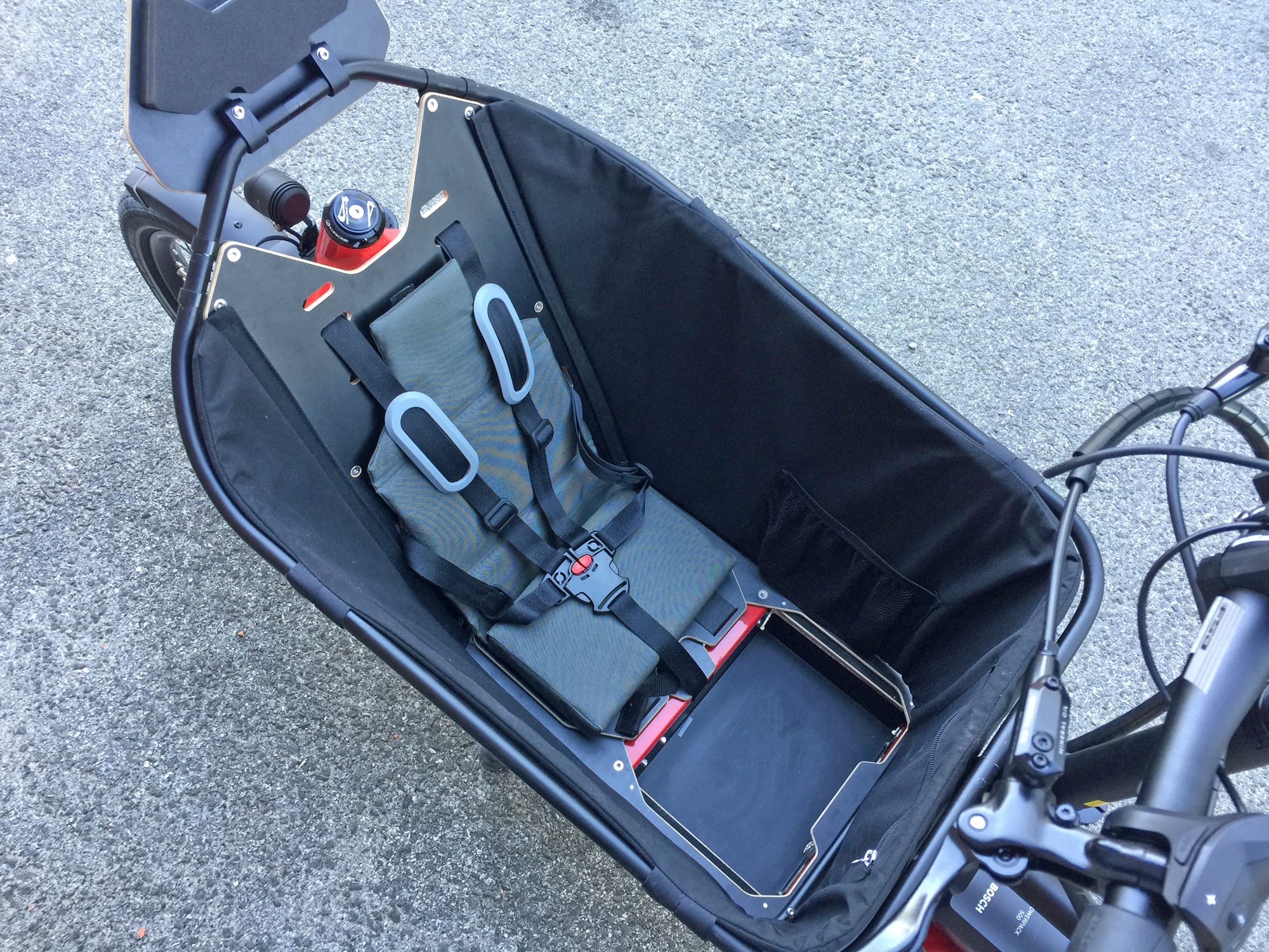

- The front bucket is versatile and Riese & Müller do sell an optional rear rack, but I love how you can also mount a bottle cage on the back of the wooden portion of the bucket or put your bottle into the canvas section where there’s a zippered pouch for easy access while riding

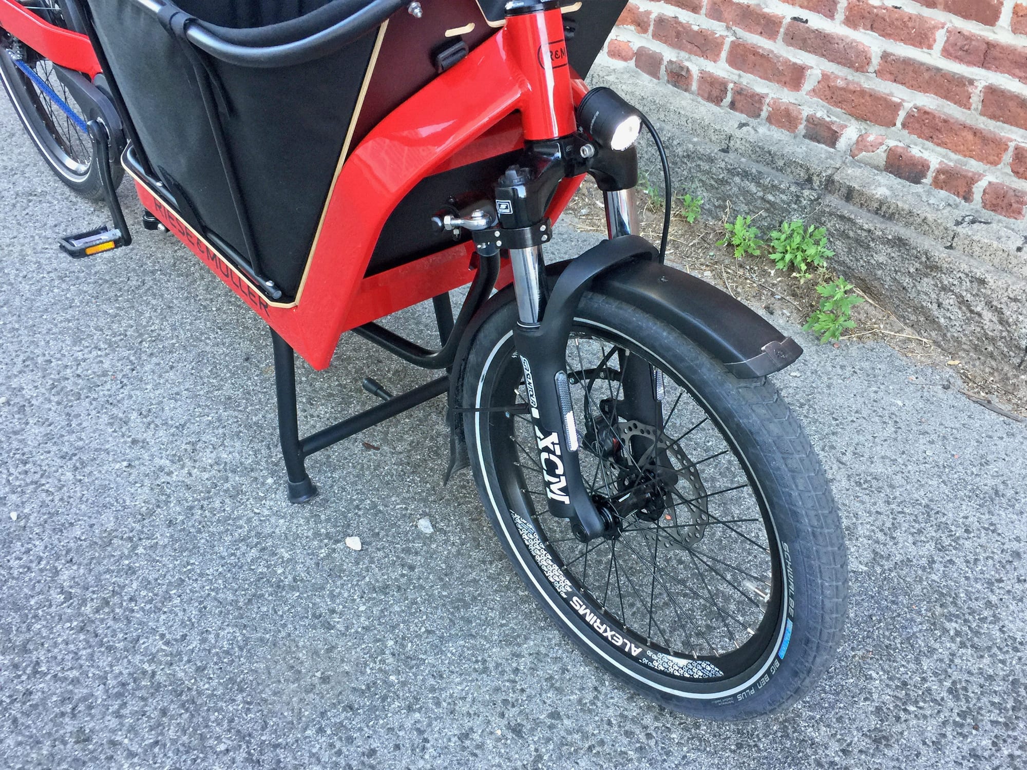

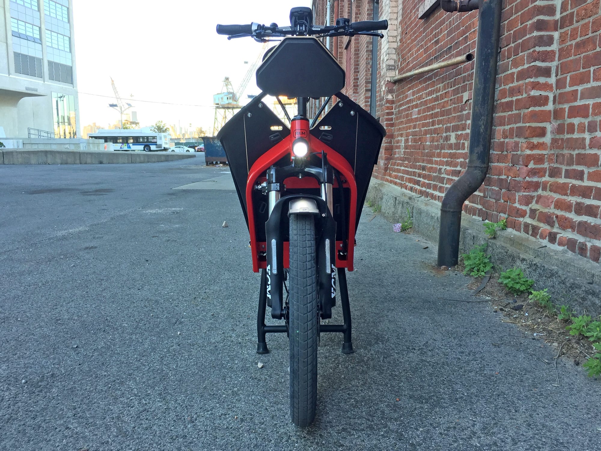

- The headlight is positioned really well, it points where you steer and is sprung so it won’t bounce around like a lot of other designs I see (where the light is mounted to the arch of the suspension fork)

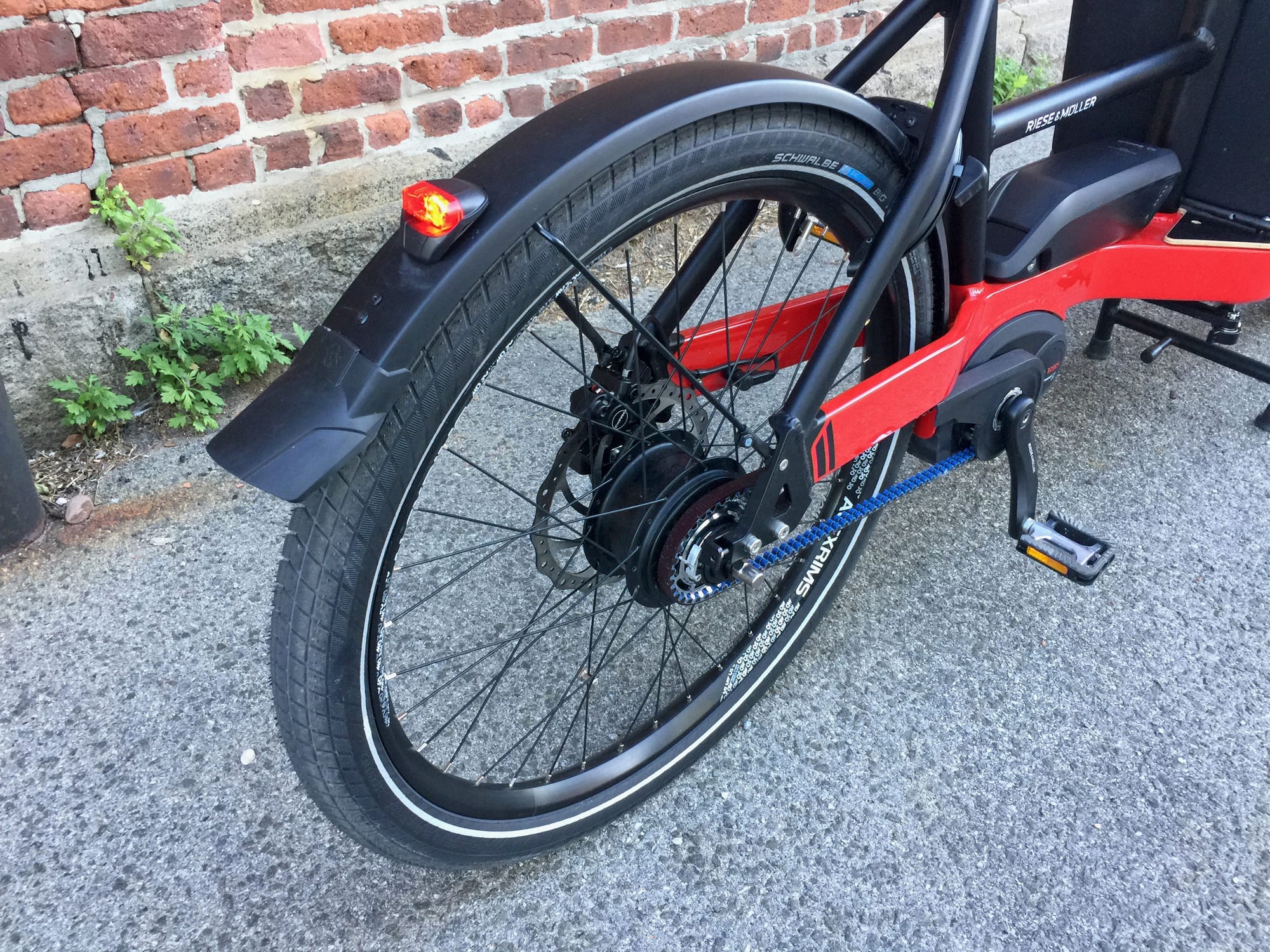

- Both LED lights are integrated, meaning that they run off of the main battery pack, and I appreciate how the tires have reflective stripes on them to further increase visibility from the sides, the light grey frame color option might help the bike to stand out even more in the dark
- By default, you get the larger Bosch Powerpack 500, but you can add a second battery pack to double your range and they will both charge off of a single port and can both still be removed to reduce weight during transport or store and charge separately
- As with most cargo bikes, there’s a sturdy alloy double-leg kickstand that stabilizes the bucket so you can put kids in or load gear, I like how easy it is to roll the bike forward and off of this kickstand when you’re ready to go, it didn’t require a lot of physical effort from me to deploy or retract because of the side bar that you can push down with your foot while balancing the bike
- If you do opt for the cargo box and child seat accessories, they will be facing backwards and looking up at you vs. forwards on most other products I have seen, this makes it easier to talk and might be preferable for some parents/kids
- Some cargo bikes use the same sized wheels, which is convenient when you go to replace tires and tubes, but the Packster has a much smaller 20″ front wheel which lowers the cargo weight and shortens the overall length of the bike (the rear 26″ wheel is smaller than the larger Packster models and further reduces length and height), I appreciate that both tires are from Schwalbe and higher quality so they should last longer and get fewer flats because of puncture protection
- Rather than using a standard 9 mm skewer for the front wheel, the Packster 40 uses a 15 mm thru-axle to improve stiffness and strength, this is perfect for hauling heavier loads (I believe it can handle 350 lbs total and 100 in the front box area)

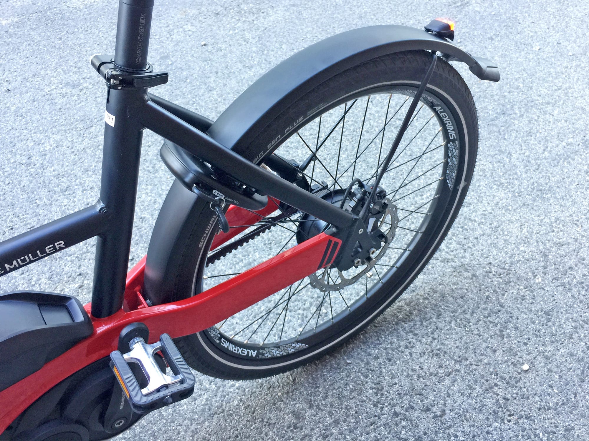

- Rain and wet streets don’t have to interrupt your ride as much because the wide 65 mm fenders and chain cover will keep you dry (especially since the front wheel is way up front) and your cargo/child can stay dry with the optional tarpaulin cover

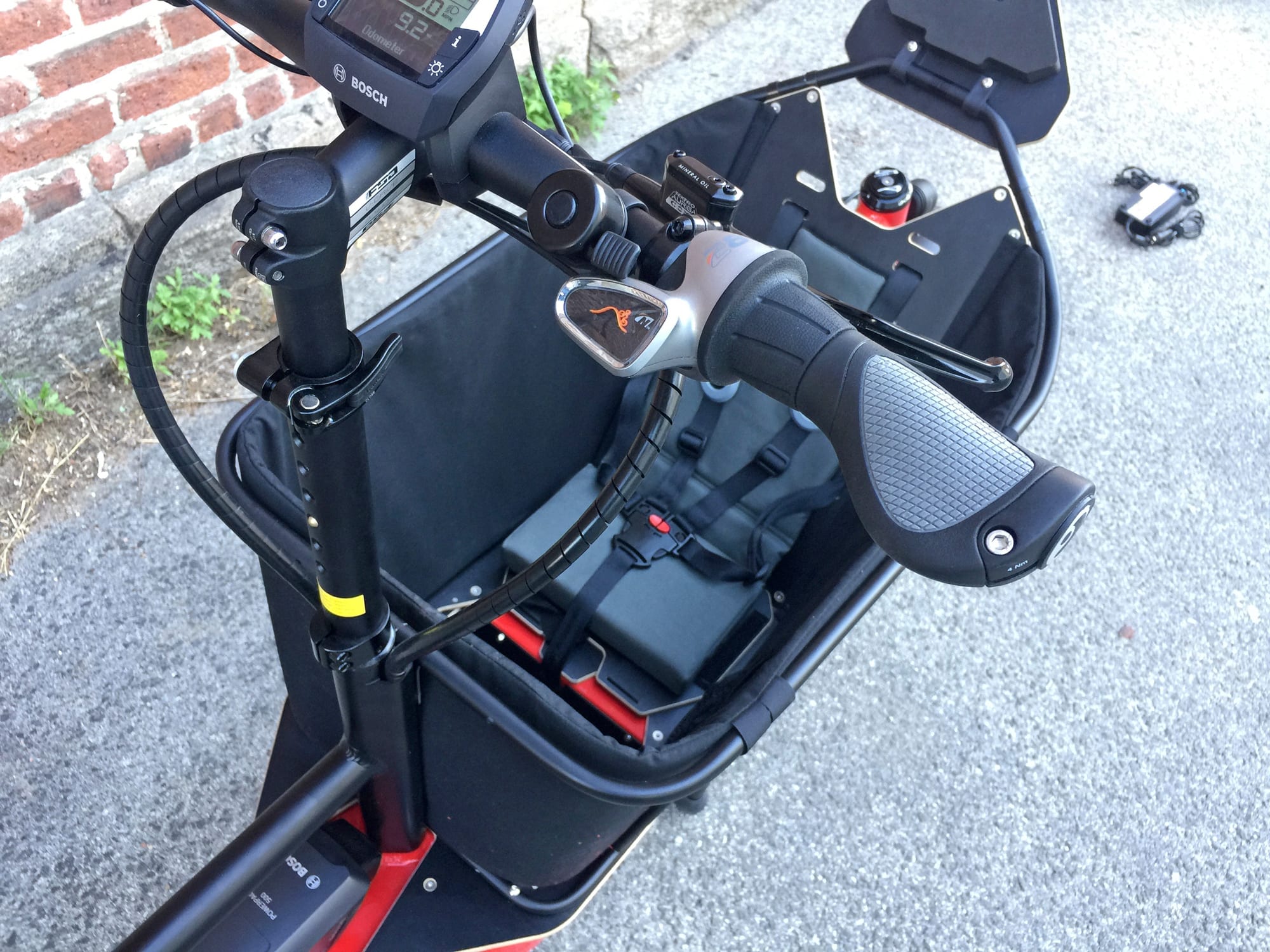

- The belt drive and NuVinci continuously variable transmission (CVT) specced on this specific model are very quiet, clean, and durable, I love that you can shift gear ratios even when the bike is stopped, in case you forget to downshift as you stop for a traffic signal

- The Bosch Intuvia display panel is one of my favorite systems on the market because it’s easy to interact with while holding the grips (by using the control pad near the left grip) and the LCD is large and easy to read, removable, and has a Micro-USB port built into the right side to maintain your phone or other portable electronics while riding!
- There are two motor options for the Packster 40 product, I reviewed the standard 20 mph Bosch CX which has eMTB mode and offers the highest torque of 75 Nm, but the Performance Speed motor is also very responsive and capable, it’s a great fit if you want to ride up to ~28 mph but are okay with the lower 63 Nm of torque

- The Bosch Powerpack batteries are widely available, the mount for the 500 is backwards compatible with the older Powerpack 400, it has a handle and LED indicator built in, and the charger puts out 4 Amps vs. just 2 Amps which means you can charge faster

- Minor gripe here, the suspension fork just has two preload clickers (that must be adjusted to match each other), it would be nice to have lockout and possibly rebound adjustment as well to reduce bouncing or maybe just an easier way to adjust preload so you can quickly make changes when loading and unloading weight?

- All of the Bosch Performance Line motors produce more noise in the highest levels of assist and when you pedal faster… but I love that they offer support up to 120 RPM so you don’t have to shift as frequently to reach different speeds
- Because the Bosch Performance Line motors use a smaller chainring and rely on a reduction gear to match their 2.5 revolutions to your single crank revolution, there is some friction produced which adds work when pedaling unassisted or above the max assisted speeds, I believe that it offers a mechanical advantage to the motor and improves chain grab

Hi, very interested to hear about the new 40 cm model. Some European reviewers noted issues regarding the front suspension fork on earlier models of the Packster. The coating on the inner fork tubes was wearing away, and the fork leg slider bushings were getting loose. Apparently sideways forces were overloading the fork at the slider interface. Perhaps the fork R+M used was a bit taxed on a cargo bike. In your video, you noted the Packster 40 had a thru bolt front fork. Do you know if R+M upgraded the front forks on the Packsters for 2018? I’d think a thru bolt would help strengthen the fork and wheel combo quite a bit.
Court Rye says
Very interesting Augsburg, this is the first year that the Packster 40 has been available in the US but I did review the Packster 80 for 2018 and noticed that it had a different fork. It’s one that I was not as familiar with, the Spinner Grind OS with 50 mm travel and a 9 mm skewer with quick release. By comparison, the Packster 40 and possibly other 2018 models now use the Suntour XCM32 with 70 mm travel and a 15 mm thru-axle. My guess is that the wheel benefits most from the thru-axle and that the stanchions could still be overloaded, but I’m just not familiar enough with either fork to say. Perhaps someone else will chime in or you could ask in the R&M Forums here. I hope this helps! You can use the compare tool on EBR to see the specs side by side to see what else has changed :)
Augsburg says
I can now see in your high res photos that R+M has chosen a front fork with chrome-plated stanchion tubes on the new models – which should address part of the reported issue. In your photos, the fork brace and crown look a little beefier on the new fork. With the thru-bolting, I’d think R+M has shown a commitment to solve any issue. I’ve only heard of a very few issues with the Packster/Load. Everyone loves them. Only other concern I saw reported is the height of the child’s canopy, which some feel is a little low for the US market, where most children wear helmets. The child’s canopy was also reported to activate the brake, which shut off the motor power in tight, low speed turns – resulting in dumping the bike. The reviewer reported that issue was solved with a BlaqPaks canopy. Researching these for my daughter. Your reviews and website with high res photos are so very, very helpful!
Court Rye says
Awesome! Thanks for bringing in the insights from the European review website, I do take the photos in an effort to empower end-users to glean information I may have missed or simply not been aware of. It’s wonderful to hear that they helped you :D

A small point: You note as one of your cons for the bike that there is “some friction produced which adds work when pedaling unassisted or above the max assisted speeds”, and that this was due to the extra fast revolutions of the motor and chain ring. My understanding is that the added friction is because of the choice of **Nuvinci gearing** that is not present with the other drivetrain option.
I am no expert on this, but I did try both drivetrain versions here in Oslo, Norway. I noticed the NuVinci seemed a bit heavy to pedal above the motor assist speed, and was told in the shop that there is about 15% (or was it 10-15%?) power loss with the NuVinci gear and that this is indeed noticeable. This is one of the reasons I chose the more traditional gear system, as I see myself sometimes going above 25 km on flat ground (limit on assist here in Europe). Also, there is a drop in battery range for the NuVinci, presumably in the same range. So I think this extra friction should be added on the con side of NuVinci drivetrain and gearing system, not of the bike or the Bosch motor system.
I don’t mean to imply that NuVinci is a bad choice. As you note, there are clearly some significant pros also to that innovative system. I would say it depends on your intended use, biking style, previous experience and personal preference (and wallet).
I believe for both drivetrain options the chain ring on the motor turns faster than your pedals. (I have not seen this anywhere, but I suspect that the extra speed of the chain ring is necessary to keep standard bike components such as chain and gears from breaking or wearing very fast as they are subjected to the extra torque of the electric motor.)

Great feedback Christian! You are correct that the fluids in the NuVinci CVT add a bit of drag to the system, it’s not as efficient or lightweight as a cassette and derailleur… However, the 2.5x reduction gearing with the Bosch Performance Line motors (Standard, CX, and Speed) does also add some drag. Not very much, but it is one of the minor cons to the system (along with chain suck if the conditions are very muddy). I’m so glad that you’ve been enjoying your bike and really appreciate the time and energy you shared making this comment. I will add more about the NuVinci in future reviews ;)
