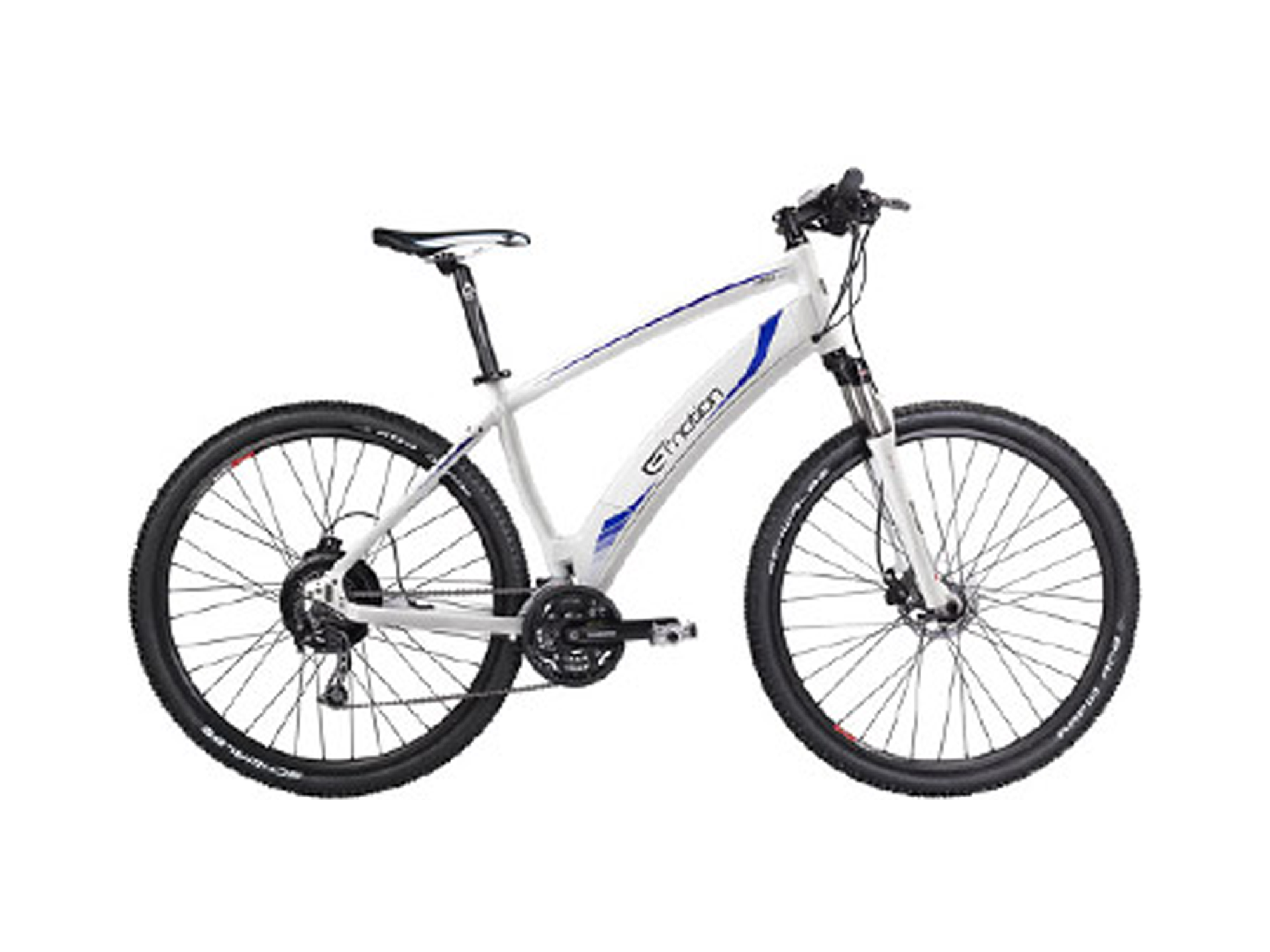

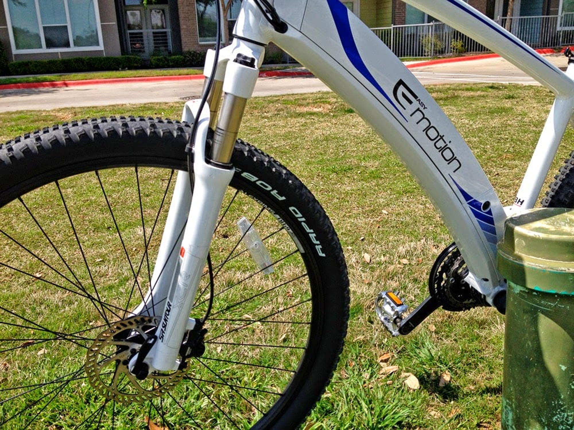

Hardtail design with 30 gears, hydraulic disc brakes and suspension with rebound and lock out adjust
Offers twist throttle for power on demand and four levels of torque sensing pedal assist for improved climbing
Large 29" wheels improve rolling momentum, provide greater traction and increase angle of attack for overcoming obstacles like roots and rocks on the trail

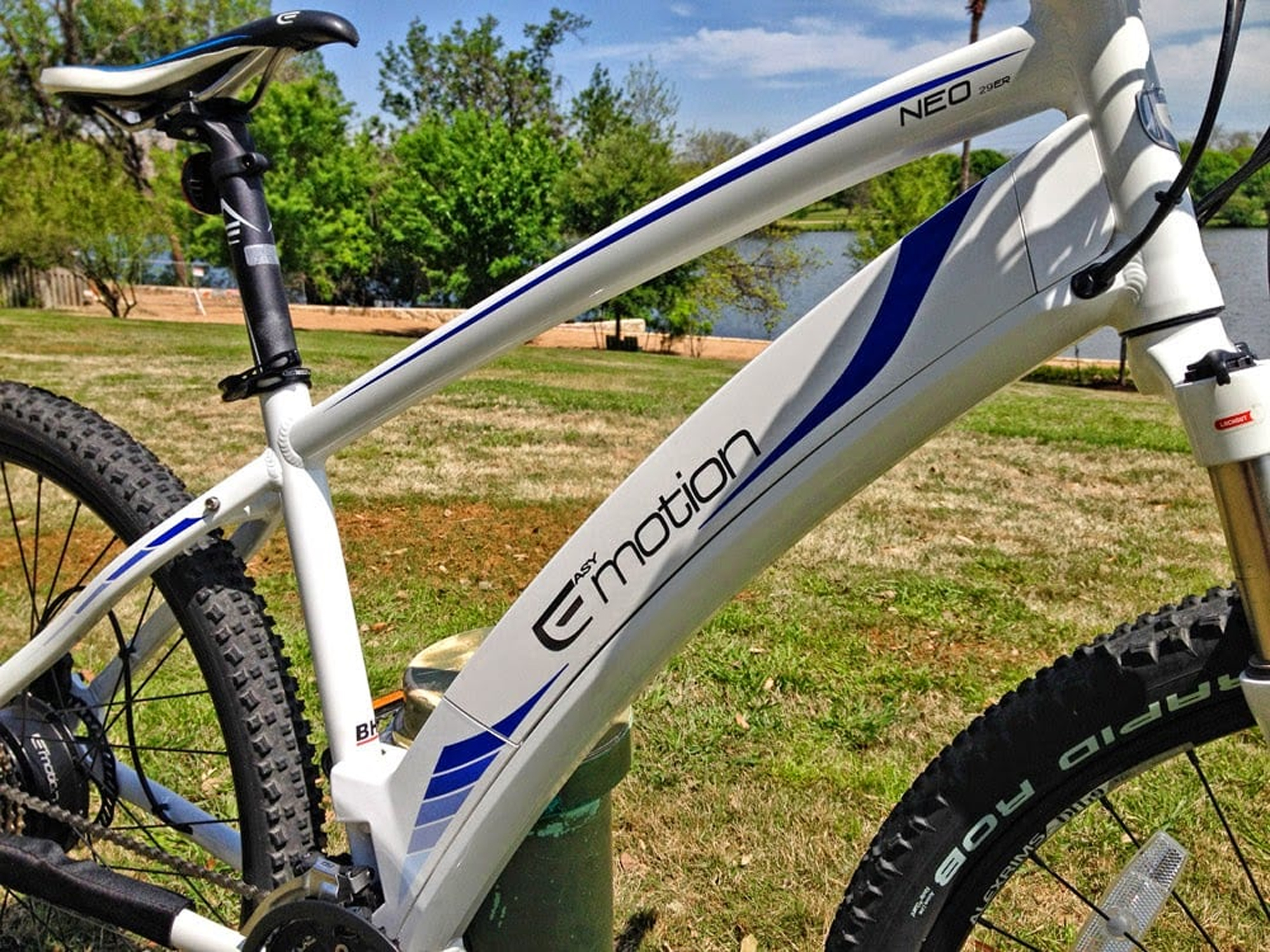

The Neo 29er is a well rounded hardtail electric mountain bike that’s well balanced, feature rich and easy on the eyes. Easy Motion offers a wide range of trail ready ebikes ranging from the Neo Xtrem with standard 26″ wheels to the Neo 650B with 27.5″ wheels and ultimately the Neo 29er is similar to these models in terms of drive system. To me this is a good thing because it means the motor has been scrutinized and the batteries are actually cross-bike compatible which makes replacements easier to come by. While it only comes in one size, Medium, this bike is slightly higher than the others due to its larger wheel diameter.
The motor on the Neo 29er delivers 350 watts of power through a planetary geared design that keeps it small, light weight and torquey. There’s enough room on the rear cassette for 10 gears and with three rings on the front crank, you get 30 speeds to choose from here making it easy and fun to ride across varied terrain. Uniting these two systems (rider and motor) is a responsive torque sensing pedal assist program with four levels. It works exceedingly well for climbing which is a major draw for someone like me with sensitive knees. Ultimately, the motor is effective and relatively quiet without being too large or heavy.
Powering this system is a 36 volt 9 or 12 amp hour battery pack (depending on the year you’re looking at). 36 volts relates to the power of the pack and the amp hours designate capacity so with the 2014 12ah design you’ll be able to ride further. The cells use a Lithium-ion chemistry that’s light, durable and configured to spread weight across the frame while keeping it as low as possible. This is critical for a trail bike that may encounter precarious riding conditions or need to be jumped around a bit.

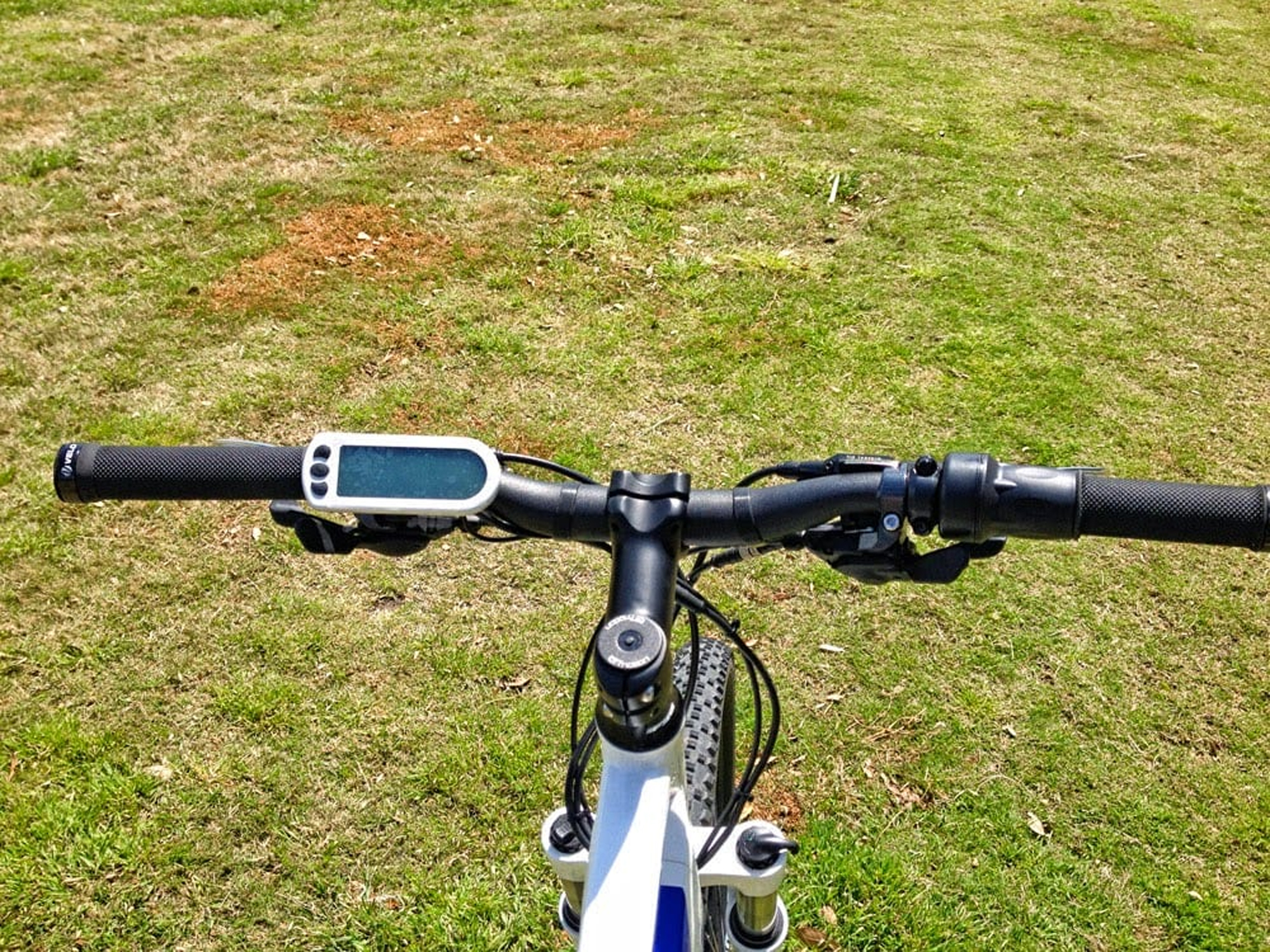

One of my favorite parts about this system is the LCD control panel. It matches the frame, has a backlit display for nighttime use, is easy to reach with your thumb when riding and is removable for safe storage when parked. It shows your speed, distance, pedal assist level and remaining battery capacity. To use it you press the middle power button for a few seconds then use the up and down buttons to select a power mode. When you’re in the lowest level the bike operates with the twist throttle and with each incremental assist level it responds based on your pedaling and contributes a higher percentage of power which subsequently drains the battery faster ;)

Integrated battery pack keeps weight low and distributed across the frame
Battery locks to frame with key for security, LCD computer can be removed easily to avoid tampering
LCD computer is backlit and water resistant, paint job matches frame
Oversized metal pedals feel great and offer good traction
30 gears for excellent climbing ability or higher pedaling speeds around town
29″ wheels are capable in off road environments and efficient on road if you use it for commuting (the lockout on the shock also helps here to decrease bob)
Hydraulic disc brakes provide great stopping power and don’t fatigue hands as much as mechanical brakes

Integrated wires look great and stay out of the way, great paint job, looks like a regular bike
Larger 12 amp hour battery pack will go further than other Easy Motion Neo bikes that offer just 9 amp hours
