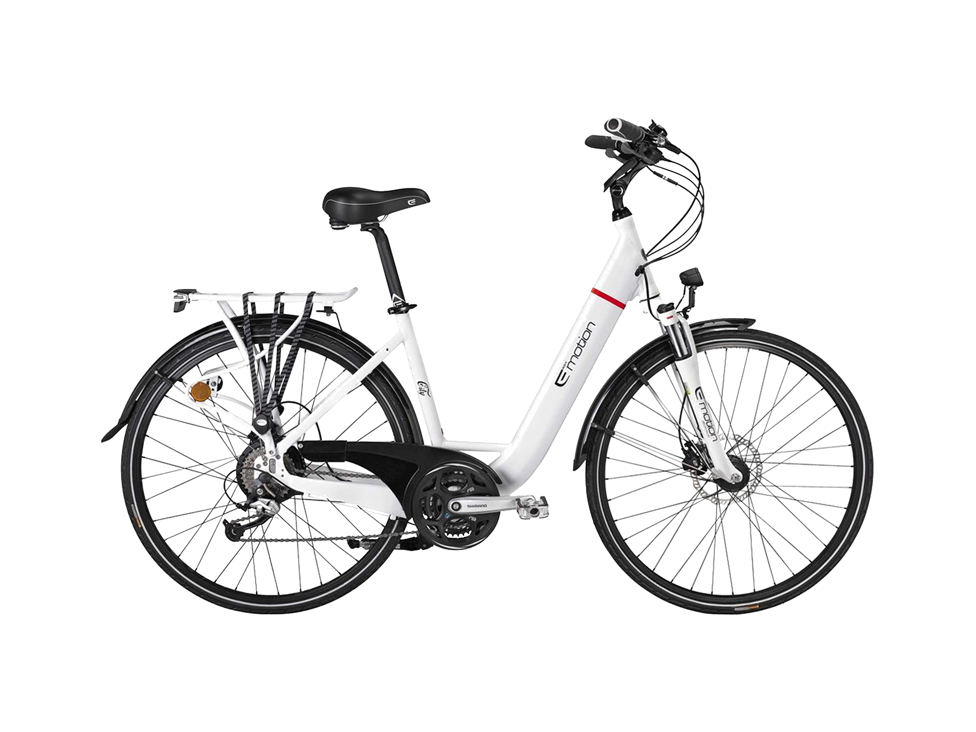

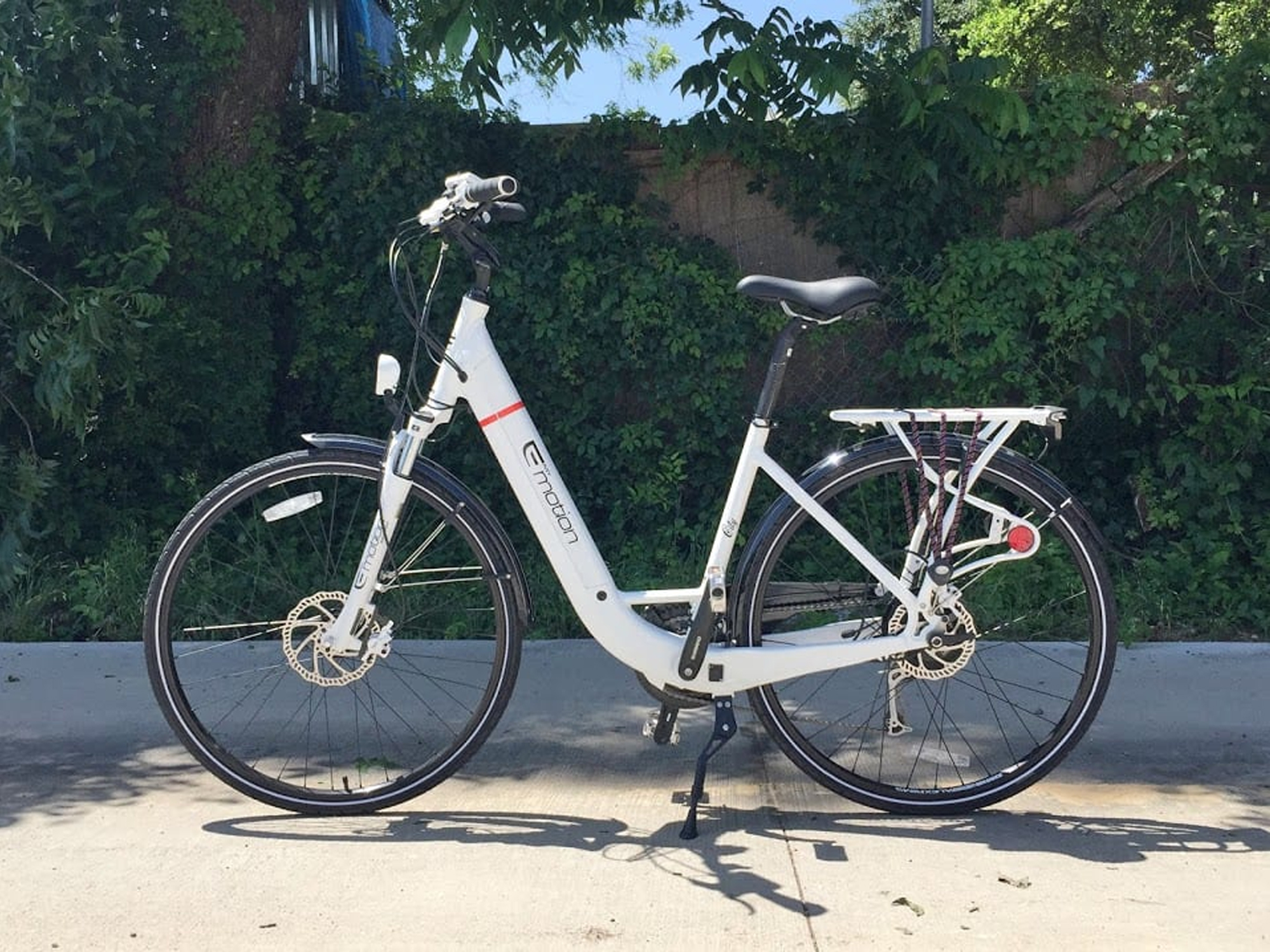

This review is for the 2015 model Evo City Wave from Emotion, you can see the latest version on this page which costs slightly more and has a larger battery and more powerful motor.
The Easy Motion Evo City Wave is a well balanced, feature-packed electric bike that delivers pedal assist and throttle on demand power. With this ebike you get fenders, a chain guard, a rear rack with bungee cords, a dynamo powered set of LED lights, a removable battery pack and a two year warranty for ~$3k and you get a two year warranty! It’s an excellent platform but the downsides are that it only comes in one color and one size (a step-thru medium) and you cannot use the throttle to override pedal assist. You might notice that the Evo City Wave resembles the Evo Eco Lite and Evo Street but includes suspension (whereas the lite does not) and uses a slightly larger frame and larger wheels as compared with the Street. While this still is not a large bicycle, it’s basically the best bet for taller riders. The step-thru frame makes it very easy to stand over and mount and the low-rise swept back handlebars offer a “heads up” riding position so you can spot traffic and avoid bending forward (which might cause back and neck pain over time). It’s not the lightest weight e-bike I’ve tested but given the nice accessories and larger battery capacity, it’s a solid offering.

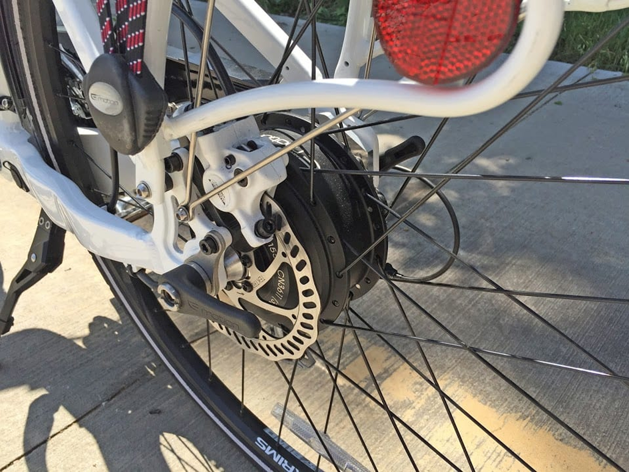

The motor powering the Evo City Wave is a 350 watt geared hub mounted in the rear wheel. Being geared, it’s relatively small and light weight but still peppy. The drawback is a bit more noise (that comes from the plastic planetary gears inside). The brand that Easy Motion uses for their Evo line is Dapu and these are some of the most powerful geared motors I’ve tested (for their rating). You get 350 watts nominal but the motor actually peaks above 500. One of the big improvements for these 2015 models is the power cable being moved from the right side of the right side of the hub to the left, this reduces clutter near the derailleur and also protects the power cable more if the bicycle tips over. Also worth highlighting a unique quick release system that has been added to all Evo models. There are two plastic levers that can be used tool-free to remove your rear wheel and this is handy for trail maintenance (fixing a flat for example).

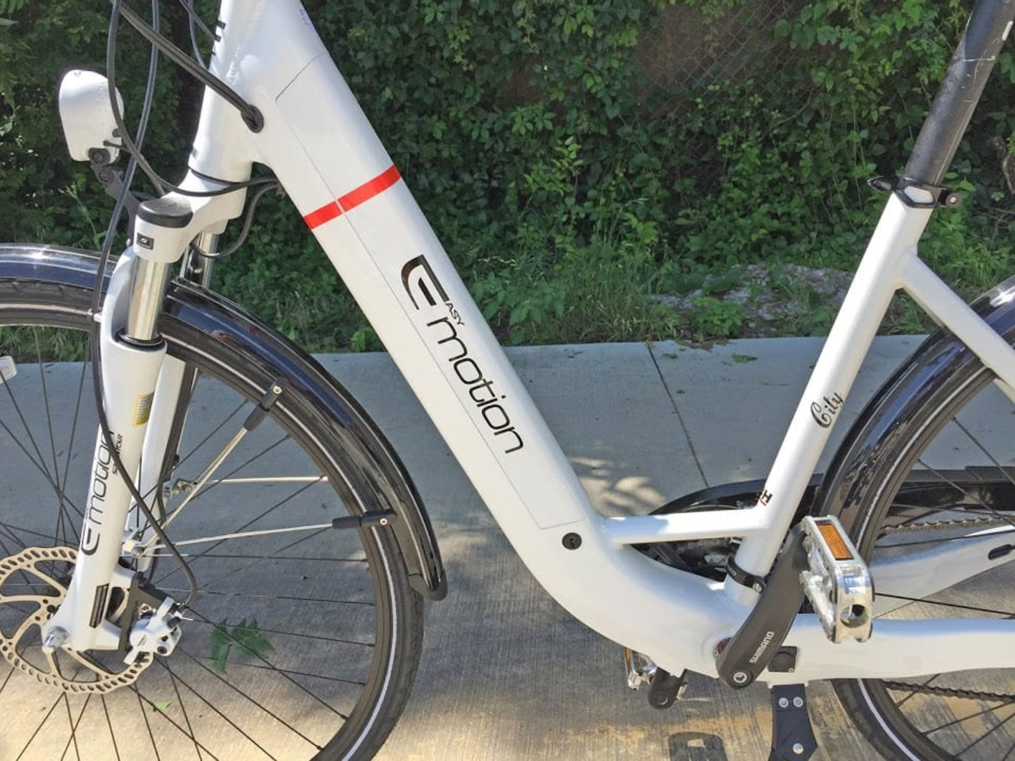

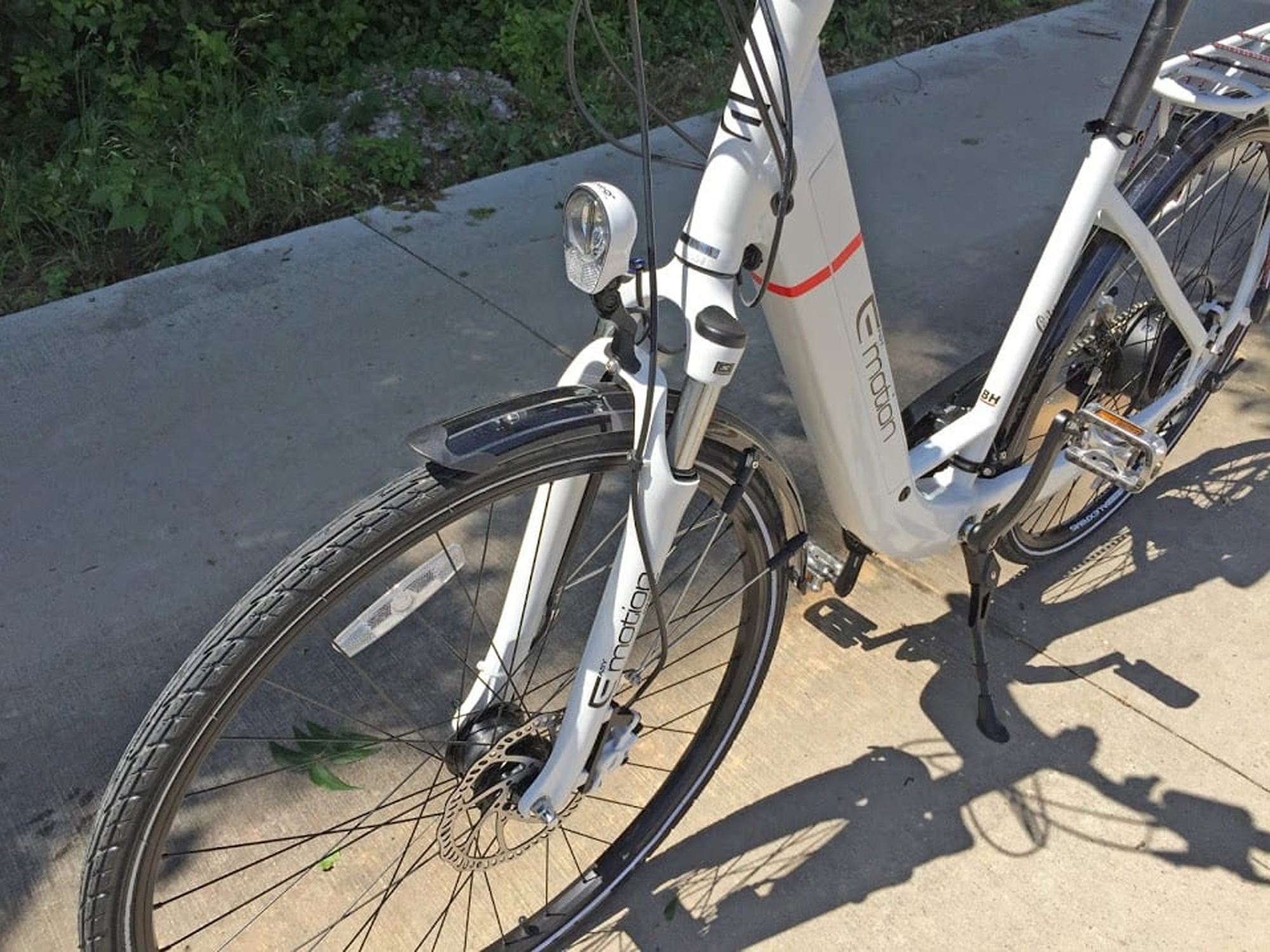

Powering the bike is a beautiful custom-designed Lithium-ion battery pack that mounts right into the downtube. It’s seamless, the pack is painted to match the rest of the frame and in my opinion it’s one of the most beautiful battery solutions in the ebike space (as of the time of this writeup). This pack can be charged on or off the bike which makes it convenient (for transporting or for when you’re storing the bike at a rack or in a garage). I recommend storing batteries in cool dry environments because extreme heat and cold can harm the chemistry and reduce the number of charge cycles you get. Withe the Evo series, Easy Motion has increased the battery capacity from 36 volt 9 amp hours to 11.6 amp hours which is ~30% more capacity and that means more range. Thankfully, the battery hasn’t changed much in terms of weight at ~5.5 lbs. Other new features include a built in LED power indicator right on the battery and a charging interface that lets you plug into the bike whereas before you always had to take the battery off in order to charge it and that meant increased potential for drops and scrapes.

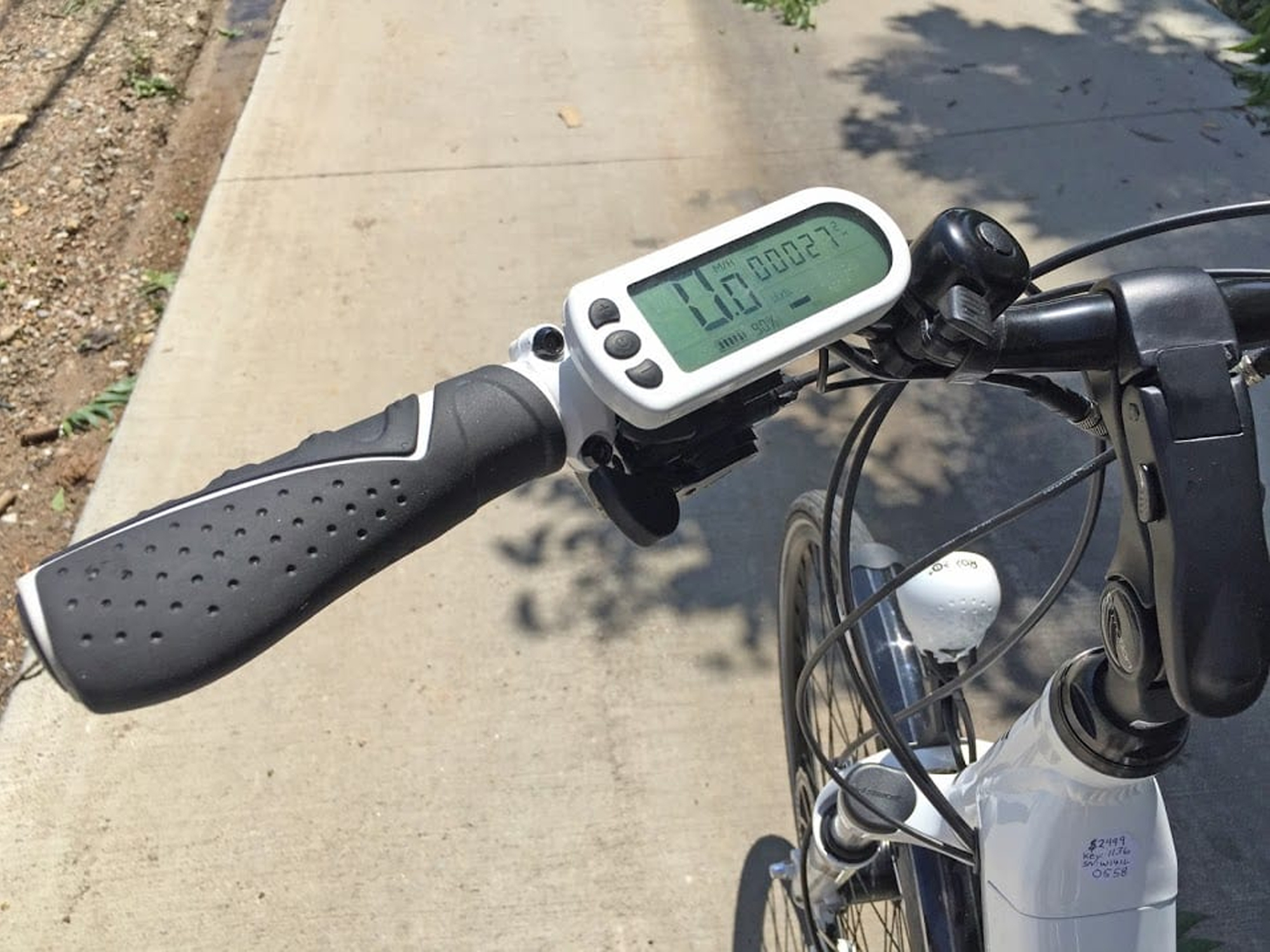

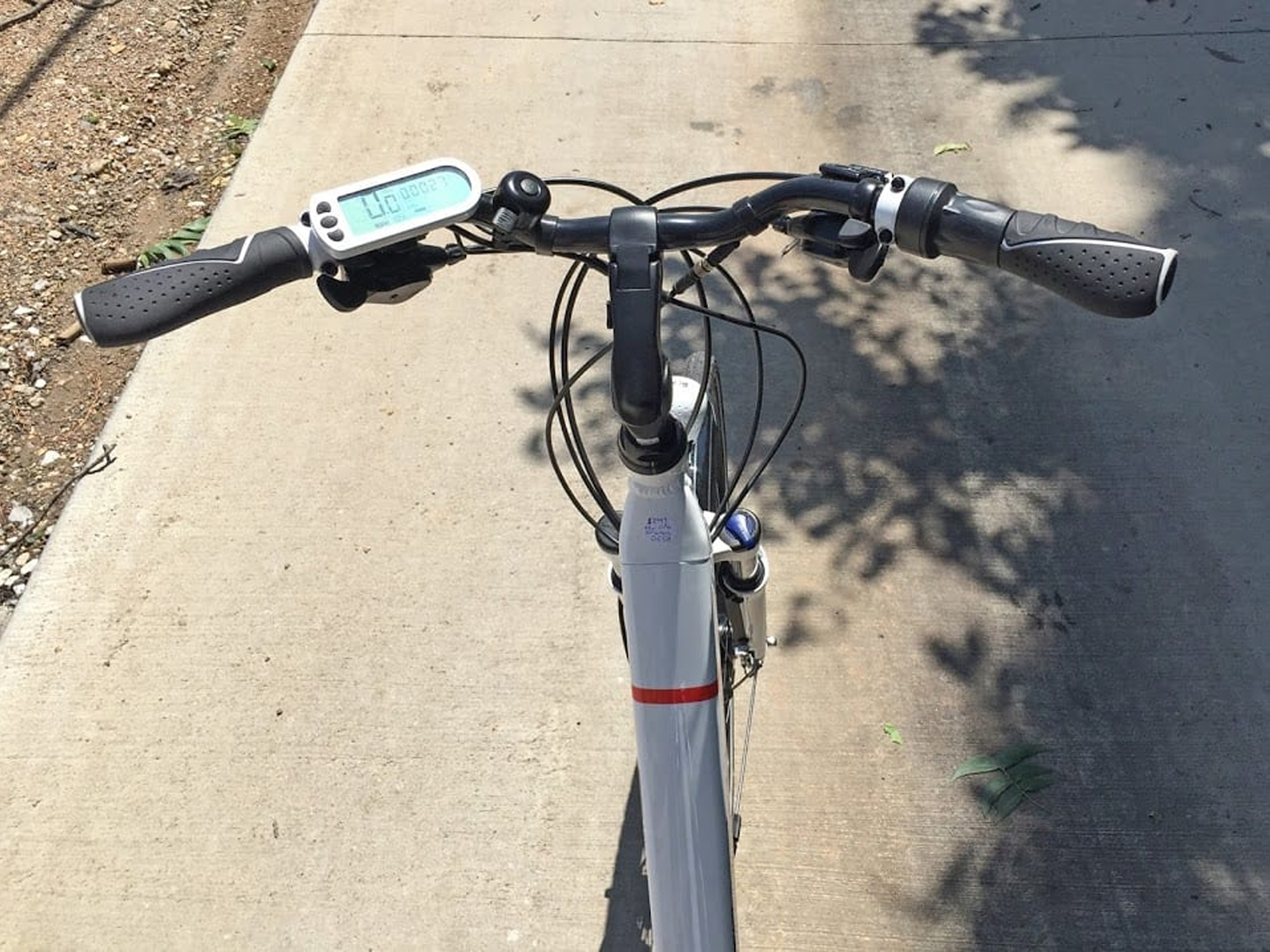

Operating this bike simple and intuitive. Once the battery is charged (again, on or off the bike) and locked into the frame you simply press the middle button on the display panel for a few seconds and the bike powers on. From here, you are shown speed, charge level, trip distance and assist level by default. You can activate backlighting on the LCD display by holding the up arrow for a couple of seconds and you can alternate menu readouts by pressing that middle button again (for timer and odometer). I love that the LCD unit is removable because that might decrease weathering and vandalism and it’s neat that they color match the bezel with the rest of the bike (it’s white in this case). The cockpit stays relatively clean thanks to the combined display + buttons but you also have a basic bell, trigger shifters to operate the 24 speeds and hydraulic brake levers. The stem (that connects the headset to the handlebars) is adjustable and tool-free meaning you can improve ergonomics on the fly if you want to be more forward or upright. A couple downsides to consider are non-locking grips that can heat up and twist if you’re really bearing down and the limited throttle activation (mentioned earlier). Basically, you can only use the throttle in “no assist” mode and once you begin using pedal assist the throttle shuts off. I wish this wasn’t the case because I like to ride in lower assist levels (for exercise and to extend range) and then having to interact with the display to get the throttle active when climbing a hill can be distracting.

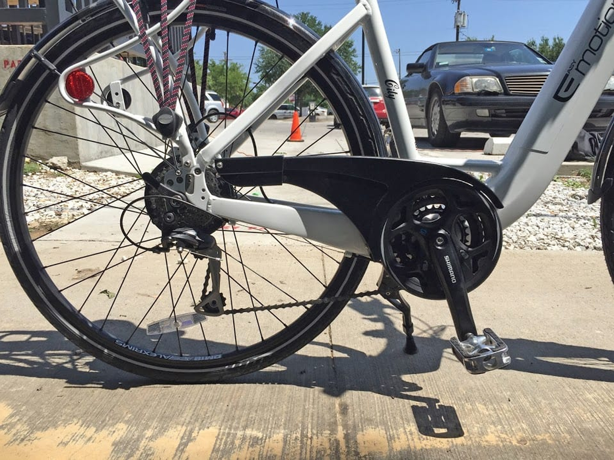

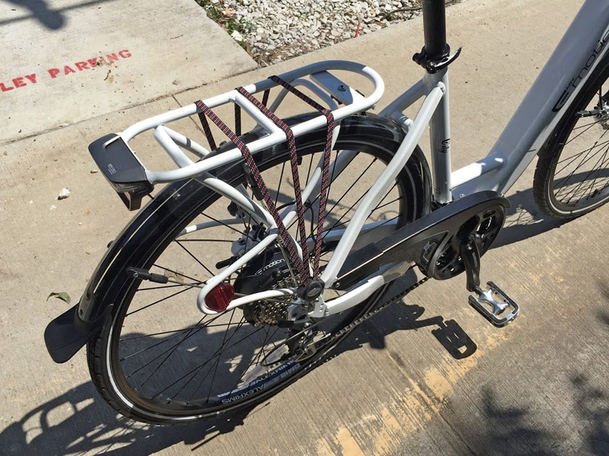

- Great safety, utility and cleanliness thanks to the full length fenders with mud flaps, large plastic chain guard, rear carry rack with pannier blockers and extra reflectors and reflective sidewall stripes on the tires

- The battery pack can be charged on or off the bike, is integrated into the downtube for a clean “stealthy” aesthetic and features a lock for security

- The LCD display is removable, easy to reach and activate from the left grip, backlit for use in low lighting conditions (just hold the down arrow for two seconds)

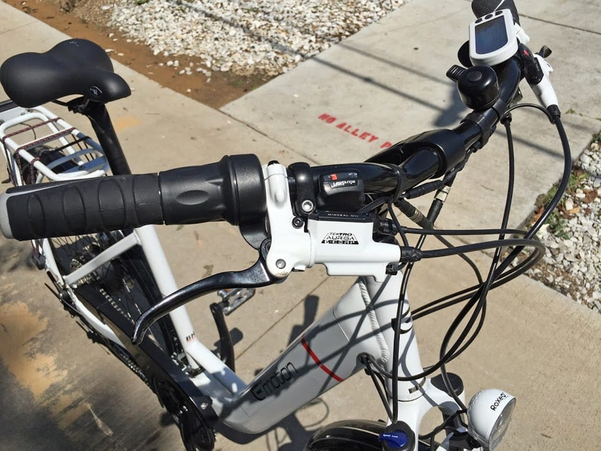

- Tektro Auriga E-Comp levers have motor cutoff switches built in and are easy to activate with just a finger or two, the large 180 mm front rotor and standard 160 mm rear rotor offer great stopping power for trail and mountain terrain
- New tool-free quick release system on the rear wheel makes changing flats and doing service much easier, the motor power cable also has a quick disconnect built in
- The motor power cable location has been updated, now entering the hub on the left side of the bike vs. the right side where the derailleur and cassette are, this helps to reduce complexity, clutter and damage if the bike tips

- The headlight is mounted to the lower portion of the suspension fork which increases unsprung weight and may cause the light beam to bounce around more than if it were mounted to the head tube or handle bars

- Tektro hydraulic disc brakes provide decent stopping power but aren’t as smooth as Avid and may rattle or squeak with use
