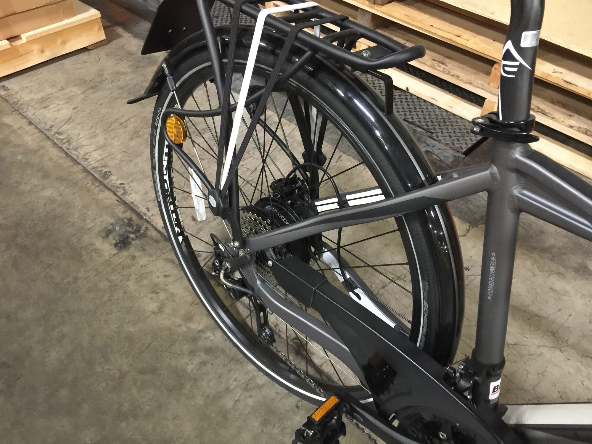

- Great accessory package for commuting including full length plastic fenders, chain guard, adjustable length kickstand, integrated LED lights and an oversized rear rack (rated for up to 55 lbs of cargo) with pannier blockers and bungee cords

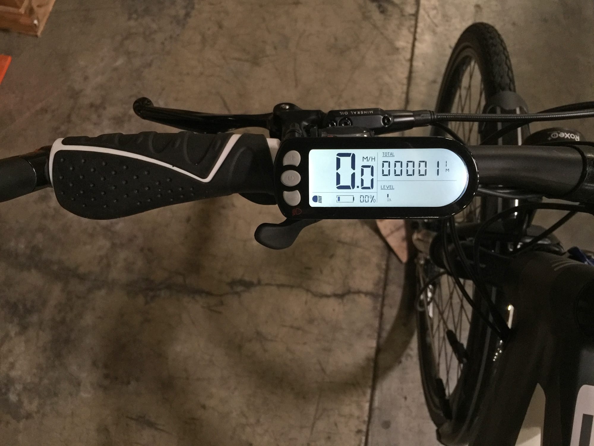

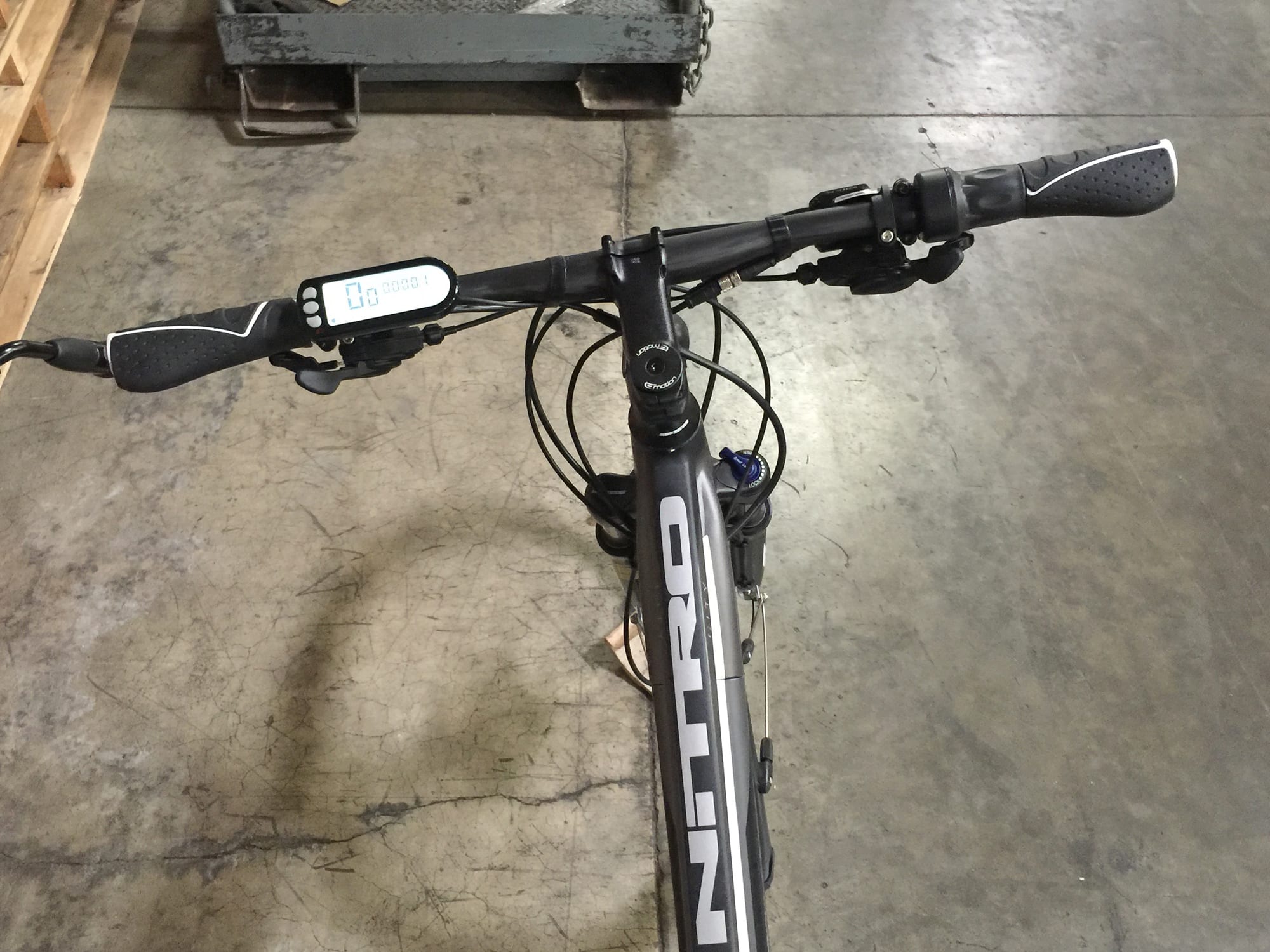

- The cockpit handlebar area of the bike is very clean and organized despite having trigger shifters on the left and right, I think the Emotion display helps a lot (and I like that it’s removable)

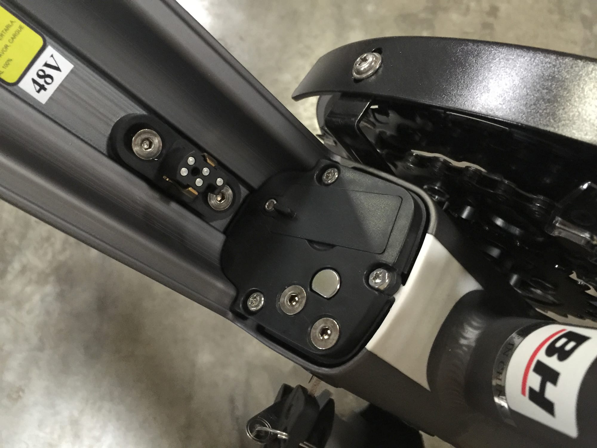

- I love that you can charge the battery pack on or off the bike with the 2016 Nitro ebikes but it requires a special dongle adapter because the plugs are different and the bike-frame plug is positioned very close to the left crank arm which can collide with it and break it off if you back the bike up while charging BE CAREFUL!

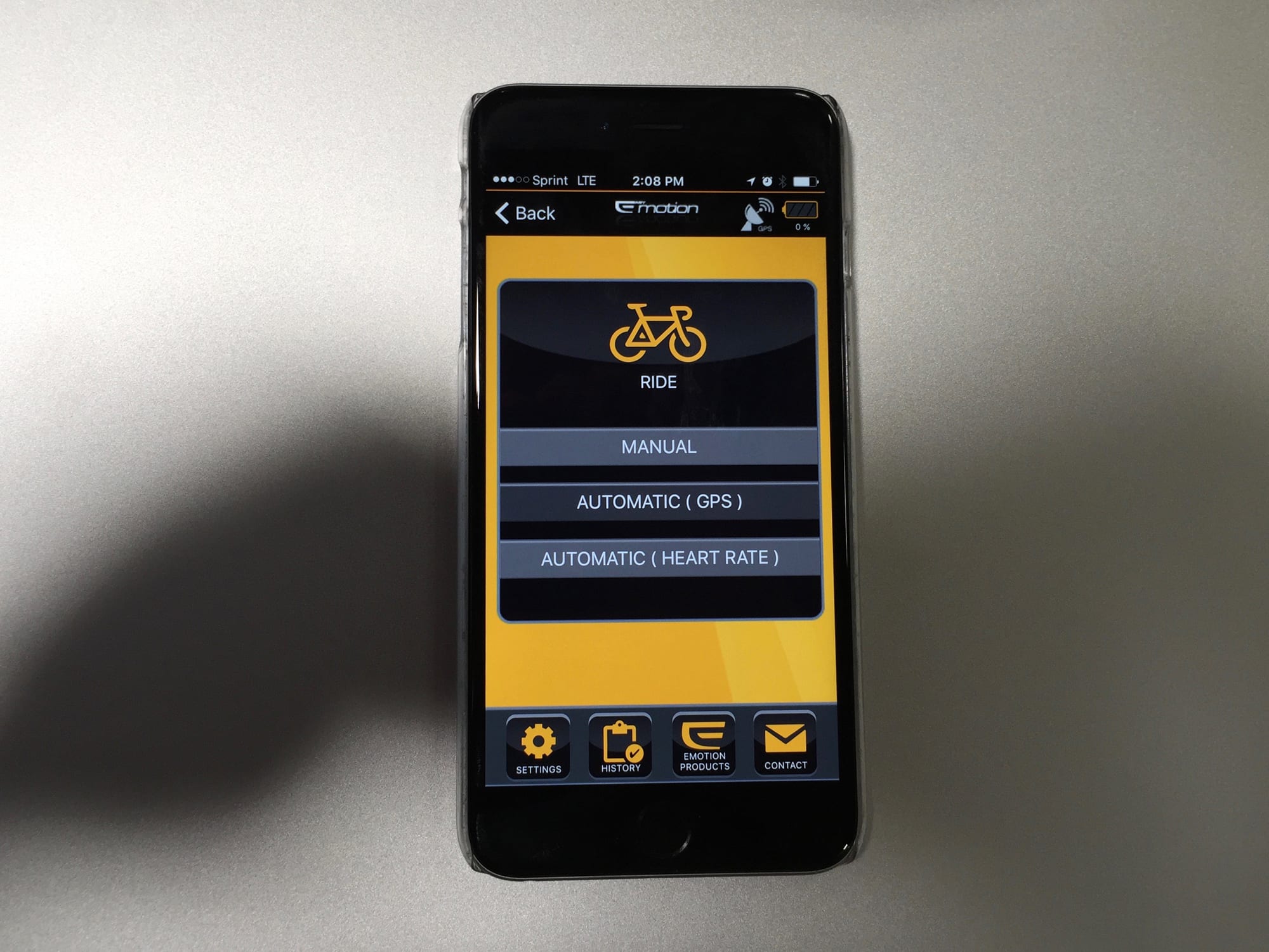

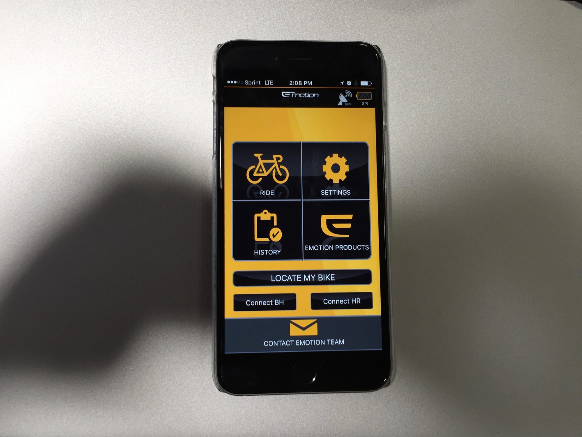

- If you purchase the optional Bluetooth module it completely replaces the LCD display but doesn’t have a display of its own so you have to use your phone… and that’s okay but there’s no charging port to keep your phone from draining rapidly as you use it for GPS etc.
