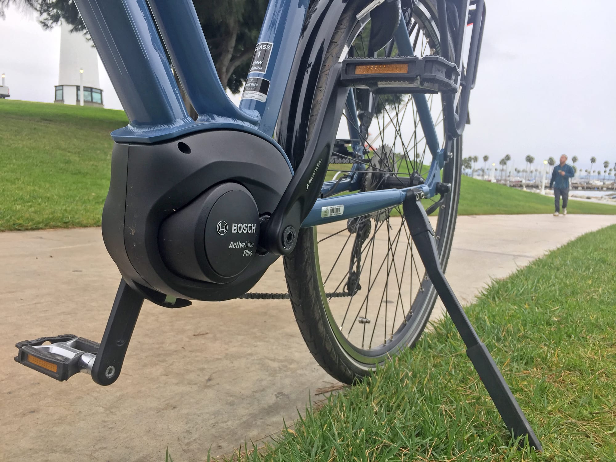

Driving this bike is an efficient planetary geared mid-motor from Bosch, called the Active Line Plus. It ranks just above the Active Line, providing a more powerful feel with increased torque (50 newton meters vs. 40nm) and faster motor output capabilities (105 rotations per minute vs. 100 RPM). This translates to zippier starts and consistent support when downshifting for climbs. It’s not nearly as capable as the 75nm meter 120 RPM specced Bosch Performance Line CX, but it’s much quieter, lighter (7.1 pounds vs. 8.8lbs), smaller, and smoother feeling. For a mostly-urban ebike like the Gazelle Medeo T9, I think it’s an excellent choice. Notice how the motor is almost hidden behind the chain cover and blends in with the black plastic. It’s really tucked into the core of the frame where the chains stays, seat tube, and downtube intersect. If you decided to add pannier bags to the rear rack, the battery would disappear and this would almost look like an acoustic bicycle vs. electric. Other notable aspects of the Active Line and Active Line Plus motors are that they can pedal backwards, actually cycling the chain through the cassette. This can be handy for servicing. All current generation Bosch ebike mid-drive systems include an advanced motor controller that measures rear wheel speed, pedal cadence, and pedal torque over 1,000 times per second. This feedback is used in conjunction with the display panel, and chosen level of assist, to provide natural power output. It measures your pedal stroke pressure, aiming to reduce power surge (the on/off wave feeling often associated with heavy pedaling). And, it measures sudden changes in drivetrain pressure outside of pedal strokes that indicate shifting. This is called shift detection, and the goal is to reduce motor pressure when the derailleur is redirecting the chain. Ultimately, this will reduce gear mashing and keep the teeth on your rear sprockets and chainring in better shape over the long term. In my experience, it’s still a good idea to ease off on your pedal pressure when shifting. With nine gears to shift through and a fancier Shimano Deore derailleur, I’d expect to see less maintenance with this bike and better shifting experiences overall. The trigger shifter near the right grip is easy to reach and activate, there’s even a clear window showing your active gear. There’s a slight trade-off with the high trigger, it doesn’t offer two-way clicking, but you still get three-step low trigger action.

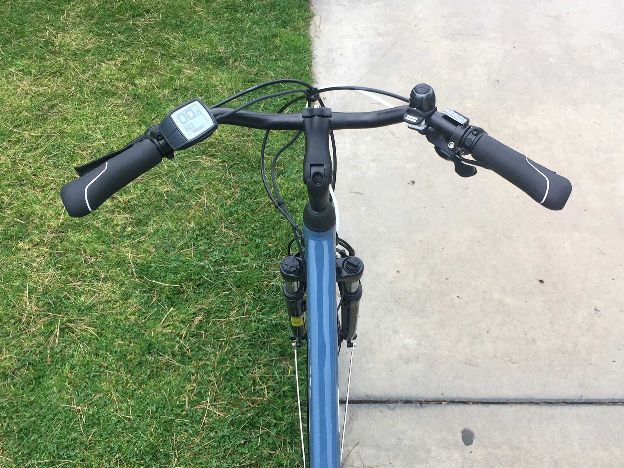

When you’re ready to ride and the battery has been charged and mounted properly, simply press the power button on the top edge fo the Bosch Purion control panel. This display is mounted within reach of the left grip and features two main buttons: plus and minus, for raising and lowering the power level of pedal assist. It boots up in Off, so pedaling is just like a traditional, albeit heavy, bicycle. From here, you can navigate up through Eco, Tour, Sport, and Turbo for increased power and speed. To truly maximize your ride speed, you’ll also need to shift up into higher gears. On the LCD screen, a five bar battery infographic communicates charge level in 20% increments but there’s actually a range estimator menu that is much more precise. To navigate to this menu, simply hold the minus key for a couple of seconds. If you hold it again, you’ll find the Trip Distance and Total Distance (odometer) readouts. Note that you can reset Trip Distance by holding the plus and minus buttons simultaneously. There’s one more button at the bottom edge of the Purion control unit, and that’s walk mode. To use this feature, navigate up into any of the four levels of assist, press the walk mode button, then hold the plus button. The bike will propel itself forward at a gentle ~4mph (6km/h) speed which can be handy if you get a flat tire or decide to walk across grass or step hills. Maybe you’ve got the rear rack loaded with gear and would rather walk than ride? Anyway, the 1.7″ LCD display is constantly backlit with a faint white glow, provides good contrast with monochrome readouts, and shows your current speed at all times. You can cycle units from miles per hour to kilometers per hour by holding minus and tapping the power button when the display is turned on. All of the critical readouts are present with this display and I’d count Range as a useful bonus. However, as cool as it is, there are some compromises with the Bosch Purion. It’s not as large as the Bosch Intuvia display, and it’s not removable. You may be able to swivel the display to reduce glare, but it could take weather damage and scratches at public racks more easily. Also, despite the inclusion of a Micro USB port built in to the right edge of the unit, you cannot charge portable electronics with this display, the port is merely for diagnostics and software updates. Compared to the Intuvia, the Purion does not show your average speed, max speed, trip time, clock, motor power output, or shift recommendation. I have found that the plus and minus buttons are also a bit less consistent to press (aim for the right edge vs. the lower left or center because they pivot in towards the right). Some shops have told me that they will upgrade to Intuvia for $200 by customer request, which is nice if you’re near sighted or very set on one of the additional features I mentioned.

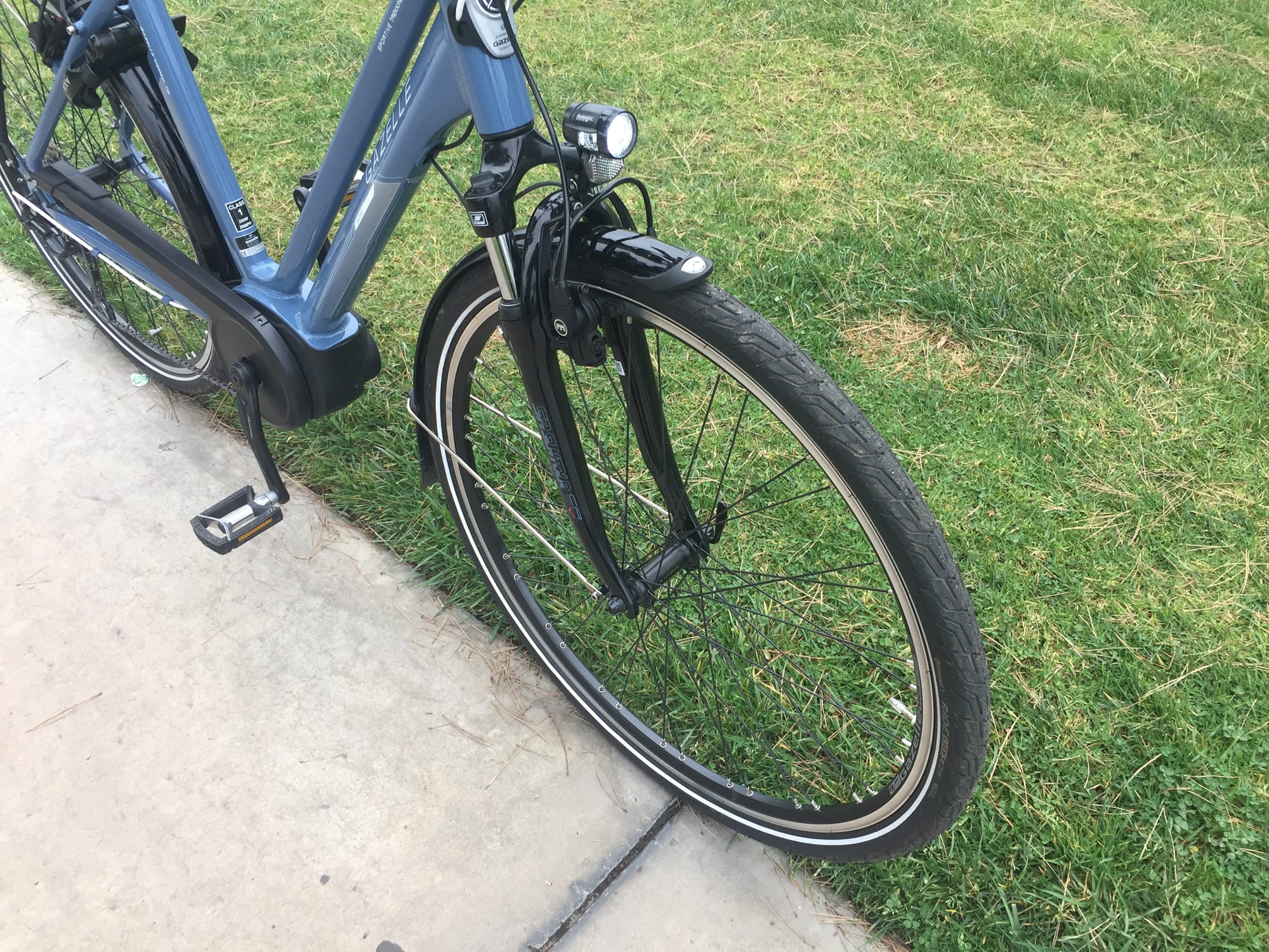

- Excellent safety features, you get reflective puncture resistant tires, nice LED lights that are powered by the rechargeable ebike battery, the headlight has side windows to keep you visible from more angles, and there’s a durable flick bell to signal fellow riders and pedestrians

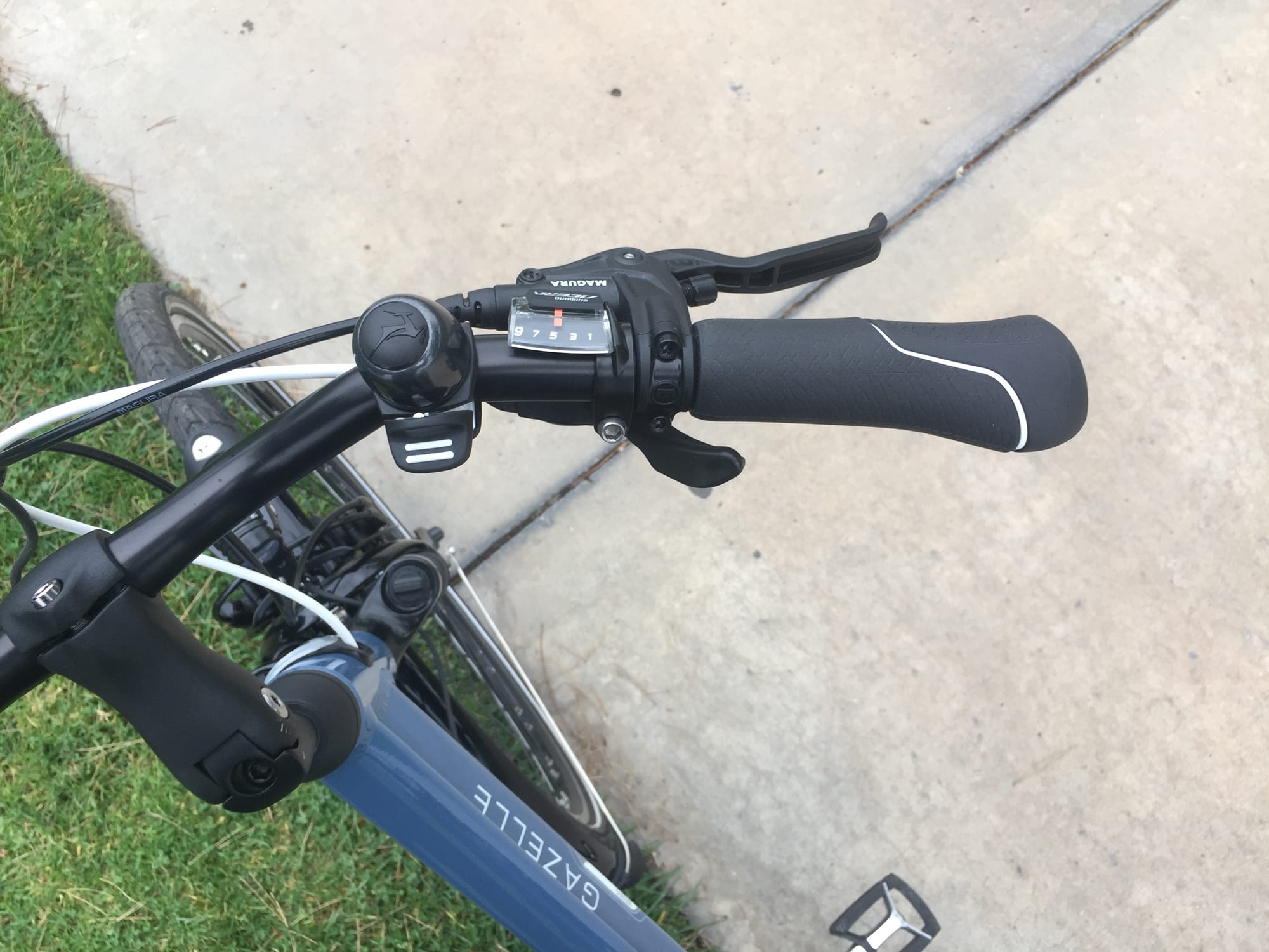

- Hydraulic rim brakes are easier to pull than mechanical, the Magura HS22 levers offer tool-free adjustable reach, and they won’t get damaged at bike racks as easily as disc brakes because of the high position

- Plastic fenders keep you dry and clean, both have flexible rubber flaps at the end, and the front fender is extra long to shield your shoes, the plastic chain cover protects your pant legs and dress ends
- Very nice Shimano Deore derailleur with 9-speed drivetrain, you should have no problem climbing or hitting and maintaining the maximum supported top speed of 20mph (32km/h) as long as you switch gears effectively

- The Bosch Purion display panel is effective and easy to reach, but it isn’t removable and some menus have been removed as compared to the larger Bosch Intuvia, remember to hold plus to activate or de-activate the lights and hold minus to cycle through menus, the Micro-USB port is only for diagnostics and not charging

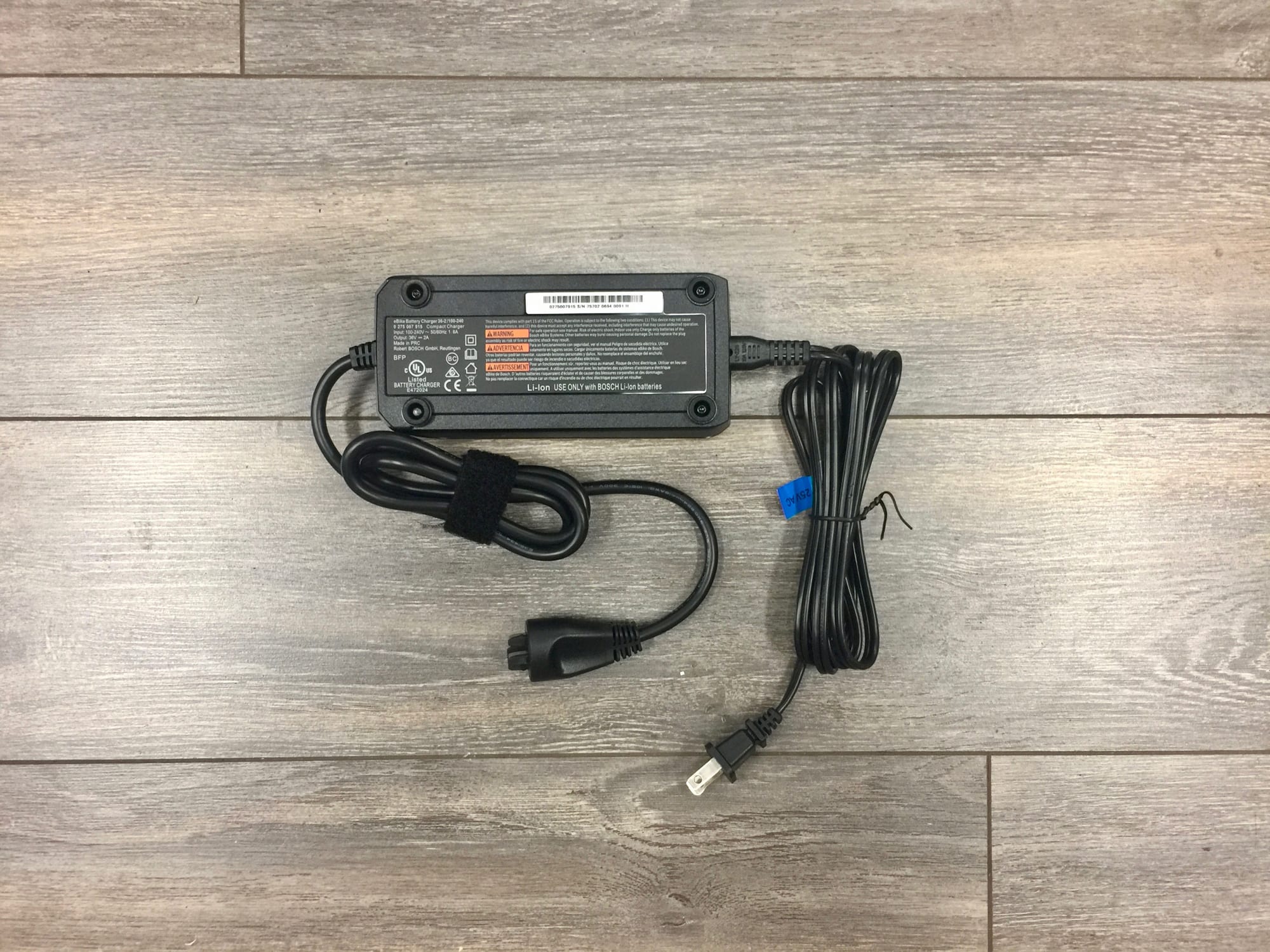

- To save money, Gazelle stocks the slower 2-amp Bosch travel charger with this model vs. faster 4-amp that comes with most of their other electric bicycles

- The Bosch Active Line motors have a bit of “clunk” feeling when you stop pedaling, I think this relates to the gearing inside that produces friction when you pedal backwards… there’s some momentum built up that doesn’t stop as smoothly, but at least it freewheels efficiently without any reduction gearing drag
