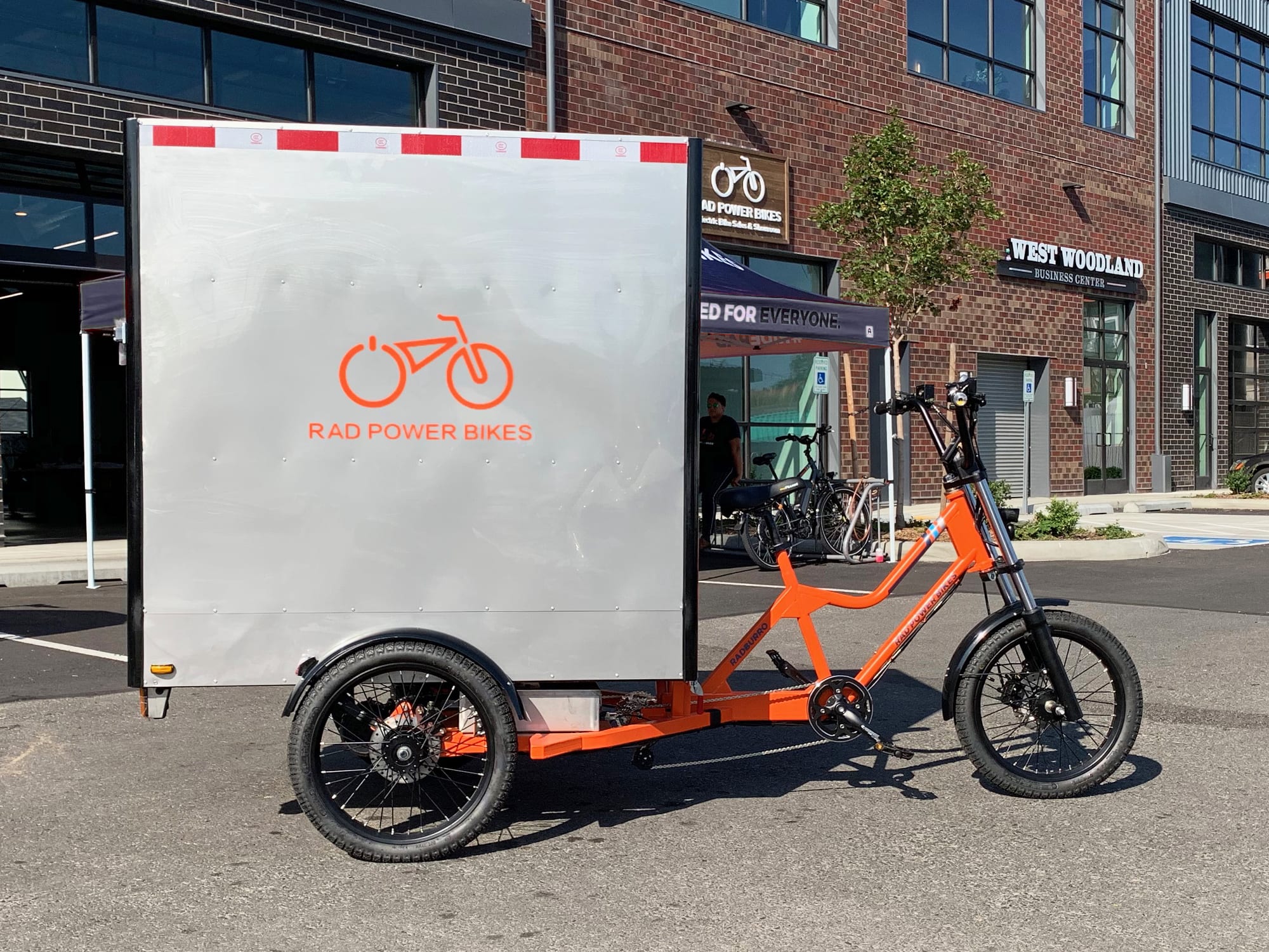

In late 2017, I was invited to Seattle, Washington for some reviews with Rad Power Bikes, including the first version of the RadBurro, which you can see here. I was impressed with the power, versatility, durability, and price point of the electric trike, but came away with the understanding that it was designed more as a commercial/industrial tool than a consumer-grade electric tricycle. I was told that it could be used as an electric pedicab, mini truck, or protected cargo mover, depending on the attachment or attachments ordered. The base unit is priced at $5,799 and each attachment adds between $700 and $1,200… In many cases, customers have ordered additional attachments so they could use the RadBurro for multiple processes. Now that it’s 2019, and the company has a couple of years of sales under their belt, I was invited back to check out the improved RadBurro and discover some of the most popular and unexpected applications that it’s being used for! As someone who lives in Canada, I was delighted to learn that Rad Power Bikes has sold RadBurro e-trikes to two libraries, including one in Burnaby and Quebec, that are being used as mobile libraries within the community. Another heartwarming application is zoos, which have replaced gas burning golf carts and mini trucks with the lightweight, affordable, clean, and quiet RadBurro. This creates less pollution for guests, less noise for the animals, and fits the conservation mission that many sanctuaries and zoos align with. Another exciting use case is bike and scooter share programs, which use the RadBurro to re-balance their units daily. Sometimes, riders will leave a bike or scooter in a park or way out on a trail, and that’s difficult to reach with a traditional vehicle. As this is a review, I’ll be discussing each aspect of the bike in more detail below, and trying to express the trade-offs or cons that this product brings, as compared to similar competing platforms. That said, it’s kind of unique and off on its own compared to many of the other products reviewed here. With a powerful but adjustable motor, this is technically a Class 2 electric bicycle, meaning that it can be ridden most places that bicycles are allowed. It uses a few motorcycle parts like upgraded hydraulic disc brakes with thick 7-inch rotors, a sturdy double-crown suspension fork, and moped tires… but the 7-speed Shimano Altus derailleur, Wellgo platform pedals, and conveniently placed bottle cage bosses, all had me feeling comfortable and confident as a cyclist. I wasn’t required to get a special driver’s license to use it, and charging was done using a standard wall outlet.

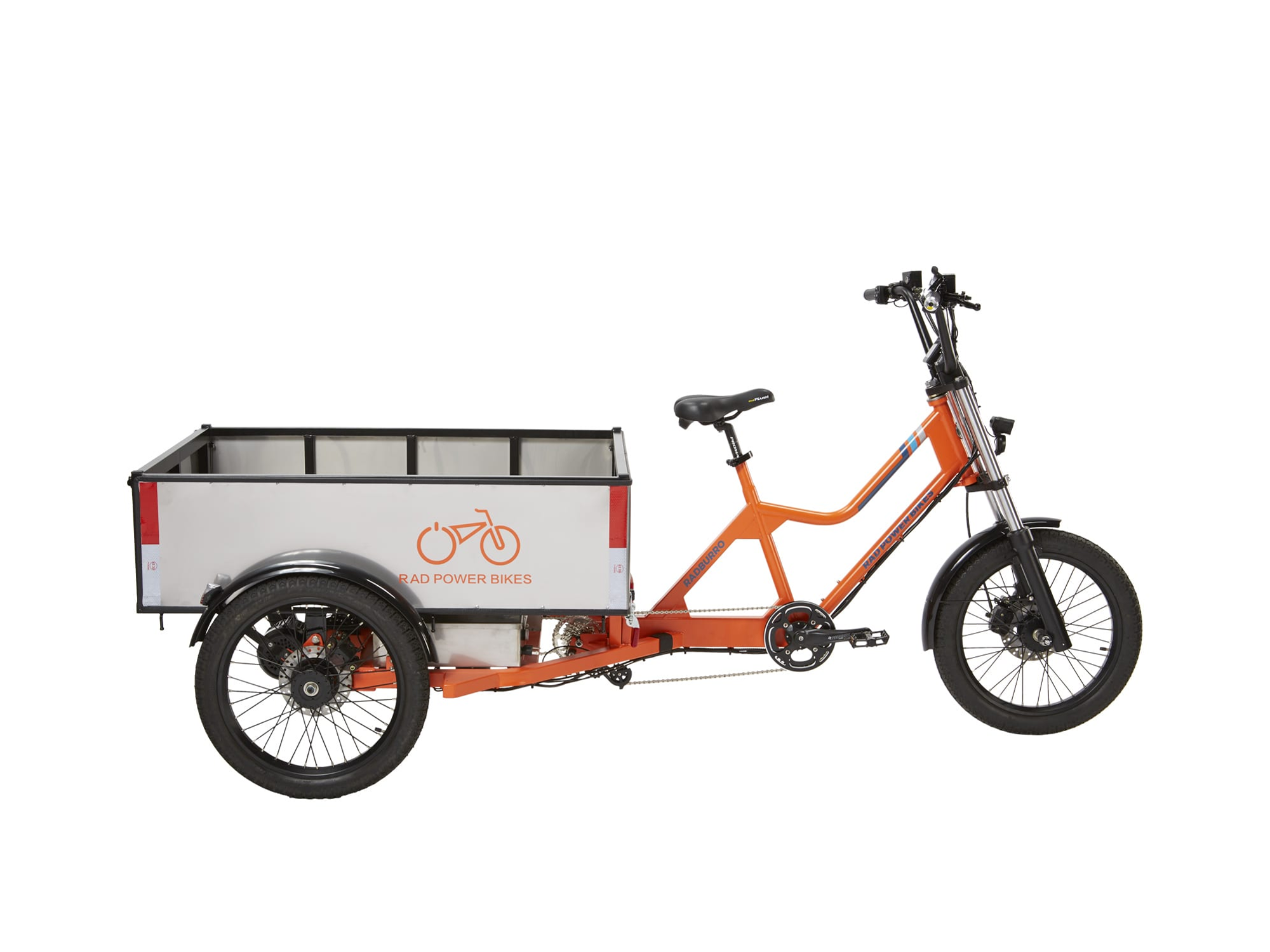

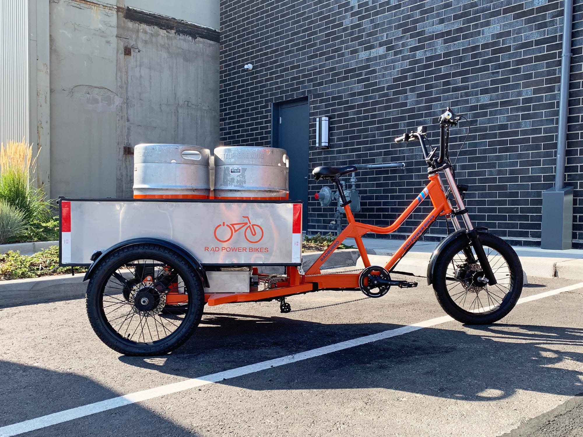

Weighing in at 227lbs (103kg), the base RadBurro platform is made from steel, which provides strength and stability. The main beam of the trike is thicker for 2019 and several gussets have been added to reinforce the mid-step design. These gussets or extra metal plates connecting the frame bars reduce frame flex, which builds confidence when hauling a heavy load! The RadBurro is rated to carry up to 700lbs (318kg) of cargo! Additionally, two triangular protector bars have been added in front of both wheels, so the trike will slide away from walls and other obstacles that might otherwise “hang up” or damage the trike and its operator… these bars reminded me of rock sliders built onto 4×4 trucks that go over rocks, logs, and other obstacles, and they seemed like a great idea for safety and toughness. Other safety points include reflective stickers and reflectors placed on all of the box, bed, and pedicab attachments, thick plastic fenders, integrated lights that run off of the main high capacity battery pack, an electronic horn, and extra-thick 6-ply moped tires that won’t get punctured as easily as traditional bicycle tires. Looking at the RadBurro from 2017 and 2019 back to back was cool, because it really highlighted the frame differences that I think would go unnoticed by most people at first glance. Rad Power Bikes has also upgraded their software, so owners can adjust the top speed down from 20mph for safety, change the throttle profile so it ramps up quick or smoothly, and turn off the reverse function if they wish. The display unit looks like a traditional e-bike display from Bafang or King Meter, but offers some deeper settings and a password feature that could be very useful for safety. I could imagine this trike being used by elementary, and primary schools for maintenance crews, and in fact, Rad Power Bikes did tell me that many universities had purchased them for this very purpose! Again, it’s quiet, clean, and relatively affordable. When I was a young man attending high School in Loveland, Colorado, the maintenance team used golf carts to haul tools around… and it wasn’t always attended. I remember seeing a student tampering with the ignition and actually getting the cart to start up for a little joyride. That’s the kind of situation where a password could really come in handy… along with the two parking brakes built into each brake lever, and the override off-switch on the battery box. These three lines of defense will help keep the RadBurro from turning into an accident, but there is still a little risk that a rider could hop on and disable the brake locks and then pedal around without power, unless the front fork is turned and locked into place. This fourth and final level of defense would be incredibly useful for parking overnight unsecured or in high-risk areas like middle schools and high schools ;)

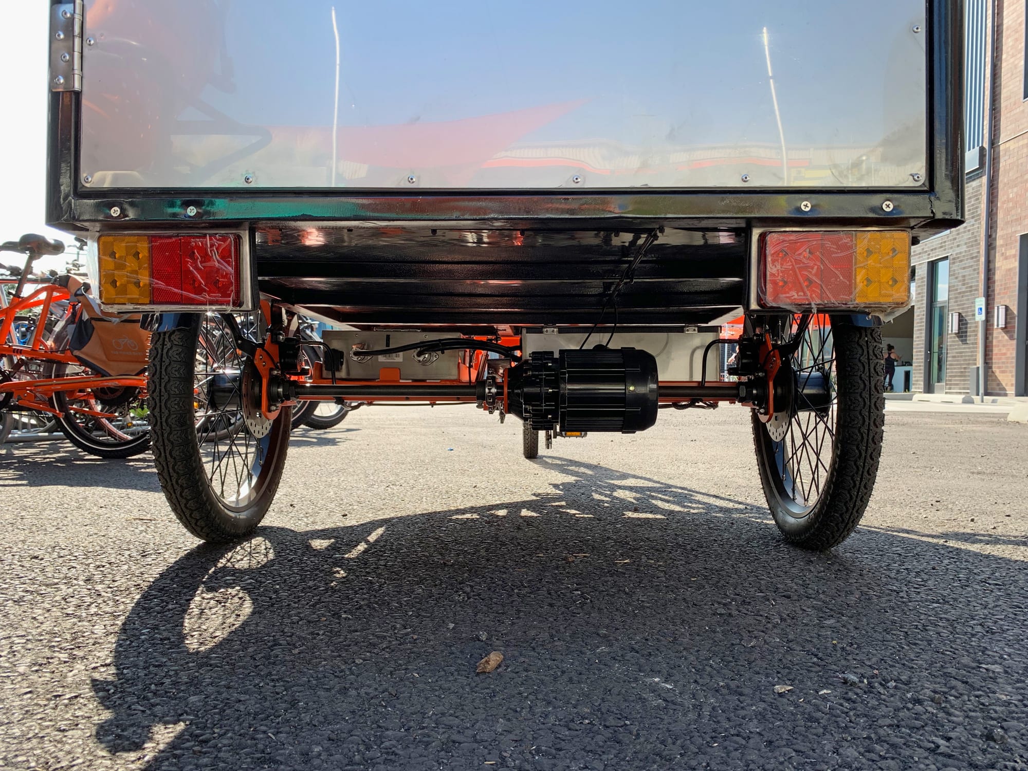

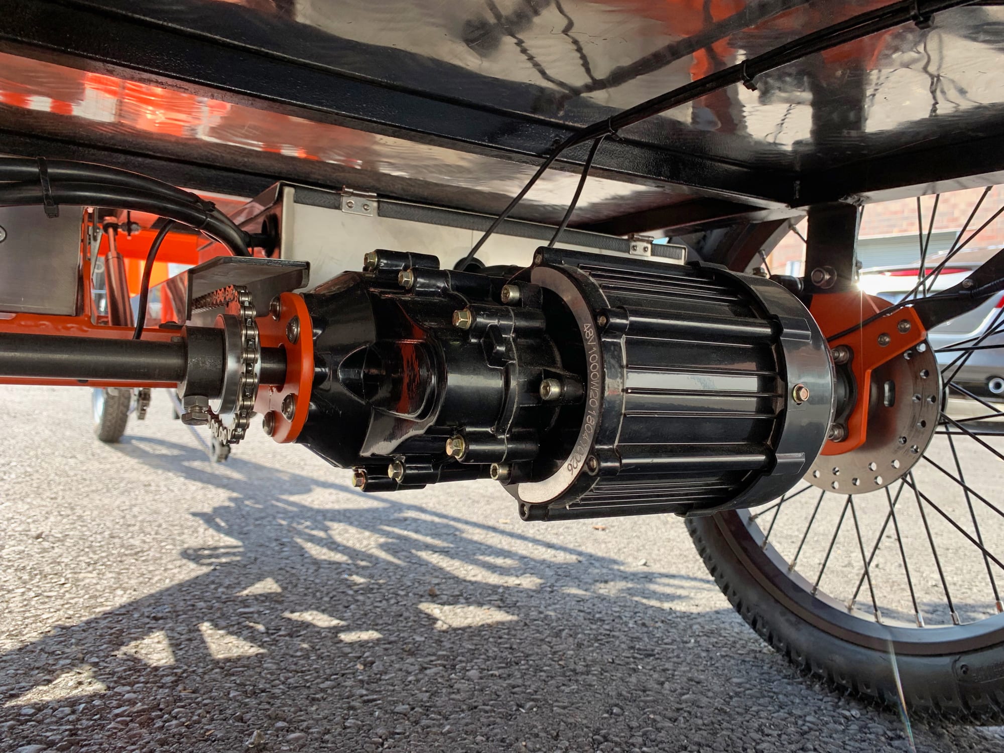

Driving the bike is a canister style 750 watt motor that uses a 10x reduction gear to generate higher torque. It comes on smooth but feels very capable (I hauled a 160lb individual as well as a large load of metal cans through Seattle without issue, while filming) and it’s not super loud… but definitely louder than the smaller electric hub motors used on most of the other Rad Power Bike products. The video overview above has a shot towards the end of the ride test where I actually lean over the back of the pedicab and show the motor in action. I love that it can be operated through the 12-magnet cadence sensor as well as the full-grip twist throttle, so you can pedal to extend range and get a workout. The throttle is critical for starting out with a heavy load, or if you forgot to shift down to lower gears before coming to a stop. Being able to click through seven gears feels nice and allows you to hit higher top speeds or get back to a charging point if the battery is completely spent. That said, pedaling without assist, even in the lowest gear, has you moving very very slowly unless there’s a decline. I have seen some pedicabs that only have one gear and the rider has to stand up and really work to get started. Having 7 gears here means that starting is easier and continuing to pedal is comfortable vs. too fast. This is a bicycle… but the way that Rad Power Bikes setup the drivetrain is very reliable and sturdy. There’s a double sided aluminum alloy chain guide that keeps the chain from jumping off on bumpy terrain, while also protecting your pant or dress ends. There’s a short section of chain leading to the cassette, and then another chain leading back to the rear differential. This two-section design allows for shorter, quieter chains, and the differential allows both rear wheels to be powered by the motor and turn at different speeds as the bike turns around sharp corners. This thing is really well built, from what I can tell. The trade-off might be that this drivetrain is more complex and possibly less durable than a single speed with just one super thick chain, but I’m not completely sure on that, and Rad Power Bikes is known for their high level os customer service and overbuilt products… given the new gussets and upgraded controller, I suspect that this drivetrain is working very well, and that’s why it remains largely unchanged since the original model. The Altus derailleur and shorter front pedal-chain should work reliably and is easier to reach and service than many of the consumer grade trikes I’ve tested from other companies. It’s mounted further forward on the chassis and is accessible if you tip up or remove the box, pedicab, or truck bed attachment. I absolutely love this tilt feature because it also exposes the controller box, battery box, and would make cleaning the bed much easier. I show this feature in the video review when we look at the battery.

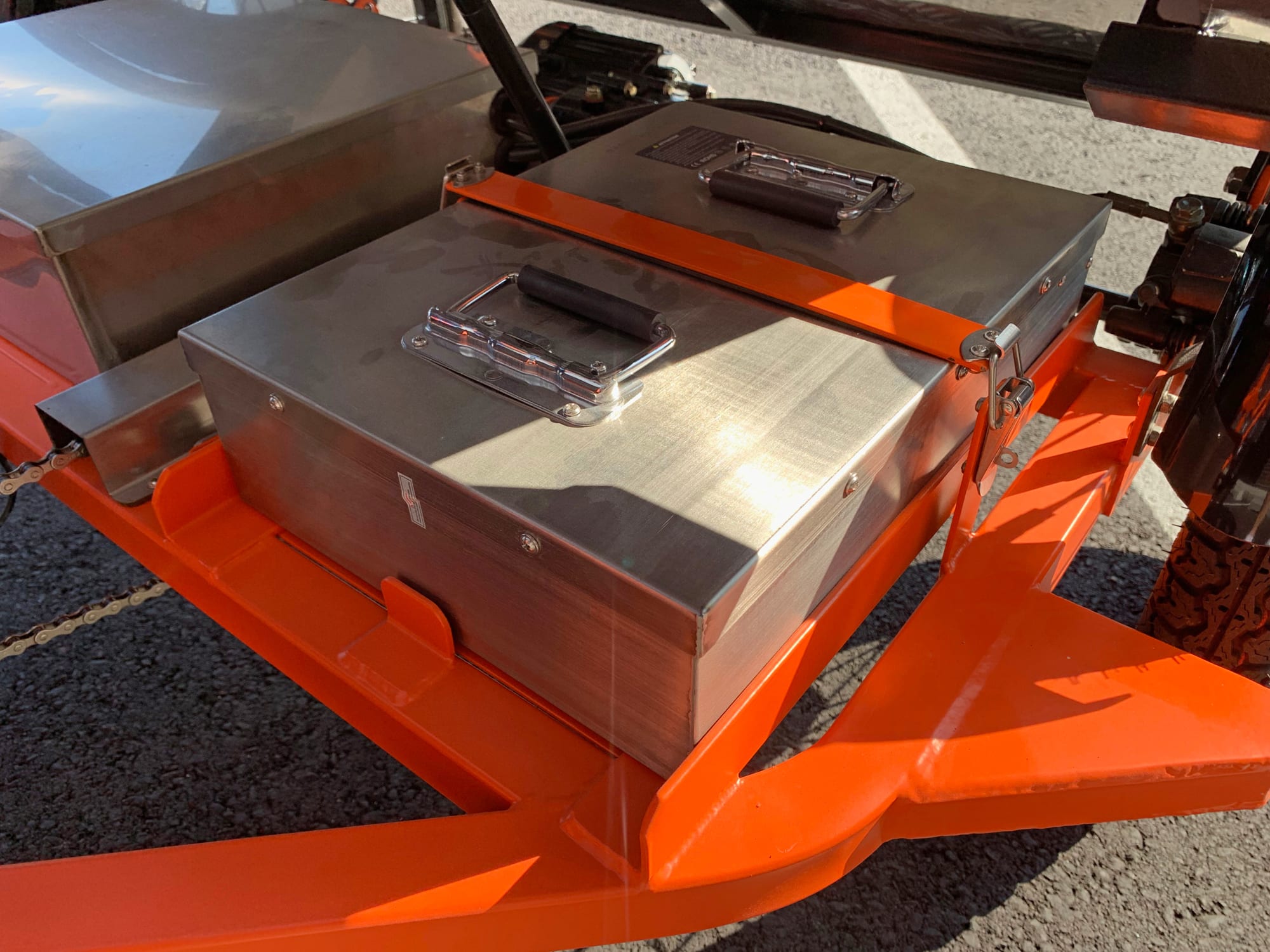

The battery pack on this bike is pretty intense, offering 48 volts and 52.5 amp hours (compared to 11.6 or 14 amp hours on most standard sized ebikes) it can assist from 40 to 80 miles depending on the terrain, cargo load, and rider input. Charging is easy with the onboard 25 amp system (a standard ebike charger is usually 2 to 4 amps) and the built-in retractable cord won’t get lost or broken the way a separated charger might. It’s amazing to think that in just 2.5 hours this ebike could be back on the job, because I’m used to much smaller batteries taking 4 to 6 hours for a full charge. Rad Power Bikes also sells a stand-alone charger, so the battery can be filled when off the bike, and the charger was designed to be able to replace the onboard charger if it were to ever break. Very cool and thoughtful design. And, for those who are really in a hurry, the battery box can be unplugged and swapped out easily for a fresh pack. Unplugging the pack takes a bit of reaching, but the ports have spring covers which should keep them from getting damaged or wet, it feels industrial and well thought out, but accessible. It’s best to store Lithium-ion battery packs in cool, dry locations when possible. Extreme heat can limit the number of full lifecycles they get and extreme cold will limit how much range you get for any particular charge. For driver, the large battery means that a bright color LCD, integrated lights, and even their own accessories can all be used without any separate accessories or adapters. Just below the display panel there’s a USB Type A port which offers 5 Volts at 1 Amp, and Rad Power Bikes sells a handlebar mount phone holder, so you could use your phone for GPS or messaging during the job. I was able to use the display effectively, but felt that the screen was a little hard to read at moments when the sun was really bright. It can be angled a bit to adjust glare but is not removable. I mentioned the integrated front and rear lights before but want to call out that the headlight is very bright and adjustable with two beams, and the rear lights have brake light activation so they go bright whenever you pull either of the brake levers! The left lever activates the single front brake while the right activates both rear brakes. And, because the brakes are hydraulic, they are easier to activate and the two rear brakes apply pressure very evenly. Please note that the extra long levers have brake latches to secure the trike when parked, and this is what I was referring to as a parking brake earlier in the review. I had to use two hands when locking the bike with these “parking brakes” this way but it stayed put with a heavy load, even on slanted ground. Again, the final step is to turn and lock the front wheel using the key.

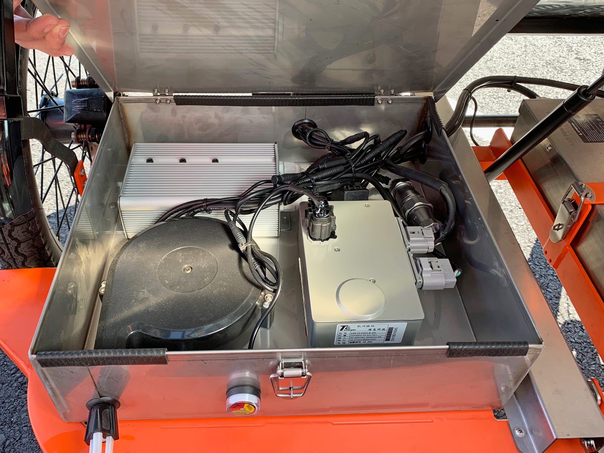

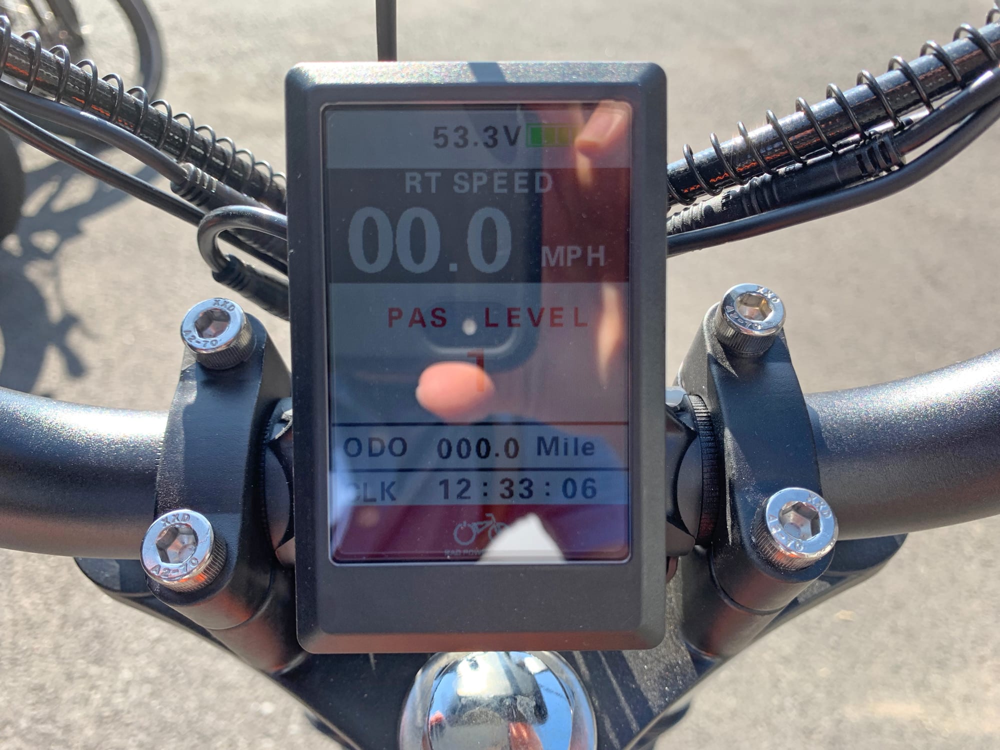

Activating this electric utility bike is a two-step process. There’s an override breaker switch on the battery box that must be turned on before the display can be activated through the control pad near the right grip. This is a good safety measure, which could reduce tampering, but takes some extra time to do. I hopped on a couple of times without remembering to turn the trike on and then had to get off and walk back and around. Part of me wanted a keyed ignition up front for this first step, just to be more convenient, but that would add even more clutter to the handlebars. I’m not used to having so many buttons up front like this, at least on bicycles, but they are positioned well and feel intuitive once you’ve been introduced… the buttons are well labeled. Once the trike is turned on, the control pad on the left will turn on the lights and activate the left or right turn signals. Press once to turn them on and then again to turn them off. I wouldn’t mind a chirp for the turn signals or when you go in reverse, and frankly, I would like to have brighter rear lights and larger brighter turn signals. The rear light units each have a single yellow LED inside for turn signal use, and and are mounted to the fenders. They stick out just barely enough to really be seen when the big box is being used and I feel like they could be higher up. The headlight is aimable and fairly bright, but it’s mounted to the suspension bridge vs. the handlebar or headset, which means it’s not as high up and could bounce if you’re driving over rough terrain. The housing for all of the lights is plastic, and seems less industrial than some of the other parts used here. Since I’m a safety nut, I feel like the lights are one area where the trike could be improved in the future, but at least the ones they currently use would be cheaper and easier to replace if they were damaged at some point. The fenders are also plastic and offer good coverage. They will bend slightly if bumped and then snap back into position, they won’t get permanently bent or rust like aluminum or steel, but this is a great time to remind you about the steel frame and keeping an eye out for scratches over time. I’ve heard that clear nail polish can be used to coat damaged sections or some orange automobile touch up paint. So the display panel itself can be explored by clicking the up and down buttons on the right side button pad. This allows you to go from zero to 1-5 pedal assist for more speed and power. The high resolution 12-magnet cadence sensor doesn’t measure how hard you push, just that you’re pedaling. This is nice for such a large and heavy vehicle because it means that the rider can get some exercise but not strain themselves excessively, trying to get the motor controller to respond. I do feel like Rad Power Bikes could upgrade from the exposed 12 magnet sensor to a sealed 14 magnet sensor as used in some of their newer consumer models. Both brake levers do have motor inhibitors so you won’t ever be fighting the motor when stopping, even if you keep moving the pedals. Overall, the cockpit is functional and the display is easy to read and navigate, despite being a bit more complex than the other Rad Power Bikes products. The display is not removable but can be angled a bit to reduce glare. Same thing with the high-rise bars, you can loosen the mount and tip them forward or back to increase or decrease reach, and that should make riding more comfortable for tall and short people. You can even swap out the stock rigid seat post for a suspension post with 27.2mm diameter, or get an extra large comfort saddle if you wish… it’s all compatible with traditional bicycle hardware.

- It’s one of the only electric bicycles that I’ve seen which seems tough enough for regular use delivering parcels, cargo, books, tools, and other “stuff” rated up to 700lbs of carrying capacity. It’s clean, quiet, sustainable, and can qualify for congestion pricing on roads vs. an internal combustion vehicle, it can be parked almost anywhere and is allowed on more paths than a full sized automobile

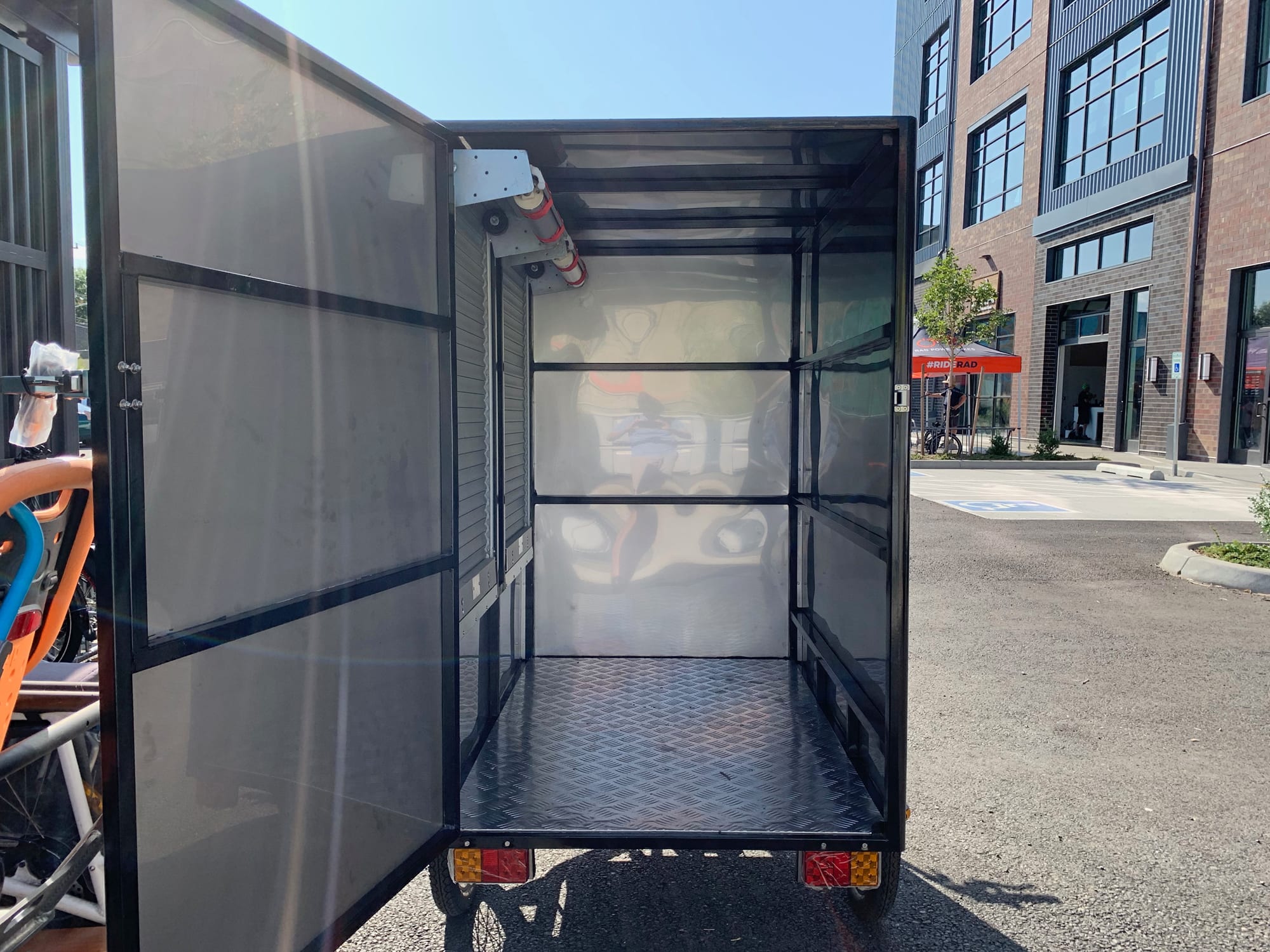

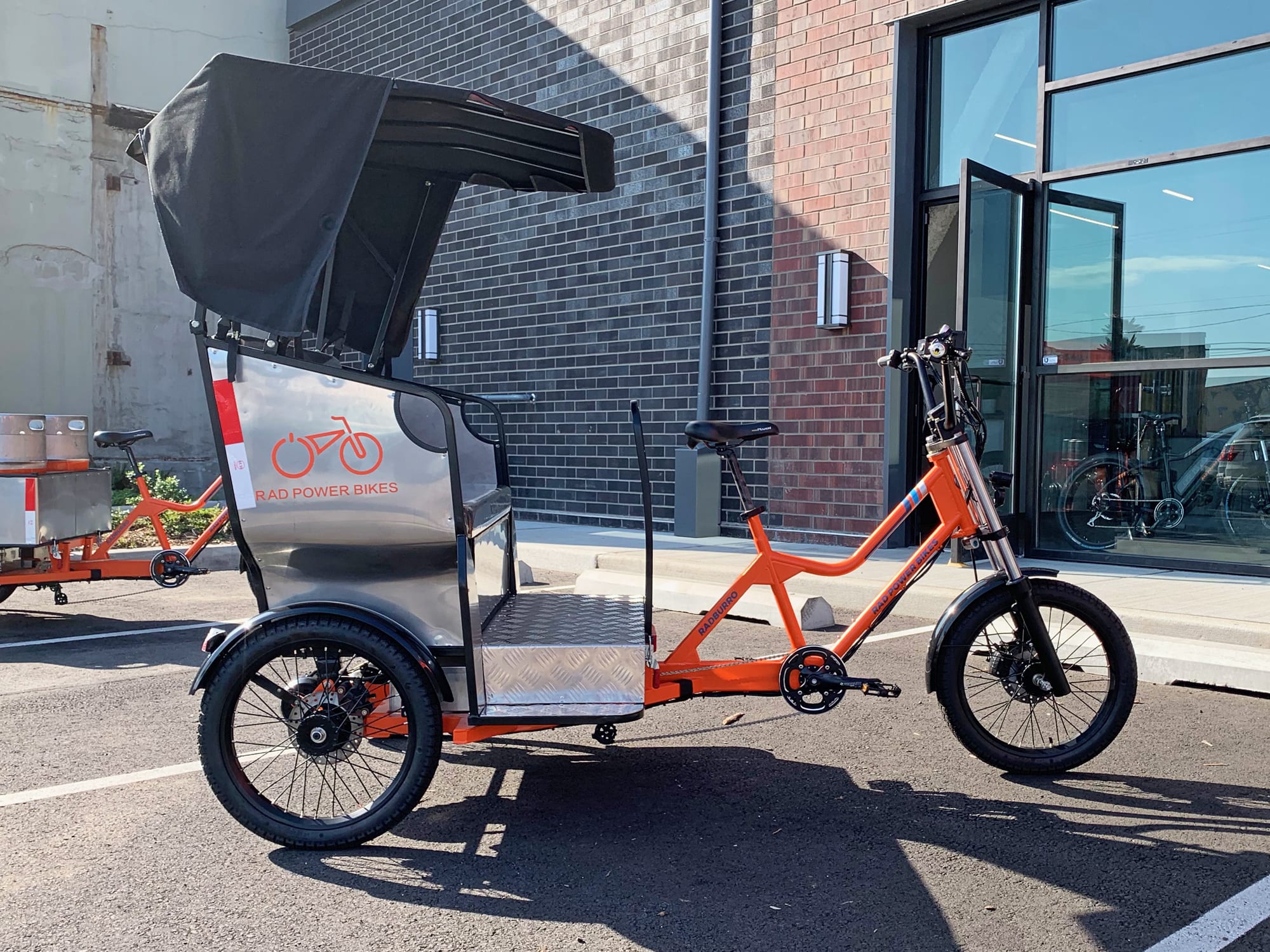

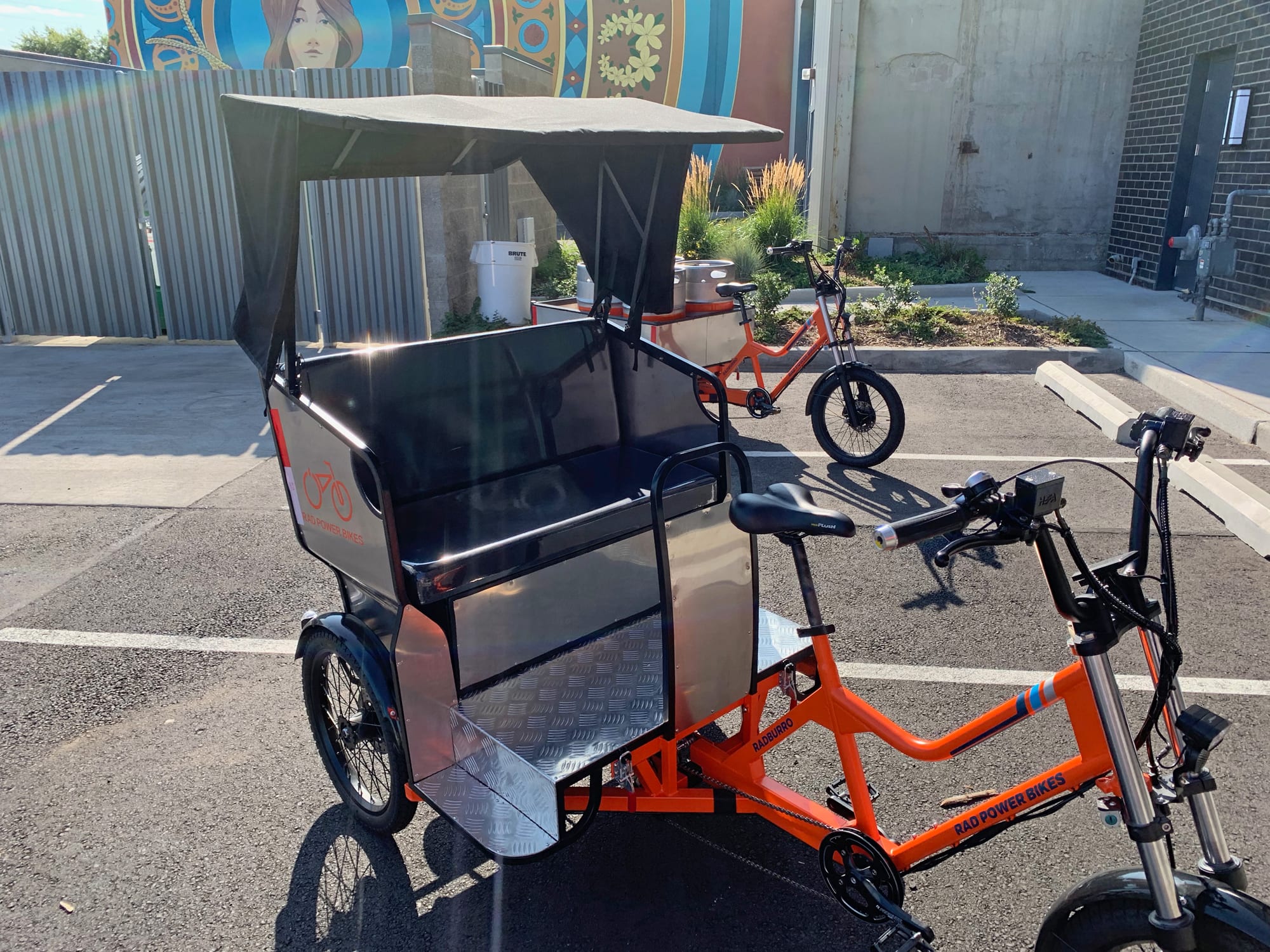

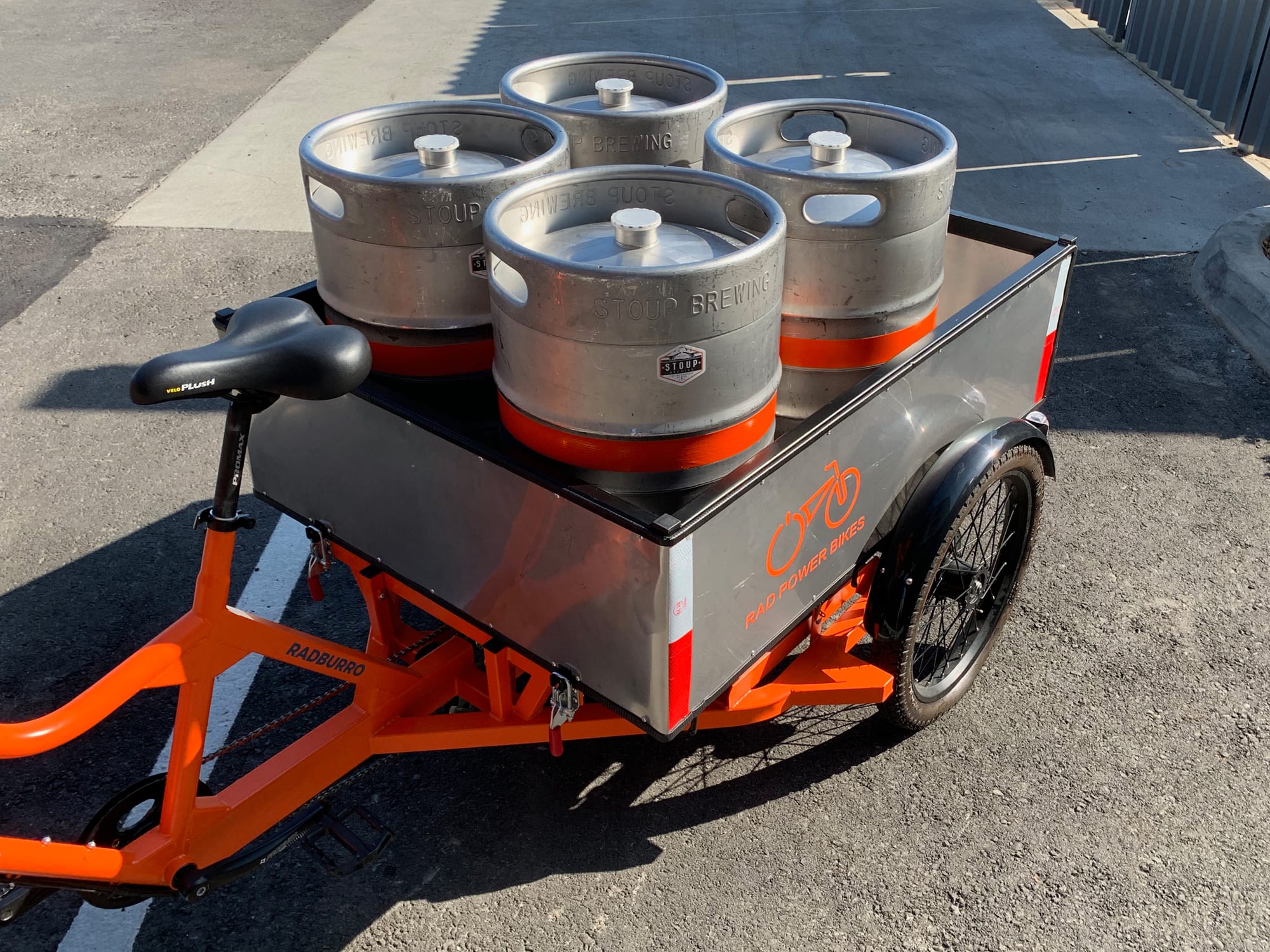

- The fact that you can swap the flat bed for an enclosed truck bed or get an insulated food box or use it as a pedicab people-mover is very neat, the platform is versatile and adaptable, many customers buy multiple batteries and accessories

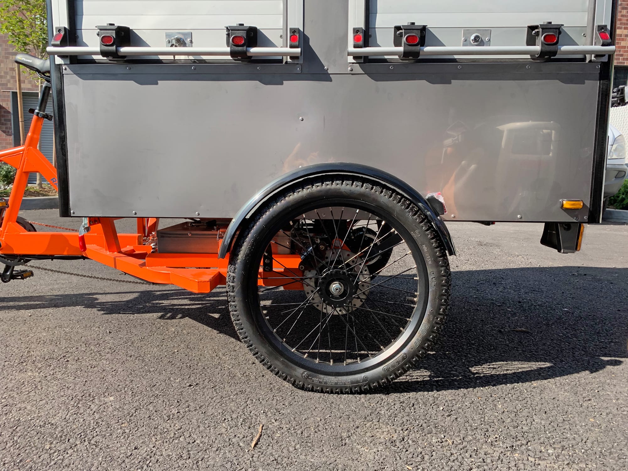

- The fenders worked well on wet streets, I stayed fairly dry under the pedicab awning during my first review of the bike in 2017, and I love that it has integrated lights, bright brake lights, and turn signals

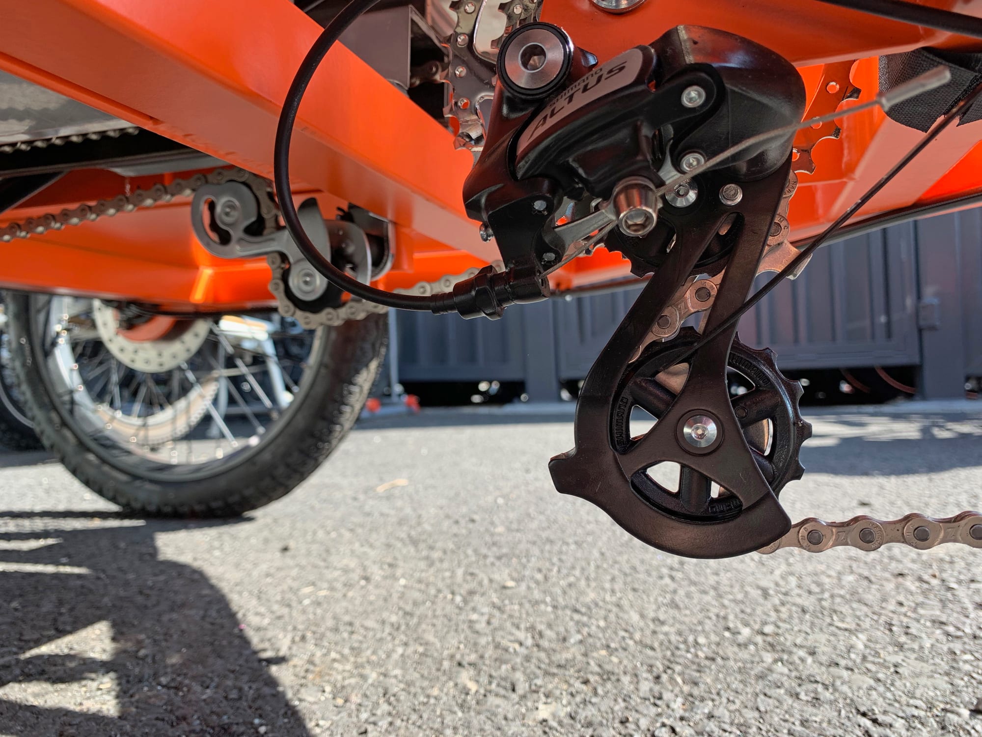

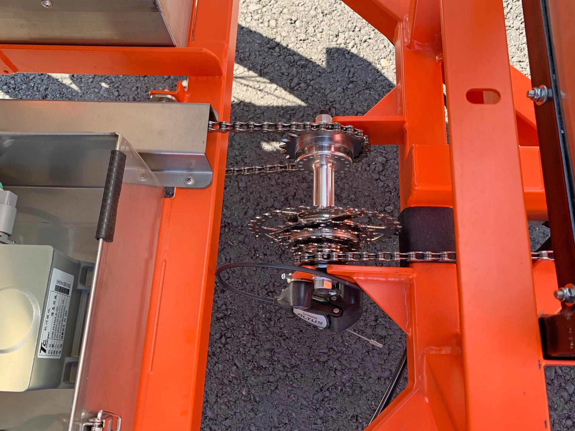

- The drivetrain is a seven-speed Shimano Altus (a step up from entry level) which worked well enough, and the chain wasn’t as long as I thought, which keeps it quieter, I love that the chainring has an alloy guide to reduce drops and keep the driver’s pants clean and that the derailleur is so easy to reach vs. being way back under the bed

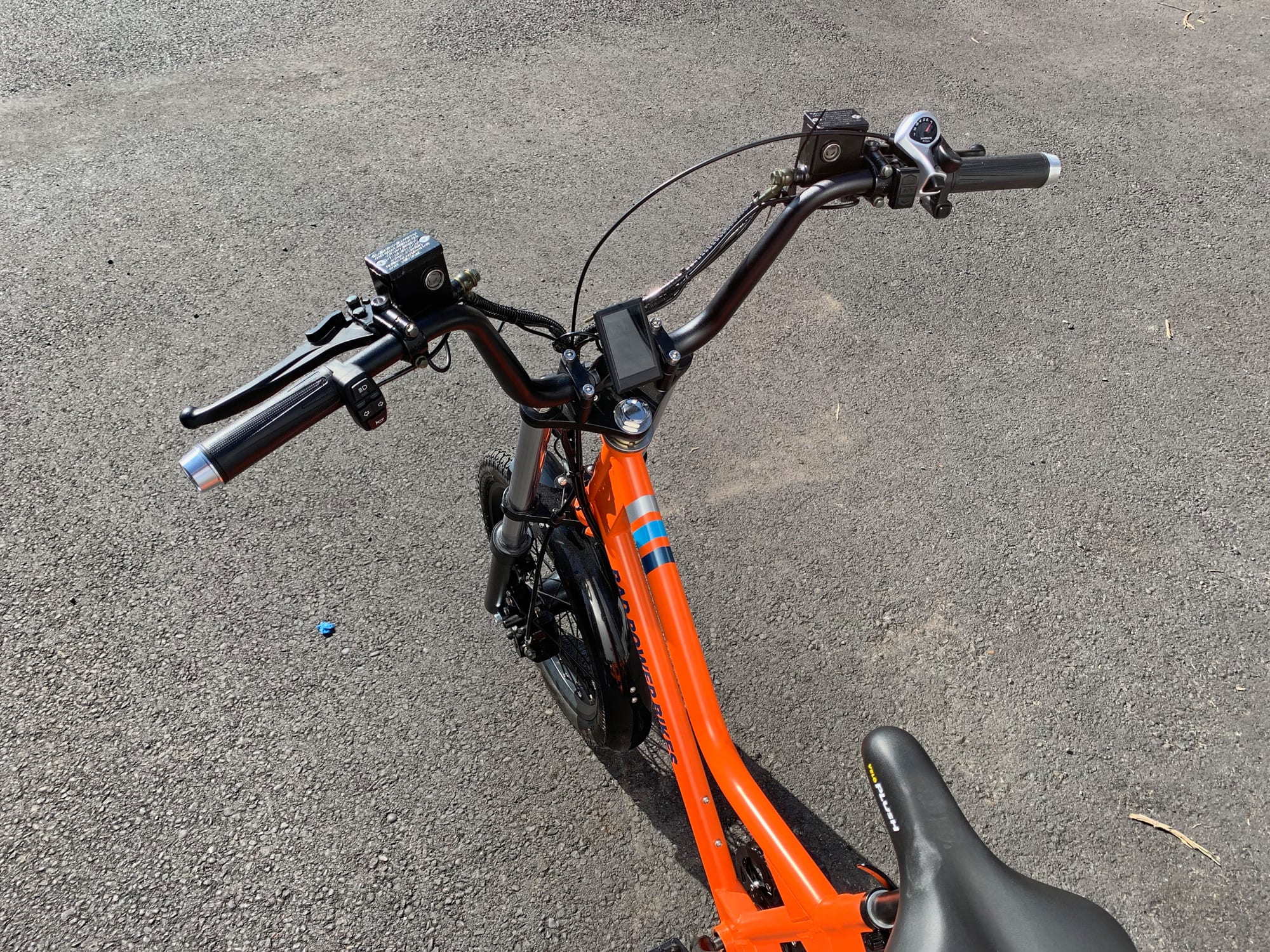

- The display panel provides lots of options and settings so fleet managers can limit top speed and power output, including the ability to change the motor controller profile so it starts quick or more smoothly, I like that it also has a USB Type A port built in to the lower edge so you could charge a smartphone and use it for GPS (and they also sell a decent smartphone handlebar mount holder)
- The onboard main battery charger is a 52 Amp design vs. most standard electric bikes that use just 2 Amp or 4 Amp, it can fill the battery pack in just ~2.5 hours or you can hot-swap a fresh battery for situations where time is limited
- Rad Power Bikes uses Samsung 35E Lithium-ion cells which are a more premium higher energy density cell (saving space and weight)

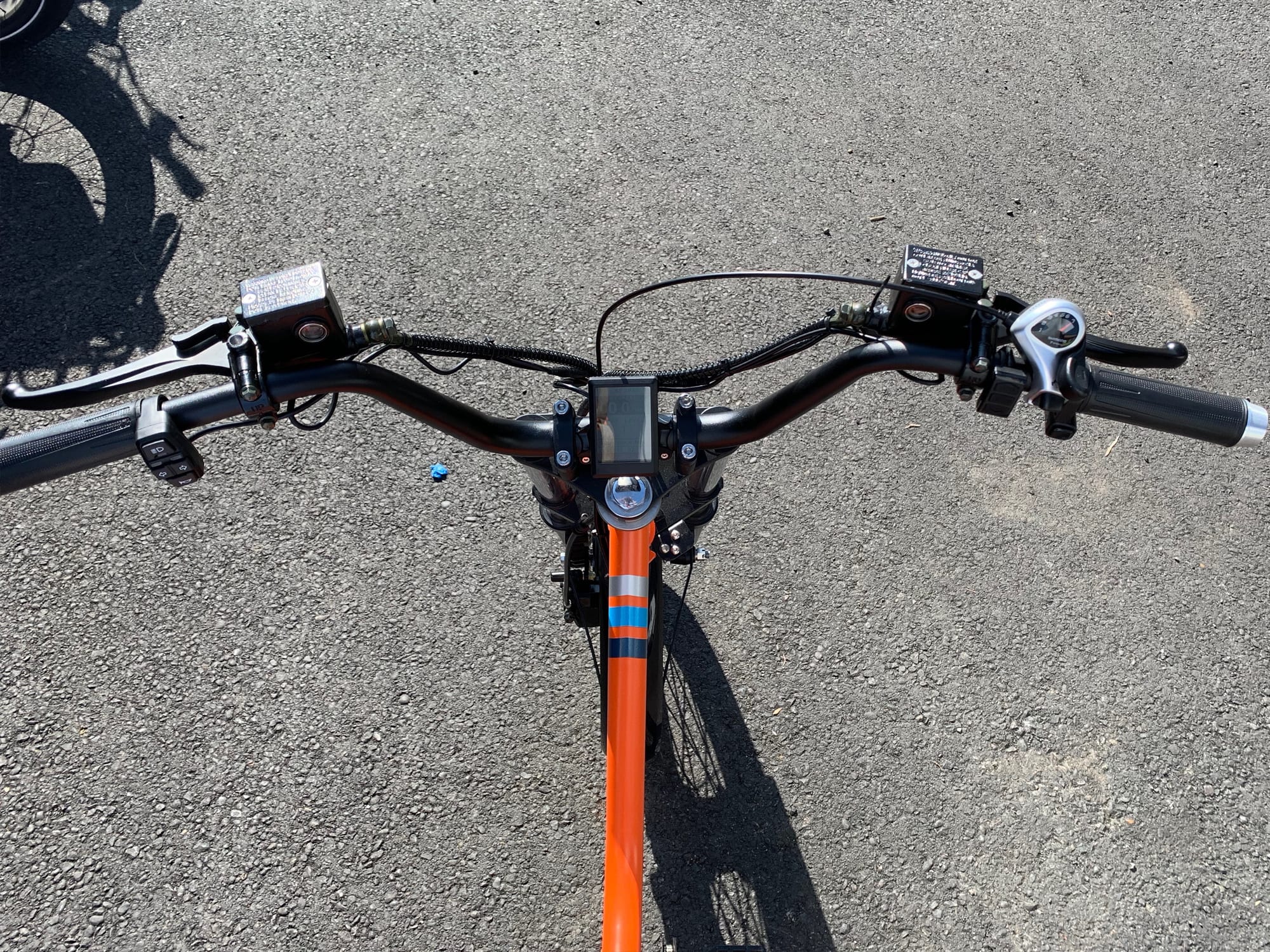

- The throttle is a full-grip twisty style that’s more like a motorcycle, it’s much easier to use with gloved hands than a half-grip twister
- The brake lever housings have standard sized threaded mounting points for side mirrors, like you’d use on a motorcycle, which is a great safety option for operators who plan on riding in traffic

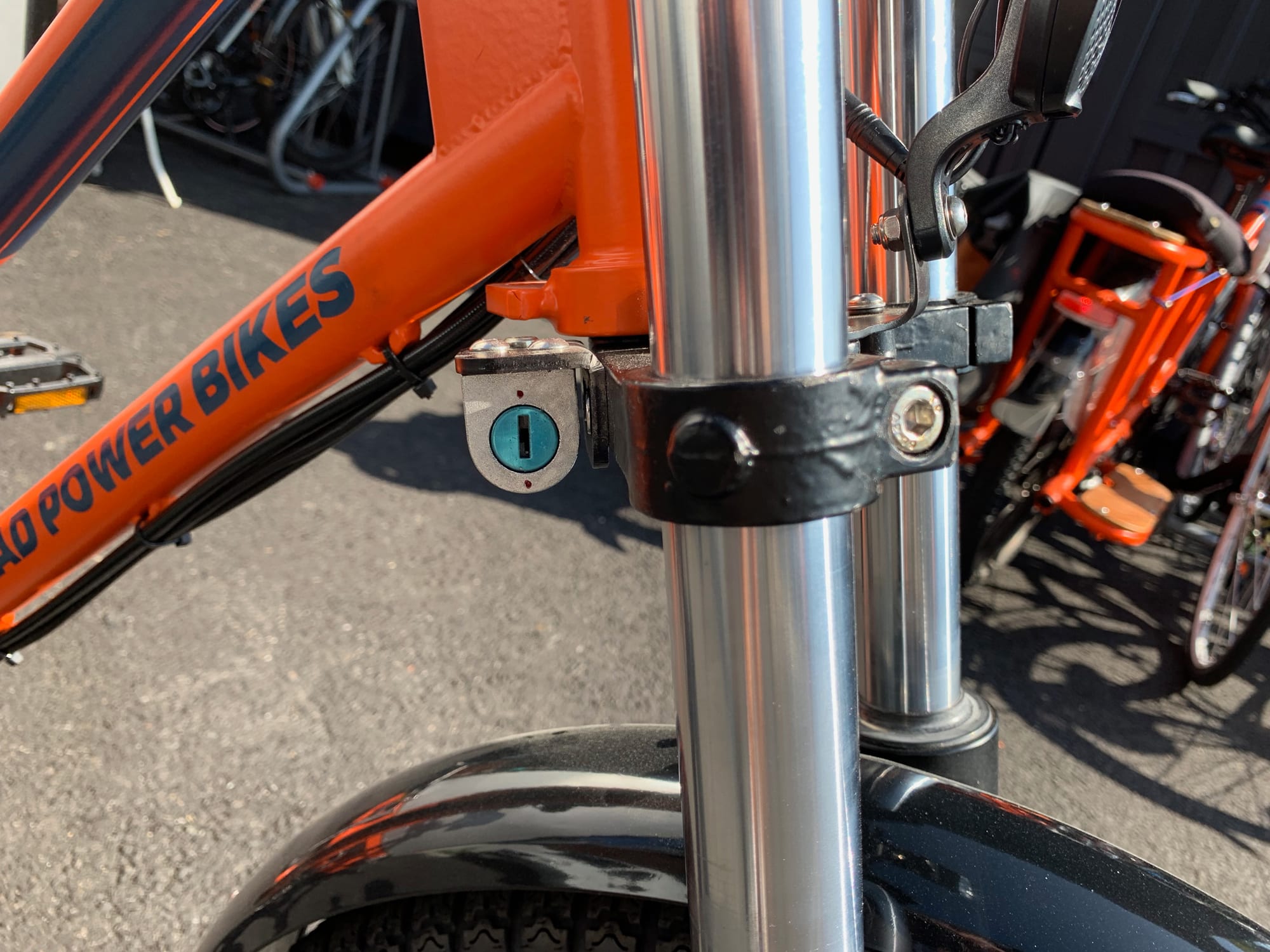

- There’s a primary on/off switch that can be activated or de-activated before the control pad up front will work, this switch is hidden under the bed and can be used to prevent tampering, I believe that the battery box locks in with a key for security here as well

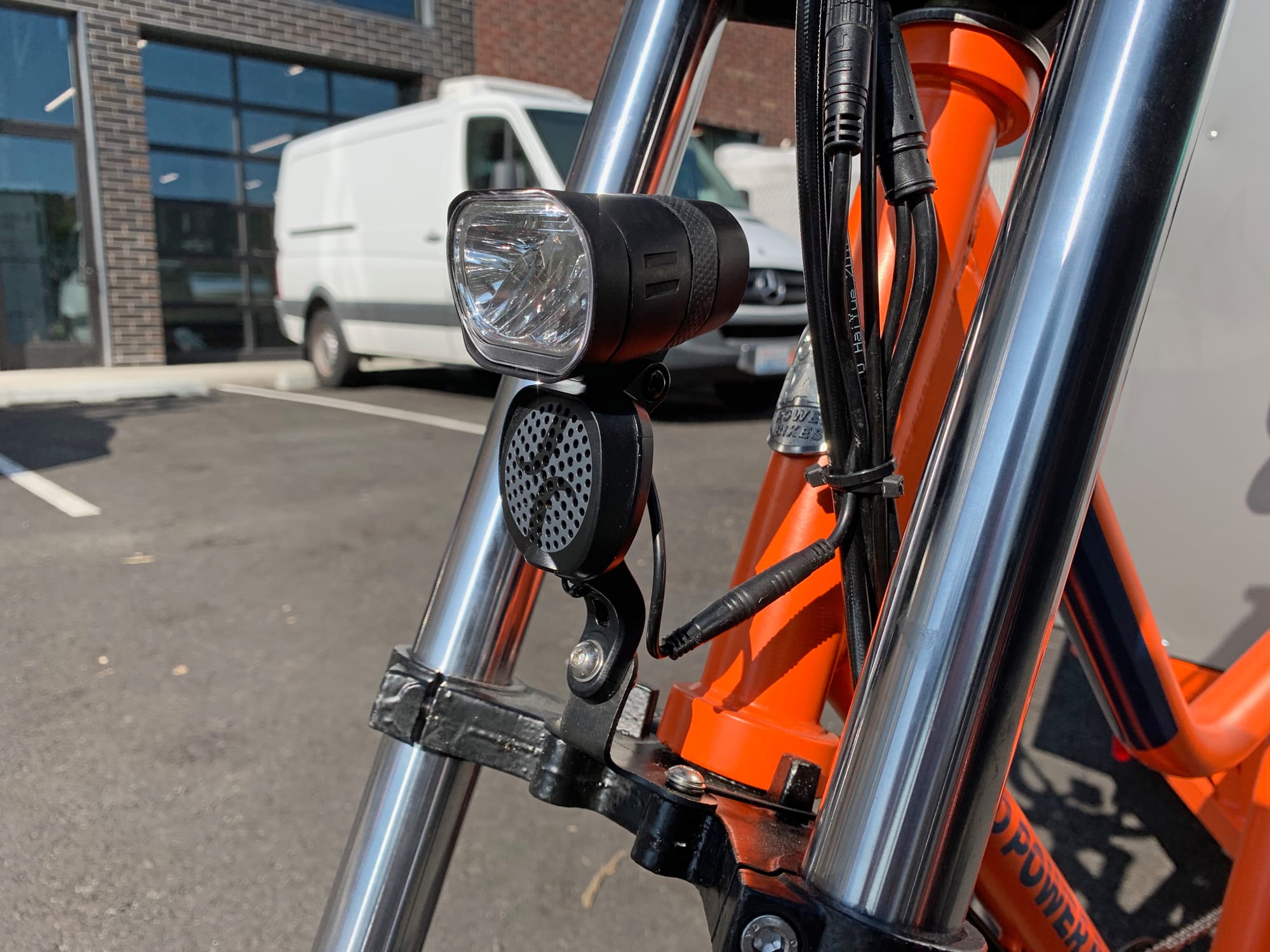

- The utility beds and pedicab have some reflective stickers, and the bike does come with integrated lights, but I feel that the lights could be bigger, brighter, mounted higher up for some applications where this is being used around cars
- I love that this thing has a suspension fork for the driver but found that the pedicab rear seat could get uncomfortable when traveling over large bumps, the seat is padded, it’s just a little rough when the tires are fully inflated and that may be due in part to the smaller wheel diameter (I’m not sure it’s much different than other pedicabs)

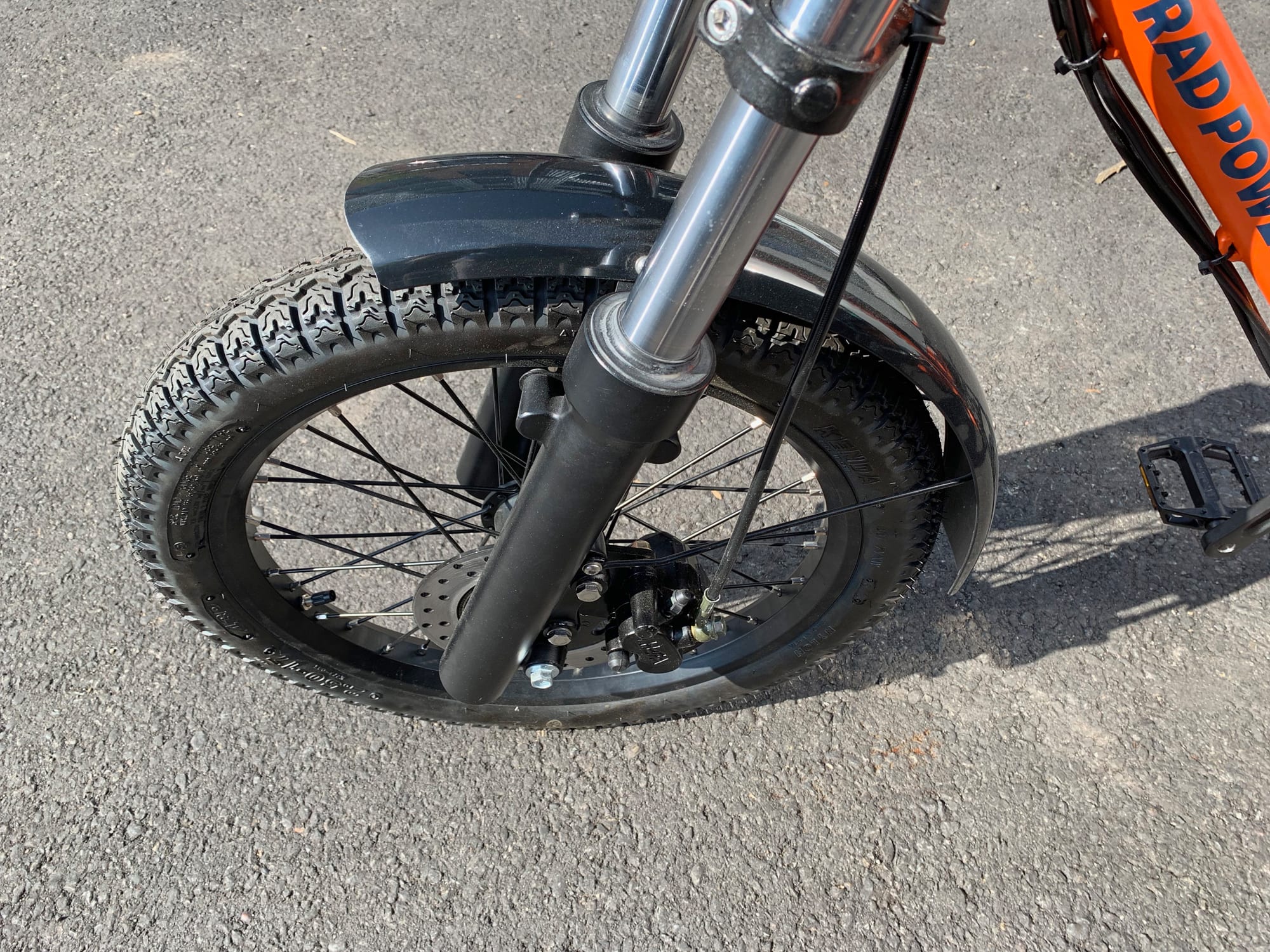

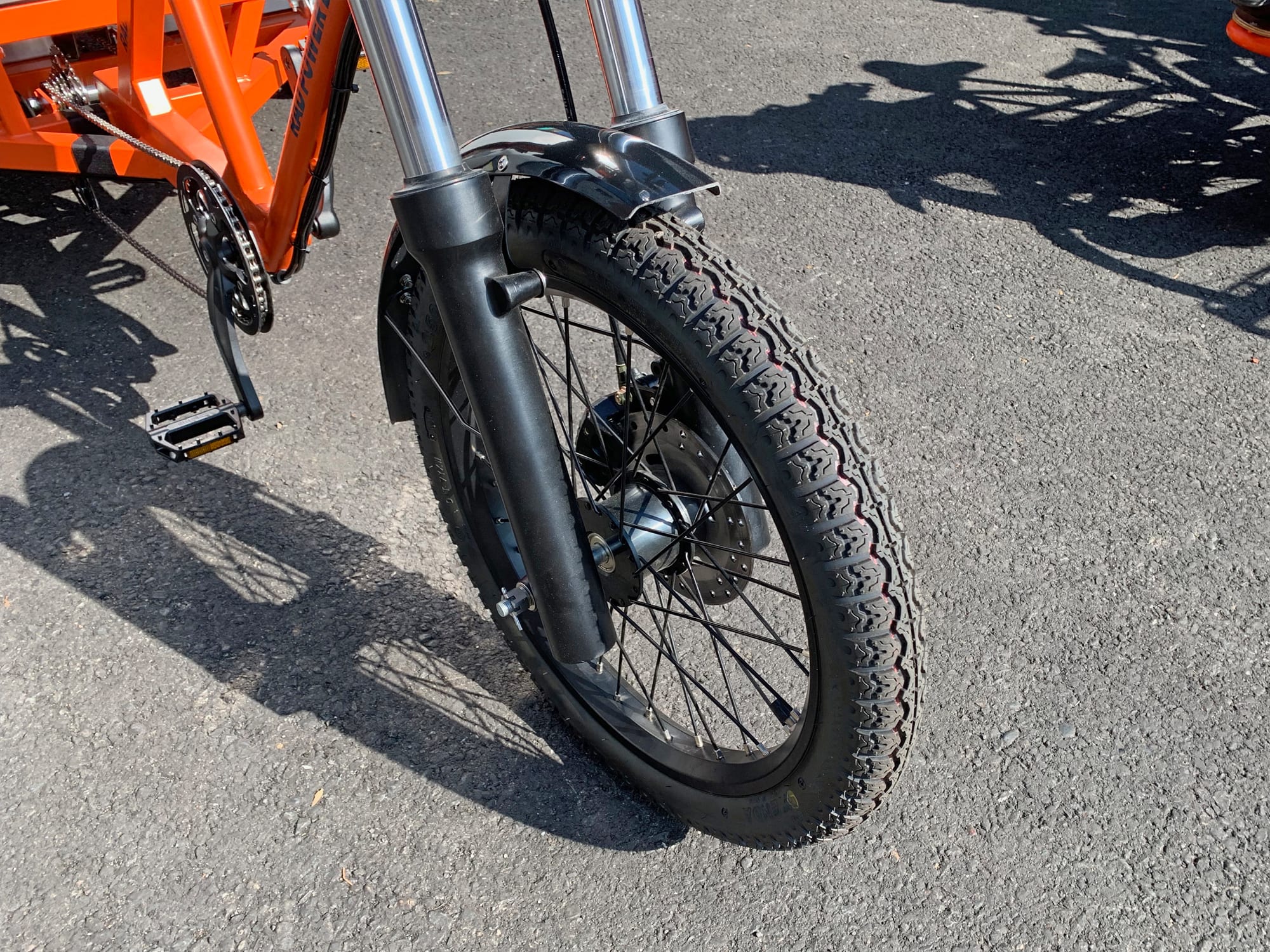

- The larger fork and heavier front wheel and tire require more energy to turn, I struggled a bit when filming with one hand and steering with the other and would recommend both hands on the grips for safest use
- The brakes are heavy-duty and work well for stopping heavy loads but require a bit more hand strength to lock in (for the parking brake), I think this is not unique to the RadBurro compared to similar light EV’s but I had to use two hands to lock them
- The suspension fork doesn’t offer lockout or preload adjust, it’s more like a motorcycle where they tuned it to the weight of the vehicle vs. allowing the passenger to make adjustments… this isn’t a huge con, just something I noticed
