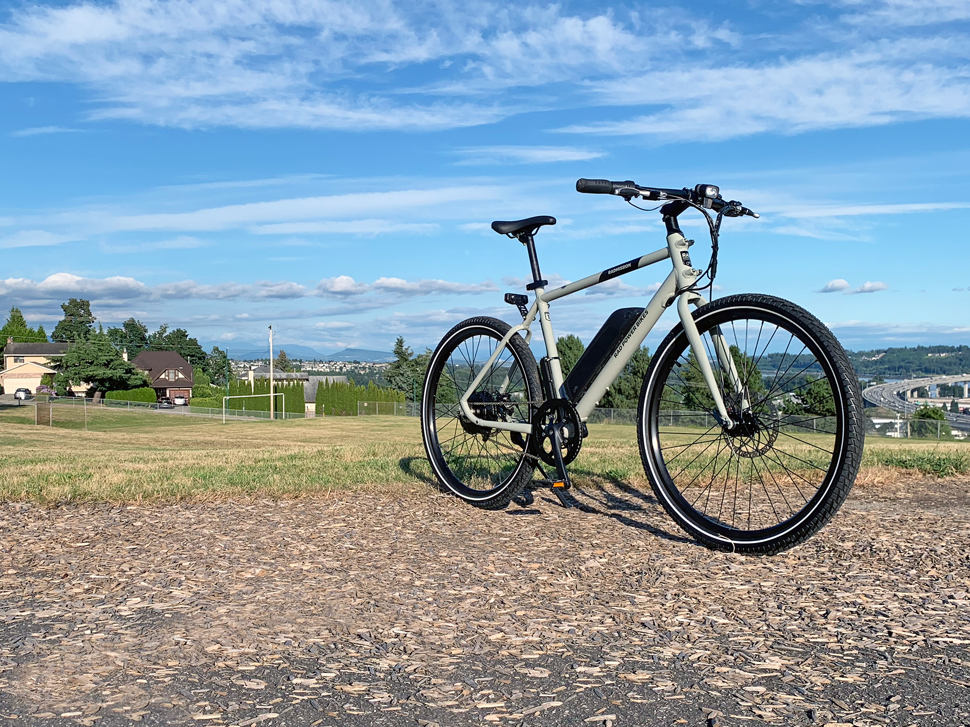

- RadMission is the lightest, most affordable electric bike from Rad Power Bikes to date. For $1,199k USD, I was amazed that they could sell it in two frame styles and sizes (high-step large 20.25″ and mid-step medium 18″). It also comes in six color combinations across the two frame types.

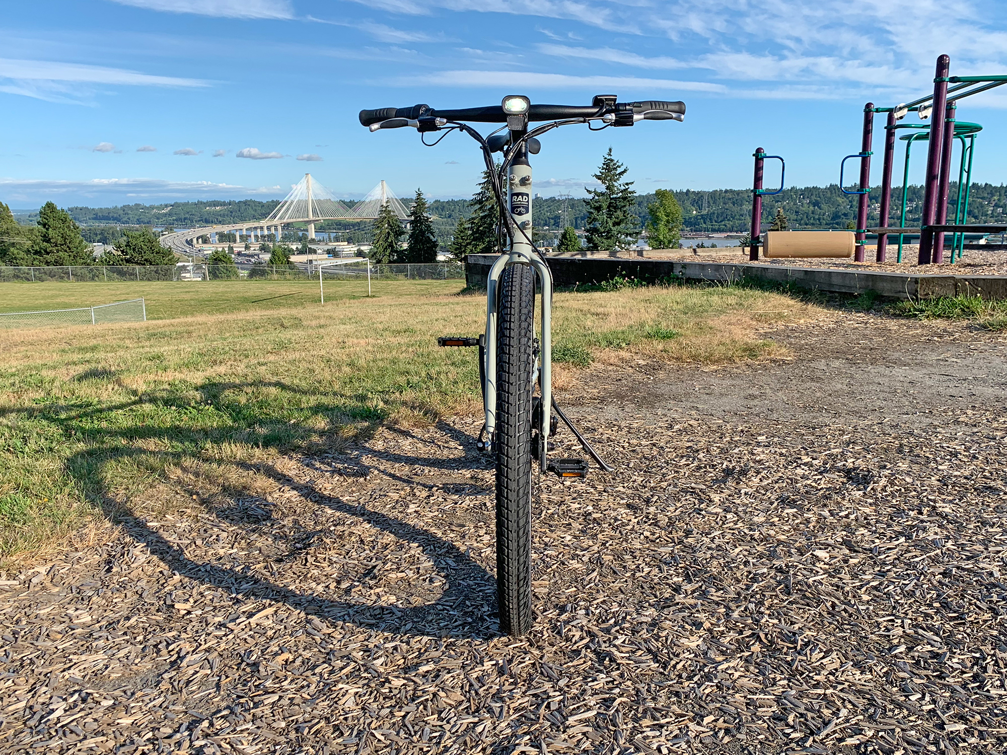

- In its default location, the headlight mounts to the stem (the piece which holds the handlebar). This is awesome because it elevates the position of the light, making you easier to see by cars and other cyclists. I wish that more ebike companies did this, but it required a special part to do right and I wonder if it will still work perfectly if you get their optional LCD display as an upgrade? In any case, I love where the light is mounted on this ebike more than any of their other models, which have it lower down on the arch of the fork.

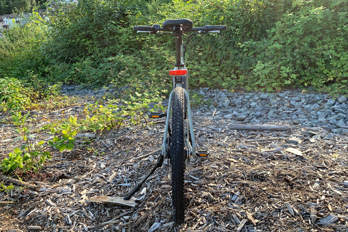

- I’m kind of a safety nut, so I love the reflective tires and quality integrated lights that run off of the ebike battery. The rear light has solid and blinking mode (just press the little rubber button on the lower left edge of the light), and it also goes bright when you pull either brake lever! So whenever you brake, the rear light will actually turn on and go bright if the lights are turned off, or it will go extra bright when the lights are on.

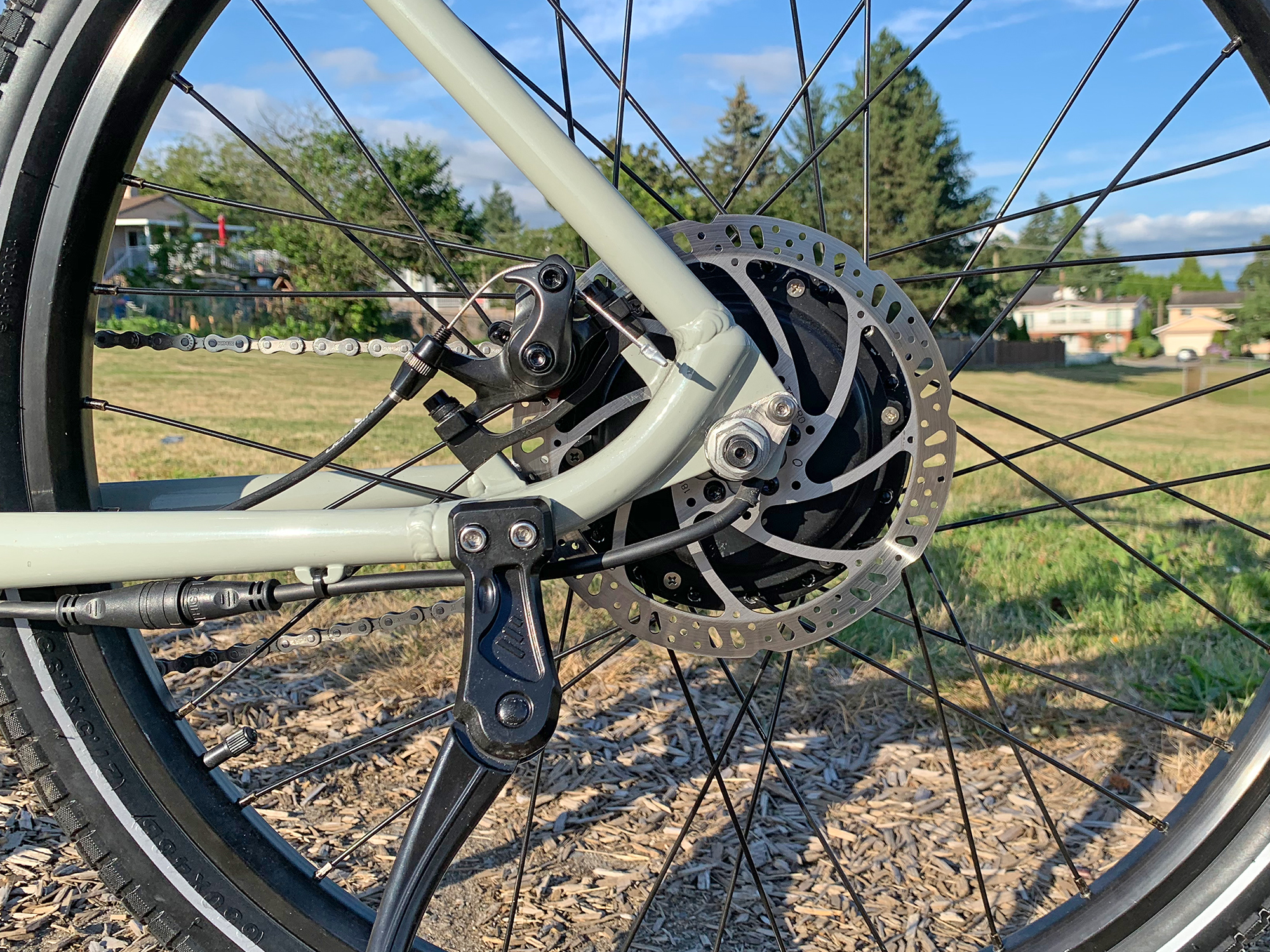

- Most of the single speed bicycles I’ve reviewed are setup with horizontal dropouts for the rear wheel. This allows the rear axle, hub, and cog to be positioned far enough back to create tension in the chain or belt. It can work alright, but often requires additional metal pieces on the frame and horizontal bolts to support and secure the axle… so it won’t slip forward over time. Rad’s vertical dropout design seems a lot simpler, especially when it comes to rear wheel maintenance and flat fixes, but it does require a chain tensioner. Perhaps the weight difference between the two approaches is similar? I feel that Rad Power Bikes did an excellent job with the design they chose and used good hardware to make this drivetrain durable and functional, it doesn’t seem like they took the easy way out.

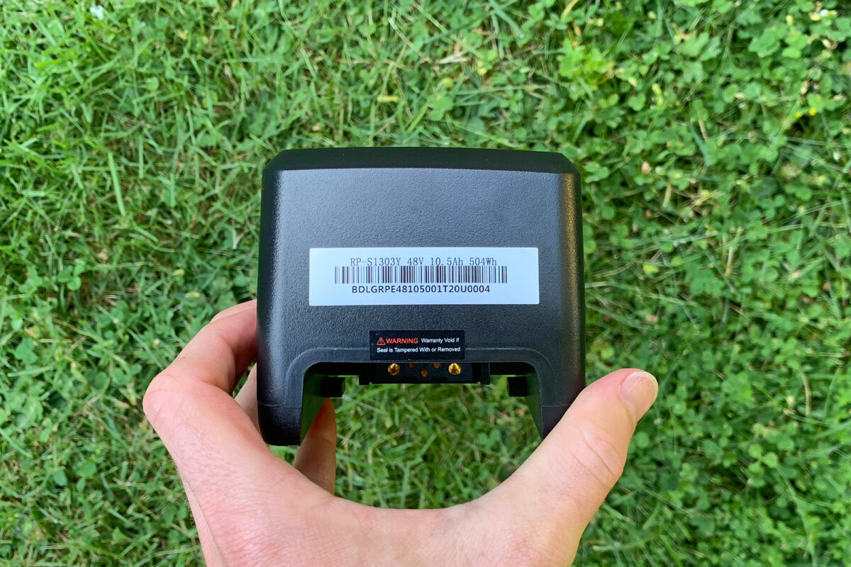

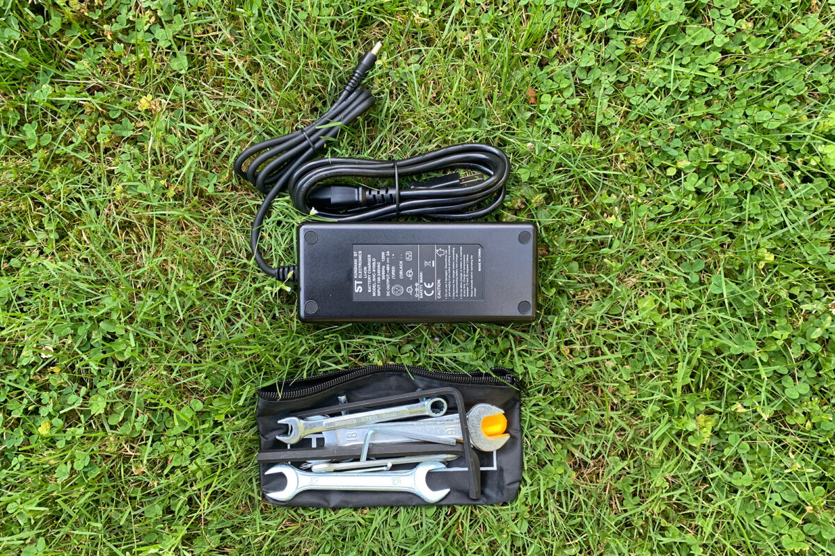

- Since the battery pack is removable, and the one-pound charger is so compact and lightweight, you can easily charge at work, school, or other destinations where there is a standard plug to use. Removing the battery will help to protect it from water, and extreme temperatures. Heat will degrade the cells faster, limiting the lifespan of the pack, while cold will stunt your range temporarily. I appreciate that these batteries have two fuses to prevent damage, and that you can also lock the battery to the bike in the “off” position, so nobody can turn on the display and tamper with your bike.

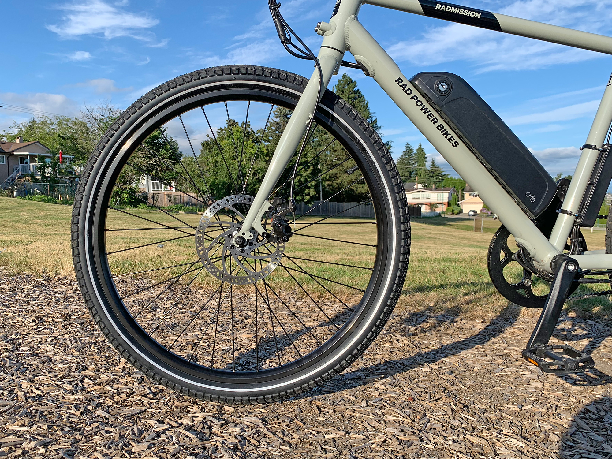

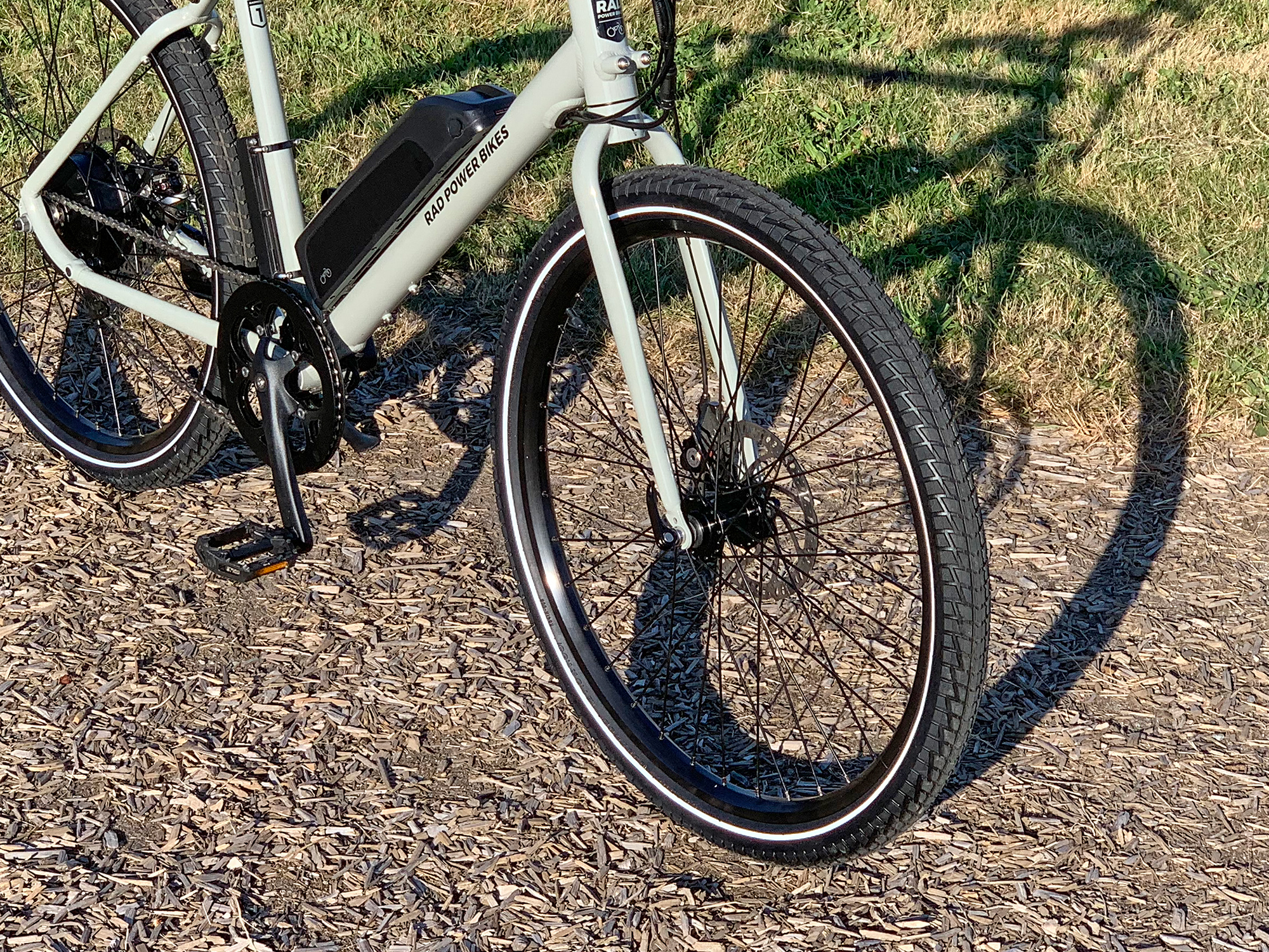

- Even though the RadMission comes with narrower tires than any other Rad Power Bike, they still chose slightly wider than average at 27.5″ x 1.95″ vs. 1.25″ or 1.75″ and that results in better stability and comfort. I’m glad they went this route, even though it increases drag and weight just a bit. That’s because, most ebike riders go further and faster on average than pedal cyclists.

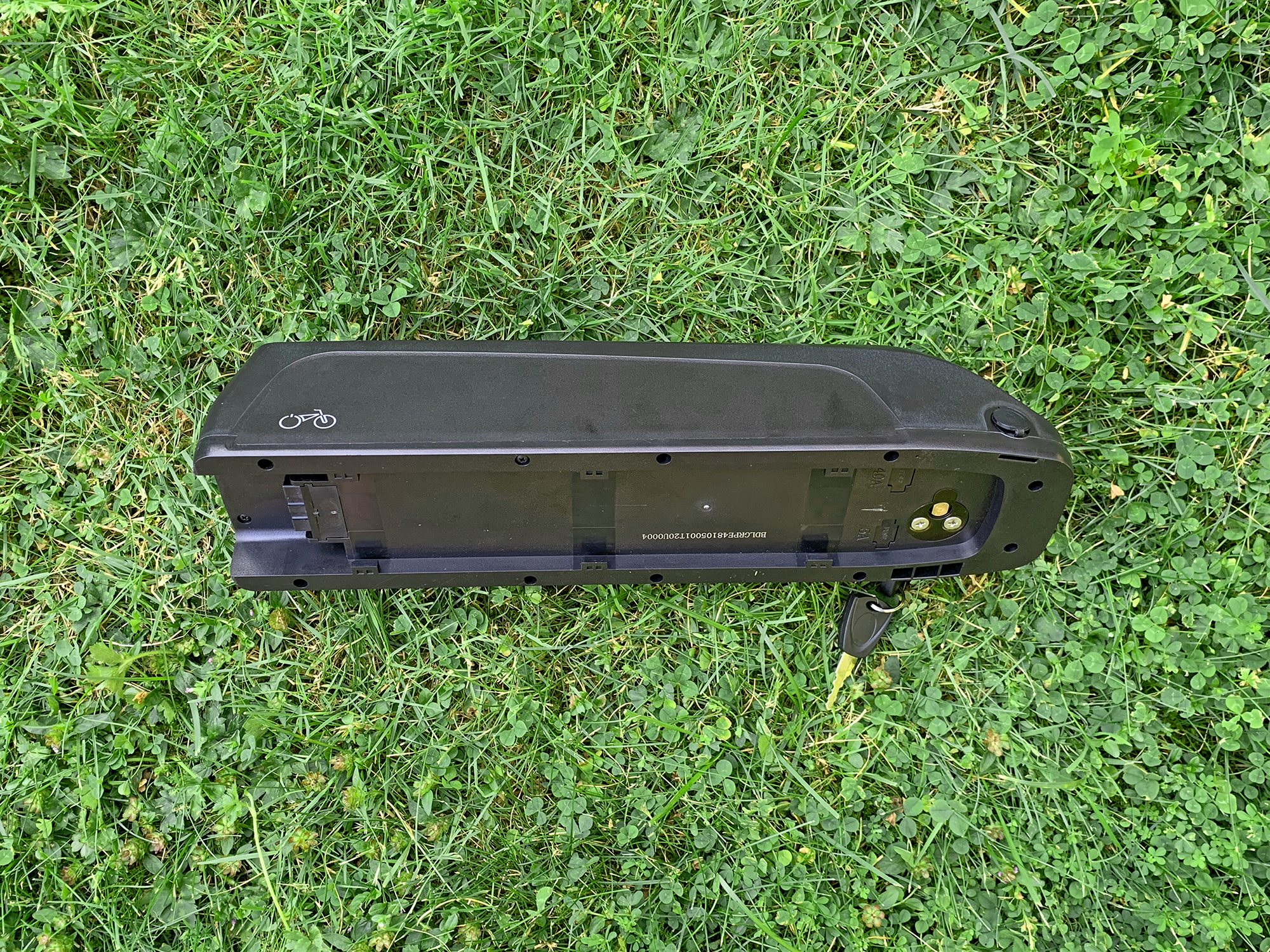

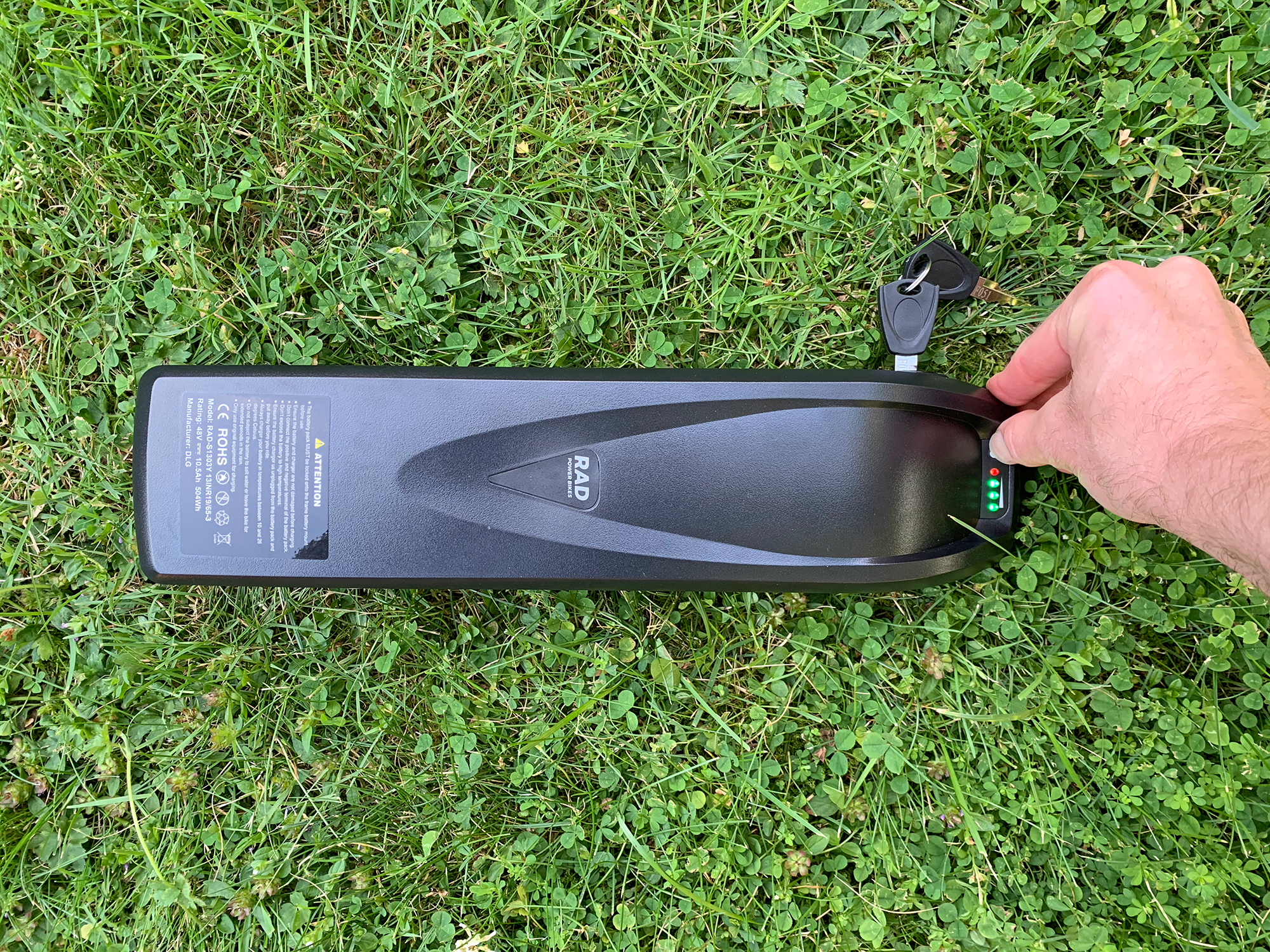

- Even though the RadMission comes with a lower capacity battery pack, it mounts using the same interface as the other bikes and those batteries do work on this ebike, This means you can purchase a few bikes and easily swap the packs around, or take two packs along for an extended adventure. All of their batteries use high-quality lithium-ion cells from Samsung, are warrantied for a year, and are cheaper to replace they don’t contain the ebike controller (that’s in a little box, mounted behind the seat tube on this bike). In short, the batteries don’t heat up as much and cost less to replace because of this design choice.
- You can charge the battery pack on or off the frame, and it has three key positions for unlocked, locked to frame powered off, and locked to frame powered-on. This helps you to deter tampering with the bike without having to take the battery pack off at every stop. For best results, store the battery in a cool, dry location. Extreme heat can damage the cells and extreme cold will stunt them and limit your range temporarily

- Both wheels are built with thicker 12 gauge spokes for increased durability and weight capacity support. Note that the official max weight rating on both RadMission models is 275 pounds (~125 kilograms). That’s higher than the average 250lb max weight limit of many other affordably priced ebikes.

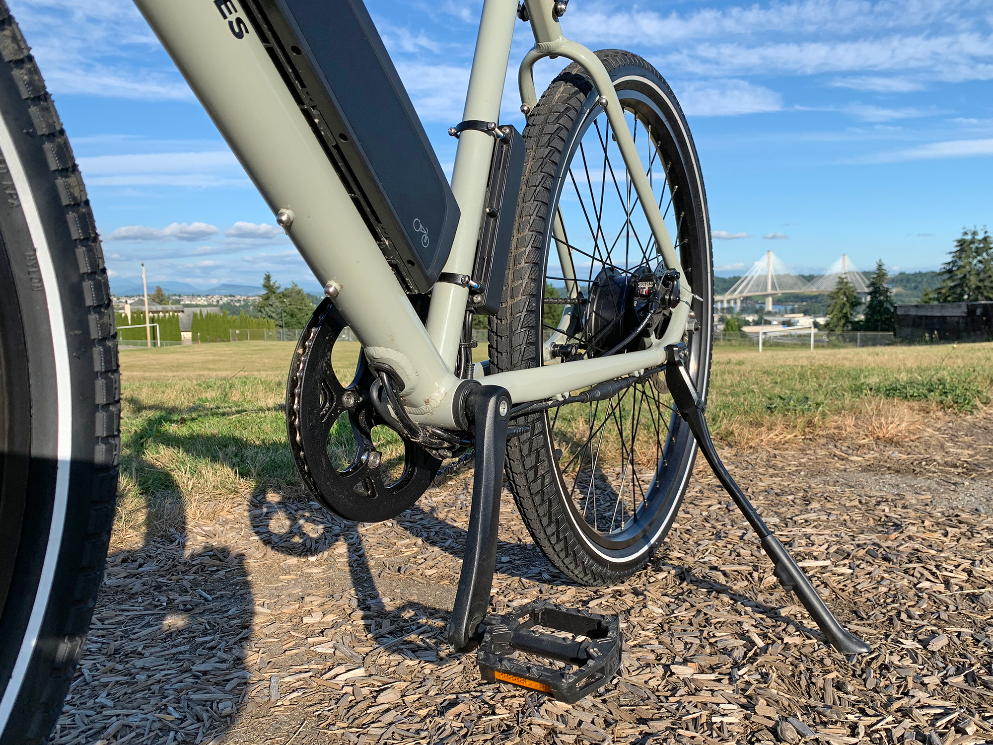

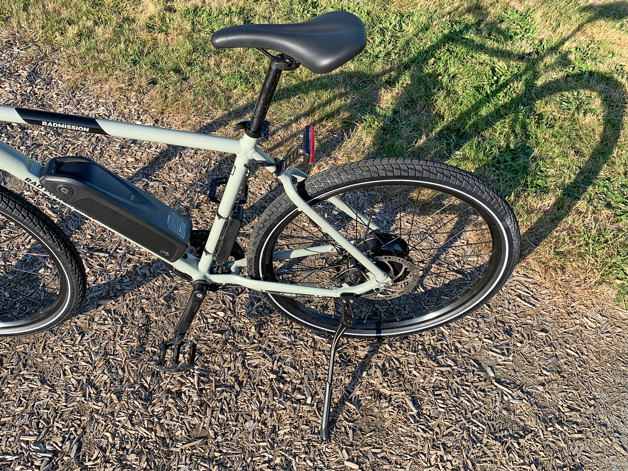

- This ebike does not come with a kickstand. That caught me off guard, because it has plastic pedals that seem like they could be vulnerable when laying the bike down on its side? I asked the founders about this decision, and they said they were trying to reduce weight and waste because not all users felt that they needed one. The bike is super tough and simple with the single speed drivetrain, so maybe having a stand is less of a requirement here… but for those (like me) who definitely want one, it’s just $15 to add it… and the stand is really great! It offers tool-free adjustable length and attaches to the frame with a standard 18mm spacing at the rear – so it shouldn’t come loose easily or cause pedal lock.

- Removing the battery pack on this and other Rad ebikes can be a bit finicky and difficult. First, you insert the key and twist left, push in, and twist left once more. This final position is unlocked… and it allows you to slide the pack forward on the track and take it off. The battery doesn’t have a handle and the slide interface can be a little sharp. Just take your time and be careful with your fingers. Try not to drop the battery pack.

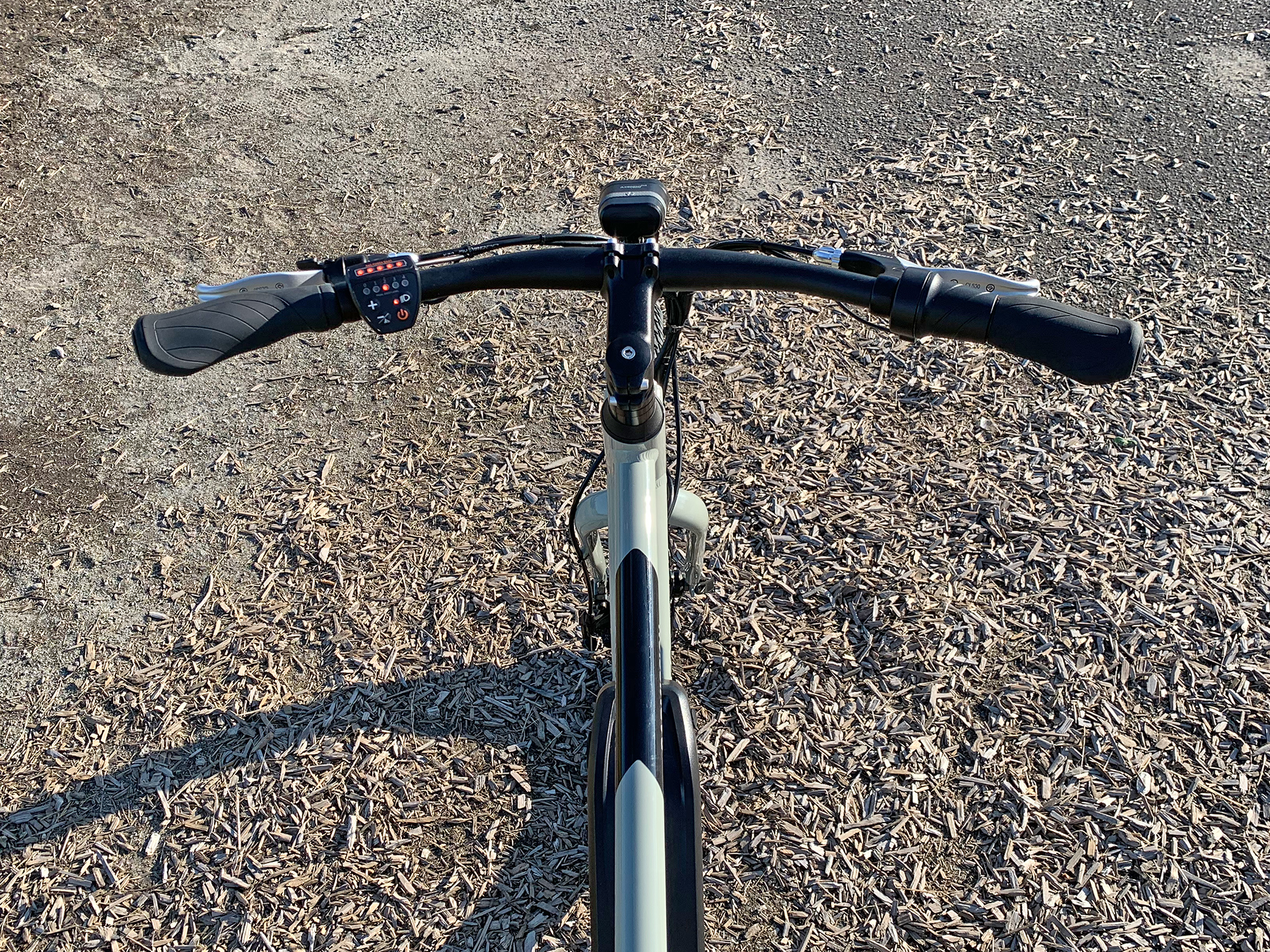

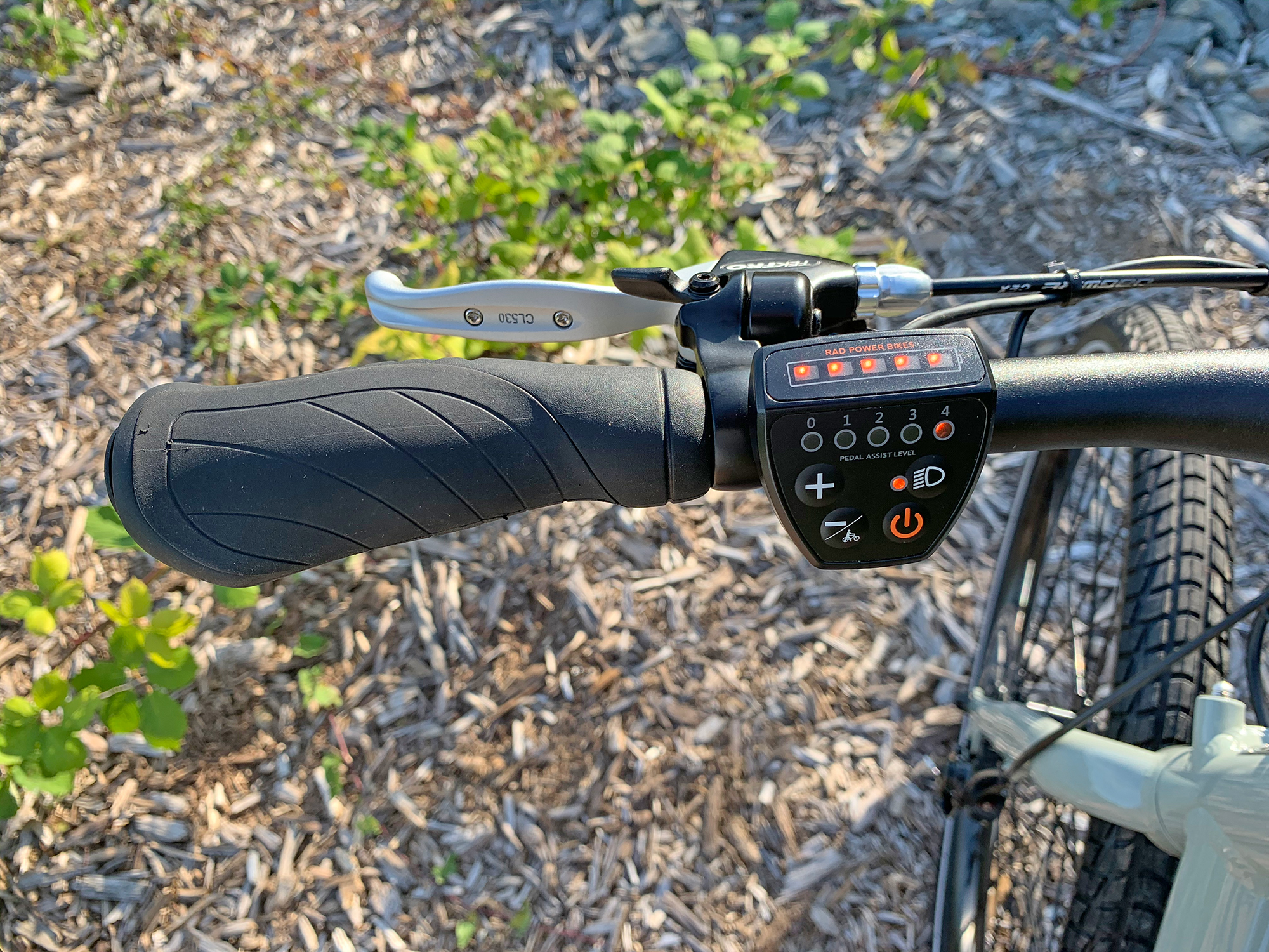

- The display panel is very simple, with limited readouts including battery charge level, assist level, and lights indicator. You don’t get the precise speed, trip stats like average speed and odometer, or watts. You cannot adjust the brightness of this display either… but I was able to swivel it forwards so the orange LEDs wouldn’t be shining up into my face when riding at night. Rad Power Bikes also told me that they’d be offering the fancier LCD display as an optional retrofit upgrade at some point in the future.
- It would be nice to have more than five bars to indicate the battery charge level, on the LCD readout. As it stands, each bar represents a 20% drop vs. 10 bars representing 10% drops, or even a written percentage such as 42%. This could really help riders to make it home without completely depleting the battery. This is especially relevant with this ebike because it’s a single speed that is geared high, making it difficult to start from standstill and and climb with.

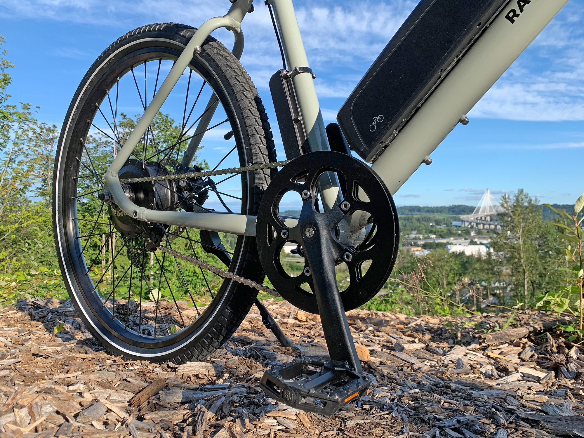

- This is a single speed electric bike, and it’s geared pretty high (slow pedaling), which makes starting and climbing much more difficult. It feels natural at higher speeds above 15mph, but I really struggled to get started and climb even small hills when the bike was shut off. I prefer lower gearing, because I like to spin fast and reduce knee pressure. I asked the Rad designers about this, and they said the gearing was chosen based on user testing and feedback, and because the bike has a throttle to help get started. The throttle definitely works well, and I can understand the choice. Ultimately, with only one gear here, some people will be happy, and others might feel a bit uncomfortable. Also, there is no way to upgrade to a multi-speed drivetrain later on; the bike isn’t setup for a derailleur at all.

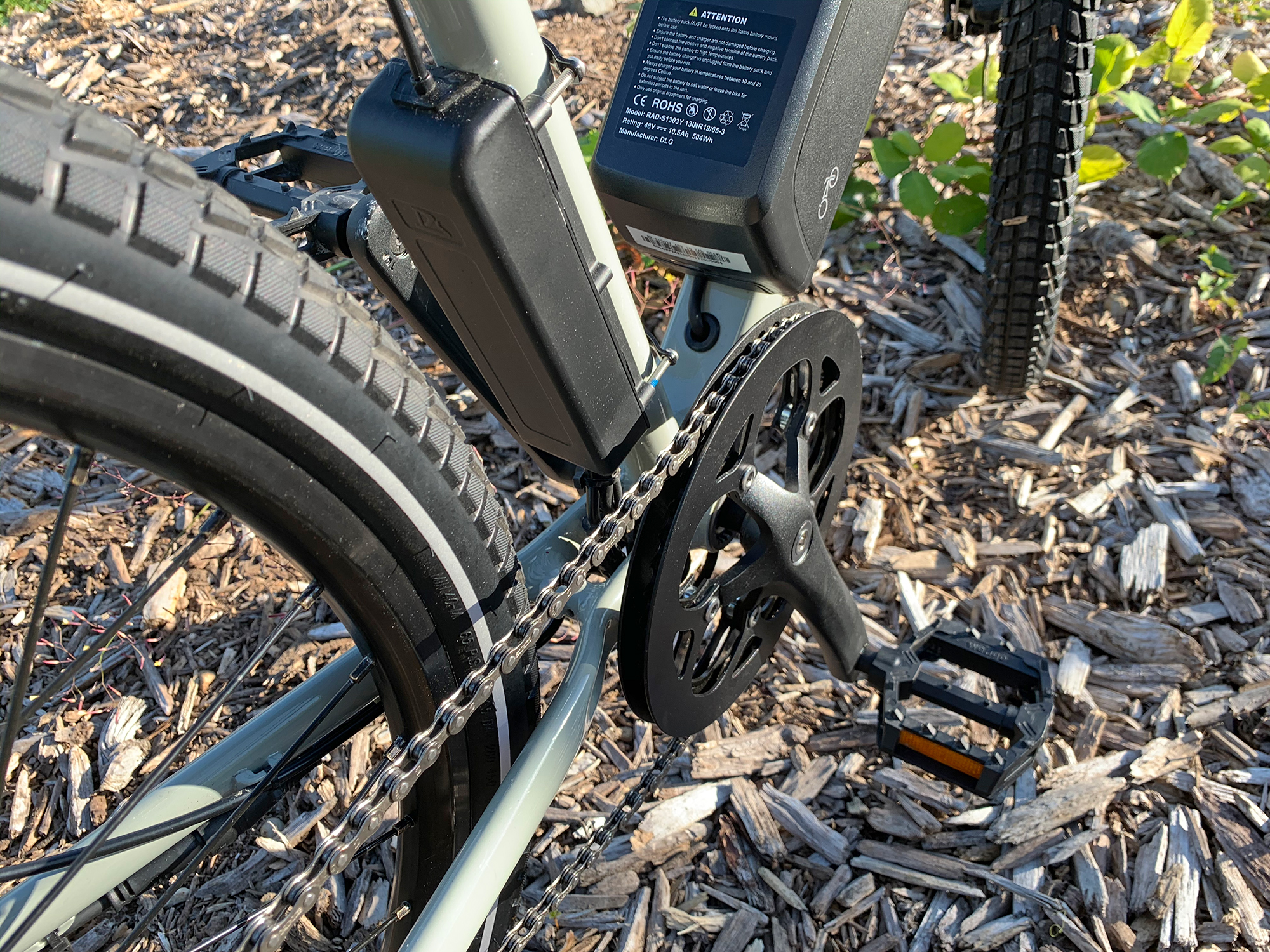

- The chain is rust resistant, along with the Nickel coated rear cog, but the steel chainring and steel fork could get some wear and show rust over time. I’ve heard that a bit of clear nail polish over scratches on the fork could reduce rust… or some basic touch up paint. Note that the main frame and optional baskets are all aluminum alloy and the optional fenders are plastic vs. steel.

- Since there’s no suspension built into the bike, it can feel a little rough if the tires are inflated to a high pressure and you’re riding on bumpy terrain. I lowered the tire pressure near the 40 PSI minimum, and I’d consider buying a suspension seat post (with 27.2mm diameter) and suspension stem if I were riding every day.
- At the time of this review, none of the Rad Power Bikes come with hydraulic disc brakes. This is probably a cost savings decision, and it makes them easier to adjust manually. The downside is that actuating the brake levers can require more hand effort, especially the rear brake (right lever). I noticed that the caliper is angled a bit, and the brake cable is running down into the housing vs. being flat on the other Rad models. This could lead to more water and dust accumulating in the brake line, gunking it up and creating friction. I asked about this, and they said they had limited space to mount the caliper because of the way the rear portion of this frame is designed.

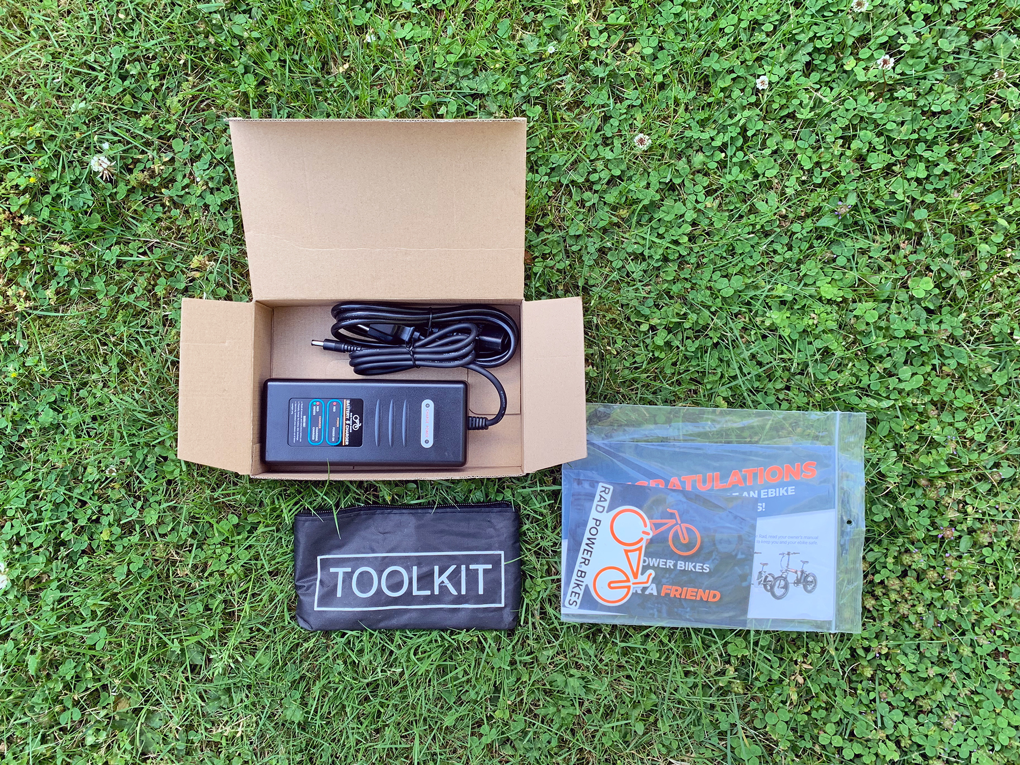

- All of the Rad Power Bikes use the same charger (just like the interchangeable battery packs), and it’s fairly lightweight, but it only puts out 2 amps. This means that charging can take up to 4.5 hours if the battery is completely drained. This would be faster if they used a 3 or 4 amp charger like some other companies have started doing, but it might raise the price, increase weight, and possibly decrease reliability.
