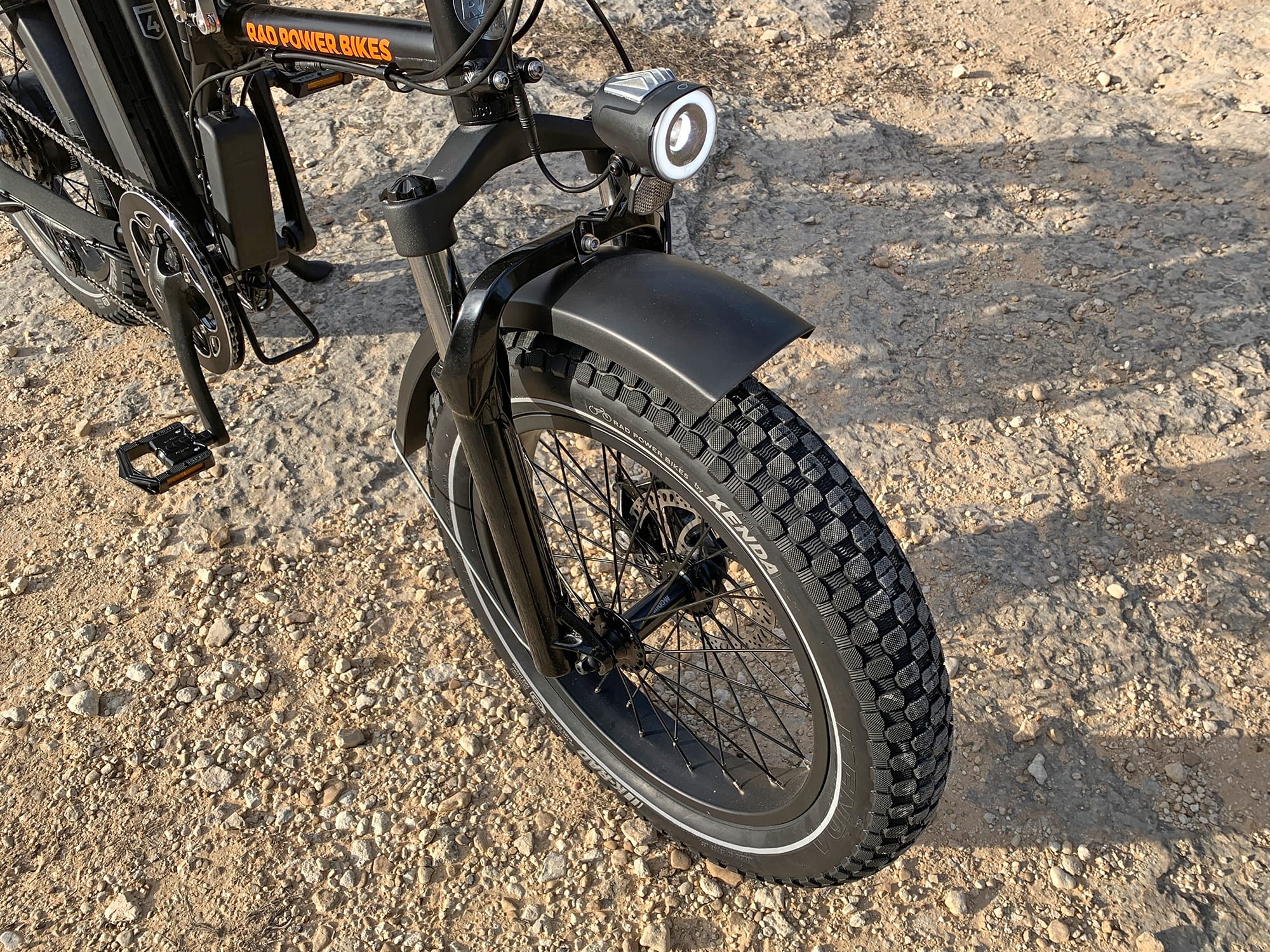

- Excellent headlight upgrade here, you get a bright 80 lumen beam that is focused for spotting the path, and a secondary LED ring that keeps you visible from the sides. There’s even an aluminum alloy heat sink built into the top of the headlight housing to dissipate heat! At first, I thought that it was just for show, but it’s actually metal and mates directly with the internal LED housing
- By default, the new RadMini models come with durable plastic fenders. They’re wide enough to keep you dry (as I tested in the video review above), and they are lightweight and durable… without producing a lot of noise. I really appreciate that the company designed a rear light riser, to help boost it up above the rear fender! Furthermore, if you purchase the optional rear rack, there’s an extender cable so the light fits further back. It’s protected by the rack tubing but isn’t blocked from the sides… excellent placement

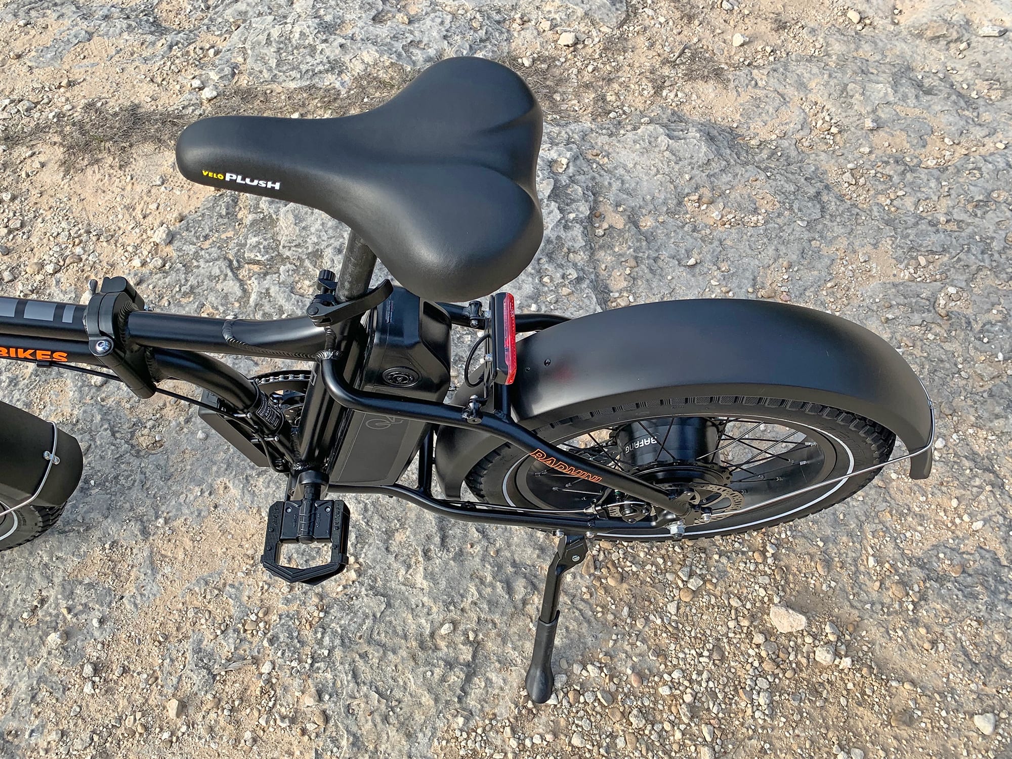

- Matching faux-leather ergonomic grips and saddle look great and provide good comfort. I’ve tested a bunch of seats, and this one is soft enough, but not so wide that it will chaff your inner thighs when pedaling. It also has a handle built into the back for easier folding and lifting of the bike

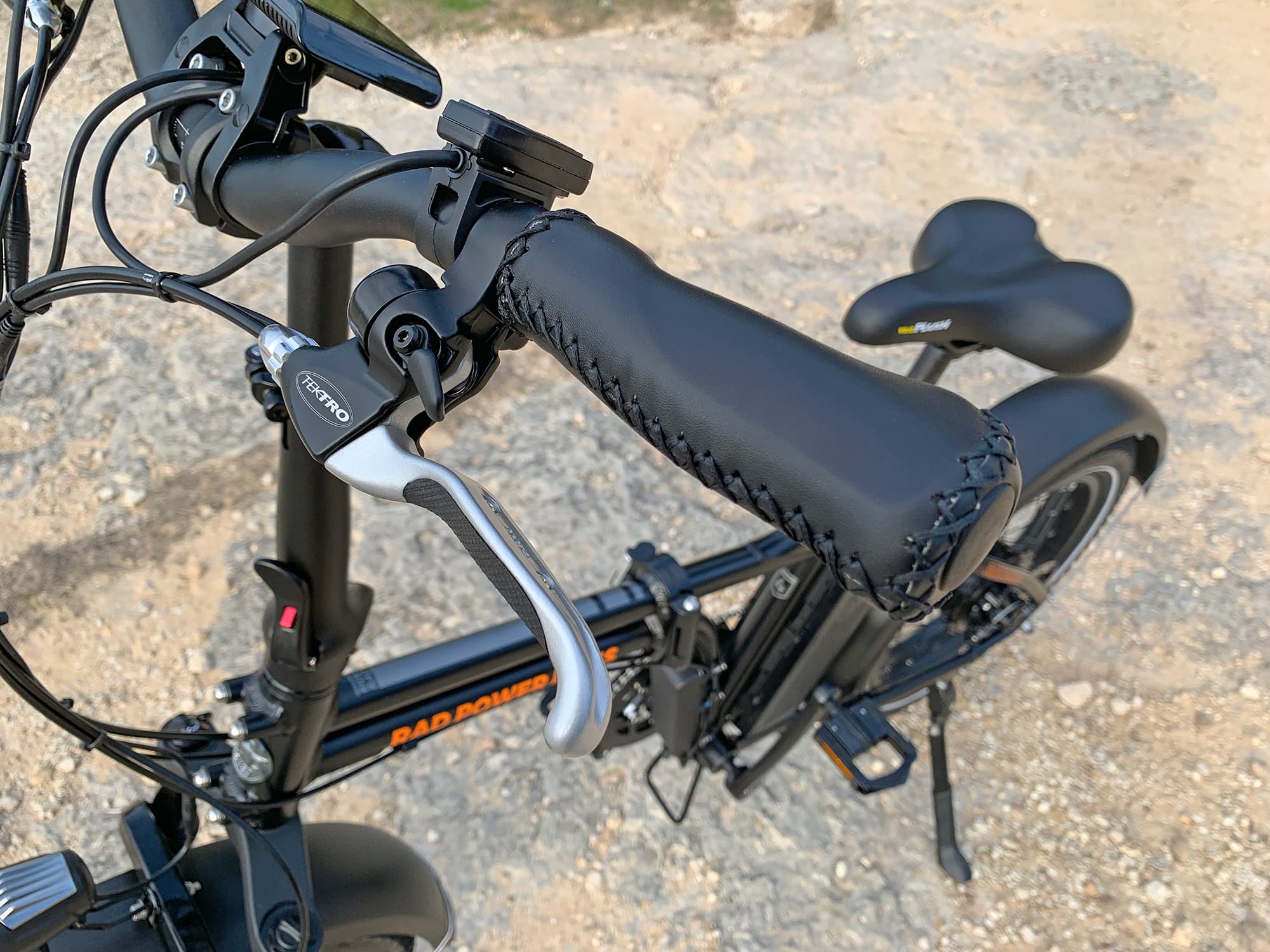

- I really like the bell that’s built into the left brake lever, it’s compact and stays more protected when folding while keeping the handlebars clean, but works reliably and produces a friendly chime. I also like the rubberized brake levers, which don’t get as cold or feel as sharp as all-metal

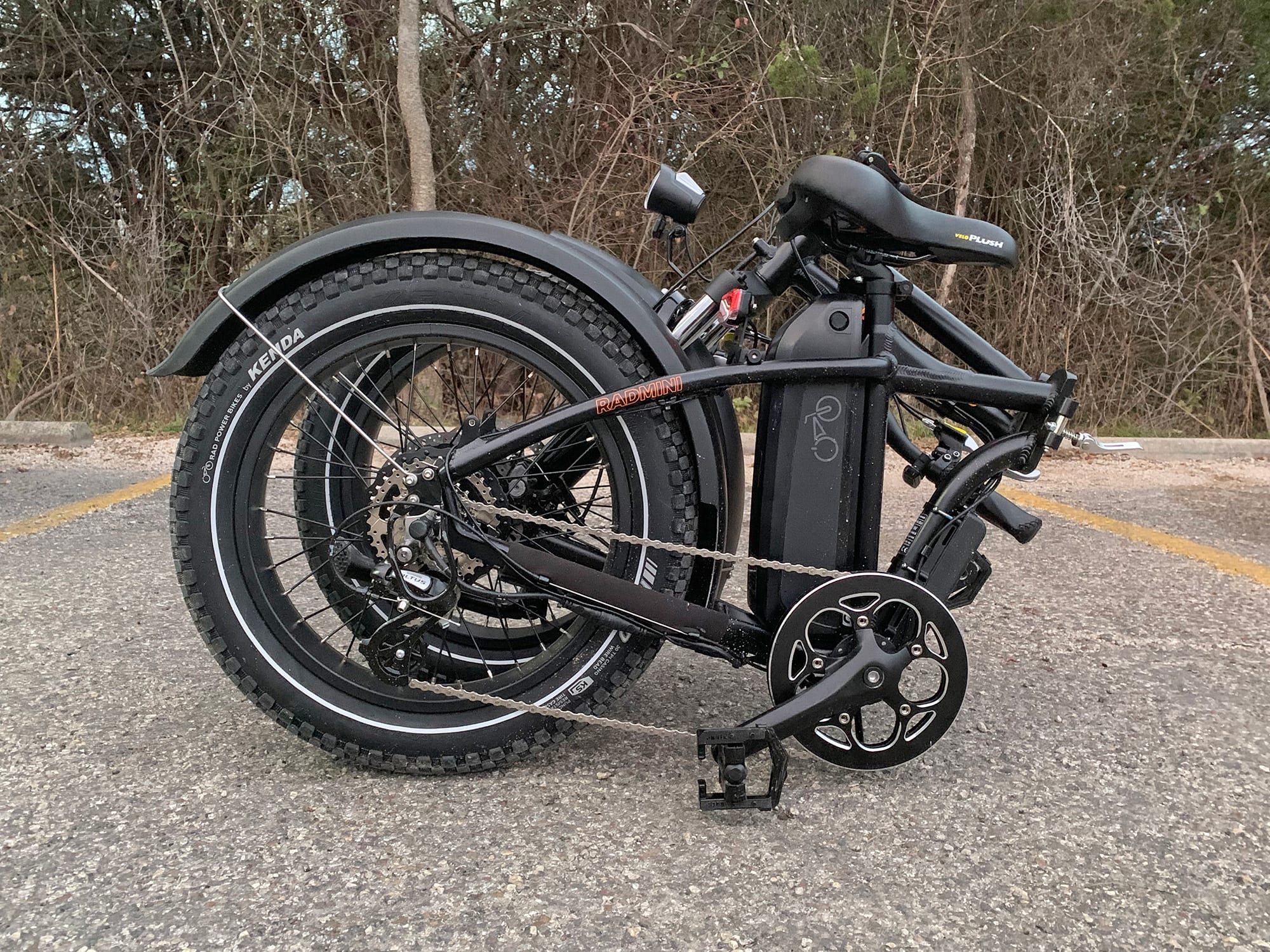

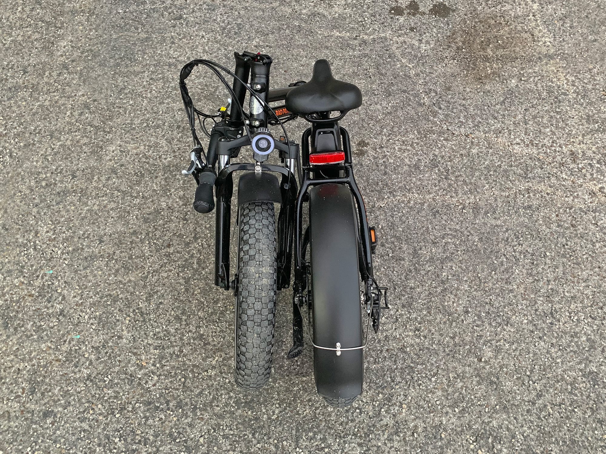

- Some folding bikes skip the bungee cord, magnet, or a Velcro strap to keep them from coming unfolded but the RadMini does not, it comes with a Velcro strap! You could still use your own bungee cords or get an adjustable one like this to keep the frame extra secure when transporting in a car, boat, plane, RV, etc. I often place a towel or t-shirt between the frame components when folding and transporting, to reduce scratches and chips. Some owners have purchased large plastic tubs and posted about it in the forums here

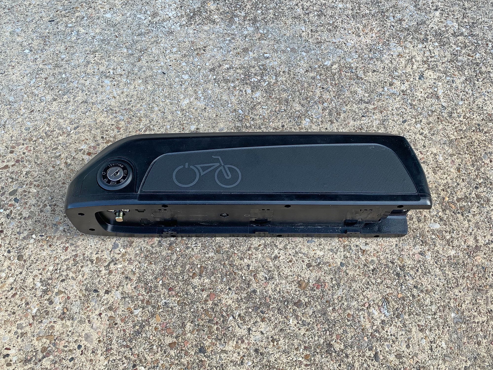

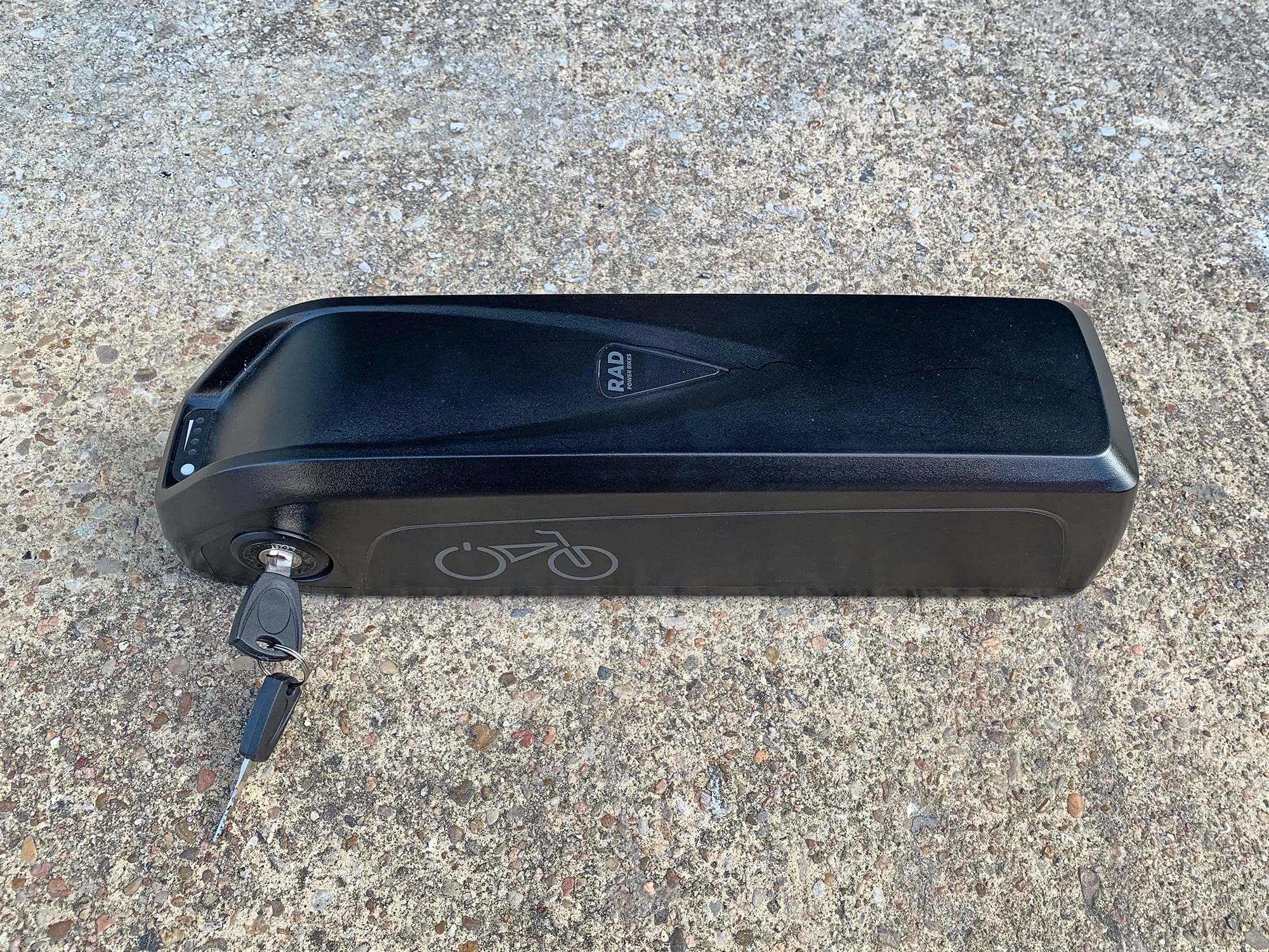

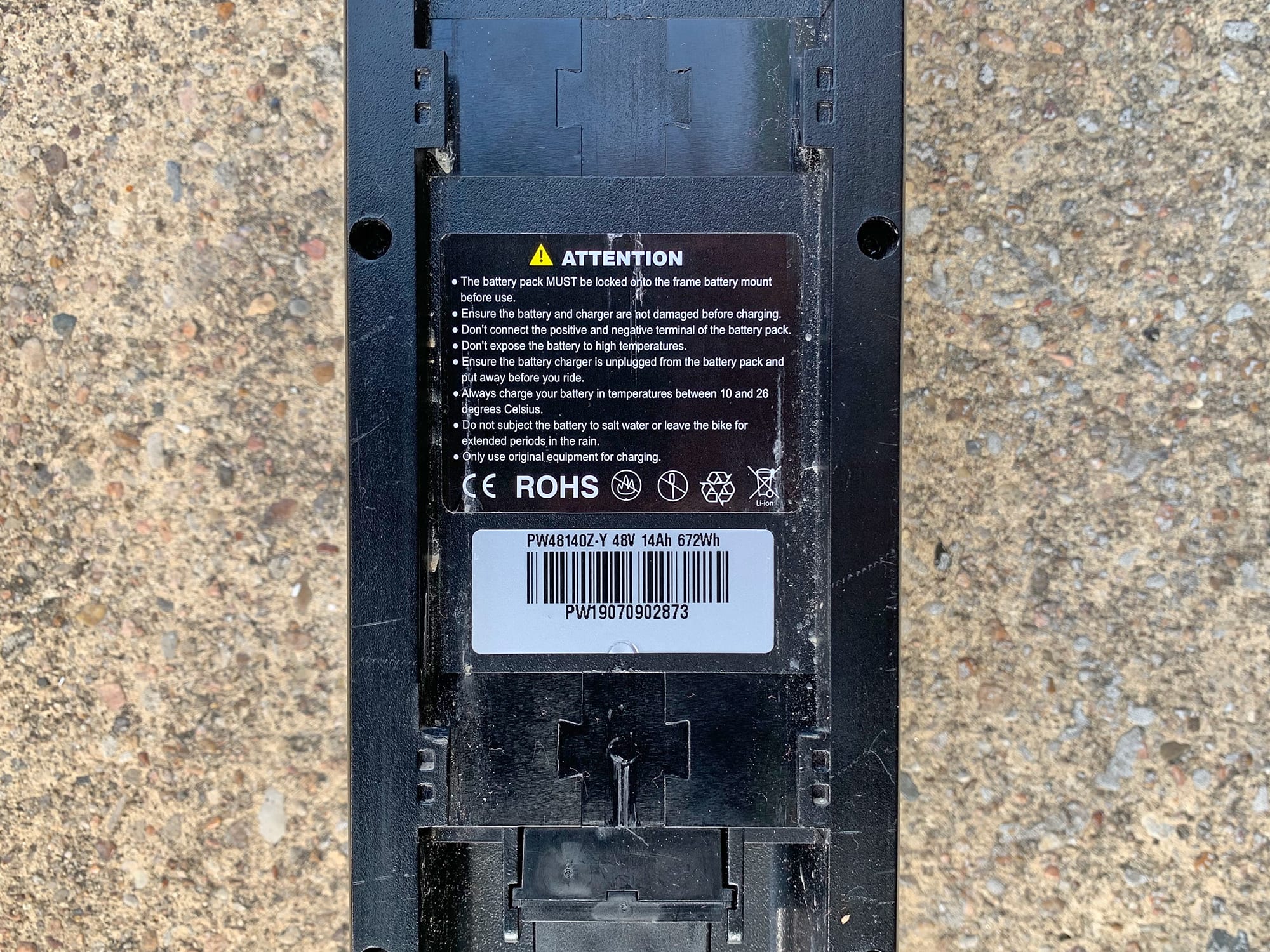

- I like that Rad Power Bikes is using the same battery pack for all of their models now. This means you can purchase a few bikes and easily swap the packs around if you forget to charge, or decide to take two packs along for an extended adventure! The battery itself uses high-quality Samsung lithium-ion cells, is warrantied for a year, and is cheaper to replace because it doesn’t contain the bike controller. You can charge this pack on or off the bike frame, and it has three key positions for unlocked, locked to frame but powered off, and locked to frame powered-on. This helps you to deter tampering without having to take the battery pack off. For best results, store the battery in a cool, dry location. Extreme heat can damage the cells and extreme cold will stunt them and limit your range temporarily

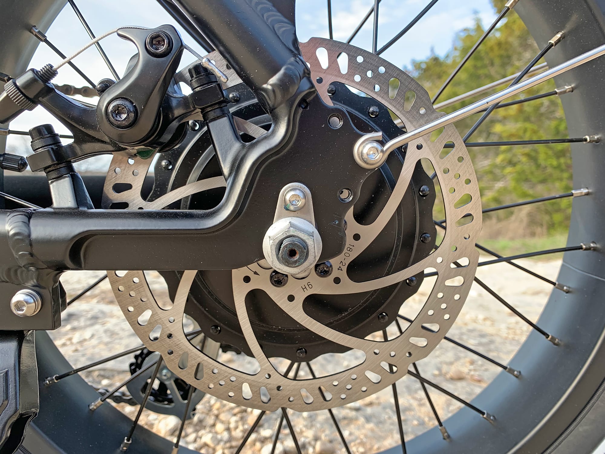

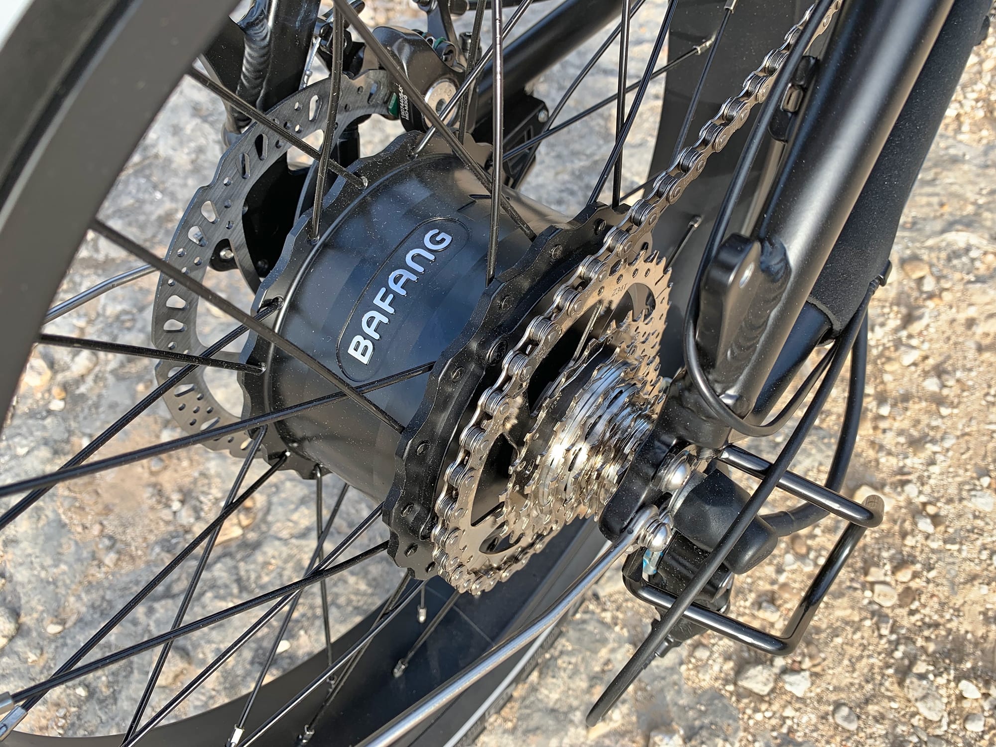

- Note the stainless steel torque arm on the rear left dropout that reinforces frame strength! This will keep the motor axle from chewing into the softer aluminum alloy dropout over time, which is important for such a high-powered hub motor

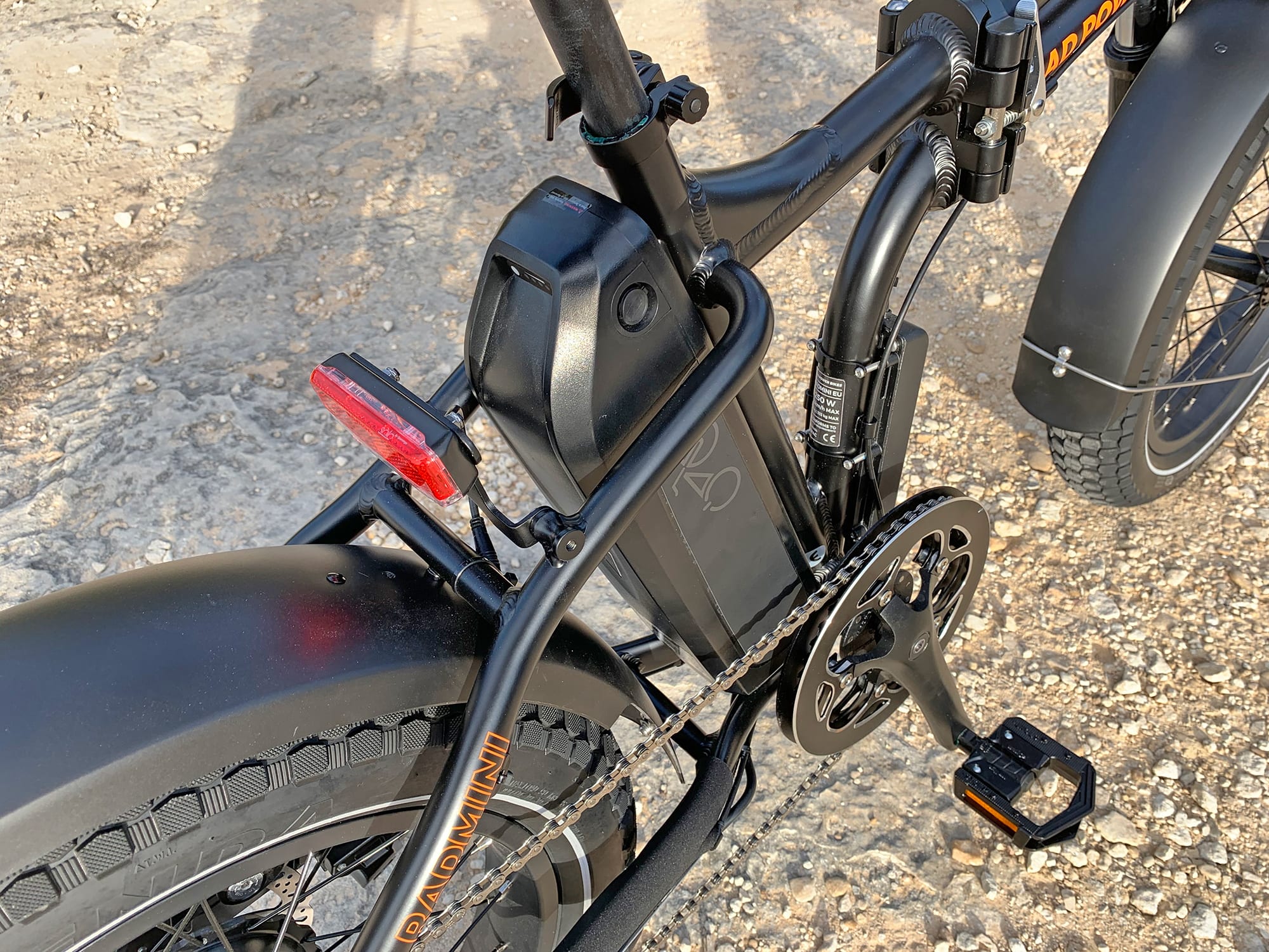

- Decent weight distribution here, notice how low and centered the battery is on the bike frame, this improves stability and frees up the rear for adding a rack and cargo. Note that the step-thru RadMini moves the battery further forward by placing it in front of the seat tube… but that isn’t available in Europe at the time of this review
- Both of the frame folding points (at the center of the frame and on the stem) have a locking mechanism for safety when riding. This way, they won’t come completely unfolded if the clamp becomes loose
- The planetary geared hub motor offers great power for starting, navigating soft terrain, and climbing. Although it ramps up steady and smooth vs. zippy, it’s still fairly capable at 250 watts. I’m not sure how much torque it offers, but the North America version offers 80 newton meters, which is also at the higher end of the spectrum
- The geared hub motor is zippy and powerful, more so than the RadWagon and RadCity models, which use a gearless hub motor. The geared motor doesn’t offer regeneration and it does produce some more noise, but it’s torquey enough to power through snow and soft sand if you lower the tire PSI to the 5PSI range. Geared motors also freewheel without introducing magnetic drag, so they can pedal more easily if the motor is turned off, or if you try to exceed 25km/h by pedaling extra hard

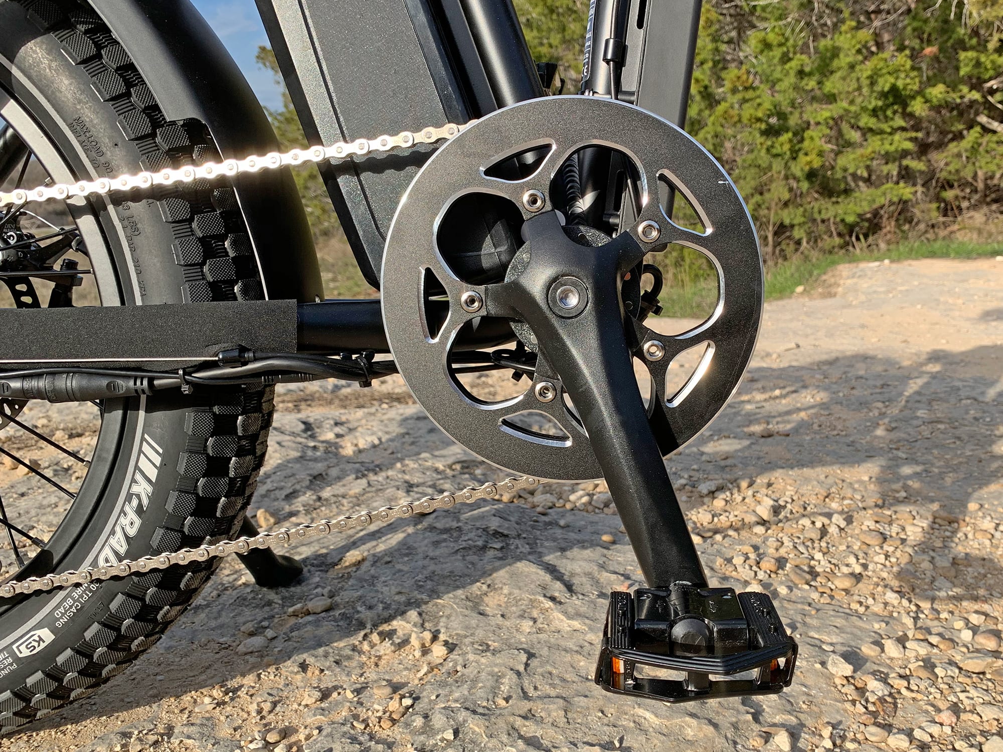

- I love the sturdy aluminum alloy folding Wellgo platform pedals that Rad chose for this model. Most folding ebikes use plastic that flex. I also like the durable alloy chain guide and the steel derailleur guard because it means the chain won’t fall off as easily and the sensitive derailleur won’t get bent if the bike tips or is being transported on its side while folded (still, be extra careful with the derailleur and large disc brake rotors, so they don’t get bent)

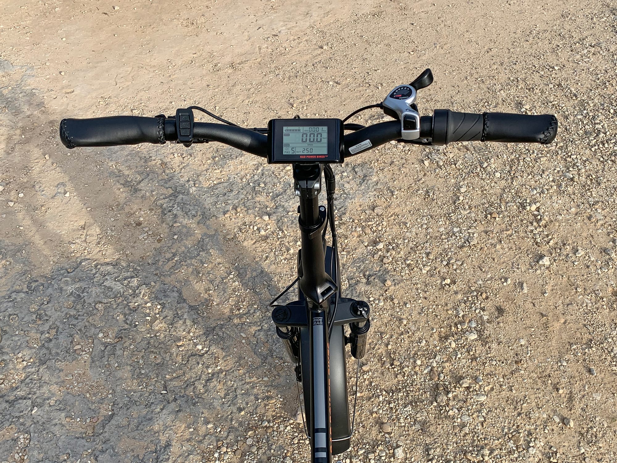

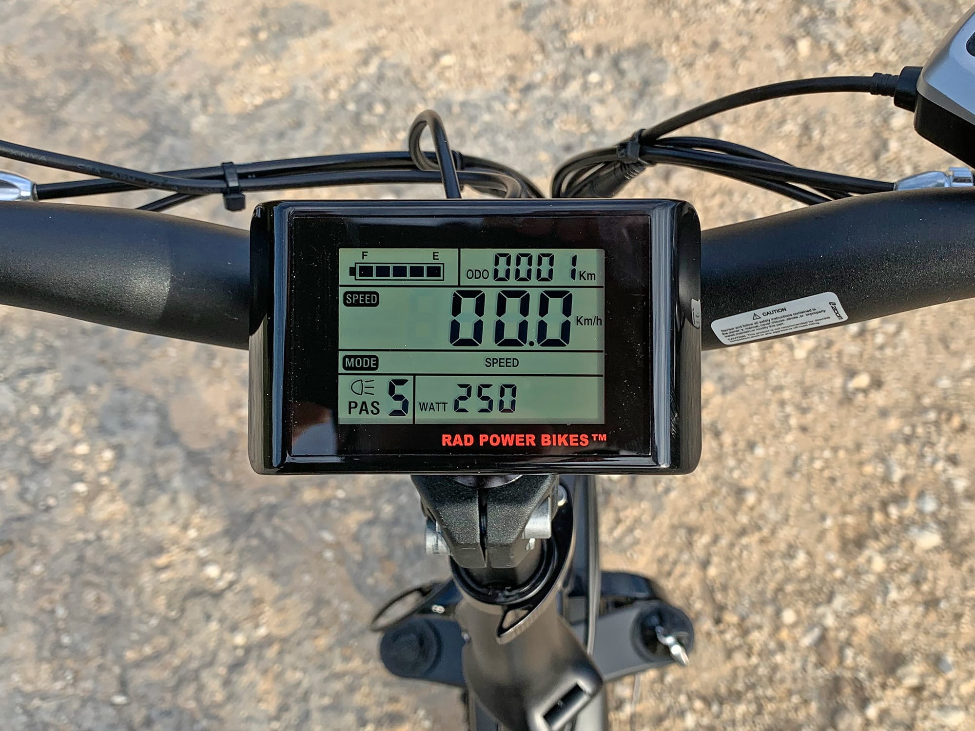

- I love that the LCD display panel is fairly large, has adjustable backlight brightness, and offers a full size USB charging port built into the bottom (providing 5 volts and a full 1 amp of power). This is very convenient if you are using the optional phone mount for GPS and need a bit of extra juice for your smartphone on long rides
- For me, the three-button control pad that’s mounted near the left grip is easy to reach and simple to use. You press up or down to raise or lower assist, you press mode to cycle odometer and trip meter, you hold up to cycle current speed, average speed, and max speed, and you can hold up and mode simultaneously to activate the lights or hold down to activate walk mode. Walk mode is especially useful if you’ve got the bike loaded up with gear or a child seat and just want to play it safe without over-exerting yourself up a hill or through a technical section of terrain… and remember that the twist power assist will also activate walk mode. Hold up and down simultaneously to get into the settings menu and adjust wheel size, top speed, and backlight brightness

- The kickstand is adjustable, has a wide platform at the bottom to keep it from sinking in to soft terrain, and it works well if you’re loading the bike with gear. Note that the kickstand is positioned far enough back that it won’t cause pedal lock when backing the bike out, or cause heel strikes when pedaling

- Great drivetrain on this ebike, Rad has chosen an 11 to 34 tooth freewheel over the conventional 14 to 28 tooth design. This provides a wider range of pedal options for easier climbing and more comfortable high-speed riding. The cogs are nickel coated, which makes them rust resistant and a lot smoother to shift. The Shimano Altus derailleur is lighter and more reliable than Tourney, but not quite as good as the Acera used on full sized Rad models like RadRhino and RadCity
- The battery slide mount uses three bolts to attach to the frame. Some of the really cheap ebikes I’ve reviewed only use two bolts and just don’t feel as secure. I have found that the battery and fenders don’t rattle much when navigating bumpy terrain on this ebike, and I haven’t seen them coming loose

- The battery and controller box are mounted externally, which isn’t as fancy or beautiful as some competing products with internal batteries and controllers… still, that keeps replacement battery packs down in price and reduces the heat surrounding the battery, which extends its life. The cables aren’t internally routed, as they are on the RadMini Step-Thru, but they won’t get pinched as easily when folding/unfolding the frame. Since the battery, controller, and cables are all black, they match the black frame on the standard RadMini and blend in pretty well, in my opinion
- Because the battery pack slides down and mounts behind the seat tube, you’ll probably have to loosen and raise the seat post and saddle anytime you want to take it off of the bike, this is not always the case for the full sized RadRover and RadCity models
- Keep an eye on the front cables when the stem is fully extended or folding and twisting the handlebar because this could pull on the some of the cables and loosen them or even cause disconnections
- The display is large and easy to read but not removable, so it could take extra weather wear and possibly get scratched at a bike rack. I appreciate that it’s well protected by the mid-rise handlebar, and that the electronics on the bike can be completely disabled by turning the key to the locked-off position (between locked-on and unlocked).
- I love that you can enter into the display settings area and adjust units by holding the up and down buttons, but I wish there was more feedback about range and remaining battery capacity, it only shows five bars which relay 20% steps vs. 10 bars or a full 100% readout

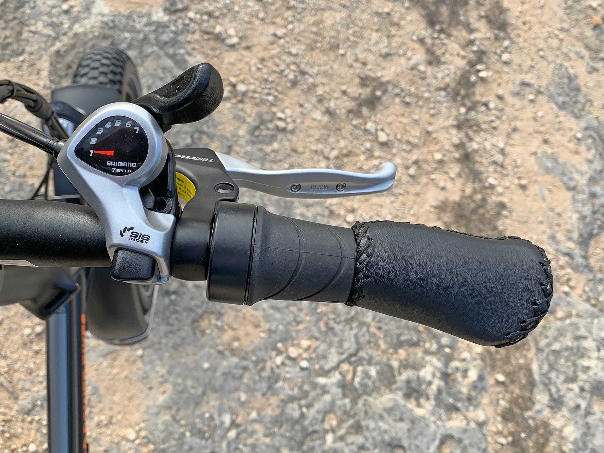

- Rad Power Bikes has been using the large Shimano SIS index shifters since the beginning, and they aren’t my favorite. You have to reach up with your thumb to press the main paddle to get to lower gears, and that can require a bit of hand flexibility and even looking down for a moment. I much prefer smaller trigger shifters, but I don’t think those will fit with the twist assist housing, and they might not be as simple and intuitive for some riders… so I see why they stick with them, and they do work fairly well if you’re wearing thick gloves
- The 180mm mechanical disc brakes worked well during my ride test, especially with the smaller 20″ wheels, but I definitely prefer hydraulic brakes because the levers are easier to pull and can be reach-adjusted for extra small or large hands. This is one part on the bike that seems to be a compromise in order to keep the price lower and the folks at Rad told me that mechanical brakes are easier for people to work on themselves verses needing help from a shop

- Minor considerations here, the headlight is mounted to the lower portion of the suspension fork and will bounce up when you encounter large bumps. This would not happen if it was mounted to the stem or handlebars… and it would be much higher and more visible there as well (but possibly prone to damage when folding/transporting). If you opt for a front tray rack, the headlight will have to be moved onto the base of the tray because otherwise it will collide and get blocked by the rack. The thing is, the light isn’t as adjustable when it’s mounted below the optional front tray rack, and it no longer points where you steer when it’s mounted there
