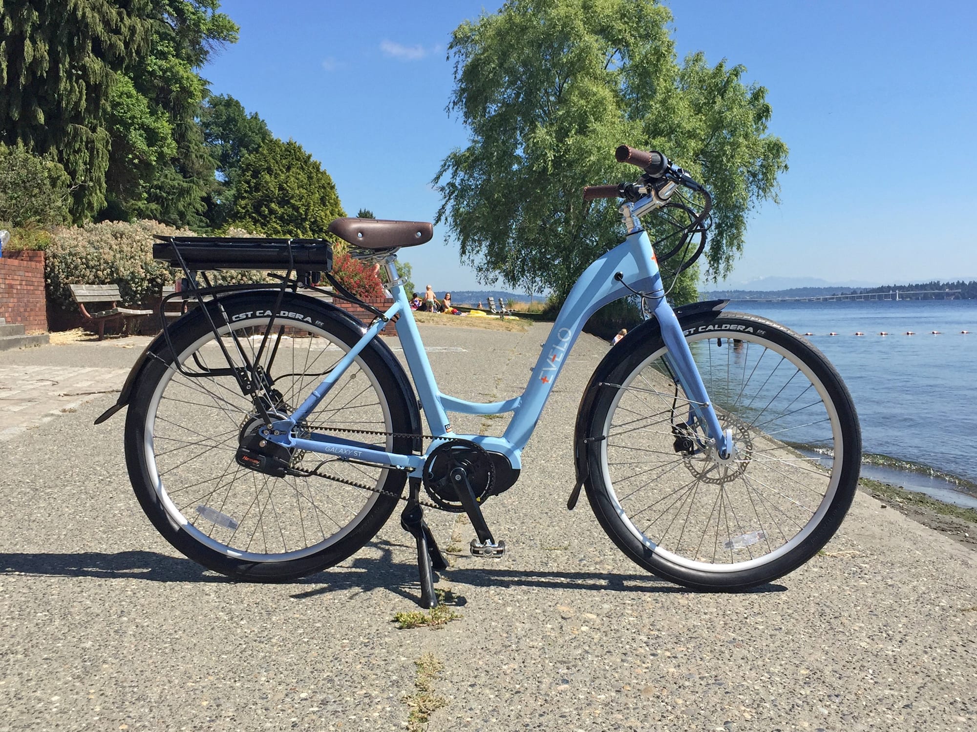

The EVELO Galaxy line offers something very unique, a mid-drive motor combined with a carbon belt and continuously variable transmission. This is a combination of parts that offer efficiency, shifting at anytime (even standstill), and durability. The belt is clean, won’t fall off as easily as a chain, and will last longer. The NuVinci continuously variable transmission hub is completely sealed and doesn’t rely on a vulnerable external derailleur to change gears. The Bafang Max Drive motor is not only responsive, because it relies on a torque sensor, but also exceedingly quiet and efficient. The Galaxy TT is the “top tube” high-step model which is slightly larger than the ST “step-thru” frame and only comes in one size and color. It’s the best choice for taller riders, those who want a more masculine look, and those who value stiffness and performance. The frame doesn’t flex as much as the ST and it may be easier to lift and hang on some car and bus racks. The bike isn’t perfect however, it’s pretty heavy at ~58.5 lbs and kind of expensive starting at $3,499, but that custom drivetrain is not cheap. Rather than using a stock frame, this one has a cutaway section in the right chainstay to accommodate the belt. In order to still hit their 300 lb max weight rating, the frame has to be reinforced… but they also managed to route most of the cables internally through the frame tubing, add bottle cage bosses onto the seat tube, and implement a precision horizontal dropout system to tighten the belt. In short, I feel that they did a good job and that the end result justifies the higher price. This is about the furthest you can come from a do-it-yourself electric bike or a basic hub motor design, it’s the kind of thing that only a company with buying power and engineering expertise could pull off. And Evelo has been around for many years doing just that. They offer renowned customer service and now have a physical outlet in Seattle (where I filmed the video review) so you can drop by and test one out yourself. Before digging in too much deeper, the other trade-offs I discovered were the basic tires, limited throttle functionality, and mechanical disc brakes. For an additional $400, you can get upgraded hydraulic disc brakes with adjustable reach levers and an electronic auto-shifting NuVinci harmony drivetrain vs. the stock mechanical one. It’s pretty amazing to ride a bike and have it automatically adjust the gearing so you can pedal comfortably at a set cadence without even thinking, and that’s what the Harmony offers…

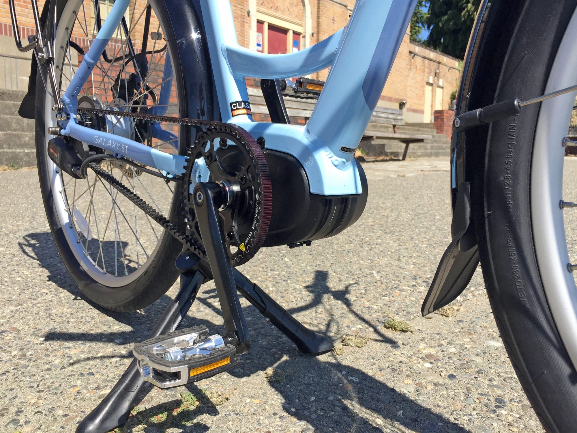

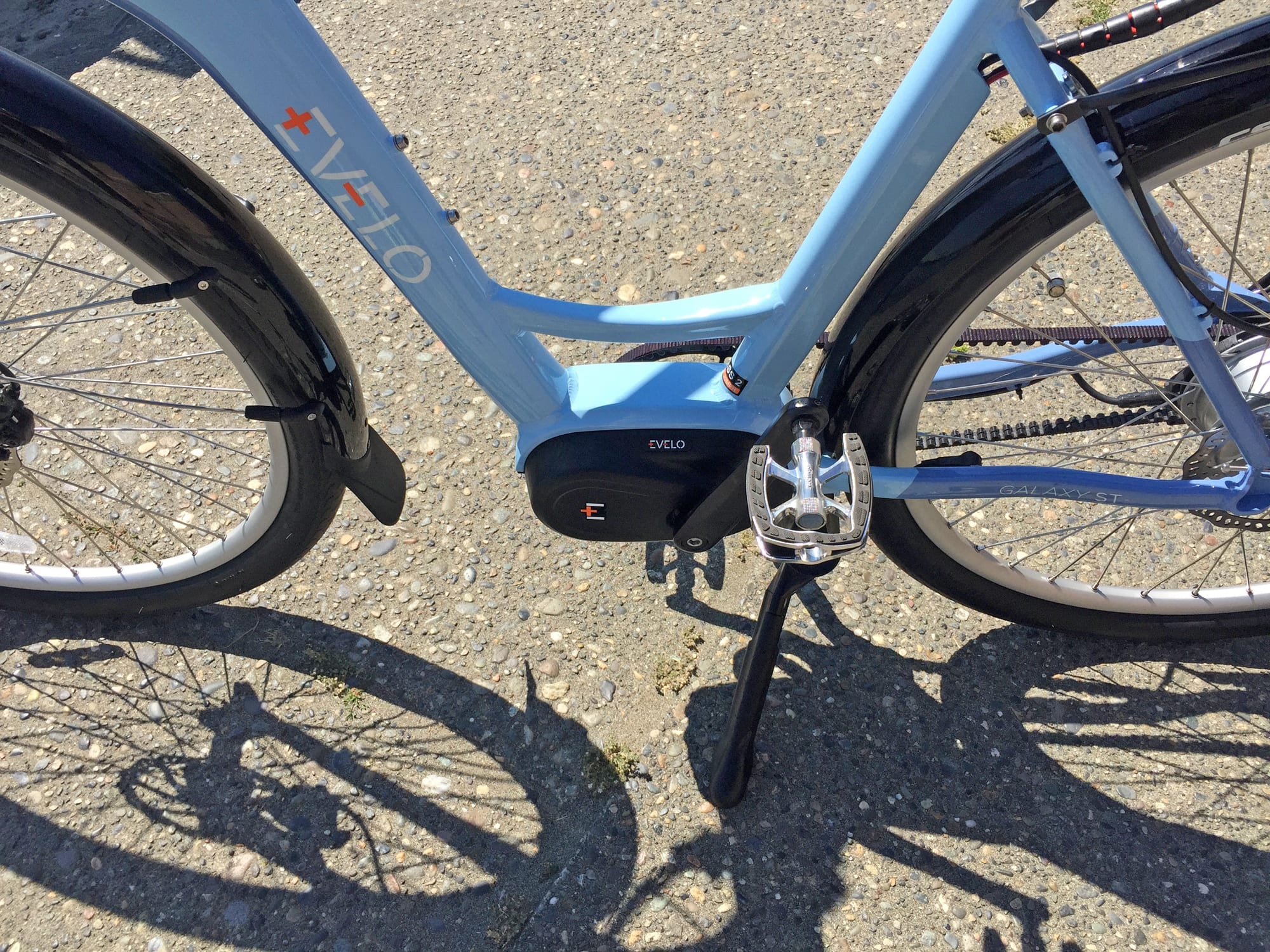

Propelling this electric bike is a Bafang Max Drive internally geared mid-motor. It’s relatively compact, impressively powerful (producing up to 80 Newton meters of torque), and ranges from 350 to 750 watts of power output. It’s a beast, but a quiet one, very quiet. Seriously, I have tested all of the mainstream mid-drive motors that are out right now in the USA (mid 2017) and the Max drive strikes a balance between responsiveness, affordability, and quiet-smooth operation. I like it a lot, even though it doesn’t have shift detection like Bosch… and with the single-sprocket belt system here and the internally geared CVT drivetrain, you really don’t need shift detection. As you pedal, the motor controller measures rear wheel speed and pedal torque. The more torque you apply, and the higher level of assist that you select, the more power and speed produced by the motor. It’s up to you to shift thoughtfully in order to reach higher speeds or climb more effectively, but as you do, the motor benefits and becomes more efficient. It’s a fancier design than a hub motor and this is part of what makes the bike cost more. The NuVinci N380 continuously variable transmission hub in the rear wheel uses orbs to pivot and translate sprocket spinning speed into wheel movement speed. It’s smooth and durable (because there’s no derailleur sticking out the side) but it weighs and costs more too. If you get the upgraded Harmony electronic NuVinci, the system looks to you for guidance on pedal speed and then automatically shifts to keep your input constant. The speed of the bike will change but you won’t have to change how hard you’re working or think about shifting with the right grip as you ride. Both systems look similar but the electronic Harmony hub has a plastic box on the right side to house electronics.

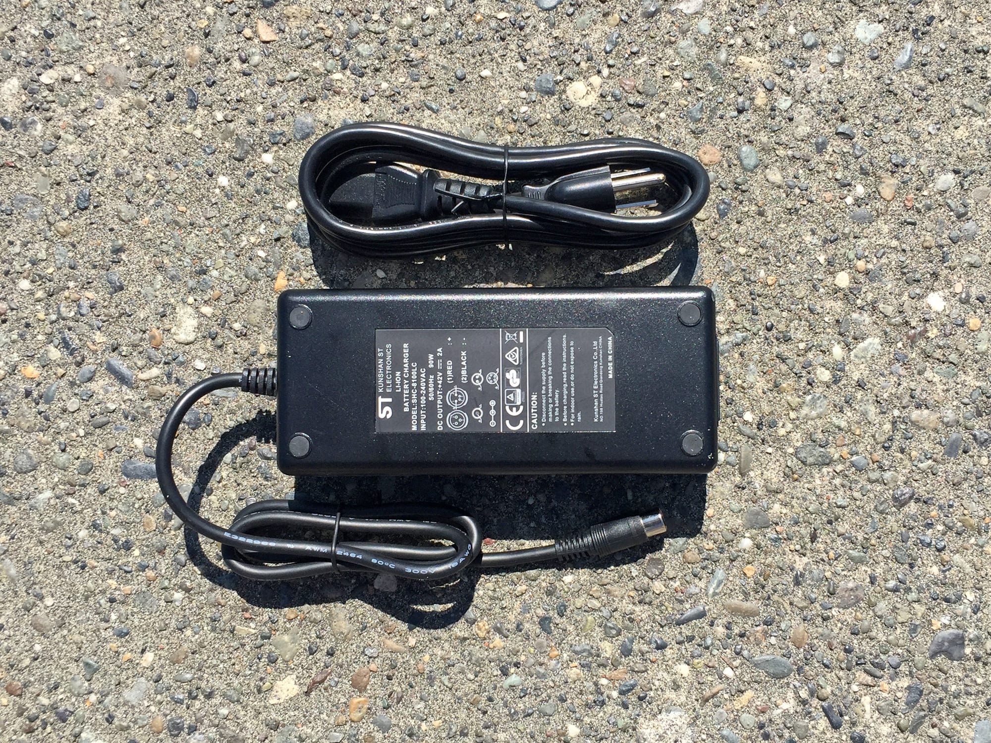

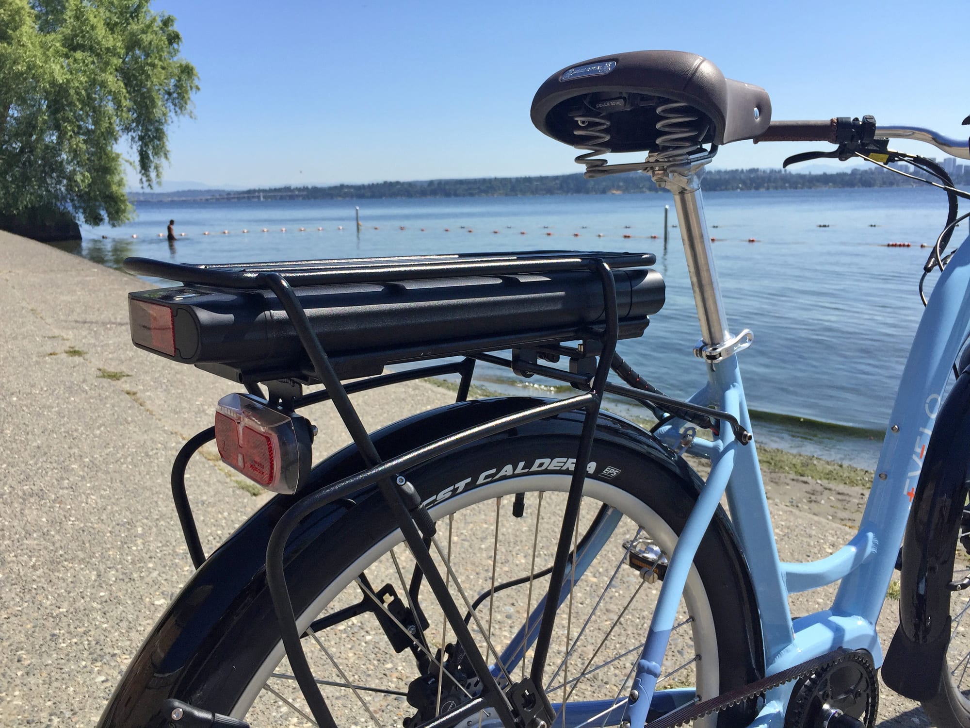

Powering the bike is a 36 volt 13 amp hour Lithium-ion battery pack that slides into the rear rack. I was told that the cells inside are made by Samsung and are of A and B quality so they should age well and maintain a higher average capacity. And Evelo backs this up with a solid two-year comprehensive warranty. In fact, they offer up to four years for everything except the battery pack which is an industry leading plan. I visited their shop and saw several returned products and those which were undergoing service, and I came away very impressed. It is not cheap or trivial to offer this level of service but they pull it off and instill a level of trust that most other brands just don’t reach. Evelo is a mid-sized company, they answer the phone when you call and jump on issues as they come up… even going so far as to service competing products that use similar systems like older iGO models. So anyway, the battery design and size isn’t the world’s most impressive setup, but it’s still above average and should work well for most customers. The position of the battery isn’t ideal, up high and towards the back of the bike, but I understand that they used the same battery and rack for both the TT and ST models which makes it cheaper and easier to service. It wouldn’t have made sense to use a mid-mount battery on the ST because that would have gotten in the way of the wave step-thru frame. The rear rack design felt solid and had pannier side blockers and a nice bungee attachment hole near the bottom which made it seem very useful and versatile. It’s a capable rack, and only a portion of the 53 lb max capacity is used by the 7.4 lb battery pack, so you could use it for books, groceries, or riding gear like a lock and the battery charger. Range will vary depending on whether you use pedal assist or rely on the throttle, how much weight is being moved, what the terrain is like, and what level of assist you choose. But, you can bring the compact 1.1 lb charger along for a fill-up very easily. It’s a standard 2 Amp design and should offer 50% in just a couple of hours if the pack is near empty.

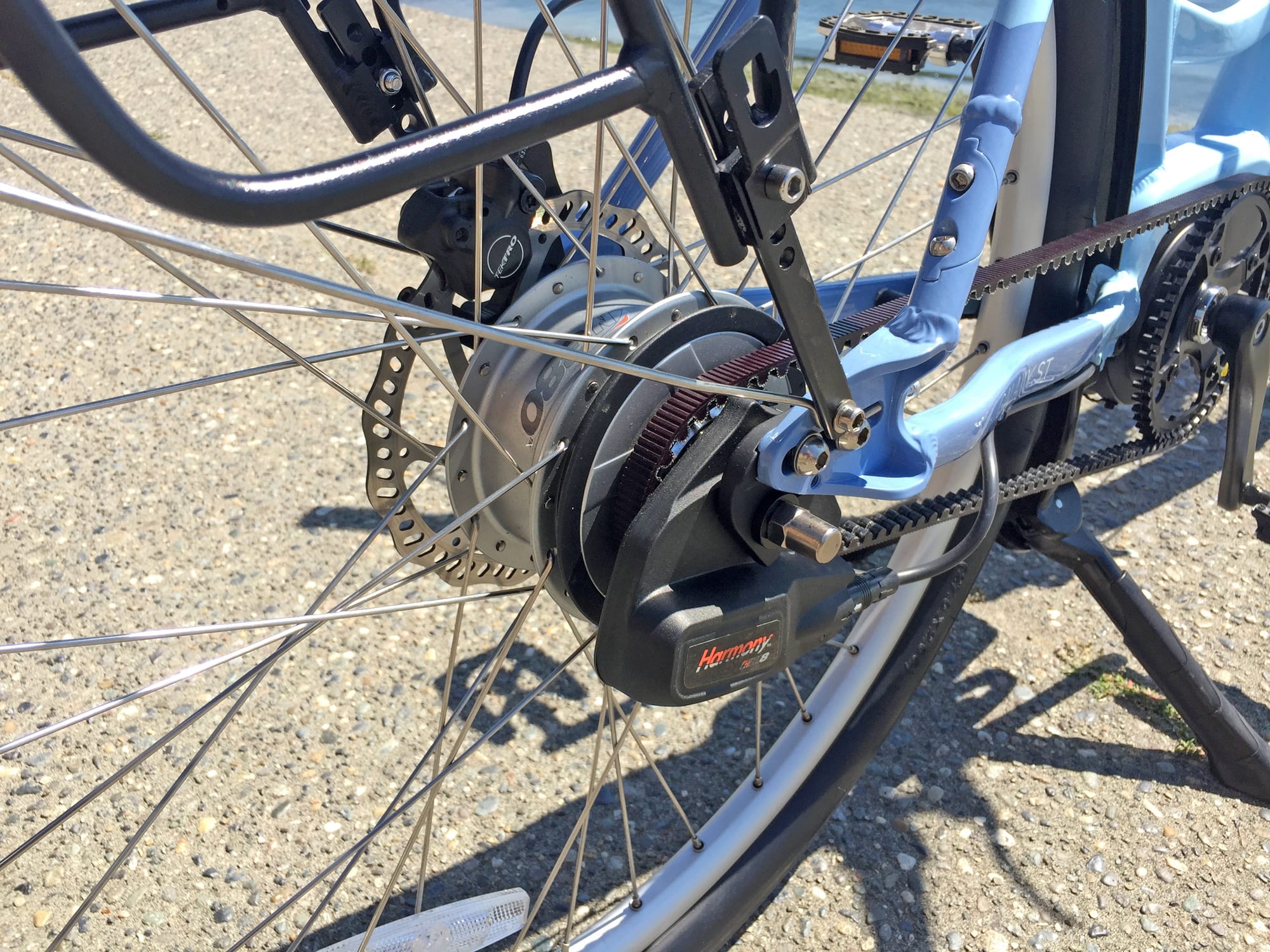

- The combination of a mid-drive motor pulling a belt drive and shifting a continuously variable transmission hub is the cleanest, quietest, and most reliable you can get

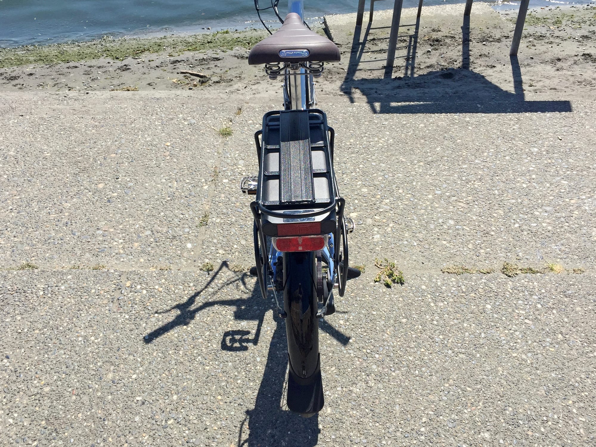

- Considering that the Evelo Galaxy ST has such a nice rear rack (with pannier blockers and bungee connector hole), I’m glad that they opted for a heavy-duty double-leg kickstand so you can load it up without tipping the bike

- The NuVinci CVT hub allows you to shift gears at standstill which is handy if you stop on a hill, it should hold up well even if you shift while the motor is working (though it requires more effort)
- Gates is a leading producer of carbon belt drive systems and the CDX uses a center track to stay on track, the belt should hold up longer than a chain and won’t make as much noise or be as messy in most cases, note that the frame had to be custom built to work with a belt drive… it has horizontal rear dropouts to keep the belt tight and a cutaway on the right seat stay to get the belt on and off for replacement

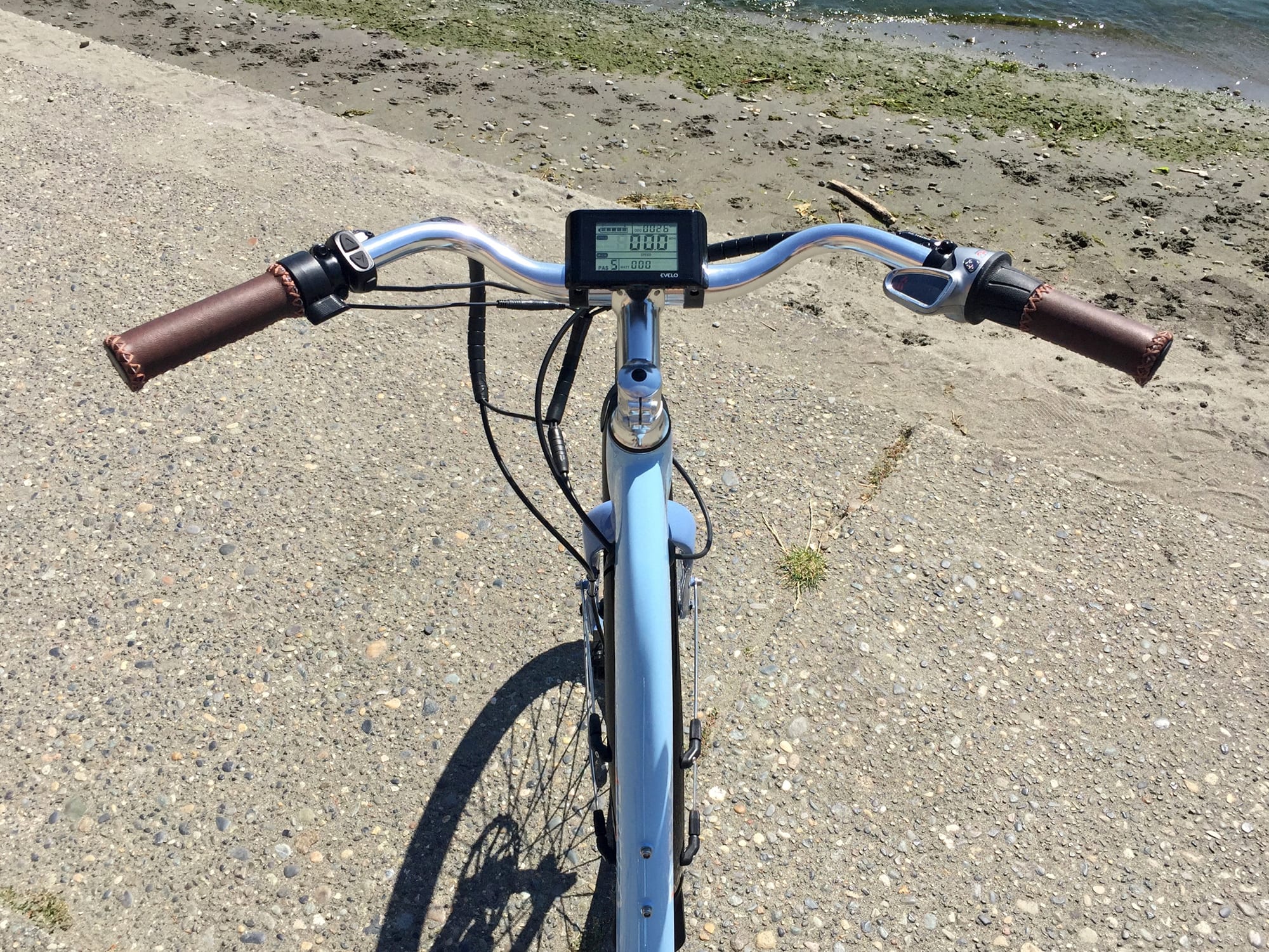

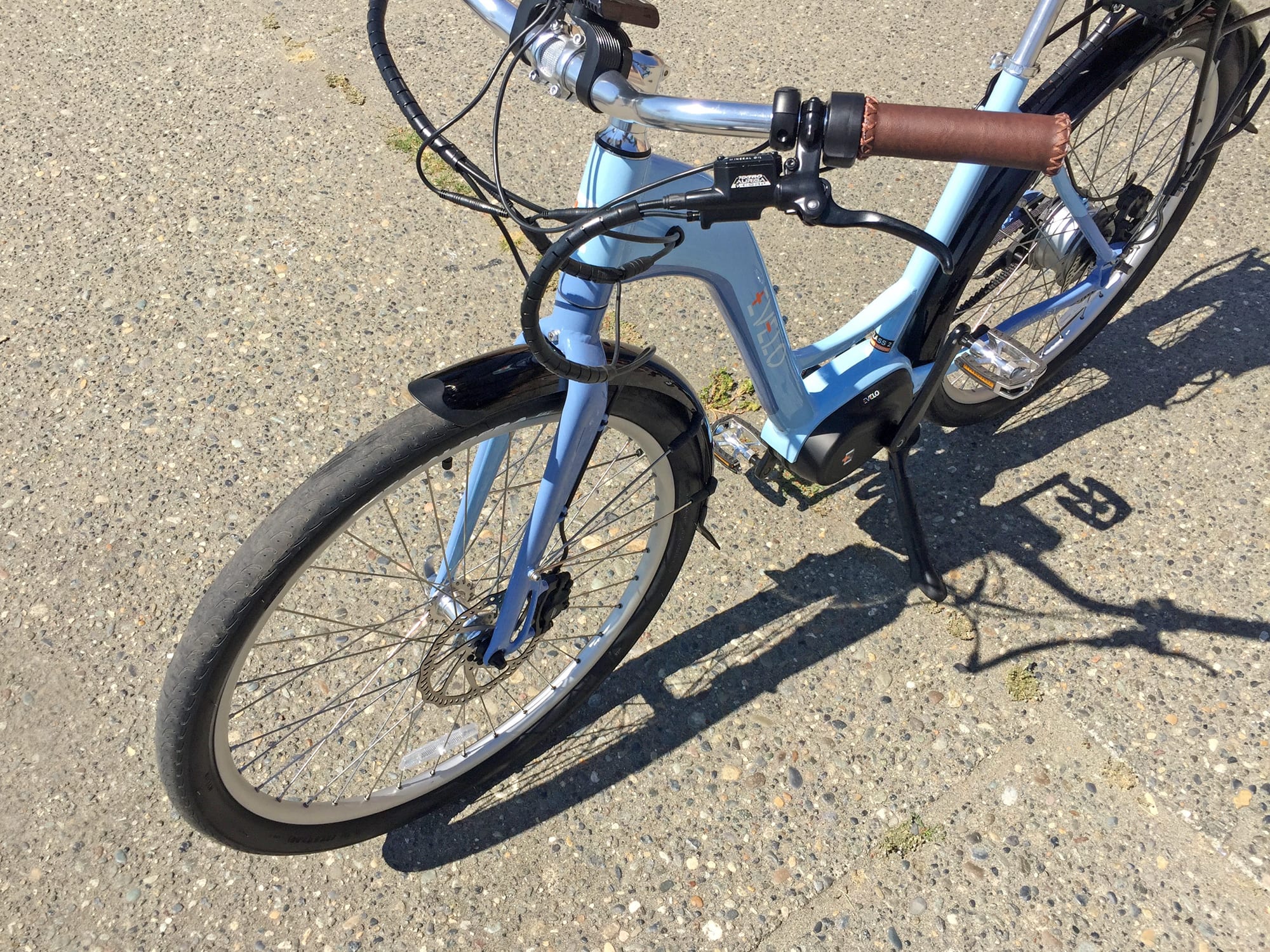

- The cockpit is a bit crowded with the large display and trigger throttle and there’s some wire clutter up front because of the extra motor inhibitor cables coming out of the brake levers… but this is such a minor thing, the wires route through the frame just after the head tube which looks nice and reduces snags

- The display is not removable, which means it can take more weather wear if parked outside or get scratched up at a bike rack… but it does angle forward and back and won’t get lost as easily or get loose
