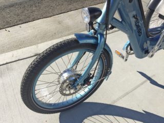

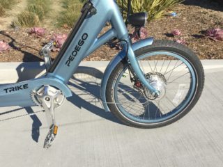

Driving the trike is a modest 250 watt internally geared hub motor spoked into the front wheel. The peak output is around 650 watts and it’s made by Dapu which is a higher-end brand with zippier performance. One thing I noticed with their new hub design is that the motor power cable comes down through the axle vs. out the end. This keeps it tucked away, reducing snags and bends that can eventually ruin the motor. Rather than 20 mph or even 15 mph the Pedego Trike is speed limited to 11 mph in pedal assist and 7 mph in throttle mode. Trikes are more stable when mounting and loading but they can get up onto two wheels at higher speed when taking sharp turns. The lower top speed here might be a nod to safety and it probably also improves range. You can hear it operating at full power but overall, I’d say the motor is quiet… complimenting the now quieter plastic tub, front fender and chain cover. For a trike with all of these extras added on, I was also impressed with the 73.6 lb curb weight.

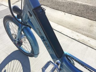

Powering the motor, backlit display and LED lights is a very average sized battery. But again, the lower top speed helps to extend range and LED lights don’t take much juice… The pack offers 396 watt hours (36 volts, 11 amp hours) of capacity and uses high quality Panasonic cells that should last. Unlike the older trike, this battery is easy to reach and remove if you’d like. It’s right there in the frame tubing which helps to bring weight forward on the trike (improving front wheel traction) and locks on securely with a key. Some electric trikes make you leave the key in while riding, like the ignition on a car, but not this one. It would be in the way and vulnerable to being kicked if so. Basically, they did the battery right. You can charge it on-frame using a port on the left side of the frame or take it off and charge it inside. The pack has a folding handle to give you a solid grip (dropping batteries is not good) and there’s even a little LED charge level indicator built in so you know how full it is even if it’s not mounted to the bike.

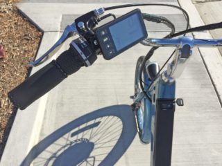

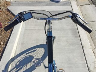

Operating the new Pedego Trike is very easy… Once the battery is charged and locked in place, just press and hold the power button on the brilliant LCD display for a few seconds. It flickers to life showing battery capacity, speed, assist level and trip stats and it starts in zero. This is a good thing because the twist throttle could get bumped if the trike started in level 1-3 and take off on you. I recommend sitting down on the trike before powering it on, then arrow up one, two or three clicks and begin pedaling. Note that this electric trike uses a fancy torque sensor vs. a cadence sensor. I’m not sure I love the choice because it required more leg power than expected during my test rides. I was consistently in the highest level of assist but still opted to use the twist throttle most of the time to get going. The combination of a “shift anytime” internally geared hub, three levels of assist and the throttle option make the experience great and I suppose that cadence sensors (which tend to have an on/off jerky feeling) wouldn’t be as smooth. And so, maybe down the line the controller will be adjusted so you don’t have to pedal as hard to get the motor to respond and note, this was a pre-production build of the trike which had been used for demos. I recommend visiting a dealer to try for yourself :)

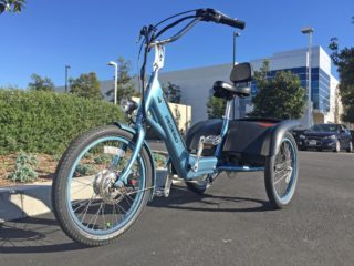

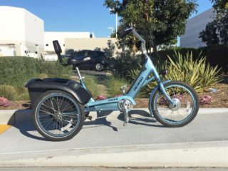

- A purpose built (from the ground up) electric trike with color matched wheels, chain guard and front fender

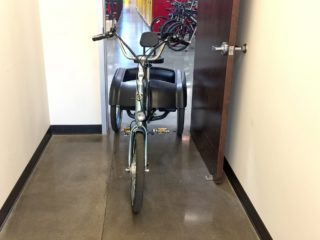

- Comfortable and stable yet narrow enough to fit through most doors (it measures 30″ wide), the oversized seat with back rest and high-rise swept back bars offer an upright body position
- Feet-forward design allows for lower seating position and easier mounting, the deep step-thru frame is very easy to step onto and sit down on
- Both brake levers have locking pins so you can steady the bike when loading/unloading and have it stay put when not in use (trikes don’t usually have kickstands so this feature is important)

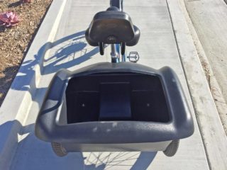

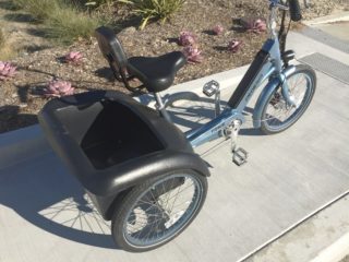

- Unique plastic cargo bin in the rear looks sleek, is textured with “orange peel” tread to hide blemishes and has drains in the bottom for easy cleaning, I like that it doubles as a fender for both rear wheels
- The battery pack on this e-trike is relatively easy to access and doesn’t require that your keys be left in to operate, you don’t have to bend way down or reach under the cargo bin to get at it… if you do take it off, there’s a plastic handle on top making it easier to move around

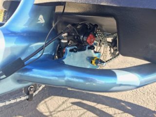

- This electric tricycle has disc brakes! I was really impressed to see two discs and found that they stopped fairly well and were easier to use than some band brakes and linear pull brakes

- Dapu hub motors are well designed and tend to be zippier than the competition in my experience, the power cable does not come out the end of the axle (where it could get snagged or bent if the trike tipped), it comes down and tucks near the fork arm
- The original Pedego Trike had a rear-mounted battery which added to the weight of the two wheels and bucket… for the new one, having the battery up front makes the frame more balanced and allows for more space in the bucket

- Several times when trying to pedal, I snagged my heels on the plastic bucket shell, I wear 9.5 shoes (so my feet aren’t especially large) and feel that the shell of the bin should not protrude so far… it’s just the plastic cover, not the inner box that snagged me so I feel like they made it long for style vs. function and maybe you could cut adjust it yourself if you snag your feet too
