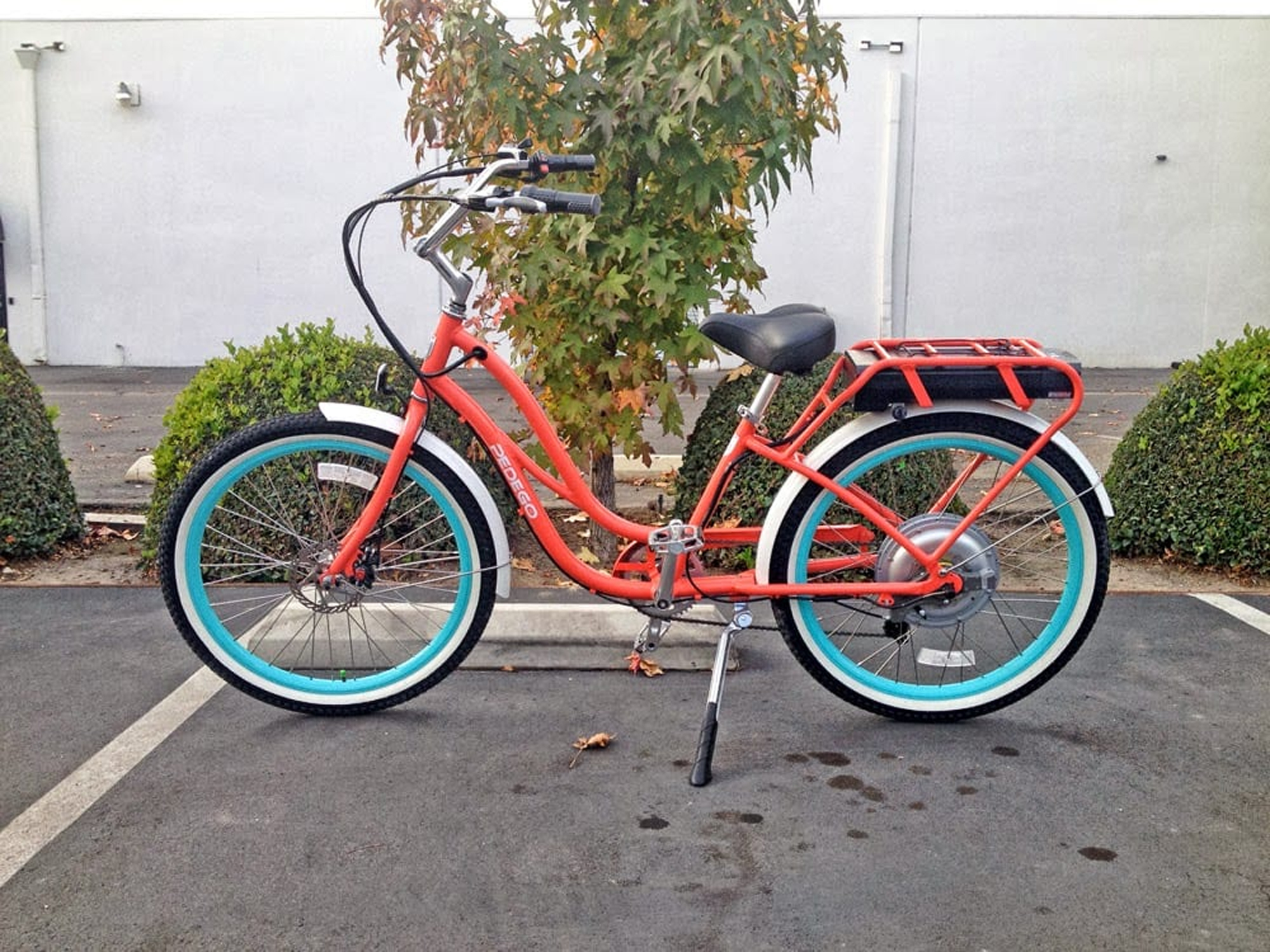

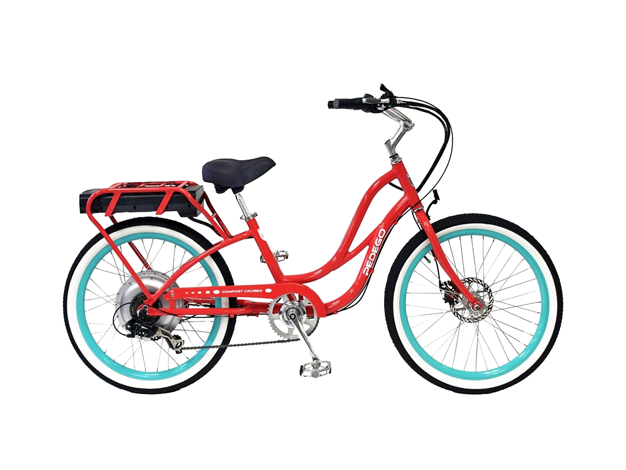

The Comfort Cruiser is one of Pedego’s original designs, dating back to 2009, and the Step-Thru variation is meant to be easier to mount and ride for smaller individuals. The bike is simple, sturdy and powerful but less sophisticated than some of the newer designs offered by Pedego and others. That’s part of its charm and what makes it a wonderful choice for tours and rentals. It performs somewhere between a bicycle and a scooter, leveraging a twist throttle design that doesn’t require any pedaling to move. The fun colors, optional upgrades, friendly dealer network and solid warranty make this a high quality offering despite its more limited feature set.

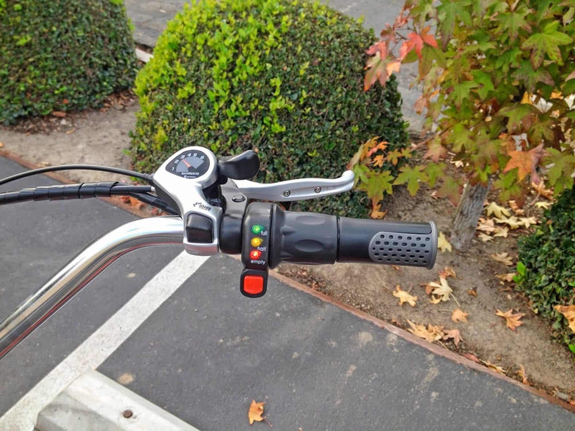

What you aren’t getting with this design is a fancy LCD computer console showing your speed, distance or precise battery level. Instead, you get a red on/off button and three LED’s (green, yellow and red) approximating how much capacity is left. There’s not pedal assist option, no fancy suspension forks and only six gears but as mentioned before… this keeps the bike simple to operate. Six speeds is enough to climb hills or reach medium speeds but it’s not so many that the derailleurs require regular tuneups or that the chain will bounce off. It’s a happy medium.

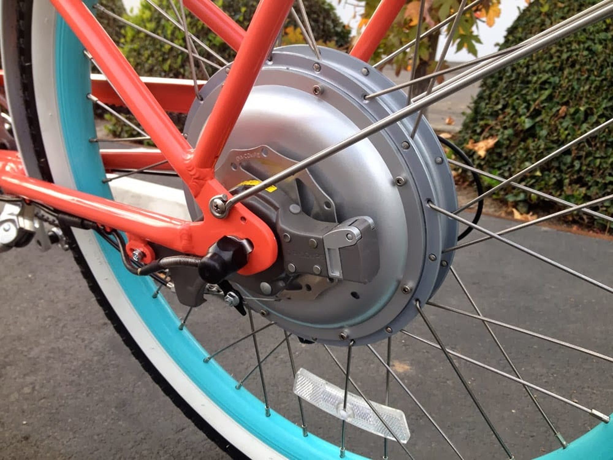

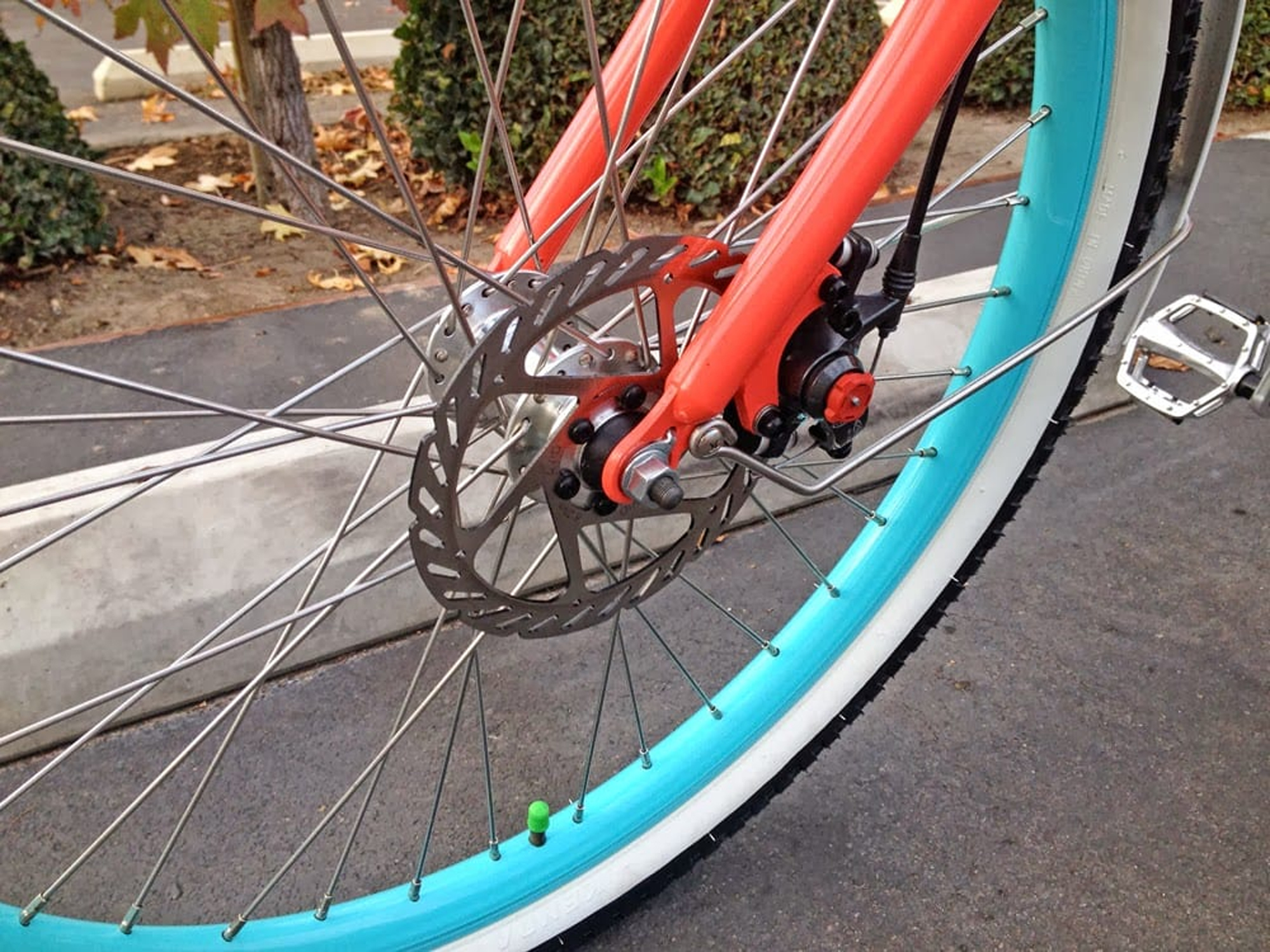

The motor driving this electric bike delivers 500 watts of direct drive power. It’s a gearless design that is very durable, quiet and smooth and it’s built right into the 26″ rear wheel. One downside to any hub motor design is that wheel and tire maintenance gets a bit more complex with the hub motor in there. For this reason, Pedego has added quick connectors to their wires here and just after the throttle. This hub motor is a bit larger and heavier than a geared equivalent might be but there’s still room for the 6 speed cassette and a band brake. Note that on the front wheel there is a disc brake which provides more stopping power. It’s a minor trade off and works well enough.

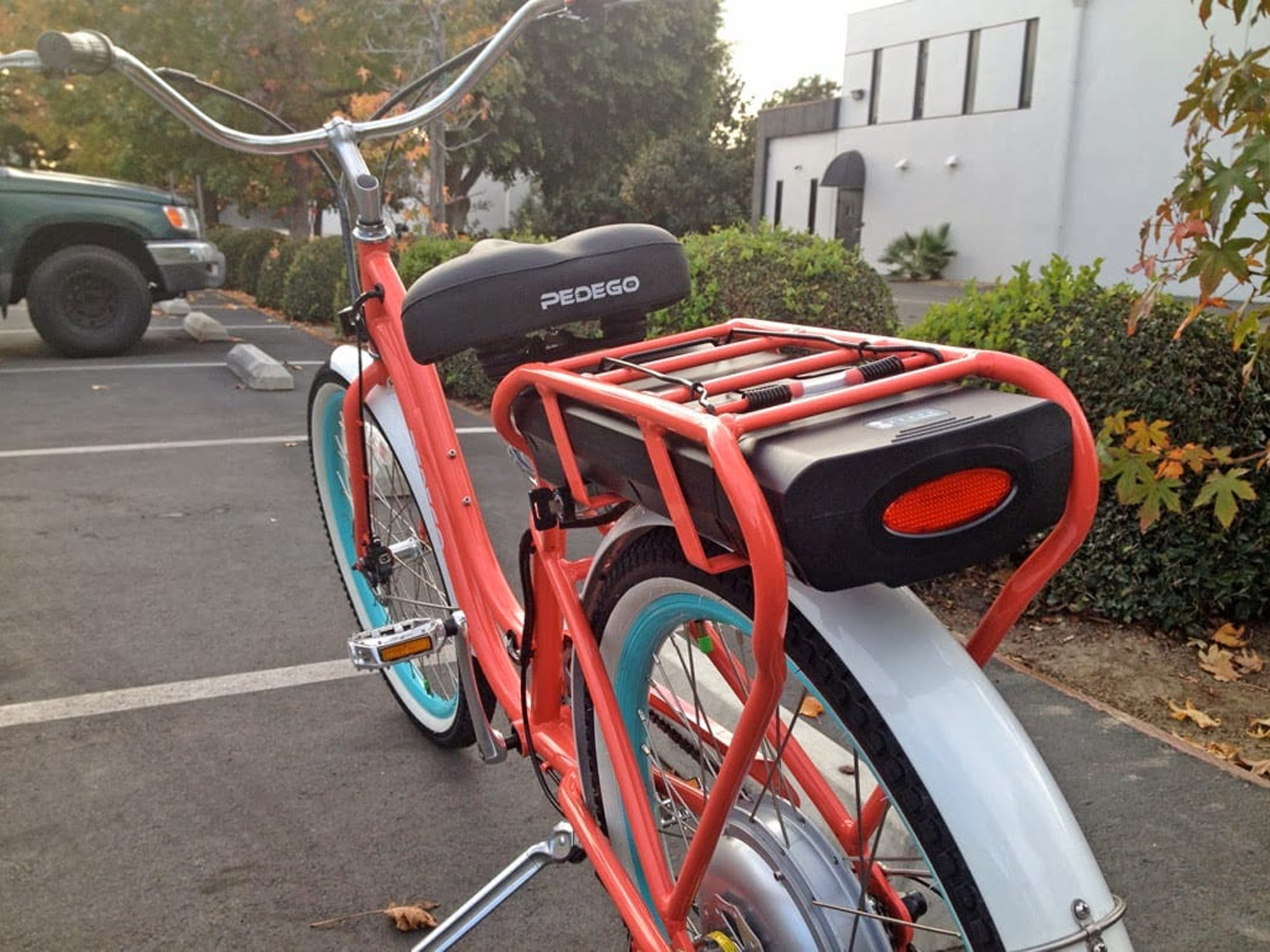

In 2014 the rear rack design was updated and now fully encloses the battery pack offering improved style, stability and rack mounting options. It also has a spring arm built in so you can secure basic items like clothing or papers without the use of a bag. Overall I like the design and appreciate that it’s welded directly to the main frame (adding strength and reducing the possibility of vibration loosening over time) however, the larger tubing is not standard and may not work with all panniers. I’ve had good luck with the Basil Elements set. It’s worth calling out that this and other ebikes that position both the motor and battery at one end of the bike tend to be more difficult to lift because they tilt backwards. The removable battery makes this easier (since it weighs ~8 pounds). Keeping weight lower also improves balance and the new rack does this to an extent but is still higher than some other electric bike designs.

- Single disc brake design (band brake in rear) provides a bit less stopping power
- Throttle only operation is simple to use and durable but less versatile than if it also had pedal assist
