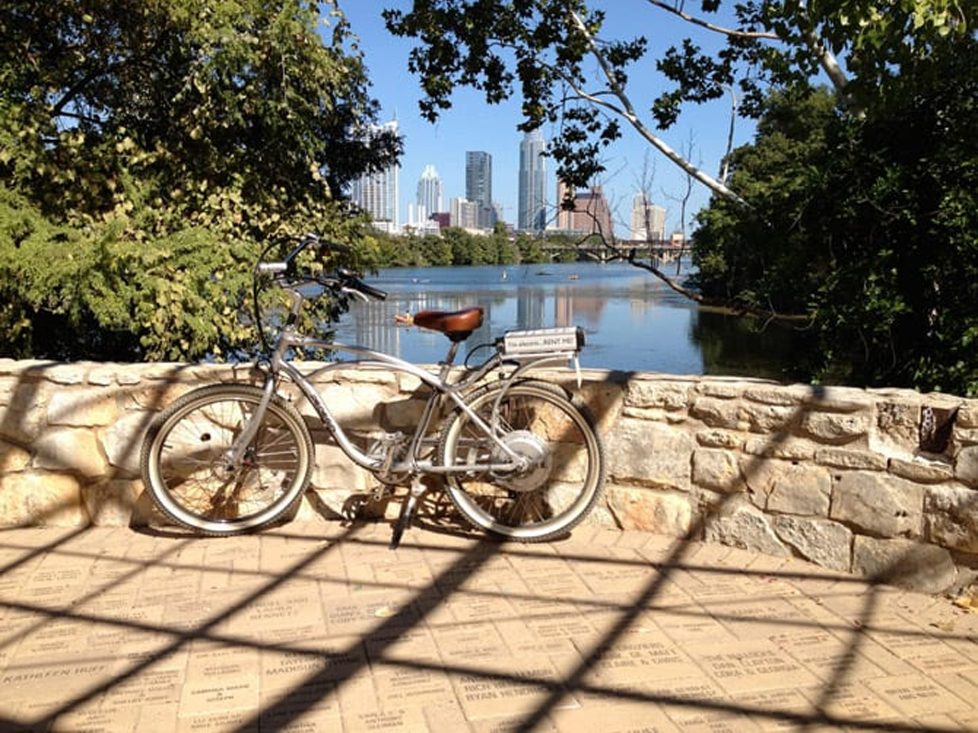

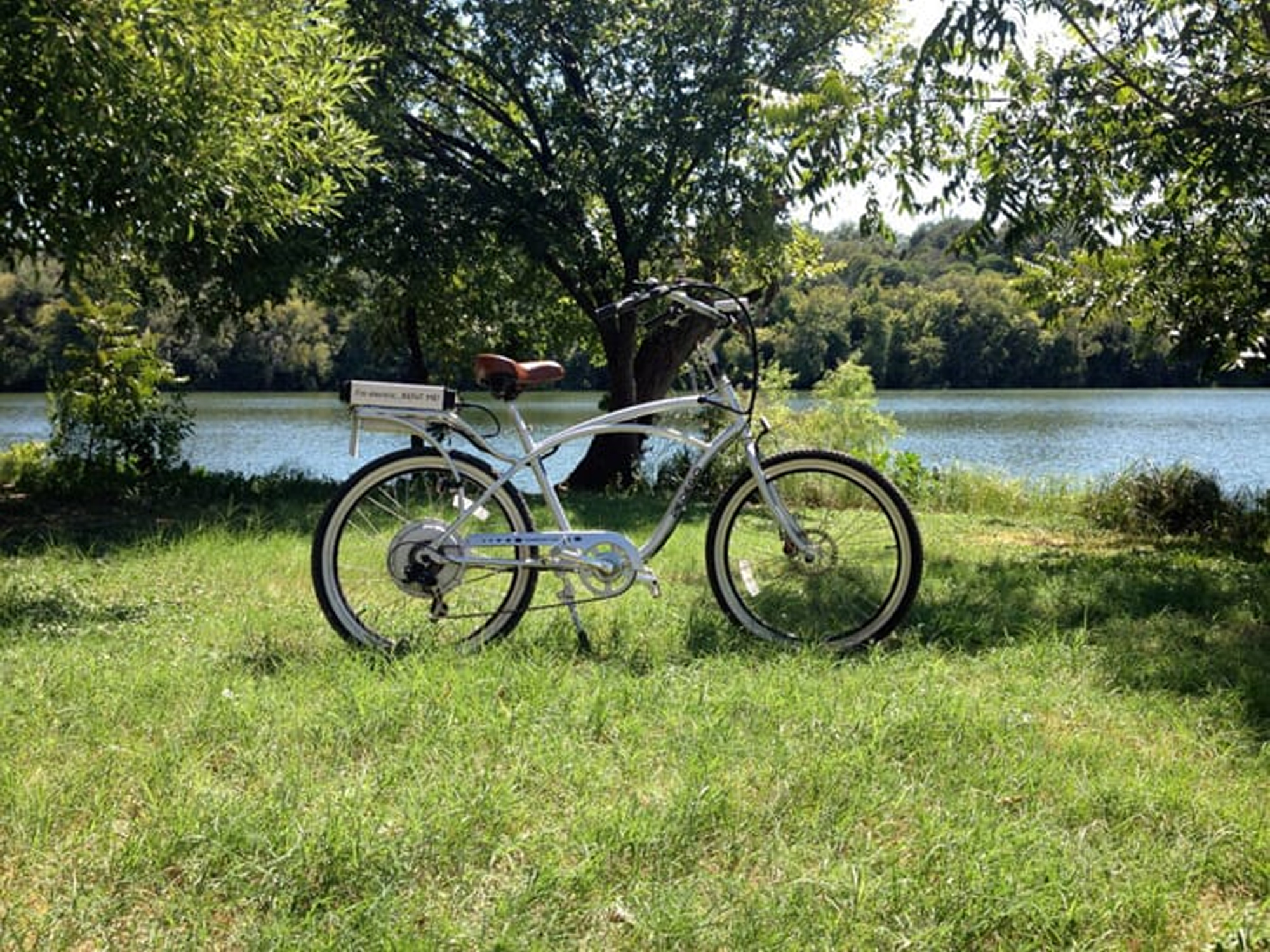

The Pedego Classic and Step-through Cruisers are loads of fun. Plain and simple. This bike was designed from the ground up to be strong, quiet and durable. It defines simplicity and quality by integrating wires, battery mount and motor in a way that reduces the chance of parts getting broken or stolen. This makes it convenient to ride and park just about anywhere. It’s one of the first bikes Pedego built when they launched in 2009 and has been refined over the years, becoming a leader in the space.

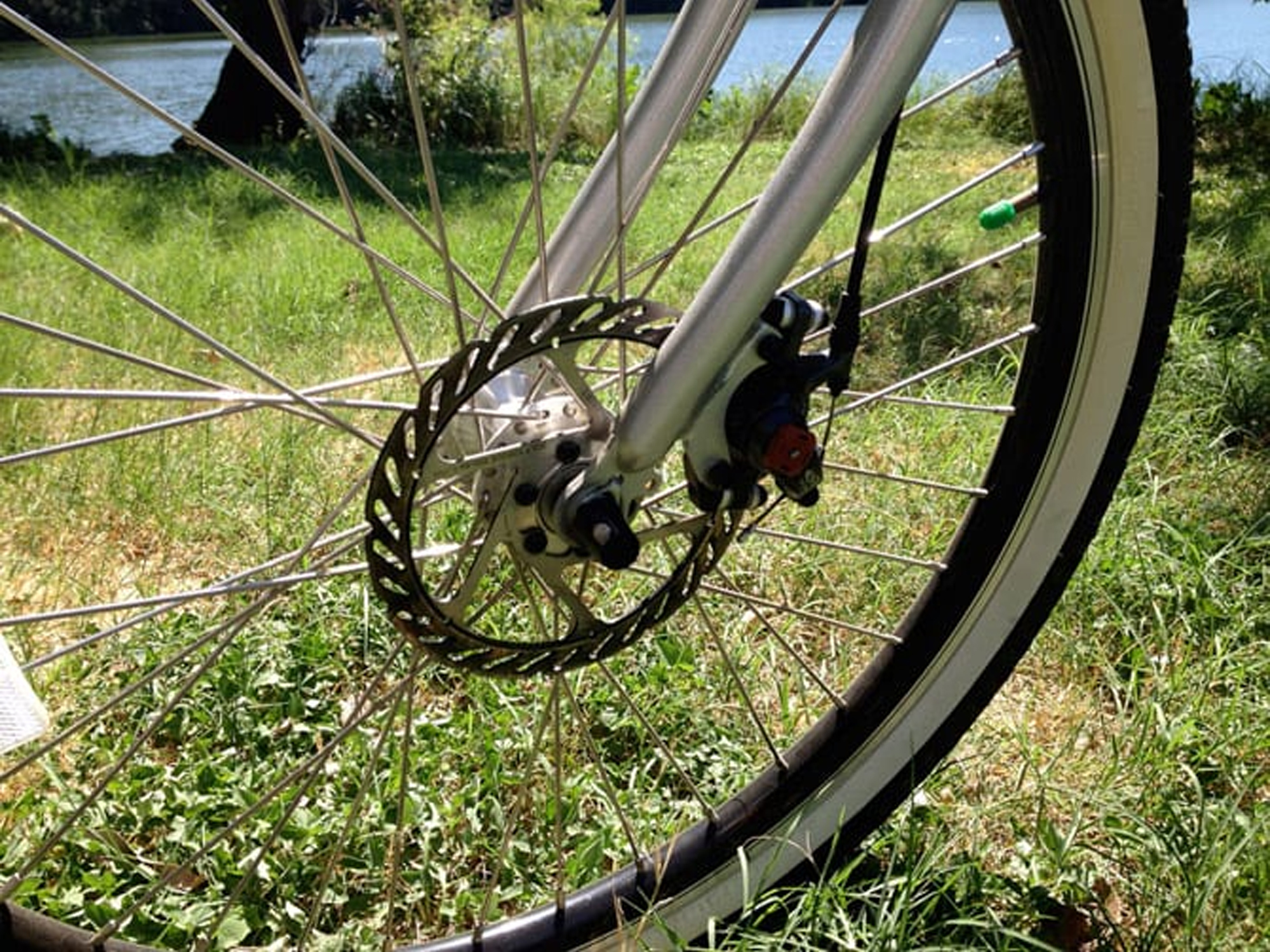

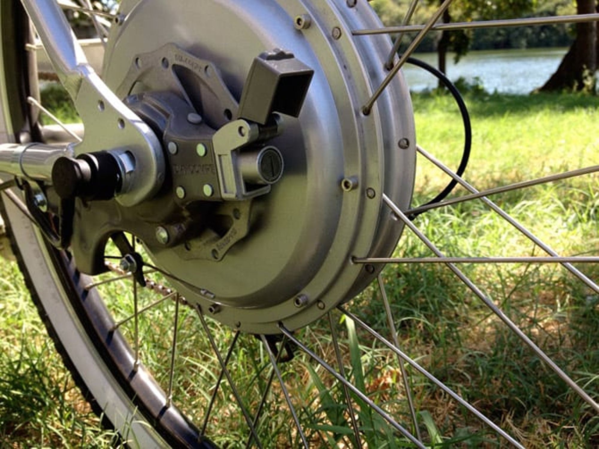

The 500 watt hub motor driving this bike is brushless and gearless making it super smooth and quiet. It provides good power for hills and heavier loads, but not quite as much as if it were geared. Gearless motors produce less friction when coasting and have fewer parts to wear out over time. Right next to the motor is a drum brake (the front of the bike has a disc brake) and a hub lock where you can use a key to immobilize the bike, just remember to unlock it before you try to ride away or it could damage the hub!

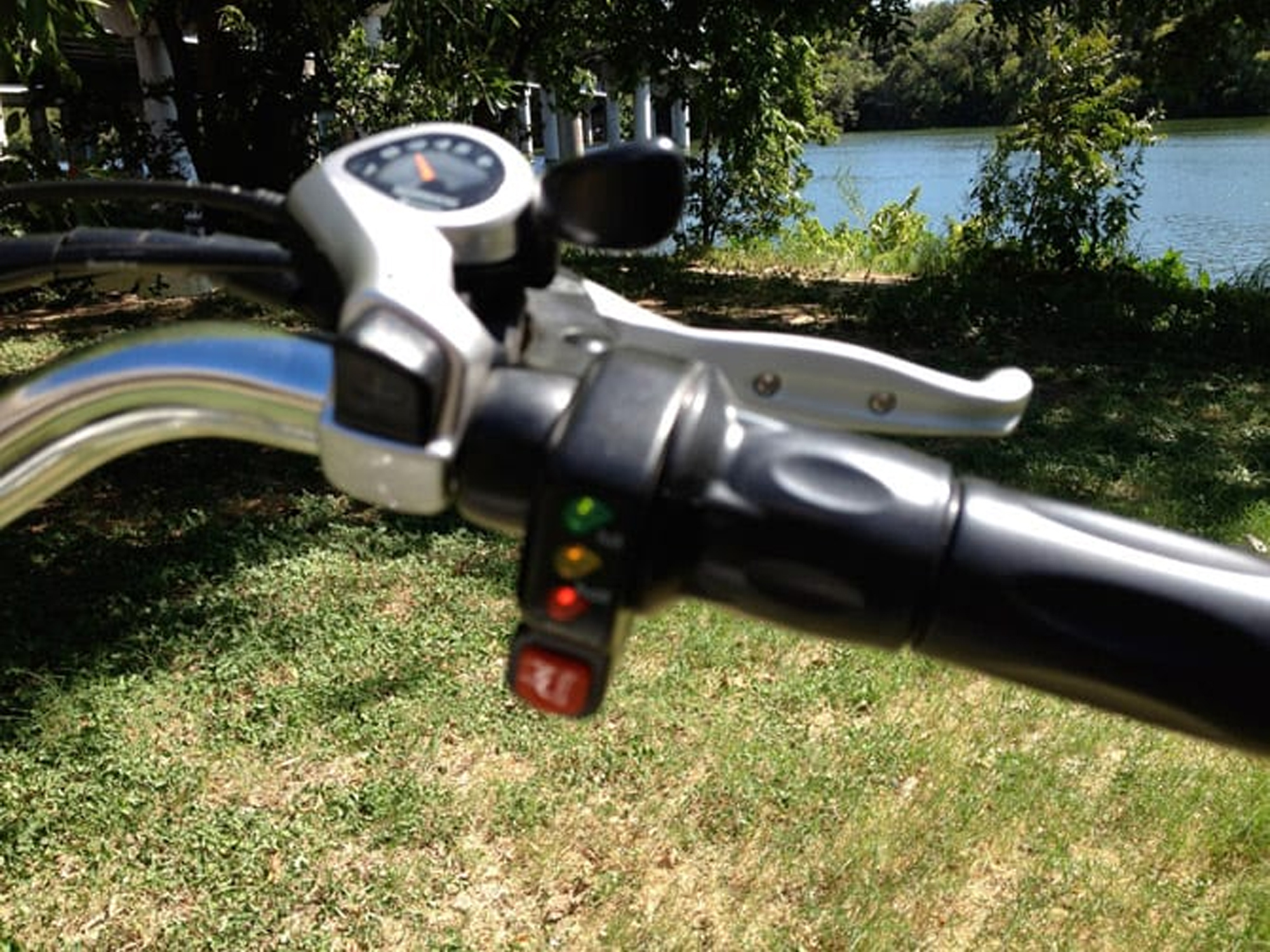

One thing this bike does not offer is pedal assist meaning you will constantly have to twist the throttle to get power. While this may seem like a negative when compared with other electric bikes that have both such as the Pedego City Commuter, it actually makes the system a lot simpler to ride and less prone to damage and failure.
Riding is almost thoughtless, as soon as you twist the throttle it goes. That’s it. It’s a great design for bike rental companies or less tech savvy users who just want to have fun because there’s less to get in the way. I really love the twist throttle design because it feels more like a scooter and makes riding a lot less complicated in stop and go situations.

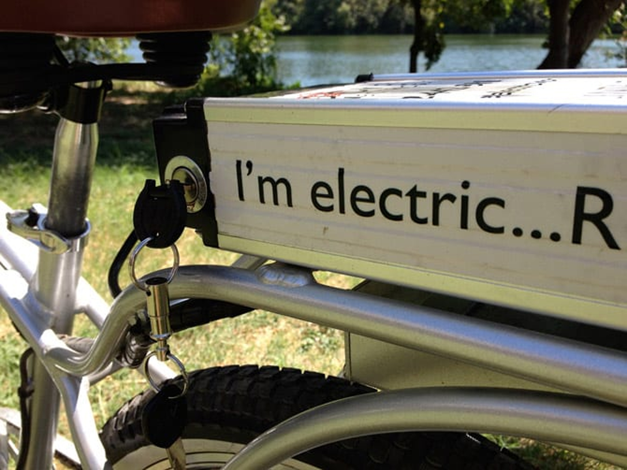

In terms of battery power, this bike relies on a 36 volt, 10 amp hour Lithium-ion pack secured inside a locking aluminum cube. In laymans terms that equates to good power, good range and durable! If you’re a larger rider or just looking for something with more power you can upgrade to the Interceptor model and get a 48 volt battery pack on basically the same frame. I recommend this option for riders who weigh in excess of 180 pounds.

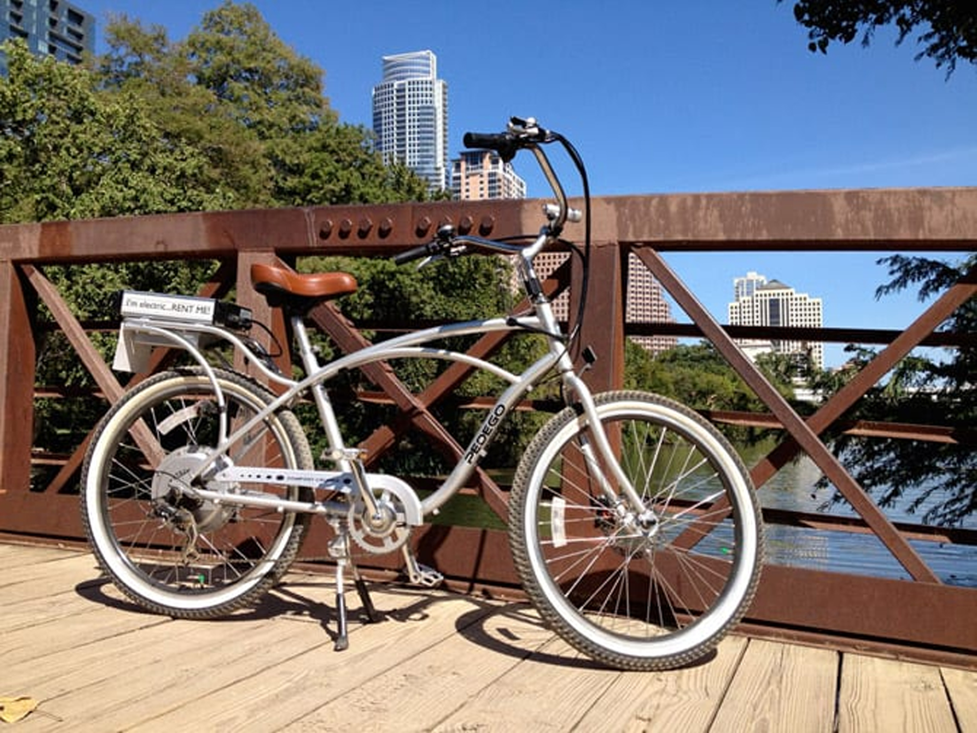

By positioning both the motor and battery pack towards the rear end of the bike, Pedego has made it easy to steer but a bit more hazardous when turning. The front wheel of this bike is more prone to sliding out because less weight is pushing down on it. This is especially true on wet surfaces so be careful! Also, carrying the bike up stairs and lifting it to get through narrow passage ways can be tough because the rear is so heavy. It can be a pain to deal with at times but the battery pack is removable and that helps a lot.

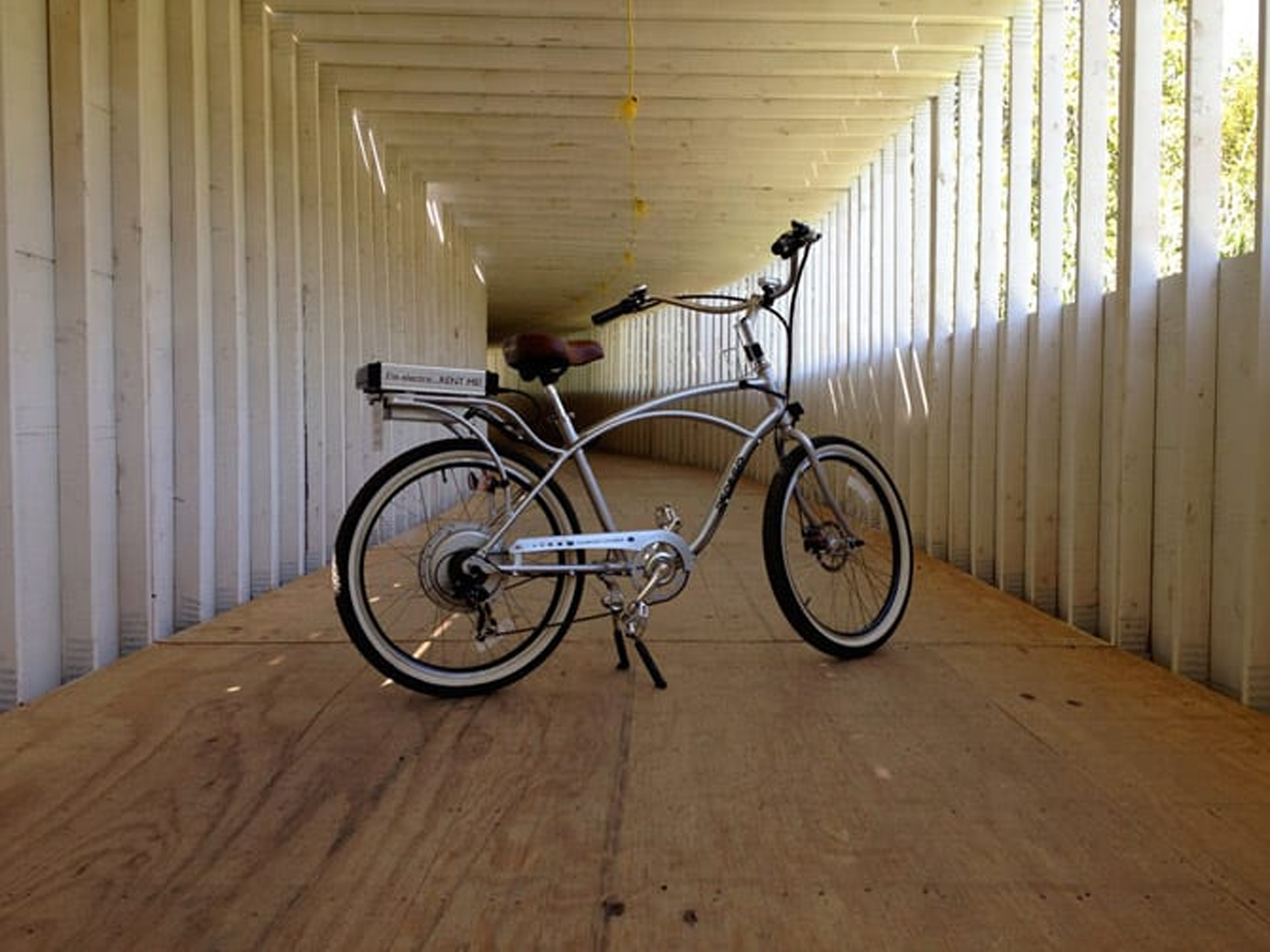

One of my favorite parts about this bike design is the design itself. Not because I’m a huge fan of the beach cruiser look… in fact I am not! I prefer the thin fast lines of a road bike but one thing you miss with that style is an upright ergonomic position. The bottom bracket (where the pedals go through the frame) on the Cruiser is actually positioned further forward which puts your feet more forward than down. This makes the bike feel more natural, like sitting in a chair or riding on a motorcycle, and keeps the rider lower to the ground. The handlebars compliment this position by being very long and swept back. This design combination provides some shock absorption when going over bumps, reducing neck and back strain because you don’t have to bend over to steer or support your weight with your forearms and wrists. This is especially good when you’re riding with a backpack.
Rider positioning is really a huge point here, while other bikes integrate front shocks to smooth out the ride, the handlebars and larger tires of the Pedego Cruiser bikes accomplish almost the same thing. The tires themselves are made by Schwalbe, come kevlar lined and are pre-Slimed helping them to endure many miles while avoiding flats. For even more comfortable rides you can upgrade the tires to even larger “balloon” edition. The seat ties all of this together by offering a large soft surface that is sprung with rubber bumpers. All in all, this is one of the most comfortable bikes out there, as long as you’re riding it and not trying to carry it up stairs ;)

- High end Avid disc brake on the front wheel provides good stopping power when combined with the rear drum brake

- Battery locks to bike for security, won’t start without key
- Built in hub-lock secures rear wheel and motor, just remember to unlock before riding away as it can damage the bike

- Rear brake is a drum brake that doesn’t offer quite as much stopping power as the front disc brake
