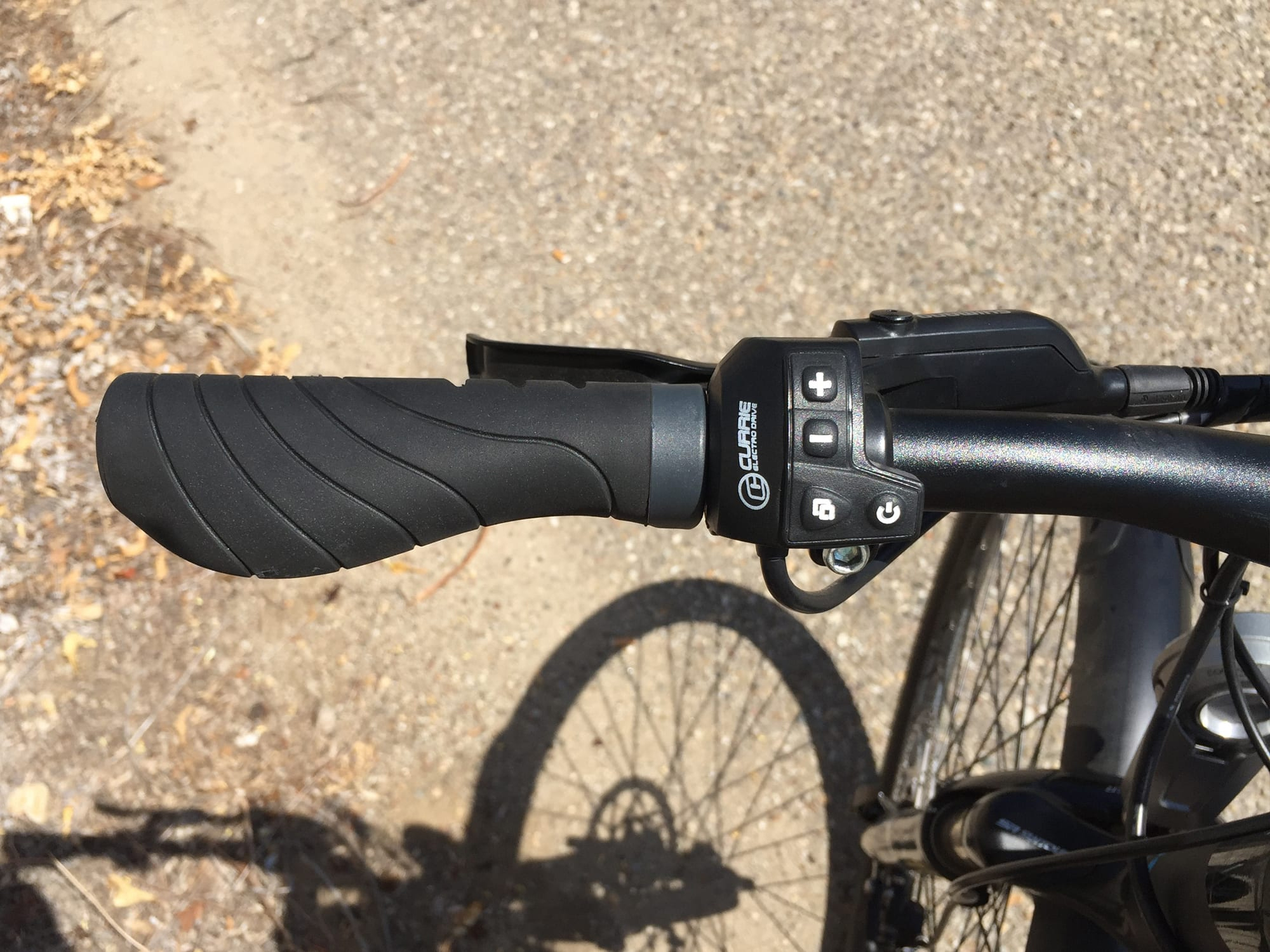

5 years agoHi! I bought and received mine at a killer deal and loving every minute of my commute now! Thanks for the review as it assisted in my decision to go with this model. However, I’m trying to find a manual/install guide for the boost button but to no avail. Nothing on currie or izip website. Any thoughts?
Thanks,
ReplyRenato
Court Rye
5 years agoHi Renato! I’m surprised to hear that… There should be a chat window or phone number to call and I know the part exists. I can’t speak for IZIP but maybe one of their dealers could help get one and ship it to you? They have a dealer map on their website here.
ReplyRenato Kalugdan
5 years agoHi Court,
I was able to install the boost button without the need for the guide as it was pretty basic. Question w/ the boost button however is that whenever I reach 20mph, it immediately throttles back down to 18-19mph or so. Climbs back up to 20 and this repeats. Any reason why it just doesn’t stay at 20 so I can just cruise at that speed without the bike jerking back and forth?
Thanks,
ReplyRenato
Court Rye
5 years agoHey Renato! Glad you got the button and were able to install it easily… What you’re describing has happened to me with some throttle systems (and even pedal assist at times). It sounds like the sensor they used isn’t as precise or there isn’t a slower ease-off approaching 20 mph. Considering it’s a button vs. a twist throttle, it’s more of an on/off performance anyway which isn’t as smooth or refined (but does stay out of the way at least). I don’t have any solutions to offer but I appreciate you chiming in so others can get an idea of the performance beyond what I shot on video and tried to describe myself. I don’t think you can get a twist throttle for your bike but there are other brands like Pedego that still offer them and they have models like the Ridge Rider that resemble the sporty look of the Dash but are more for off-road riding.
