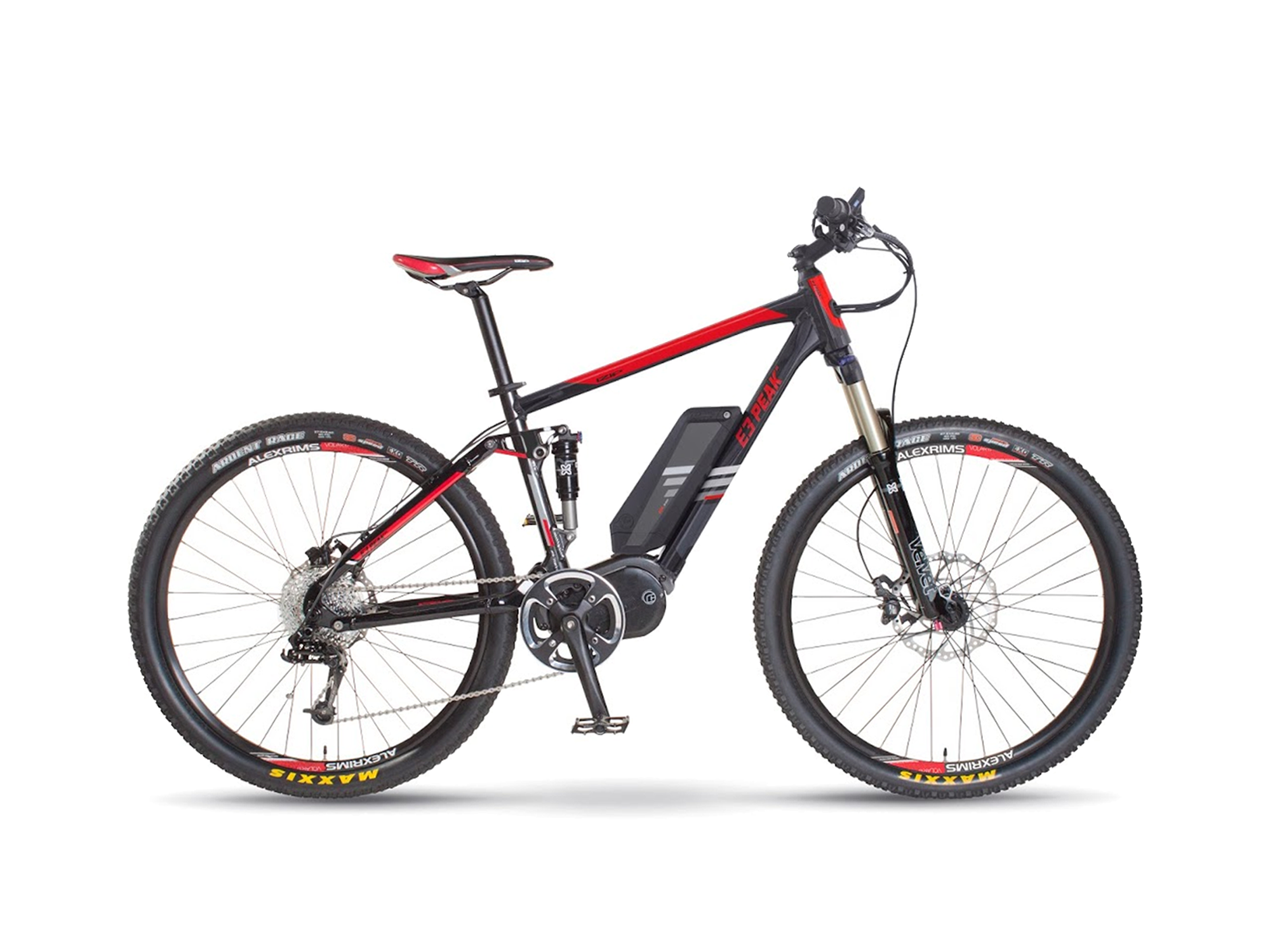

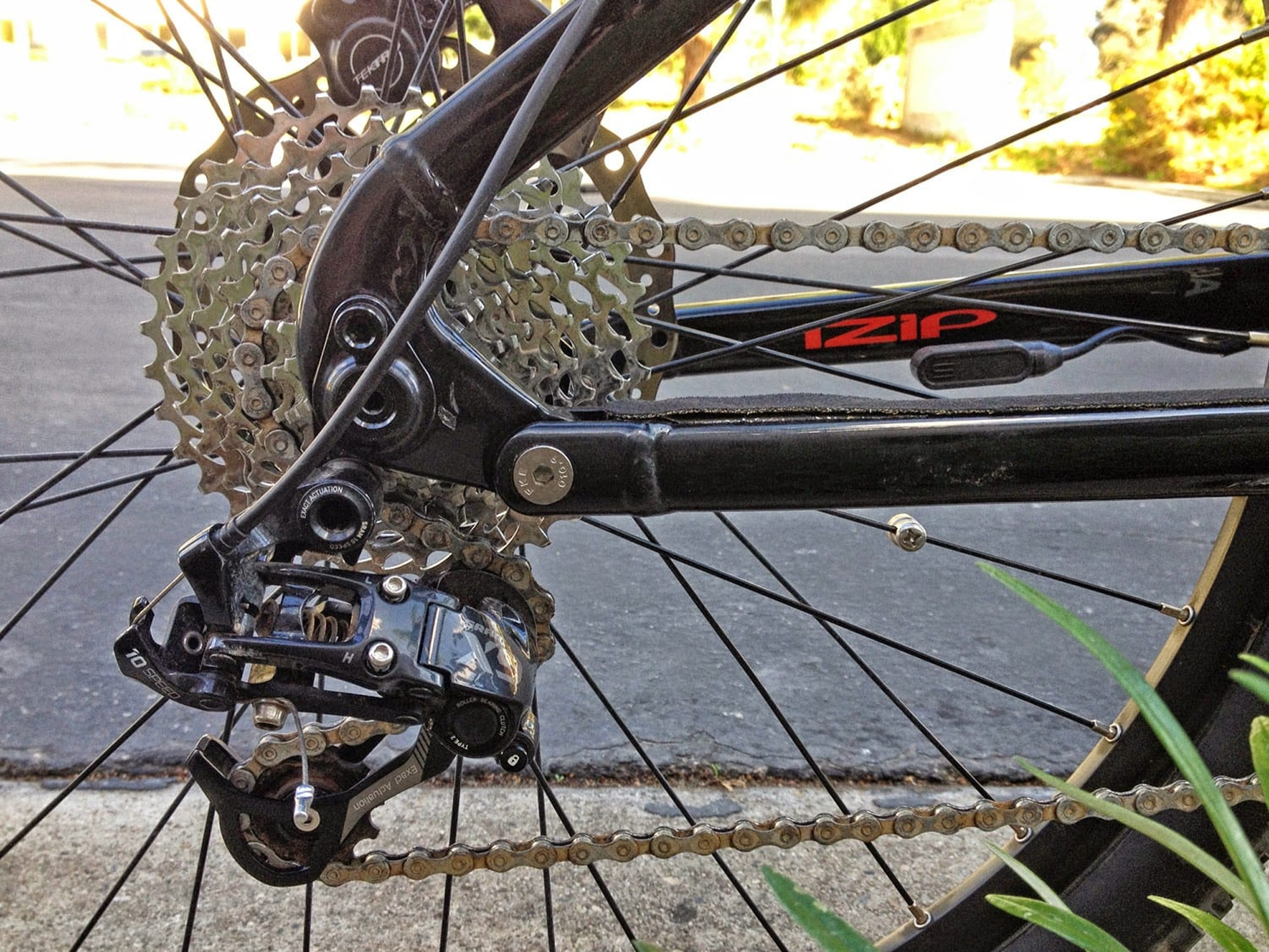

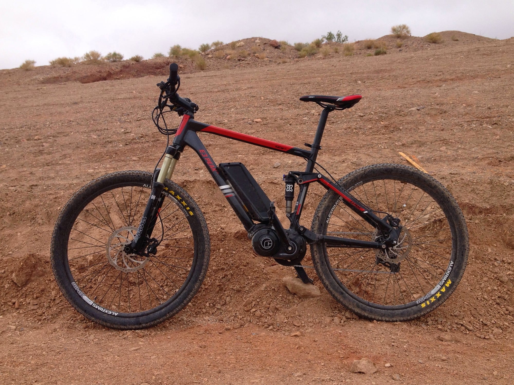

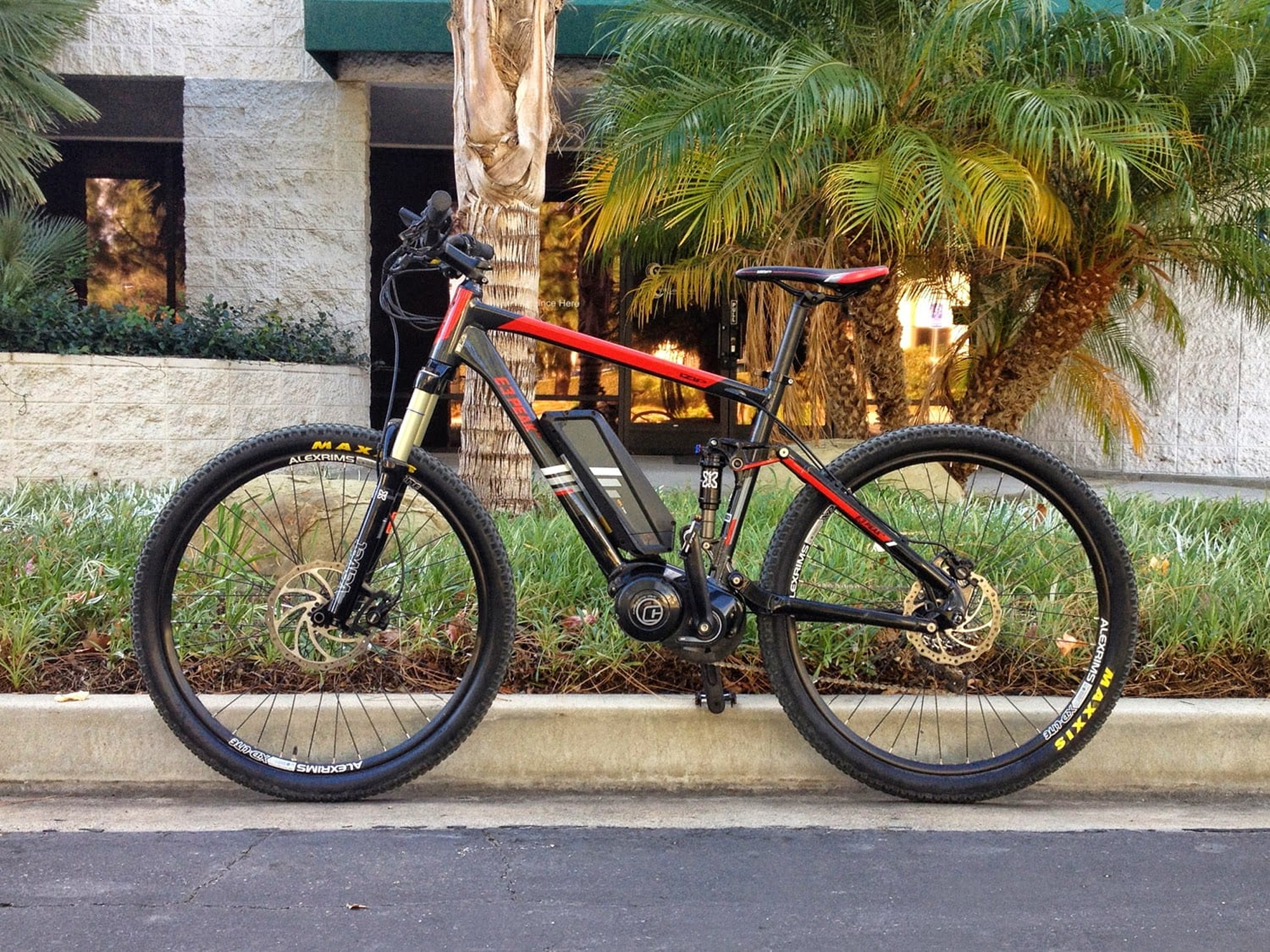

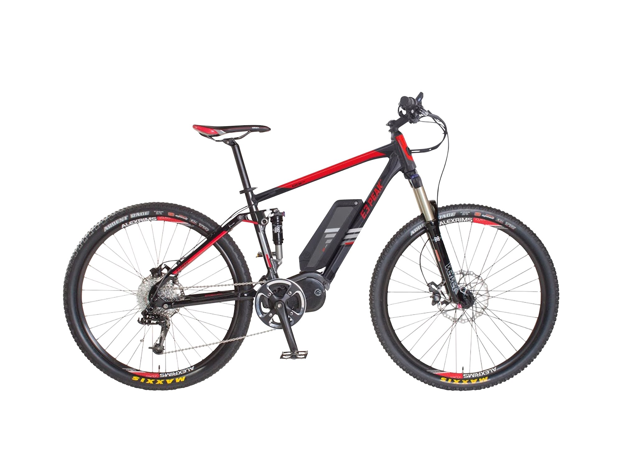

The 2015 IZIP E3 Peak DS (Dual Suspension) is a full suspension electric mountain bike that offers a unique combination of twist throttle and speed pedelec performance capable of 28 mph top speeds that’s hard to find anywhere else. With 120 mm travel front and rear, this thing is comfortable on or off-road but lacks the utility of rear rack and fender mounts that its more affordable cousin the hardtail IZIP E3 Peak offers. Comparing the two models, the $1,400 price differential goes towards an upgraded SRAM X9 vs. X7 derailleur, X-Fusion vs. RockShox suspension, larger hydraulic disc brakes and Maxxis vs. CST tires along with the custom full suspension frame. In my opinion, there are better mid-drive systems out there (namely from Bosch), but they currently don’t offer throttle mode or high speed performance. The closest comparable ebike that I’ve reviewed would be the Haibike XDURO FS 27.5″ and at just $400 more, it’s well worth considering in my mind – depending on your ride needs. With two frame sizes, excellent distribution and a solid warranty, there’s a lot to like about the E3 Peak DS and frankly, I think it looks very cool.

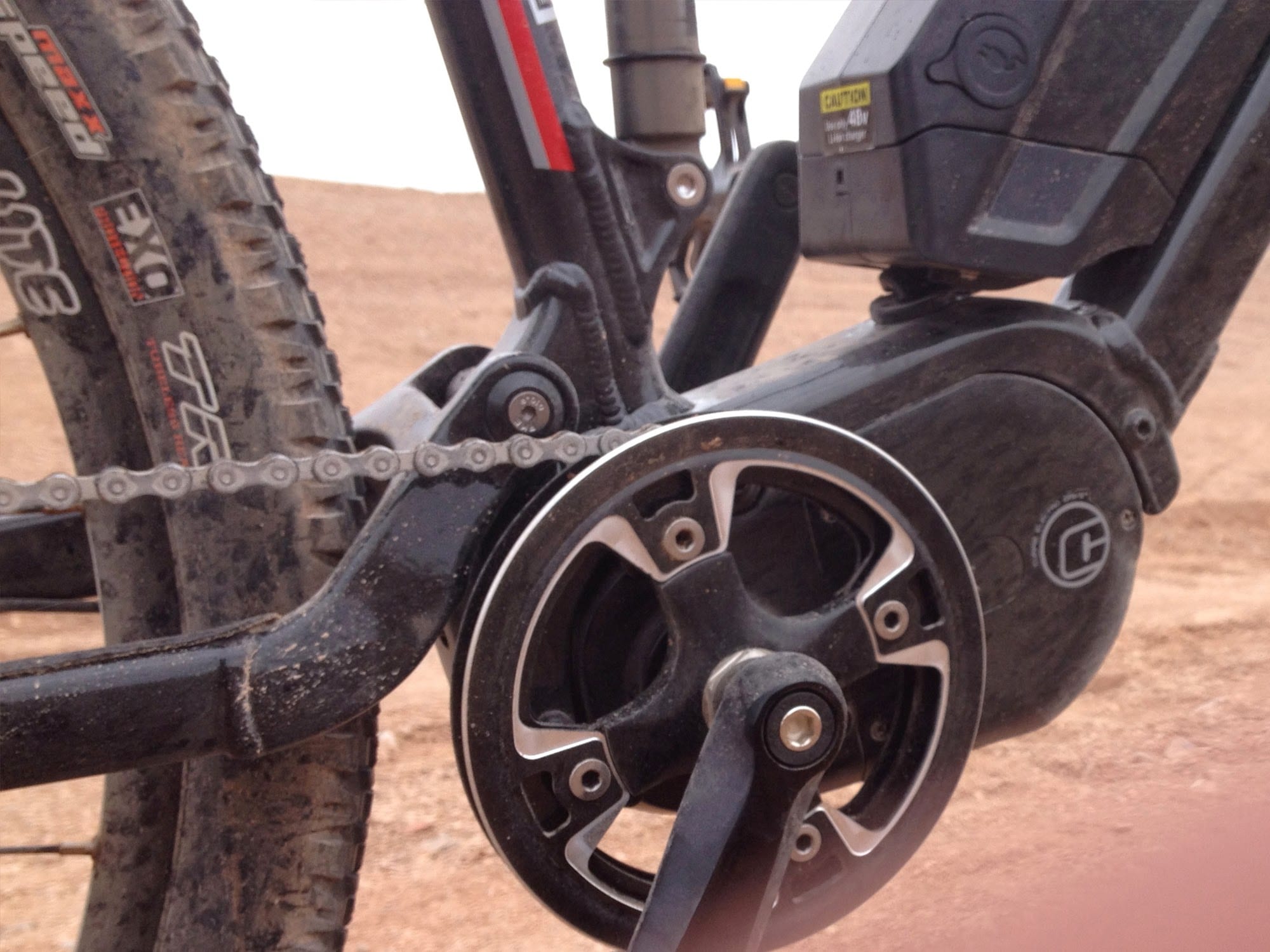

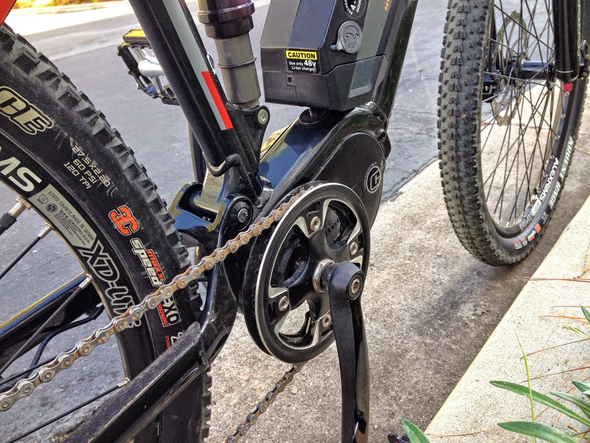

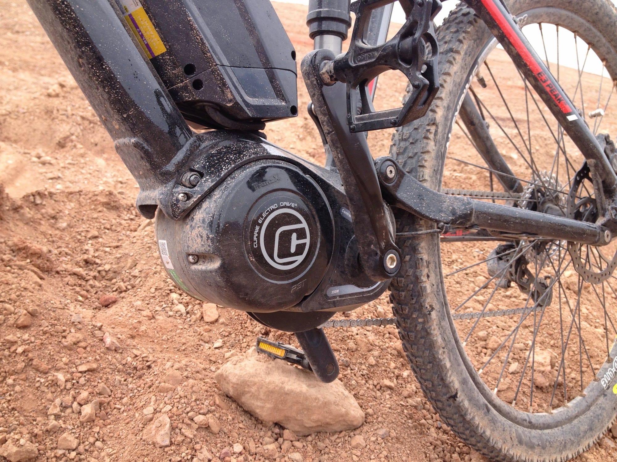

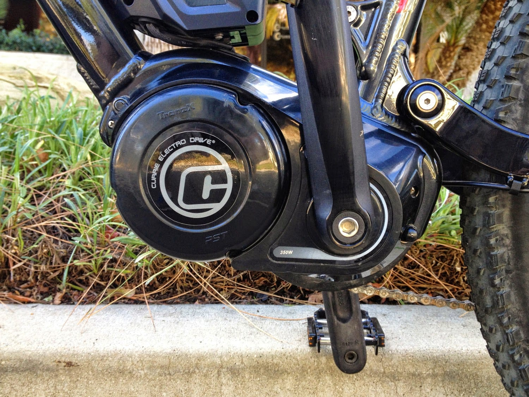

The centerdrive motor driving the IZIP E3 Peak DS in electric mode is a 350 watt geared design from TranzX. The first time I tested this motor was in late 2014 on a hardtail E3 Peak and since then I feel like it has become more responsive and refined. It’s not super loud but definitely not your quietest motor either (mid-drives tend to produce more noise when operating at high RPMs in lower gears). I like how small the motor casing is and that it keeps weight low and center on the frame. The chain ring that it pulls has a built in aluminum alloy bash guard and guide designed to protect the sprocket teeth and probably the motor to some extent. This front ring is a standard sized 38 tooth design and looks relatively normal from the side. With a 10 speed SRAM X9 cassette in the rear, I found that there were enough gears to climb and reach the higher 28 mph top speeds without limiting pedal cadence or over complicating shifting. There are actually a lot of mid-drive off-road ebikes that limit gears to 10 and I think this makes the system more durable overall, reducing the need for tuneups. The big difference between the higher end centerdrive motor system and the E3 Peak DS is that they (Bosch and Impulse) can sense when you shift gears ease off for a second to reduce mashing which causes chain and sprocket wear. On the Peak DS, if you lightly squeeze the brake levers the motor will stop and this imitates shift sensing. During my tests, there actually wasn’t too much mashing going on even without braking so it might not be a huge issue depending on how you ride.

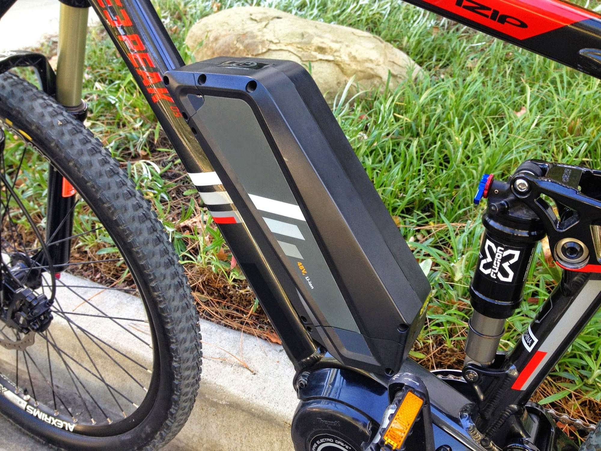

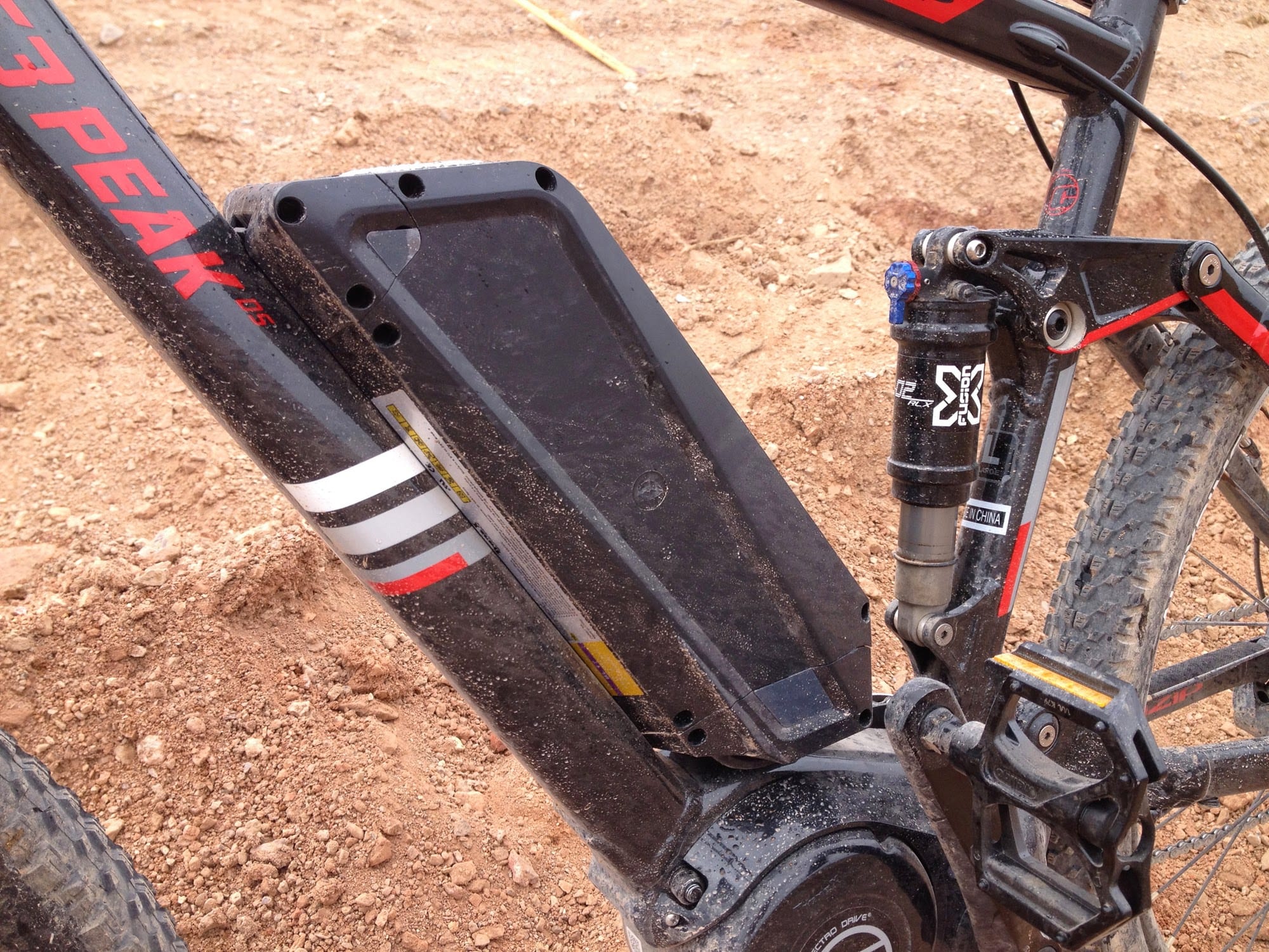

The battery pack on the E3 Peak DS offers a strong 48 volts of power (which is also more efficient than 36 volts) and a decent 8.7 amp hours of capacity. It’s a locking pack that secures directly to the frame for security but is also removable for easier transport or convenient charging inside your home or office. The battery cells used here are Lithium-ion which is valued for being relatively light weight, durable and long lasting. Built into the pack is a small LED charge level indicator so you can tell how full it is without connecting to the bike and powering up. One drawback to the design in my opinion is that the battery pack has to be turned on before the display panel can be turned on… You end up pressing two power buttons which is not so common on other ebikes and can lead to some confusion (I thought the battery was out of juice when first trying to activate this bike during my review). Still, overall the battery is fine and once you remember the extra step for activating the bike it works just fine.

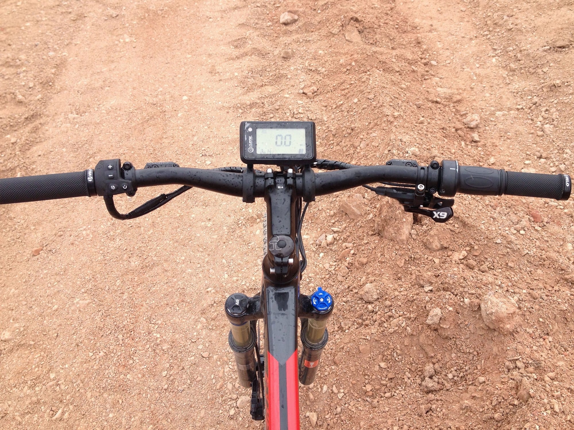

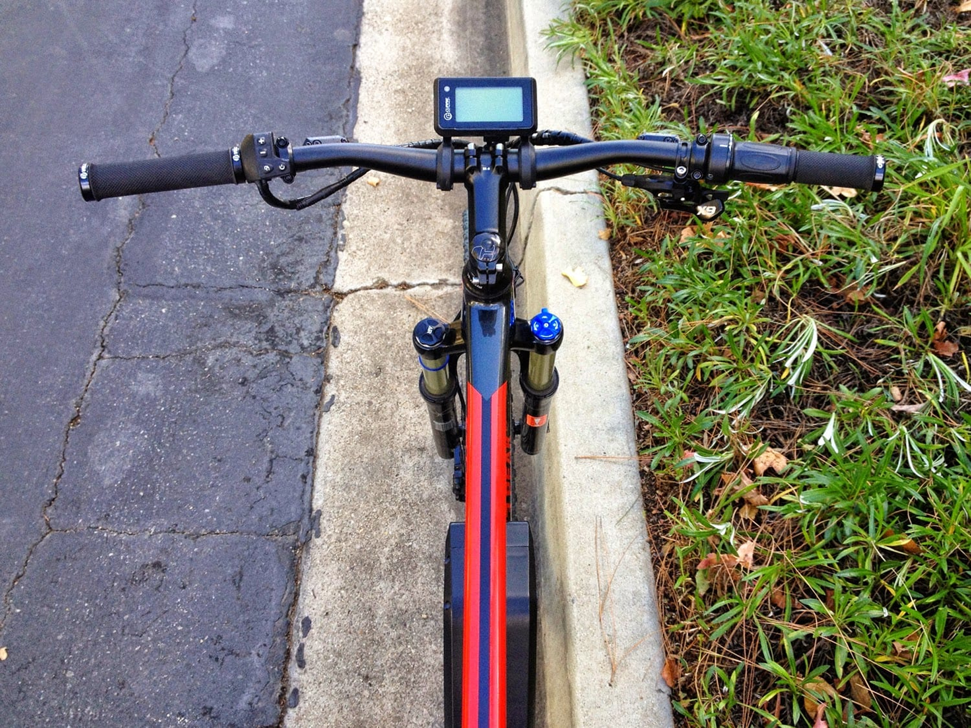

One of the most refined areas of the 2015 IZIP line of electric bikes is the new display panel and associated button pad. The display is backlit, easy to see (mounted front and center) and now connected at two points to the handle bar for improved strength which could come in handy on the trails. I love that it can swivel forward and back to reduce any glare you might be experiencing and I love the range estimator readout that approximates how far the bike can go at each level of assist given the remaining battery charge. The buttons that operate the display are pretty simple to use and very easy to reach. The pad is completely rubberized to keep out dust and water but still provides a tactile “click” to let you know you’ve activated each button. You can navigate through four levels of assist with up and down buttons (which offer increasingly greater power output from the motor) and ultimately allow you to reach 28 mph assisted (with active pedaling) all without looking down at the display. Most electric bikes cut motor power at 20 mph and that is still the case for the throttle mode on the DS one but note that the throttle will really only reach ~6 mph without pedaling. As long as your cranks are moving, it can reach 20 mph and it’s designed that way to act as a sort of “override” for lower levels of assist, helping you for a short burst to overcome hills.

- Mid-drive motor leverages the 10 speed cassette for improved efficiency and range, great for climbing with lower gears

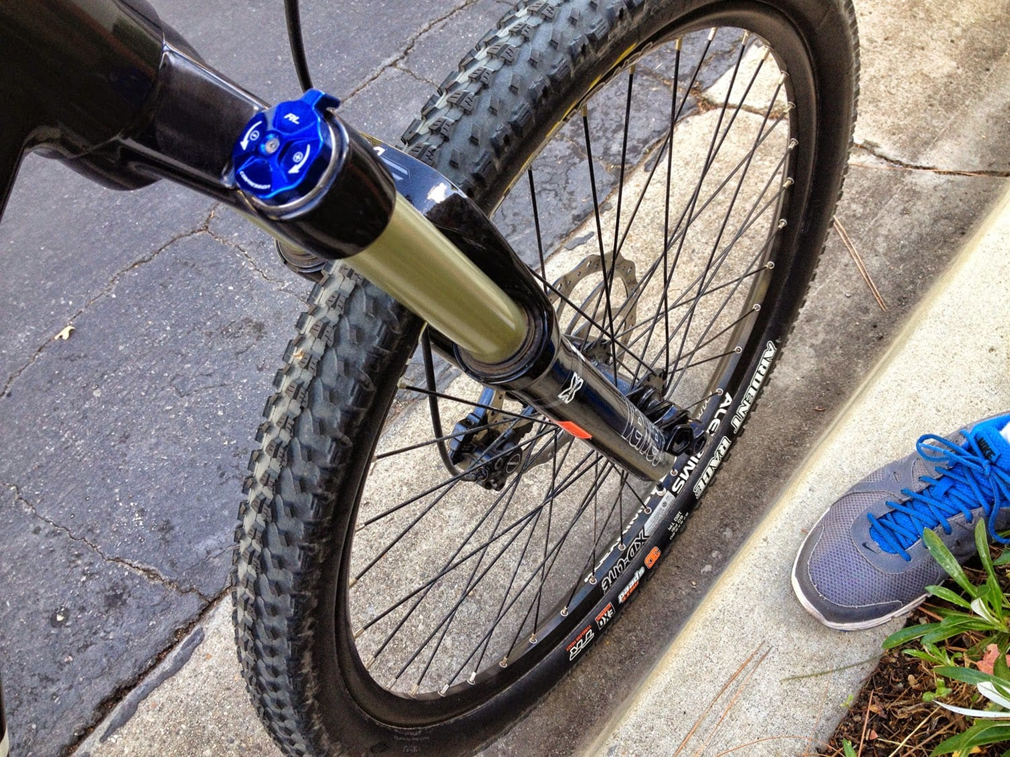

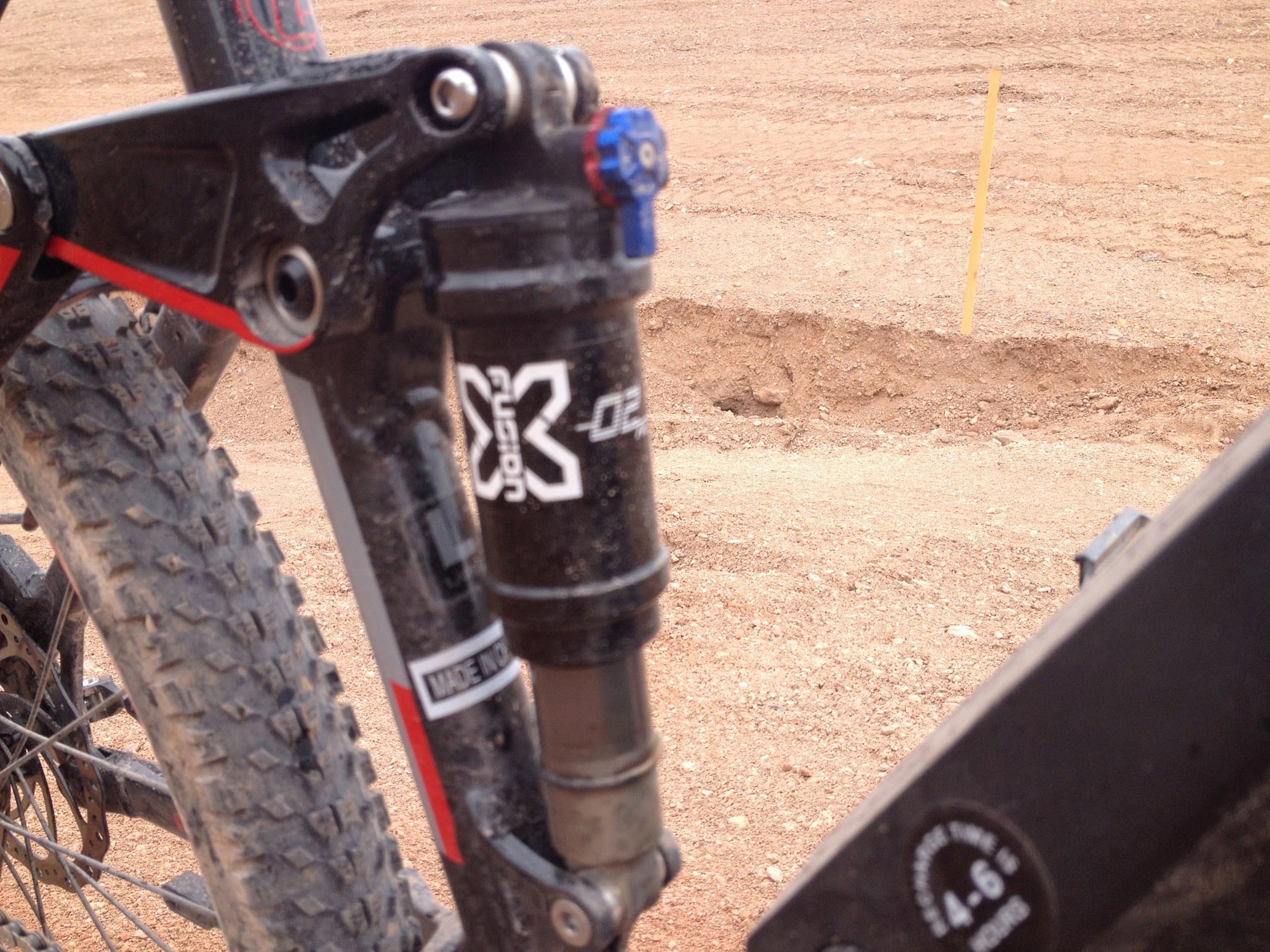

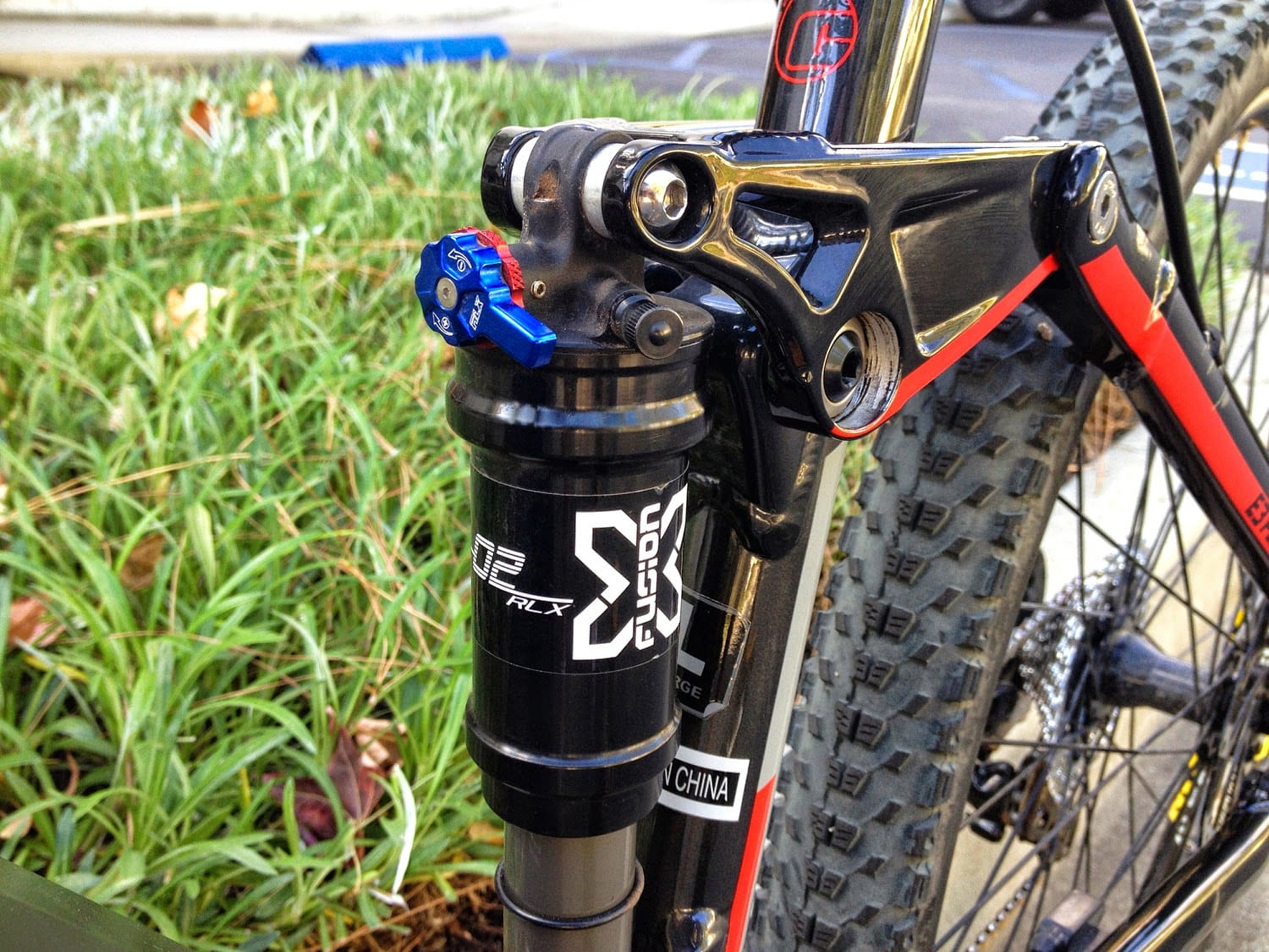

- Adjustable X-Fusion suspension fork and rear shock improves pedaling efficiency on smooth and hard packed surfaces
- New 2015 display panel can swivel to reduce glare and is attached at two points for improved strength, also backlit for use in dark environments

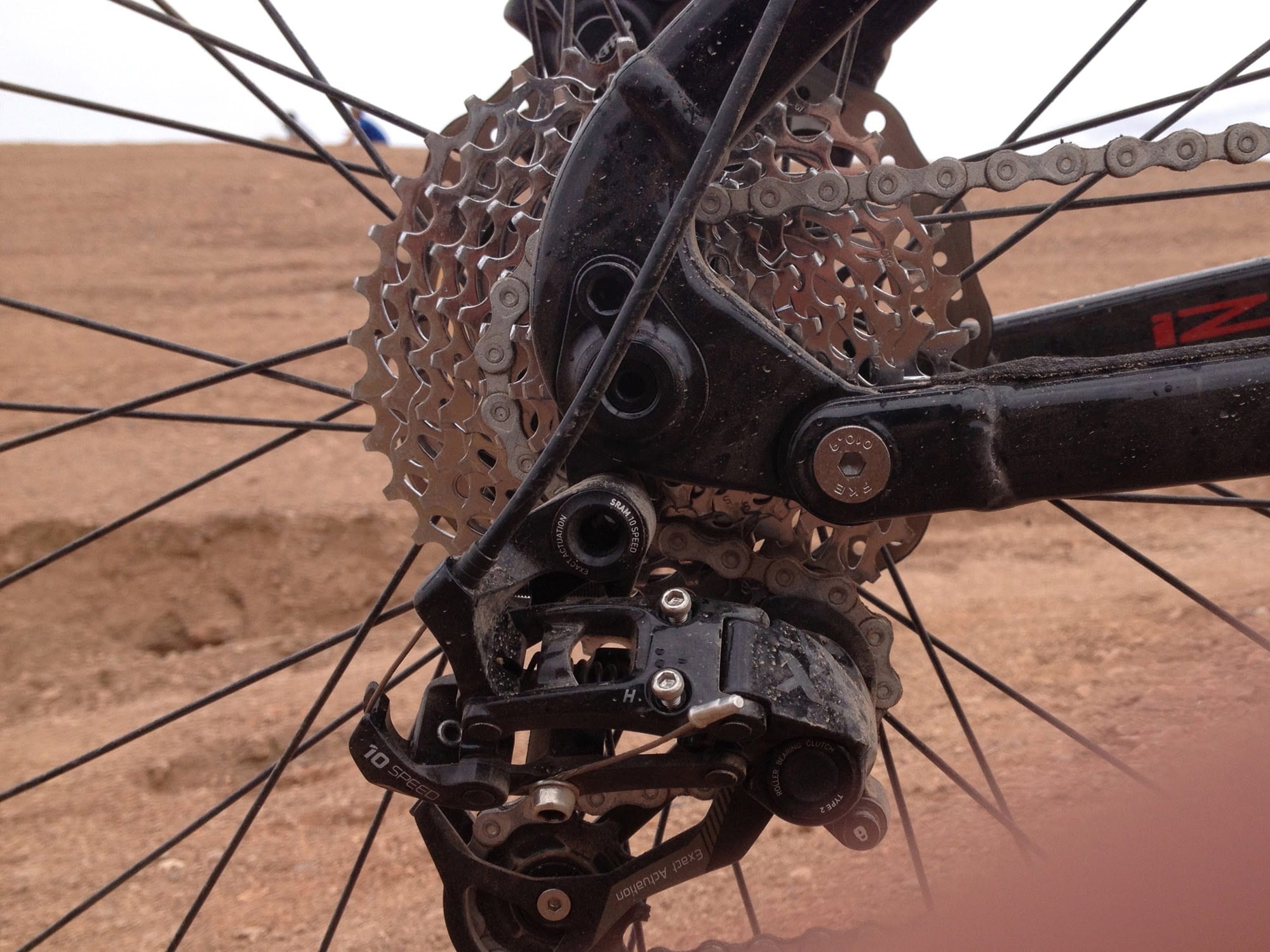

- Nice component upgrades including the SRAM X9 10 speed cassette, locking grips, aluminum alloy pedals and X-Fusion Velvet 120 mm suspension fork – frame, saddle and fork all match nicely

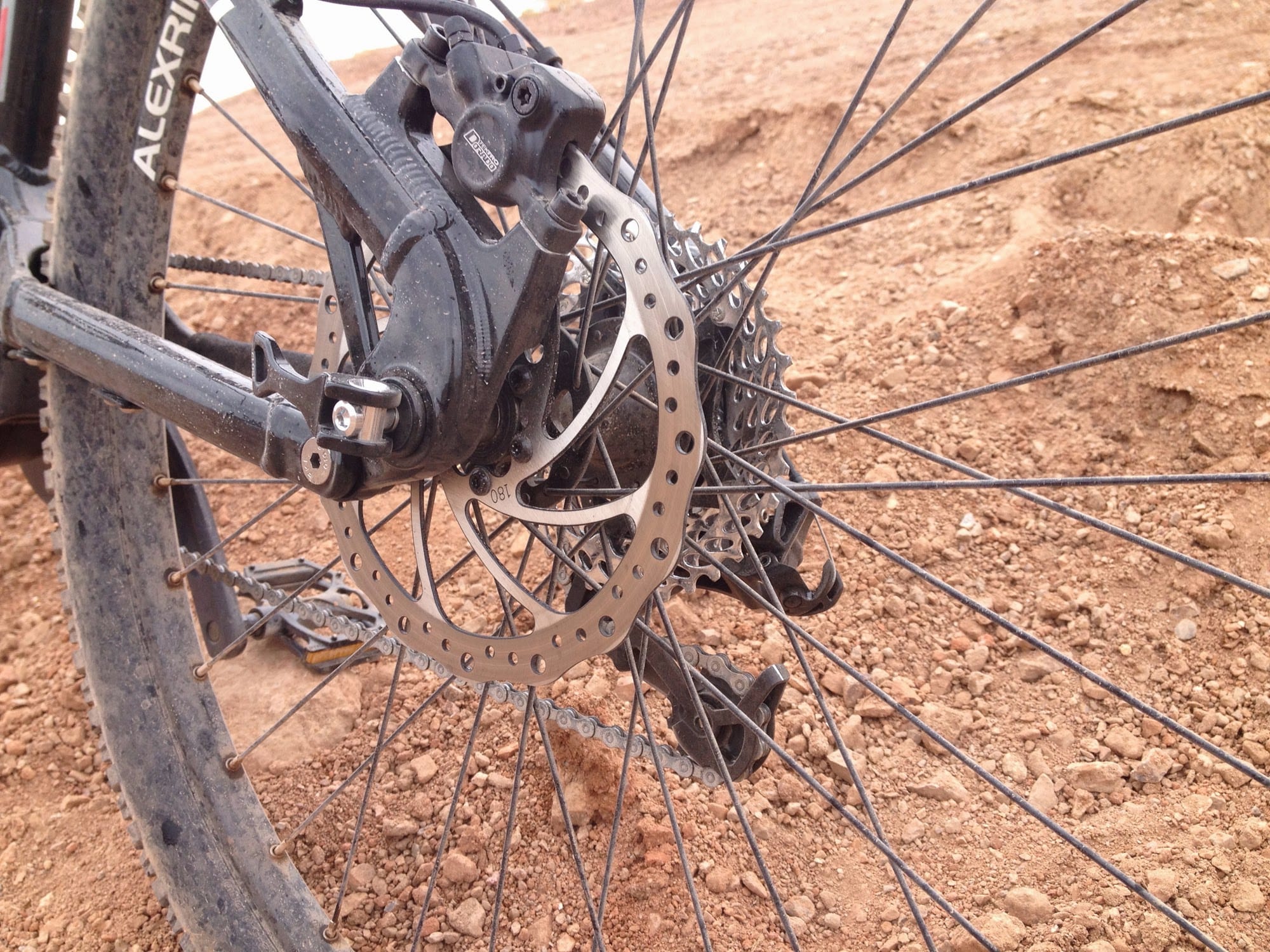

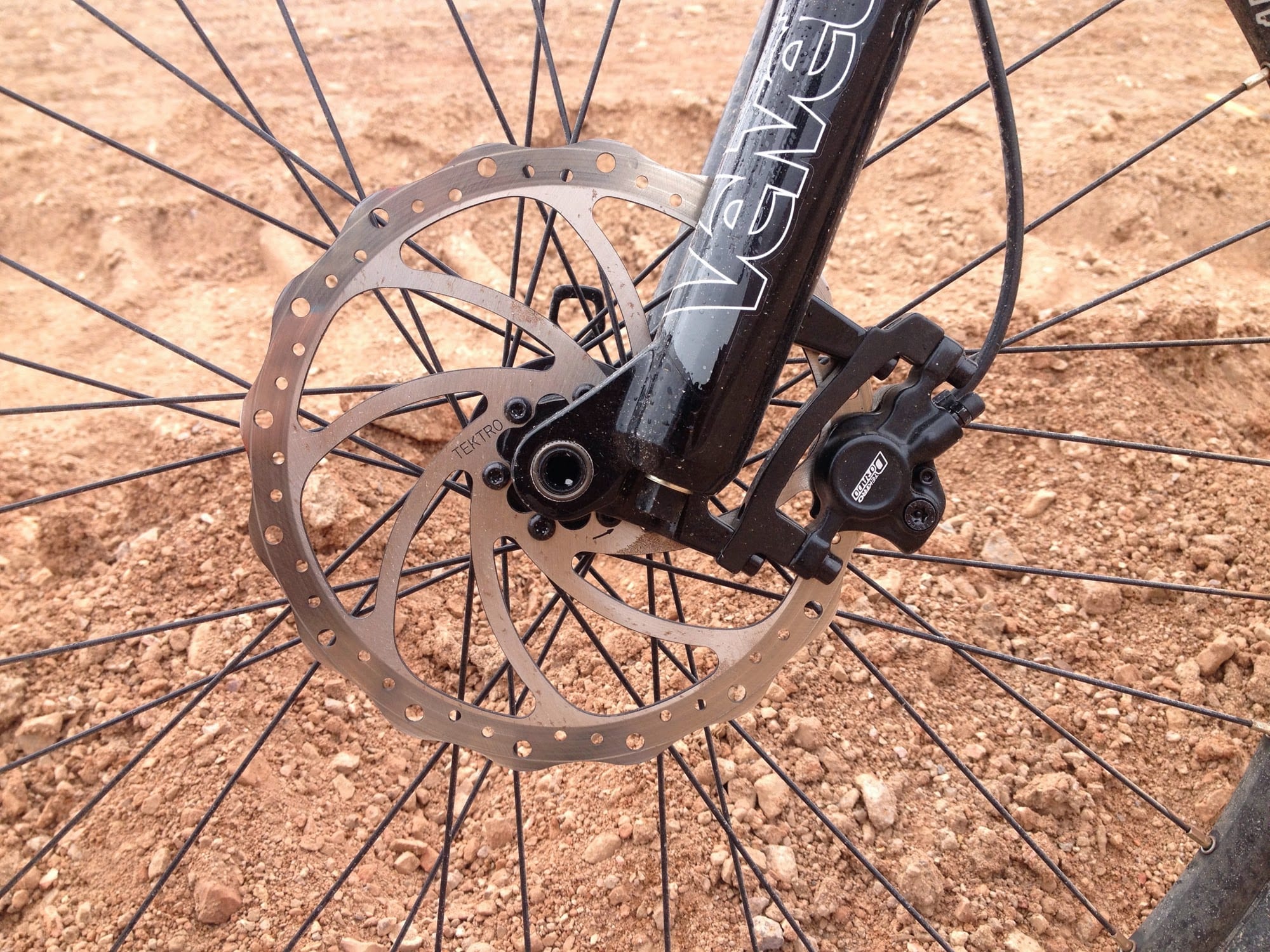

- Hydraulic disc brakes operate without requiring much effort, they are smooth and provide quick stopping power while also cutting power to the motor, upgraded 203 mm and 180 mm rotors are large for added strength

- Display panel is not removable, when using the bike to commute to work or park in town this exposes it to more wear through weather and possible tampering
- Value drive system with larger front ring and simpler control sensors than higher end systems like Bosch or Impulse, the motor doesn’t kick in or stop as quickly and it also can’t sense when you’re shifting gears
