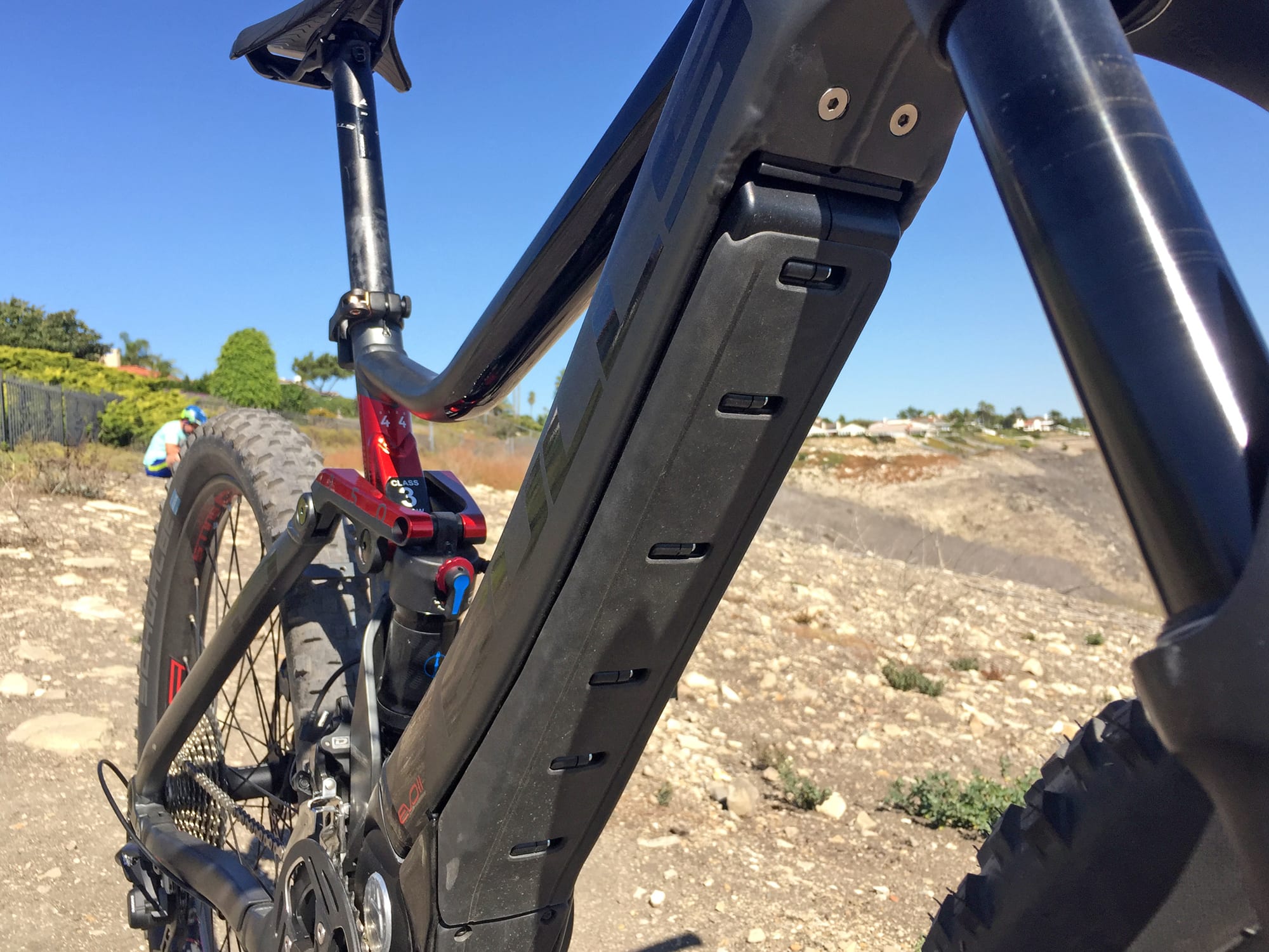

Powering the motor, two MonkeyLink light mounts, and 5 volt Micro-USB port on the control pad is a high capacity Lithium-ion battery pack. Inside are 18650 BMZ branded cells offering 37 volts and 17.5 amp hours of energy, which is quite a lot! Approximately 50% more than the average 500 watt hours I see from most competitors this generation. Note that anytime you’re riding above 20mph, air resistance produces drag exponentially. People aren’t super aerodynamic when sitting up straight, riding on a bulky mountain bike frame with wide knobby tires. And, on those occasions where you throw efficiency to the wind and max out at 28mph, I’d suggest taking those turns very carefully lest you slide out and whack your chin as I have done while joy riding across wet grass on my way to work. This e-bike feels a lot like flying because it can handle almost any terrain comfortably, and won’t leave you breathless to maintain higher speeds. It’s a blast! Back to the battery itself, the mounting interface is solid but a little tricky to work with. You have to push the pack up from beneath the downtube (latching the top and snapping in the bottom). There used to be a sliding lever system that was tricky to deal with, but now it’s just a click-in system… During removal, it’s nice to have a kickstand on the bike, so you can use both free hands to unlock the pack and carefully lower it out. Unlike Bosch, which has a two-step design for their integrated PowerTube battery, the BULLS BMZ battery can tumble out unexpectedly when unlocked from above. It’s alright to never take the battery off of your bike, but that makes it heavier to lift, service, transport on car racks, and could expose the pack to extreme temperatures at outdoor racks or inside uninsulated garages and sheds. Lithium-ion batteries can be temperature sensitive, so it’s best to store them in a cool dry location to maximize lifespan. And, if you know that you won’t be riding for a month or more, try to leave it at 50% capacity so as not to stress the cells. Charging back up will be quick with this electric bike, because BMZ has supplied a faster five amp charger vs. the standard two amp that come with most competitors. Bosch has a really nice four amp charger that’s a bit slower but much lighter and physically smaller. I prefer the Bosch charger to this bulky aluminum charger… but suppose that this might be stronger in the long run? It interfaces with the battery with a magnetic plug that is designed to pop out vs. breaking if you trip on it accidentally. It’s called EnergyBus and uses the Rosenberger standard, which is pretty great and usually only found on nicer products. The pack weighs about seven pounds which isn’t too bat given the size, but it’s a bit long and doesn’t have a handle built in, so be careful. When you take a step back, it’s easy to appreciate how hidden the pack is, how well the new rubberized guard protects it (note that the electronics are also IP56 ingress rated against dust and water), and how perfectly weight is positioned (center and super low for optimal balance and handling).

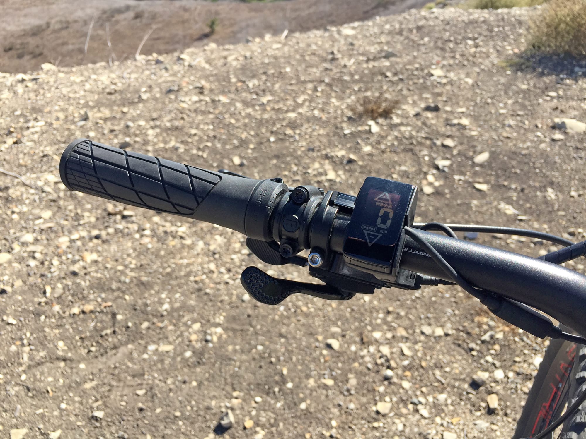

Operating the BULLS E-STREAM EVO 45 AM feels simple because the display panel is compact and the main buttons are so intuitive. Once the battery is charged and mounted, you may begin by pressing the power button on top of the battery pack or on the top edge of the BLOKS control pad, which is located within reach of the left grip. This wakes it up, and shows your current speed in the middle, a battery bar infographic with five squares below, assist level with up to four full blocks above, and an up and down arrow with plus and minus symbols inside. To raise or lower motor support, you press onto the upper or lower half of the display itself. This fills in the blocks (which go from empty to four full) and that’s how you know what power level you’re riding in. Now, the readouts are off-white in color with the background being black. The readouts are fairly easy to see in bright light because the LCD is transflective. When you click in, the display will also become backlit for a moment, so it’s easy to see in dark riding conditions as well. The BLOKS display panel is definitely on the smaller side compared to Bosch, Yamaha, and Shimano. You don’t get any feedback about average speed, max speed, trip distance, or even odometer. The five 20% battery bars are much less precise than a full one-percentage increment readout and there’s no dynamic range estimator. Still, the smaller physical size leaves more cockpit space for mounting a phone or Garmin device… and you can charge or maintain on the go by connecting to the Micro-USB port just below the display. Going back to the quiet motor and hidden battery design, perhaps this display will go unnoticed by fellow riders or be less provocative at the bike rack. You cannot easily remove it, nor can you swivel it once it’s tightened down. On the left edge of the control pad there’s also a walk mode button (which is useful if you get a flat or encounter a steep gnarly section of trail), along with a lights button. You can hold the lights button in for several seconds and then click up or down on the main screen to change units from miles to kilometers and back. Note that the light button is only really relevant if you purchase the aftermarket MonkeyLink compatible lights. And on that note, the rear light interface could also be used for a compatible fender. One final consideration about the headlight is that it is not aim-able. It cannot be positioned up or down, it just points ahead based on the head tube angle and stem angle of the bike itself… which is a bit up for this bike due to the longer travel fork. it does, however, point from side to side as you steer the bike.

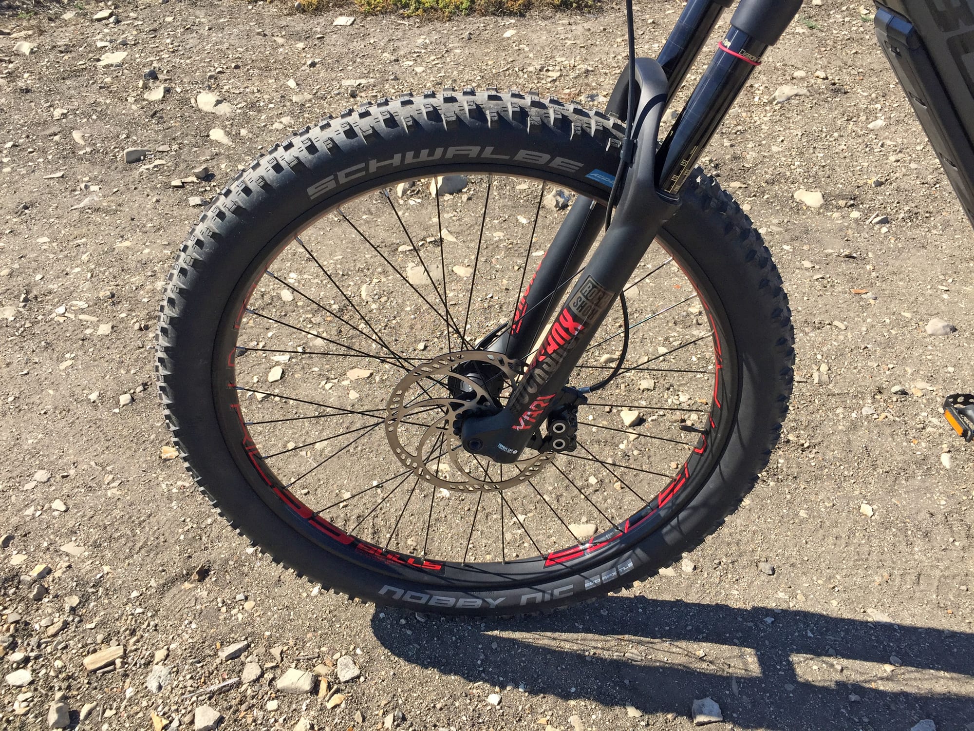

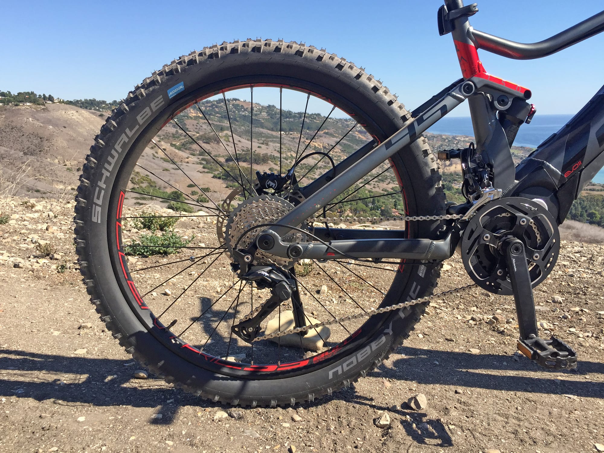

- Both wheels offer quick release for easy trail maintenance, the connect with sturdy thru-axles that support wider boost hub spacing and the large 2.8″ plus sized tires
- With longer 150mm suspension travel, this ebike offers all-mountain performance including climbs and descents, the larger tires provide increased traction, stability, and comfort while reducing deflection
- Extra large 203mm hydraulic disc brakes with quad piston calipers provide the necessary stopping power for higher speeds, steep descents, and increased weight

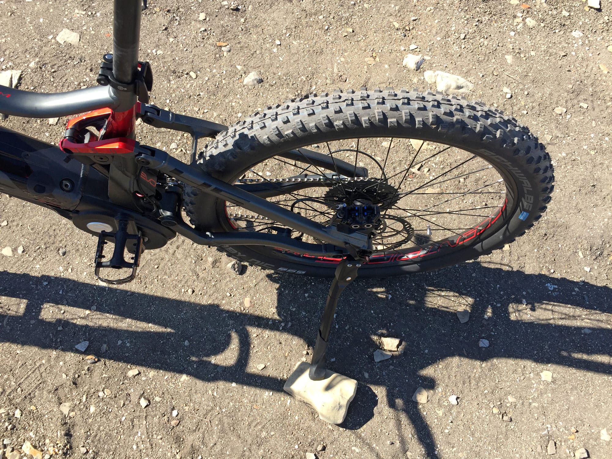

- I think it’s neat that they included long plastic slap guard and an adjustable kickstand, the stand may bounce around and rattle on the trail but really comes in handy if you commute and park the bike at public racks or in your garage

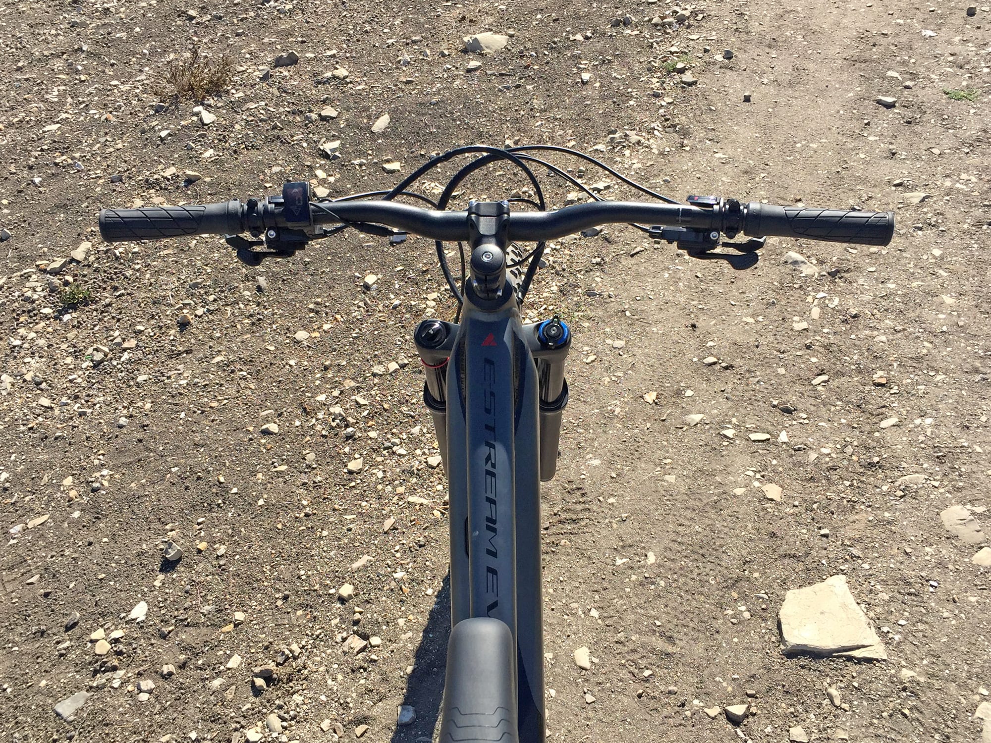

- The BLOKS display panel is compact but easy to read in bright conditions because it’s transflective but also backlit for dark conditions, there’s a Micro-USB port built into the bottom for charging accessories
- The rims and tires are tubeless ready, which allows you to reduce weight and run lower pressure without pinch flats, I like Schwalbe tires and noticed that these ones have ADDIX speed grip for higher speed riding

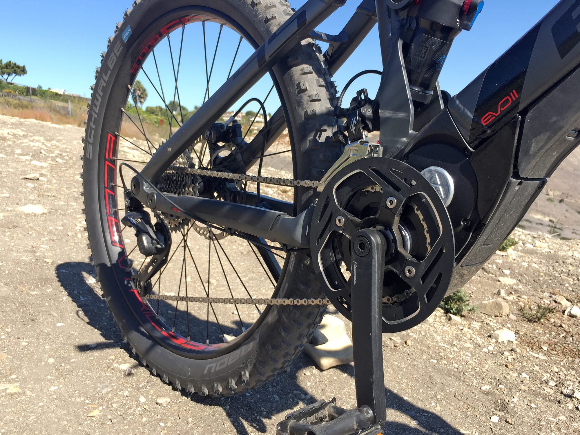

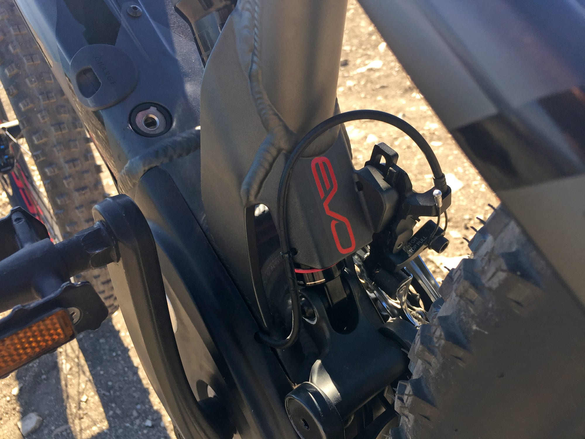

- The drivetrain appears to be well protected against rock strikes and drops because the chainring has a large alloy guard, the front derailleur functions as a chain guide, and the rear derailleur has Shadow+ a one way clutch to reduce slaps and bouncing (just click the little gray leverl into the up position to enable or click down for easier shifting and wheel removal)

- The new generation of E-STREAM models have a tough rubberized shield along the base of the battery and front of the motor casing, older ones had a narrower foam shield that didn’t seem as durable

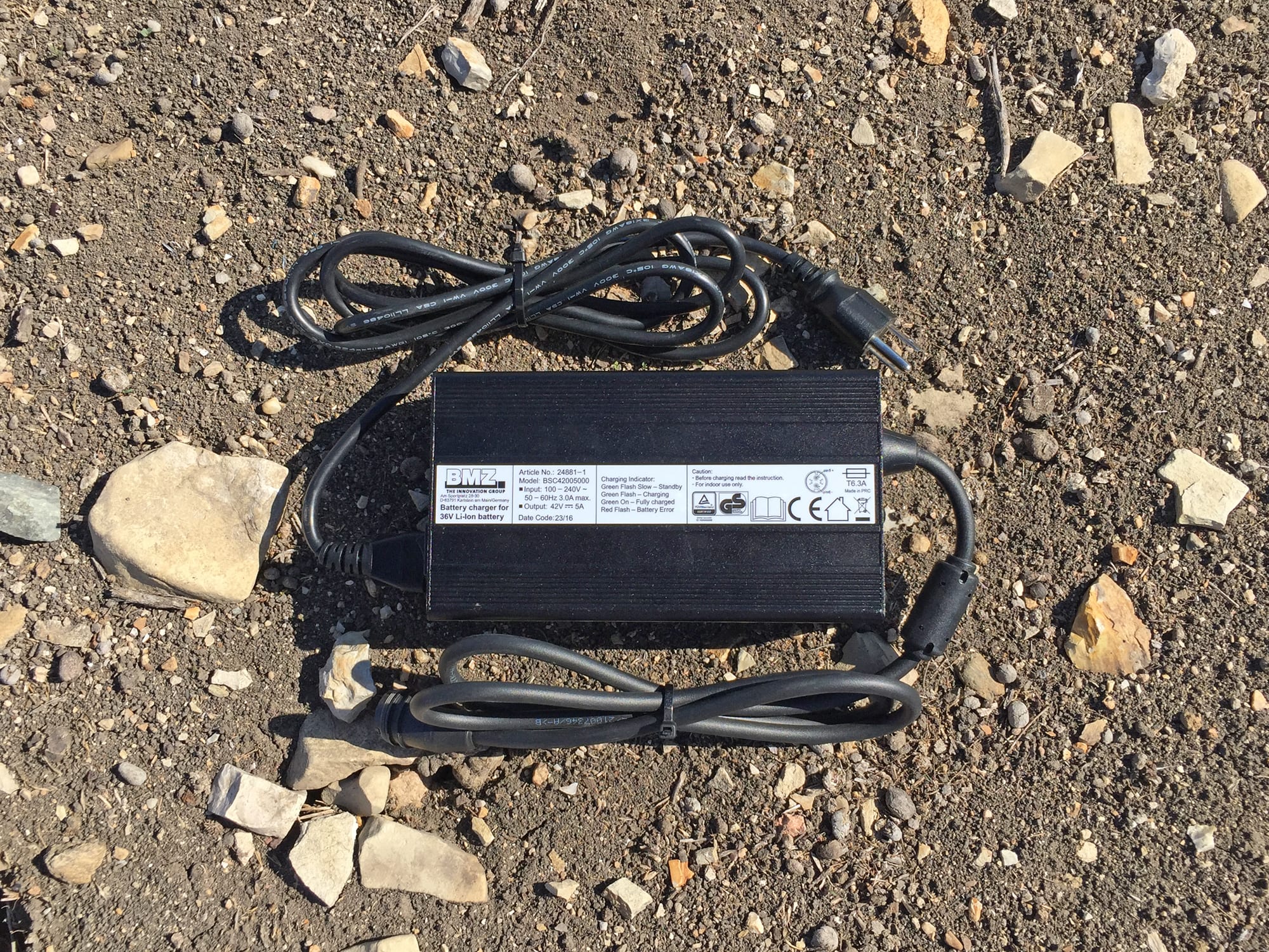

- On the one hand, I really appreciate how fast the battery charger is (5 amps vs. 2 amps on most competitors) because this ebike comes with a high capacity battery, and I like the quick-release magnetic charging cord… but on the other hand, the charger case is larger and heavier than average and will take up more space in your backpack

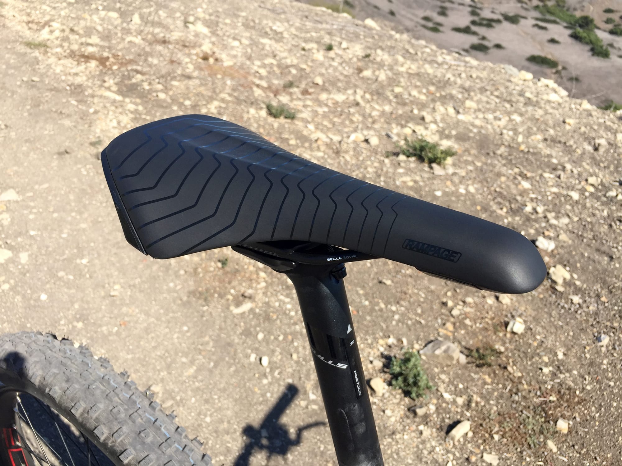

- I feel like this electric bike would be a good candidate for a seat post dropper, it’s the one upgrade I didn’t see but you could always get one aftermarket

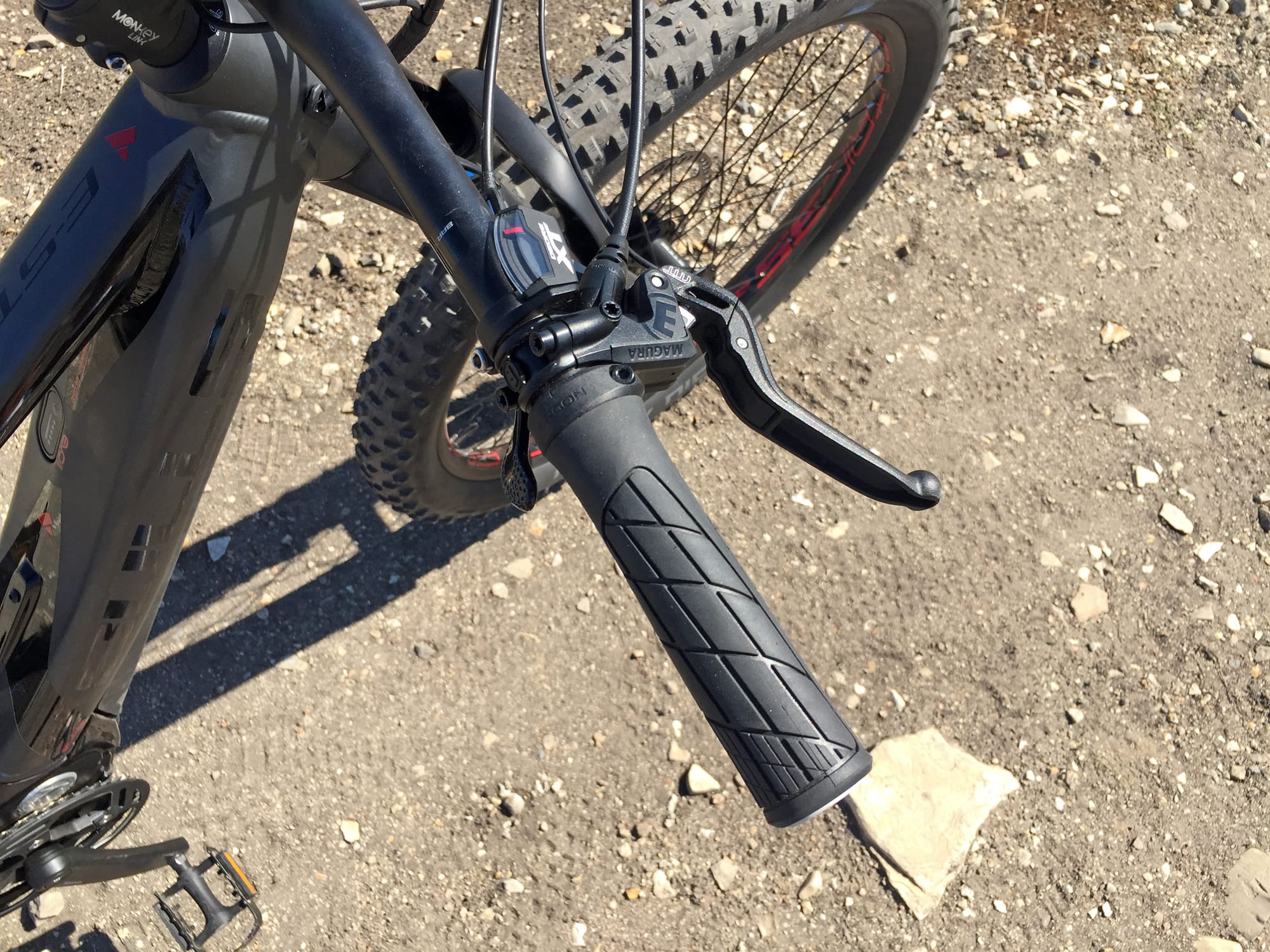

- Some of this is personal preference, but I really don’t love the curved saddle or cage style pedals stocked here, the Ergon ergonomic grips are great though
- The display panel doesn’t list as readouts, isn’t as large as most competitors, and isn’t removable… but it still works well for this type of application

- Unlike the Bosch PowerTube, which has a two-step battery removal process, this custom BULLS + BMZ battery pack sort of just tumbles out as you unlock it… so be careful to stabilize the bike and support the pack when unlocking, also keep track of the magnetized battery charging port cover because it doesn’t have a leash and could be easily set down and lost
- Unlike Bosch and some of the nicer Yamaha display panels, this setup lacks a range estimator and battery percentage readout which makes it difficult to gauge distance at times, you just have a five bar battery info-graphic
