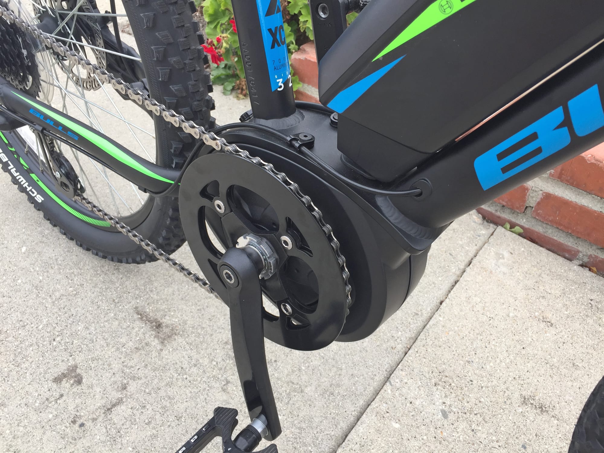

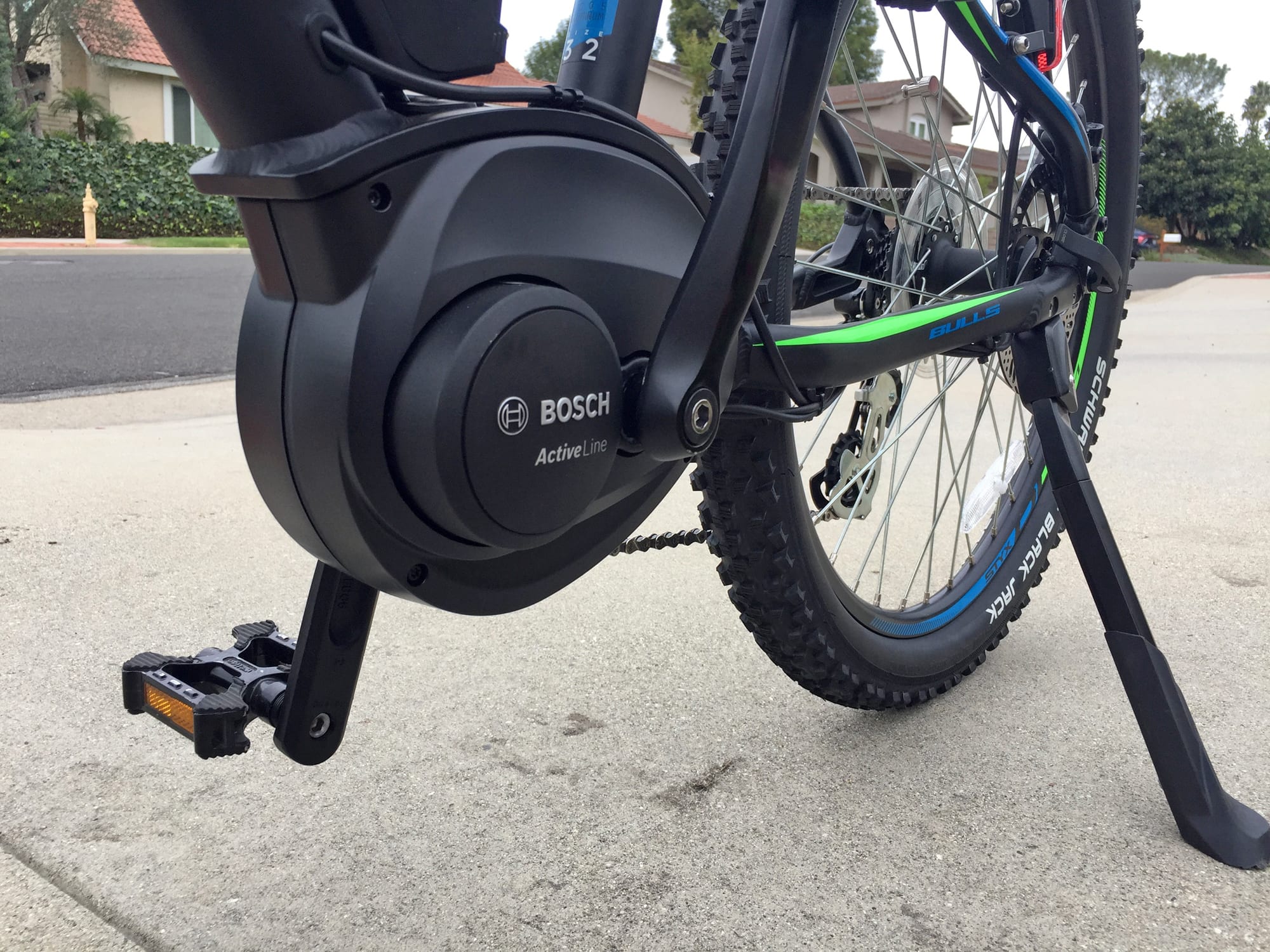

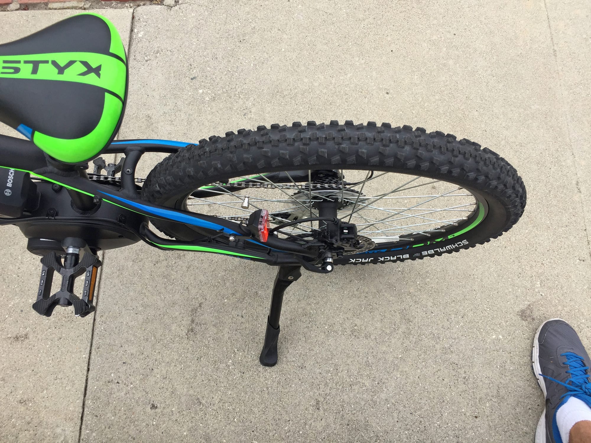

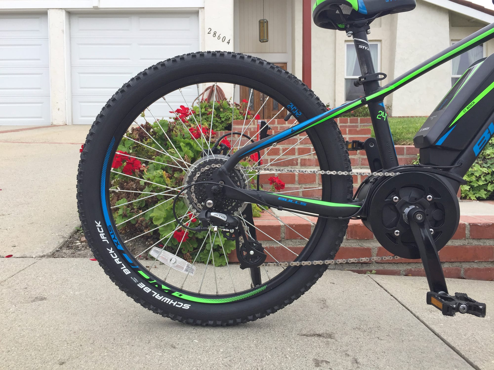

Driving the BULLS TWENTY4 E is the brand new Bosch Active Line Plus mid-motor. Compared to the older Bosch Active Line, this new motor weighs ~1.5 lbs less, is more compact in size, and offers a full-sized chainring vs. a reduction gear that spins 2.5 times for each crank revolution. In short, there’s a touch less drag when pedaling but chain retention might be slightly lower and response time may also be just slightly slower. I noticed and appreciated the Aluminum alloy chainring guard, which will keep pant legs and dresses snag-free while simultaneously keeping the chain on track. The motor is smooth and quiet but responds near-instantly so there’s no problem with unexpected starts or delayed overpower when it’s time to slow down and stop. Stopping is handled very well on this bike because Bulls opted for 160 mm hydraulic disc brakes with smaller levers that kids can easily grab and pull. Carla seemed to have no issue stopping during our ride and was regularly leading the pack with a huge smile on her face. She also handled gear shifting extremely well, easily going from low gears to start up to the higher gears in order to keep up with the pack. This electric bike is outfitted with a Shimano Altus 8-speed drivetrain and traditional trigger shifters near the left grip. The big button shifts to easier gears (for slow riding or climbing) while the small button shifts to harder gears (for faster riding and descending). One thing that I have always appreciated about the Bosch mid-motors is that they have fancy control systems that can detect user shifting and tell the motor to ease off, which reduces wear on the drivetrain. Considering that many young riders are new at shifting, and may be paying attention to balance and stopping, it’s great that the Bosch system can sort of protect itself and keep the bike from getting worn out prematurely. The motor casing-surround is made from black plastic which blends in with the bike frame. In my opinion, the bike is a bit more masculine in color, but Carla didn’t seem bothered at all by this (never mentioning it) and the fluorescent blue and green accents keep young riders visible to cars. Again, the lights, bright frame color accents, and white accents on the Schwalbe tires are all designed for safety because kids tend to be shorter and more difficult to spot by automobiles.

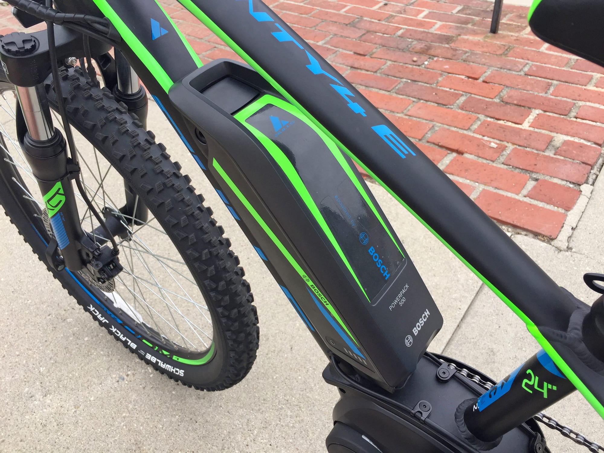

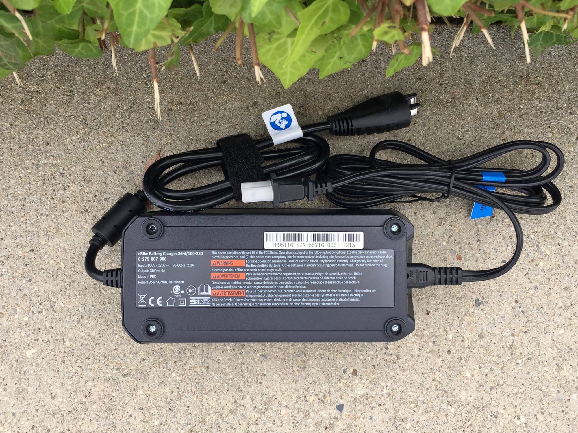

Powering this “kids” bike is an adult sized battery pack. The Bosch Powerpack 500 offers 36 volts and 13.4 amp hours for a total of ~482.4 watt hours of capacity. It’s enough to go probably 40 to 70+ miles on a single charge depending on how the bike is ridden, how much the rider weighs, and what level of assist is used. This battery can be charged on or off the bike and is filled by a quick 4 Amp charger that weighs ~1.7 lbs. I appreciate that Bosch has stuck with the same battery design since 2013 in the US because it means that many parents might be able to share their own batteries with their kids’ bikes… same goes for the charger. The battery casing has a big open loop at the top, making it easier and safer to carry around. It has an LED charge level indicator built into the left side, so you can tell how full it is when unmounted. And, it uses an ABUS locking core to be secured to the bike frame. ABUS makes high-quality locks and sells a whole range of security locks like u-locks, folding locks, and chains which can be “keyed alike” by using the code printed on the card that comes with your ebike keys. Okay, so one of the few question marks or complaints I have about this electric bicycle is that it’s expensive, which could make it difficult for many parents to justify if they expect their kids to outgrow it. One area where BULLS might have been able to save a couple hundred dollars and also reduce weight by ~0.5 lbs is to utilize the older Bosch Powerpack 400 battery. I think that it would have offered enough range for kids to match parents due to the lower top speed and lighter weight of this bike.

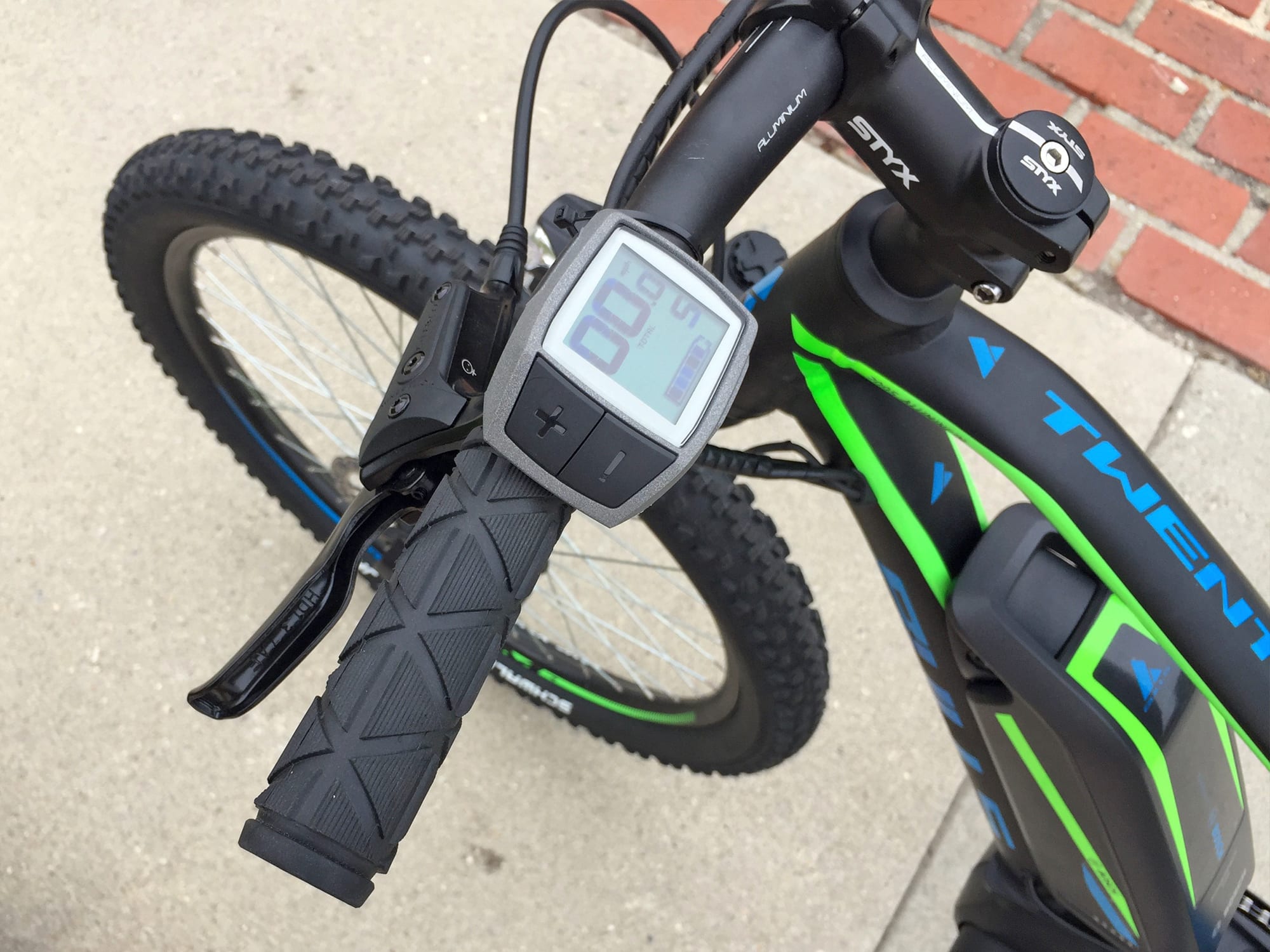

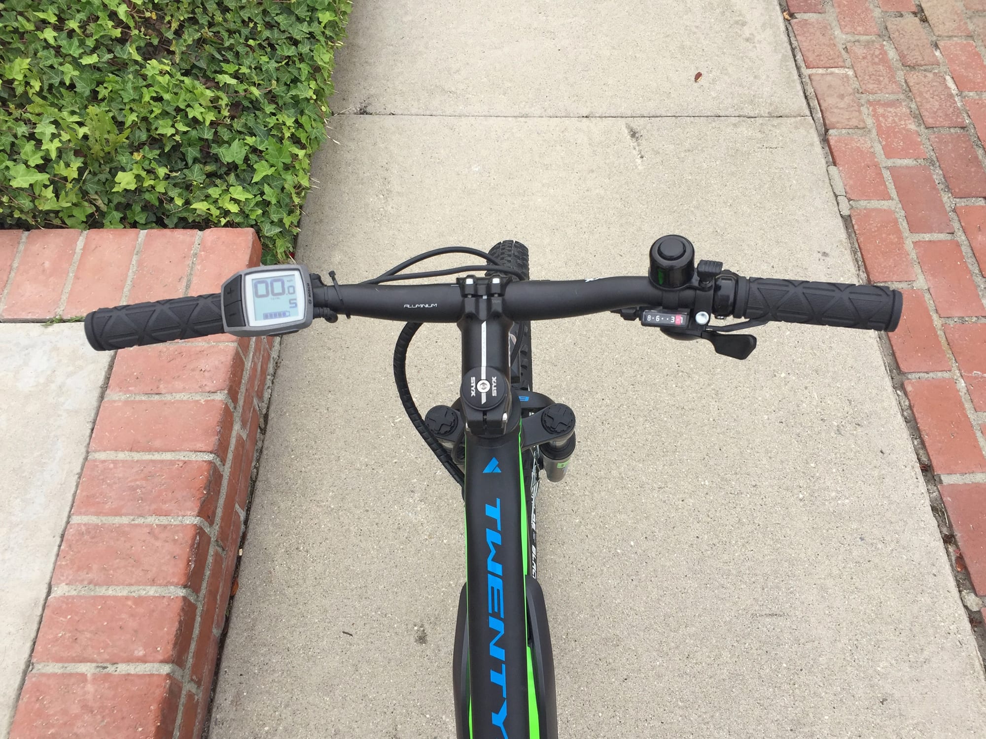

Operating this bike requires a few memorized steps to turn on and adjust power levels using the Bosch Purion compact display panel. This display cannot be removed like it’s bigger brother, the Intuvia, and it doesn’t have a micro-USB charging port built in, but maybe that’s for the best? It means that it’s tougher and less likely to get lost. The four buttons on this display are the power button along the top edge, a plus and minus key on the front left side, and a walk-mode button on the bottom. When you press the power button, the display comes to life very quickly and is faintly backlit so as not to distract but also stay useful when it gets dark outside. Once it’s on, there’s a battery infographic with five bars to designate fill at the top, a speedometer in the middle, a listing of assist levels that change as you press + and – and a couple of sub menus that can be accessed by holding the minus key (trip distance, total distance, and range). The range menu is neat because it updates as you select different levels of power. Other secrets include holding minus and tapping the power button to switch from metric to standard units and light activation which is done by holding the plus key for a few seconds. Considering that this is a kids bike and they nerfed the top speed, I think it would have been cool to make the lights auto-on and constantly on… just to increase safety. The final lower-edge button is for walk mode and you have to tap it and then hold + in order for it to work. This can be a very useful feature for pushing up hills, through grass, or getting home with a flat tire. You can change gears to increase or decrease walk-mode speed. All things considered, once this electric bike has been charged and turned on, it’s easy to use the different levels of pedal assist and reaching the button pad isn’t too much of a stretch, even for small hands. I feel that the plus and minus buttons could be improved by Bosch, to be easier to click near the lower edge and center (because they pivot at an angle) but Carla figured it out and did just fine. For those who wish to upgrade to the larger Bosch Intuvia display, many authorized dealers do offer a replacement/upgrade option which would make the display removable and just bigger (easier to see) with more responsive buttons and more complex menu options to explore.

- I’m not sure a rear-rack would fit on this frame without some creative tweaking but there are bosses for attaching such a system on the chainstays, I like the kickstand choice and location, and I appreciate the sturdy chainring guard that will keep the chain from dropping easily while simultaneously protecting pants from getting greasy or snagged

- The new Active Line Plus motor from Bosch is very compact and lightweight at ~7.05 lbs vs. 8.8 lbs for the Bosch Performance Line motors, this helps to keep the overall bike weight down at ~45.3 lbs, making it easier to maneuver and ride for young people who might not be as strong

- I like that the bike comes standard with a little bell and that they used shorter crank arms and a shorter handlebar to really fit the rider and make it feel comfortable

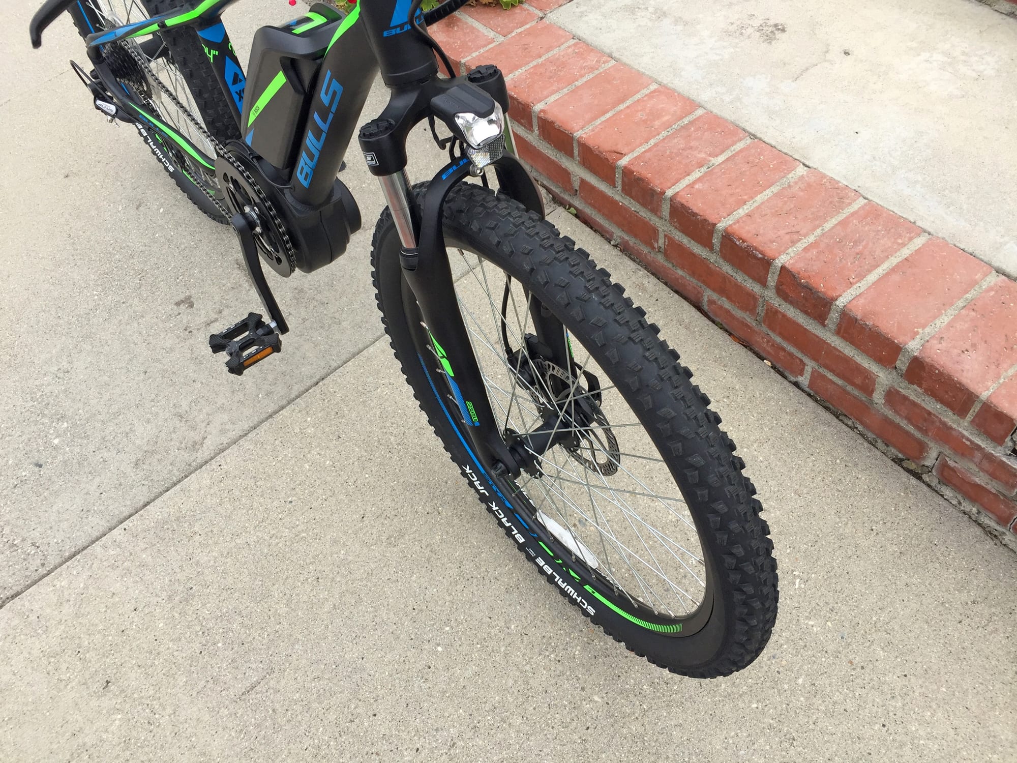

- The official Bulls stock image shows the headlight mounted up on the handlebar which means it won’t bounce as much as if it’s connected to the suspension fork bridge and it will be easier to see… but the demo model I actually reviewed did not have the light up there, instead, it was mounted to the suspension fork

- The Bosch Purion control panel uses big buttons that are easy to reach but I have found that they don’t click as reliably if you press near the lower edge or center because they pivot at an angle towards the screen, this could be confusing, distracting, or frustrating for a younger rider… press near the screen for best results
