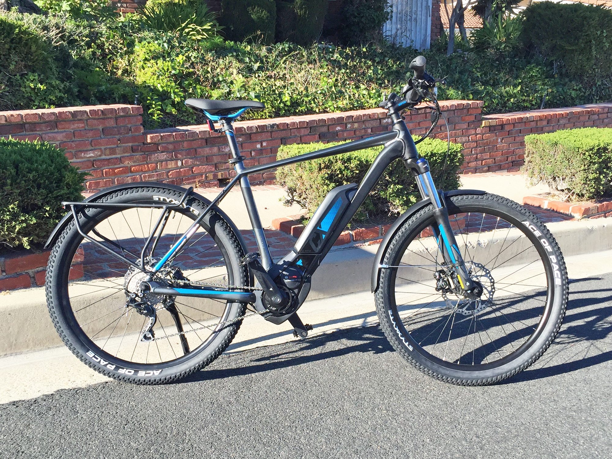

Total Weight:
55 lbs (24.94 kg)

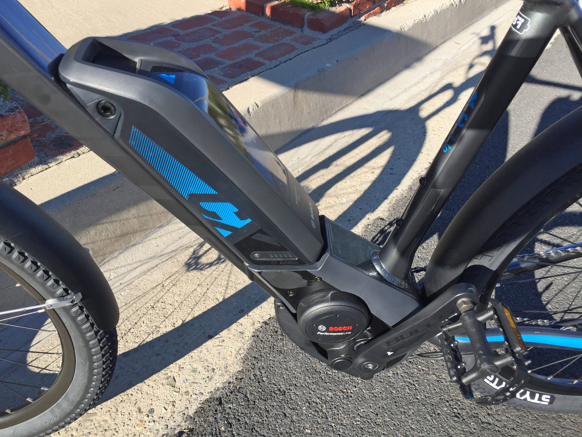

Battery Weight:
5.73 lbs (2.59 kg)
Motor Weight:
8.8 lbs (3.99 kg)
Frame Material:
7005 Aluminium
Frame Sizes:
16.14 in (40.99 cm)19.9 in (50.54 cm)20.47 in (51.99 cm)22.05 in (56 cm)Geometry Measurements:
32" Stand Over Height
Frame Types:
High-Step
Frame Colors:
Matte Black with Gloss Gray and Blue Accents

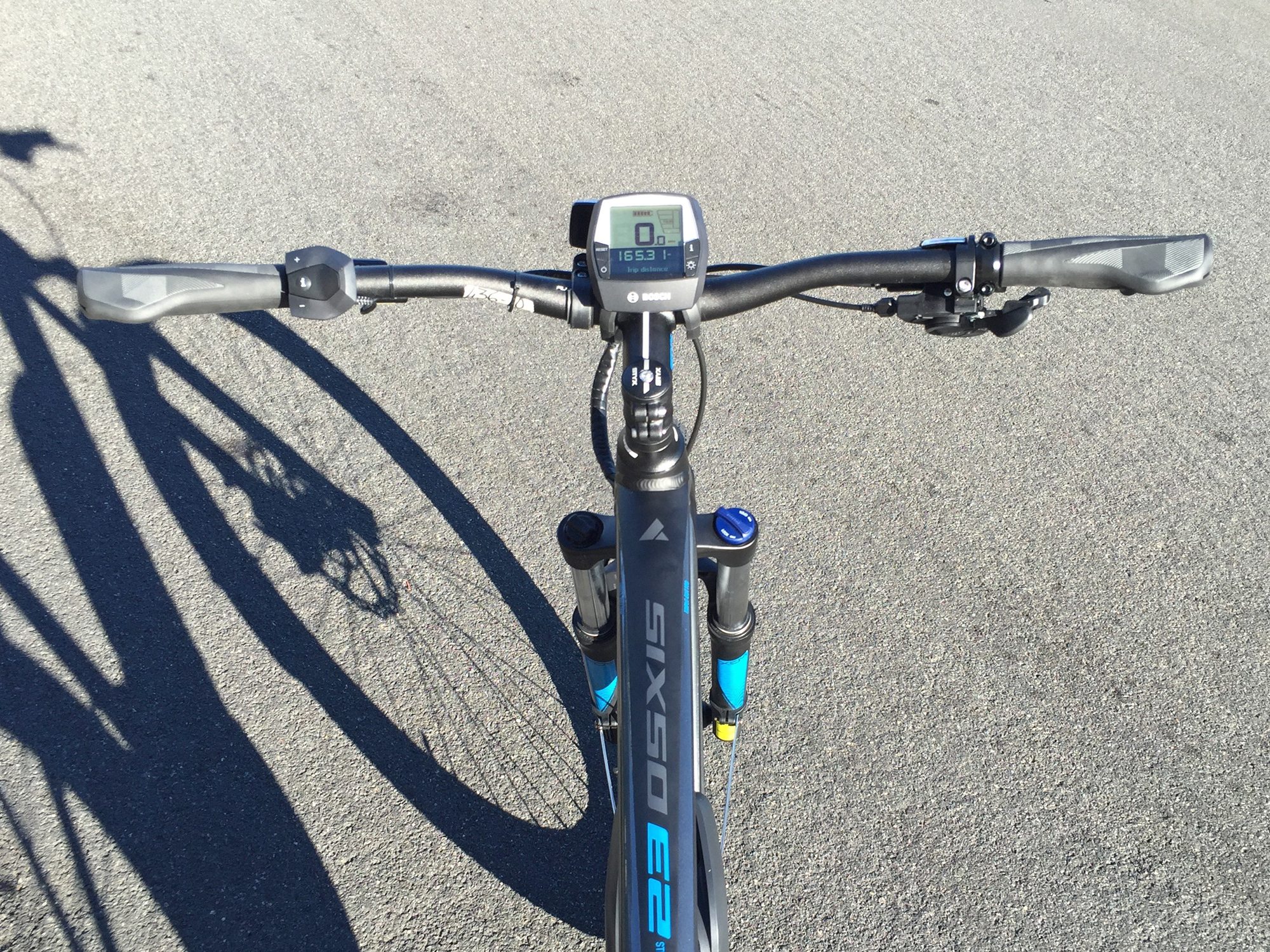

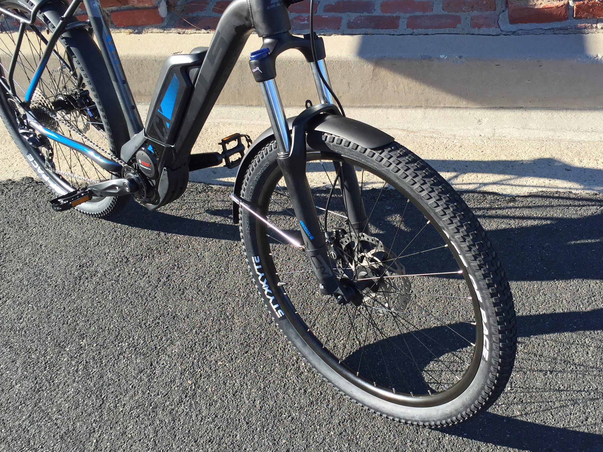

Frame Fork Details:
SR Suntour XCN-DS HLO 27.5, 120 mm Travel, Lockout, Preload Adjust, 9 mm Skewer with QR
Frame Rear Details:
9 mm Quick Release Skewer
Attachment Points:
Rear Rack Bosses, Fender Bosses, Bottle Cage Bosses

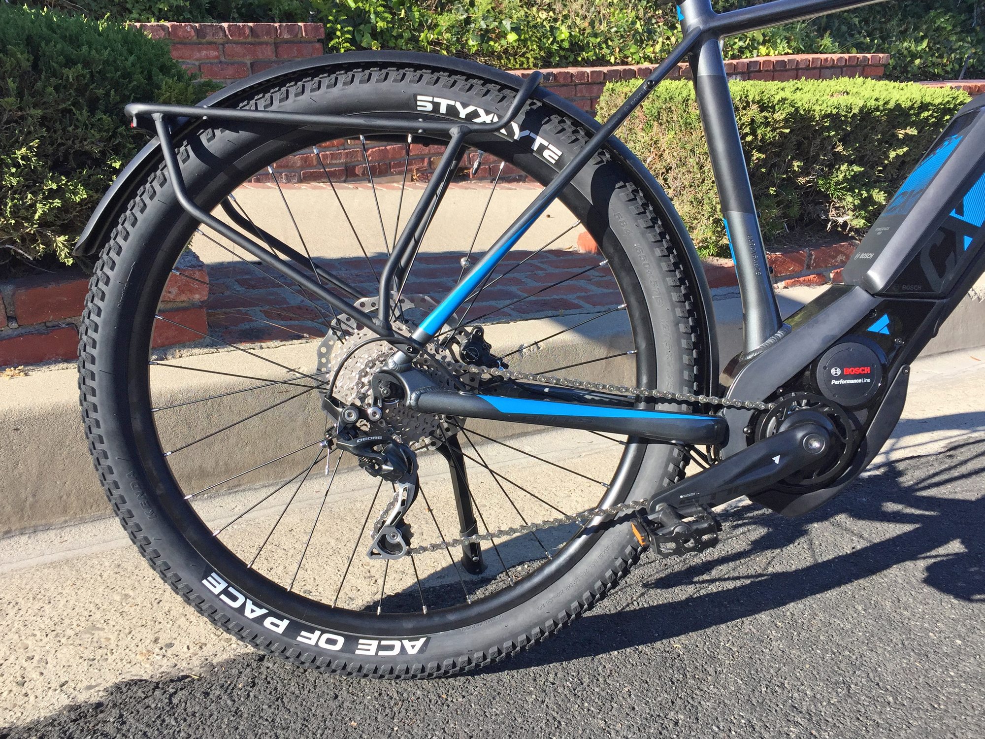

Gearing Details:
10

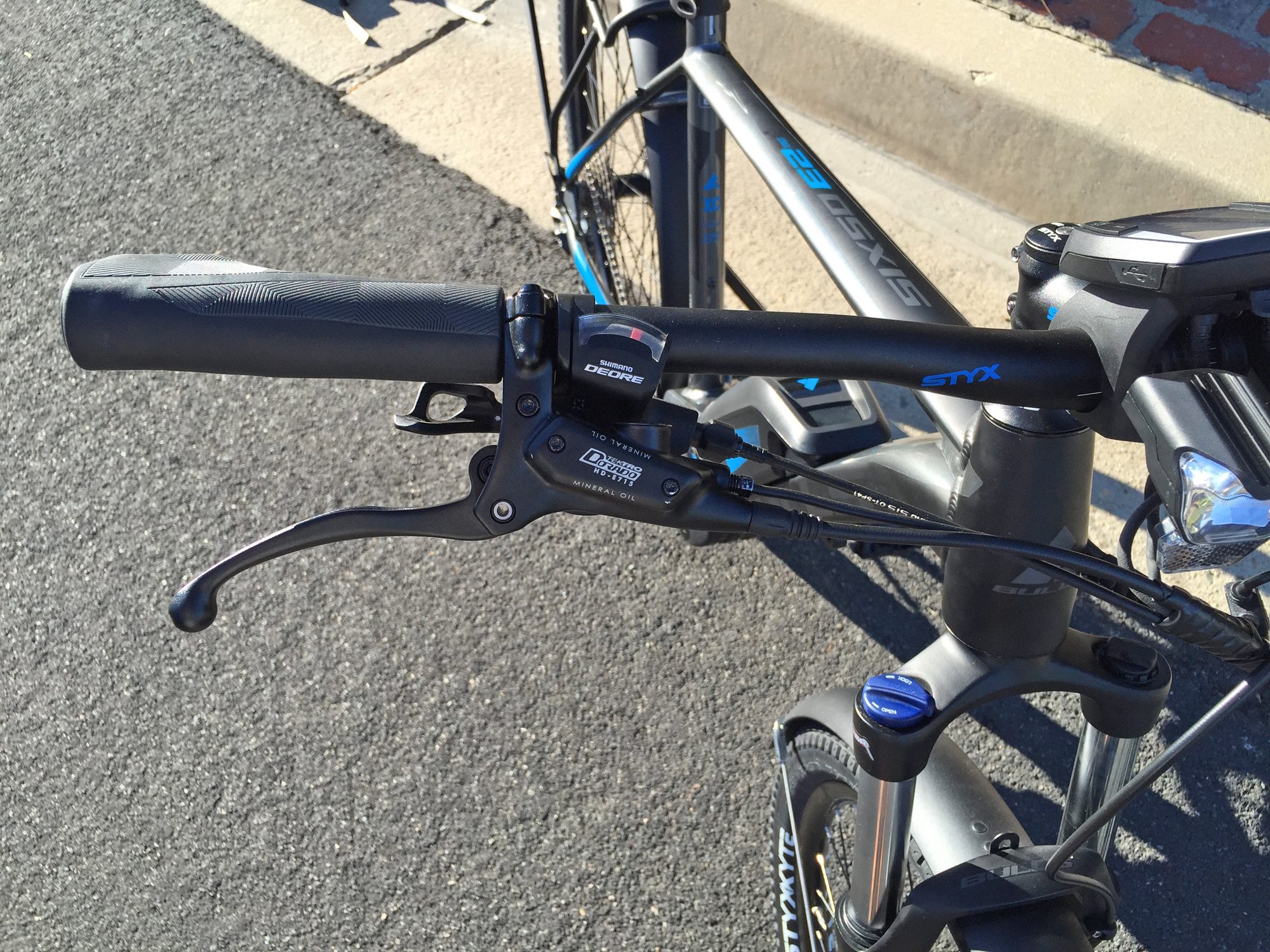

Speed 1x10 Shimano SLX Shadow, 11-36TShifter Details:
Shimano SLX on Right

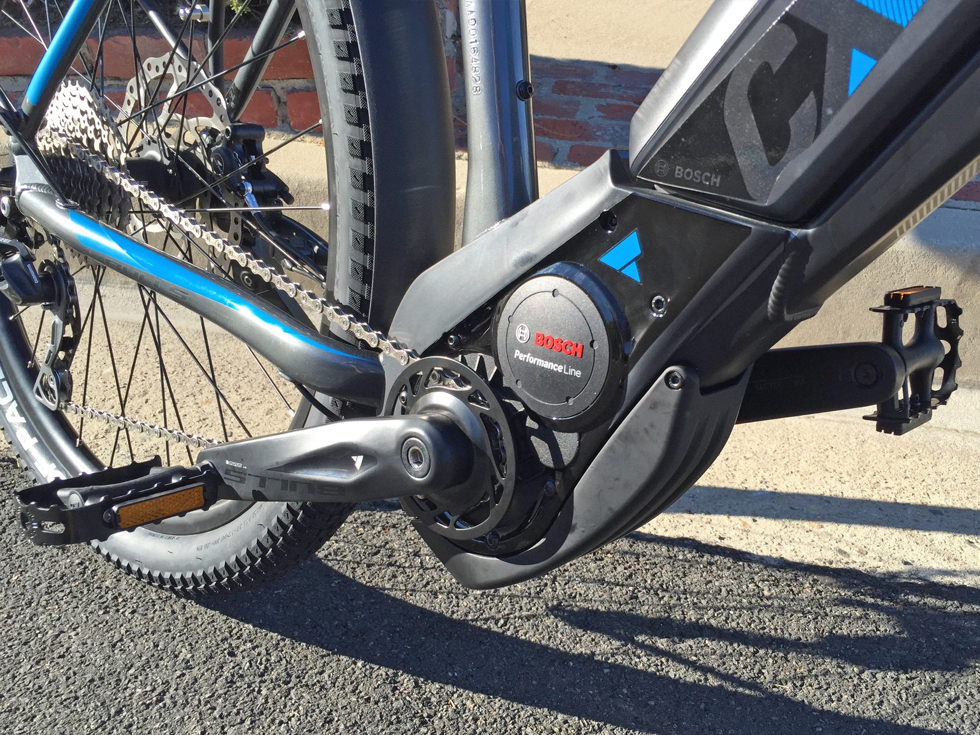

Cranks:
SR Suntour Cranks, 15T Chainring

Handlebar:
Alloy, 740 mm Length, 25 mm Rise, 9° Bend

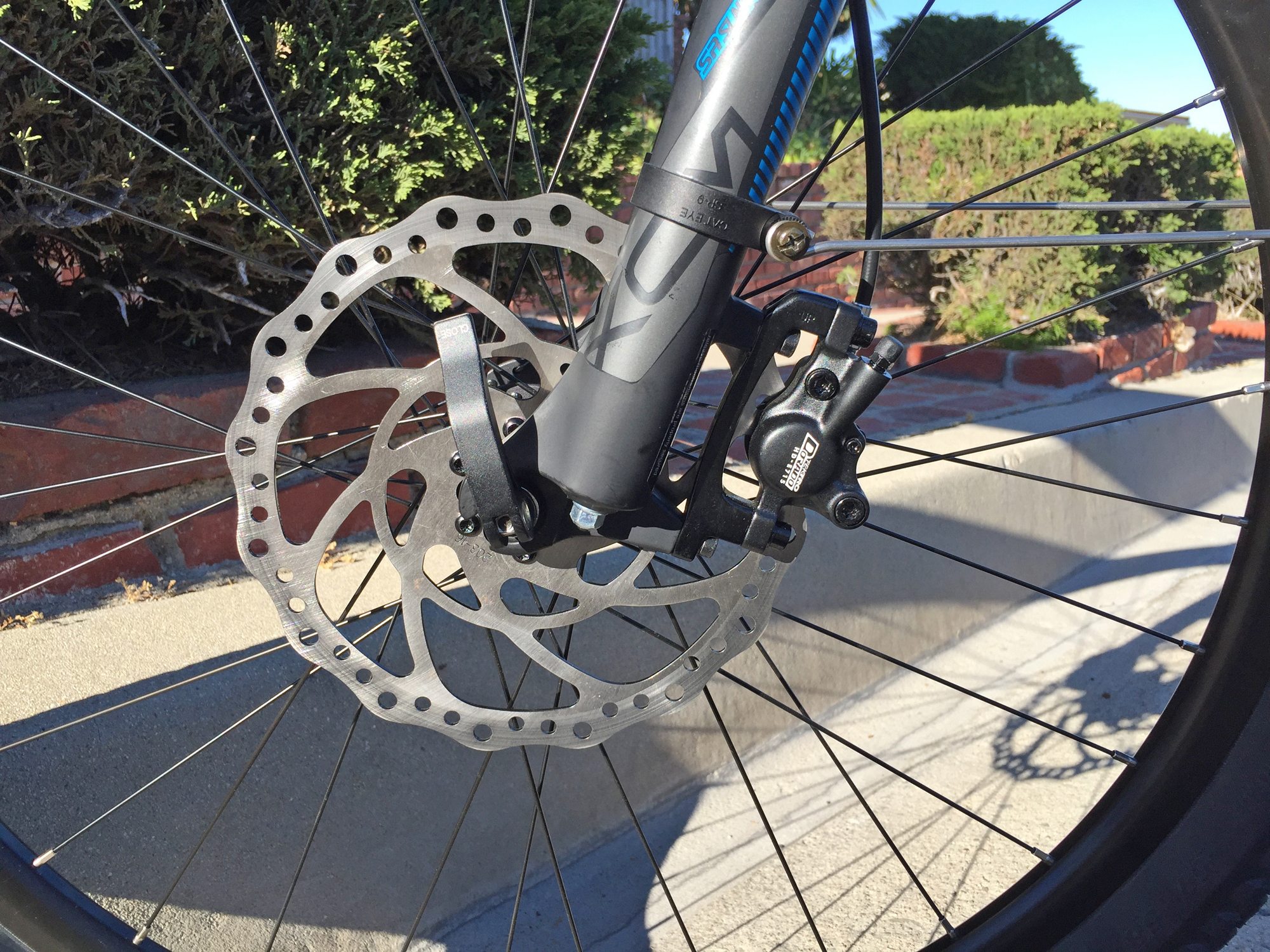

Brake Details:
Tektro Dorado Hydraulic Disc with 203 mm Rotors, Tektro Dorado Levers with Motor Inhibitors
Grips:
Velo Ergonomic, Black

Tire Brand:
Kenda STYX Ace of Pace, 27.5" x 2.25"
Wheel Sizes:
27.5 in (69.85cm)Tire Details:
30-50 PSI

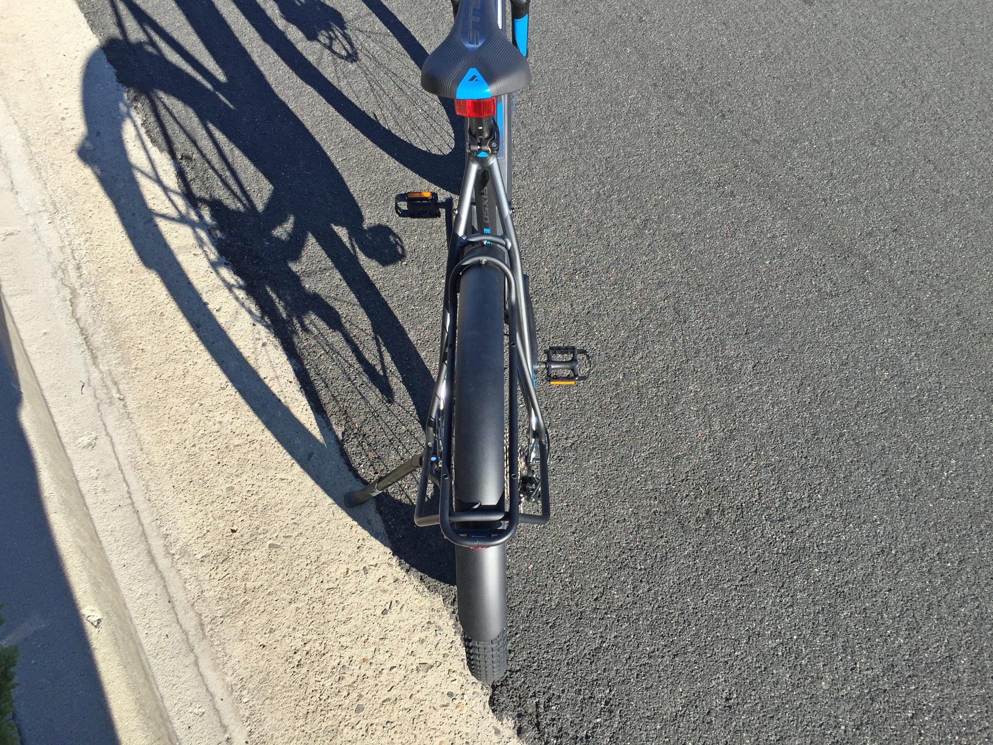

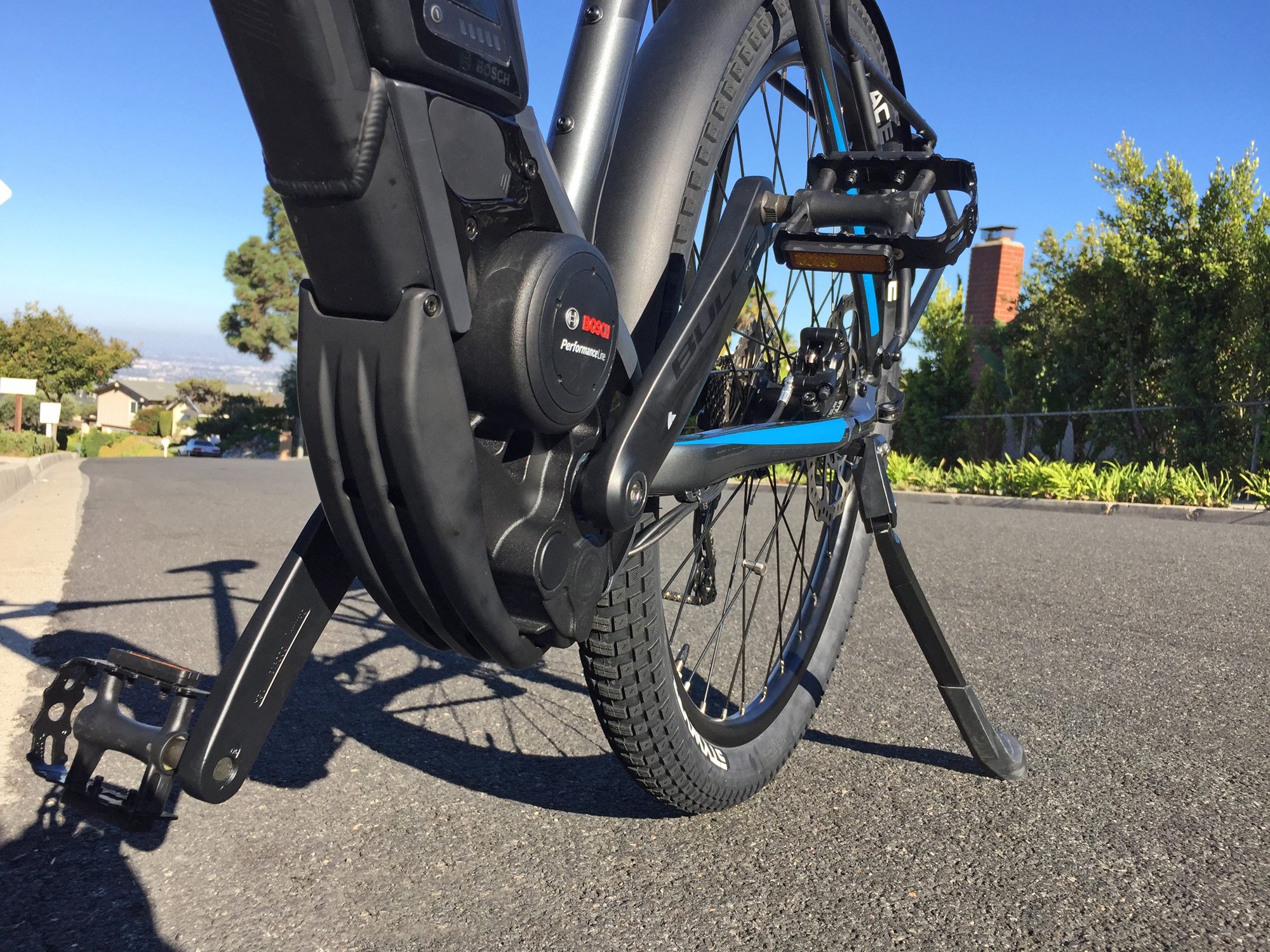

Accessories:
Aluminum Alloy Fenders, Standwell SW-CA477 Pannier Rack, Adjustable Length Kickstand, Supernova M99-E12 3 LED Tail Light (Brights with Braking), FUXON K1102 LED Headlight 60 Lux

Locking Removable Battery Pack, 2.2 Amp Charger 1.7 lbs, STYX Hub

It feels like the 15 tooth chainring is a mistake for a 28 mph bike. It would be perfect for a 22-24 mph bike but at 27 mph I’m just pedaling too fast. Thankfully, chainrings are cheap! I’m curious how the bike will ride with a 20 tooth chainring.

The Super Commuter has a 20 tooth chainring which I plan to install on my Six50, which came with a 15 tooth chainring. The 15 tooth chainring seems like a weird choice. I guess it would be better for really steep hills but in my 16 mile test ride (which I will be repeating 100s of times) I never touched the lower gears. I didn’t need them. Sometimes I just started out on the highest gear in turbo mode and I was fine. The 20 tooth chainring will run me about $25. Not a big deal. As is, the Six50 cruises easily around 23 mph. I had to really crank on it to go 27. I never got to 28 mph. I have read that adding a bigger chainring should help. We’ll see.

Court, I’ll entertain your suggestion for an eighteen tooth chainring. That might be the sweet spot. Yeah, it would be better if Bulls had the dealer network that Trek has. I’ll see if I can convince my local shops to carry them :-)
