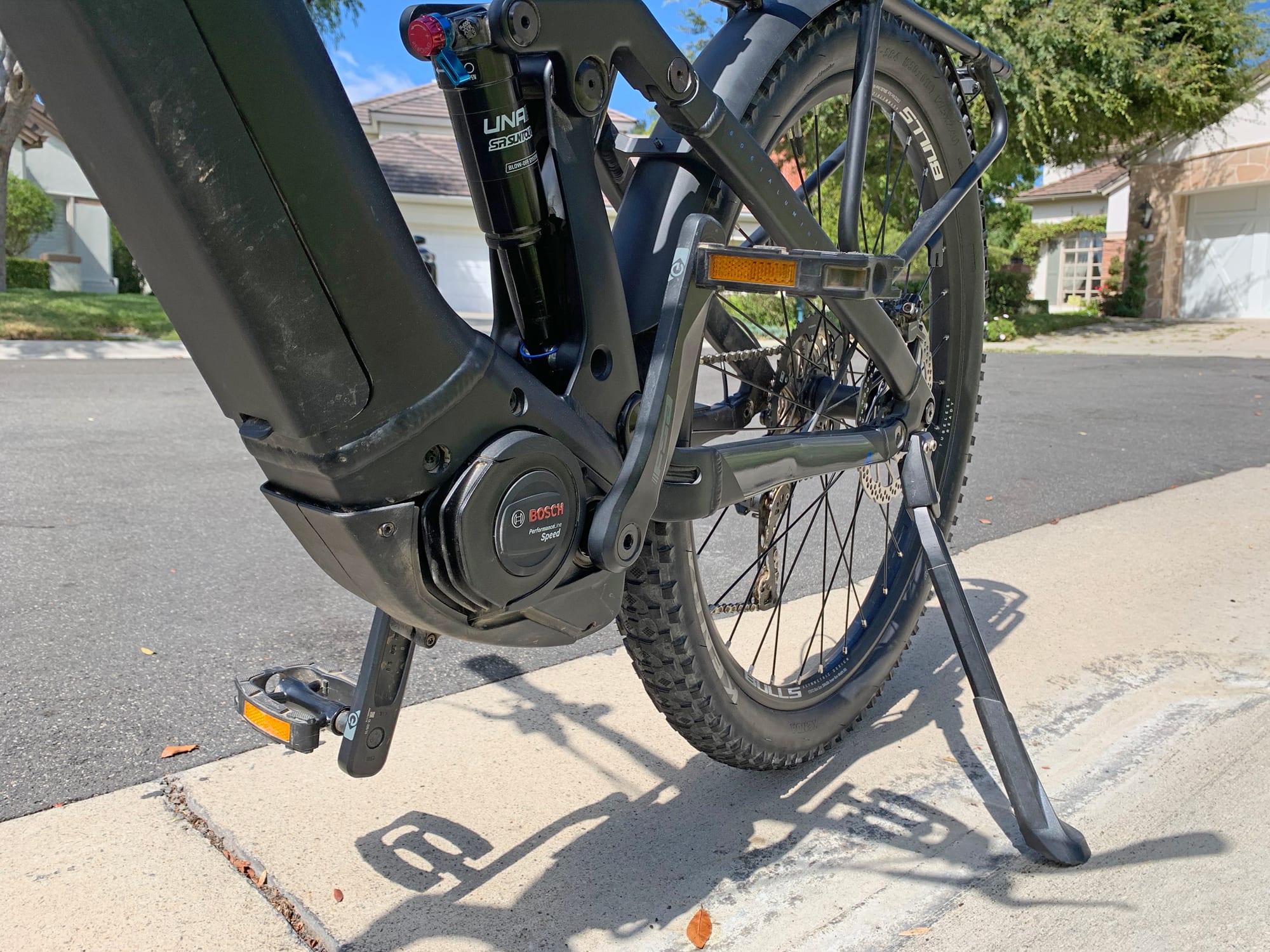

SR Suntour UNAIR, 120 mm Travel, Lockout, Rebound Adjust, Boost 148 mm Hub Spacing, 12 mm Axle with 6 mm Hex Key Bolts

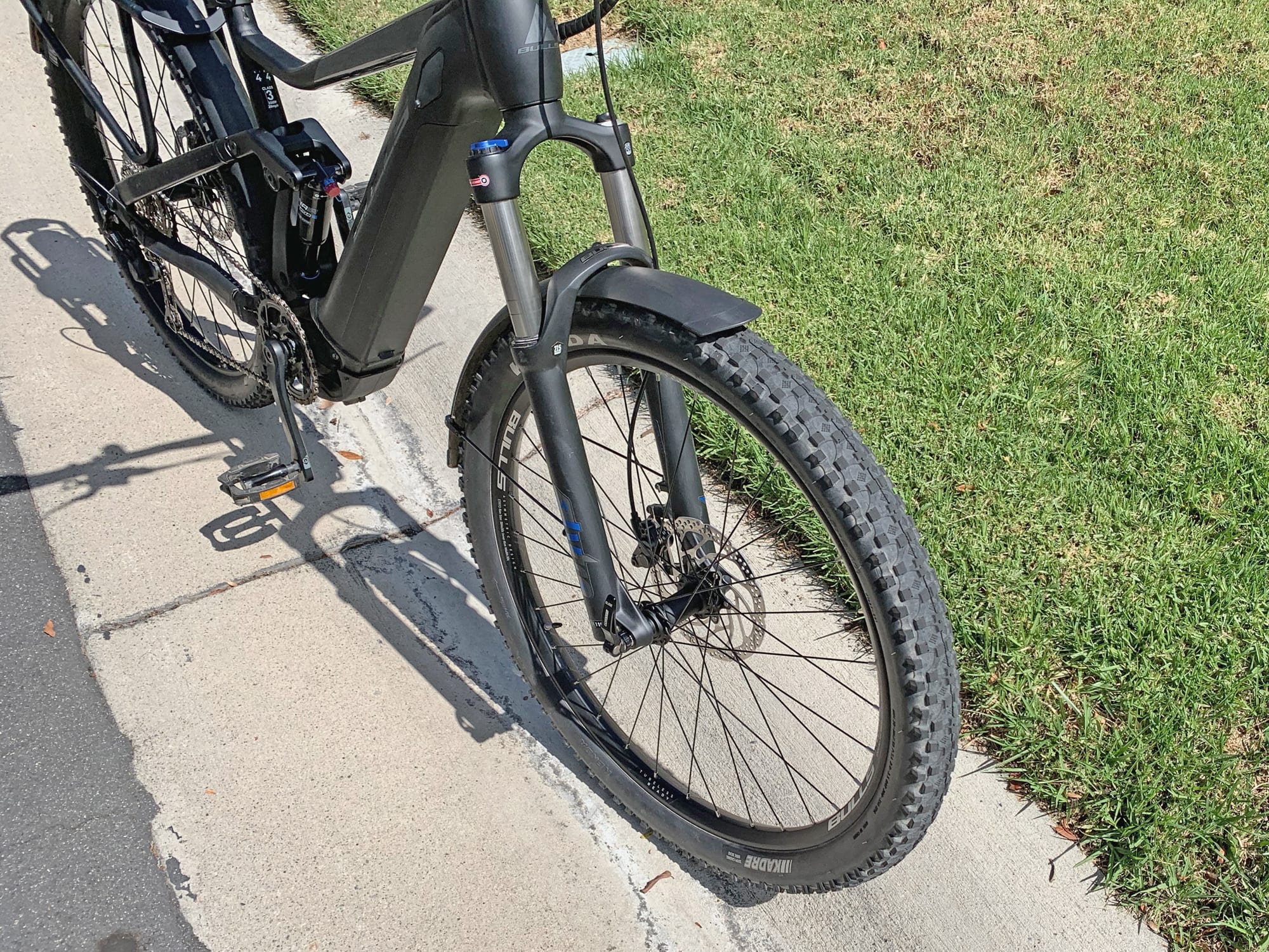

BULLS Branded Lytro 34 Air Suspension, 120 mm Travel, Compression Adjust with Lockout, Rebound Adjust, 34 mm Stanchions, Boost 110 mm Hub Spacing, 15 mm Thru-Axle with Quick Release
BULLS Eccentric 35, Double Wall, Aluminum Alloy, 584x35c, 32 Hole | Spokes: Stainless Steel, 14 Gauge Front 13 Gauge Rear, Black with Nipples
CST Supero All Ground, 27.5" x 2.4" (62-584), Anti-Puncture, Reflective Sidewall Stripe

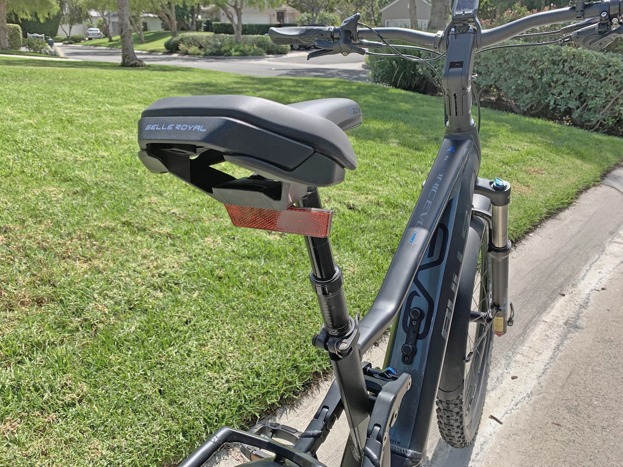

Limotech Jovial Dropper (75 mm 100 mm 125 mm or 150 mm Travel)
30.9
Selle Royal E-ZONE

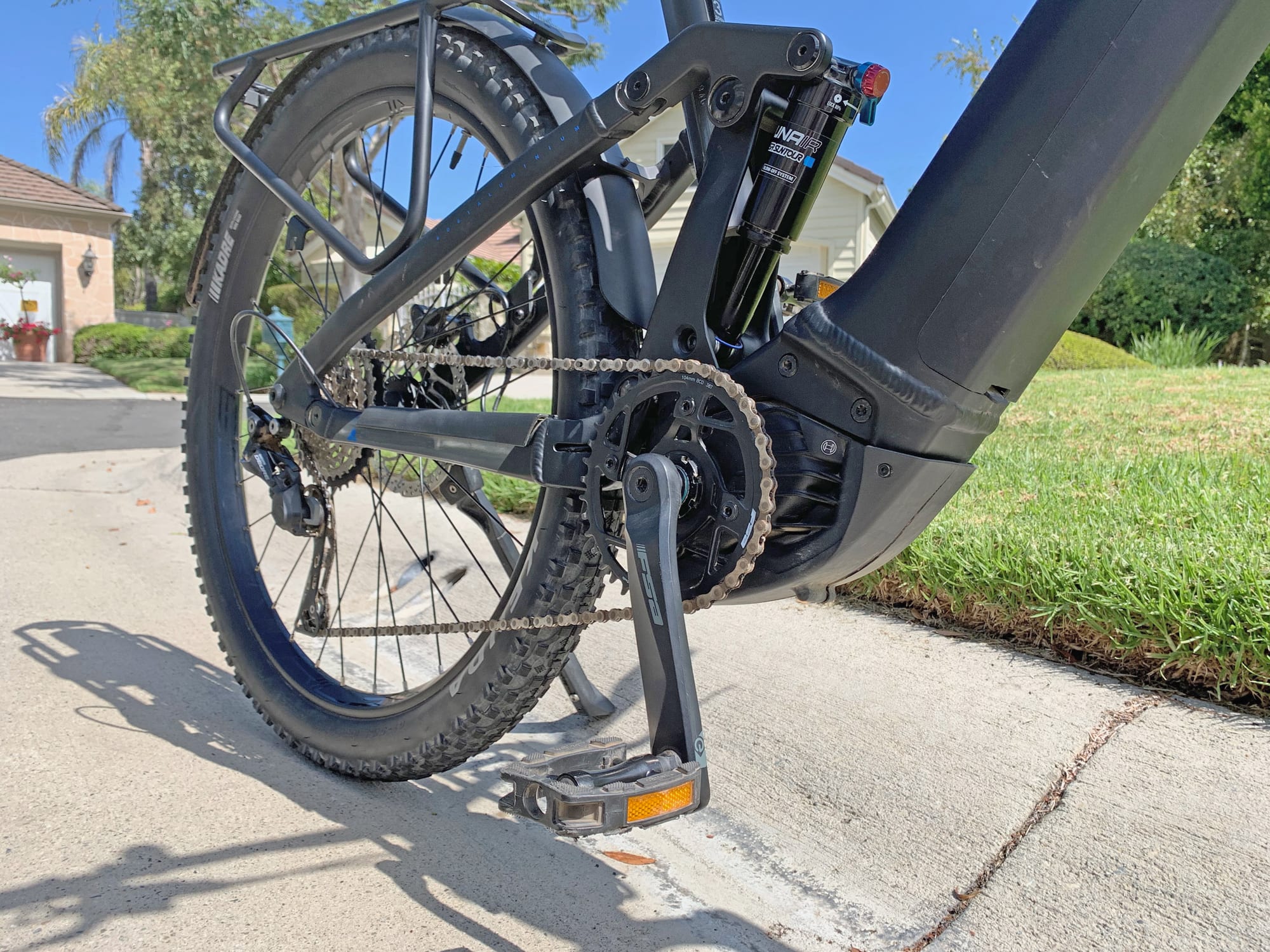

  • Bosch Gen 4 motors no longer use a reduction gear, so the standard sized chainring freewheels without producing any drag and the Performance Line motors don’t clunk when you stop pedaling like some of the Active Line models… though the chain does not cycle backwards when you backpedal

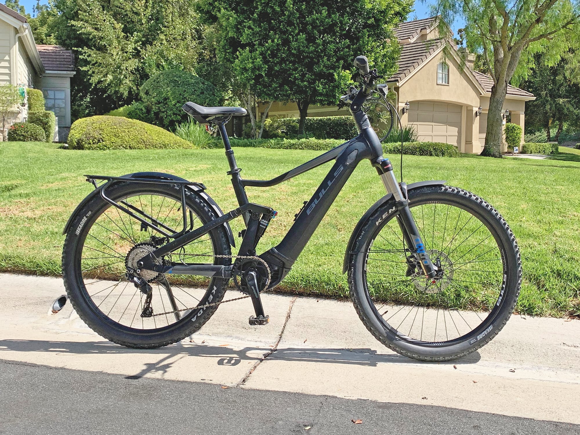

  • A unique full suspension Class 3 electric bike that’s setup for cross country or urban commuting… the 120mm air suspension with compression and rebound adjust gives your wrists, shoulders, back, and neck a break, while also reducing knee pain whereas a suspension seat post on a hardtail model would not. The bike offers a beautiful aesthetic and lots of utility extras with a reliable drive system from Bosch, high capacity 625 watt hour integrated battery, upgraded Kiox color display panel is removable and features a Micro-USB charging port

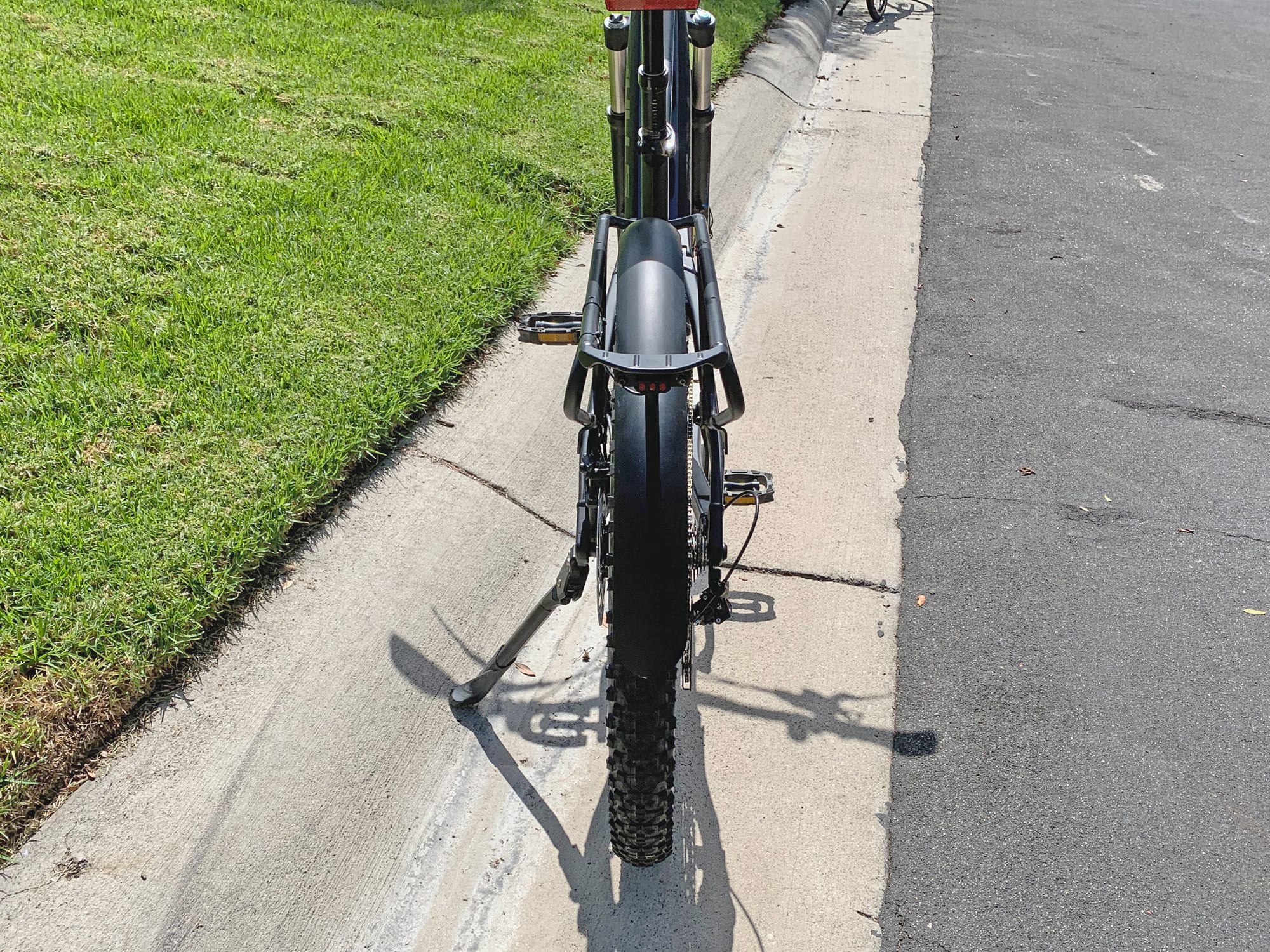

  • This is a feature complete electric bike that comes with quality integrated lights, aluminum alloy fenders, thick plastic slap guard, a sturdy rear rack with pannier slide stopper knobs and bungee notch (even an optional top platform for trunk bags!)

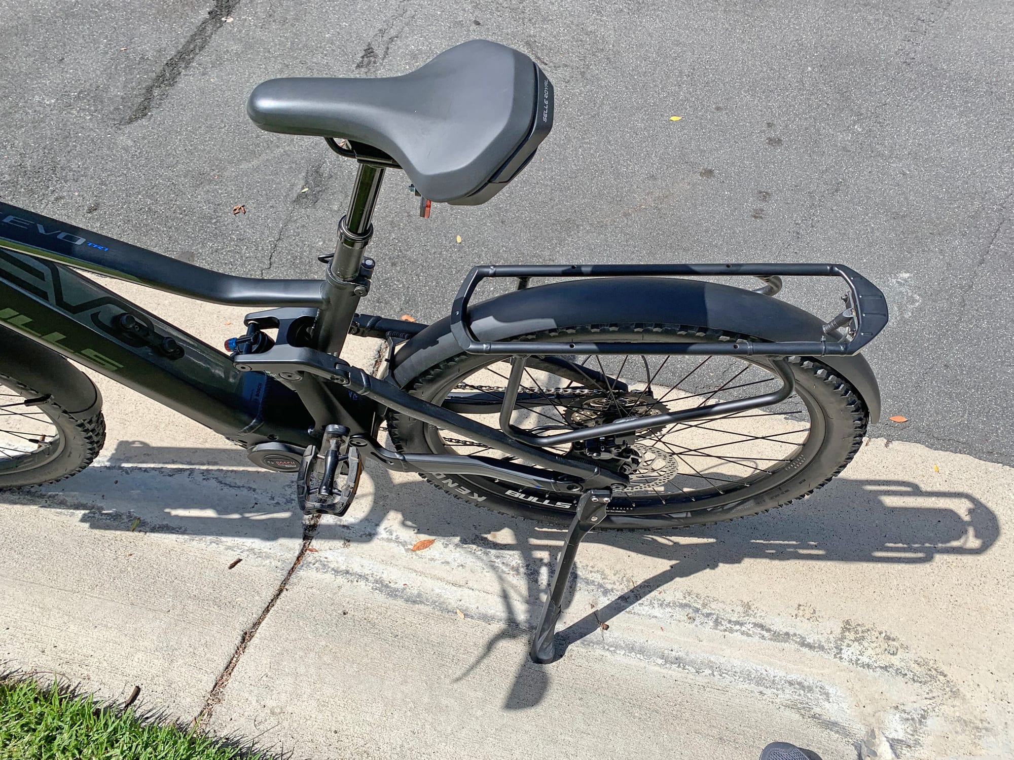

  • In addition to the 3-LED rear light, BULLS has included a very large back reflector. I also noticed that the saddle has a handle built into the bottom, so it’s like they really thought about the urban use case and made conscious decisions to optimize this ebike for that sort of environment :)

  • Large 180mm hydraulic disc brake rotors provide a mechanical advantage for stopping larger wheels, they cool faster, and the front caliper offers four pistons (two on each side) that support a longer brake pad that also stops more efficiently with more surface area that cools faster… the rear caliper is a standard dual piston (one on each side), which is good enough to get the job done here

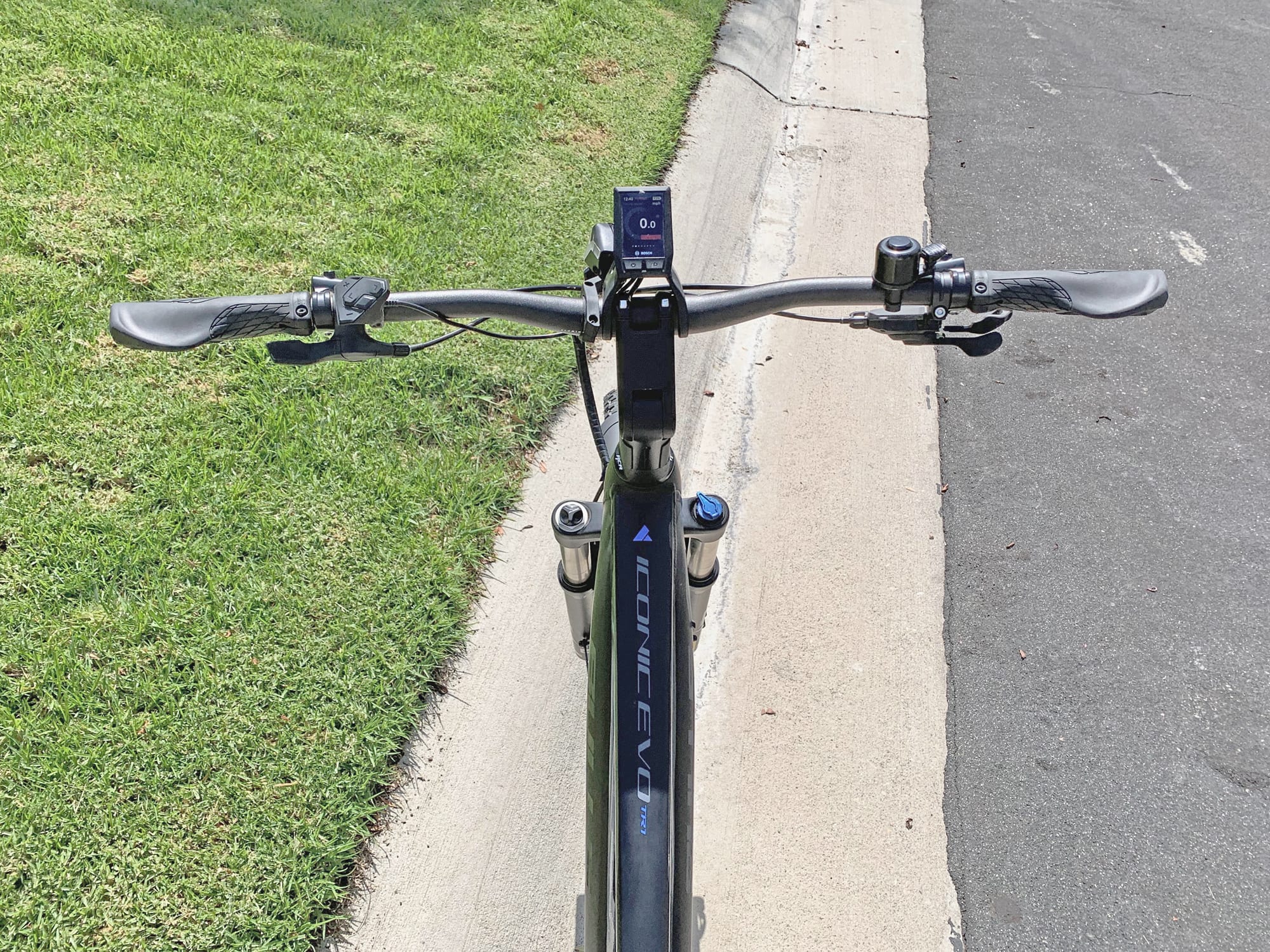

  • I noticed that the stem and spacers here are a rounded rectangle vs. standard circle, and this provides room for the Bosch button pad cable to run through and be hidden, the spacers are actually two parts that can be taken apart to change positions and de-couple from the cable! Note the beautiful internal cable routing of the other electronics, shifter, and brake line all across the frame, it looks nice and keeps the cables safe

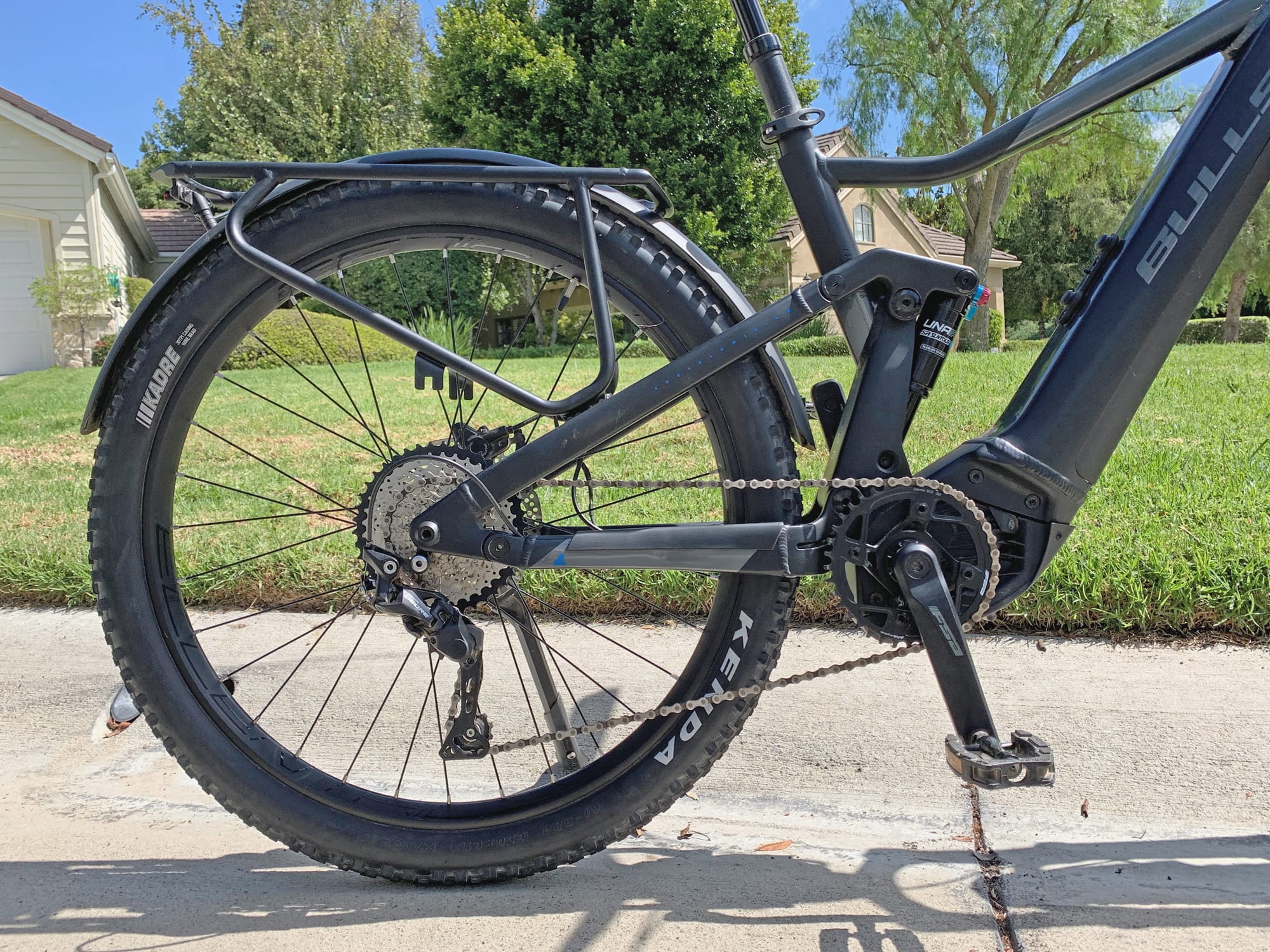

  • Solid 10-speed drivetrain here with a reliable Shimano Deore derailleur that has a clutch for tighter chain tension when riding fast or going off-road, note the narrow-wide chainring that reduces chain drops on bumpy terrain!

  • Very cool seat post dropper! The Limotech Jovial provides different extension lengths depending on which frame size of the BULLS ICONIC EVO TR 1 SPEED you get, but the post doubles as a suspension seatpost with just a little bit of give to take the edge off of a hard hit
  • Adjustable length kickstand is positioned perfectly at the rear end of the bike, clear of the left crank arm and not colliding with the large 180mm disc brake rotor… it should support a loaded rack well from its position
  • Premium 4th generation Bosch Performance Line CX Speed motor is 2.5lbs lighter than Gen 3, offers even more torque at 75nm vs. 63nm, and is more compact. I like how BULLS tips it up and blends it into the downtube… it’s almost hidden behind the 42 tooth chainring from the right hand side. I found the motor to be smoother and more dynamic than previous generations. It still offers shift detection and can support over 120 pedal strokes per minute, so you don’t have to upshift gears to maintain motor support, the motor controller is extremely smart and consistent, it measures rear wheel speed, pedal cadence, and pedal torque over 1,000 per second

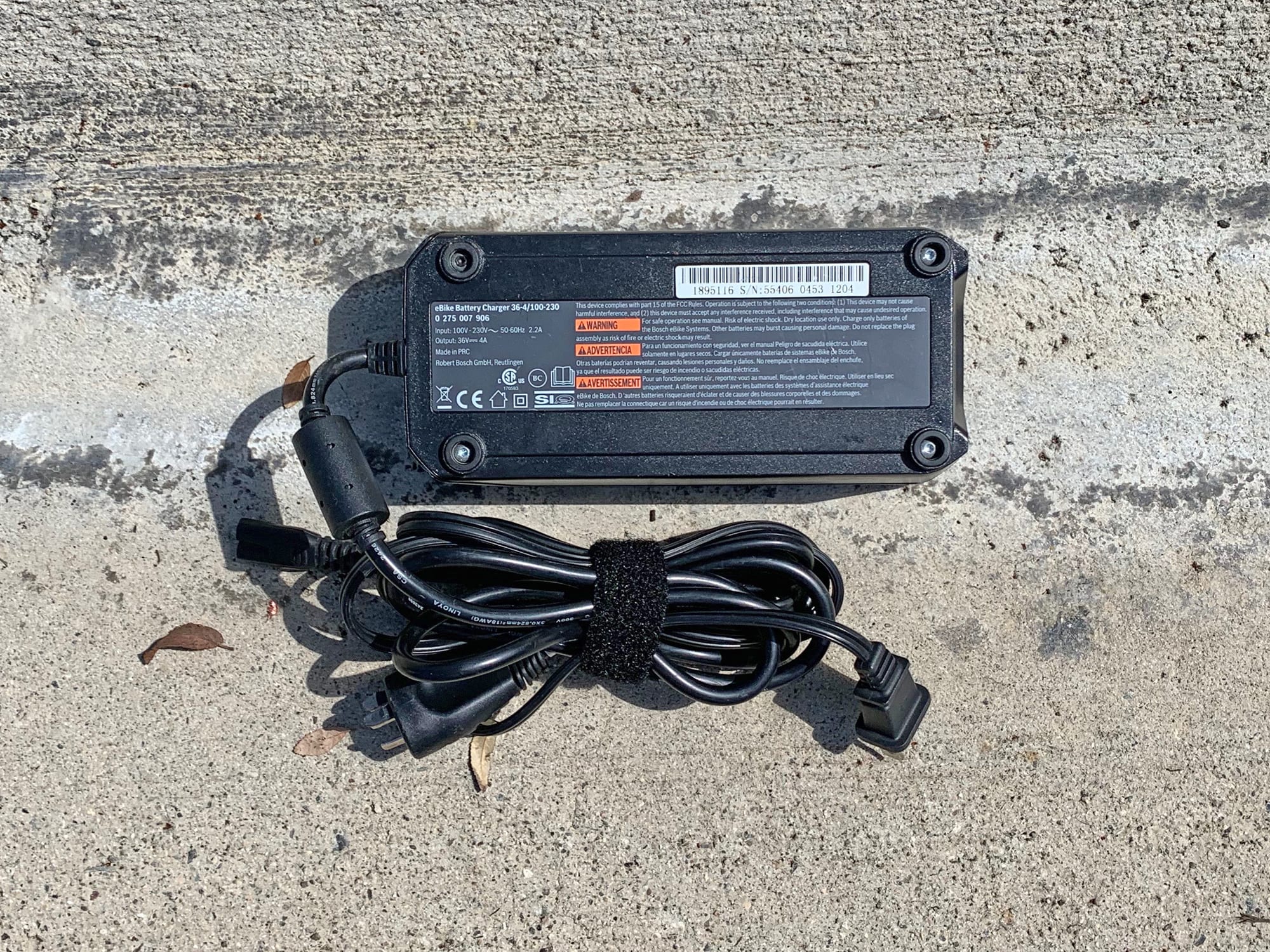

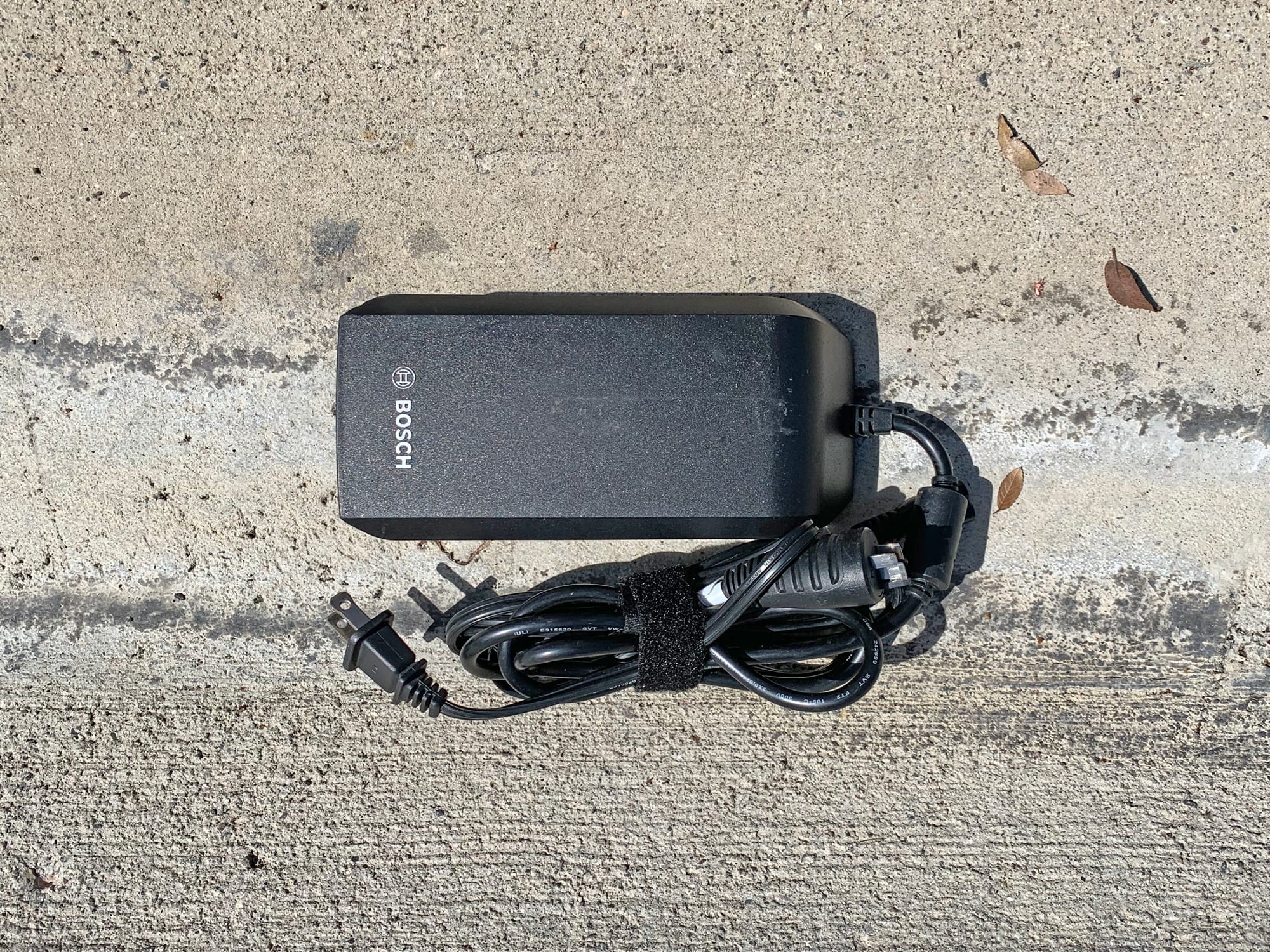

  • The included high speed 4 amp charger is a perfect fit for the higher capacity battery, it features a proprietary plug that won’t get mixed up with other Bosch products and the compact size (with removable wall-side cable) and lightweight 1.7lb design makes it easy to bring on longer rides

  • The Kiox display panel is well protected at the center of the bar, is connected via magnets and can be removed easily, uses Gorilla Glass so it won’t scratch up like plastic if it gets dropped, and it offers Micro-USB charging for portable electronics. The display is fairly easy to interact with using the remote button pad, mounted near the left grip and it provides a Bluetooth option for use with mobile devices
  • I love that the Kiox LCD is color because it’s easy to interpret which assist level you’re in without squinting to read a small font (the display isn’t especially large at 1.9″ diagonal). I love that it lists battery percentage in addition to range estimate for more precise trip planning, and I love that Bosch is working on Bluetooth applications which could sync with heart rate monitors and other devices in the future

  • I love the way this ebike looks, how they matched the frame color to the motor casing and suspension fork perfectly, but it only comes in one color option, and it’s fairly dark… thankfully, I was told that the final version will come with tires that have reflective stripes! (I’d definitely wear reflective clothing and get panniers with reflective fabric or patches, also consider black reflective stickers like these if you ride in the dark frequently)

  • Despite moving away from the reduction gear (with smaller chainring) the high-powered Bosch ebike motors still produce a fairly audible whine at high RPM and high power settings, it’s not a deal killer, but seems a bit louder than Brose at times, keep in mind that the video was filmed on a demo bike with pre-production motor… so it might be quieter on the final units
  • I feel that they could have upgraded from 11-42 tooth to 11-48 or even 51, given the wider range of supported speeds. It might have reduced durability or just added to the price? Wasn’t a huge issue during my test rides however, and I love the trigger shifters they chose (two way high shift lever, multi-step low shift lever)
  • Minor consideration here, the rear rack is not suspended, so your gear will bounce up and down as you ride over rough terrain vs. if it were attached to the main section of the bike. For comparison, check out the Riese & Müller Delite with suspended rack (heavier bike, more expensive, but better rack design)
