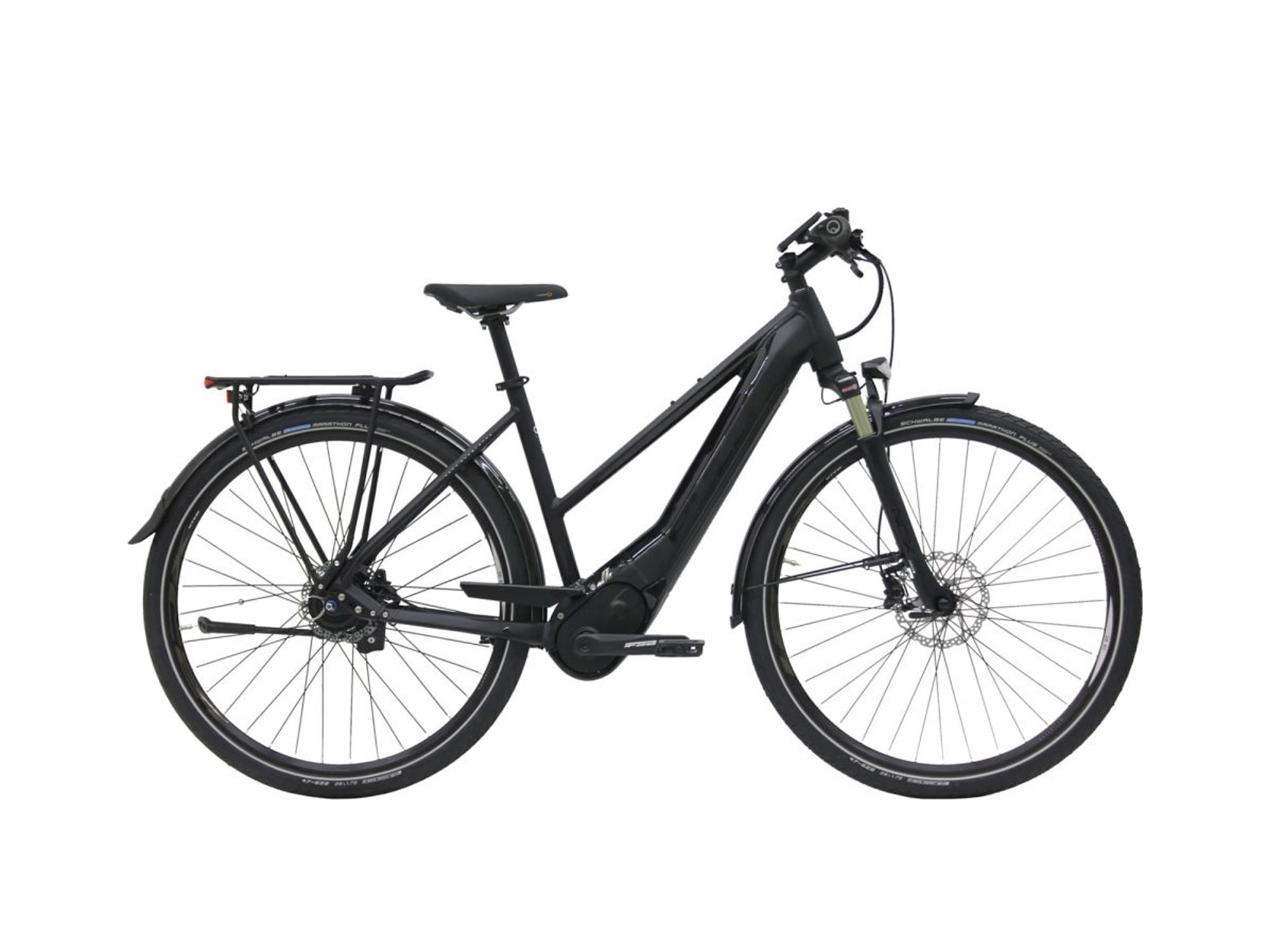

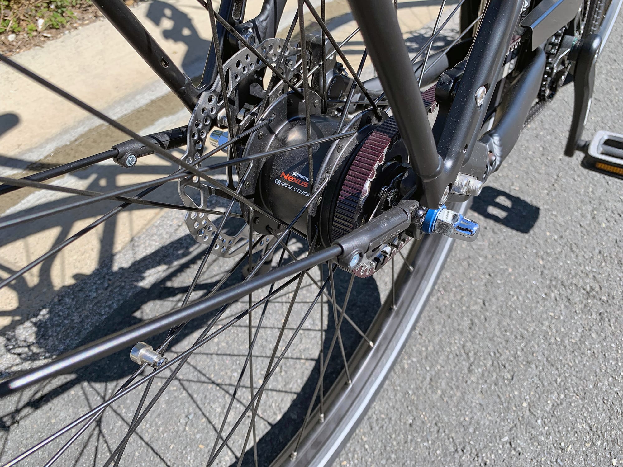

The BULLS Lacuba series has many variations, but this one may be its smoothest yet. That’s thanks to the EVO Lite here using not only a Brose S Mag with an internal Gates Carbon Belt Drive, but is also using a Shimano Nexus Inter5 belt driven geared shifting hub. The bike comes in 3 frame styles, a step-through, mid-step, and high-step, but also comes in 4 various sizes across the lineup. Each size has slightly different specs with the handlebars, crank arms and other setting, but are more or less the same in the settings mentioned in this review. For reference, today I am checking out the Small sized step-though for reference. This Small step-though weighs 55lbs, and the bike will pretty much go up from there with the other frames and sizes. There is a lot of adjustability and comfort on this bike. For example, you get a premium SR SunTour NCX air suspension fork in the front. A lot of times when I see commuter bikes, they have spring forks, so it is nice to see an air fork here. It is lightweight and more adjustable than a spring fork, there is a compression clicker and a lockout as well. I noticed the headtube was tapered also, so you could switch it out for another fork if you wanted. The tires are 28” x 2”, so fairly large with a 35-65psi range. The tires here also have reflective sidewalls for safety and puncture protection built in to reduce flats. The bike also includes these awesome fenders with mud flaps to help alleviate toe strikes. The fenders are mad of this durable plastic, and they even connect to the included rear rack to help reduce rattling. For more comfort, they have these Ergon ergonomic grips and this Selle Royal gel seat. The seat post is 30.9mm here so you could swap that out with a suspension seat post to almost get a full suspension effect on the bike. I love that the Lacuba also comes with battery integrated lights. In the front you have an aim-able light that points where you steer, however in is mounted on the fork, so you might get some bouncing. The rear light is integrated with the rear rack and I love that they put a reflector under it too so you get the best of both worlds. Other features include bottle cage bosses, Wellgo platform pedals with grip tape, an alloy chain cover over the belt, flick bell, and this heavy duty adjustable kickstand which is mounted away from the pedals to eliminate pedal lock.

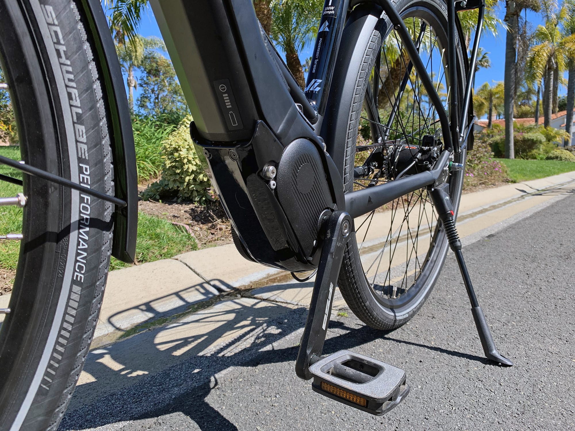

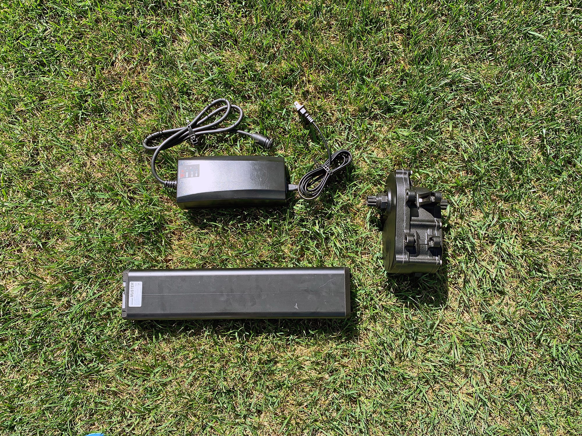

Driving the bike is a compact mid-motor from Brose called the Brose S Mag with redesigned casing that uses less material. It’s also using a lighter weight material; magnesium verses aluminum alloy. My guess is that the internals are similar to the Drive S Alu but the weight dropped from 7.5lbs to 6.39lbs. You still get a very narrow Q Factor, optimal spindle placement (to reduce chain stay length for snappier turns and a shorter overall frame length), and excellent ground clearance. This motor is compact and has a sturdy plastic skid plate below, in case you do take a rock or log strike with the suspension fully compressed on a drop. So, the motor unit is small, but it really packs a punch. You get 250 to 560 watts of power output with up to 90 newton meters of torque! That’s extremely high for a mid-drive unit. Power is delivered based on your rear wheel speed, pedal cadence, and pedal pressure. The new Shuttle mode is all about torque, allowing you to raise it in lower cadence situations, sacrificing battery efficiency for more help if you prefer to pedal slow and reduce cardio while climbing. I personally love this feature because my knees are sensitive and I don’t always want to pedal fast. If, however, you do want to spin, the Brose motors all support 120+ pedal RPM. This means it won’t drop out on you while downshifting on approach to a big hill. Moreso than many other competing products, the Brose motor really hangs in there at high pedal speeds. The Drive S Mag is light, more powerful, and amazingly… more efficient than its predecessors, but it’s still quiet and smooth because it contains a Gates Carbon belt drive that transitions from gears to spindle output. This reduces vibration and provides an organic feeling to the pedal experience that I can vouch for. The older Drive S was my favorite between Bosch, Shimano, and Yamaha for this reason, and Brose is expanding its support and presence in North America. There’s no pedal drag if you do choose to pedal unassisted (no reduction gearing) and the motor is decoupled from pedal strokes beyond the maximum supported speed of 32km/h (20mph). It’s an outstanding drive system, but I do feel that the charging port positioning, on the left side of the motor bulge, requires additional bending over and is in the travel path of the left crank arm… which could get snagged or bumped out of position. At least it’s magnetic with a leash, so it won’t break, and the cover seems very durable. The Brose S Mag does not incorporate shift detection like Bosch and some Impulse systems, but that’s less of an issue with the internally geared hub here. The Shimano Nexus Inter5 is a mid-level part that provides a good range of pedaling options as well as some self-protection mechanisms. If you try to shift while pedaling hard (or if the motor is pushing hard), you may hear some clicking and notice that the gear does not change. As you ease off a bit and the motor slows down, the gear will click into place. This behavior is different than traditional sprockets and derailleurs that will basically force a change and compromise the chain and teeth on the sprockets, wearing them out quicker. For cyclists who have ever had their bike tip over and bend the derailleur or those who have experienced dropped chains and lots of greasy noisy operation… internally geared hubs can seem like a dream because they are so durable and clean. The chain on this bike never changes position, there’s just one chainring up front and one sprocket in the back, and Bulls opted for an alloy guide on the chainring so it’s almost impossible to have the chain fall off. To me, this is almost overkill because the Lacuba EVO Lite isn’t designed to assist you over 20 mph and is not setup for extremely bumpy off-road use. Still, it doesn’t add much weight to have the full chain guide vs. a chainring guard, so I see it as a nice little upgrade. Shifting can be done at a standstill which is nice, and there is even a little window here that shows you what level you are at. Overall, its is very quiet, clean, and durable… it is complimented very well by the hydraulic disc brakes with 180mm in the front and 160mm in the rear.

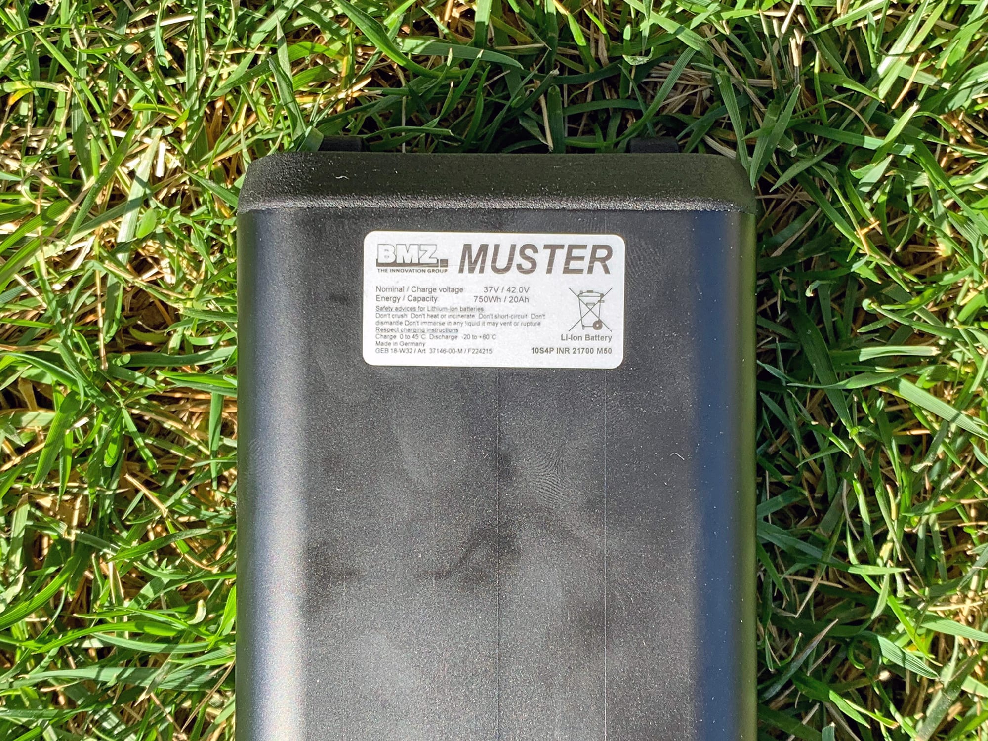

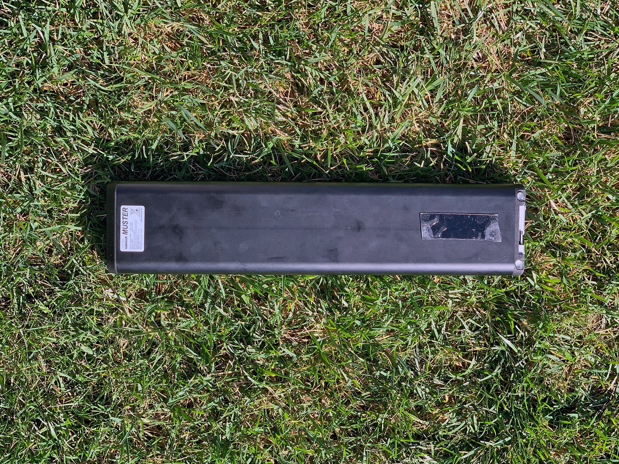

Powering the bike is a Supercore frame integrated battery. The Supercore battery has an aluminum alloy casing and is actually IP56 ingress rated! This battery is 37.5v and 20ah, I consider it a big win here as it is really high capacity with that amp hour rating…. really just a great battery for all day riding. There is no battery cover here, but it does have this impressive aluminum alloy incasing that is actually IP56 ingress rated, so overall, very durable. The battery is about 8lbs and has this nice handle for transporting. There is also a battery readout infographic so you can check the charge level without putting it on the bike. The battery is secured via lock and key and it is using an Abus system that can be key-to-like with other Abus locks so you only have to carry around 1 key. I love the magnetic interface here for charging, very easy to use and clean setup. The charger itself has a magnetic cable too, and it is about 1.9lbs, so pretty portable. I love that it charges at 4.7amps…. That’s really fast and a great paring with this high capacity battery. To really care for this and other lithium-ion packs, I have heard that storing in a cool dry location vs. extreme heat or cold will extend the life and try to keep it about 50% full when not using for long periods so you won’t stress the cells. Try not to let it run down to zero, because that’s really hard on the cell chemistry.

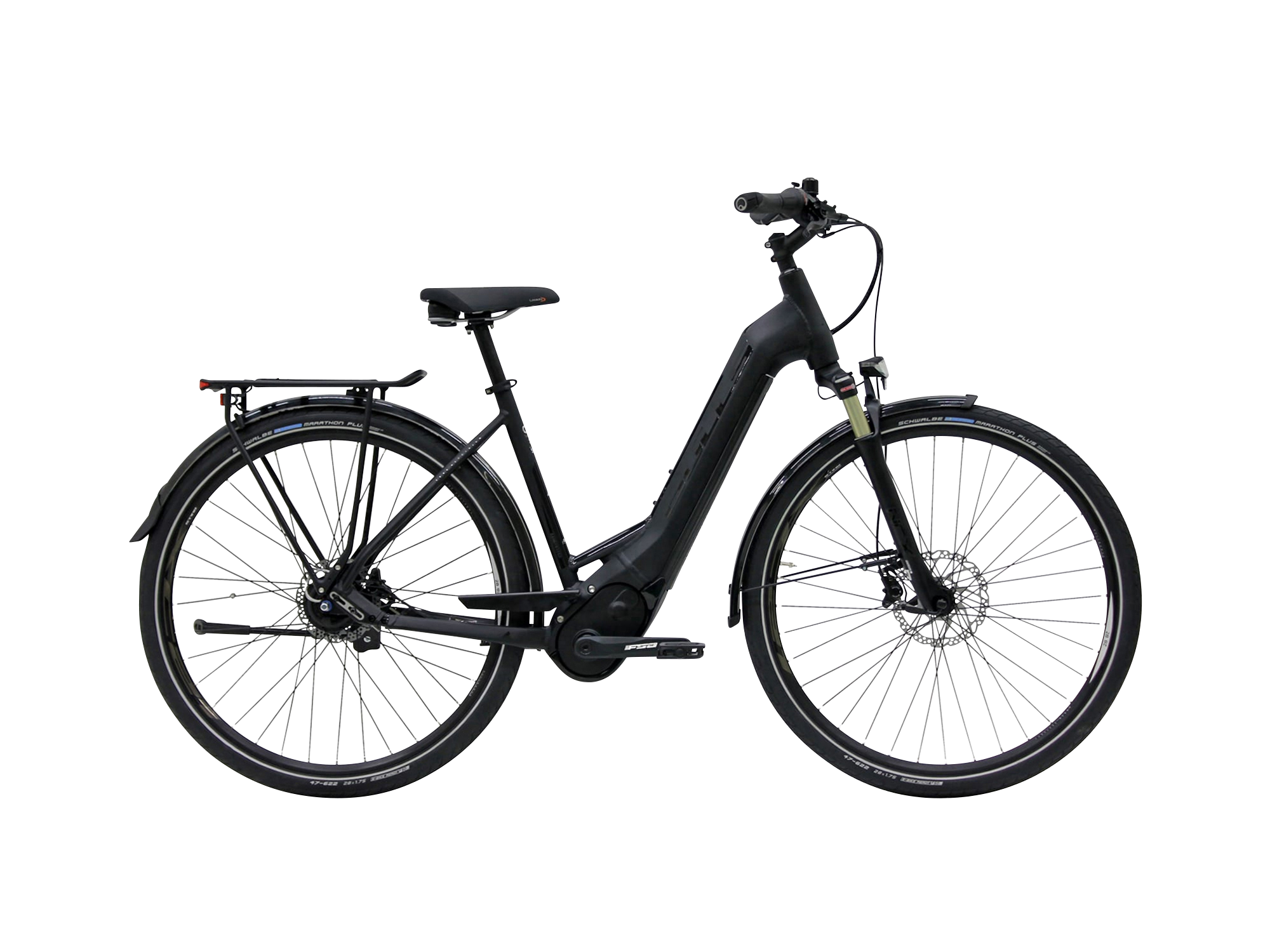

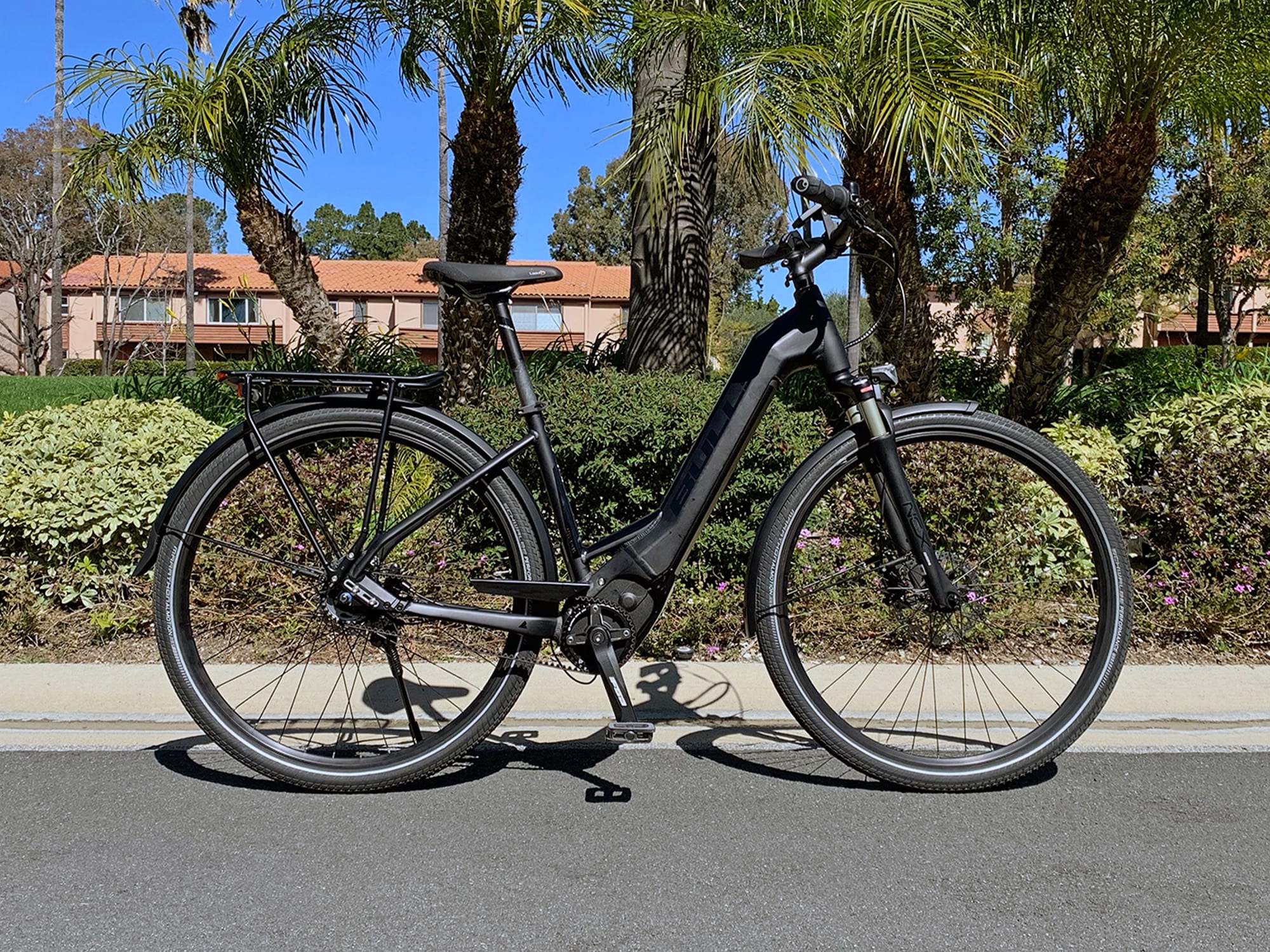

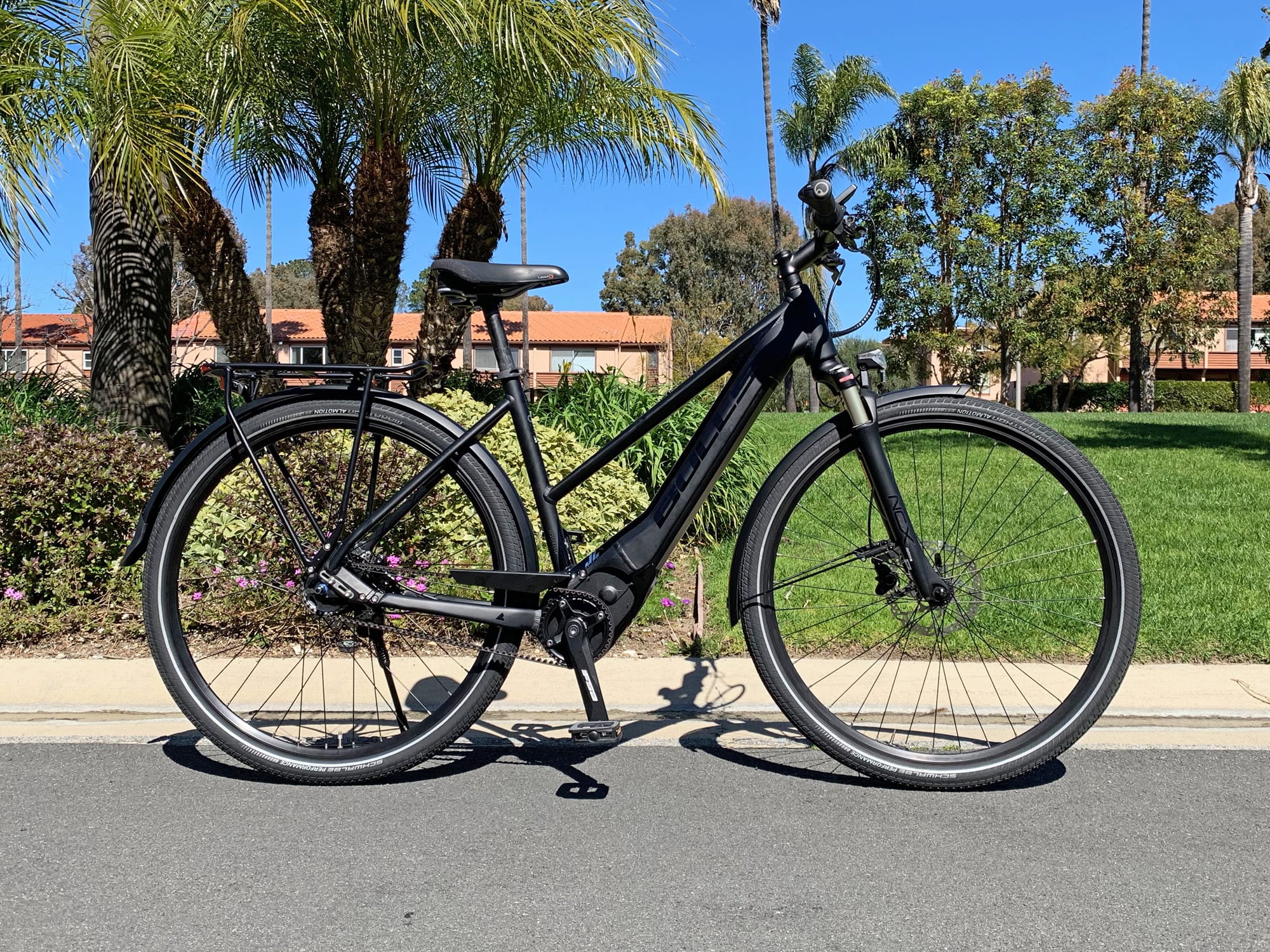

- Available in four frame sizes and three different styles! You can aim for stiffness with the high-step or approachability with the mid-step and wave models, the wave will experience the most frame flex but with the top assisted speed of 20 mph, this shouldn’t be as much of an issue, especially for relaxed neighborhood rides
- Beautifully integrated motor and battery system, you can hardly tell it’s an electric bike at all given how compact and integrated the systems are, the motor is also extremely quiet

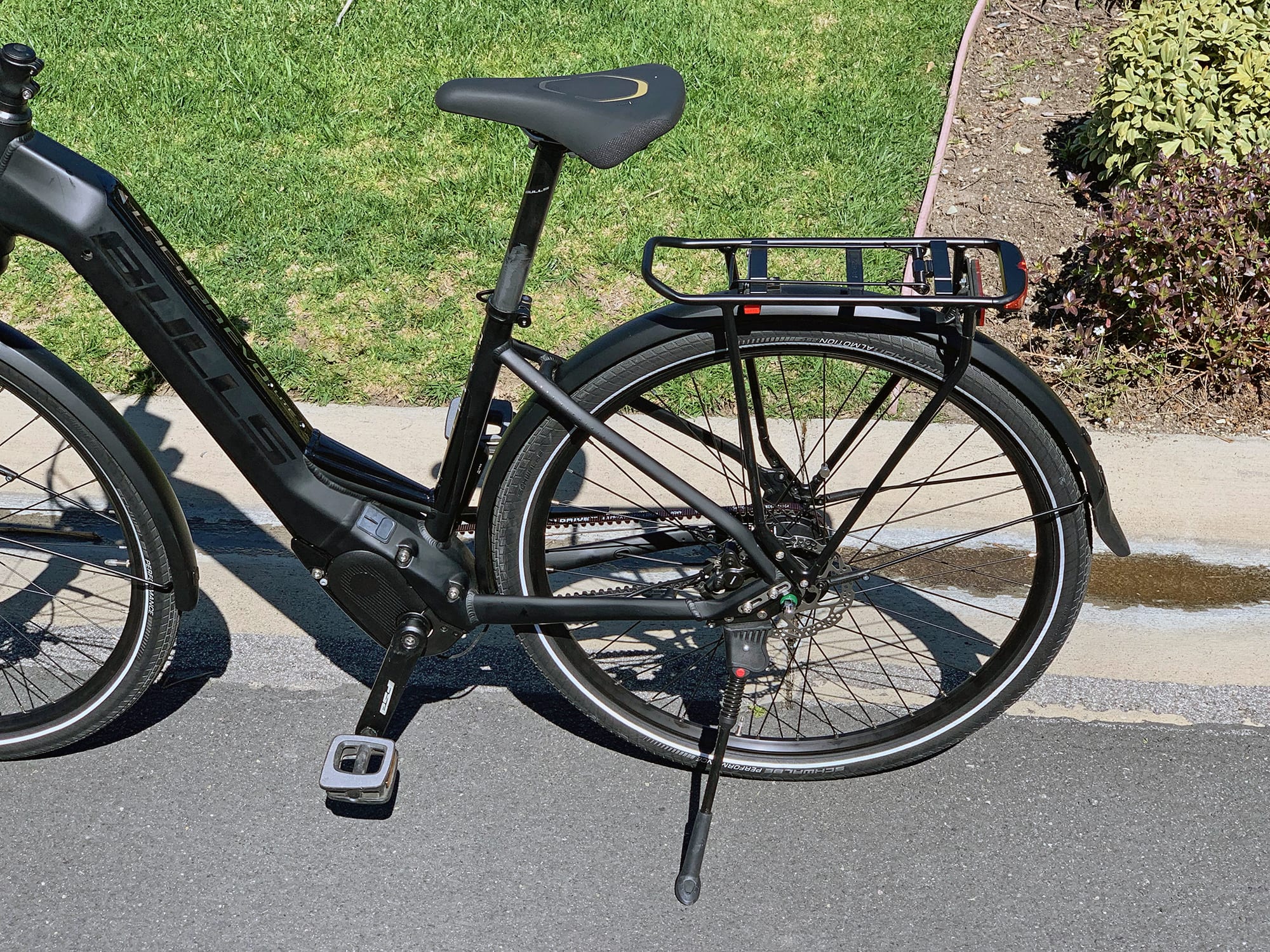

- Internally geared hubs tend to be cleaner and more durable than cassettes and derailleurs, the chain doesn’t have to jump to different sprockets so it will be less likely to fall off when riding and it won’t be strained by the mid-motor as much
- Full-sized fenders and a longer chain cover will keep your pants, skirt, or dress clean while riding, feet and shins may still get a bit wet if you pass through deeper puddles

- This battery is 37.5v and 20ah, I consider it a big win here as it is really high capacity with that amp hour rating, really just a great battery for all day riding
- The Brose S Mag (sport magnesium) is 15% lighter, is very responsive, quiet, and very fluid, I enjoyed not only its capabilities at higher RPMs, but also it’s ability to work well in varying situations

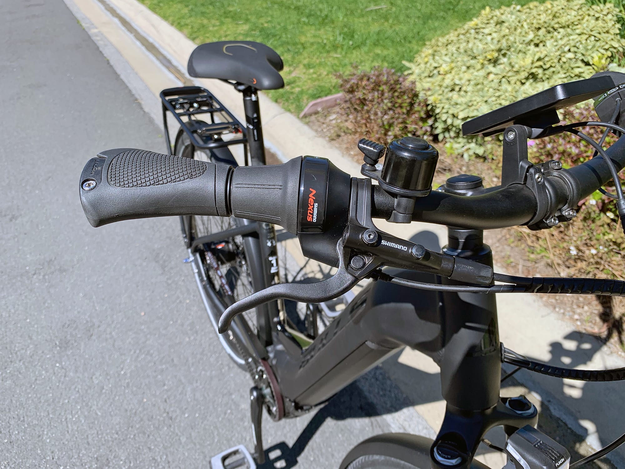

- High-quality Shimano hydraulic disc brakes with adjustable-reach levers, the rear rack is setup to handle clip-on panniers and keep them from rubbing on the wider tire, the kickstand is positioned well to stay out of the way and offers length adjustment
- I love that the suspension fork uses air vs. spring because that means you can lower the pressure if you’re a lightweight rider (like me, at ~135 lbs), the fork also has lockout so heavier riders can reduce bob when pedaling and dive when stopping, it has a quick release skewer so be sure to lock your front wheel, the seat, and the frame when parking
- I love that there is a shifter window on the handlebar, makes it easy to see what level you are in
- I would consider this bike to be more tough, there isn’t a derailleur that could get bumped out of true, the belt is sturdy and has a full guide to prevent drops, and the Brose motors are known for being higher quality and require no maintenance

- The deepest wave, step-thru, frame does experience some frame flex, this reduces pedal efficiency and may contribute to speed wobble of the front wheel depending on how much the rider weighs, how the body position is setup, whether the rear rack is loaded, and how fast you go, just keep both hands on the bars if you notice a bit of wobble on the front wheel at higher speeds

- The battery pack detaches downwards and requires a bit of hand strength and balance to hold when unlocking, so just keep an extra close eye on it and make sure the bike is stable if you decide to remove the pack, most people will probably just leave it on the bike and charge that way for convenience, but it can reduce the weight of the bike and protect the battery from extreme heat and cold by removing it
- The center button on the control pad (located near the left grip) is touch sensitive… and I found that it was easily activated even when I really didn’t want to change menus, I think I prefer a standard button vs. the touch interface because its more intentional and probably works with gloves better

- Be careful when removing the battery pack because it drops out from the bottom of the downtube and doesn’t have any handle or extra grip area, it’s a more sensitive and expensive part on the bike and the 8.2lbs can seem heavy if you’re not expecting it
